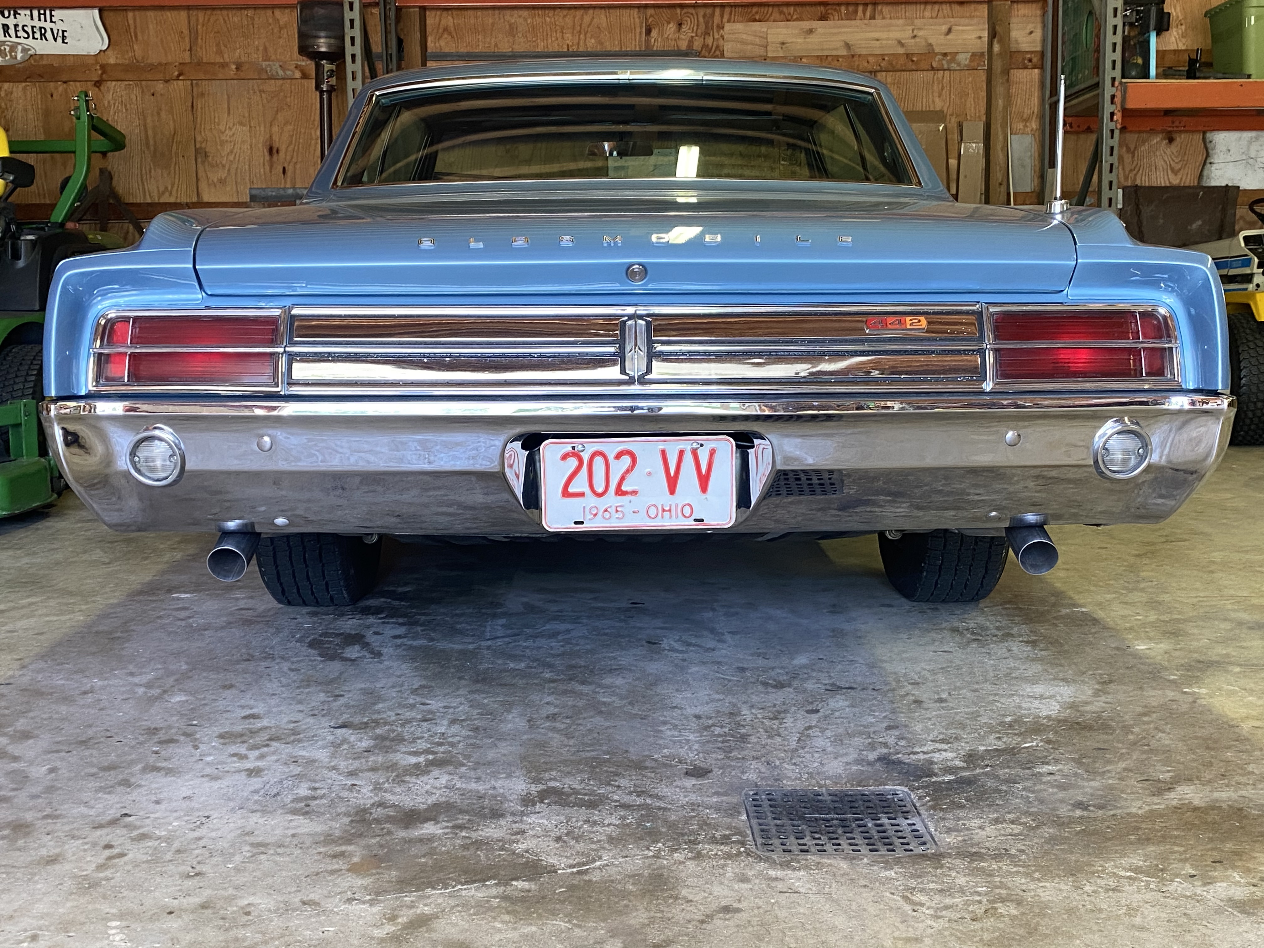

38,885…. So some might and some might not understand this, but having an incorrect look makes me insane. This was the situation with the tailpipes on the 442. The pipes are supposed to come straight out under the bumper. The pipes that were on the car came out where the lower corner of the bumper and the quarter panel connected. Whenever I looked at it, it made me nuts! Last Sunday, I had new tail pipes put on. The old pipes were welded on halfway between the rear wheel and the bumper, so all we had to do was cut it off there and add the straight pipes on. I got them on and they were a bit too long, so today I cut them to a length that was to my liking. I’m pretty anal when it comes to symmetry, so I spent a bit of time making sure they’re the same distance from the bumper, both with length and clearance from the chrome. Once I had them placed correctly, I took a file to the end of them so they’re nice and smooth to the touch. In my mind, this is such a great aesthetic upgrade. I’m very pleased with how they turned out! On to the next project.

Re: 1965 Oldsmobile 442
I believe the right side is slightly longer than the left. :mrgreen:
Posts: 1801
I'm not a stickler for originality but, the pictures make your point. BIG improvement!!
Posts: 1296
wxo wrote: Fri Jul 29, 2022 11:16 am I believe the right side is slightly longer than the left. :mrgreen:
HaHa! I measured twenty times to make sure it was correct!!
I even repaired my measuring tape to make sure it was right.

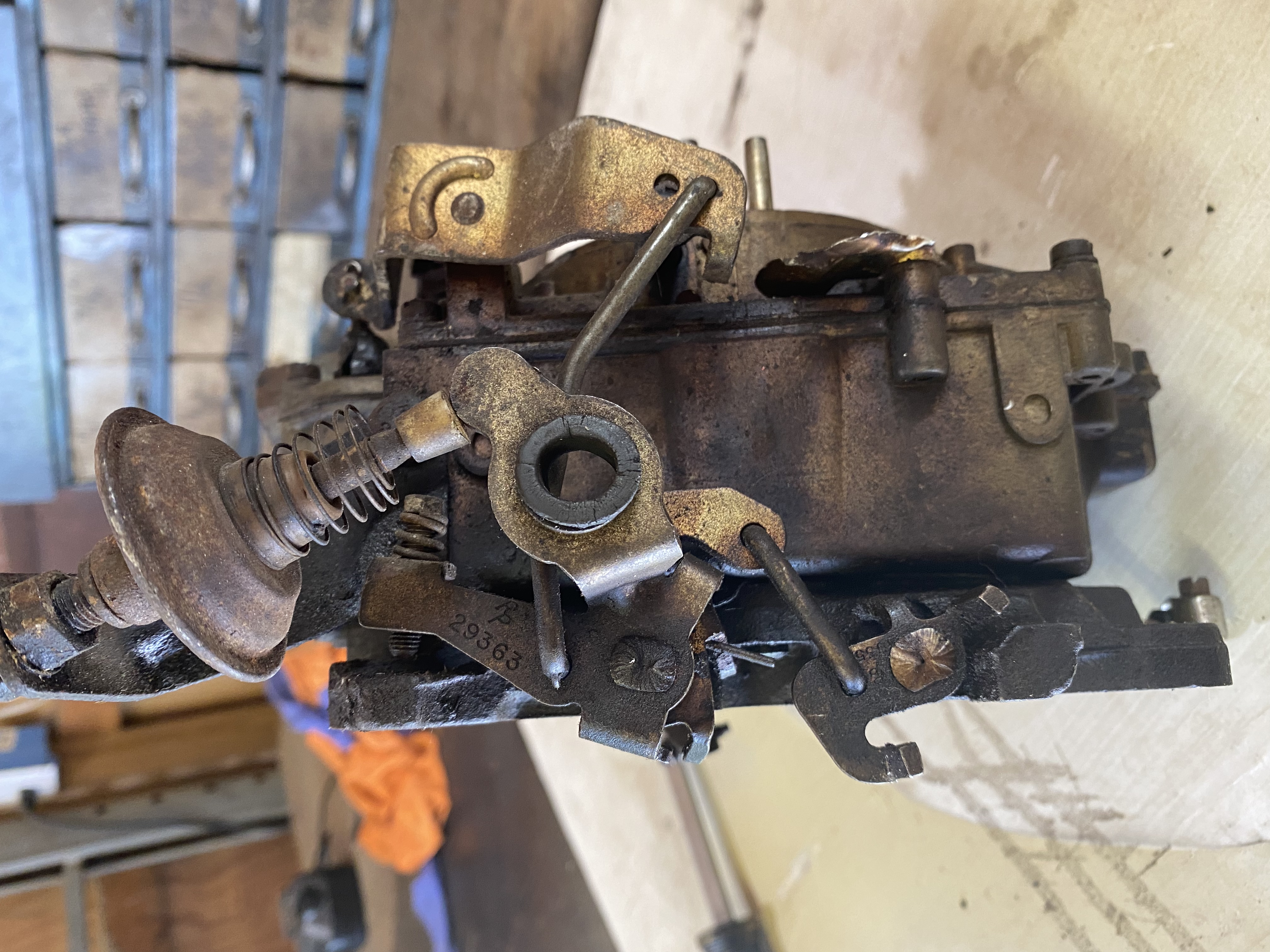

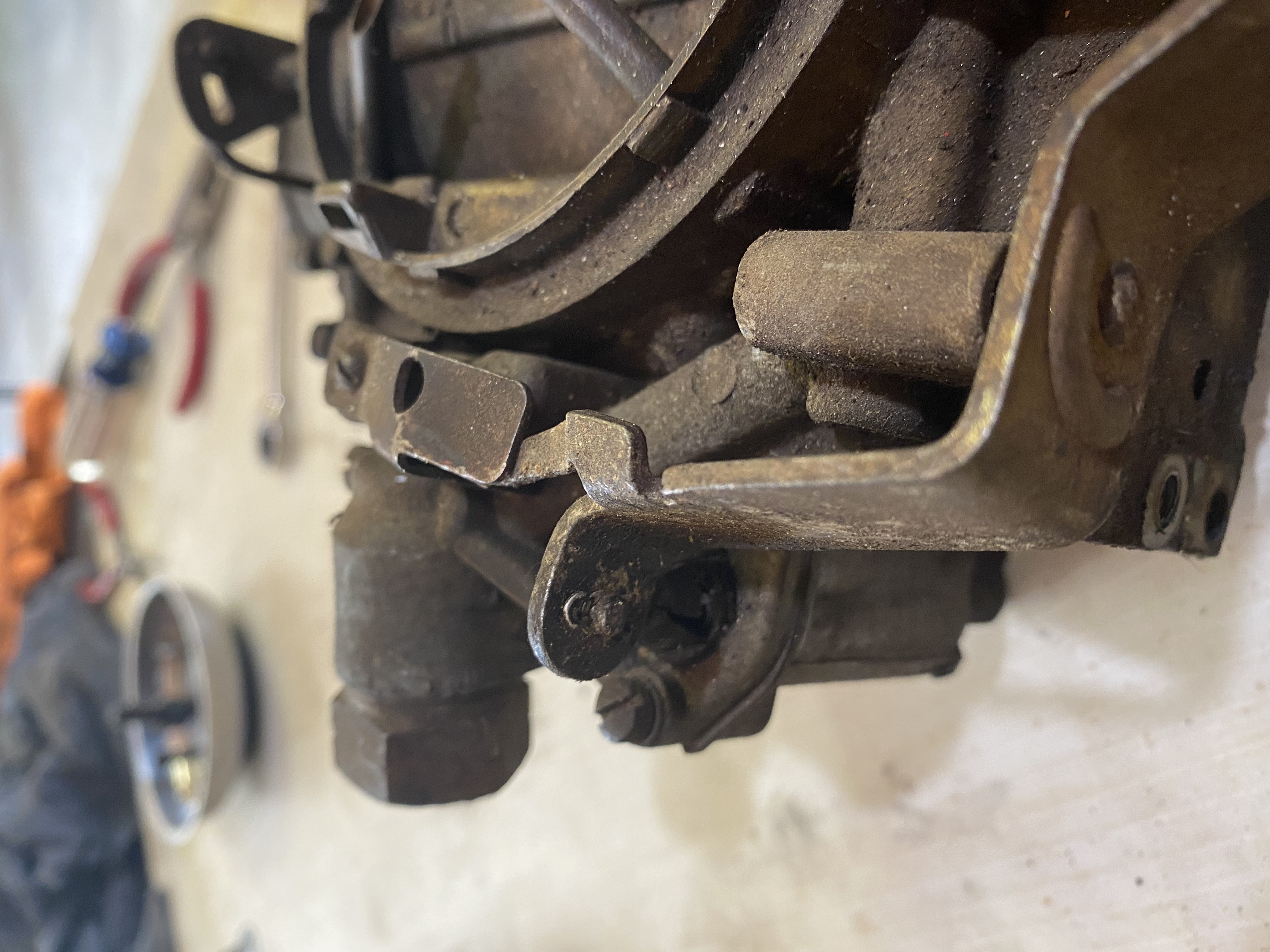

39,502 … One part of a large pile of ‘65 Olds parts I acquired from a Facebook marketplace was a 4GC Rochester that was factory stock on a 425 Olds. It’s very similar to the carb that came on my 442. My carb is a one year and one model only carb. It’s pretty rare. Not wanting to do my first rebuild ever on a 4GC on my carb, I figured I’d do a trial run on this one. It wasn’t a horrible undertaking, and like most projects, if you take your time you’re rewarded with success. The rebuild was pretty simple aside from a check ball that was cemented in the hole it is designed to cover by old crappy gas. Literally, there was no possible way to remove the ball. I soaked it for a couple of days with penetrant. I tried heating the fuel bowl. 150 psi air wouldn’t blow it out. So I gambled on drilling it out. It worked! Today, I did the install on the car. To my surprise, the car started and ran perfectly on the first shot. No leaks. The only issue I ran into was that I overthought the air flaps in the secondaries. They’re adjustable, and from my prior knowledge of Rochesters, you can adjust this to allow air to come in faster. I made it so it was too fast, and I got a bog order WOT. The base plate needs to be removed to get to the air valve. It took me three times to get the speed correct. I can tell you that this rebuild is such an upgrade. There is no fuel smell under WOT, it idles consistently at the same RPM, and the choke works perfectly. My plan is to run this carb until I can get the original one rebuilt. I guess that means I’m half way through the project, but I can keep driving it and enjoying it while I take my time with the other rebuild. Parts will be ordered this weekend for phase II.
