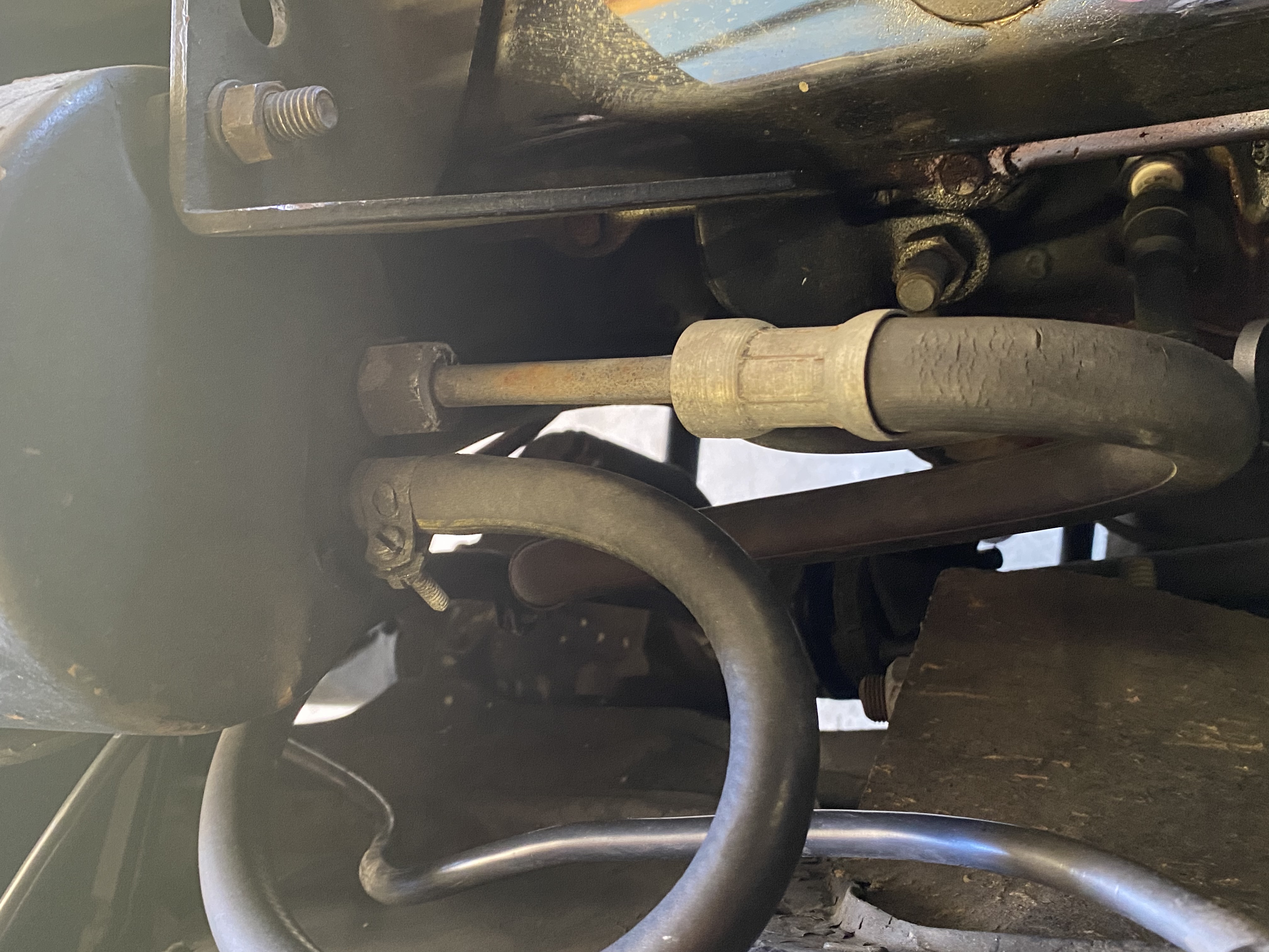

Last Saturday, I had some time to take a couple of more steps toward reliability. The power steering lines
were still holding and not leaking, but the pressure line was cracked and dry rotted and the fluid was
black. I purchased both the pressure and return lines (Gates brand) and had a quart of ATF in my inventory.
With parts in hand and time to work, I went for the install. The work wasn't that hard at all, the worst parts
were the clean-up of the fluid that got everywhere despite my best attempts at keeping it in a drain pan and
getting the pressure line off of the pump. (I had to sawzall the line off and use a deep well socket instead of
an end wrench to get the fitting off.) I also changed the voltage regulator. The old points-style regulator was
functional, but I was worried that it would fail. Solid state regulators are a better option and are less prone
to failure. That install went well except for the fact that I lost my 3/8" socket as gravity wasn't my friend
that day. I searched for 20 minutes and still couldn't find it on the car anywhere. I figured that, at my current
labor rate, it was a lost cause looking any longer and purchased a new socket on Ebay for $4.95 to replace it.
I test drove that afternoon, and on the way back, my ignition system developed an issue and the car won't
rev over 3,200 rpms now. Totally unrelated to the work I just did, I have some stuff to figure out, but I will.

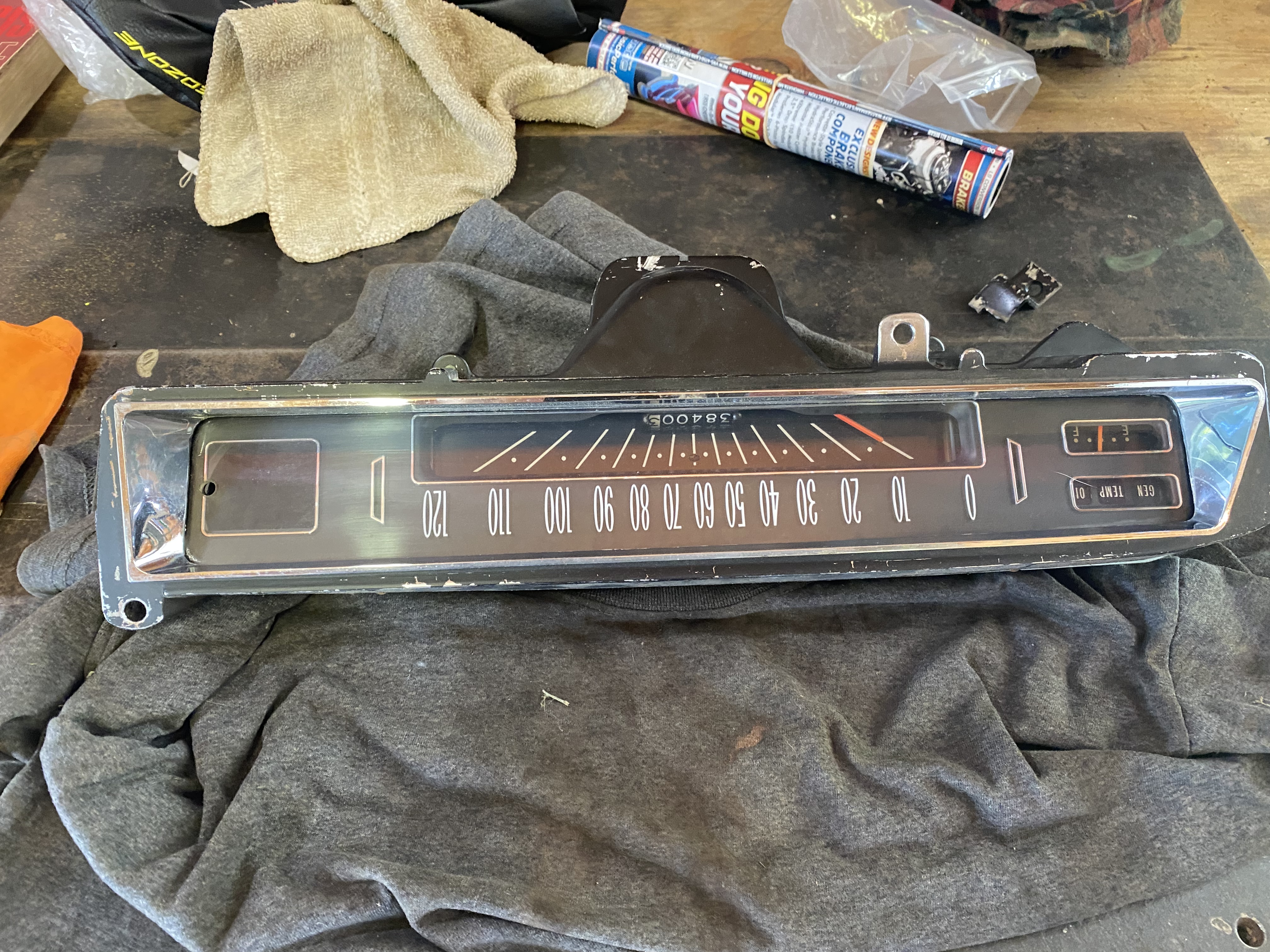

Odometer repair
38,481… For the first time since I’ve owned this 442, I can post the mileage as the odometer in the car hasn’t functioned since I owned it. I purchased a nice cluster on EBay for $125 shipped to me. After cleaning it, lubing it, and learning how to change the mileage on an old speedometer (there are no YouTube videos on how to do this!) I decided it was finally time to do the install. Fortunately for me, I purchased some manuals for the car and they gave me the correct guidance on how to remove the cluster. There are only three nuts holding it to the dash, but they aren’t the easiest to access. With some struggling, removing a bracket and lowering the steering column a bit, I was able to get it out. Truth be told, the unit in the car didn’t look as clean as the one I had just purchased, but I decided to keep the original cluster and just change the speedometer head. I spent some time touching up the orange on the indicators for the fuel gauge and the speedometer as the orange was pretty faded. I had a bottle of the correct Testor’s paint left over from my ‘69 Chevy truck project a few years back. After final assembly, I put the cluster in without much trouble. I taped the nuts to the socket to keep from loosing them while installing on studs I couldn’t see. This worked sweet as I didn’t drop any! The project came to a crawl after I hooked up the main wiring harness to the dash. No lights AT ALL on the dash. I was stumped for over an hour. I got out the wiring diagram and studied it for a bit. Embarrassingly, the issue was an easy one to diagnose. With a test light, I found that the harness was hot. So was the peg it clips too and the rest of the dash. The issue was that, when I cleaned the little bulbs in the dash, I installed them on the dash and NONE of them was making contact with the circuit board. I had to pry little brass tabs down on all of the bulbs and they worked. Talk about a waste of time. Anyhow, after all of that, I then lubed the speedo cable and bolted it up. When all was said and done, I took it for a spin and both the speedo and odometer work. Woohoo! I think I had a strong five hours into this whole ordeal. Hindsight being 20/20, I could’ve saved myself some time by bench testing the purchased head unit and bolting it straight in. Hopefully there won’t be a next time to have to use that mentality.

Any idea from prior owner how long the odometer was not working?
I know this unit is quite old but odometer fail at 38k seems unlikely. do you know if gear fail is common in this unit?
Re: 1965 Oldsmobile 442
The previous owner didn’t mention the odometer not working. With little effort, I was
able to make it work, but I’m not sure it would’ve been reliable. I was unable to find anything
about 1965 Cutlass dash failures in my searching. My guess is that a tooth was chipped and
it couldn’t quite engage. My title reads 38,400 miles, which would need to be verified with
records or reciepts to actually state that the mileage was actual. I think with a car this old and the fact
that speedometers were limited on mileage ability, most people purchasing don’t worry
about “actual miles.” I didn’t use mileage as a determining factor on my last three vintage
vehicles, but rather the condition of the car itself. The real reason I wanted the odometer to
work, aside from maintenance recording, was it drove me crazy that it didn’t work and I knew
I could make it work with some effort.
