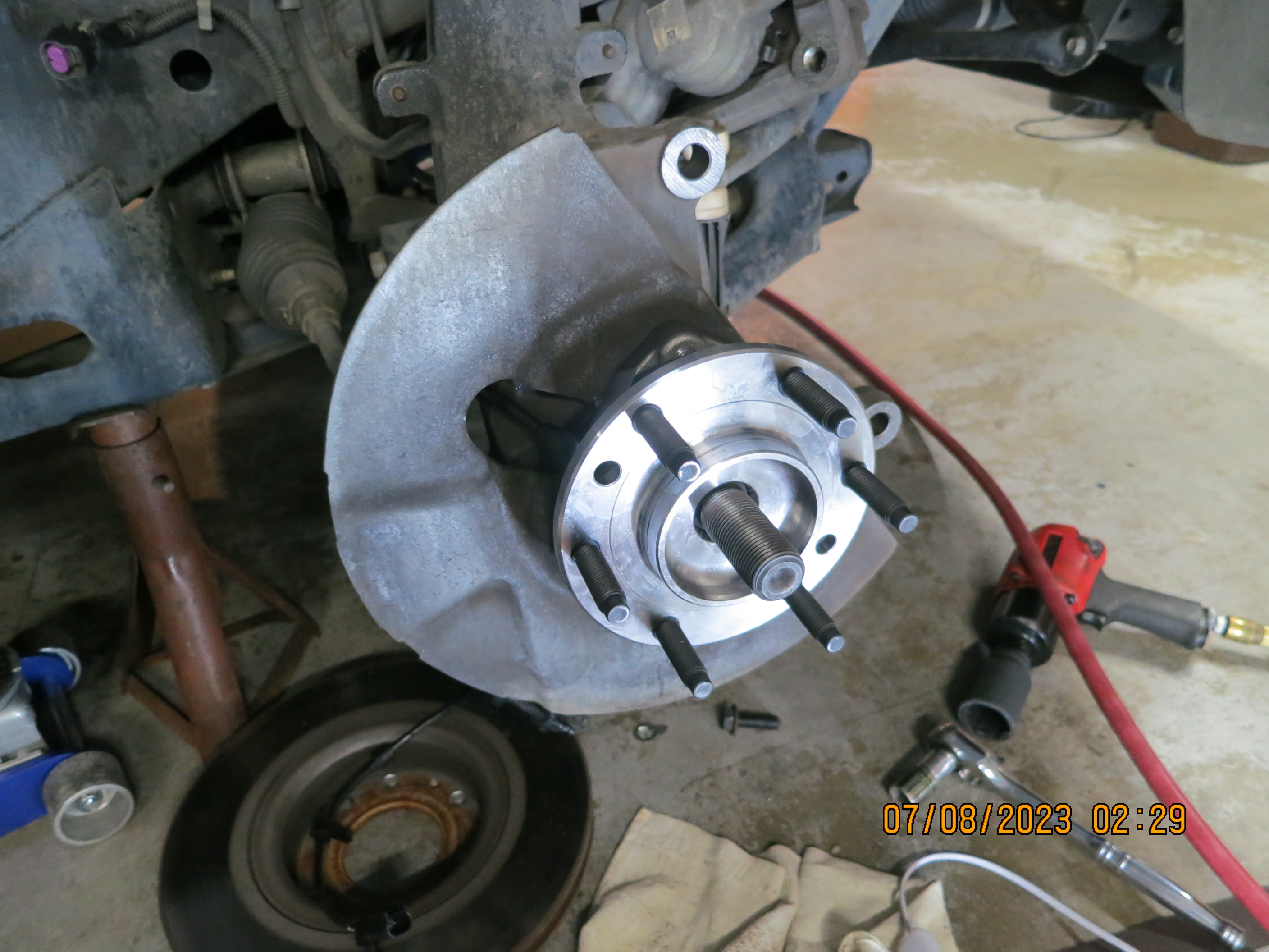

Yesterday, I corrected a problem with a whirring noise that varied with wheel speed. I used my "Chassis Ears" to compare the sounds from each of the four wheels while driving down the road. The sound was definitely coming from the right front. The front wheel bearing was the likely suspect even though I couldn't feel any roughness. This broke new ground for me. The wheel bearing on this vehicle is integrated into a front hub assembly. No more grease packing. I bought a very nicely finished "Detroit Axle" hub from Amazon for $56 otd. I also had to buy a 36mm deep impact socket to get the spindle nut off (~$14).
