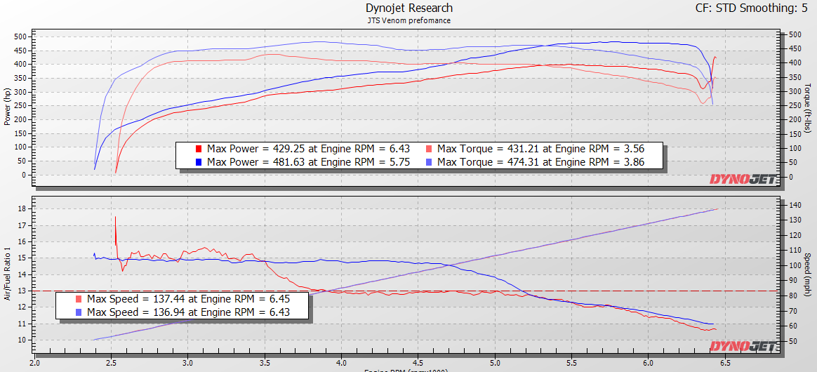

It may be Paul’s bday, but I’m very happy and got a nice present today. Red lines are pulley only and blue lines are with tune. Assuming 20% loss for an automatic, that’s 600hp @ crank, almost 130hp gain for $1K. *does a happy dance*.
Not much more I can do performance wise other than some minor improvements for intake and exhaust.

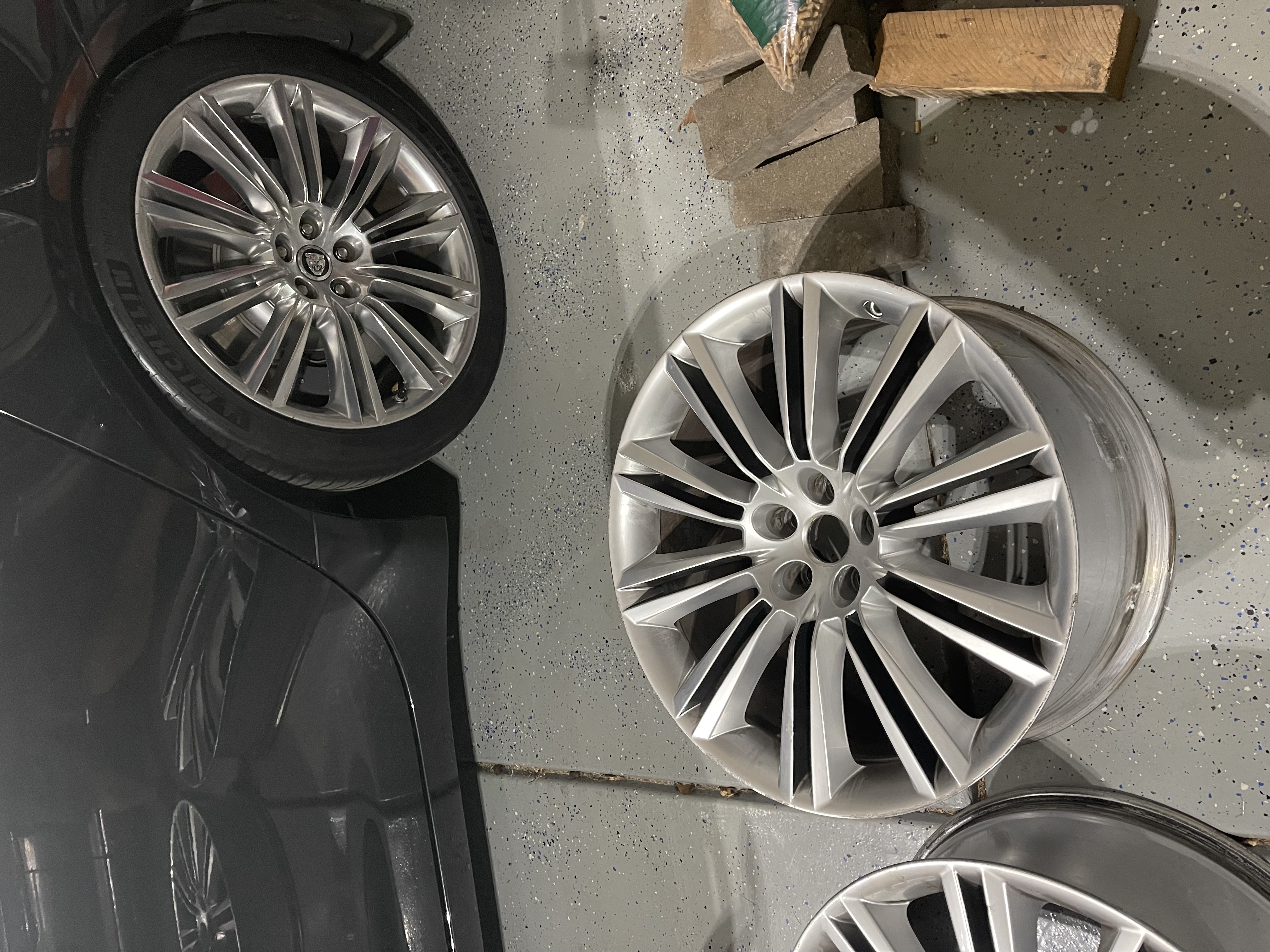

For the past few weeks, I’ve been dealing with a slow leak on one wheel despite new tires. The shop couldn’t find a leak but we suspected the old weld repair might have a developed a crack. Anyway, that was enough to make me sand and polish that new set of rims I got on the cheap that had some curb rash. After a lot of elbow grease, I added some really nice clear coat and boom, looking much better and not leaking.
