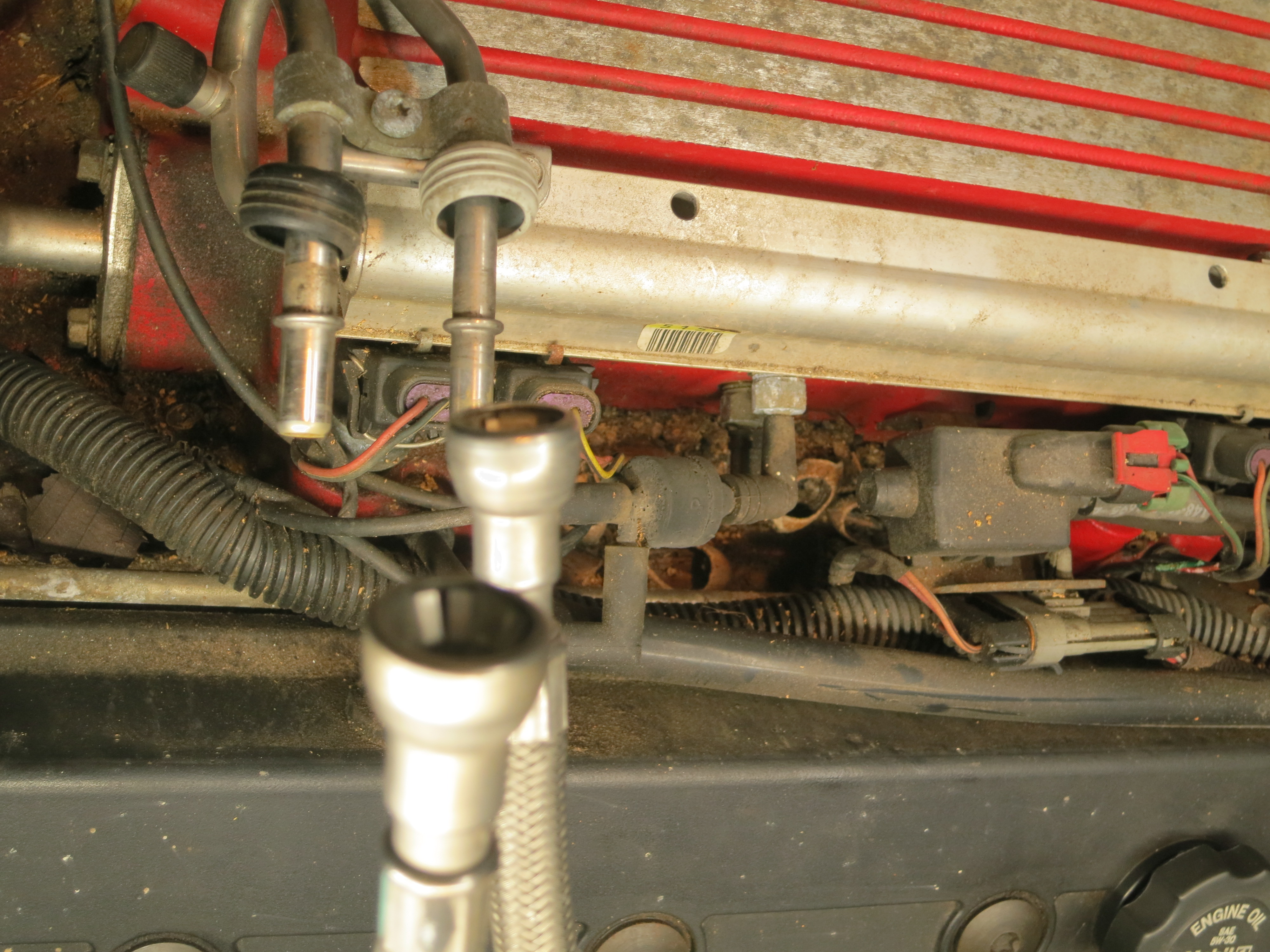

Today I didn't accomplish very much. I disconnected the fuel lines from the fuel rail before I began to remove the rail. I spent time cleaning out the pecan shells that the squirrels left on the intake manifold.
Along the way I found a vacuum connection that has obviously been broken and leaking for a long time.
Once the fuel rail was out, I pulled an injector to see what things look like. I struck water again.
Next time I plan to try to clean out the rail and the pressure regulator and then move on to the injectors. I hope to be able to learn how to test them to determine if they are still salvageable along with the regulator.

I don't know yet how bad the fuel lines are. I haven't gotten to that point yet. I have been on the phone with Mostmint to get his advice and understand what I am up against. One of his fuel lines actually ruptured. He's been there. The CLR or equivalent is a good idea. I will seriously consider that. Thanks.
I'm still picking at the fuel system. I am now focused on the injectors, fuel rail, and pressure regulator. I disassembled the fuel rail assembly and saw that the water contamination was bad. Rust on the injectors leads me to believe that water has sat in this system for years. I was able to have a long phone conversation with Rich Jensen of CruzinPerformance in Michigan. He has 30 years in the injector rebuilding business. He is currently laid up after shoulder surgery and was gracious enough to agree to a phone call on Sunday. Rich took on any and all of my questions about fuel injectors and related questions. I asked him why the part number on my injectors doesn't match the information I found on the web. To answer the question he went out to his garage and looked at one of the two LT4 crate engines he bought back in the 90's to verify that my part number is the same on his engines. You can't get better verification than that.
Bottom line he stated that water is the enemy of injectors and attempting to rebuild mine would probably be futile. OEM injectors for this LT4 are hard to find and expensive. Rich said that injector technology has greatly improved since the 90's and I'd be better off with something newer. I'm looking at ACCEL injectors with the same specs.
The pressure regulator in the Vette is, as expected, clogged with rust also. Rich suggested an adjustable one, but for now, to keep things simple, I'm going with just a replacement.
My next task in this mini fuel system project is to find new 0-rings for all these components (except the injectors). "The Beat Goes On"
