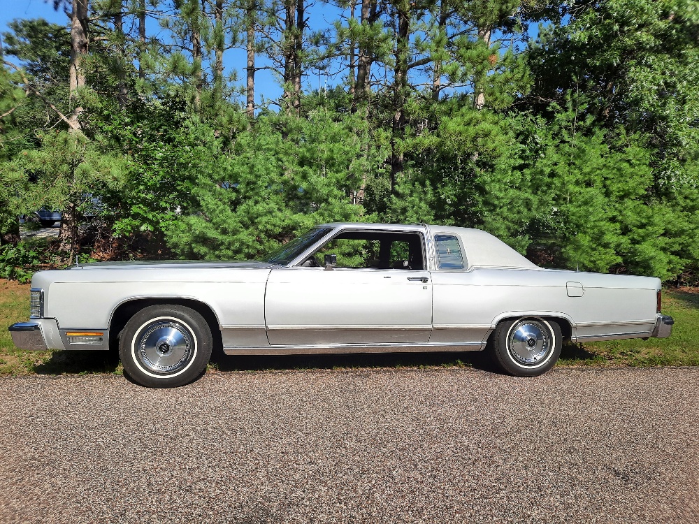

Hello All - I'm Perry Bush, the lucky guy now responsible for this wonderful car. It will be some time before any significant changes are made, if ever, but deciding to keep her story going here. I've read the entire thread a few times now, a couple others as well, and really like what I see! Sharing of input, experience, opinion, recommendations...without some of the nonsense I see too often elsewhere. Congrats and Thanks!
Several years ago we had to start naming the Lincolns (just saying "I'm taking the Lincoln" became confusing when there was finally more than one that was drivable). I'll be calling this one Belle, after the Beauty in the Beauty and the Beast stories.
I don't know when or if I've ever been happier with the entire purchase experience with an old car, and there have been a few. Even with this trip including a car hauler tire blowout on the way home. Starting with the car! A true beauty indeed, better than I expected and Jim already told me I'd be impressed - he was right :) Sounds sappy, I've been accused before, but I'm genuinely honored to take over. Especially so after spending time directly with Jim. We've been in touch off and on for over a year and I knew he was a good guy and skilled mechanic, but what a host and gentleman also. Walt (WXO), too. Thank you both so much one more time for taking on this project, doing it so well, and documenting it here with all of us. What else could a guy want?! Well, how about a pick-up bed, and then some, full of extra and original parts, maintenance supplies, documentation, some tools, and just general good miscellaneous garage stuff? All in a good and grateful home.
I'm waiting now for the WI DMV to snail mail the new title and plates to me. Until then, keeping the cruising to the neighborhood, but expect to be driving this car often, let's say very nearly daily. Yes, it will be visiting Wisconsin International Raceway about an hour from me as well. I'll be looking for a trailer to carry the light weight jack, drag radials, tools, etc. Can't wait. Jim already added the hitch, good thinking.
I'm already crazy about this car, and looking forward to keeping this thread alive.
Couple fresh pictures from Wisconsin attached. Pleased to be here!
