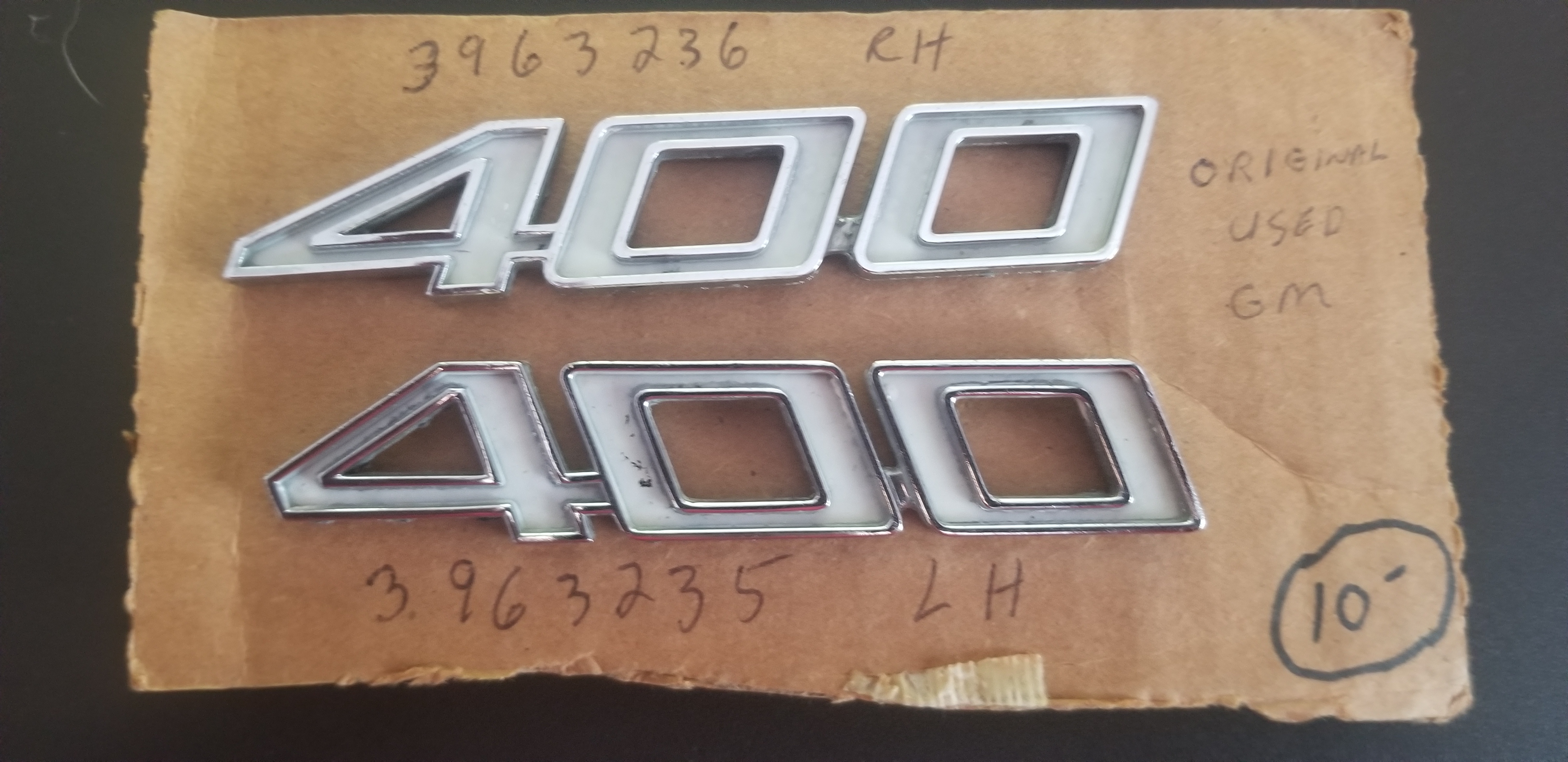

Maybe it's time to finally install these. I think I got them at Carlisle. They've been in a bag on a shelf for a long time. The white would match my stripes.

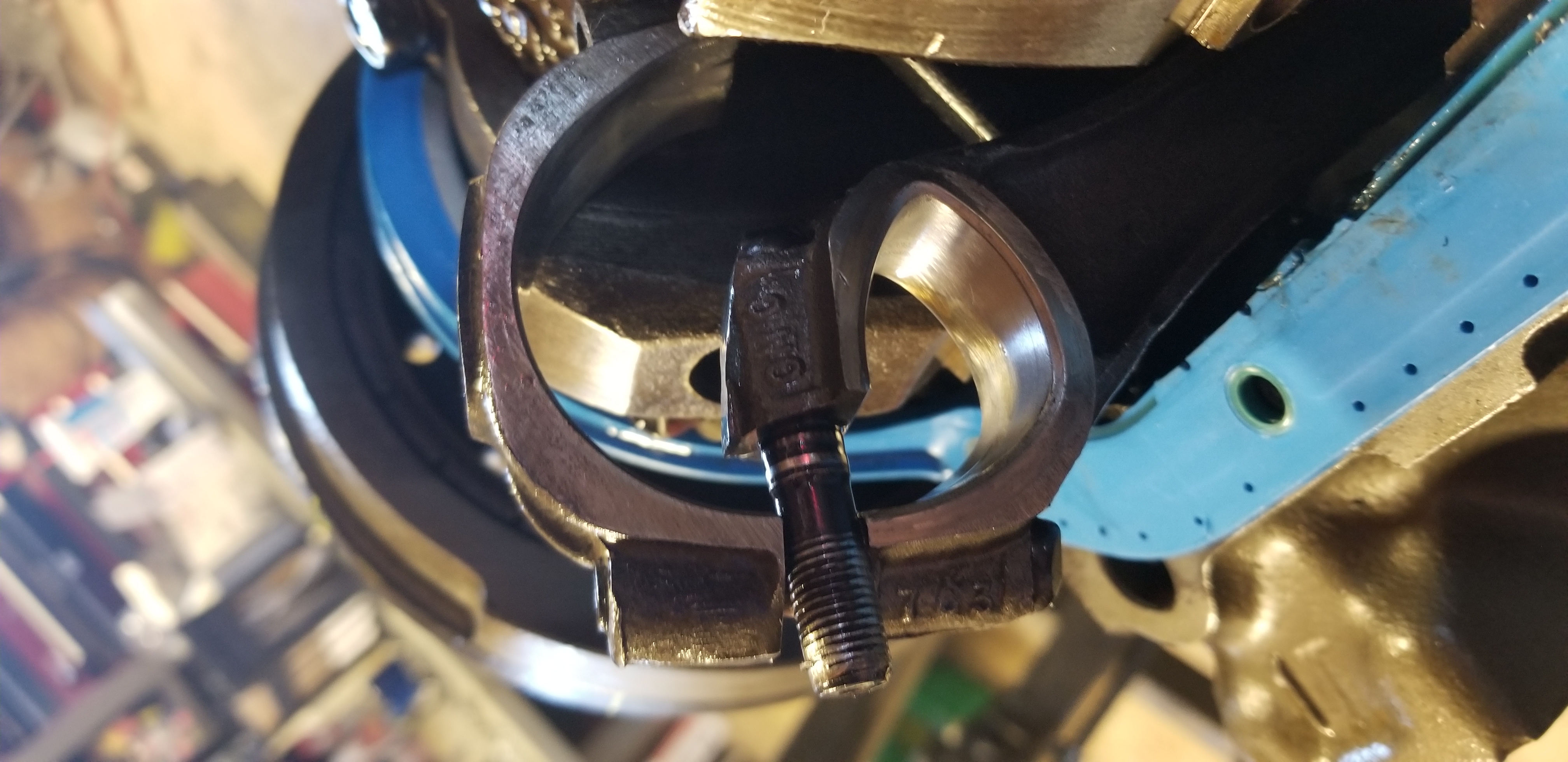

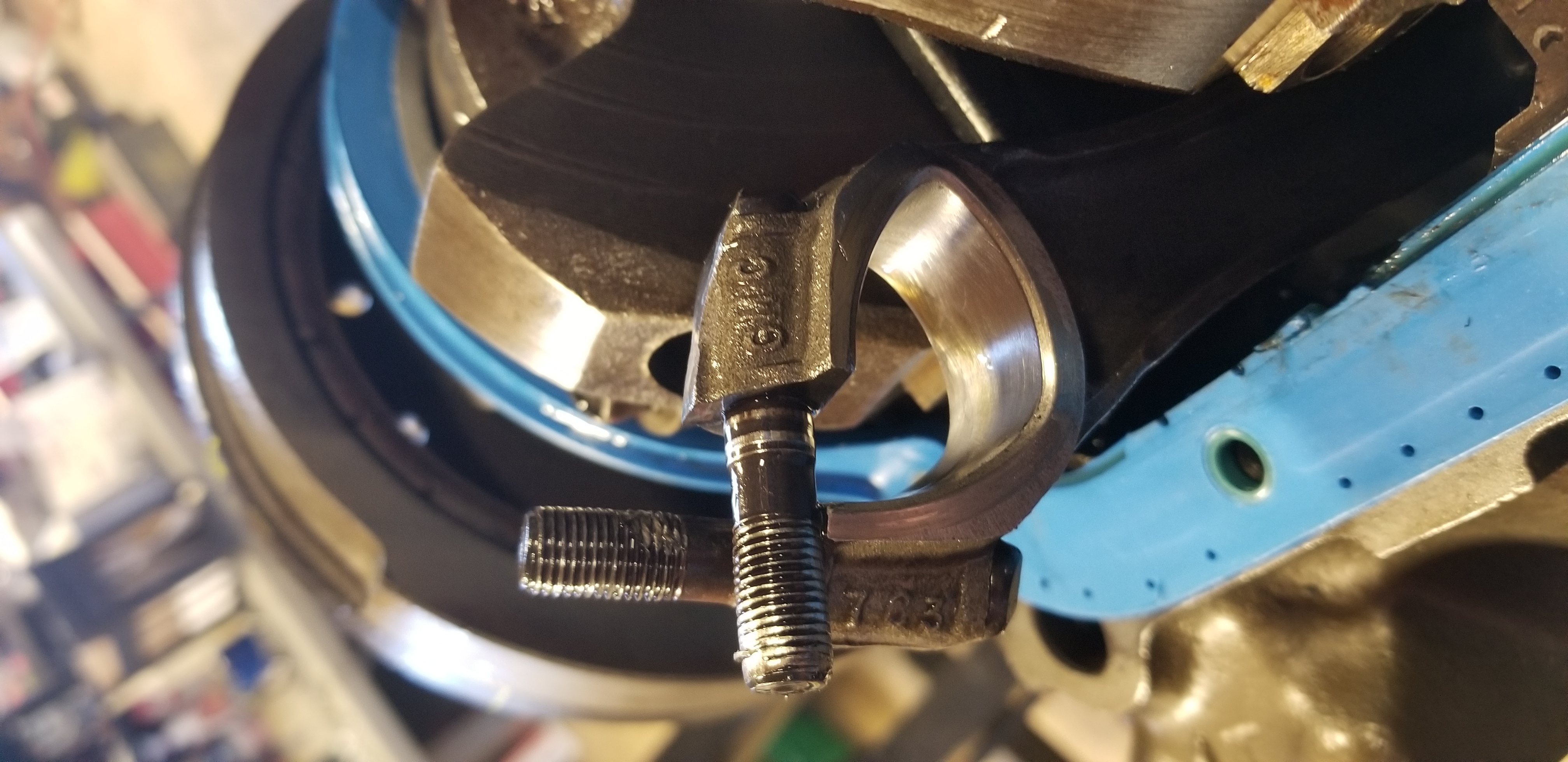

Re: 408 resurrection / potluck
#2 rod. That was the same one that had the bad/wrong bearing last time.
ugh. that looks like the rod cap bolts backed off? there is no break in the rod or cap.
- Posts: 2624
Yup, thats what it looks like. I found both nuts and they look fine.
How does the crank look??
- Posts: 399
- Posts: 2624
Like it got in a fight with a rod. Double KO.GMJohnny wrote:How does the crank look??
seems likely the rod cap bolts somehow got stretched or they were not torqued correctly.
