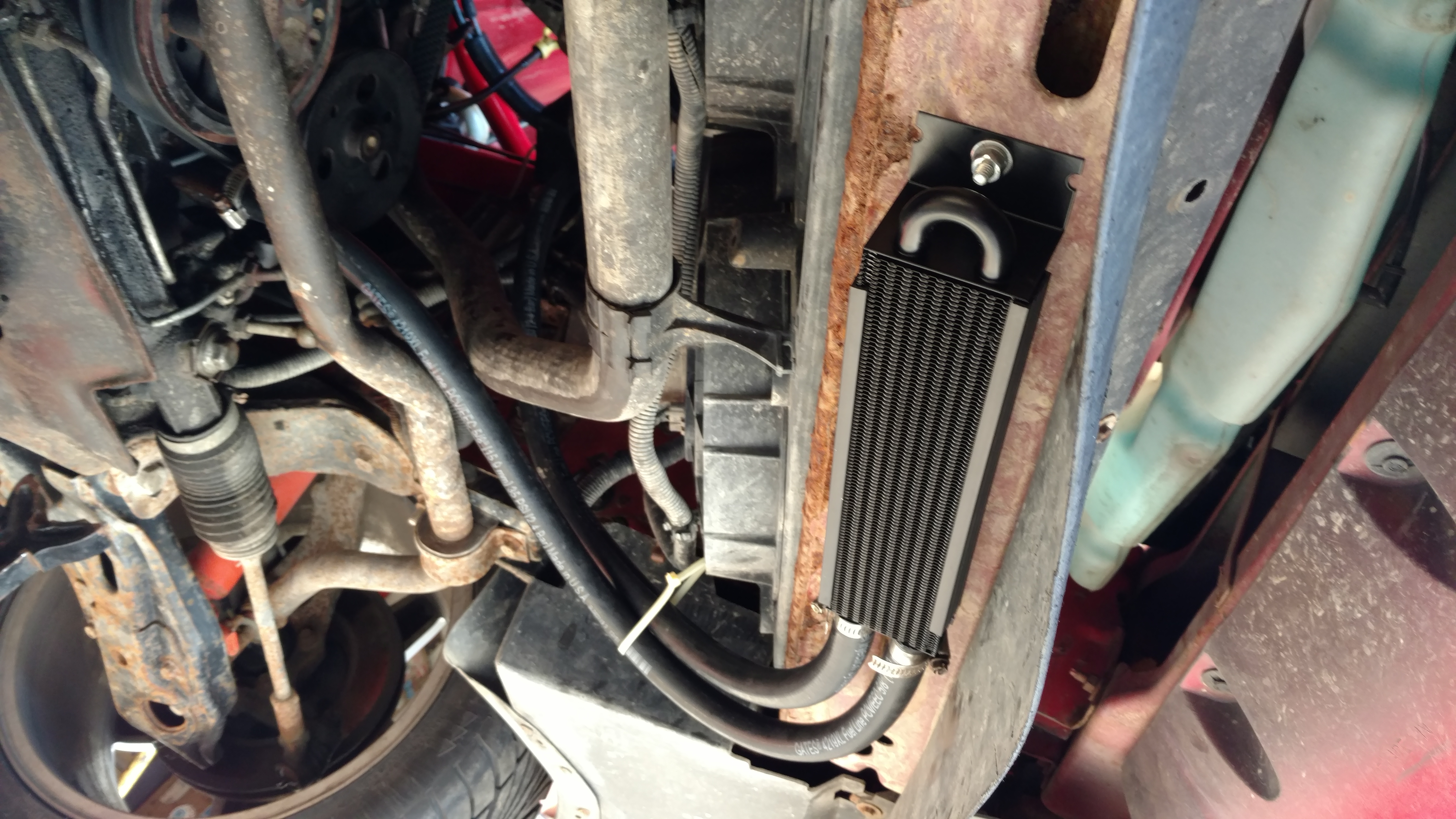

With another track day looming, we had a few things to do. The most important was the power steering cooler and synthetic fluid. We also rotated the tires, checked the brakes and fluids, installed the new non-leaking gas cap, and pulled out the rear seat and seatbelts. Good thing too as there was a stinky mouse nest onder the driver's side rear seat.

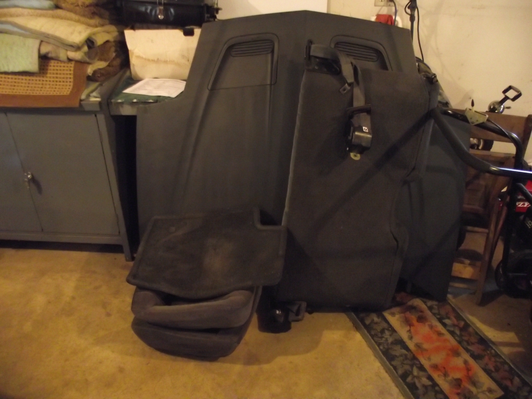

No more back seat
No more back seat
15 maybe 20 lbs. of stuff

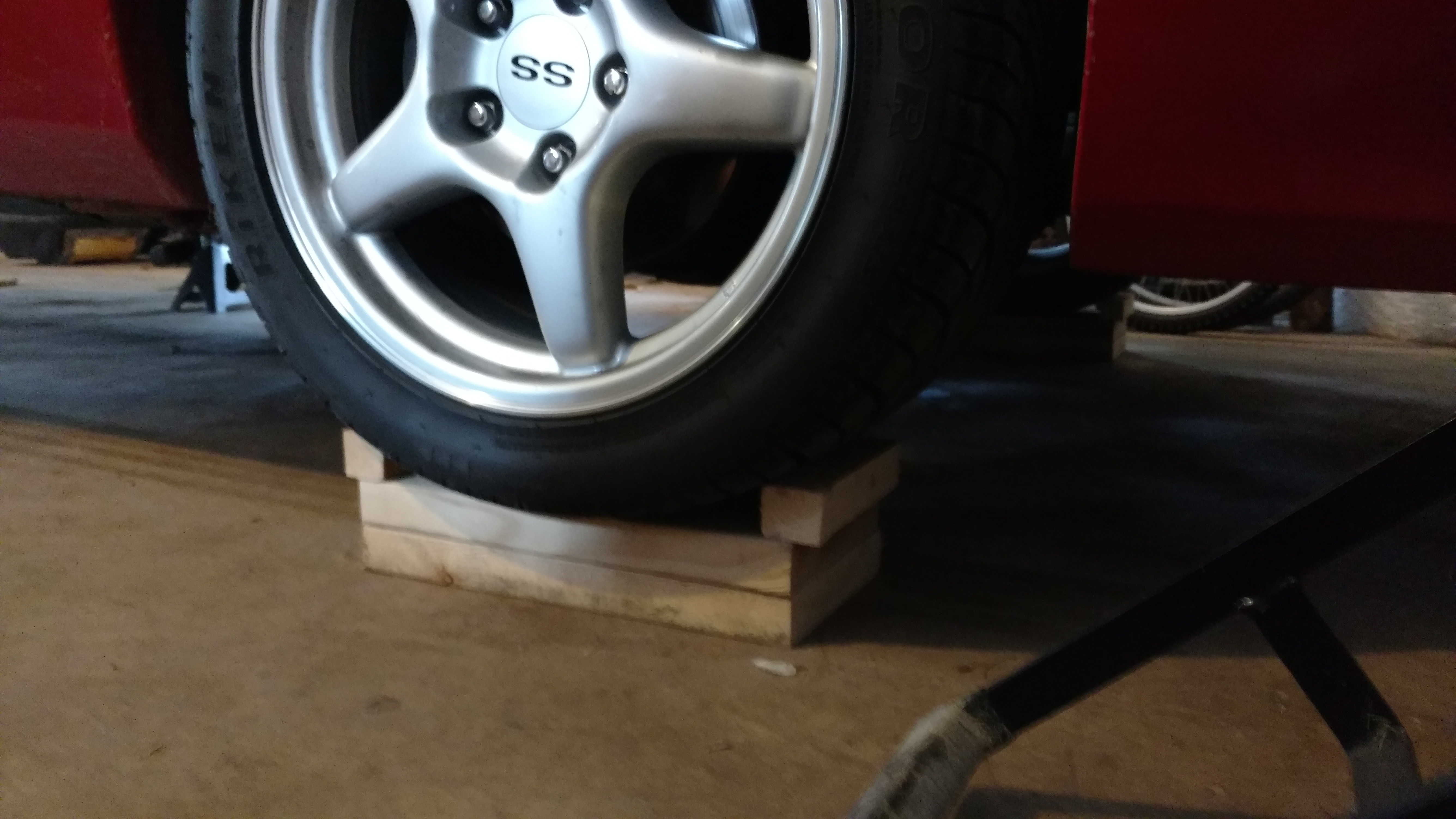

Yesterday I did a little prep work to get ready to pull the rear end out. Got the car jacked up, put my newly made wood lifts under the front tires, and pulled the muffler and tailpipes off. I ordered a 3" muffler last week, but realized that the current pipe is only 2.5", so I'll have to swap it out on my next trip to Summit.
Hopefully next weekend we can get the rear end out so we can get it to JD race for the 3.90 gear install. I also have an aluminum driveshaft and tubular rear lower control arms coming this week.

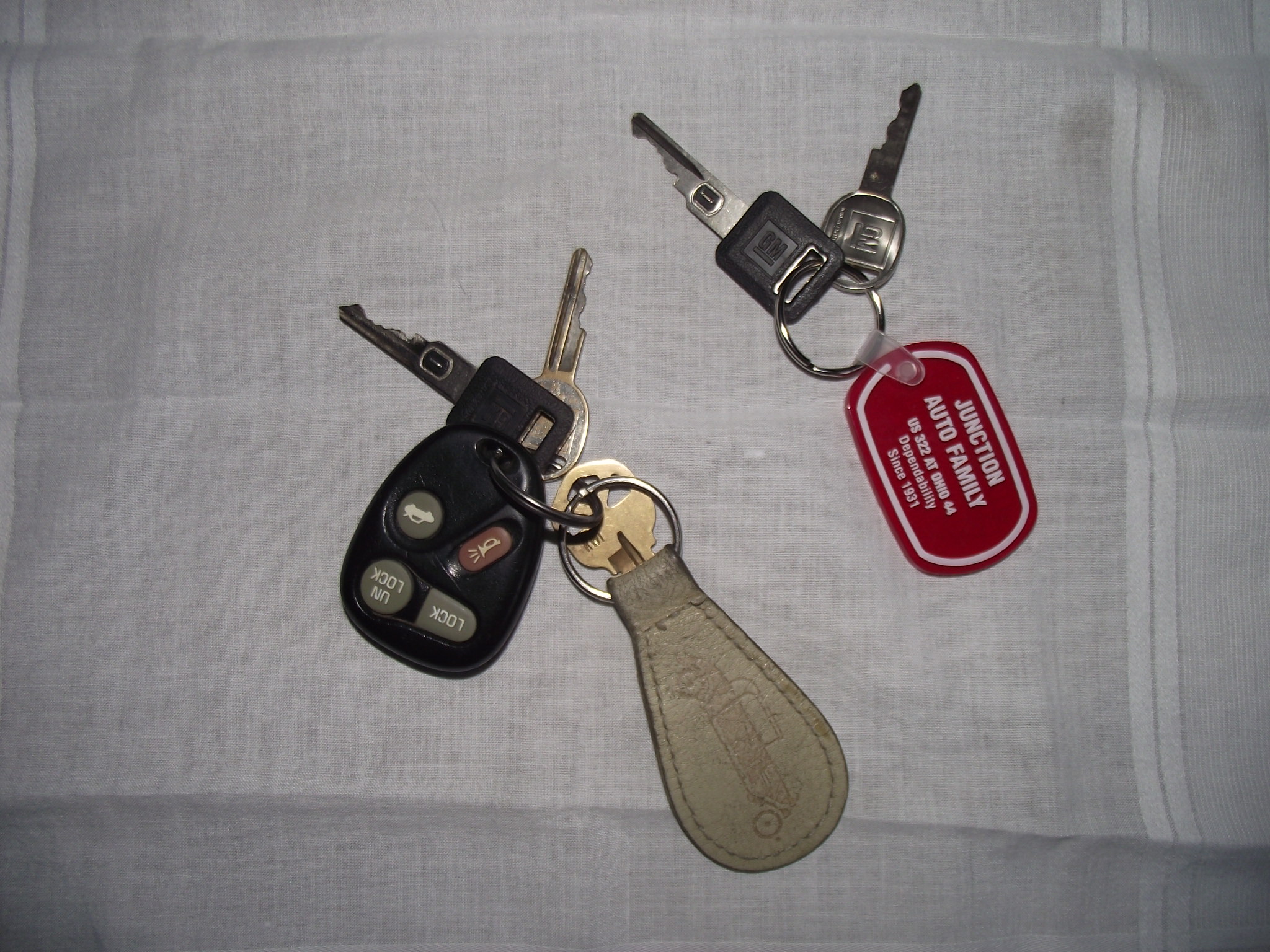

TrackBird came with only one set of keys. After I tried a few things looking on the internet,
I just went to Junction, they have a secret box, ordered the correct keys and picked them up today.
Now there are two!
Now there are two!
OK, I tried them and the car comes to life and the doors can be locked. (Deck lid is a different matter.)

Seems to me they could make a lock for the back that matched your key. Maybe too old?
