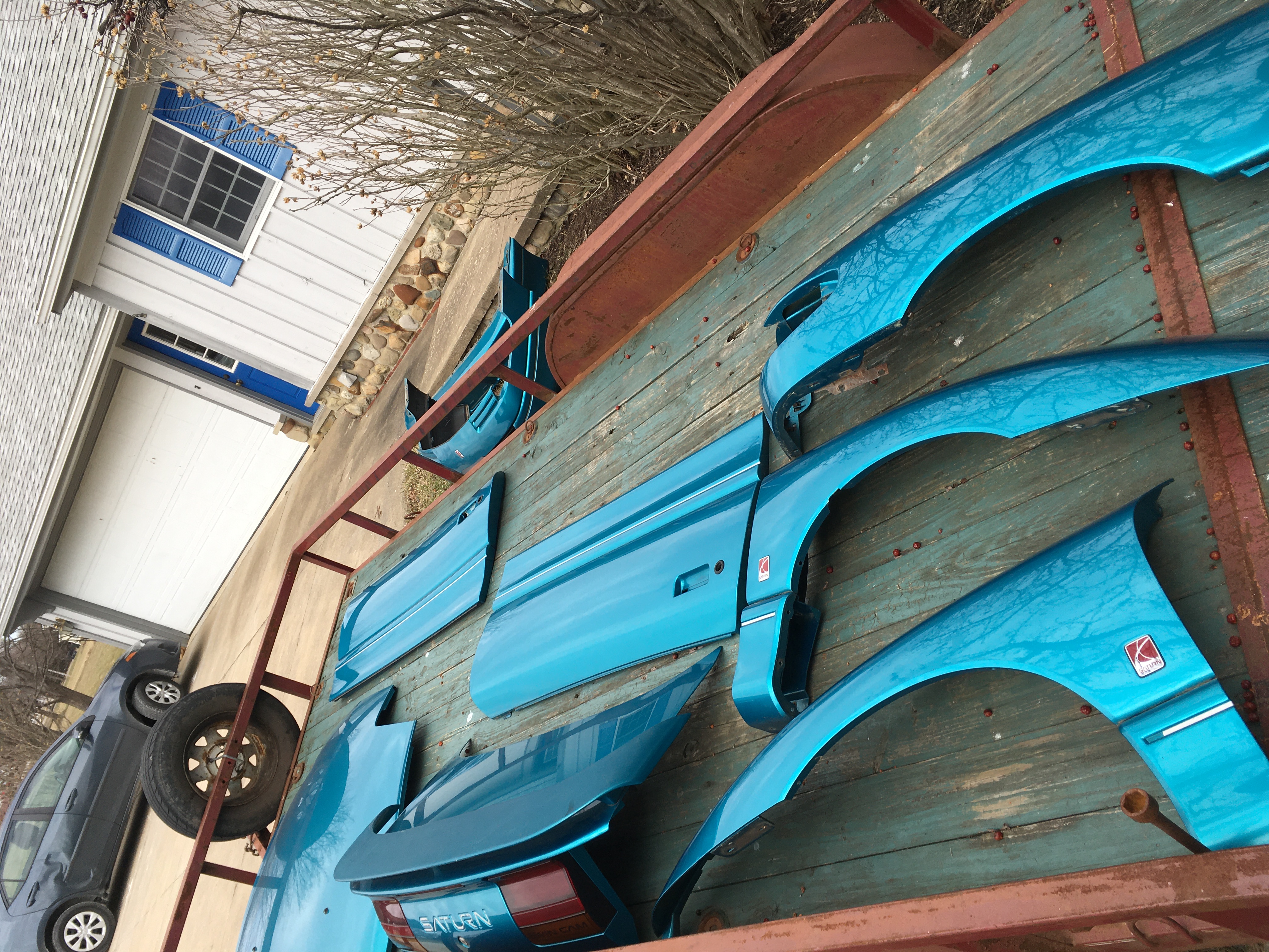

With too many cars at the inn, and this one in the auxiliary inn I am going to move this car. I had it on FB marketplace for a week with little interest - admittedly at $1500 the price is a bit high. The body panels are so nice I plan to keep them for the race car. I'm still deciding on the rest of the car but I'm leaning toward parting it out.
The interior is so nice wish I knew someone who needed it. Kurt pretty much not interested as he was stripping out the interior of his future car anyway. May hold onto those parts until the fate of the green car is solid. If I was poor I'd move the interior and exterior panels over to the green car and have a pretty nice cheap low mileage daily driver, but that is not going to work here Kurt not liking teal for his daily.
Posts: 3000
Re: 92 Saturn Mostmint #41
With no takers the time has come to take what is of value and scrap the rest. Today was disassembly day. More to do yet but with four people working it we made a lot of progress
