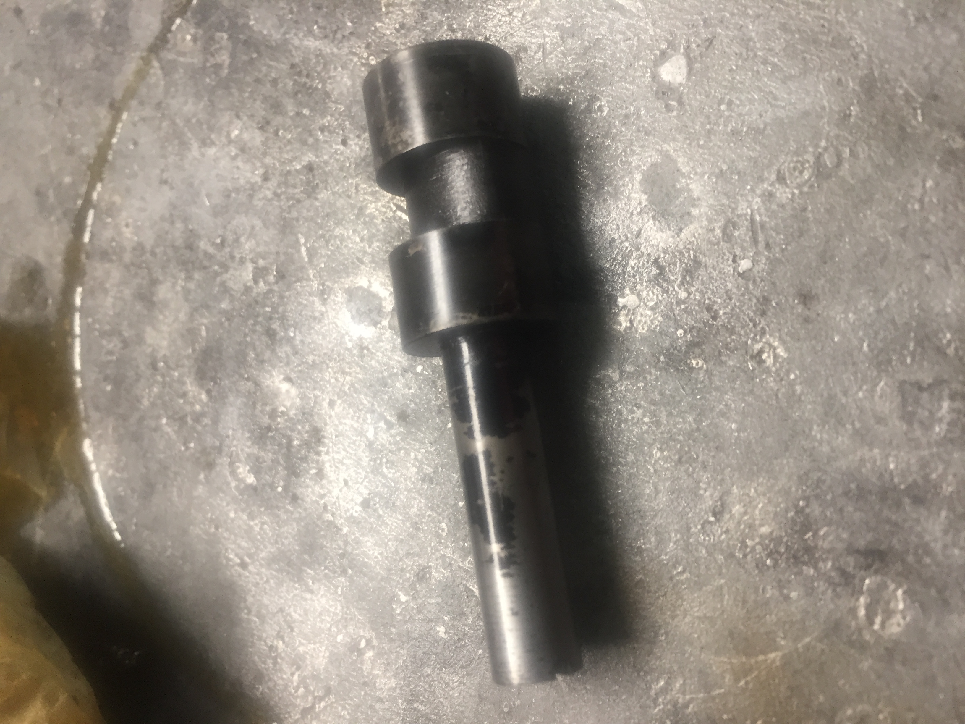

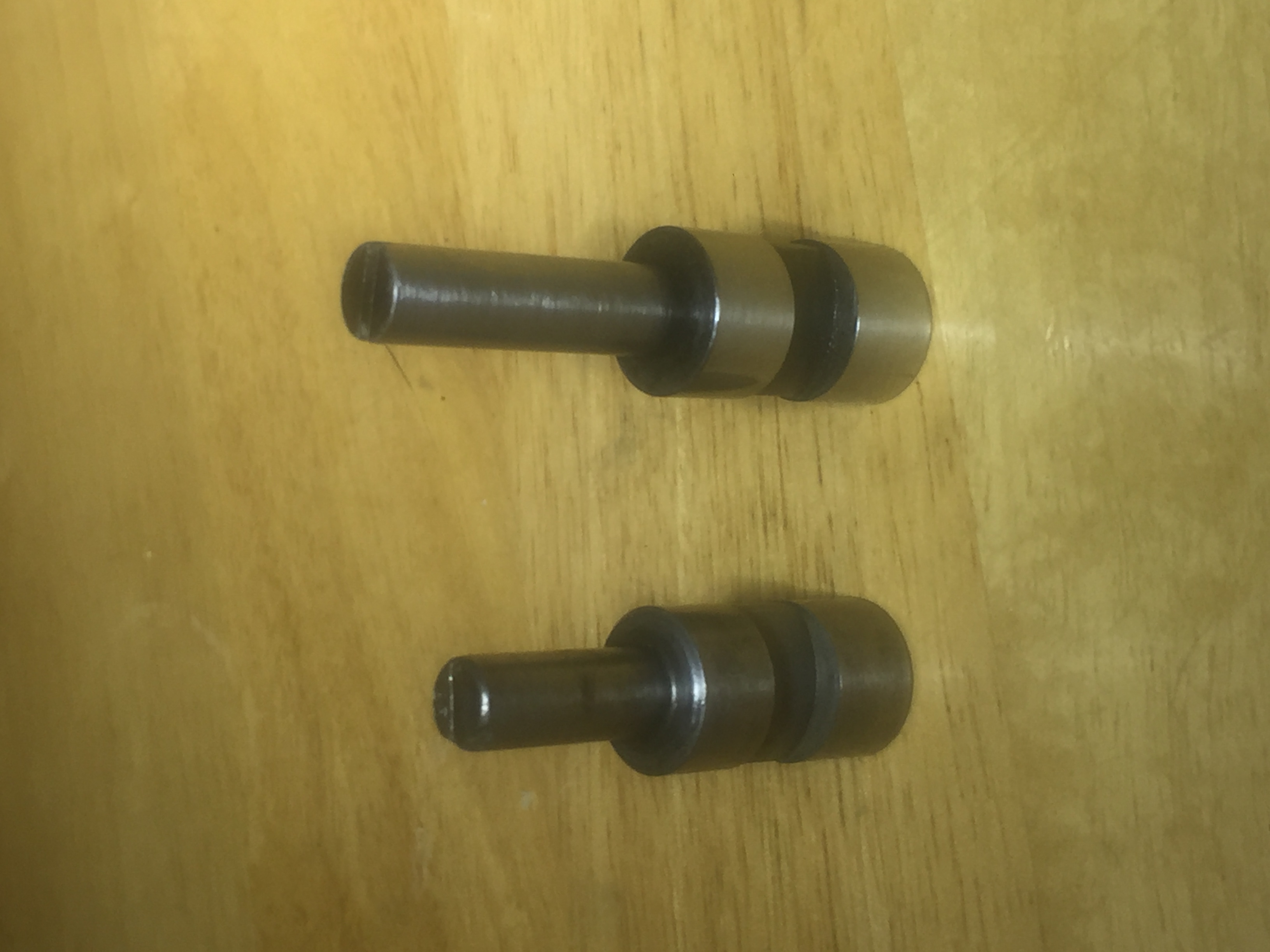

So I opted to try and make a hardened spool valve. My hillbilly hardness tester indicates that a "factory" spool is between 60-65 Rockwell "C" (about the hardness of a dowel pin - aka HARD). While I doubt that I really need to do this - I thought it would be a good challenge so OFF we go! I ordered some O1 (aka "drill rod") because that's supposed to be one of the easiest materials to harden at home. I made the part with the OD having a few extra thousandths that I will grind off later. I then took an old coffee can, put some metal chips in the bottom and filled it with used motor oil that I heated until it just started to smoke. I then heated the main part of the spool until it was just turning a bright red and verified it was NOT magnetic (signaling it is hot enough) - I then dropped her in the oil!!!!! Let it cool - retrieved it and ran a file across it - skated like it was glass - mission accomplished. I purposefully did NOT heat the small shaft up as I felt it was less risk to warp it. Next I cleaned the oxide of the shaft (it came right off with a scotchbrite) and put it in the lathe collet. Using my just rigged up toolpost grinder I took it down to a half thousandth oversize and then polished the last couple tenths off. Came out great - I'm ecstatic.

"I thought it would be a good challenge so OFF we go!"
I love that! And you were able to get it right on the first shot too. Nice.

BasementPaul, To be honest I was a bit hesitant because I had a fair amount of time making it and knew I could scrap in short order with the heat treating, but I then remembered what Stan used to say, "I'm gonna go do something even if it's wrong!" Gotta break a few eggs if you wanna make a cake! So now that it's done - I, of course, thought of a WAY easier way to machine it. And you KNOW I will have to make more just to see if my "NEW" way really is easier or not. Good times.

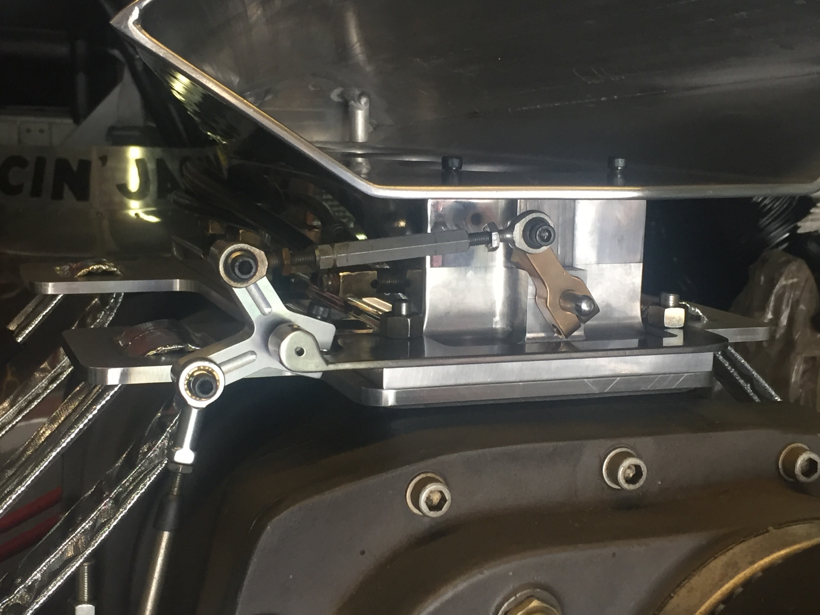

Re: Chip off the old block

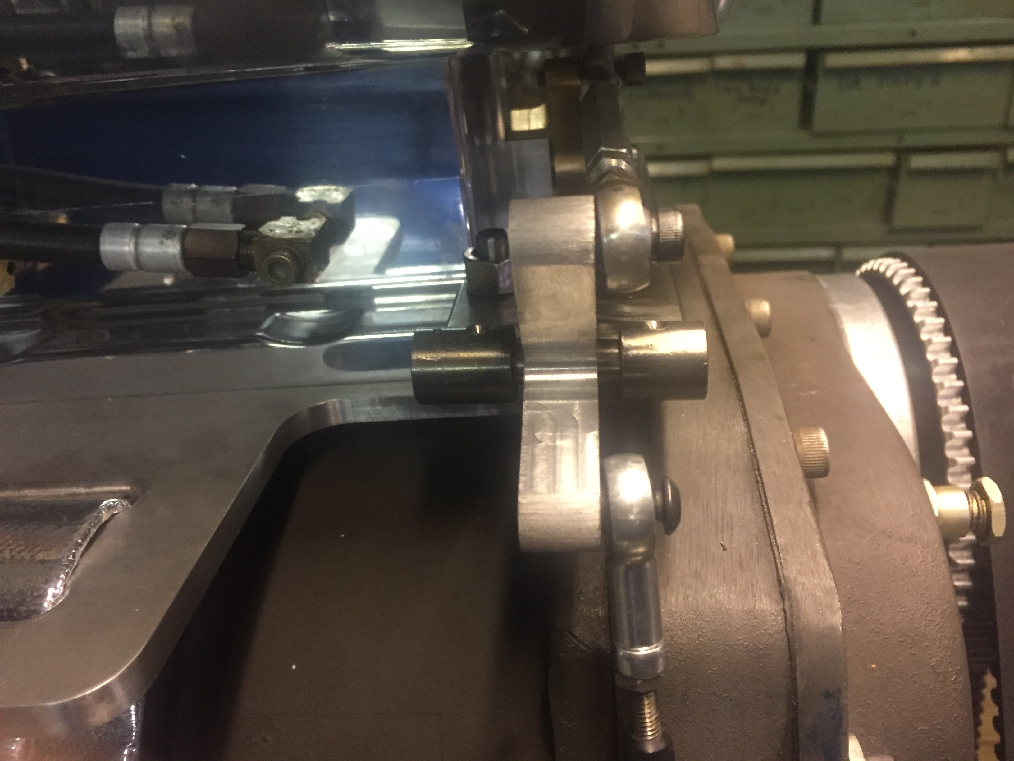

Worked on the linkage...the bracket is Stainless, the bell crank is aluminum fully polished now). The bellcrank rides on bronze bearings for the utmost reaction times! Ha ha ha
A work of art, Jason.

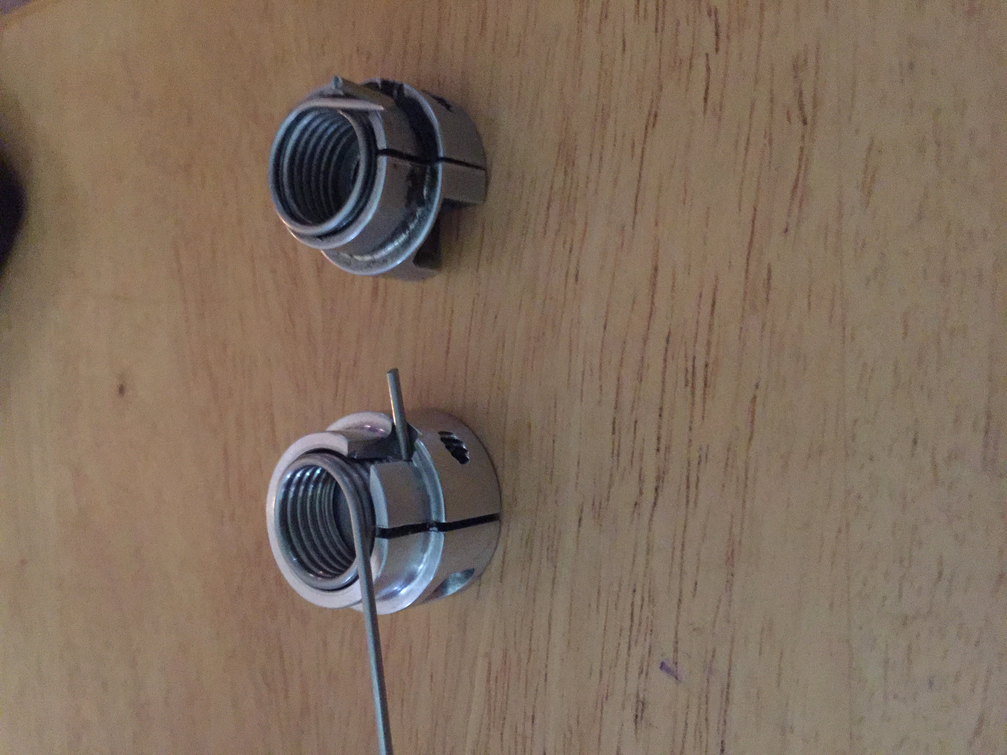

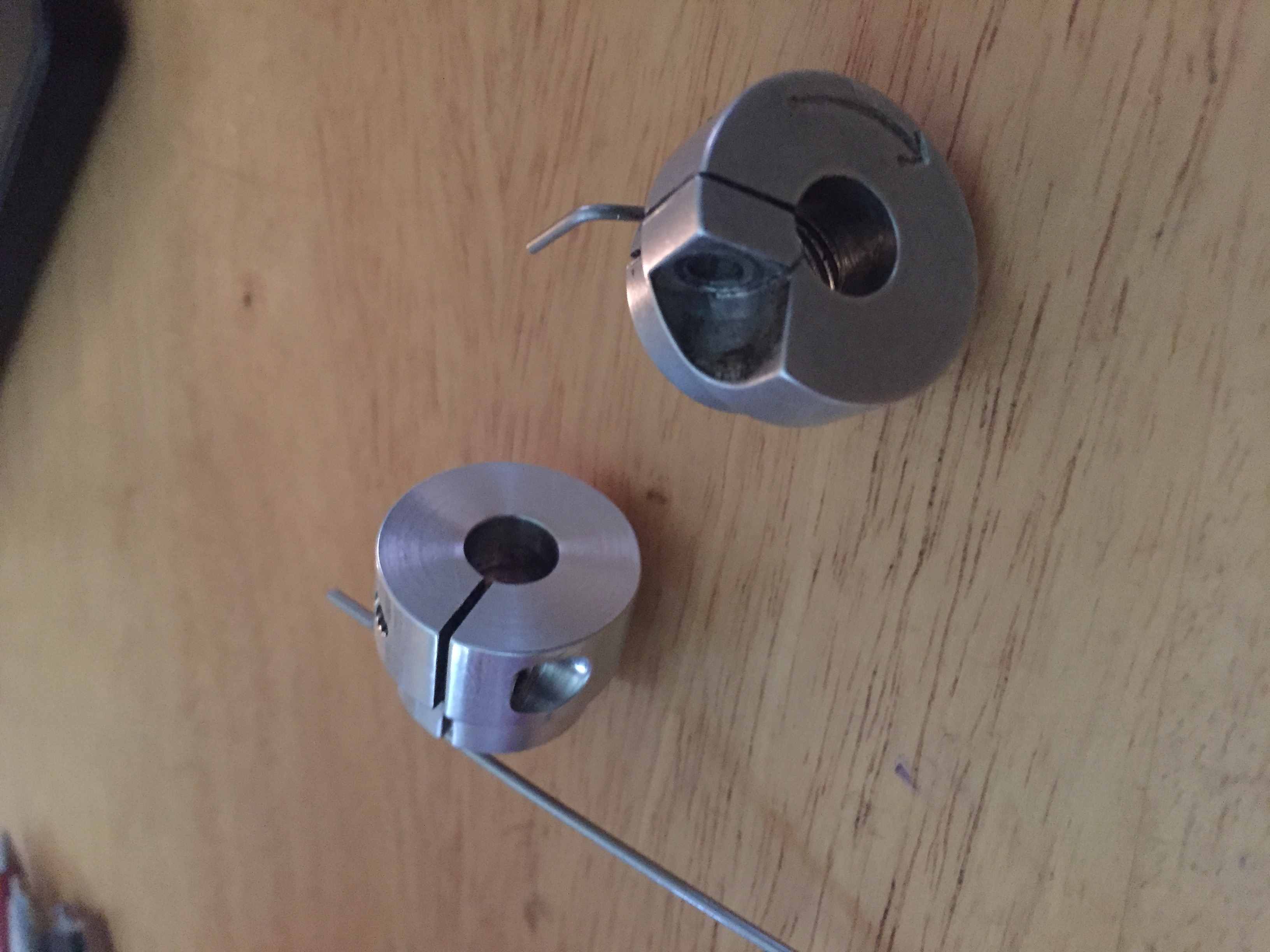

Thanks Guys! It really has been a labor of love. As a bonus I think I've learned a few things in the process. Here's the latest component- a torsion spring. Hilborn sells these so nothing earth shattering about them, but if you notice the one has a crack in it. Now was that because I got a little caveman while using it on my stack injector or was it a design defect? I think maybe a little of both. Combine that fact and that I wanted to use it slightly differently than Hilborn sets theirs up. Result is raiding my dwindling scrap pile and make a slightly improved version. Mines on the left and features a wider hub (more wall less likely to crack). I also use a spring with a longer leg to allow me to position it much further down on my shaft where it will be optimal for my setup.

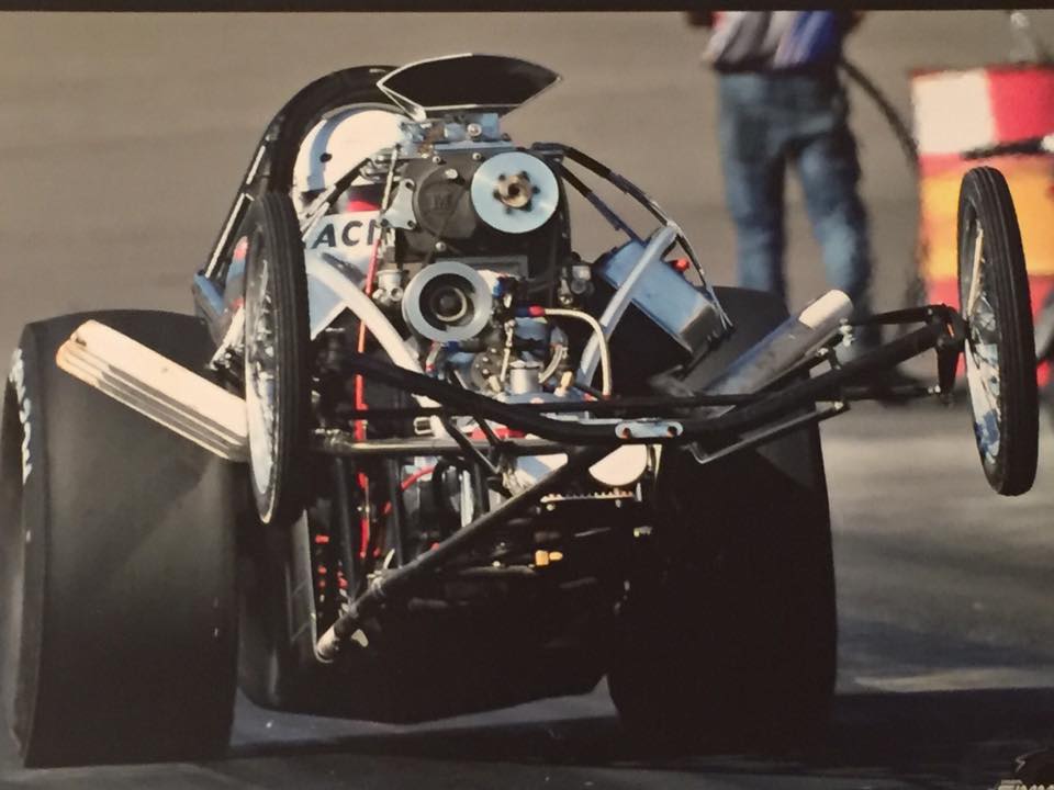

Let's try this: https://youtu.be/U3RmKBUCmwg
- Racin'Jacin
- Posts: 354
Injector working good, landing was a little rough, tweaked a couple tubes, I will repair!!
- Posts: 3398
That's such a bad-ass picture! I doubt you finished that pass after the hard landing though? Hopefully a little weight will cure your wheelie woes. Too much power is cool!
