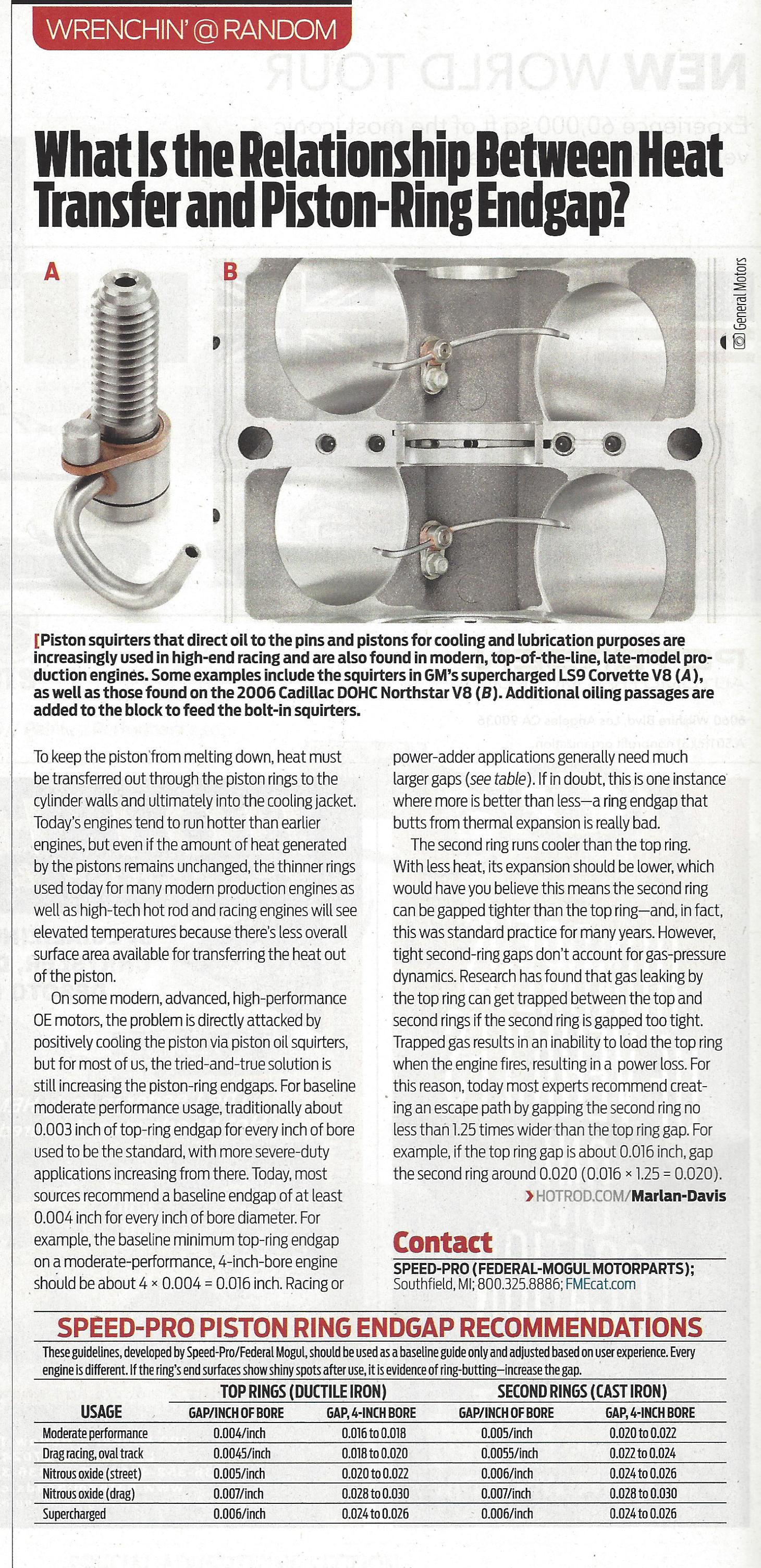

From the Jan 2019 issue of Hot Rod Magazine. The last paragraph about the second ring gap is Interesting.
