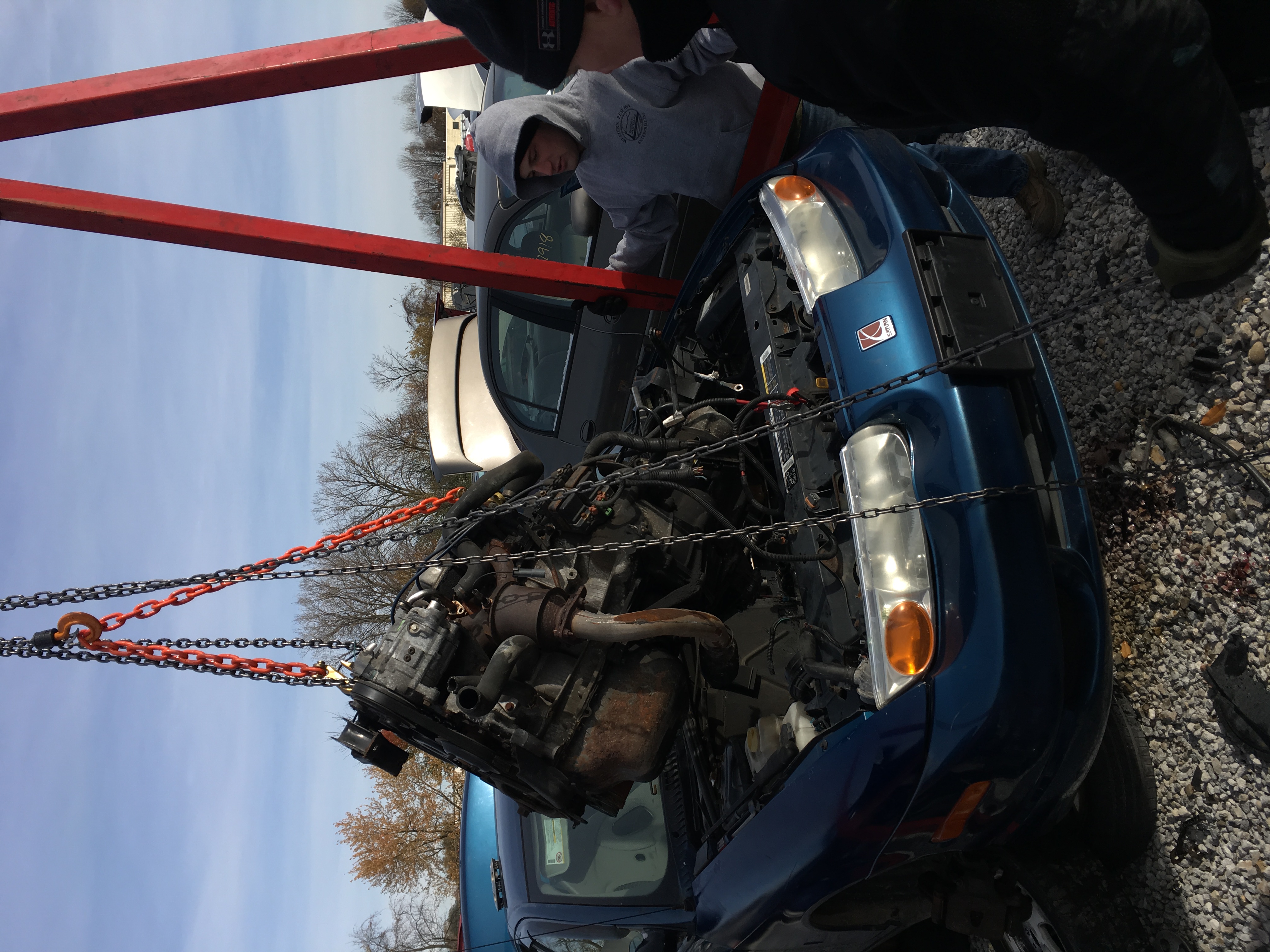

A few weeks back we made it to pull a part to get a transmission. While we had the engine out we pulled some connecting rods
This past weekend I got the block and crank back and did the assembly. Note rod #4 still sporting junk yard paint:

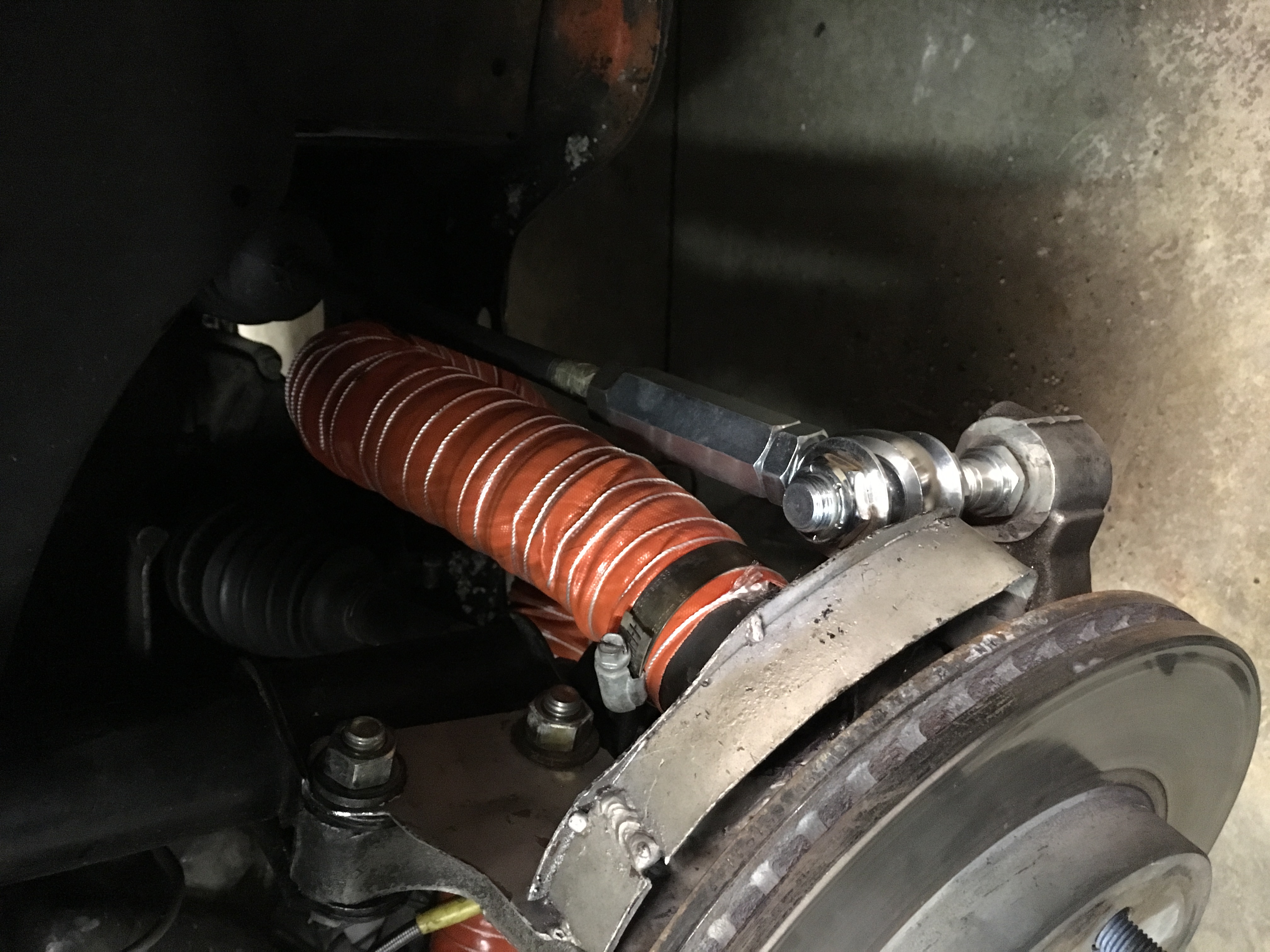

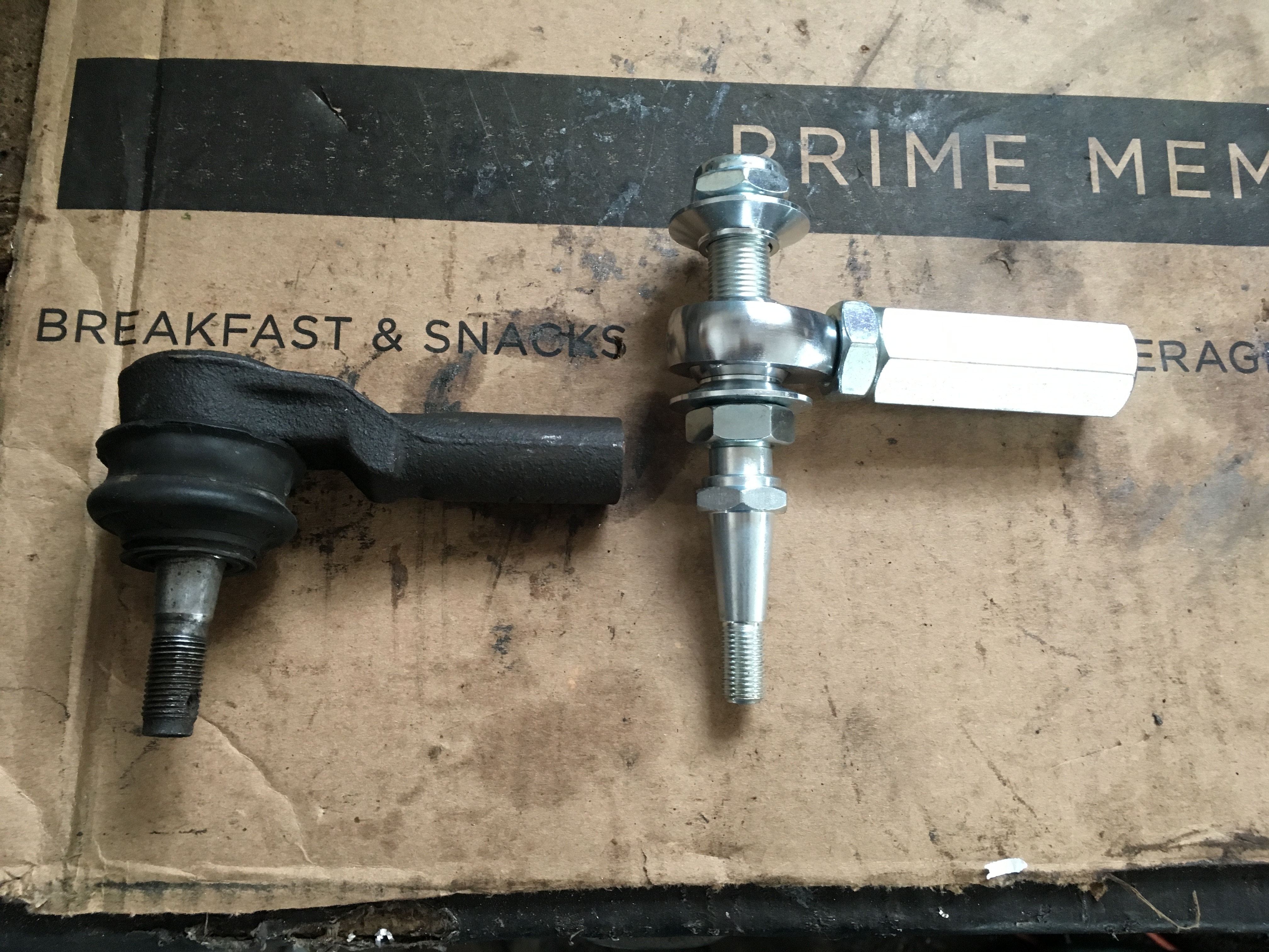

We have an issue with bump steer that has made itself evident driving on the uneven surfaces at VIR and Nelson Ledges. I just drive the car but the guys don't like it so we're going to fix it. The issue was created when we switched from stock knuckle to Ion knuckle. The tie rod end fit right in but we had to invert it and the connection point moved by maybe an inch vertically.
With just a little digging I discovered the 4th gen F-body has the same tie rod end as the Saturn.
This kit works but it's $170:
http://www.spohn.net/shop/1993-1997-GM- ... -Body.html
Now I can get just the rod part for $10 each:
https://www.speedwaymotors.com/Adjustab ... gK7sPD_BwE
I need to check the taper angle on each and then a Heim joint and the sleeve that connects it to the tie rod. Anyone have any experience with this?
Posts: 2984
Re: cheap car racing
I ended up ordering the Spohn kit and the other kit for spares. Installing the adjustable tie rod ends would have been easy except the pin intersected with my brake duct adapter. I decided to reduce the hose size to 2" since there was already a 2" section in the hose. Technically this is easy but it took quite a whil to cut the 3" off, fabricate a plate and a 2" pipe, then get it all welded back together.

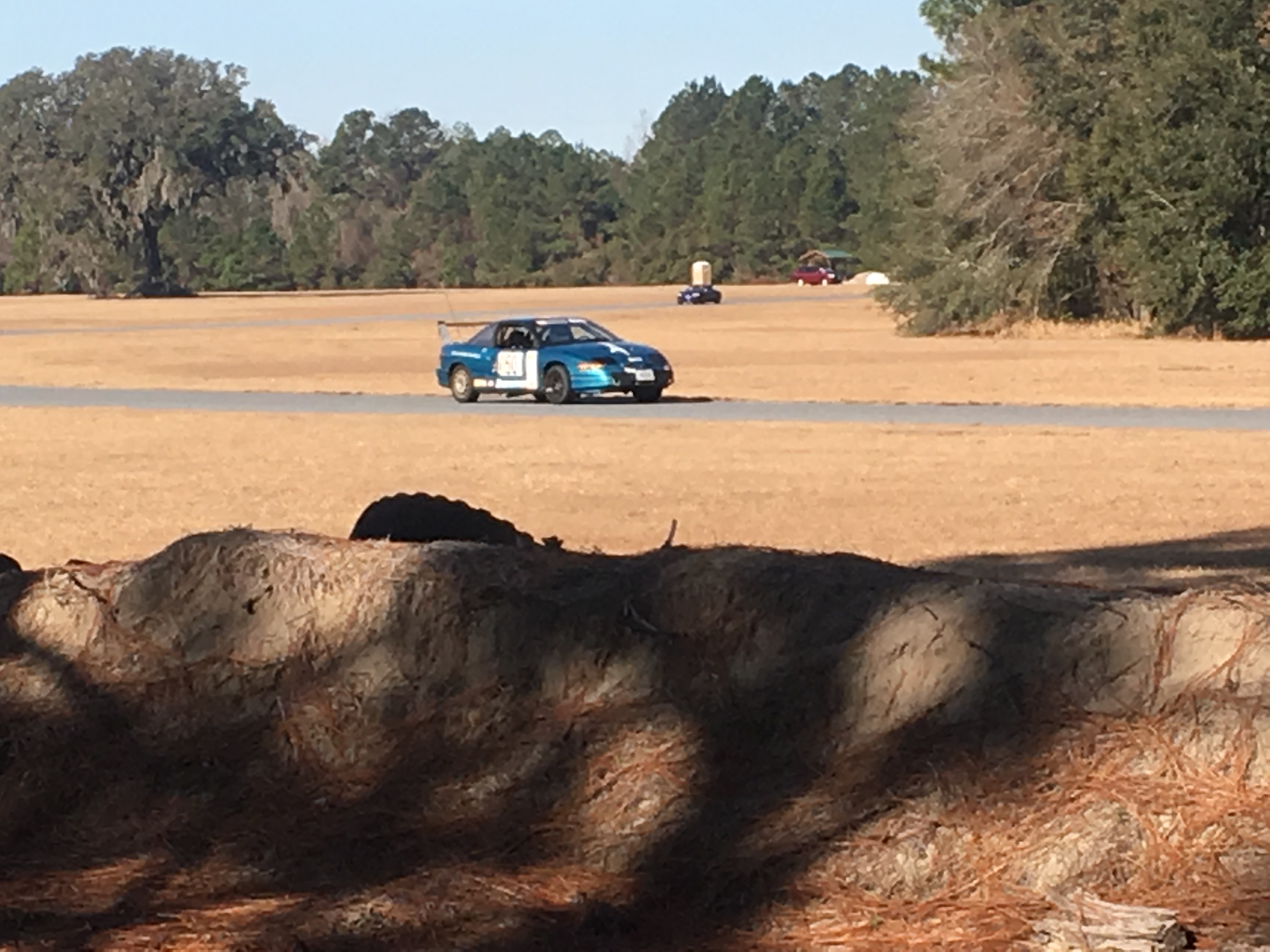

Had to get that all done by last weekend, since Joey had planned a trip to Roebling Road in Georgia for an HPDE weekend. I told him he could take the car if he ran some tests. With the whole Megasquirt still fairly immature I decided to go along. In all he put the car on track for 9 20-minute stints over two days. It was like 12 hours each way but probably no less insane than the entire concept of endurance road racing so why not!
Roebling Road is a basically flat 2 mile paved road course. It is very easy on brakes but the pavement is gritty and it is hard on tires. It's not a premiere track like Watkins Glen but the amenities and facility were decent. Hoping Nelson Ledges can end up like that some day.
The weather turned out to be great - basically sunny/clear skies the whole time with temps getting to 70 during the day.
On Sunday morning I rode along and plugged the laptop into the Megasquirt and did some real time data logging. Stupid screen went blank after 10 minutes due to keyboard inactivity. Try typing in a 10 digit password with caps and special symbols left handed while riding in a car making hot laps on a road course. It was comical. Fortunately the logger kept going so we got the whole thing. Still need to study that log there have to be some gems in there.
The Megasquirt handled the task just fine. Used several of those sessions to make adjustments on the tune.
The new tie rod ends were set up well and eliminated the bump steer. We still have issues with the nylock nuts backing off but we will fix that.
We also learned the car is about 1 second a lap slower there without the wing and the holes in the hood.
