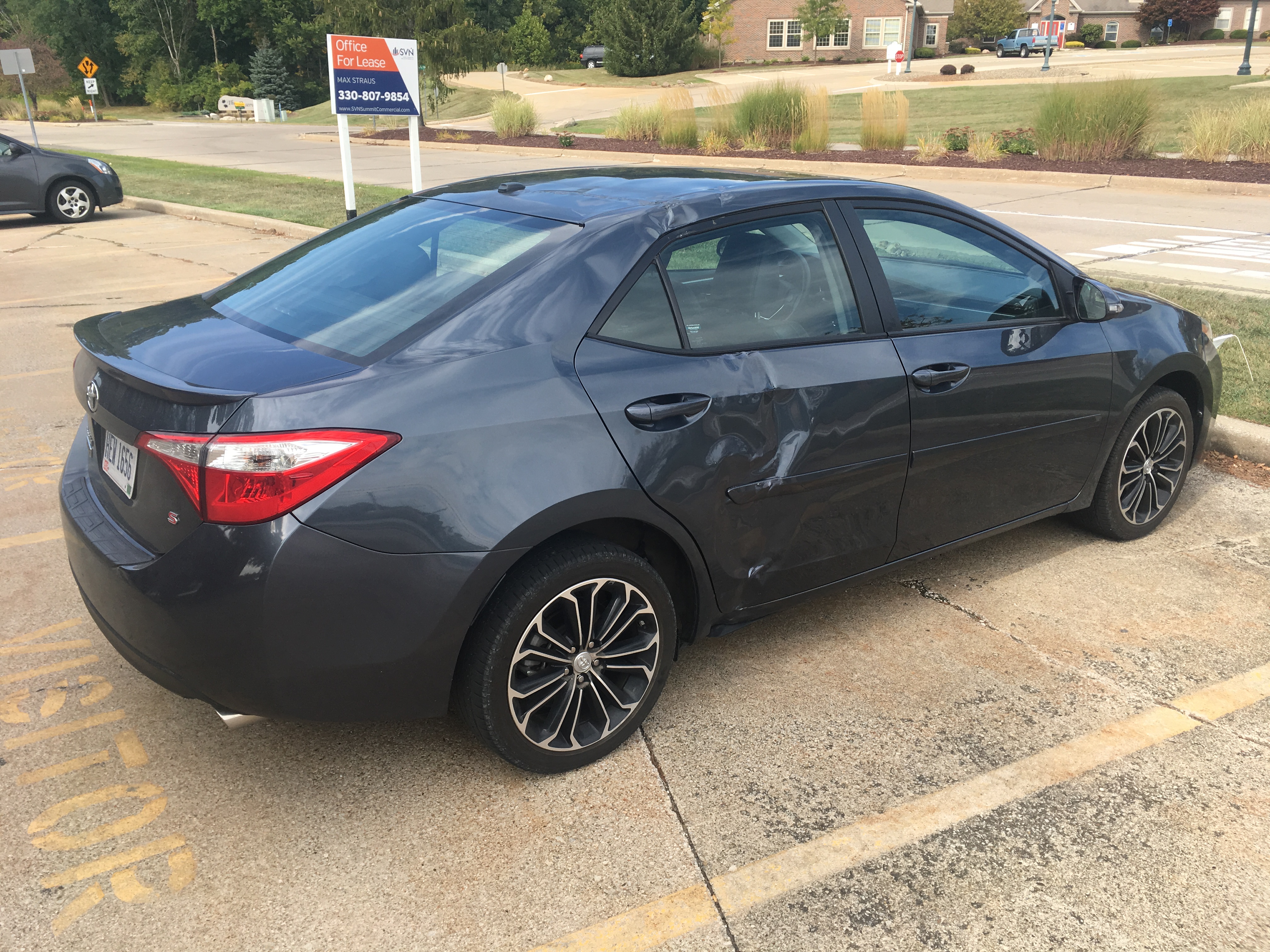

After the last track day I realized Rachel and Kurt need more practice with a stick shift. They learned on the Saturn but that is not practical for regular use. This is the car I selected for that.
The car is a 2015 Toyota Corolla S. It was made in Canada in June 2015 and has 5715 miles on it. I paid $5k for it + tax.
It was sold by a dealership in VA and resided in MD originally. The next step in its journey was to be repossessed by Toyota Finance after it was wrecked. I think the car got hit in the left by a van or SUV (maybe went too wide in a right turn) which punted it into a sign post in RR door and the sign came down on the roof. You can see it was a 4x4 white post. Car was from Maryland have no idea what sign posts are like in neighborhoods there. The specifics of why it was not repaired are not known to me.
The car has considerable damage which has created this opportunity. None of it affects the structural integrity of the car.
* Rear axle beam is bent giving way too much negative camber on LR. Tire was rubbing inside wheel well near strut. Axle beam Is unique to S model and not easy to find in junkyards yet, new is $1100 and used like $750 - so we will be fixing it. Two words: Kurt welding.
* LR hub has some free play from the impact.

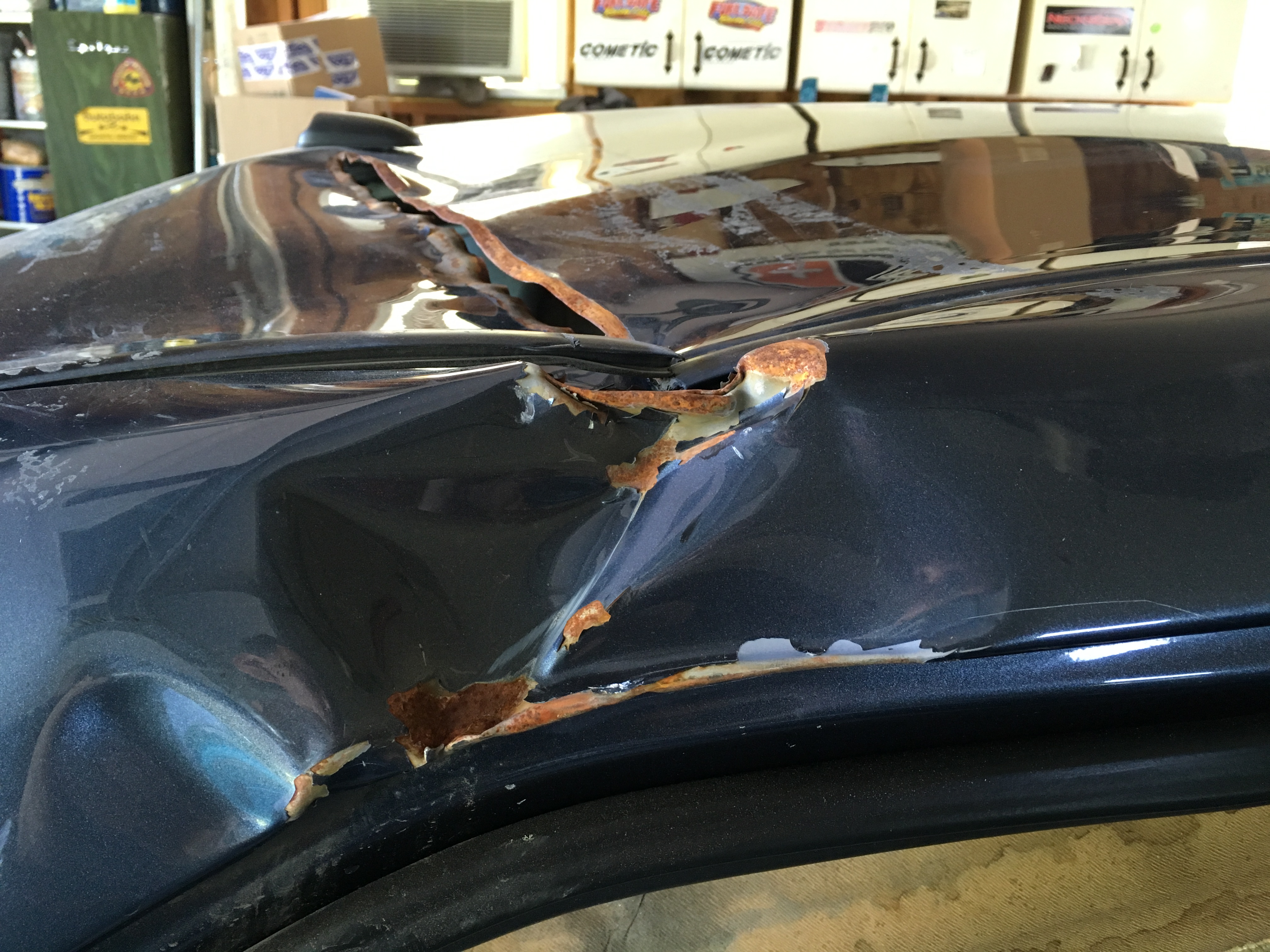

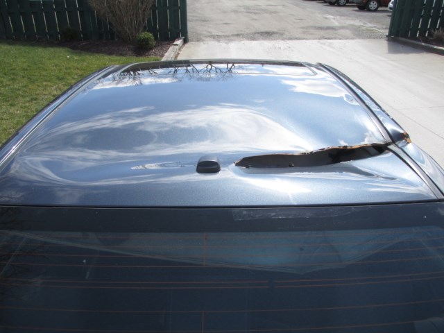

* There is a slicing hole in the roof about a foot long over RR passenger seat. The guy tried to cover the hole but failed so water leaked in and carpet was wet - like there were puddles on the floor.
* The roof is pushed down some where the slice is over RR seat.
* There is body damage on LR door and some damage to door jam on wheel side or LR door.
* RR door also has damage that blocks window from going down and the rocker panel below has some damage.
* The headliner also took damage from the roof slice
* There is a minor dent on the LF fender.
* There are a couple minor marks on the bottom of front bumper cover where it may have hit a curb.
* The LR wheel has some cosmetic damage.
* Not sure the radio antenna might have taken a hit in roof damage.
All the doors work.

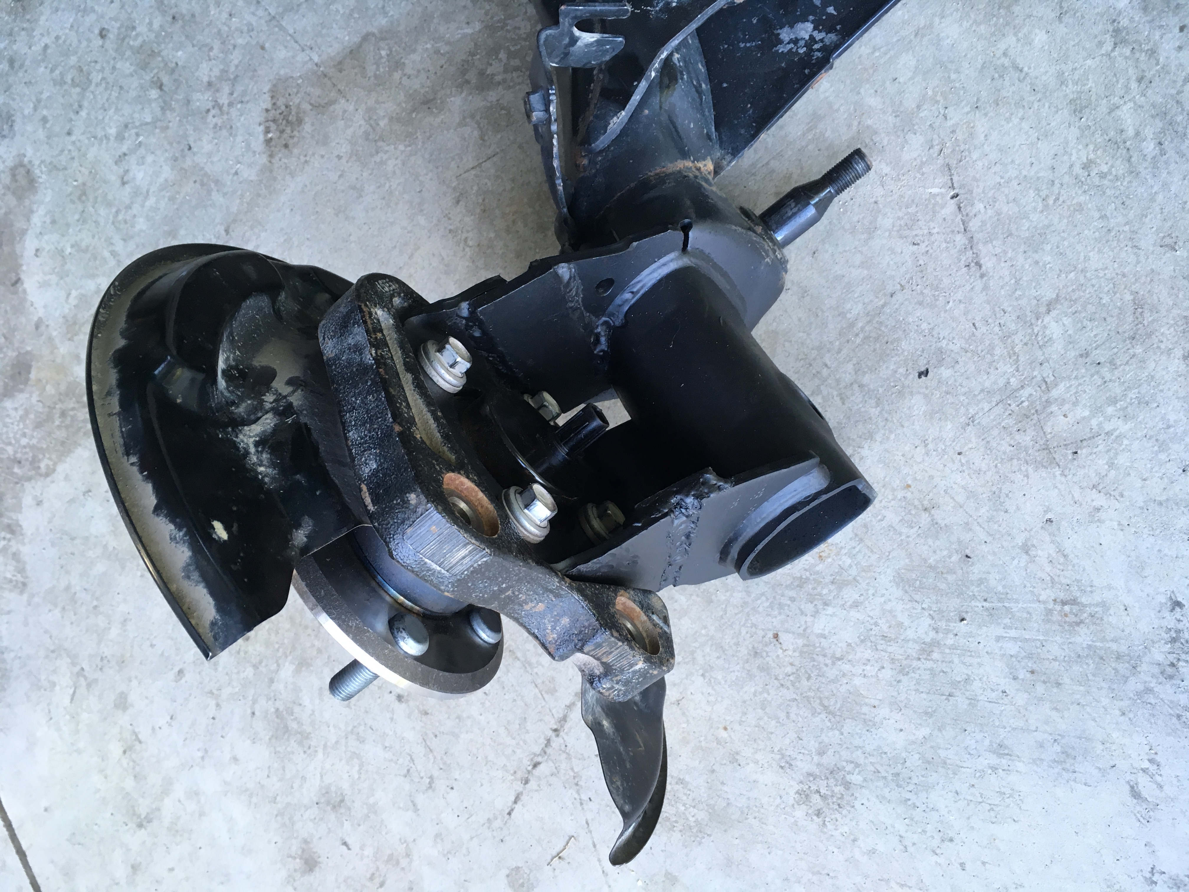

* Removed rear axle beam to work on straightening it. Most of the problem is the LR wheel has way to much camber now and it hits the iner fender. Tried a couple things to straighten but still had -6 degrees negative camber and I need to get to -1. To do this I cut the support braces for the LR wheel and repositioned the mount where it needed to go, then made some plates 1/4" thick and had Kurt weld them back together. Camber now appears in acceptable range and while it has about 1/4" toe in this should be fine.

* LR hub was purchased and is on the axle. Moog part is the exact same part as the OE part - stampings and all are identical. I needed this to be straight to get all my measurements right.

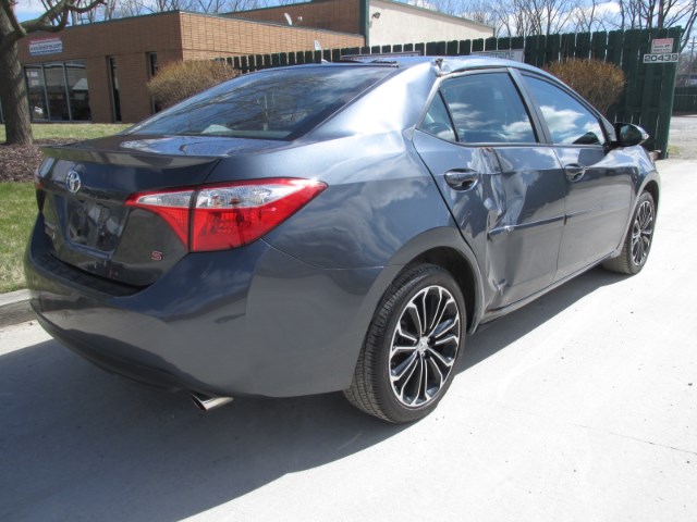

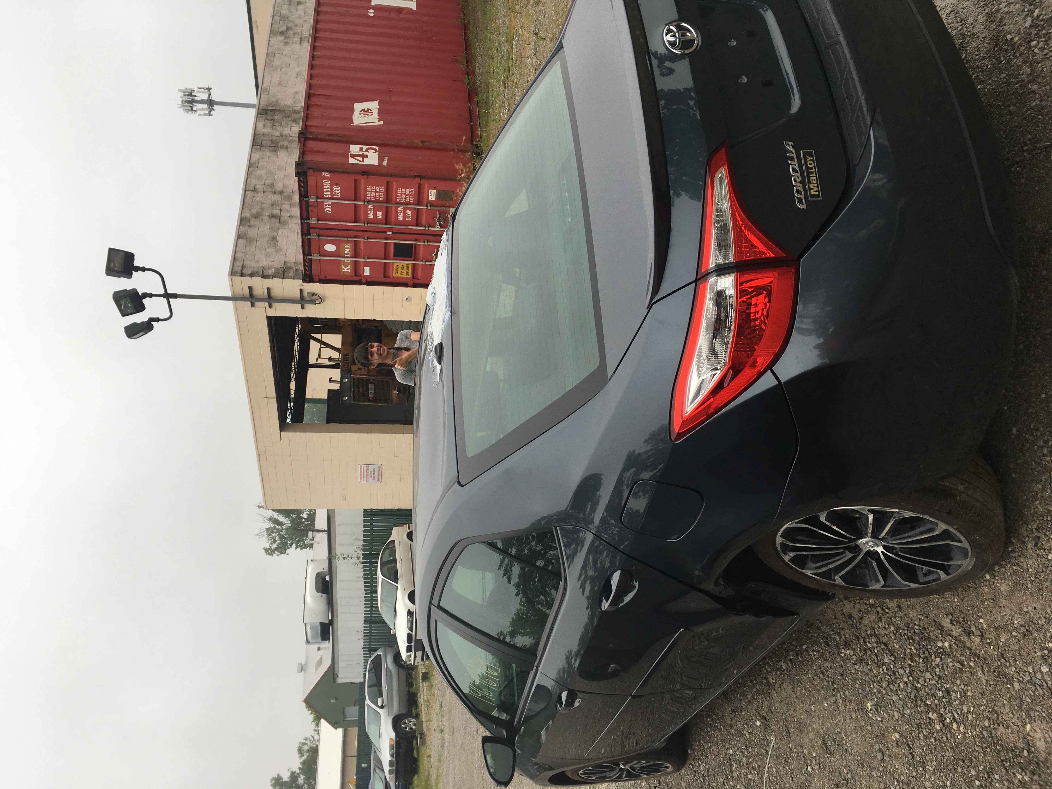

Here are some of the dealer pics:

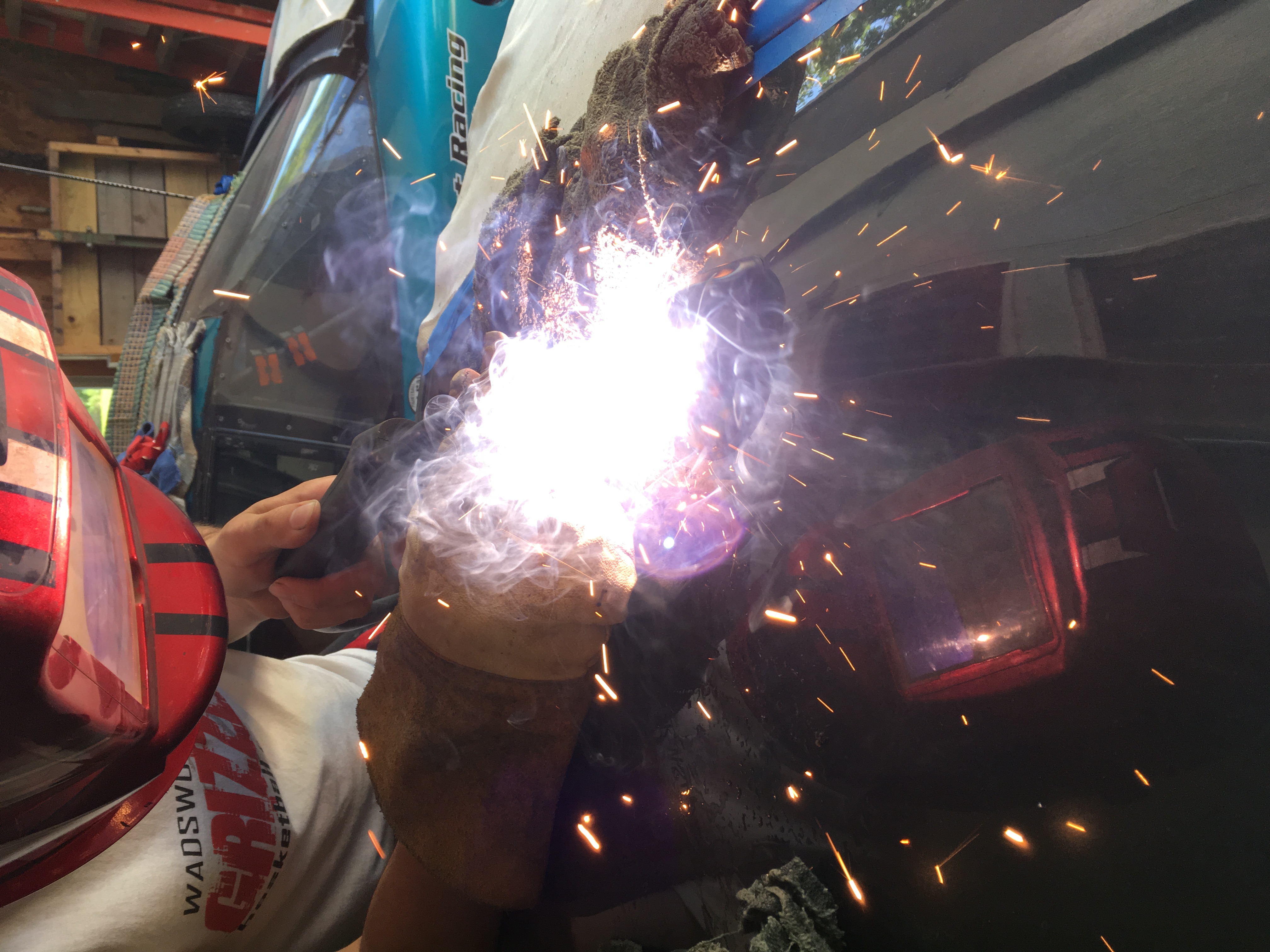

Tell Kurt to learn about stich welding on sheet metal. That will help reduce warpage when trying to go across that long stretch of very thin metal. Or you could just rivet a patch of galvanized sheet metal across it like the Poor Man's Blazer.
Re: 15 Corolla S - Mostmint #38

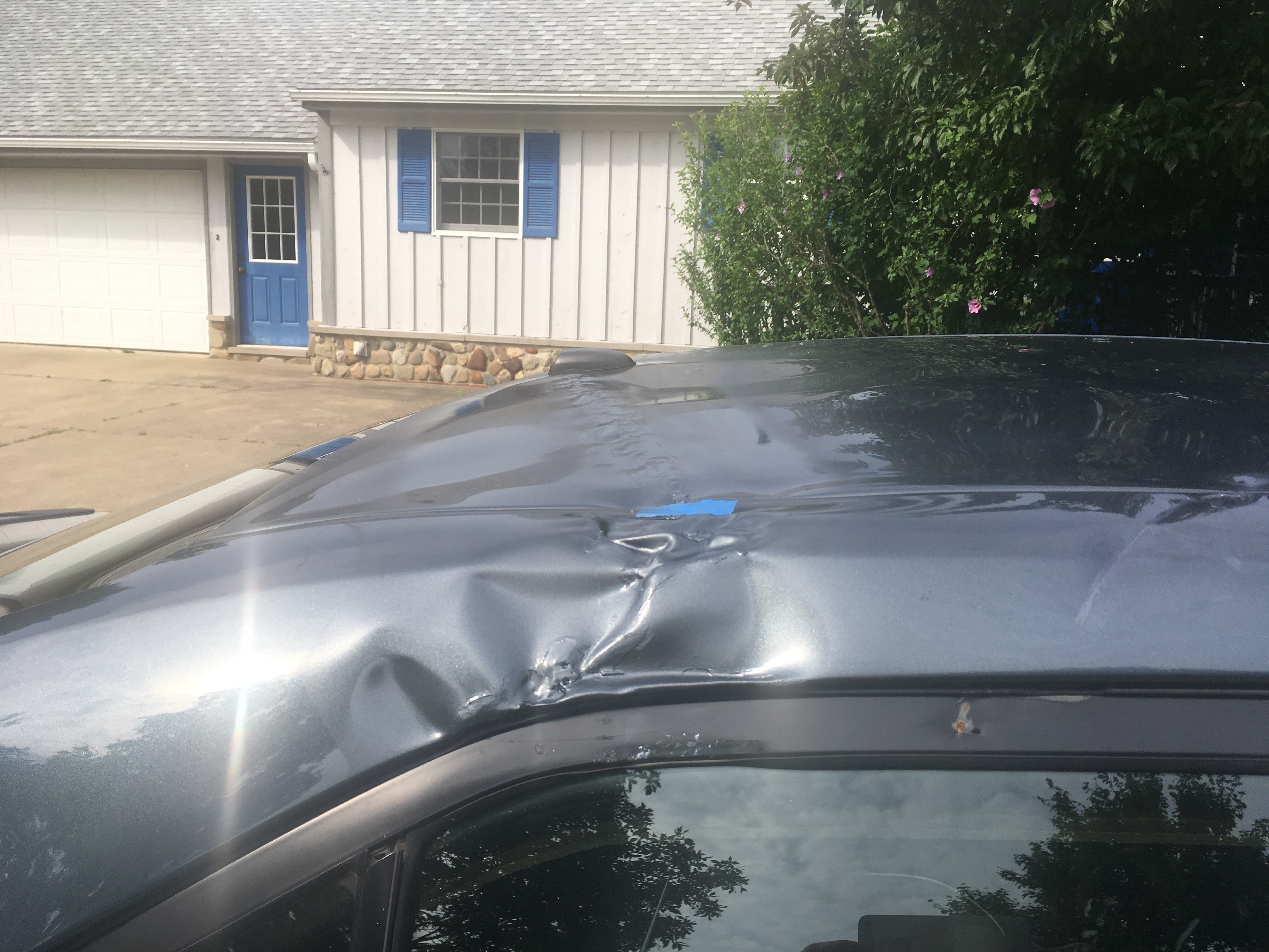

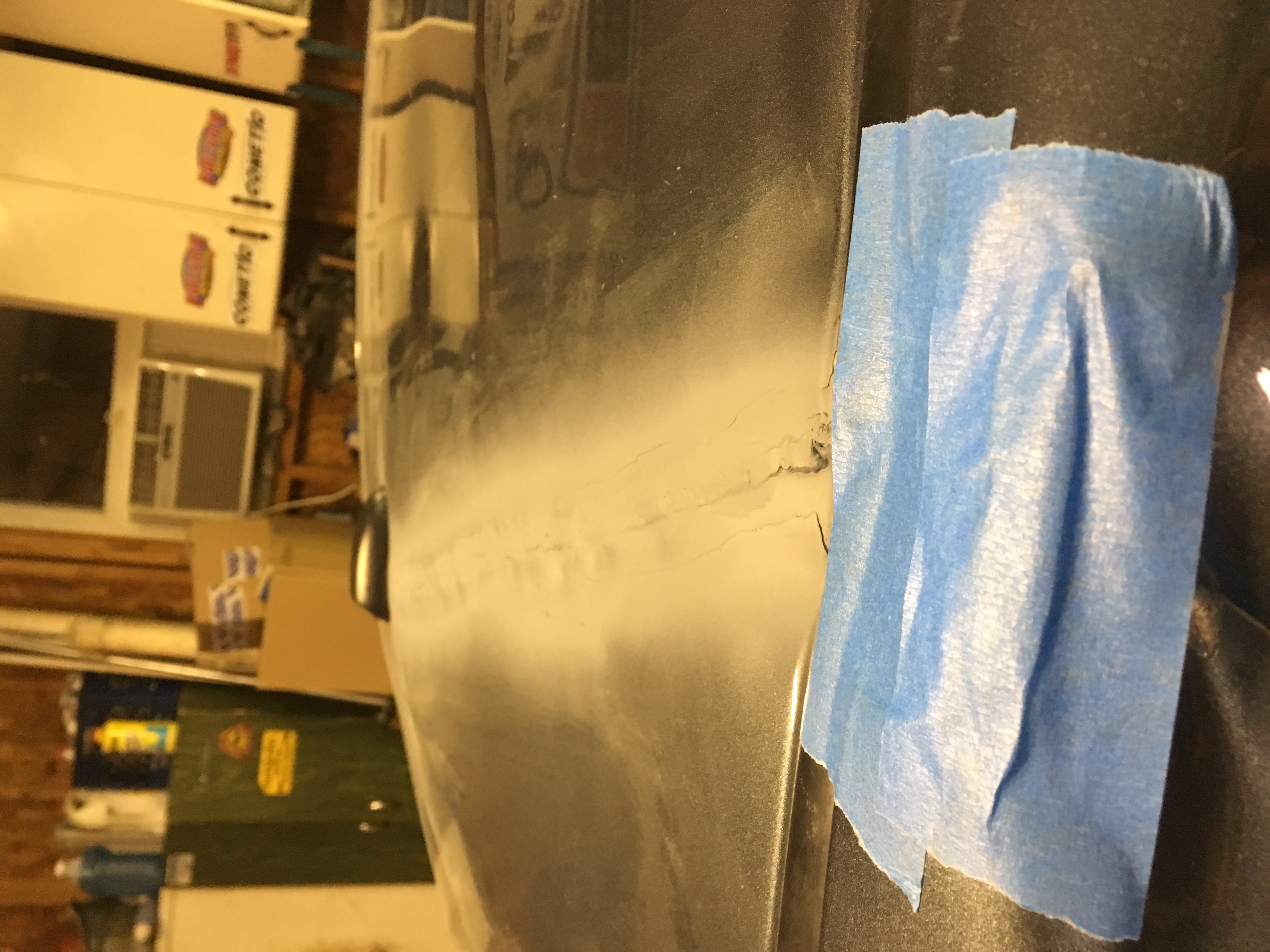

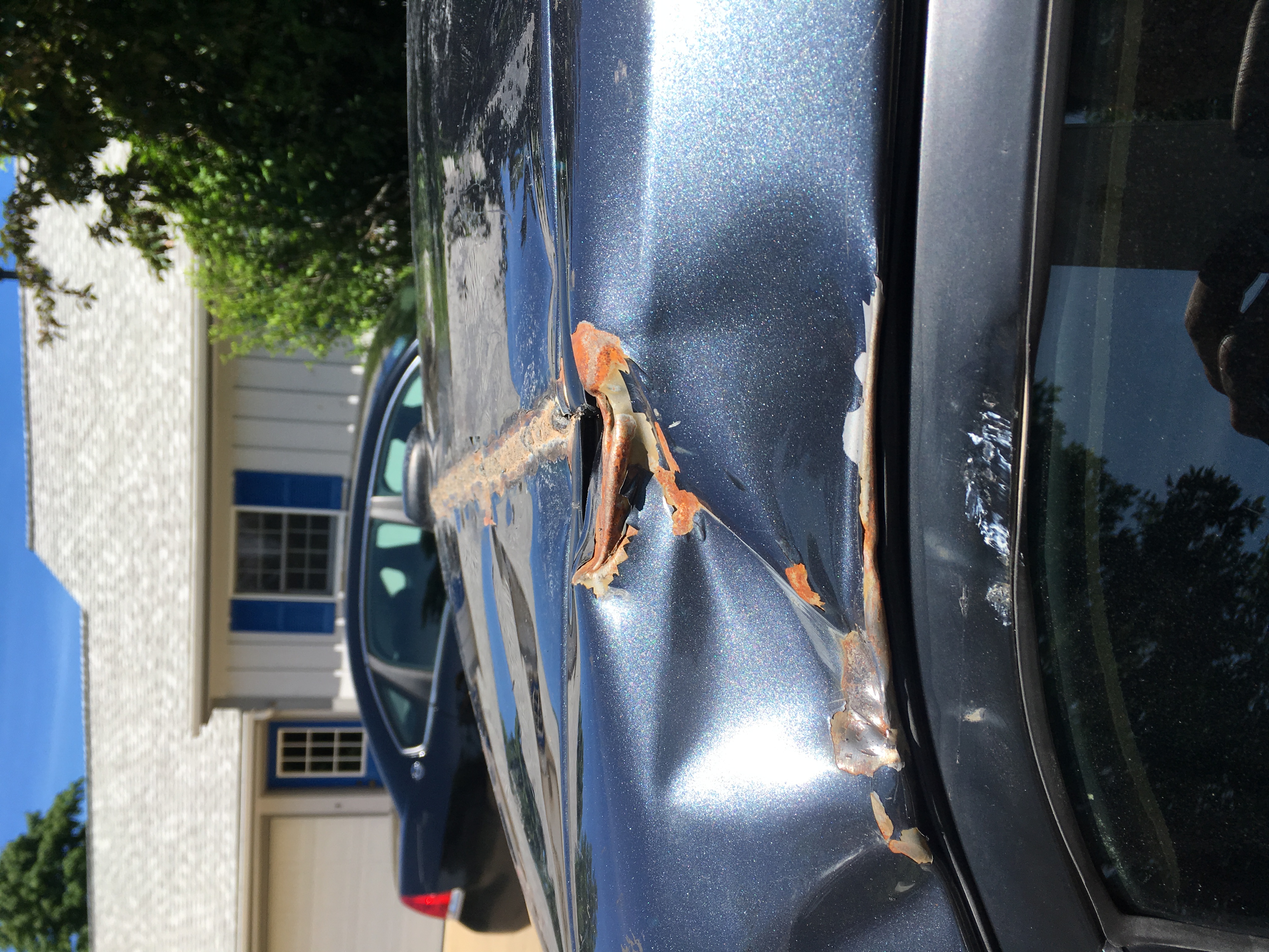

The roof was put back into a reasonable shape and the gash was welded shut
The edge of the roof line was another challenge. I was able to use the porta-power to fix the rest of the roof line, and move this part way back into place but this last section was in a channel and behind the side curtain air bag. My option there was to have Kurt weld some nails to the exterior metal and use a slide hammer to raise the material- then grind off the nails. It worked. (do not have pics of this handy)
I bought a rattle can of 1F9 custom mixed at the local NAPA store, and a can of clear and put some paint on the repair
I also got a 2 ounce ouch up for the other exposed areas
Spent a fair amount of time priming then touching up all these spots

The new LR hub was purchased and installed

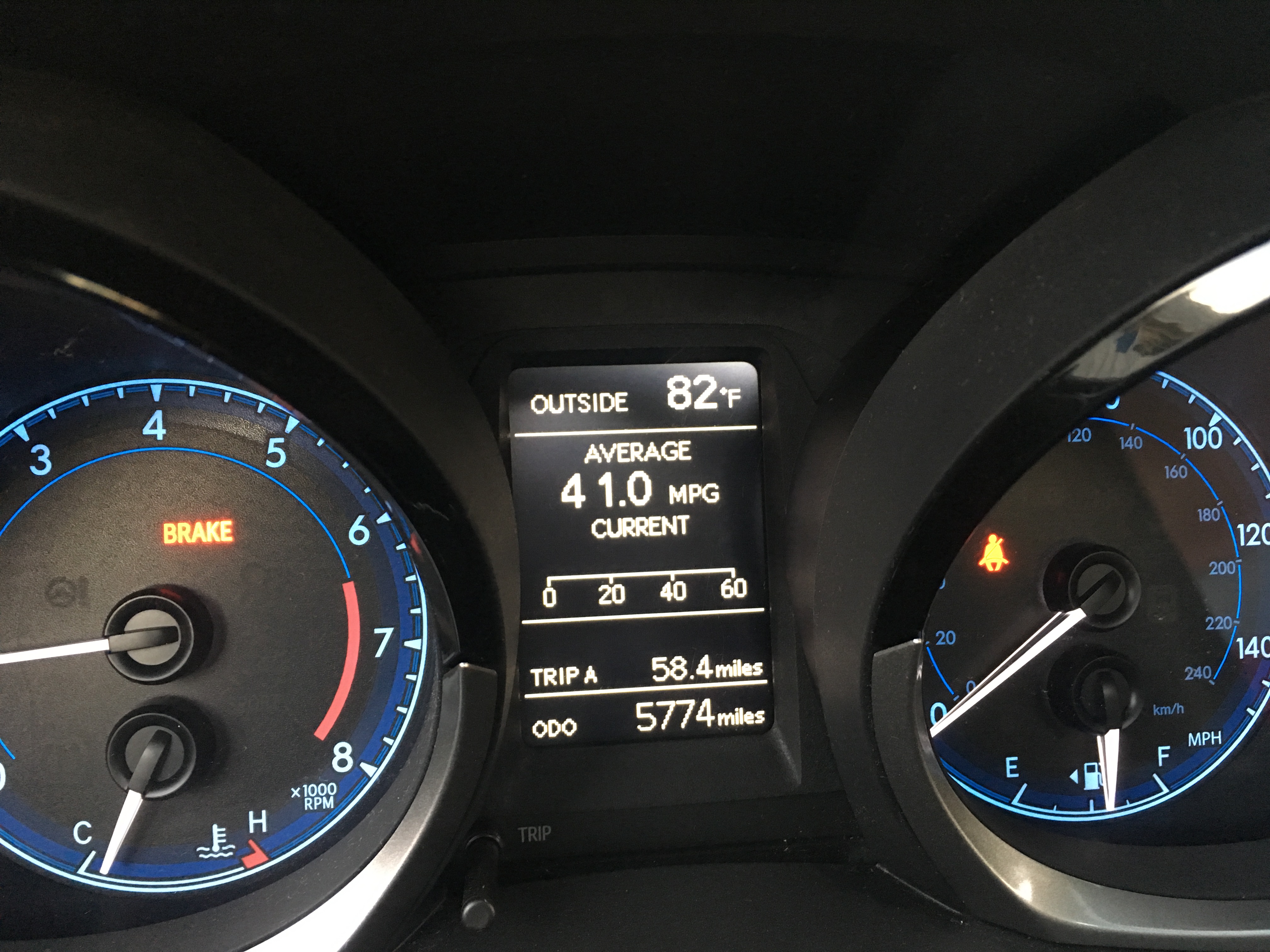

Also the car is making 37 MPG with my style of driving.

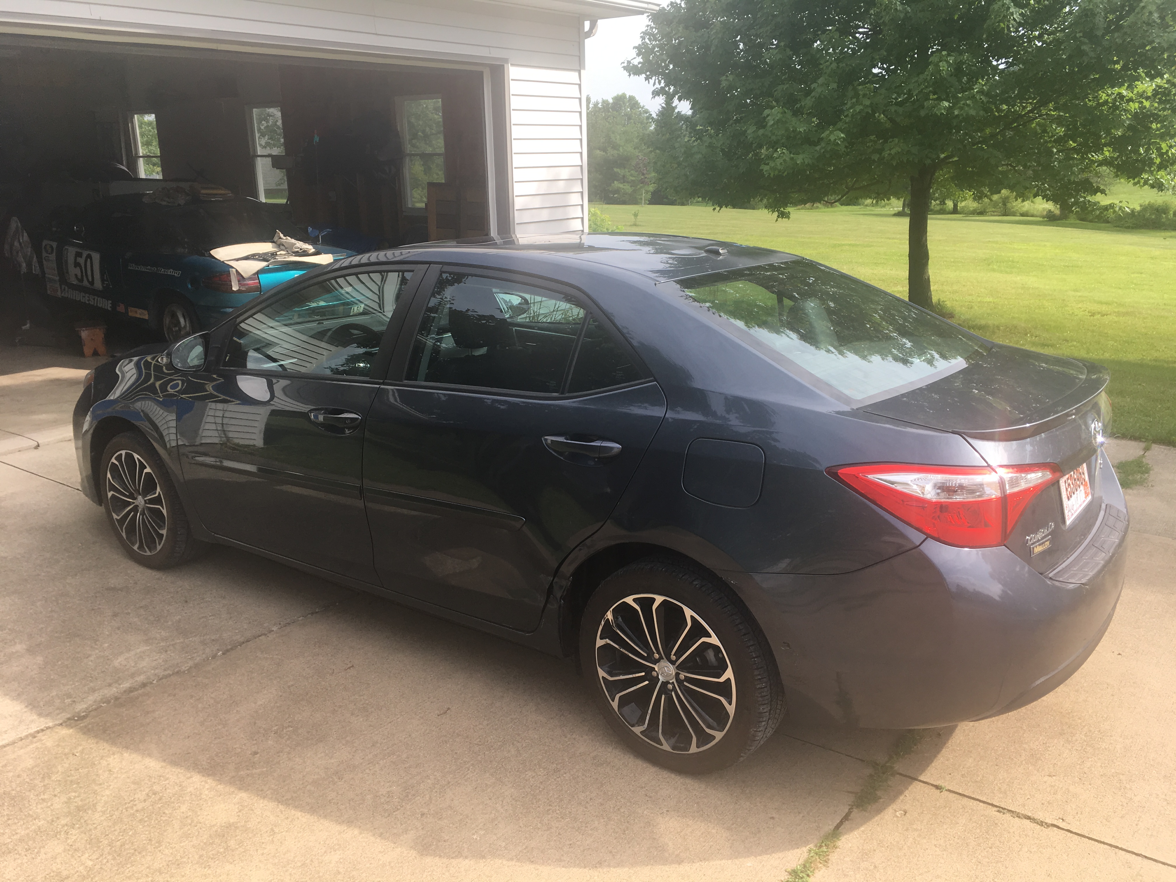

So a couple finished pics of the car:

Recently noticed the left rear tire having more wear. Knew it was toed in .75 degrees so this weekend I went to work fixing that. It had just a touch of positive camber too. I had shimmed the hub when I repaired it originally. With trial and error I got the toe from about 1/2 inch toed in to even.

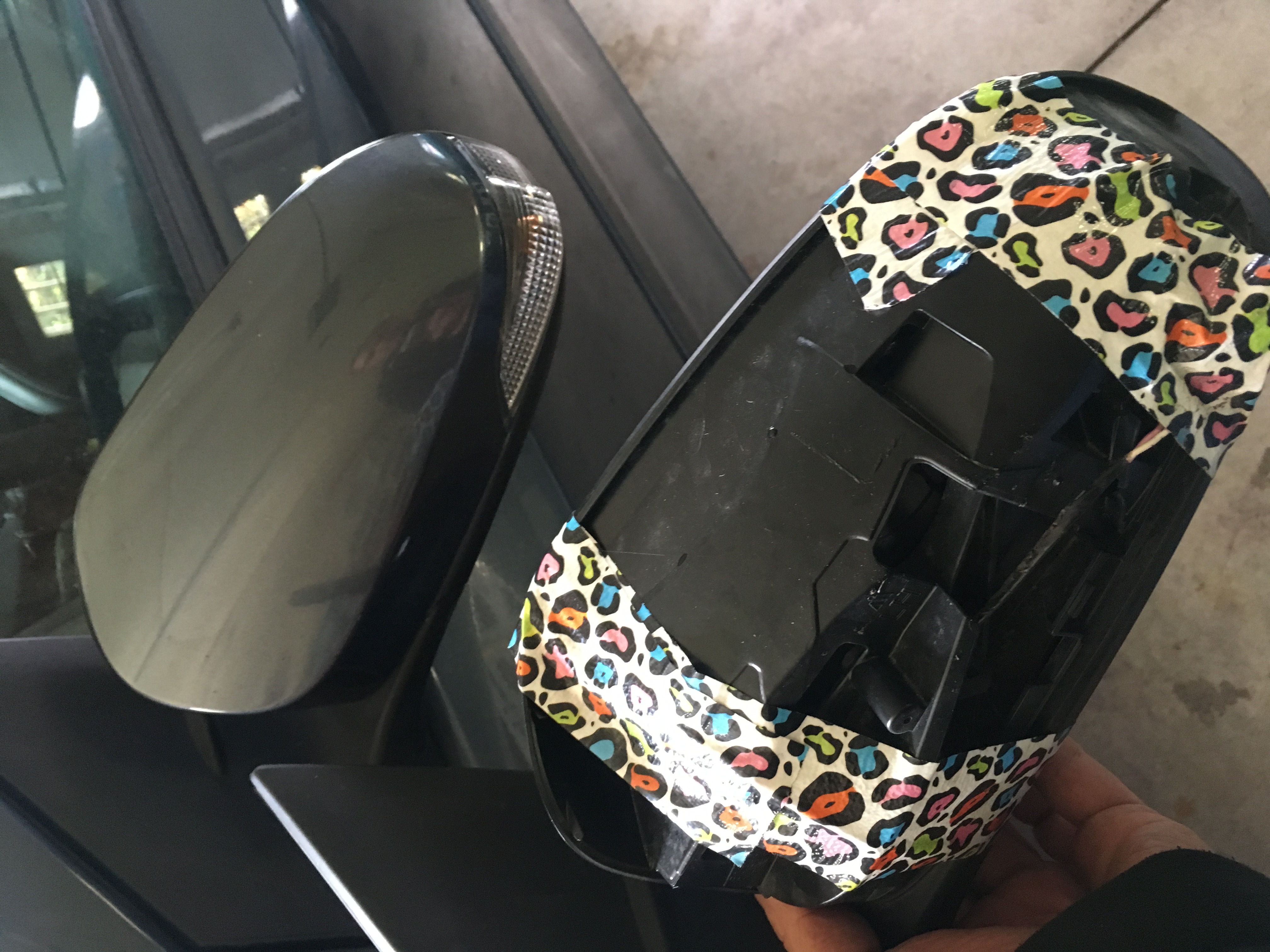

On a recent trip to New Jersey there was an incident where the mirror got hit. Found a color matching unit online for $115 and has Rachel but it. Put it on the car today.

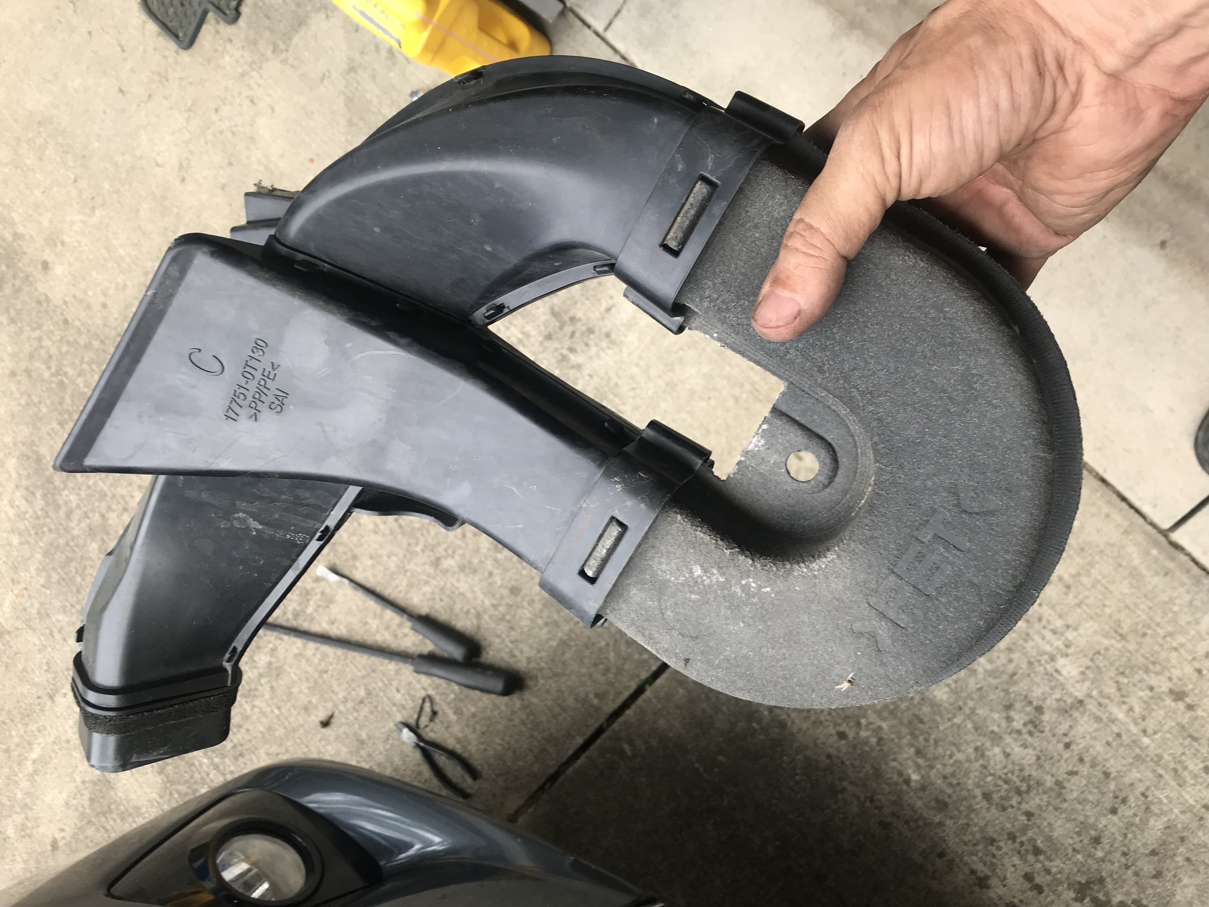

Car now has 51720 miles. Regular maintenance - oil change - had the car up on jacks so I took the opportunity to remove the tow hook underneath in the center. This is at least a lb of weight carrying around for nothing. Last year some time I removed the floor mats, owners manual and the trunk mat (still has the factory "carpet" underneath - this netted about 15 lbs of weight off for free.

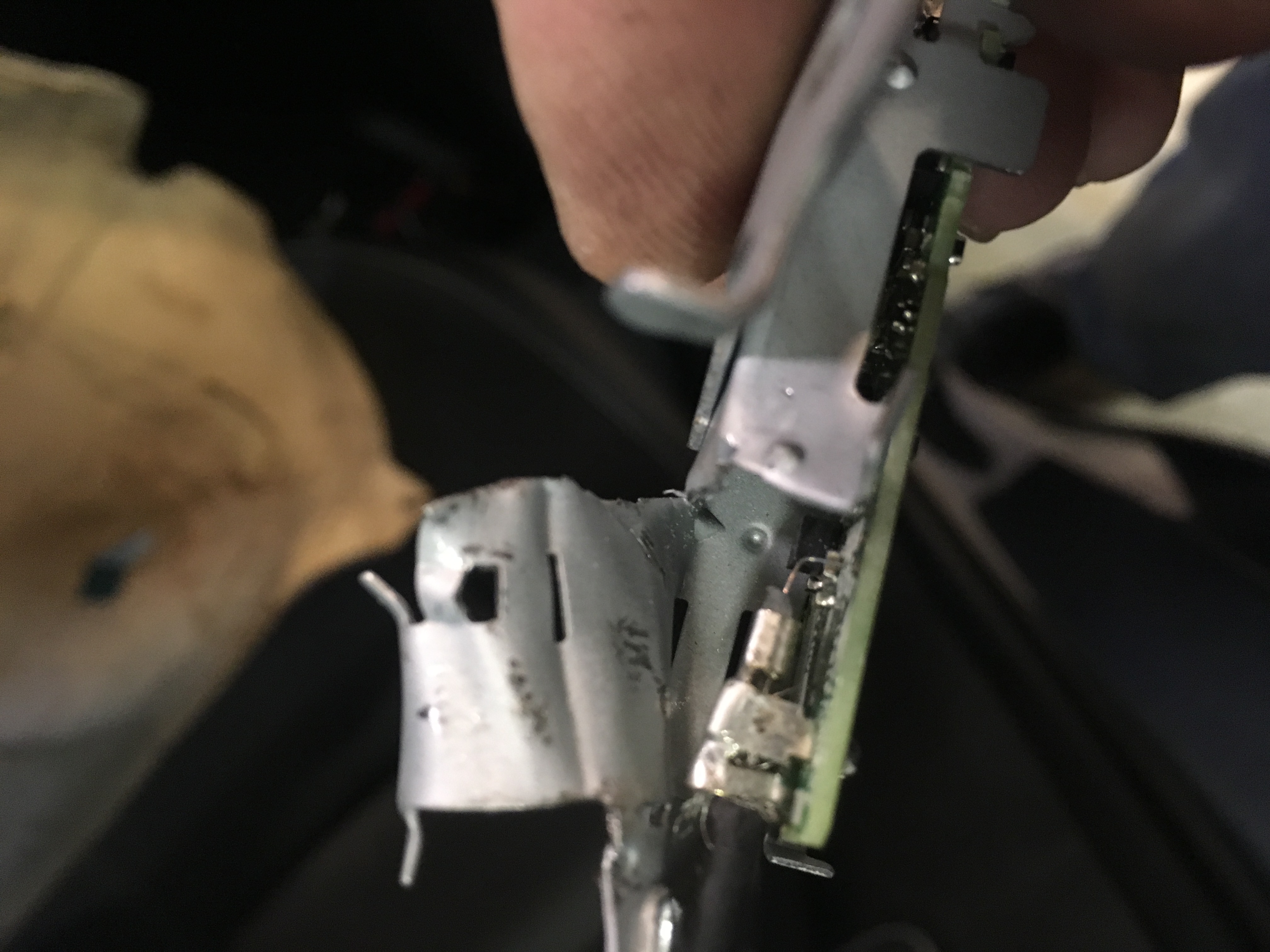

Also I decided to improve the factory intake - it has a big loop in it to quiet the intake sound, and it's picking up air from just inside the engine compartment. I removed half the loop and now it gets air from the cavity behind the front bumper.

I cut this off right where my thumb is
And I had a curious cat doing some inspections
