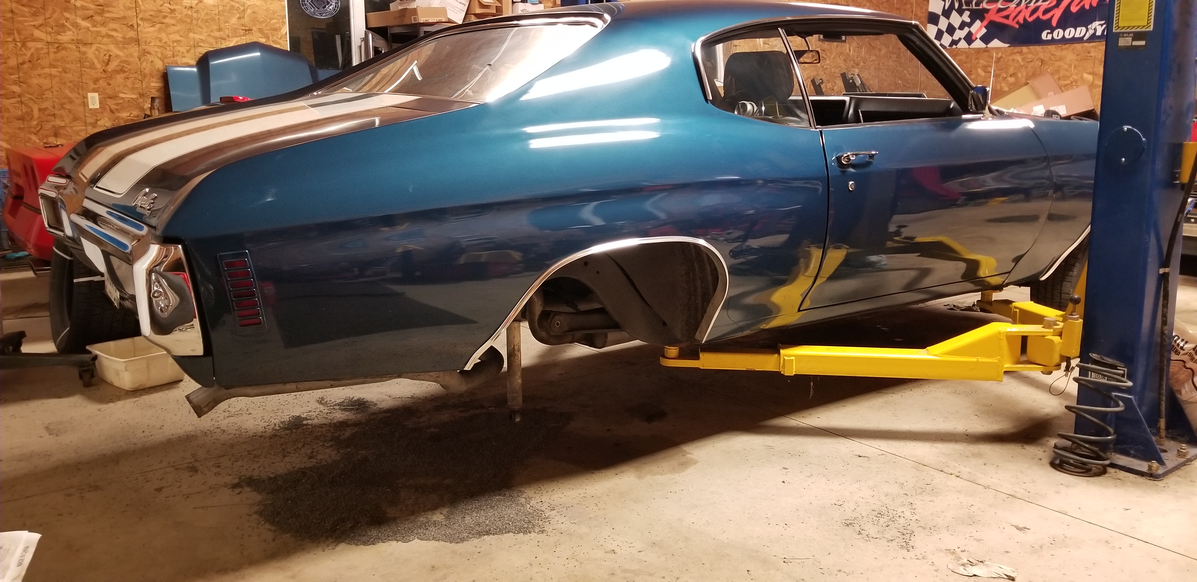

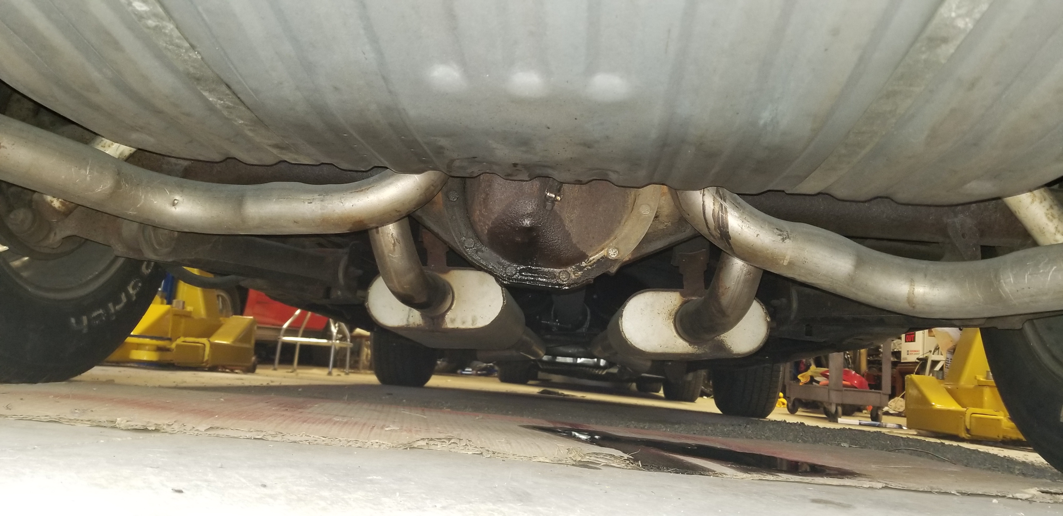

Driving to work last Friday, I ran it pretty hard down 271 and heard a new noise. :-) Twice, kind of ping noise that I'd never heard, while at speed. I continue to work, and go home with no issues. Yesterday (sunday), I pull it out of the garage, and while it's idling in the driveway, I see a big oil spot on the floor, but way behind, not under the engine. WTF? I drove it over to my parents, no issues, short lap of Chesterland, and put it back in the garage. I put cardboard under the rear and today there's a bunch more oil. Something has dented the cover from the inside.
The rear end is a 12-bolt posi that was put together in 1992!! This will be the first time I'm opening it up since then. I'll be paying a visit to Jim down in Richfield, most likely.

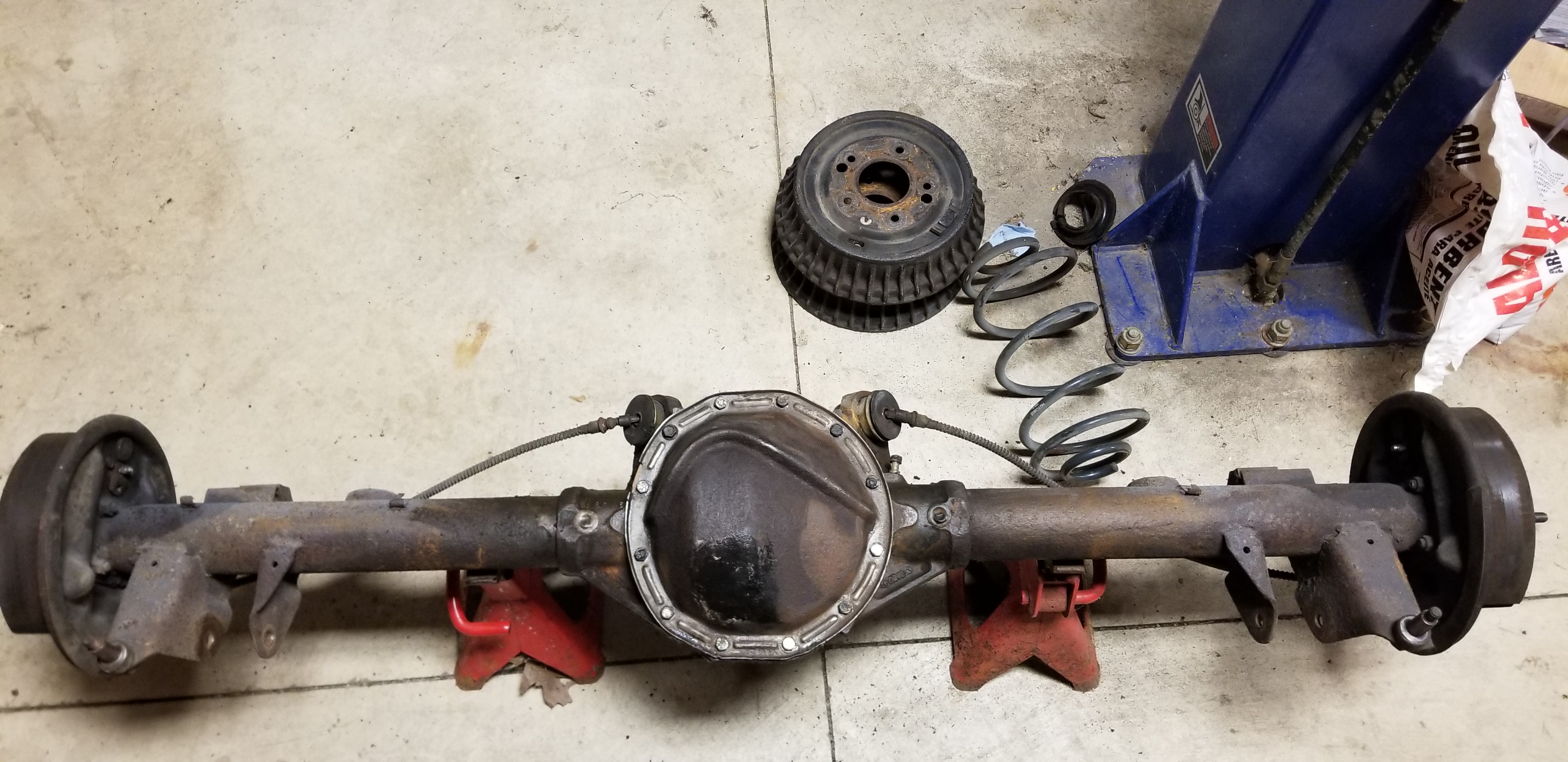

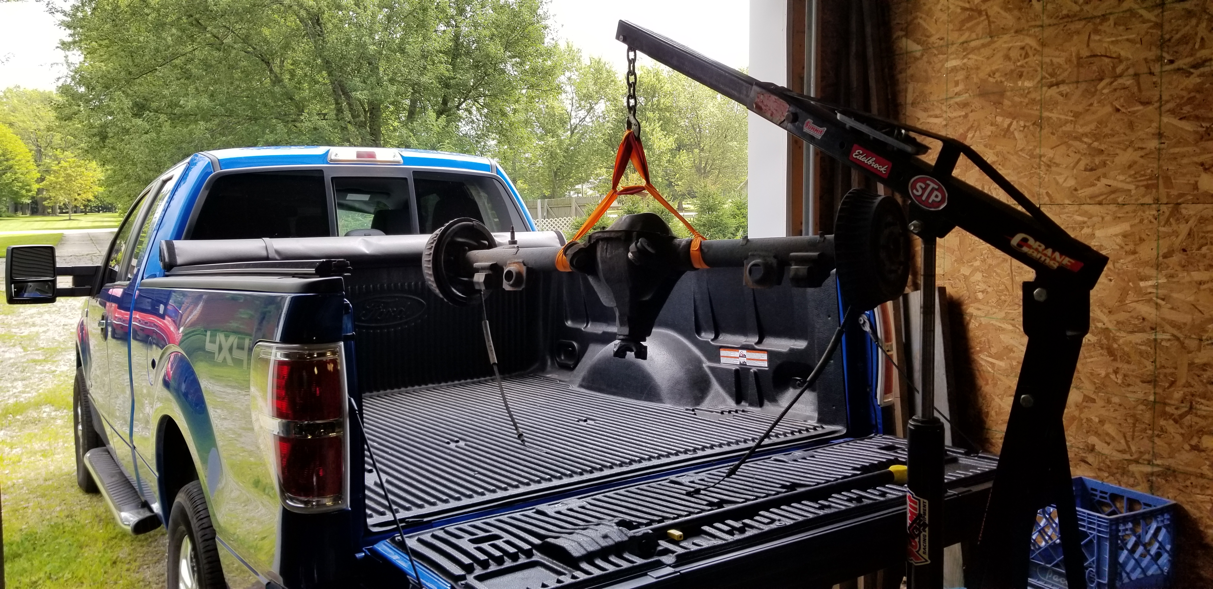

Got the rear-end out last night. Called Jim @ JD Race yesterday, I'll drop it off this week. I'm still not supposed to be lifting anything heavy after surgery, so I might need to round up some help getting it loaded in my truck.
Posts: 3610
Re: Chevelle Upgrades, 2019
You could use an engine hoist if you didn't want to wait for anybody. You sticking with the same gears?
Posts: 2602
Yep, hoist is my other option. I may give that a shot tonight. Probably keeping the same gears.

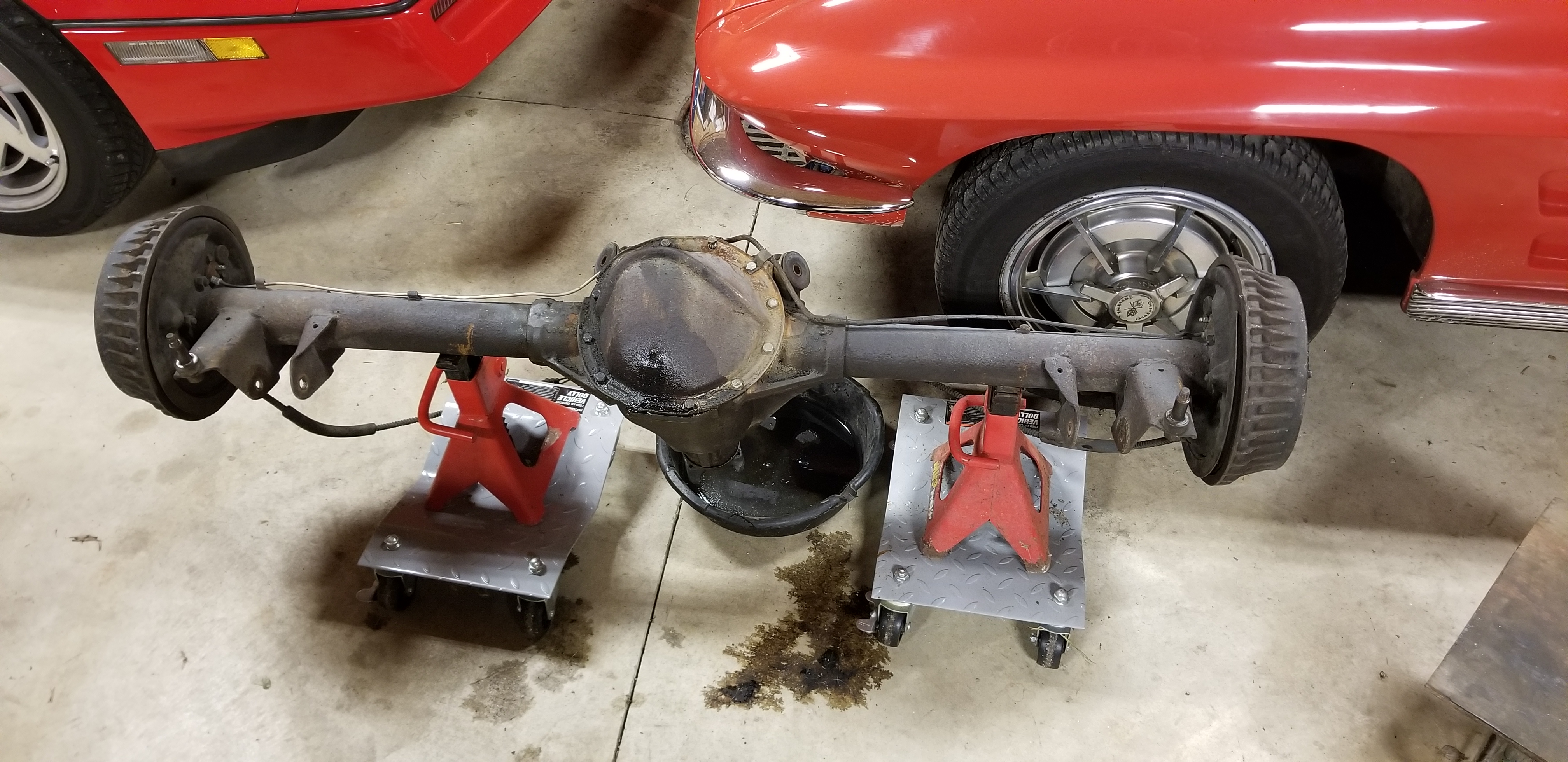

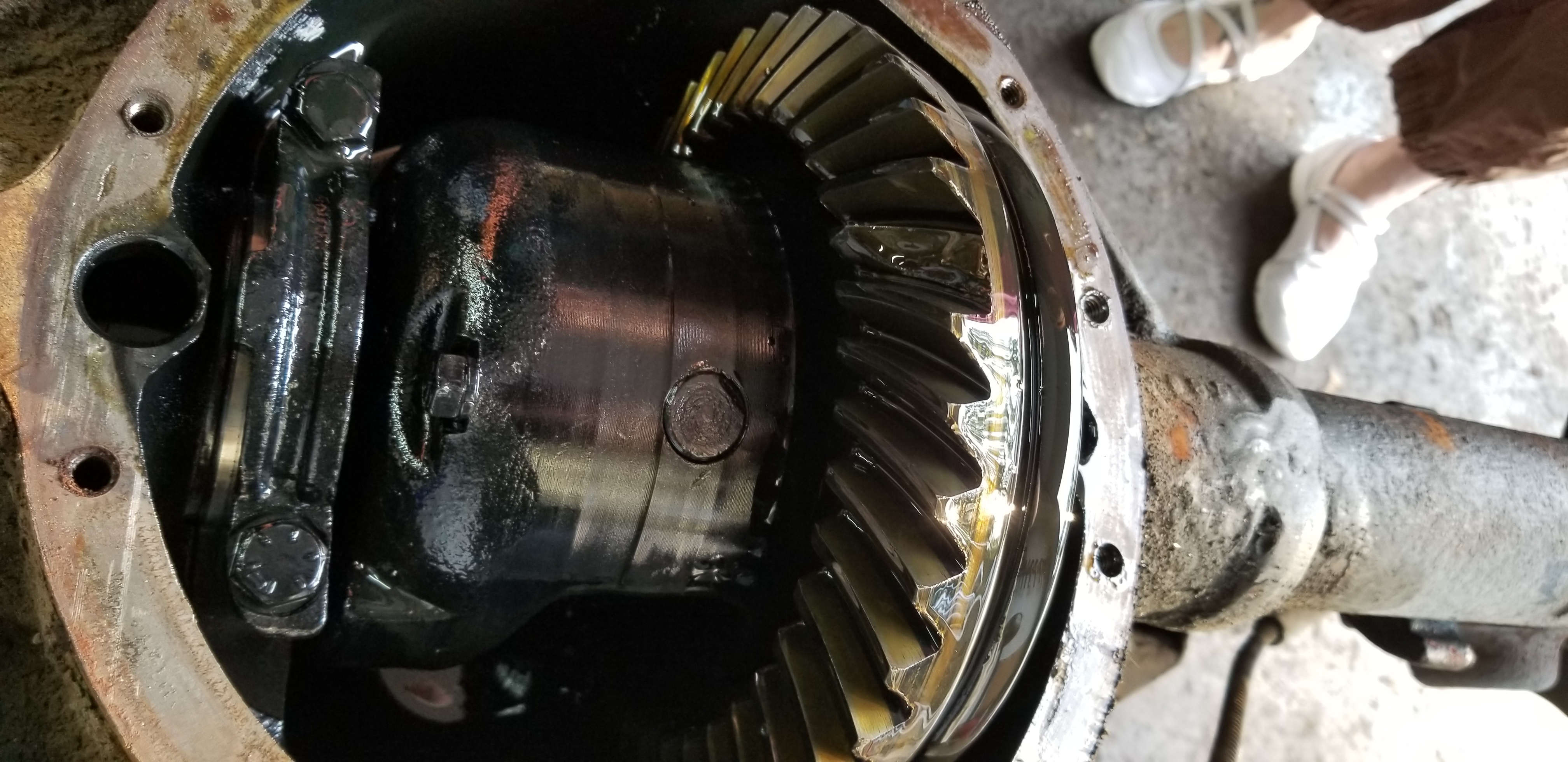

I took the rearend down to JD Race last night. We opened it up and found a broken tooth. He showed me the gear pattern, which seemed to be a bit shallow.
I'm gonna try upgrading to 3.73s. I've had 3.55s for a loonnng time, and they were a better street gear back in the TH350 days. I know it's not a huge change, but it's a change in the correct direction. Besides, from BP's experience, getting the gears changed is a (relatively) cheap operation if nothing else needs to be replaced/upgraded.

So last Friday, I went back to JD Race to pick up my axle. Of course, it wasn't just a simple ring and pinion change. Basically, my posi was junk, the cross shaft wouldn't come out, he had to hammer/bang/cut enough of it until he could get the axle c-clips out. That posi was a Canfield or Randolph special. 2-series carrier, and when I had it setup, they had to use a spacer for my 3.55 gears. This rear axle was the oldest piece of the drivetrain, by far. Many engines and transmissions had come and gone before this axle broke.
It now has a Yukon posi with 3.73 gears. My old Moser axles were still good so they were re-used.

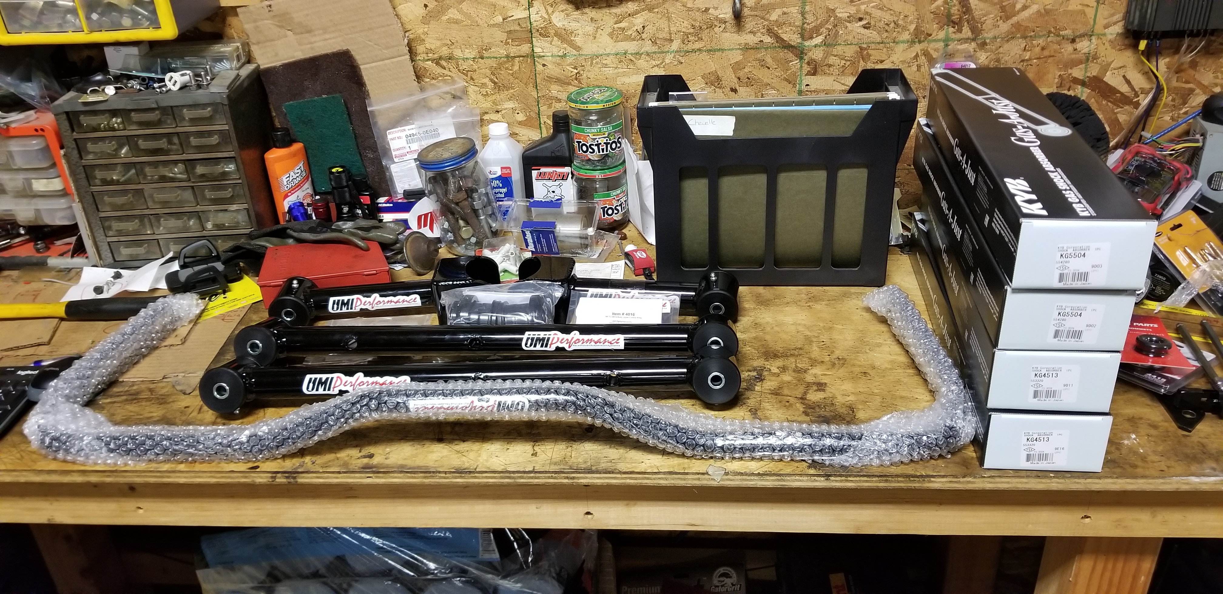

I bought a UMI rear suspension kit with new upper & lower arms, triangulation braces, a rear sway bar, and 4 new shocks.The brakes were re-done in 2016 or 2017 I think. I re-did one of the brake lines then in NiCopp, I will re-do the other one this time, and then give the whole thing a coat of paint. I also bought a new Pitman arm, as I think now might be as good a time as any to also swap in my fast-ratio steering box that has been sitting on the shelf. It's supposed to be a "bolt-in".

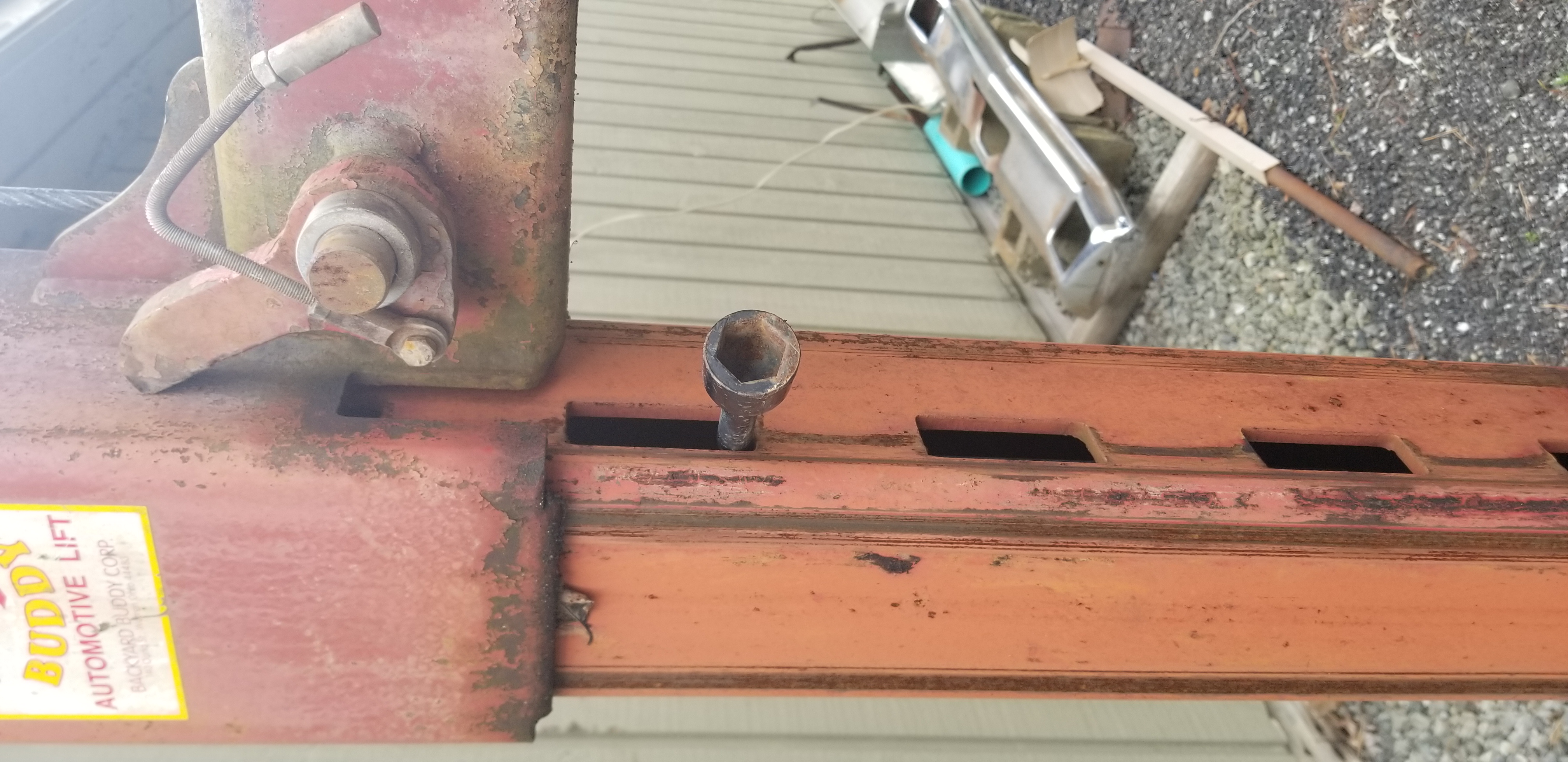

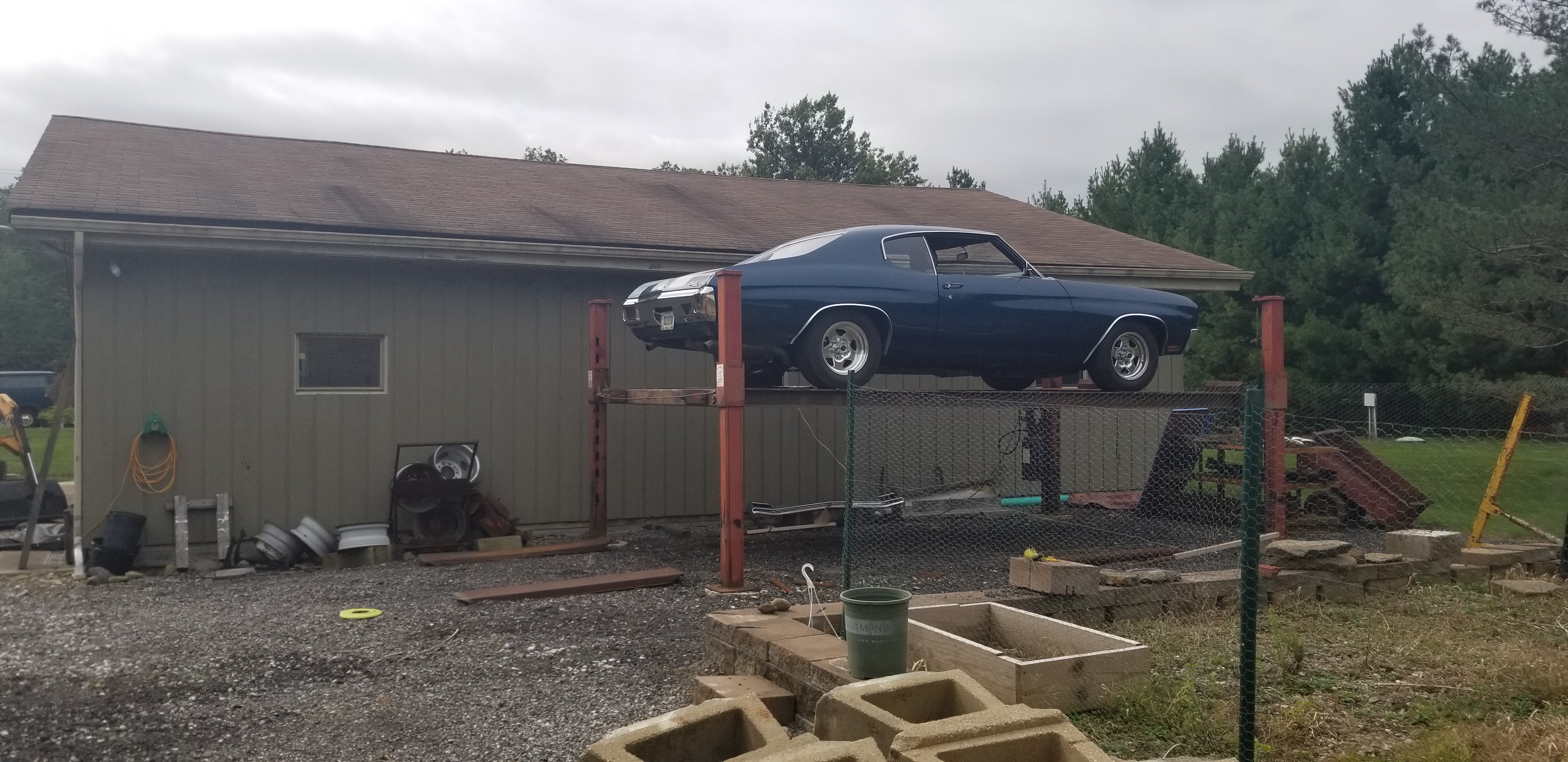

Well, the new posi/gears/suspension/shocks are done! I used Jerry's drive on lift, with exclusive tire-iron safeties, to put the final torque on the control arms. I've driven it several times now for to break it in (several heat cycles). Next time I drive it, I'll probably let 'er rip!

Is that your old rear bumper behind Jerry's garage?
Posts: 2602
Haha, no.. hes got waaay more old chevelle parts laying around than me.

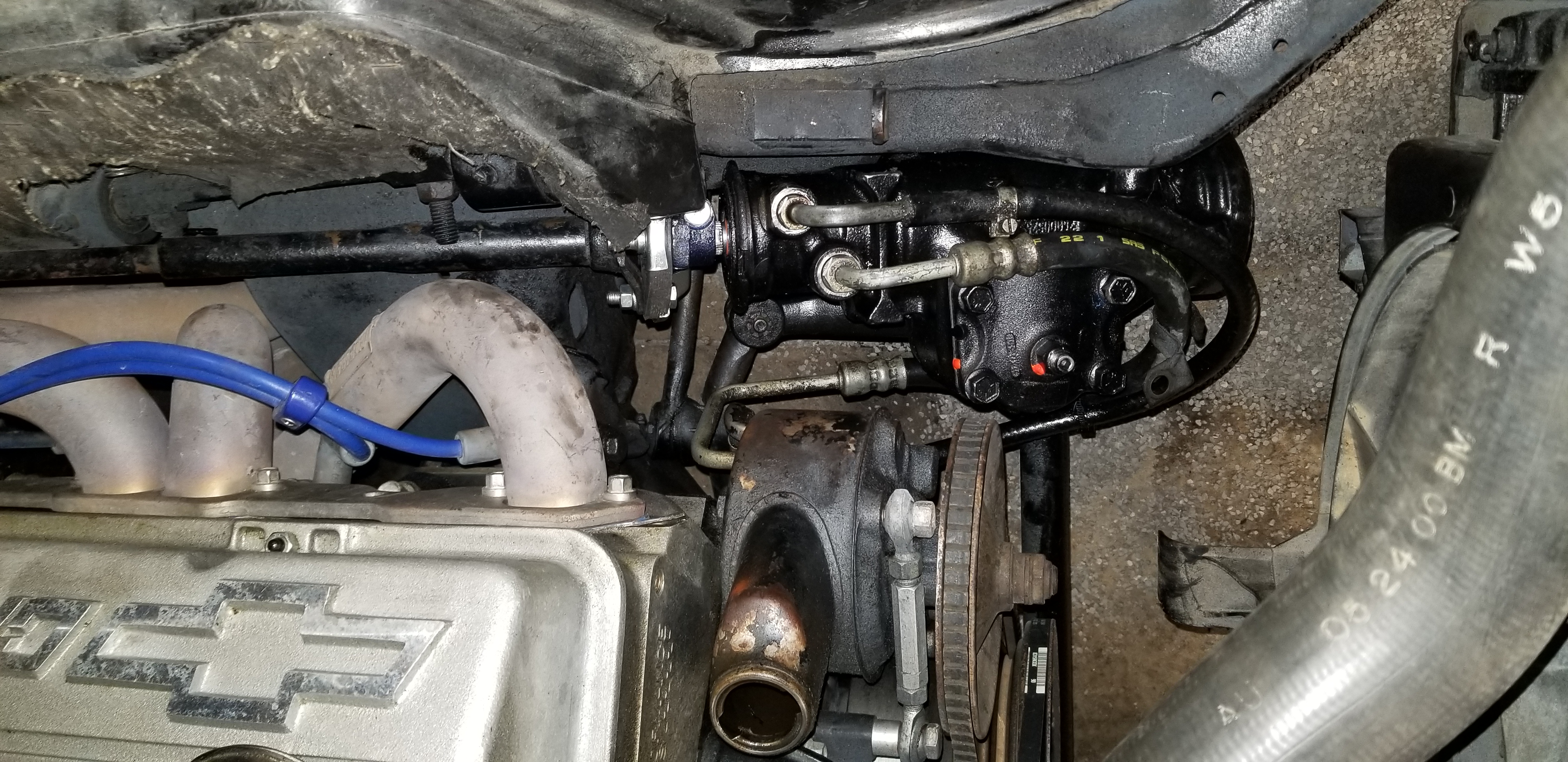

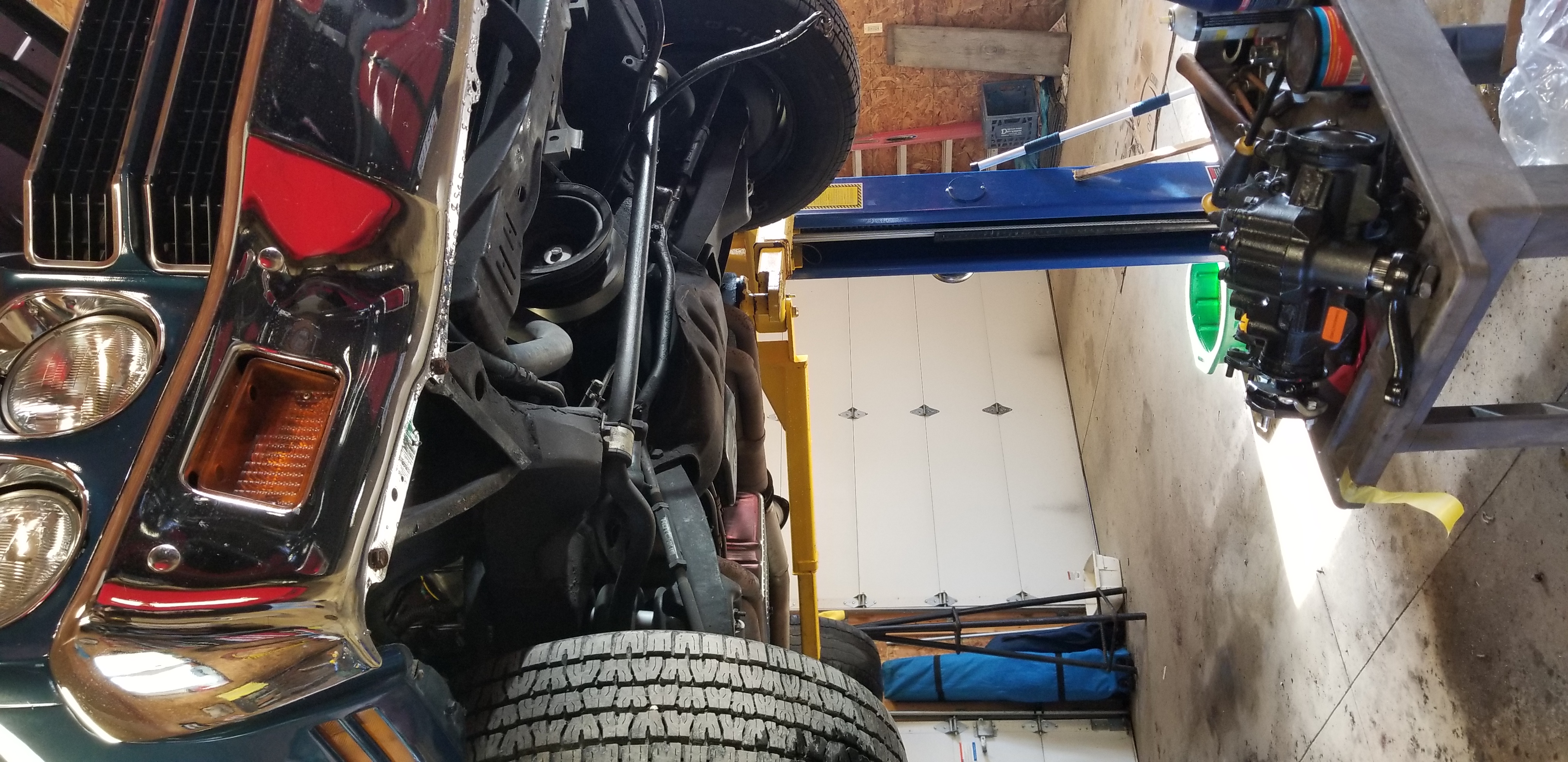

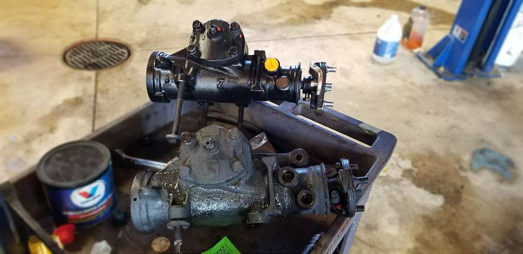

So I *finally* got around to an upgrade I've been meaning to do for years. There's a late-model steering box you can swap in -- bolt-in direct -- that is supposed to totally upgrade the feel and give a faster ratio. Corvette or Camaro box you say? Nope. JEEP. Grand Cherokee.
Decided on Monday to take Tuesday off -- very good decision!
Old box and new box
New box fully installed and plumbed

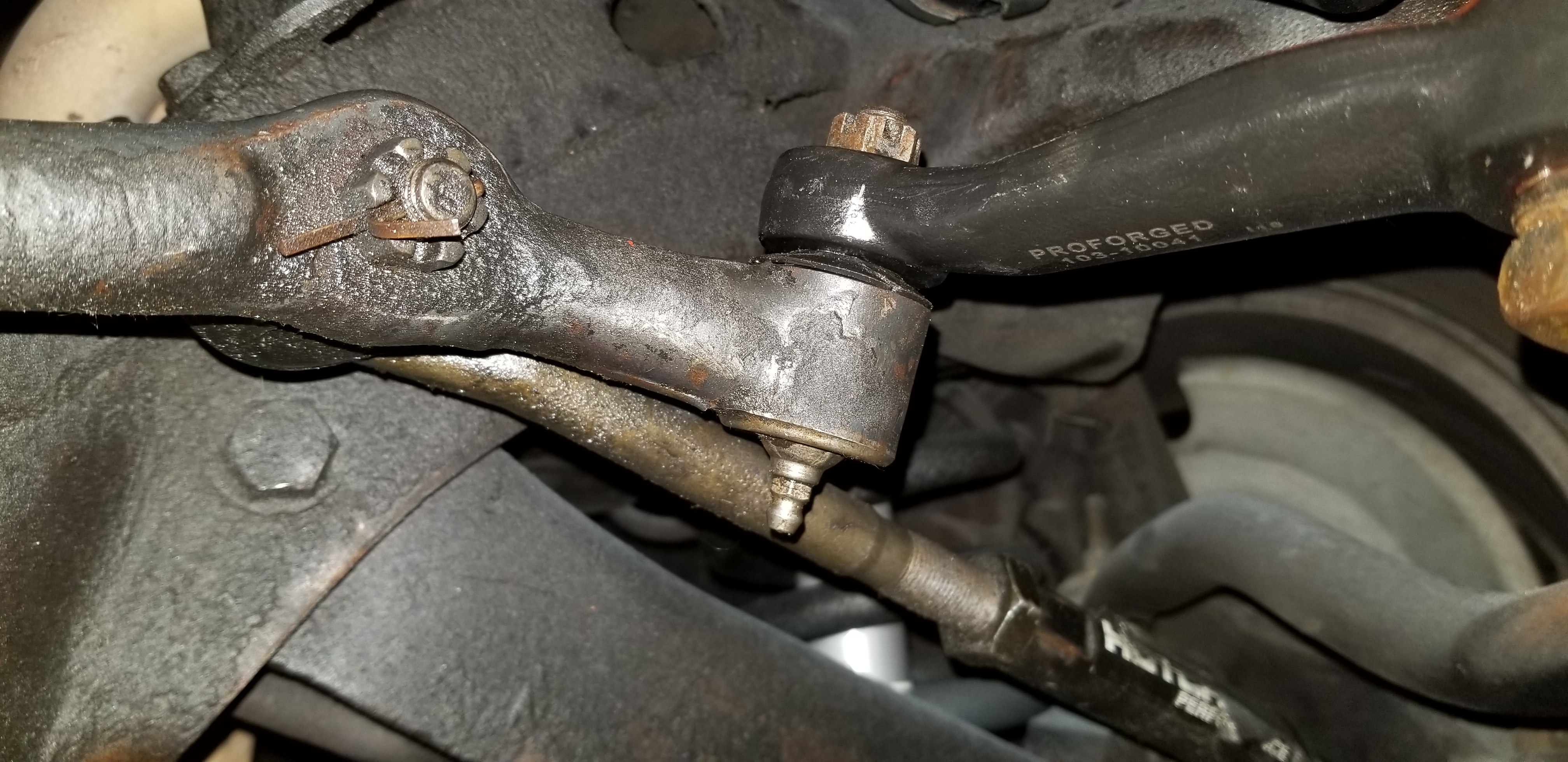

My one issue -- the center link doesn't want to seat correctly into the new pitman arm.
I 'll try to re-seat the center link later today. Worst case, I suppose, is to swap to the old pitman arm.

Had the same issue when a Monte Carlo steering box was swapped in to the El Camino. There are two different diameters for that style of splines. Got it resolved with the seller listed here. https://www.tiresmoke.org/viewtopic.php ... arm#p13144 That seller can probably tell you what pitman arm will work for you.
The Jeep steering box is also a popular swap in El Caminos. A search on the El Camino Forum will give you lots of info. https://www.elcaminocentral.com/forums.php
I loved the quicker steering/road feel with the MC box. People say the same about the Jeep box.

I think the only reason Chevelle guys don't use the MC SS box is that the steering limits (internal) are wrong. Cant remember if its too tight or not tight enough in terms of resulting turn radius.
The new pitman arm is installed on the steering box. It's for a '70 Chevelle, as the swap normally calls for you swapping over your stock PA. I just bought a new one to save time (!!) and everything eyeballed ok, although I didnt measure that hole.
The centerlink (drag link?) is not fully engaging. As that's a hole on the pitman arm, there are pitman arms with different size holes for centerlink side?
