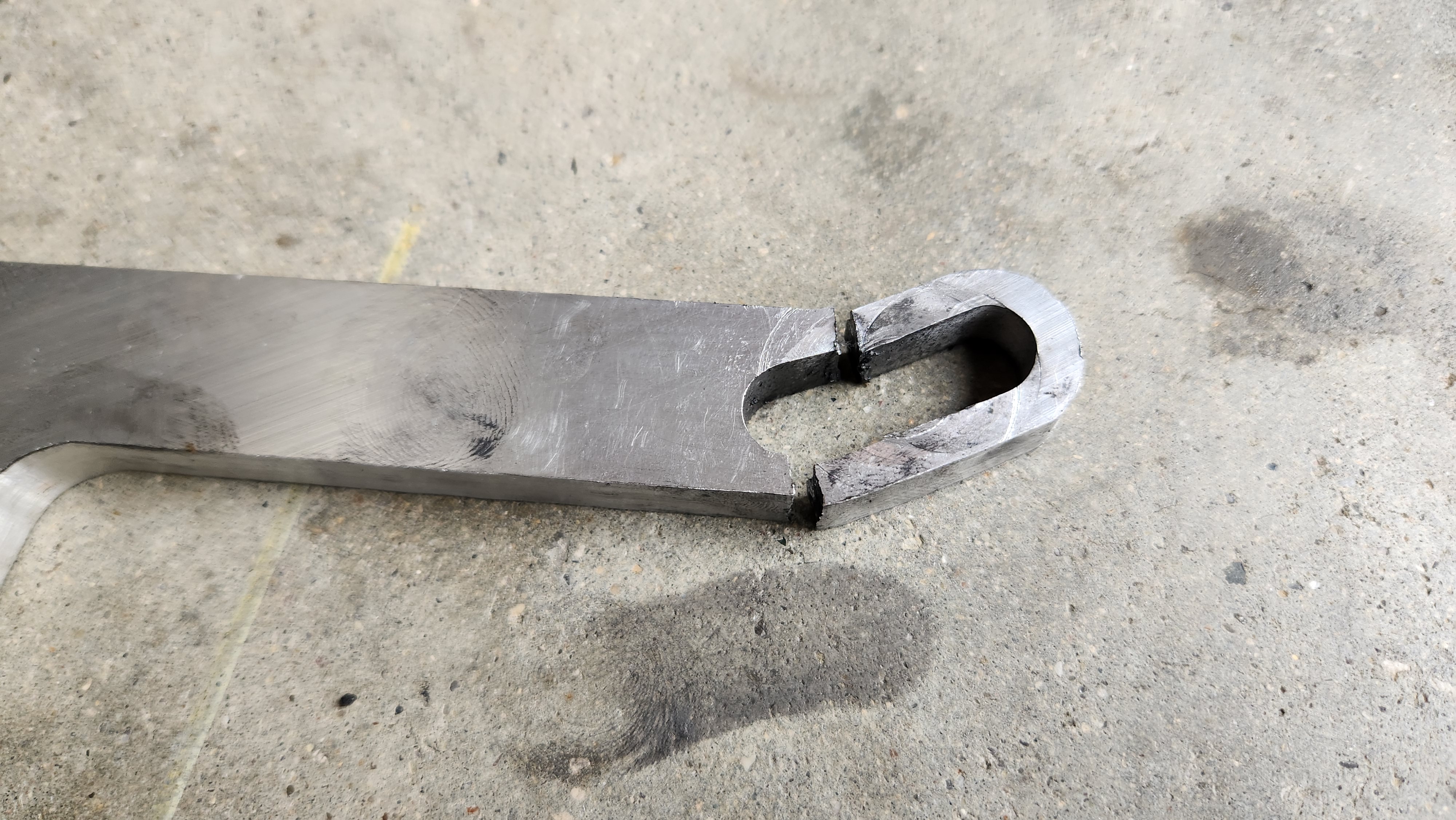

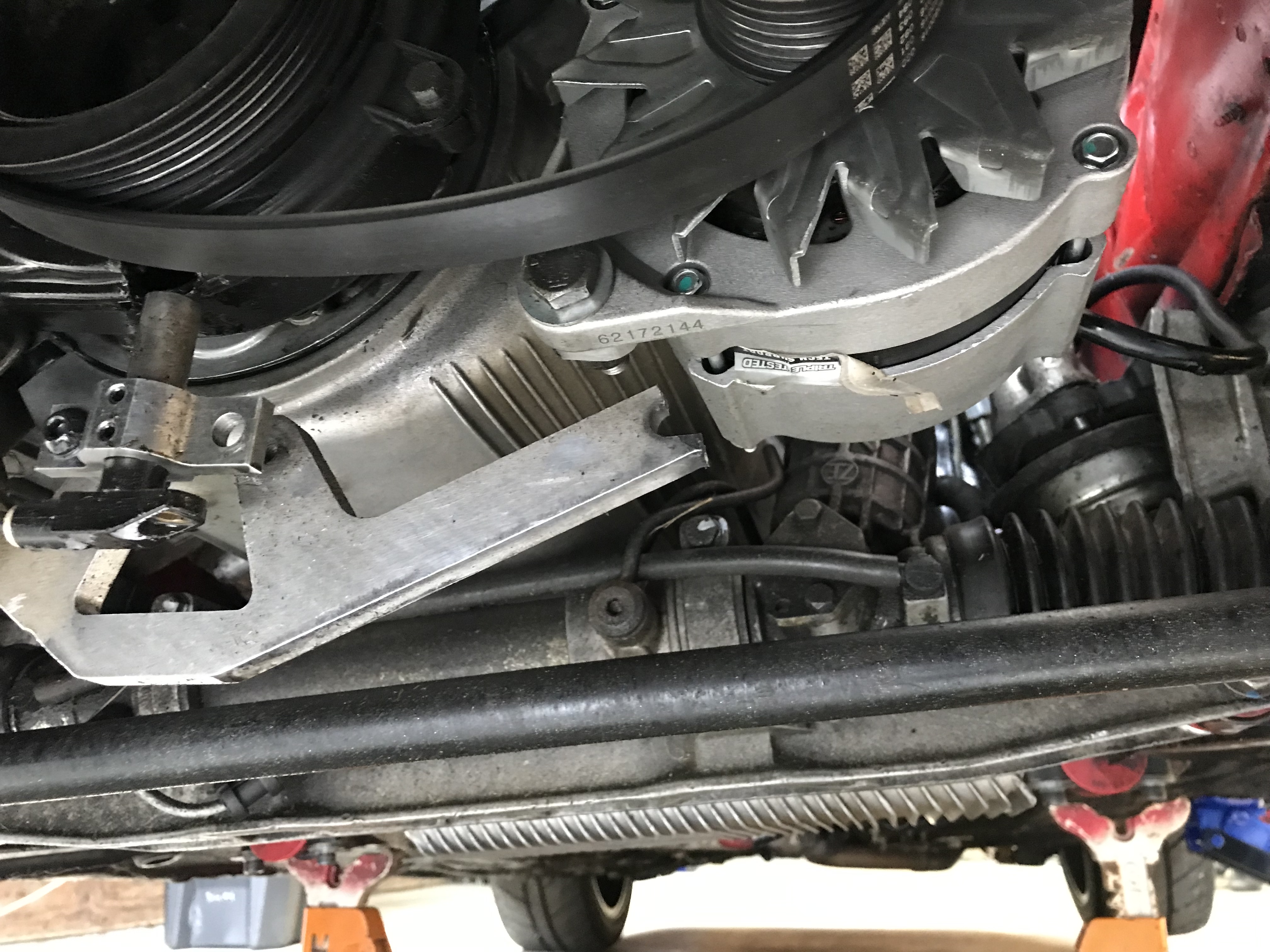

On Saturday, Scott took the green flag at 9am. At 10:30, he was towed in, car was dead and wouldn't start. The new aftermarket bracket that was a combination crankshaft-sensor-mount and alternator bracket had broken. This threw the sensor way out of alignment. With some hardware store help from Chris and Jered, we were able to MacGyver together a working solution, and I was out on track by 12:30pm.

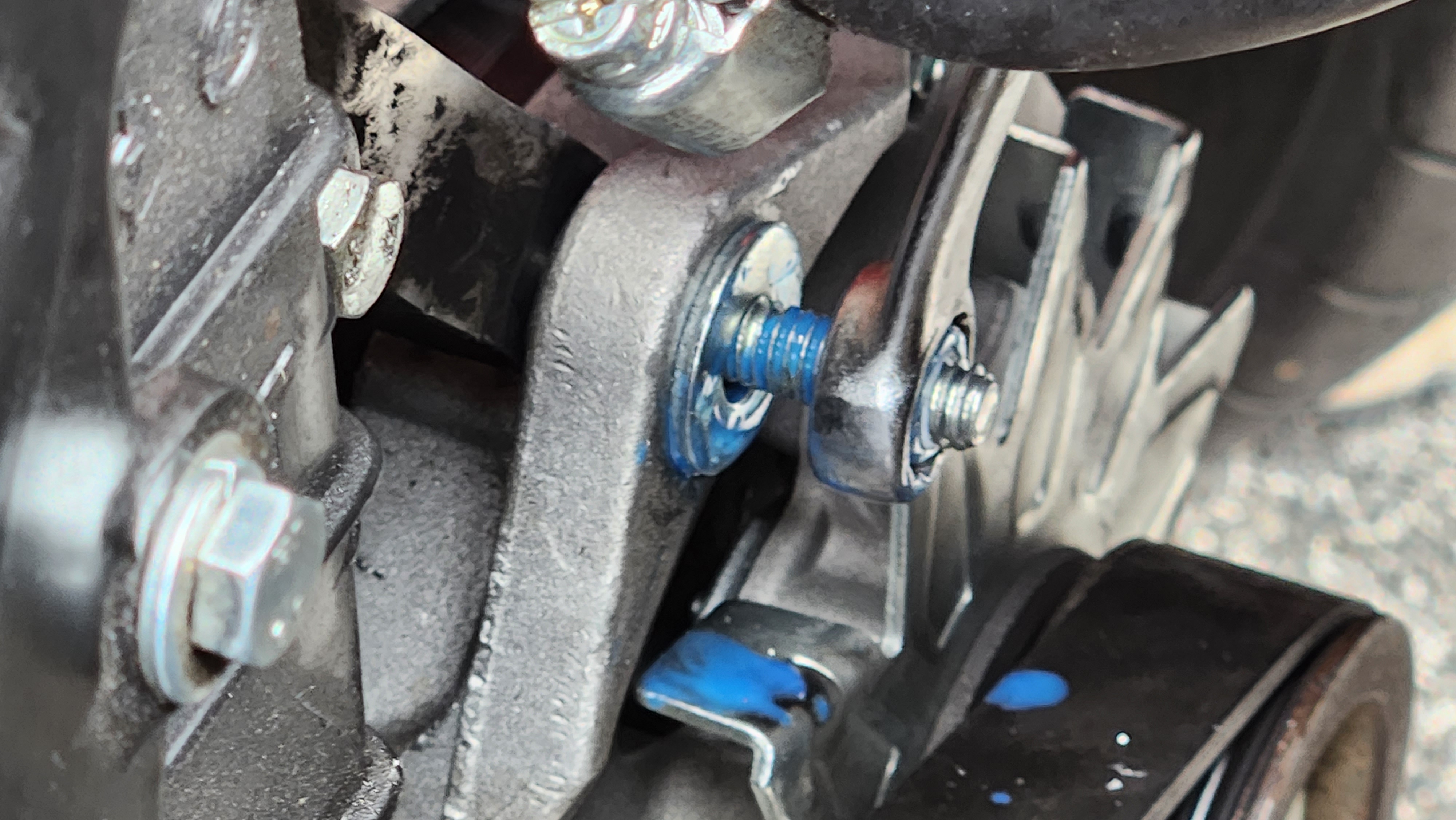

I got out of the car at 1:50pm and went from exuberant to pissed off in about 30 seconds when I heard the car turning over and not starting. This time, the alterntor pivot bolt was missing, which again messed with our crank sensor alignment. Chris and Jered made another quick trip to the hardware store, got a bolt, and we had the car running again for Tom's stint.

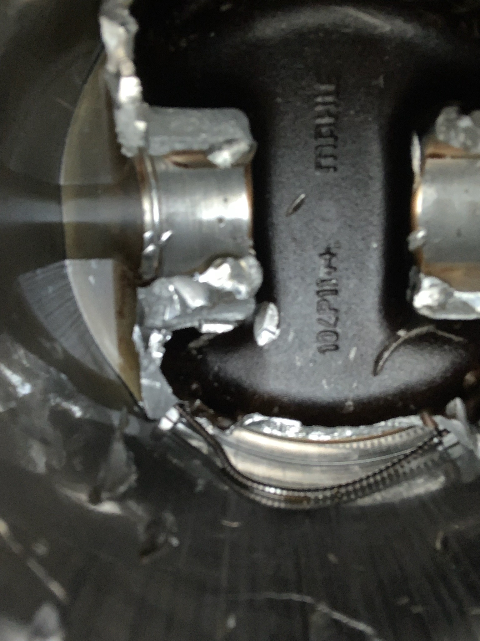

Joey got in the car at 3:45pm, but it would only last 20 minutes or so before he was towed in with catastrophic engine failure. We could see a hole in the block where the upper balance shaft goes.

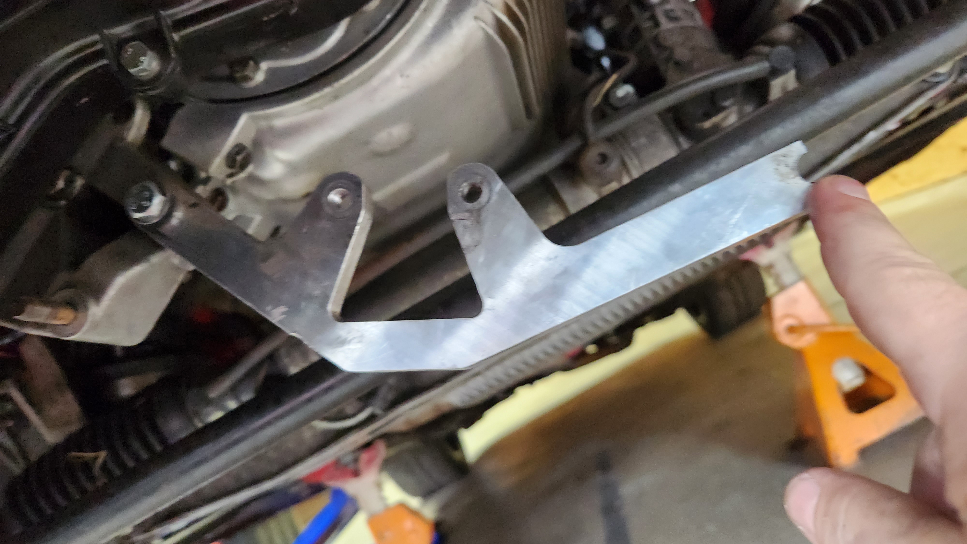

I didn’t think to photograph the hole but Scott had this view of the inside. Bonus pic is the CPS bracket right after it cracked
- Posts: 3399
Re: Porsche 944 Megasquirt conversion
A suggestion would be to make that exact bracket out of steel.
- Posts: 2460
No, the correct answer will be to figure out how to use the factory crank sensor back by the bellhousing. That will eliminate this bracket all together. That bracket might be nice for street use, but is not positioned well for an endurance racecar, IMO.

That bracket was in use to get a crank signal in the time that was left. Now there will be time to get the signal right from the top mount location Dave mentions. If that fails that entire bracket needs redesigned. If you look closely there is a mark just at left of photo. If that bracket went straight across instead of coming down in more of a V shape there would have been no contact and we may not have had those issues.
Also if the make had left the metal wider instead of cutting a slot that removed over half the metal there the metal may have had adequate strength. Just not a well thought out part for a real racing application. Made it possible to get the car running though so it was not a total waste.
