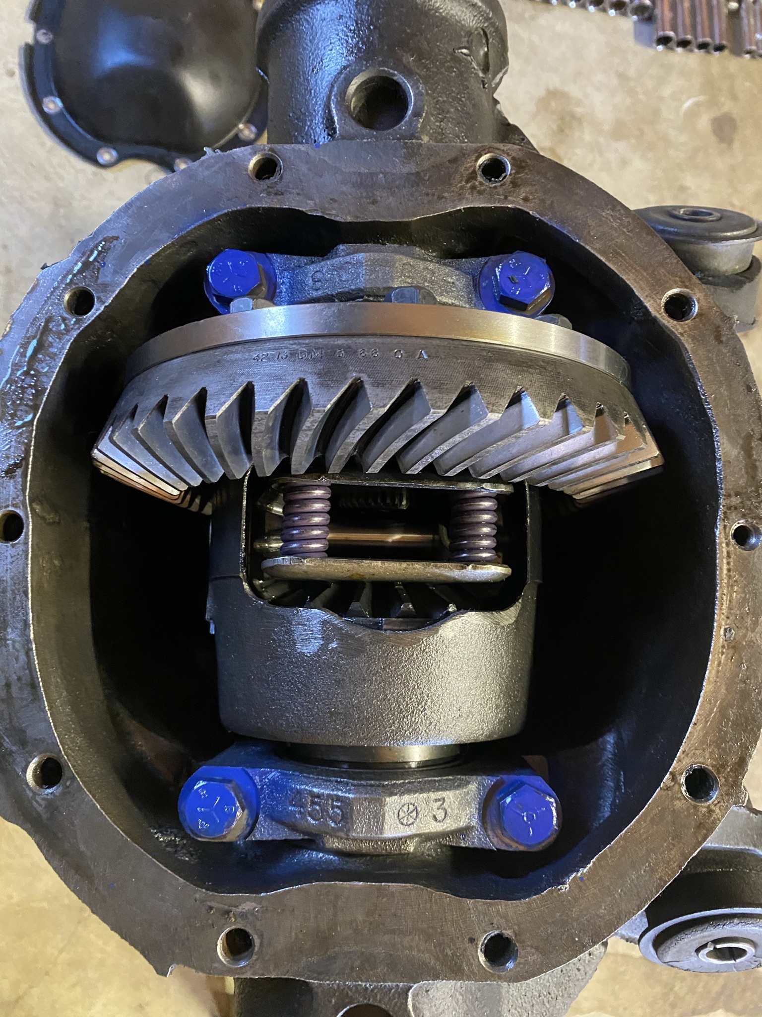

I haven't posted for a bit, but slow progress is being made. I had to read back through my last couple
of posts to make sure this post is actually and update. Since last post, I took the 3.36:1 gears out of the
spare axle housing and installed the 3.90's. Fred was there to assist. I'm not certain that our work would
pass inspection at a speed shop, but the gears are in and I now have a 3.90 posi lying on the floor waiting
for install. I've also been doing minor adjustments between joy rides. I had a feeling that there was more
adjustment to be made in the vacuum advance. After switching the vacuum supply to the rear carb, I was
getting a small surge under high vacuum. I've adjusted that away and it's now way better. I also bumped the
rev limiter to 5600 rpms. After the exhaust smoothed out the acceleration so much, I felt that I was short
shifting and I was correct. I get a very strong pull through 5400 rpm now. This should help out the e.t. a bit
I'm certain. I guess my thoughts now are to take it to the track and see what it will turn with the new mid-pipes
and mufflers and newly found rpms. Once I have that baseline, I think I'll pop in the 3.90. If the axle swap
nets a large increase, I might have to do something about getting an overdrive set up. More to come.

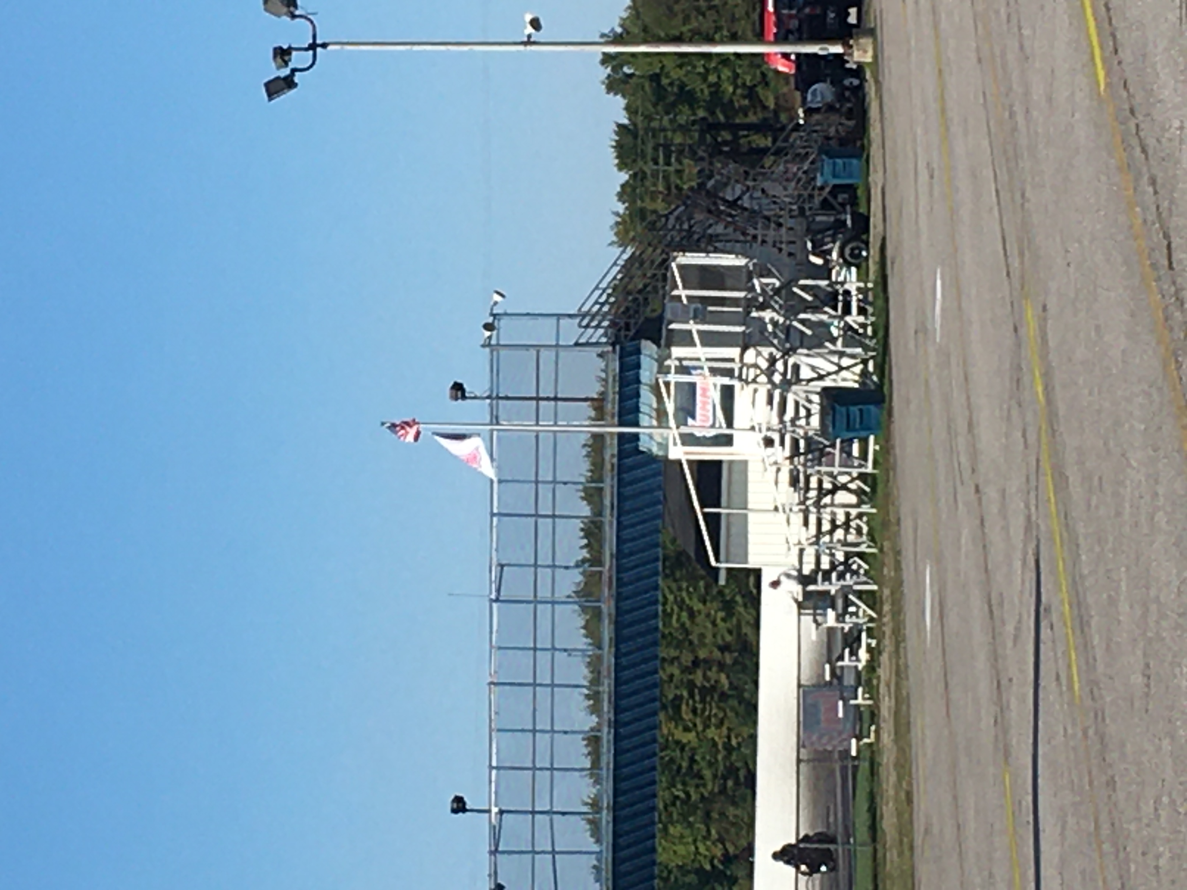

I've missed the last few Wednesday nights at the track. Last Wednesday, I was about two miles from
the track when Mother Nature scared me away with some showers and, as it turns out, they were able
to race. Today, the weather was a cool 45 degrees with a light West wind. I made the decision early to
hit the track and see if my last two modifications would make me quicker. I made it to the track and
pulled in just as they were calling cars to staging. I only sat for about 10 minutes before my first pass.
I ran a 13.73 @ 102.7. I would have been satisfied with that run, as it was a solid two tenths faster than
my best. Since there were only about 40-50 cars there, it made getting some runs in pretty easy. My second
run was a 13.71. Before my third pass, most of the cars were in the staging lanes, and I actually had to wait
about 20 minutes before I went. I pulled off a 13.57. So before my next run, I waited another 20 minutes, but
I could feel the temperature climbing and I was losing the cold. I ran another 13.71. I figured that was the
best I could get out of the day, and called it enough. I'm very pleased with my times. After checking my old
time slips from the Vette, I realized that the 442 is faster than the stock C5. I think that I can bump my rev
limiter up a bit, as I'm pulling very strong through 5500 rpm. This coupled with a cold day should net me a
couple of tenths. Going to the 3.90 rear axle I think would get me a couple more. I never dreamed that this
car would be going as fast as it is. Perhaps going in the 12's may not be just a dream for the 442. We'll see.

So the rear ends made their way back home on Christmas Eve. I was correct in my thinking that the
3.23 rear was clunking. As it turns out, the cross shaft that holds the spider gears in place was starting
to chew into the carrier and one of the spider gears was frozen on the shaft. The gear set and housing
were still in good shape, but I had to have a new posi carrier put in that rear end. Eaton doesn't make a
carrier for that gear set, so we had to go with an Auburn center section, which is very similar to the
original carrier. The 3.90 rear end that Fred and I just bolted together was half correct. We used the old
crush collar, which got the pinion depth correct, but our shims were wrong side to side. That rear got
fixed on the cheap. I tood the time today to install the 3.90 and make sure that the control arms are
properly torqued and teh bushings are lubed properly. The only thing left to do to the car now is take the

The weather was pretty decent yesterday and I was looking for a reason to go outside, so
I went to the barn to tie up some loose ends. The 3.23 axle needed fluid and a cover gasket, so
I searched them out at the local Napa store. I knew they’d have the gasket, as I had purchased from
them before. They did. I grabbed my parts and went did the install. It was pretty simple. I also
removed the old rubber control arm bushings from the housing and installed urethane ones. It’s
properly filled with 80/90 lube and Auburn’s positraction additive and is now ready to install if/when
I need to use it. I also spent twenty minutes removing the ratio adaptor from the trans housing, so
the 3.90 axle install is now complete. I fired the car up, let it come to temperature, then parked it away
for the rest of the winter. The battery tender is on and so is the car cover. Attached are some pics of the
new Auburn carrier with my 1966 dated 3.23 gear set installed.
