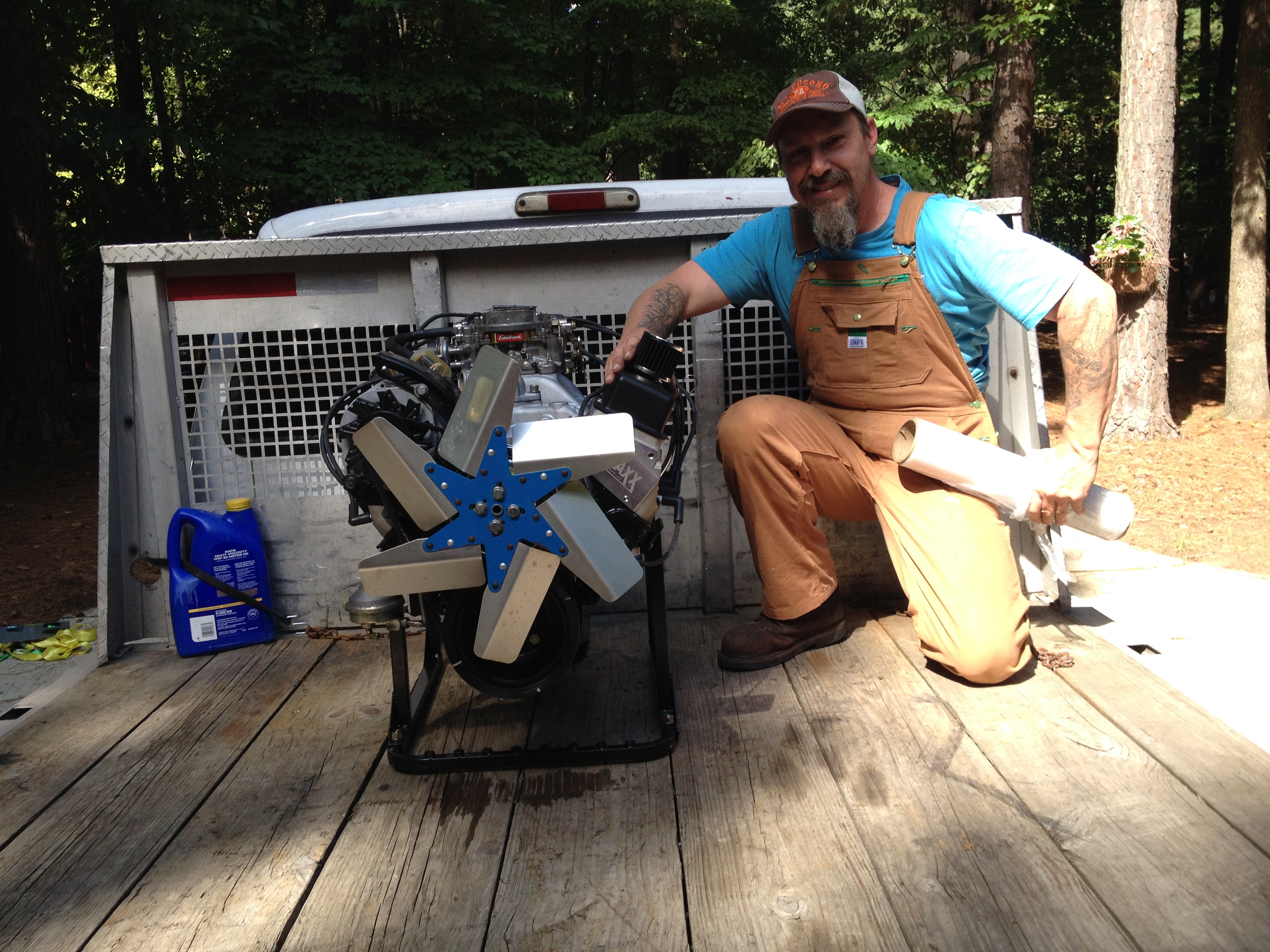

Today was about tending to some leftover issues...set timing, overheating, and rewiring the start button to include a relay. Jim worked on the wiring while I struggled to make my 40 year old flex fan work on this water pump. I had to make a trip back home to locate a fan spacer to move the fan back. I found the spacer, but the holes didn't match the pulley so I had to drill more holes in the pulley. Finally it all came together. The fan is in exactly the right place up close to the radiator and misses all the other dangling things after we used up a few of Jim's zip ties. The relay wiring was accomplished nicely and we set the timing at 12°BTDC and this thing runs beautifully. Cooling issues were resolved with the addition of the flex fan and YouTube issues were resolved with great help from "THE Tiresmoker".

Re: SBC 350 + Test Stand
Engine is sold. WXO's Craigslist ad caught the eye of a guy in PA that builds custom trucks for resale. He was thrilled with the engine and the price. Says we should charge more.
Its going in a $50K 1966 (?) C10. Wants us to build more engines for him but he needs them in 8-10 weeks. Kinda hard to do with our one-day-a-week work schedule and my puttering during the week. We'll talk but seems unlikely we'll make another deal.
A really nice feature of this transaction is he gives no guarantees on his builds so our "as is" sale works well.
The engine stand was really effective as a sales tool. The buyer wanted an engine to drop in with no tuning. That's what made the deal.
