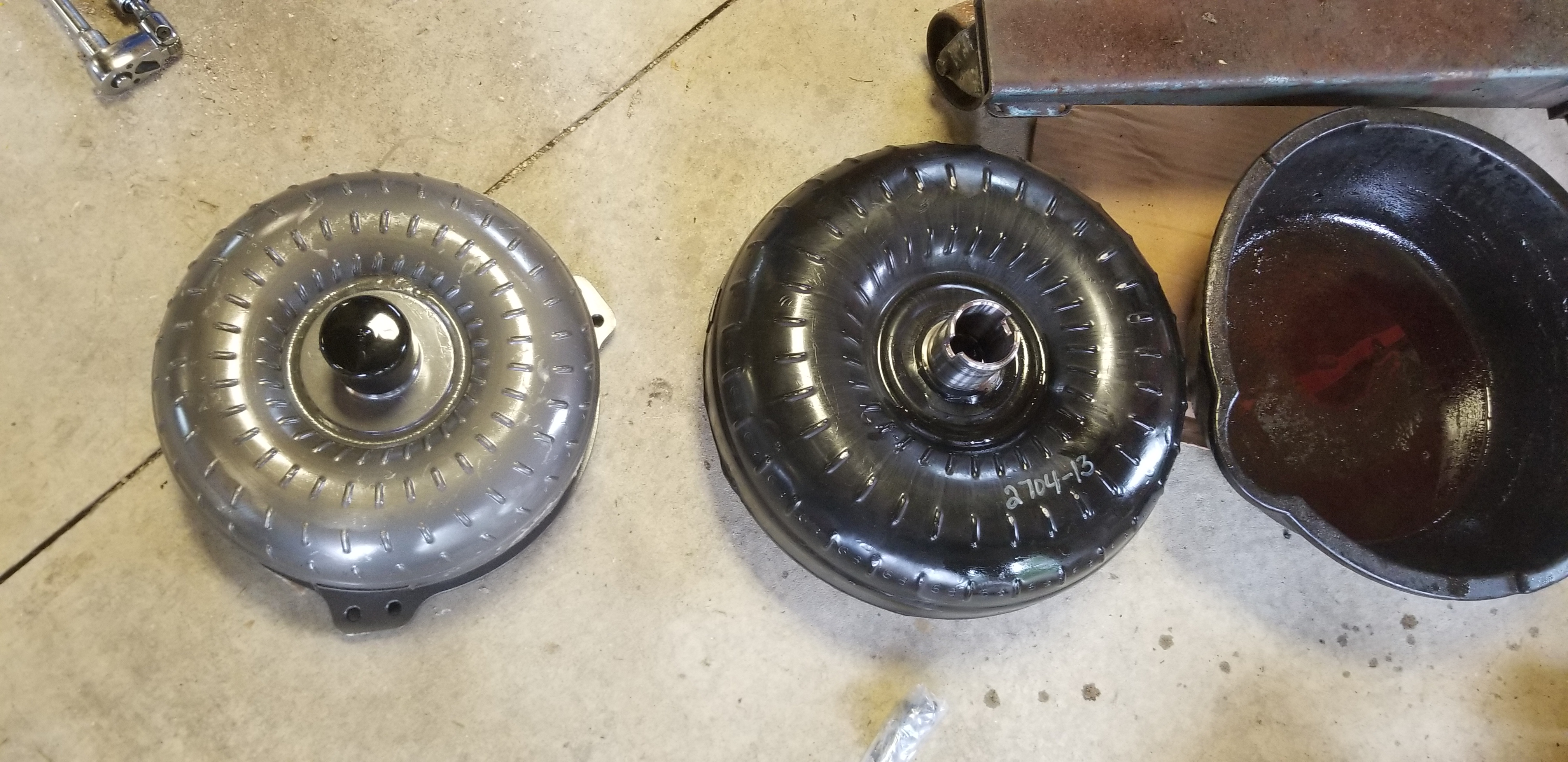

I bought a custom torque converter a few weeks back from Edge Racing Converters. Tony has an Edge in his car and it works great. I called and talked to Andre about what I had and what I wanted. He was a very good guy to deal with. The pic of the two converters almost hides some of the size difference. New one is a 10", max. Previous Summit converter is 13" and no where near the 2600 advertised stall, flash or otherwise.

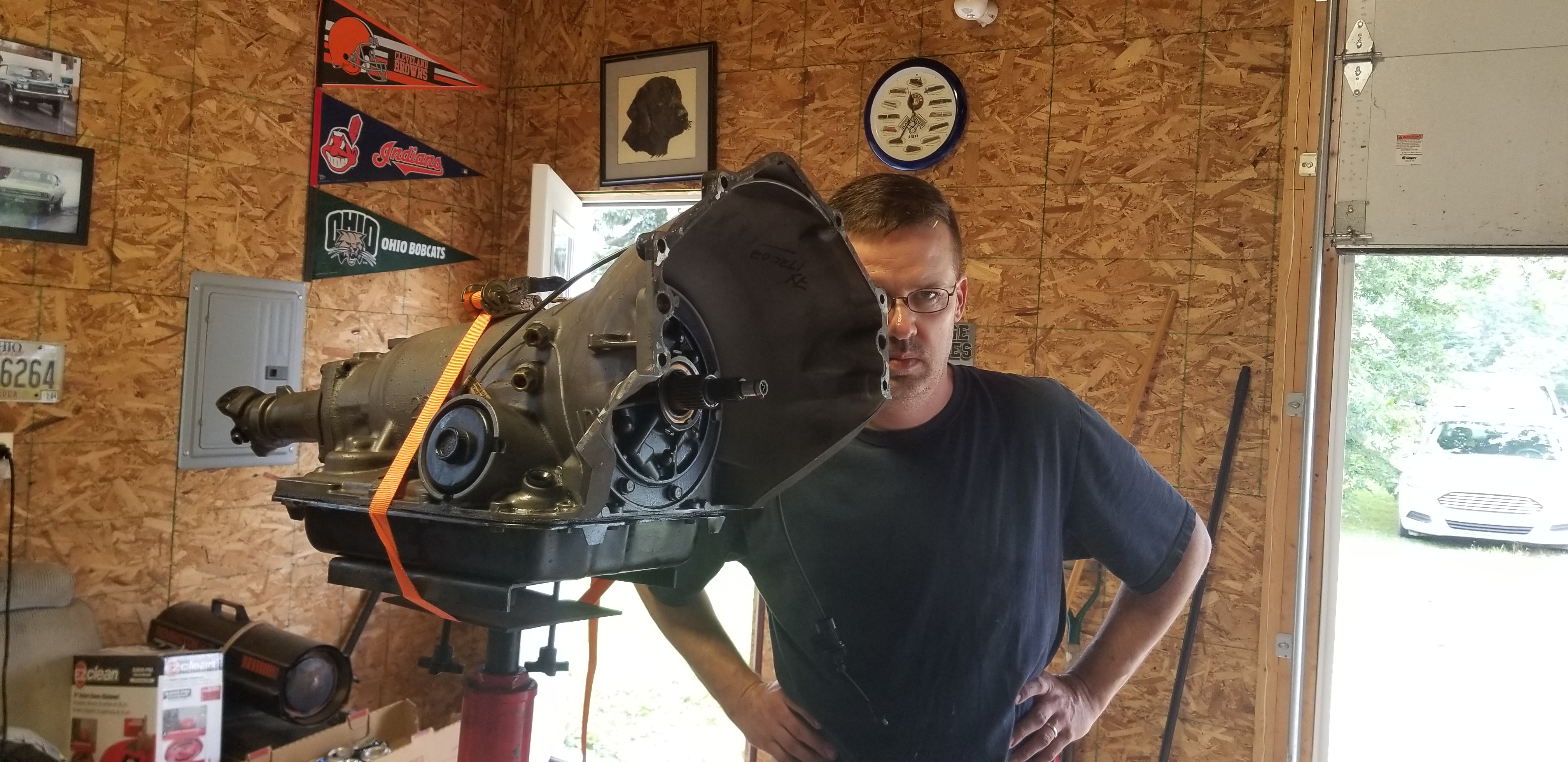

At breakfast this past Saturday, Paul offered to come over and help me swap it on Sunday. I'm always down for help, especially for this job, as getting the trans out (specifically, getting the bellhousing bolts) is no small feat. I had to be up at 6am for scheduled maintenance for work. By 8am, I was in Tiresmoke Central getting everything ready for Paul's arrival at 10.
I pretty much had everything ready to go. The plan was to let the engine/trans tip back so that hopefully we'd get a shot at the upper bellhousing bolts. The passenger side isn't awful, but the driver's side is real tricky. But after piecing together just about every extension I have, along with a taped-up u-joint, we were able to get all the bolts out. I may have to buy a few 2ft extensions for the future. Neighbor Jerry was cool enough (as usual) to let me use his transmission jack.
Once we got it out, we made quick work of the converter swap. I took a picture of the input shaft, as I believe the o-ring at the end is vital for the lockup to work. So, I have a picture, it's there. Lockup never worked on the Summit converter. After the converter swap, I made a governor change, from #2/#3 weights to #1/#2 weights to lower the shiftpoints a little.
It took a little while to get it out, but once we knew the obstacles, it went back together pretty fast. By 1pm, the trans was back in the truck with all 6 bellhousing bolts & all 3 converter bolts tightened. We set the crossmember in place and called it a day. It was starting to get hot and muggy too, so it was a good stopping point.
