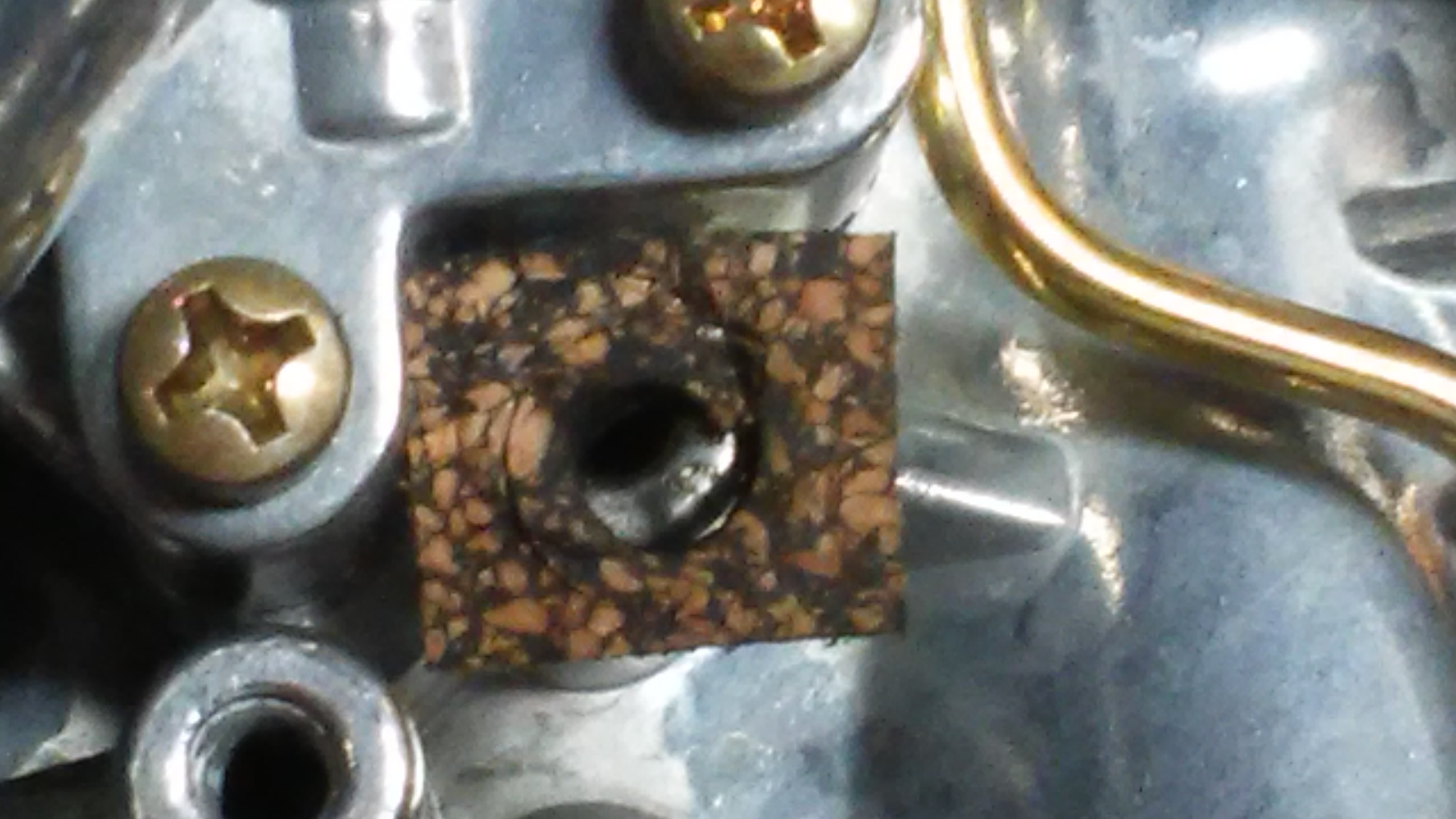

In replacing the manual choke on the carb to be returned, a vacuum leak is evident in the gasket on the choke vacuum port. Blueprint tech guys thought maybe there was a vacuum leak. I blocked off all the vacuum hoses with no change. Didn't think about the vacuum for the choke pull off that's built into the choke housing till a week or so ago. While swapping the manual choke back on, I looked for evidence of a leak and there it was. Notice the dark path on the port.
I don't remember replacing the cork gasket when the electric choke kit was installed so it may have come that way from the factory. Or, maybe I did replace it and cause the vacuum leak. A new cork gasket is still there in the parts left over after the electric choke kit was installed so maybe that's the original gasket.
Looks like the square cork gasket has to be trimmed to fit over the port. I won't be installing the electric choke on the new carb with it on the engine. Its too hard to see what's going on.

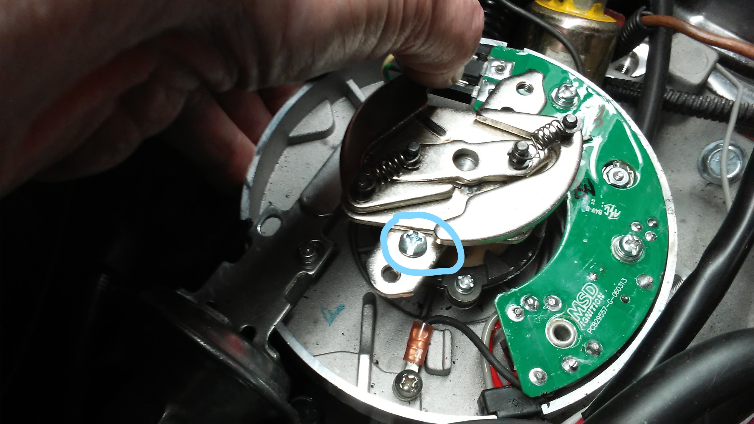

Cheap Bastage Qualification??
This might get me admitted to the Cheap Bastages club it if works. Need to limit the mechanical advance to keep total in check with as much initial as the 383 seems to need. A 10-32 screw fits nicely in the holes on the plate and limits the weight travel. One side of the screw head is ground down to the diameter of the thread and a cam shape goes around to the original diameter on the opposite side of the screw head to provide for adjustments. A nut under the plate secures the stop cam. There's room for a lock nut on the screw that will be added when adjustment is final. Some clearancing of the rotor may be required to fit over the screw head.
First try will have the stop set for maximum travel.
Tomorrow, when the neighborhood is at work and school, I'll see what that does for total advance.

Clearanced the rotor for the new stop screw.
Initial timing was only set at 9* BTDC and total was 30* with the new stop screw set to allow new max advance. Moved initial to 11* BTDC and total was 32*. Close enough for government work.

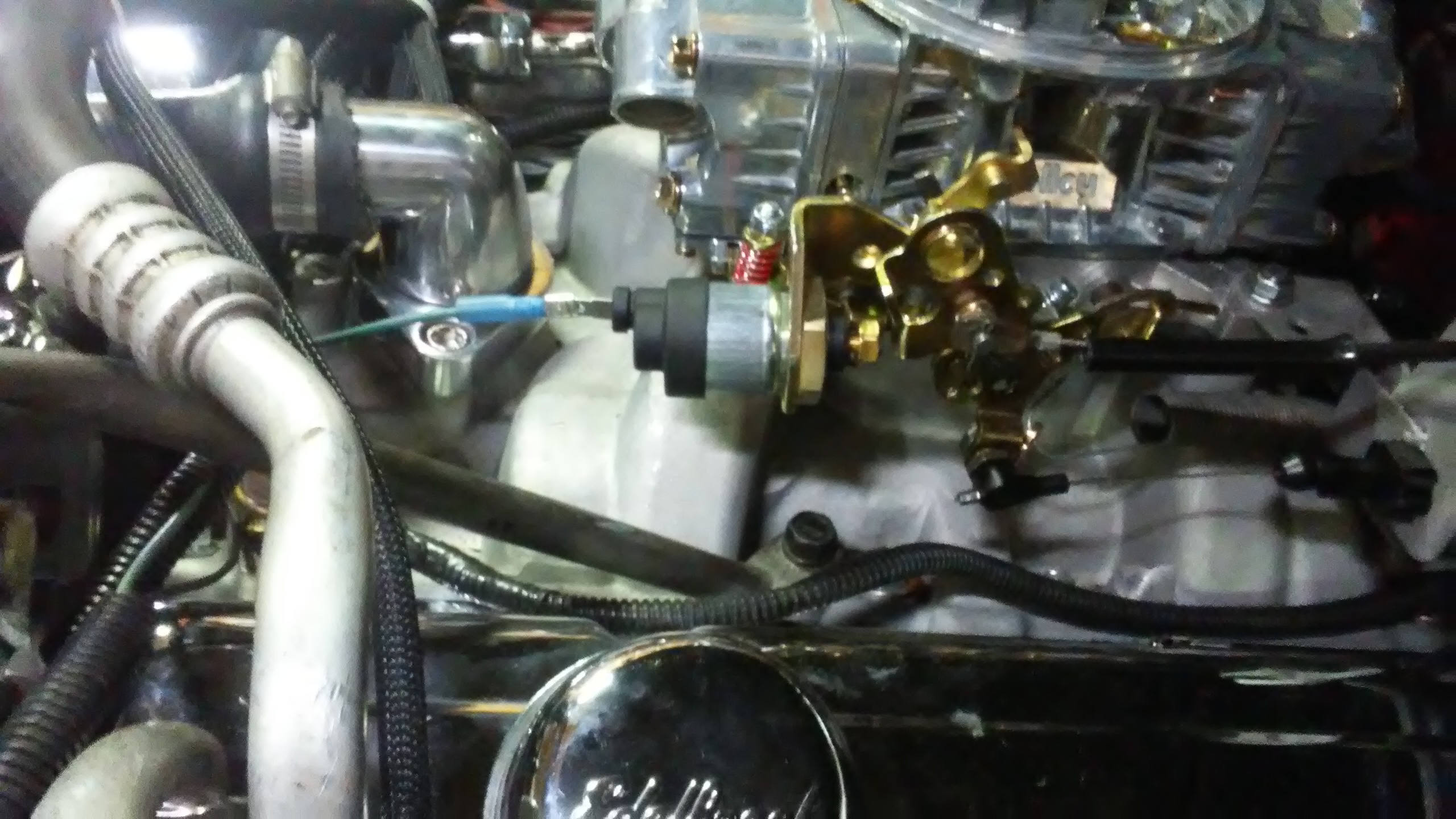

Got the Holley AC idle solenoid but when I tried to put it in it's place, the upper radiator hose was in the way. I never liked that hose anyway. It runs sideways from the thermostat housing over the valve cover, squeezed in between the AC compressor and the oil fill cap.
Before:
A guy on the El Camino forum suggested a hose ("It is an upper hose for a 1990 Suburban 1500. Carquest E71973") that goes forward from the thermostat housing. Fortunately, I already had a swivel housing to point the hose forward.
After:
That picture shows the hose before about 8" was cut off the engine end to make it work.
With the new radiator hose, the AC idle solenoid goes on.
The solenoid was adjusted so, idling in gear, no RPMs are lost when the AC cycles.
