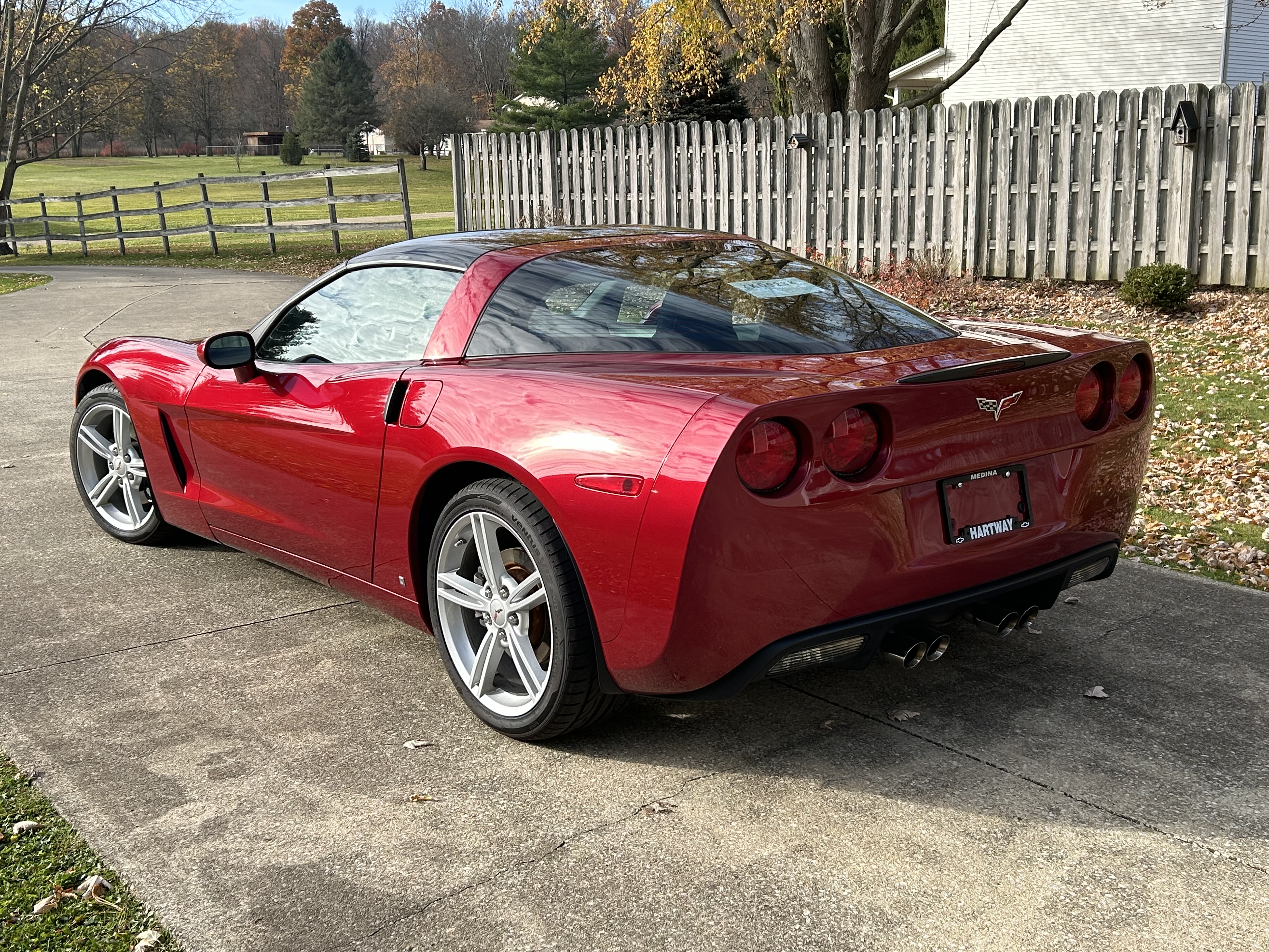

I filled the tank the other day. I was able to get
22.5 mpg on my first tankful, which was mostly freeway driving. Also to be noted is the fact that premium fuel is recommended. Here are a couple more pics before winter sets in.

That's hot.
Re: 2008 Corvette Coupe
Really sweet, a car that makes you look and feel just a little younger, just sayin' !!!
Posts: 2648
Agreed, that is super cool! Looking forward to seeing it in person!

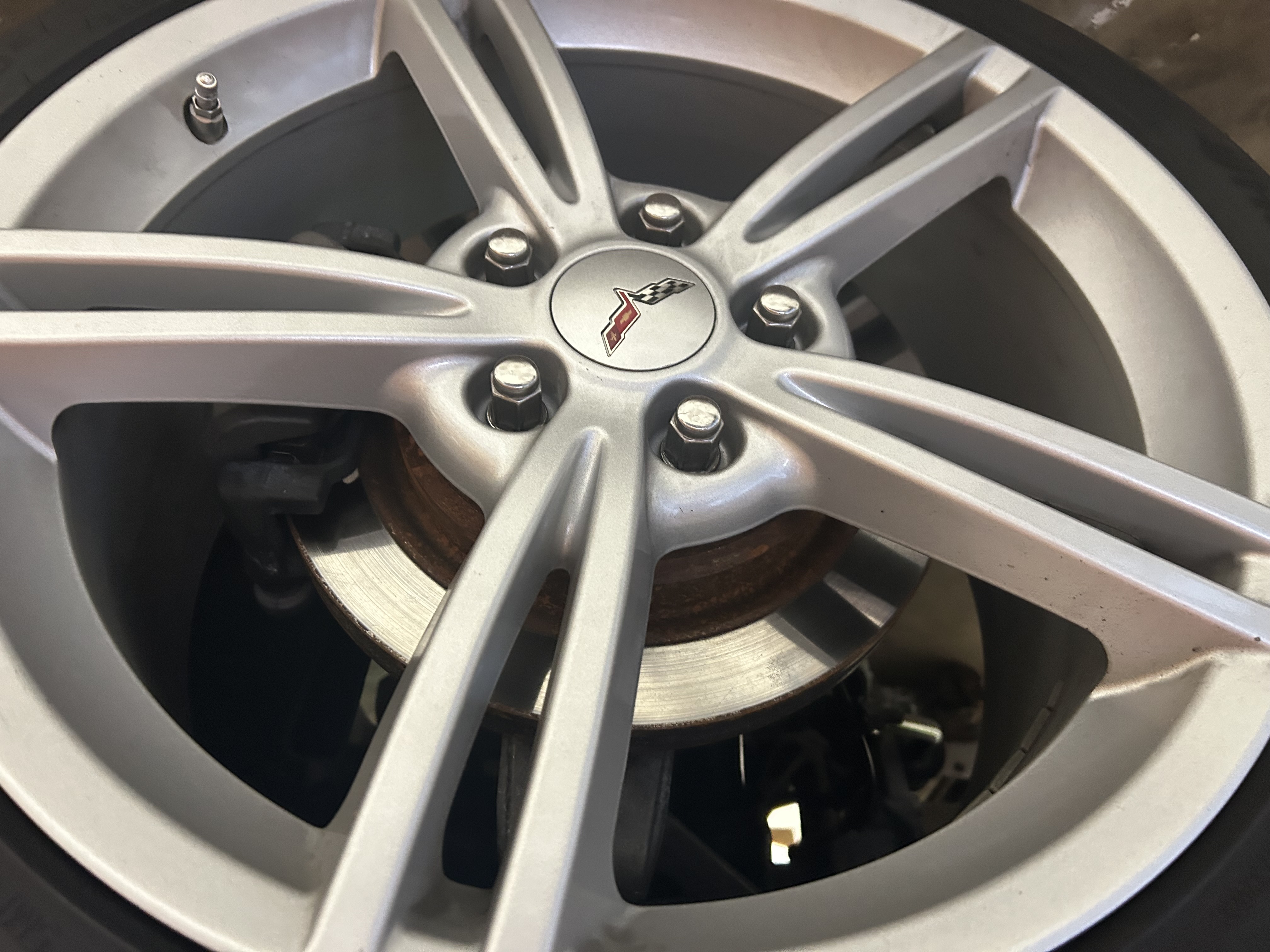

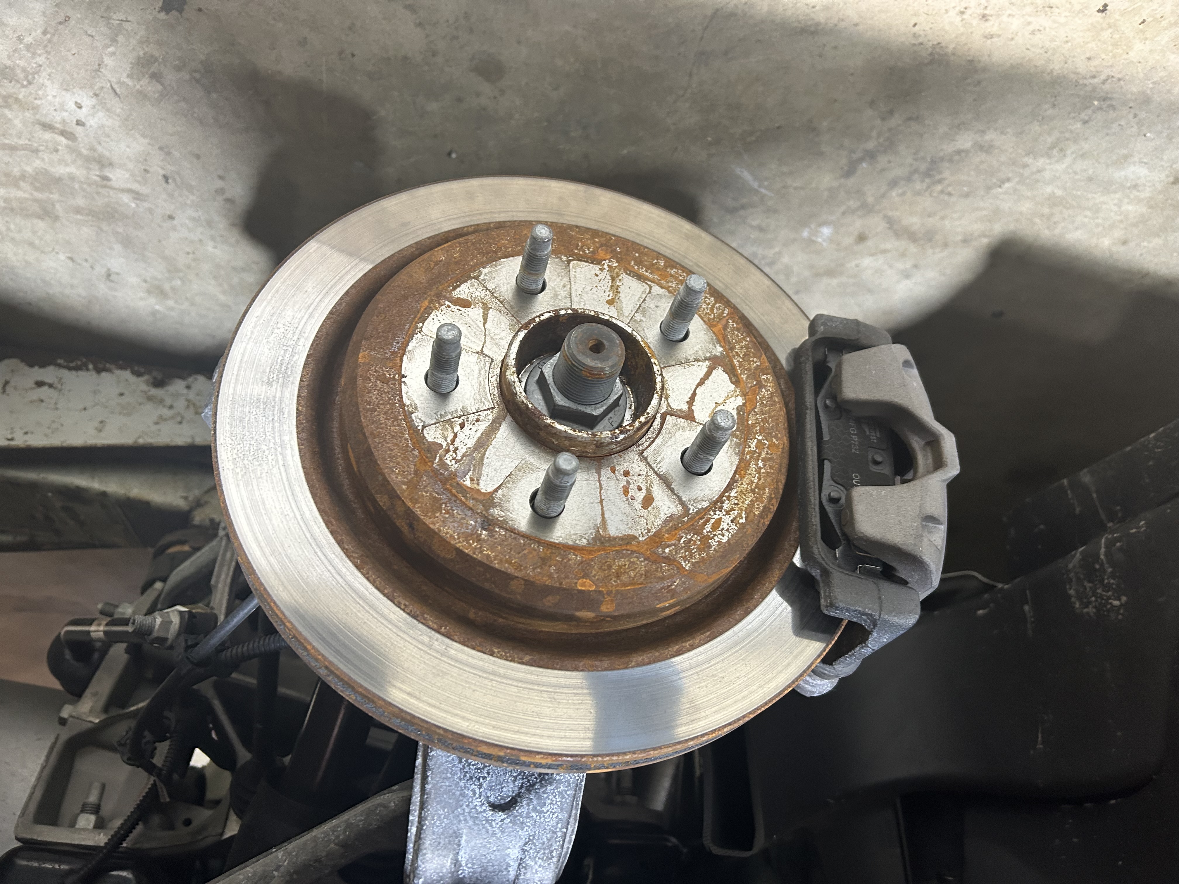

38,040 ….. I did this project about a week ago but have been a bit lazy about posting it. It really wasn’t a hard project, but one that needed to be done. Before I got the car, the dealer had new brakes and tires installed on it. They used uncoated rear rotors, so they were all rusty. I painted them to give it a cleaner look. The good news is that the brake disassembly was pretty easy with no special tools required. The whole project took a couple of hours. I let the paint dry over a full day so the wheels won’t get bonded to the rotors by the paint. The color match wasn’t 100%, but because the fronts and rears are so far apart, you can’t tell….. and a bit of brake dust will help the cause out as well. I have driven it between the raindrops, but weather is getting better, so that will change. This is a super comfortable and enjoyable car to drive! Also to note is how CLEAN this car is… the first couple of pics show the frame and suspension components…. There’s minimal dirt under this car… the frame still shines like new!

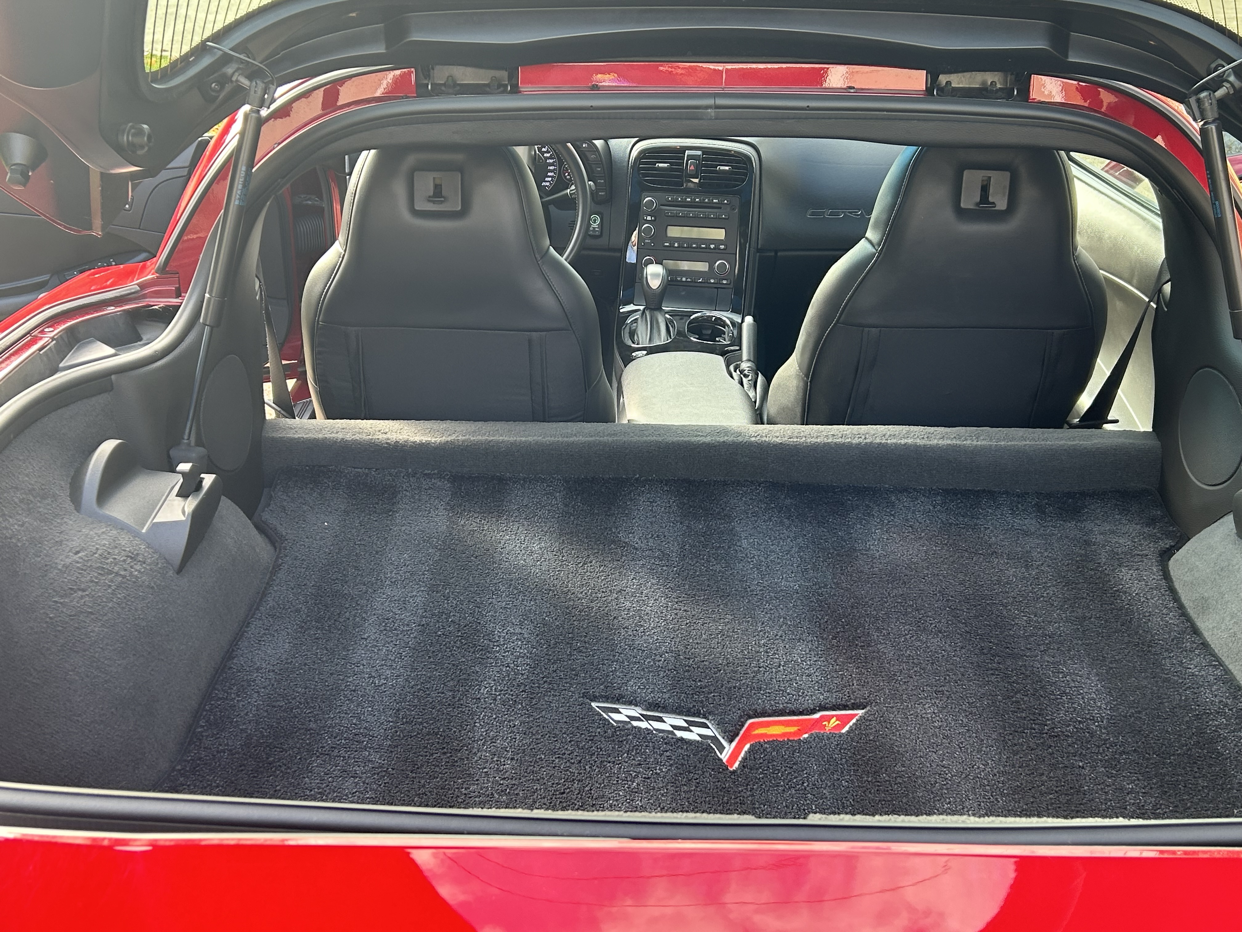

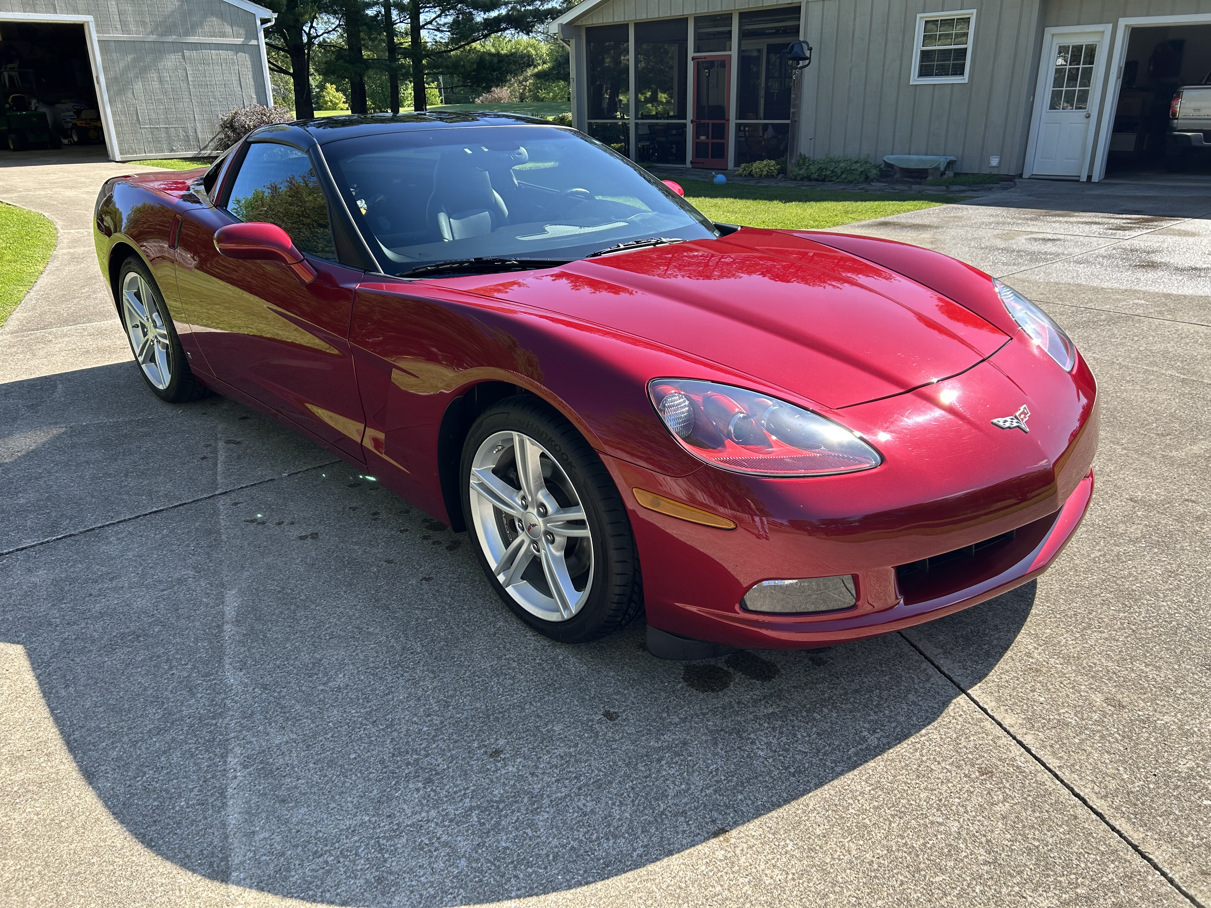

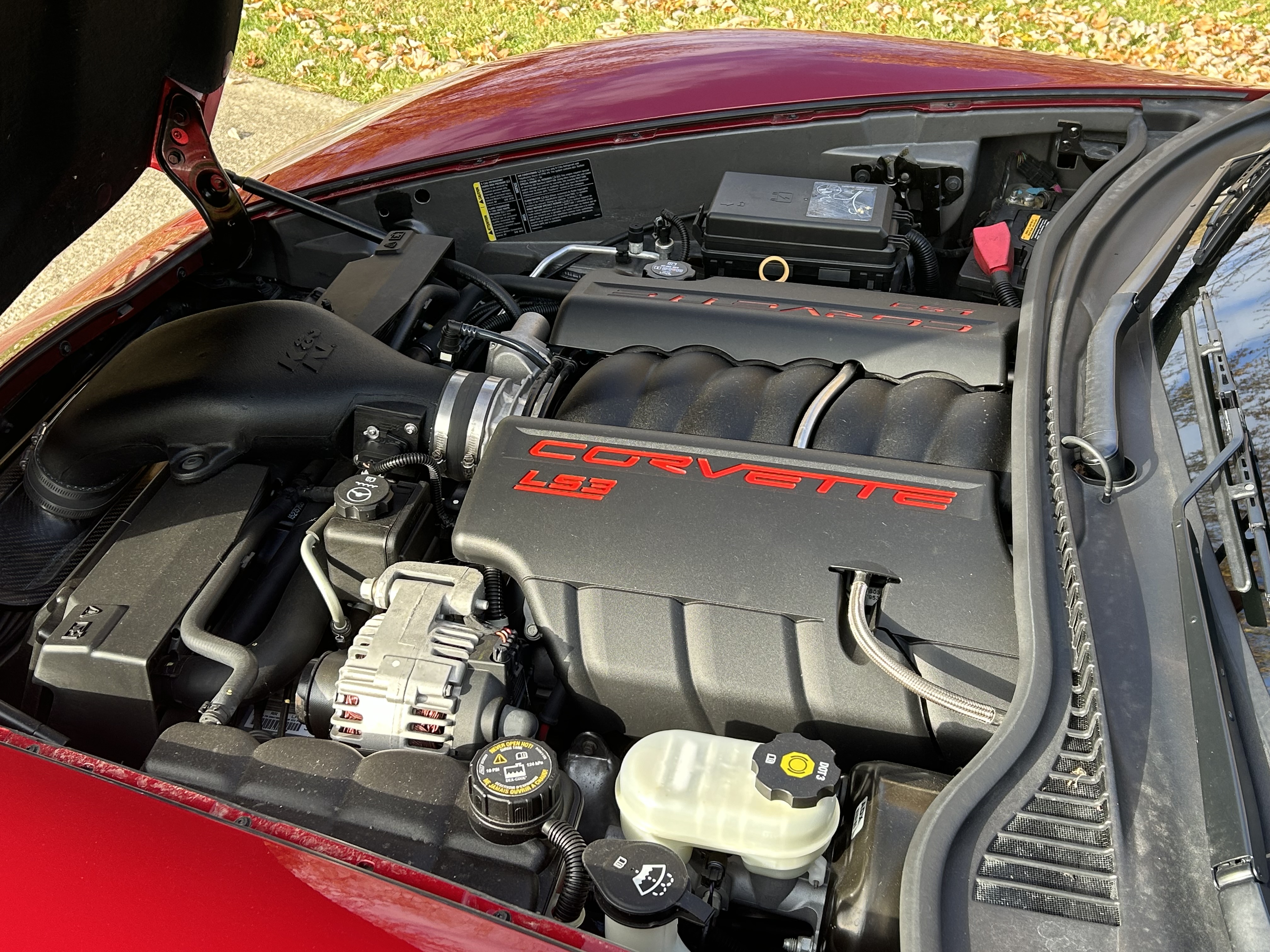

38,516 …I’ve only managed to put a little over 1,000 miles on this car. With as horrible as the weather has been since I’ve owned it, it’s not hard to believe. I did do a small project a few weeks back that I didn’t post about - the rear hatch button didn’t work when I got it. It took about an hour to remove it, clean it, and reinstall it. ( You have to remove the inner right tail light to do it, but it was easy. ) After a ride with GMAmy last night, I decided to give the car its first bath today. This car looks good dirty, but looks SO good when clean. After a small interior detail and wipe down, I checked the oil. The oil is crystal clear with about 80% life left, and right up to the fill mark. I’ve had the top out on one of my rides and it felt very much like a convertible. I’m not a huge fan of having to store the top in the back of the car, but there’s not much I can do about that. For now, the car has done what I wanted it to do - be there for me when I’m ready to drive it. May it continue that way! Happy official start to the summer of 2025!

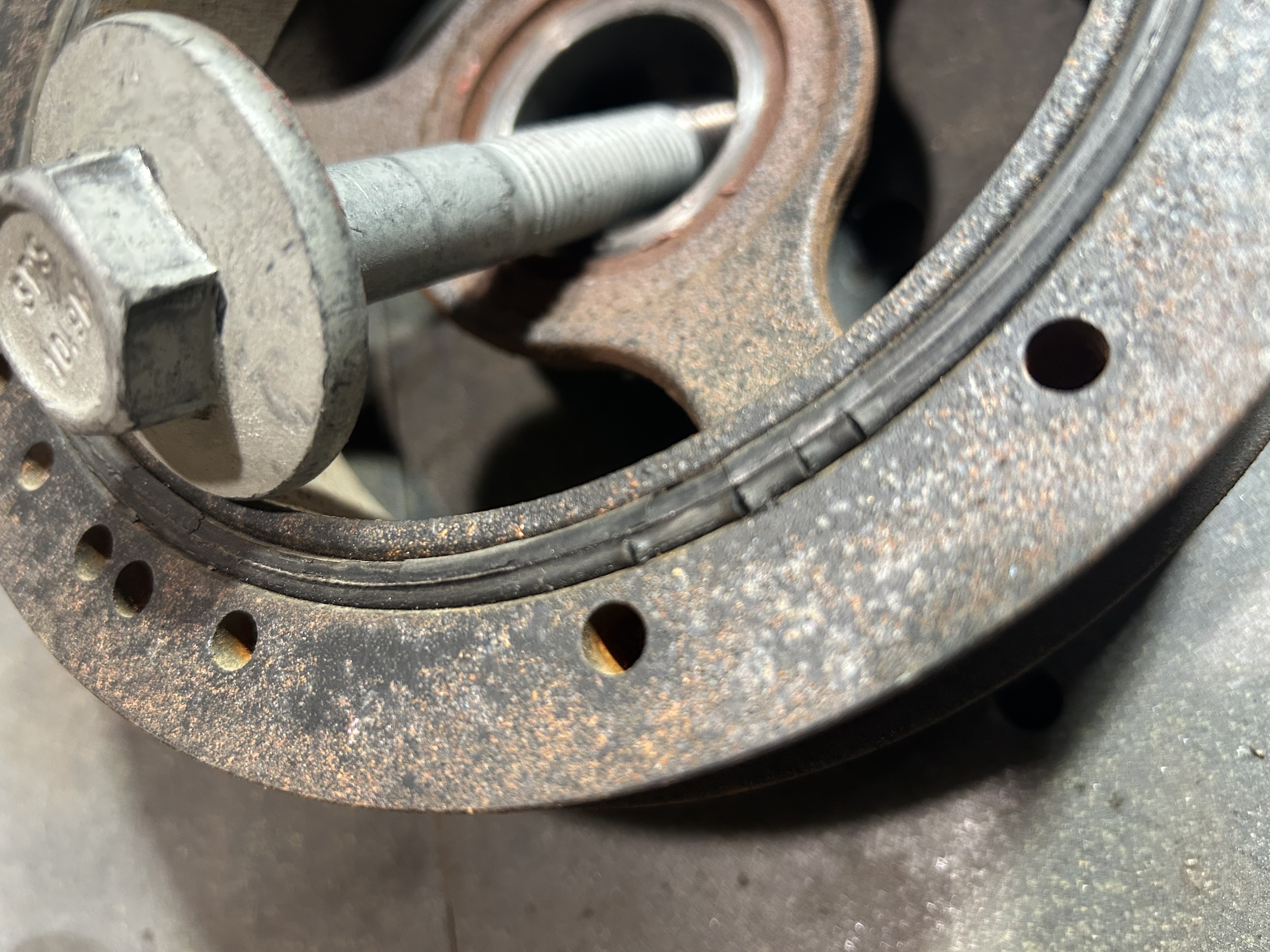

38,628 … So, the C6 Corvettes have many issues that are well known. Let’s face it, this car is already 17 years old! One of the well known issues is the harmonic damper failure. My car still had the factory damper on it (still in good shape and not wobbling) but, I opted to get it replaced as a preventative measure. I’ve read about terrible things happening when they fail. In my mind, it was not if it would fail, but when it would fail. I took the car to Hutter’s for the repair. I had an ATI Super Damper installed. Way more race than required, but guaranteed not to fail. Do it once and it’s done. While in the shop, I had them change the shifter cable grommets (they dry rot and fail, leaving you stuck in park) and they zip tied back the park pall (the solenoid fails and leaves you stuck in park). While trying to replace the grommets, they broke the shifter cable plastic clips, so they bought a new cable for me and installed it on the house. These are three of the four major issues with an automatic C6. The last issue is a gas smell that comes from a failing cross-over tube for the fuel tanks. I’ll wait for that to fail before sending it in for repair. Hutter verified they can do the work, so I’ll send it to them if/when the time comes. They do fantastic work and are very fair. For now, three issues behind me …. Ready for more driving!
