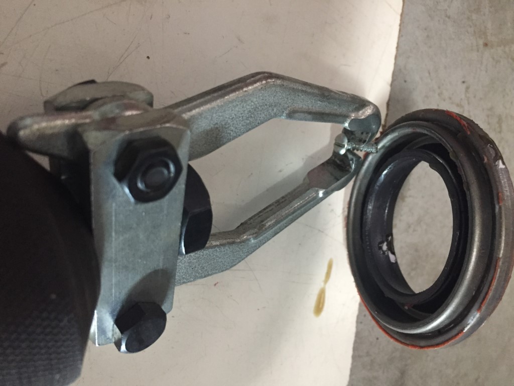

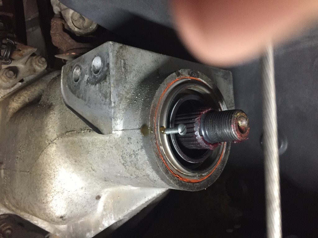

I recently heard about this technique for removing an oil seal, so I tried it. It works great.
- Drill a small hole in the metal part of the seal, drive in a sheet metal screw and jerk out the seal using a slide hammer. The slide hammer is a bit awkward, but it does the job efficiently.
