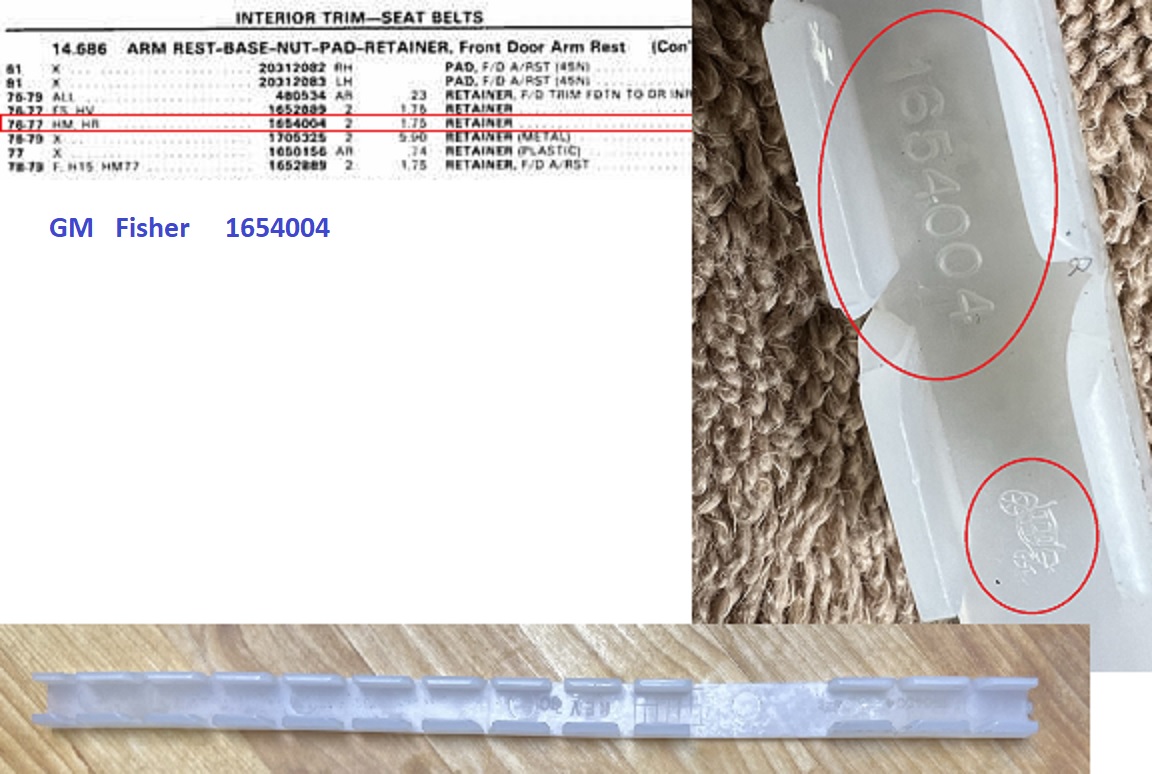

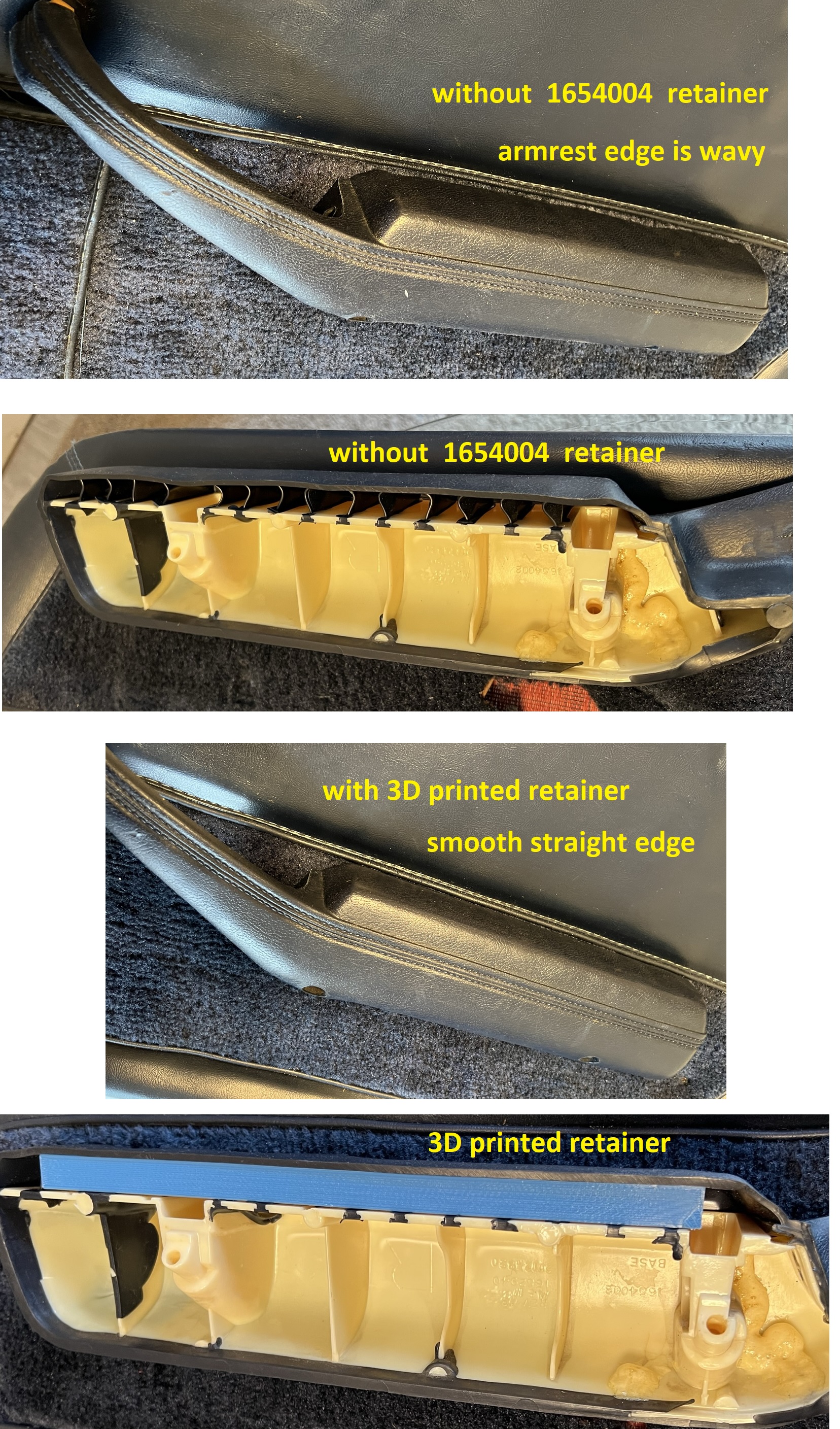

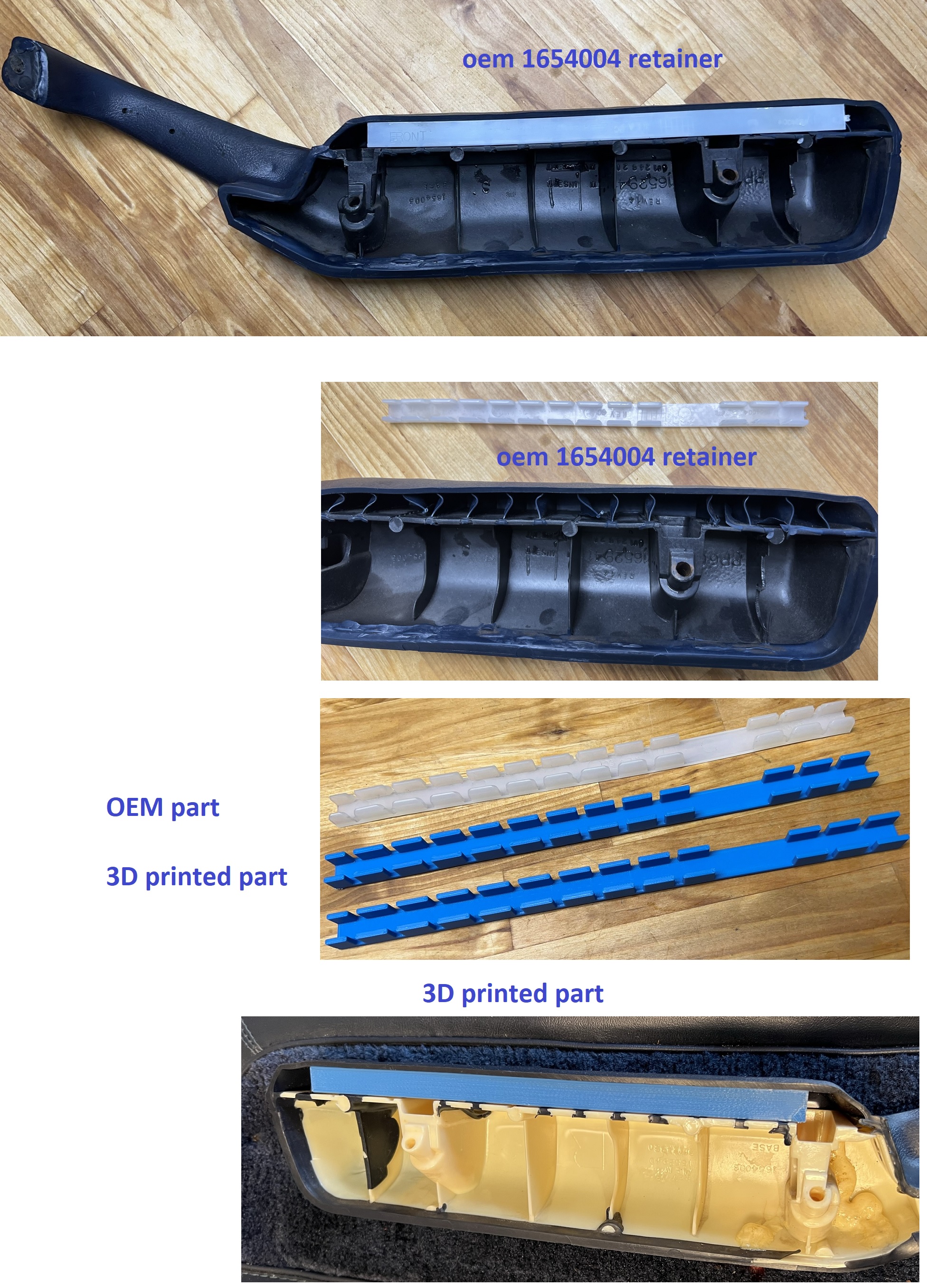

As you may know Alex and I are working on his corvette. In one of the 4 sets of door handles that we have, ONE of them had a GM retainer that virtually NO ONE on the corvette forums has seen before. Attached is screen shot of the corvette manual showing the part number. There are several pictures of the OEM part and the 3D printed part that I measured, drew in CAD and printed on my 3D printer. To me, it makes the edge between the door pull and the door panel so much straighter and crisper. The OEM one is white and the 3D one blue obviously.
I am planning to try and sell some on the Facebook C3 forums. I was thinking $25 plus shipping for 2.
Thoughts ?

Nice. If they sell fast you can raise the price.
Re: C3 corvette interior door retainer set
Good job, Matt. How long does it take to print one of these?

This part is a few hours each.
