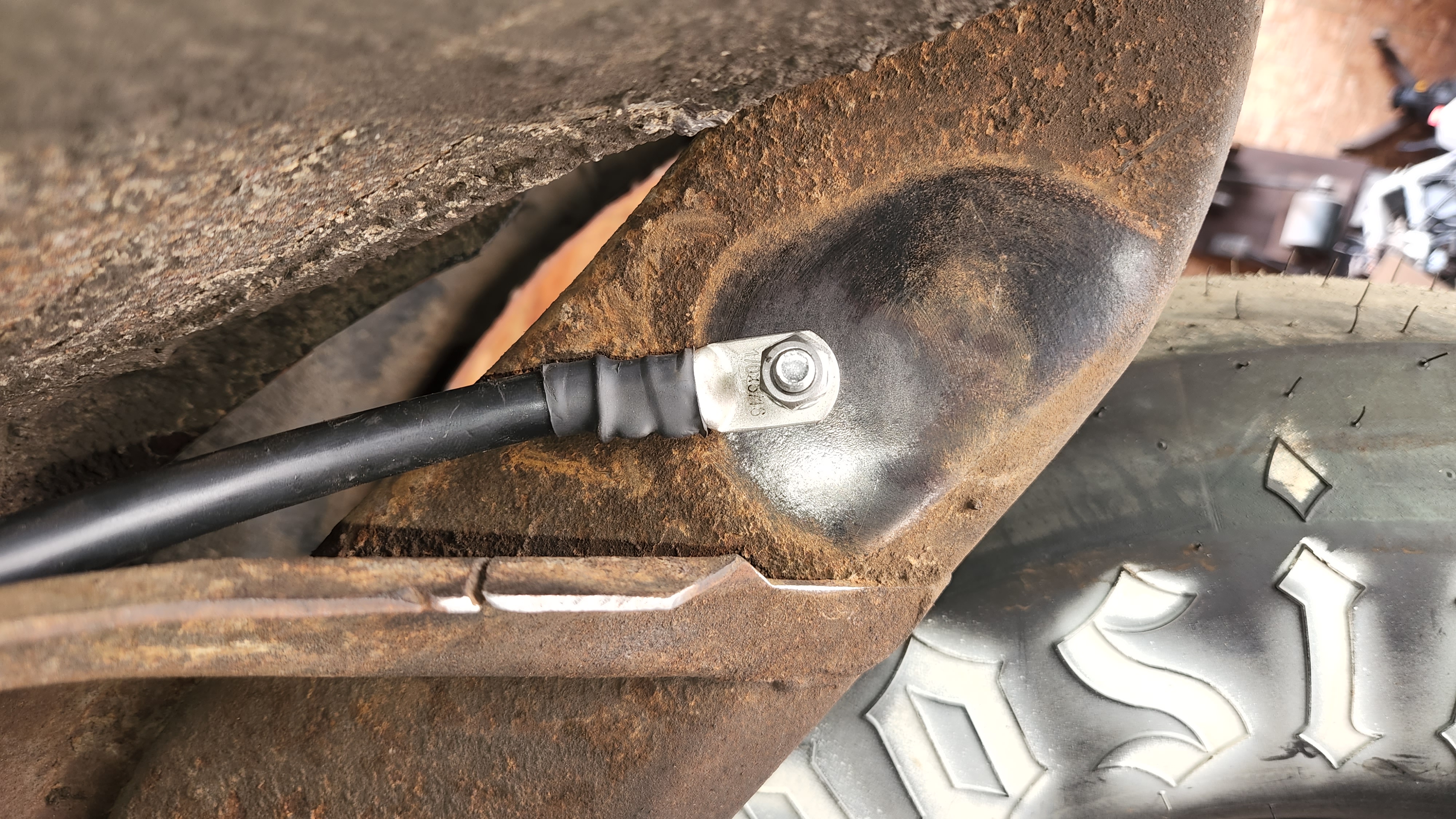

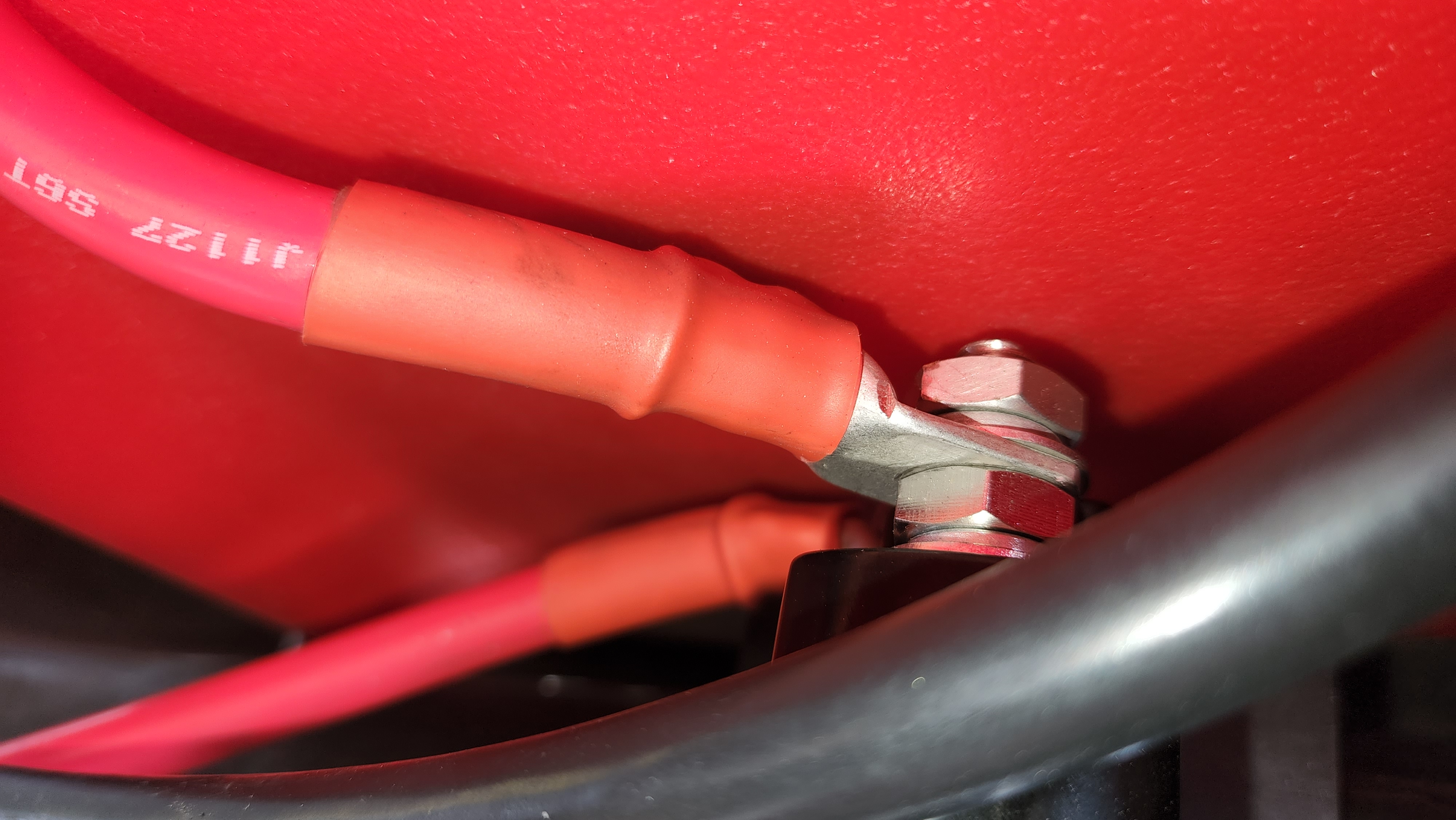

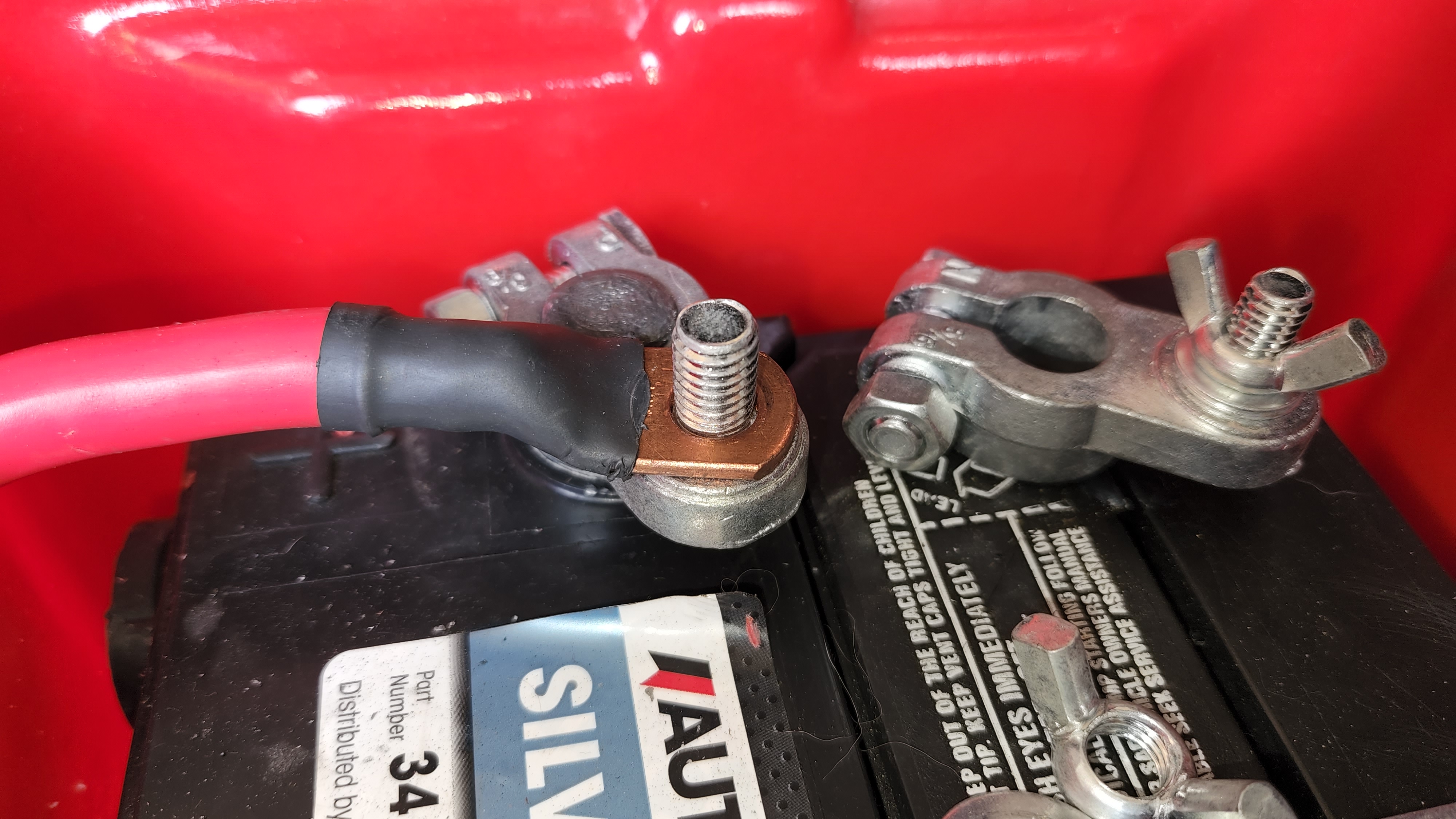

When I did the trunk mount battery in the Maliboost, I knew I would need to cut the cables to my length and put the ends on.
I found this battery cable crimper/cutter on Amazon for $45. https://www.amazon.com/dp/B09811F8ZL?re ... tails&th=1
The Summit kit came with 1/0 cables, so I had to buy a pack of 1/0 ends for another $14, https://www.amazon.com/dp/B08TBTPB9G?re ... tails&th=1 I also bought a couple a Turney's
I'm pretty happy with the results that this thing generates. It takes quite a bit of force to make the crimp -- I usually end up lodging one handle against my workbench or something solid and using both hands on the other handle. It's a hex-crimp and it feels pretty solid. After putting on a small piece of heat-shrink, the results look top notch.
