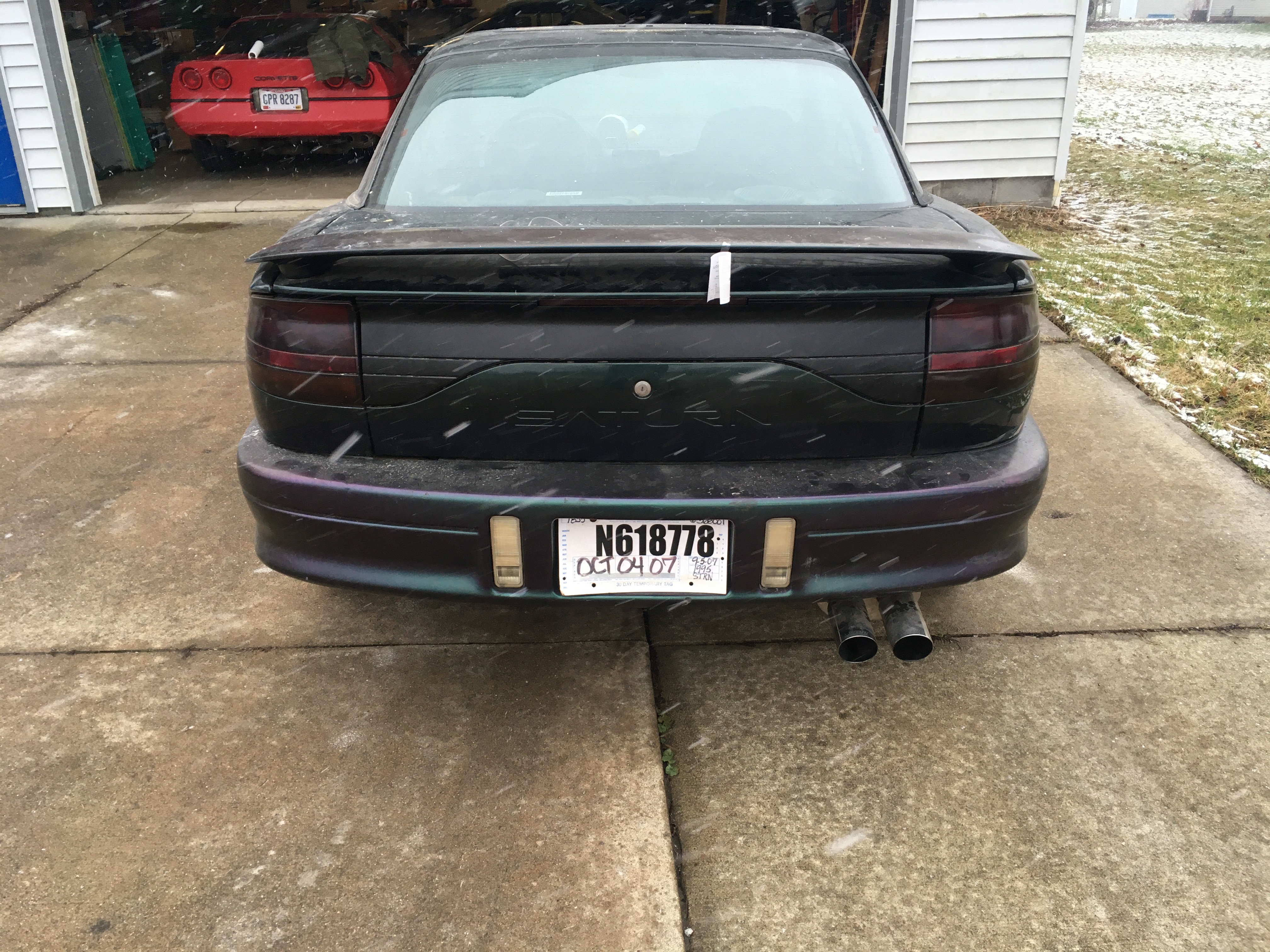

I am not exactly sure how we ended up here. Kurt for some time has been dissatisfied with the Corolla. It's too new and worth too much so he can't really modify it. Couple that with a desire for a carrot to get better grades, Kurt and I started discussing what he might want to drive. We went back and forth talking about several different vehicles, but in the end he chose this.
Its a 95 SC2 5 speed with 84k miles and four wheel disc brakes. We're taking a bit of a chance because we bought it not running. Here are the specifics:
- aftermarket front side markers
- aftermarket header and complete performance exhaust
- MSD ignition coils
- cold air intake
- Eibach lowering springs
- KYB struts
- slotted rotors
- SAFC aftermarket performance chip
- custom gauge cluster
- big tach and shift light
- 17" aftermarket wheels with 30 miles on 13 year old tires
- front sway bar has poly bushings
- this car is very clean underneath. It has a temp tag from 2007 has not been run since then
- the fuel pump is not working. Prior owner tried to fix it but failed he has no fuel pressure
- he had a trickle charger on it for a couple days but it has some problem where it is draining the power
- ebrake cable brackets are missing
- the front bumper cover was replaced after a deer hit
- passenger mirror is beige so presumably replaced also
- lots of little scratches and abrasions on the paint due to sitting in the garage and presumably being a shelf
- has some rattle can translucent purple/green on it
- most of the interior is out of the car including door handles
- missing key lock for driver side door
- no wiper arms
- Prior owner said he ran 15.21 with the car. Seems plausible based on everything I see.

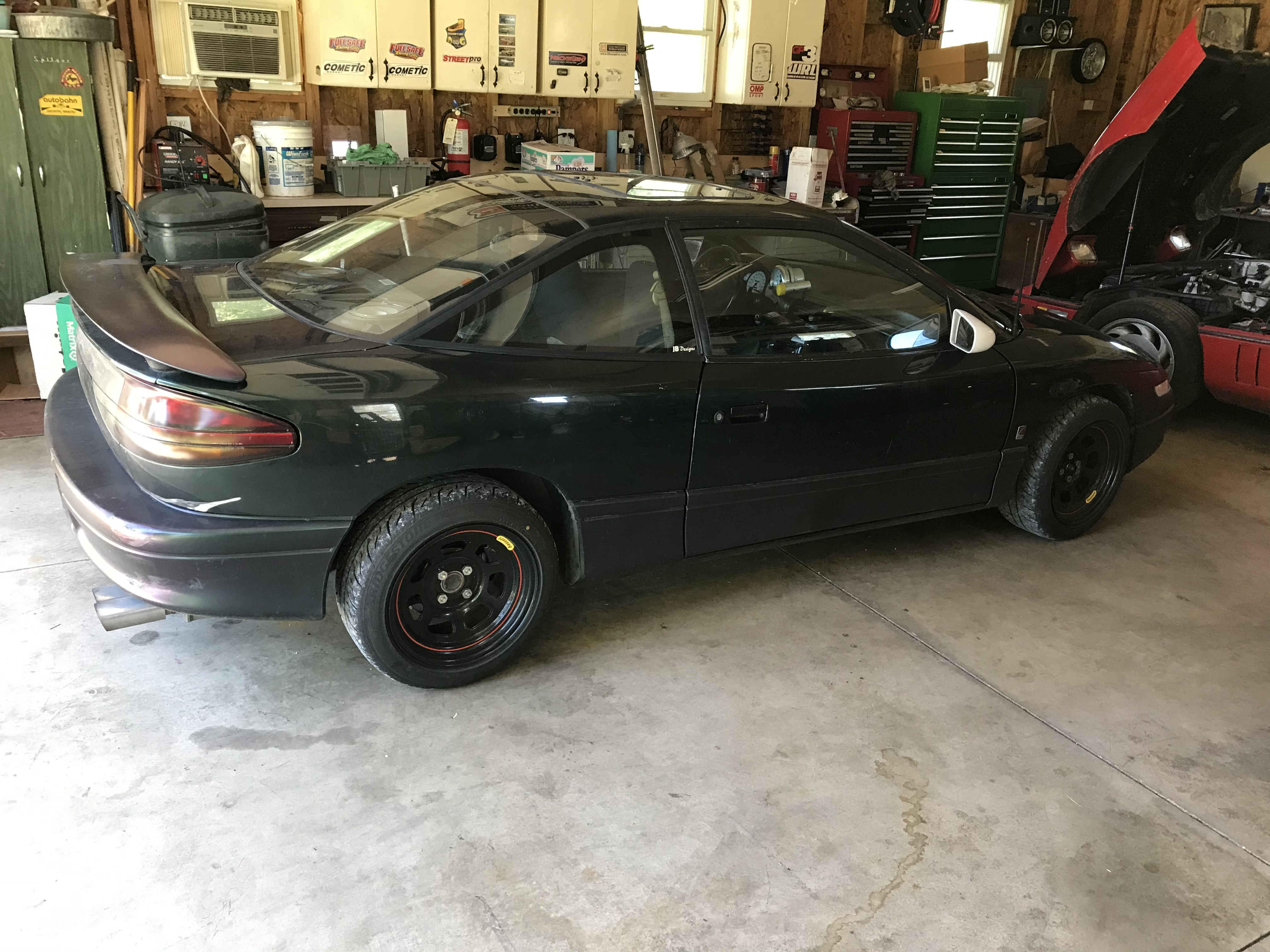

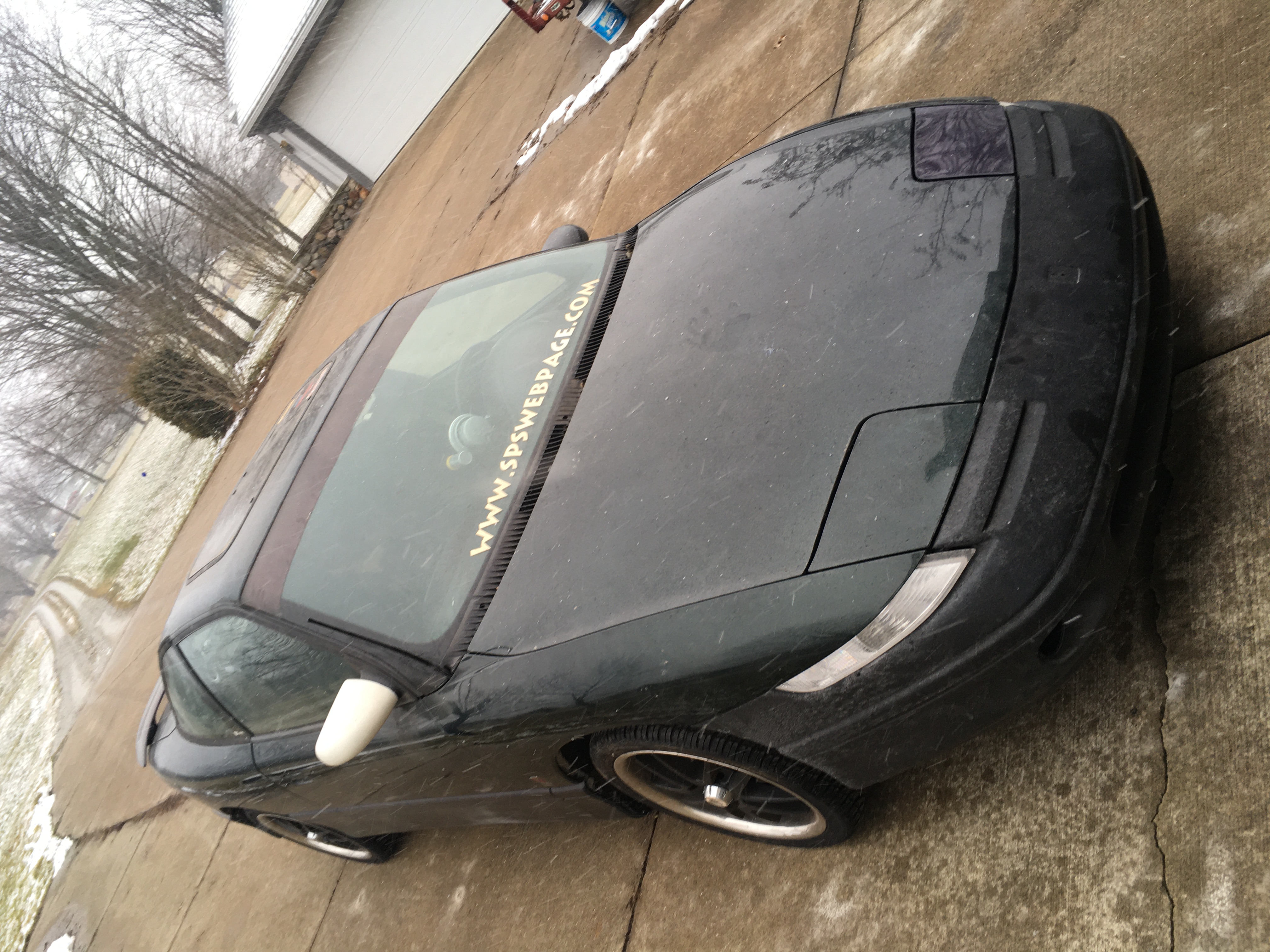

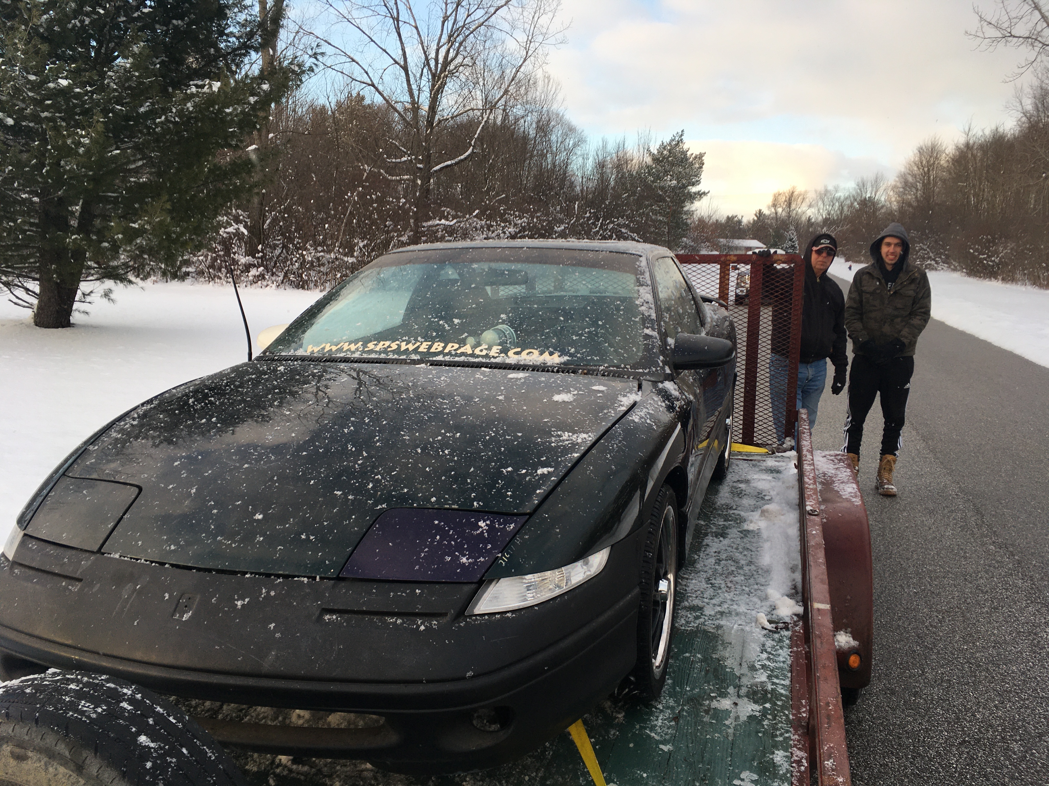

It's been on the internet for sale for a long time. I recall seeing it months ago with a $1200 price tag but apparently not much demand for a 25 year old Saturn that will not run. Most of these parts don't really have value to me but this car is well set up for what Kurt wants to do.

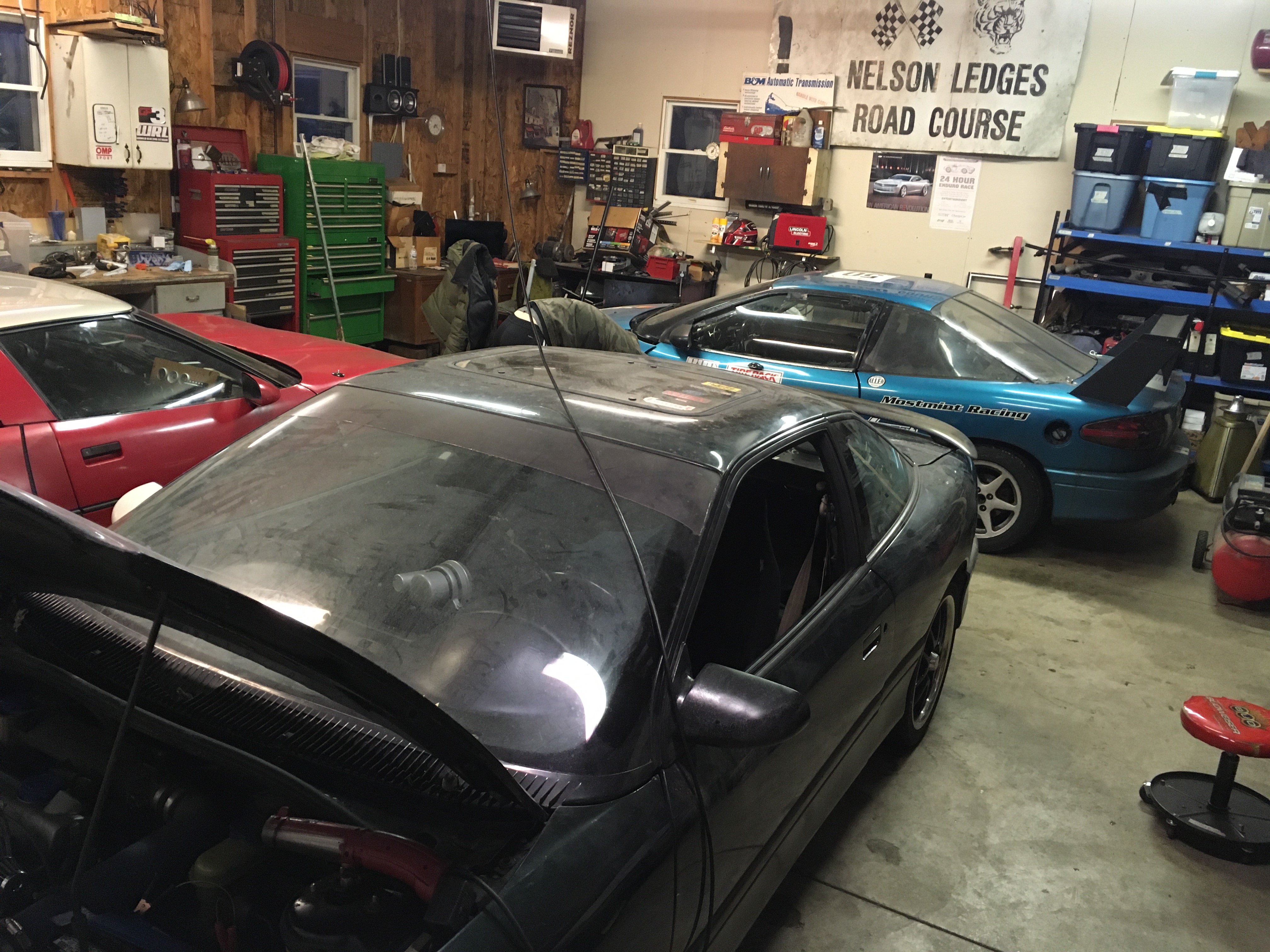

The car in the garage as we first saw it Fred32v offered the services of his new GMC to tow it from the garage which was in the seller's backyard and had no driveway. We used a side street just around the corner to load the car. Rolled off the trailer and into the garage with no major issues These pics are from the ad:

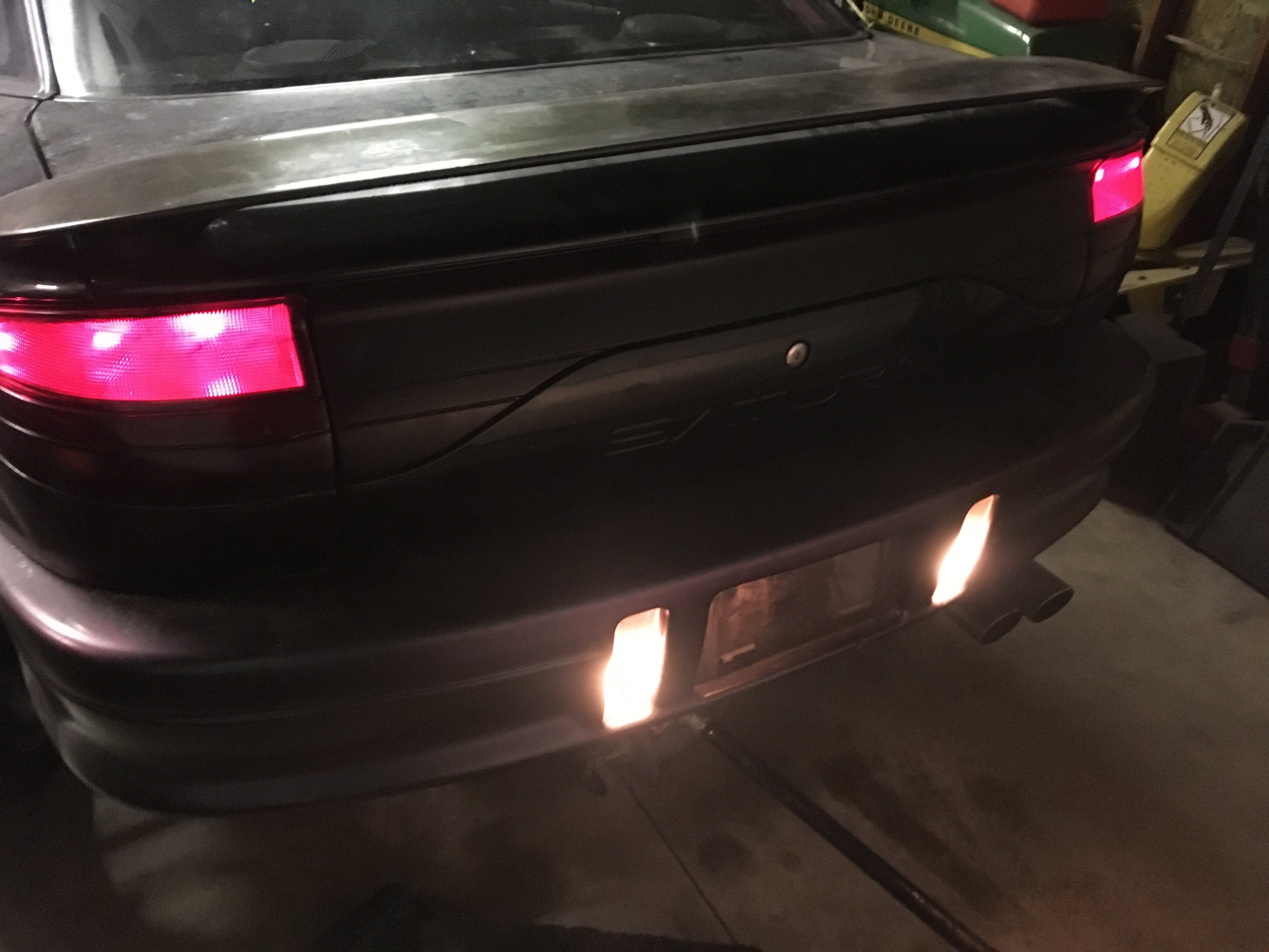

Kurt was over last night we made some progress

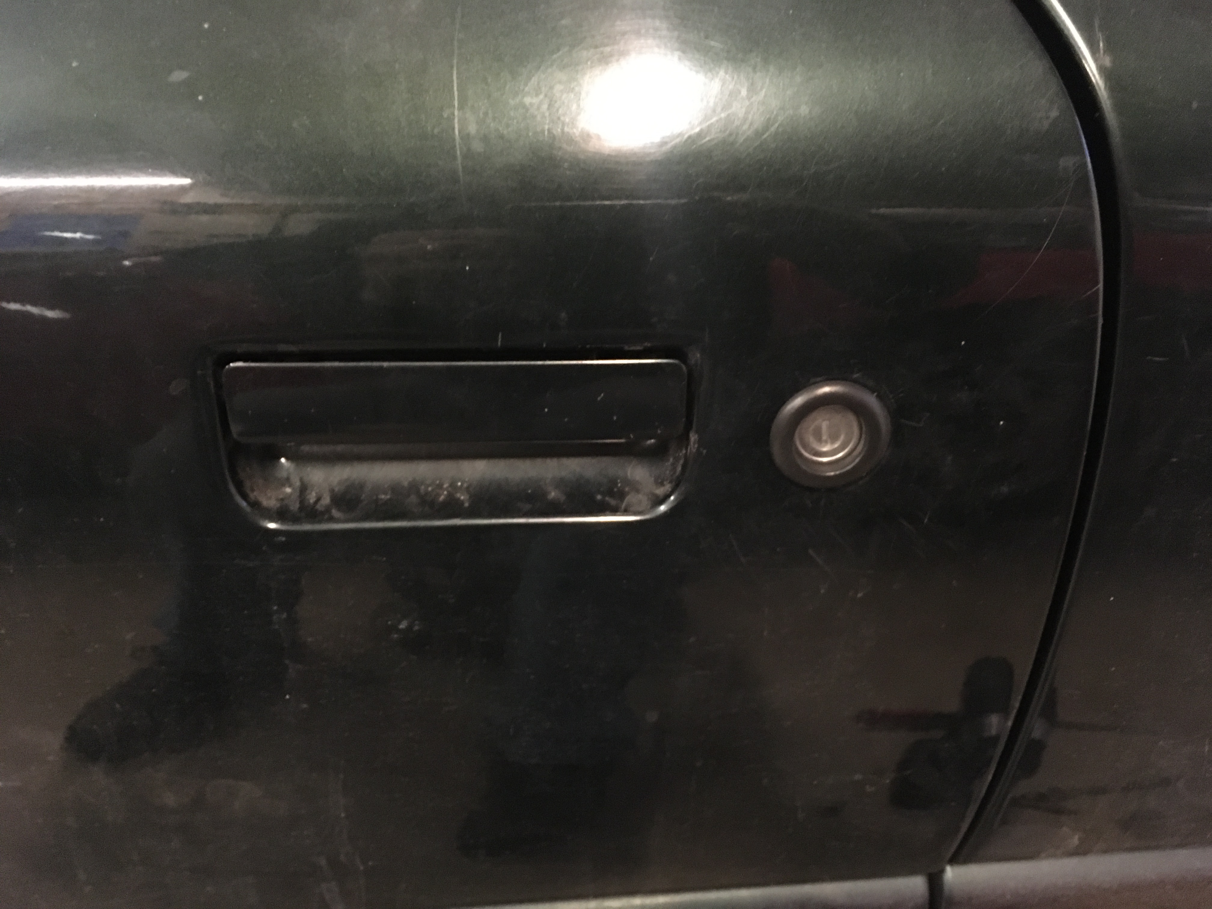

- wiper arms installed
- got the driver side headlight working
- installed the key barrels in the doors
basic checks
- wipers and squirter work
- all the running lights, brake lights and headlights work
- horn works

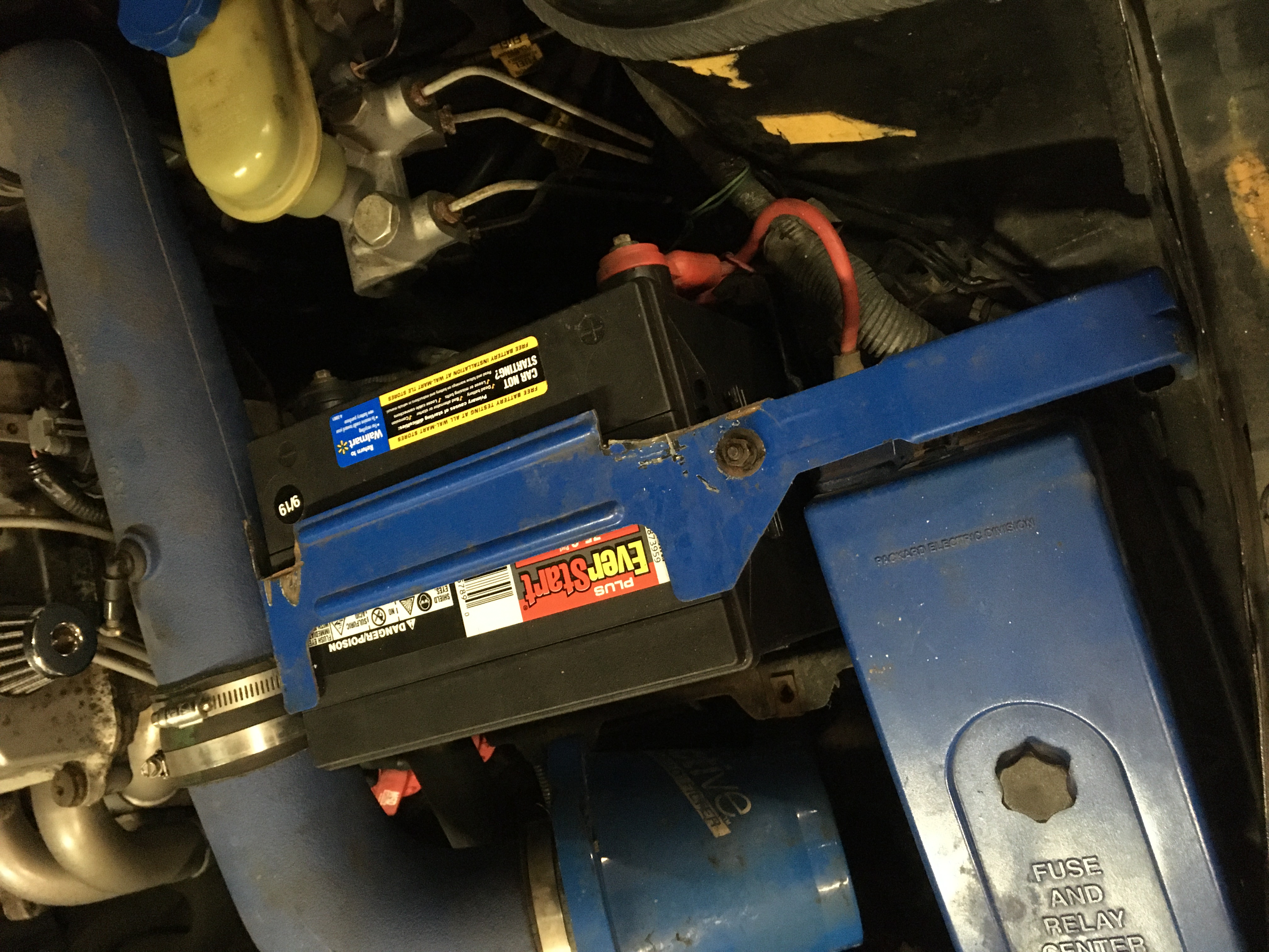

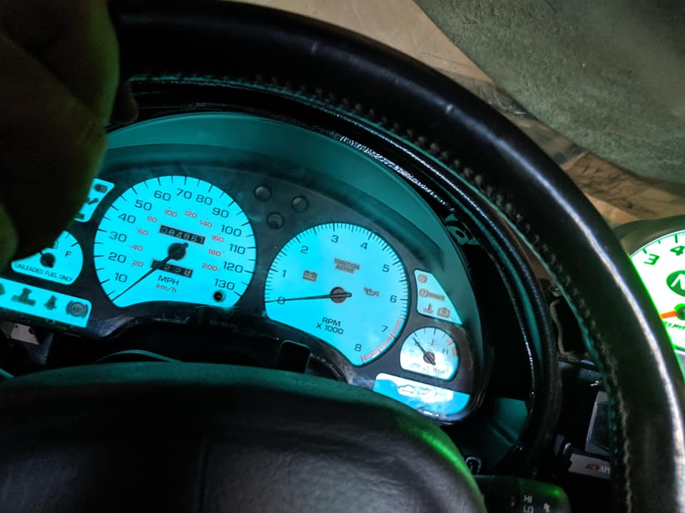

- the gauge cluster was loose - found a couple small bolts to secure it
- the dash lights now work - the dimmer switch was unplugged. installed the bezel that it mounts in
- hooked up the driver door speaker. car has three speakers and aftermarket radio. this might be the best speaker
- switched out the pop up headlight motor on driver side - had one from teal Saturn #2
- switched the pop up headlight cover on driver side. This headlight had been replaced after the car hit a deer, but we got the original cover and it was still good
- the license plate lights were out. Found a bulb from teal #2 and installed it. Could not locate the other so will have to buy one
- extracted the key matching key barrel from the trunk of teal # 2
- install the battery tie down - had to locate some bolts
- tie down the hood release cable
- replace the shifter cable bushing - this broke when I was unloading the car. I had a heavy duty spare for the race car which I installed after Kurt paid for a replacement which is being shipped
- located spare ebrake brackets

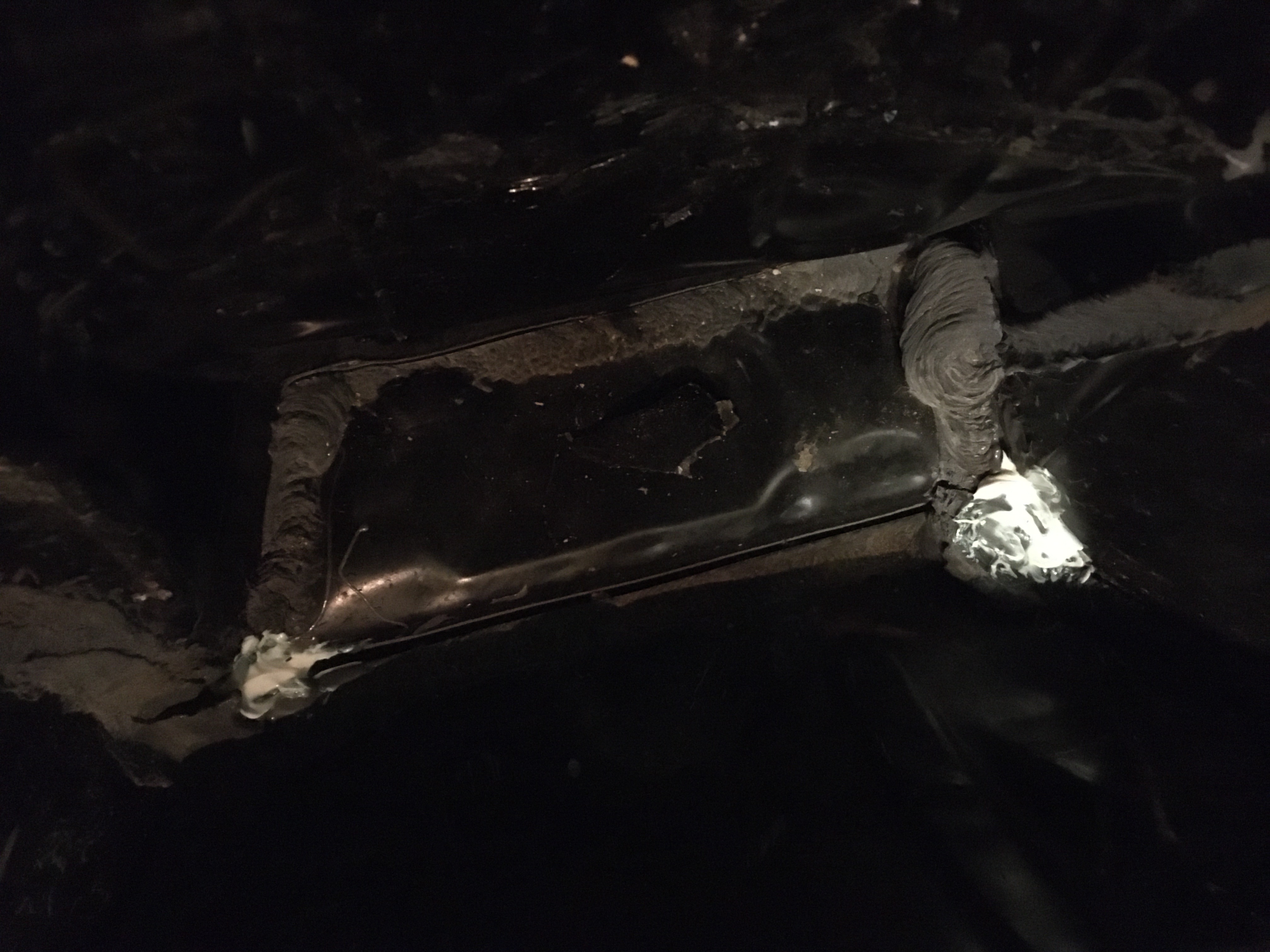

- looks like this car took a little damage to the right rear - which opened air gaps between various panels in the trunk which I caulked up

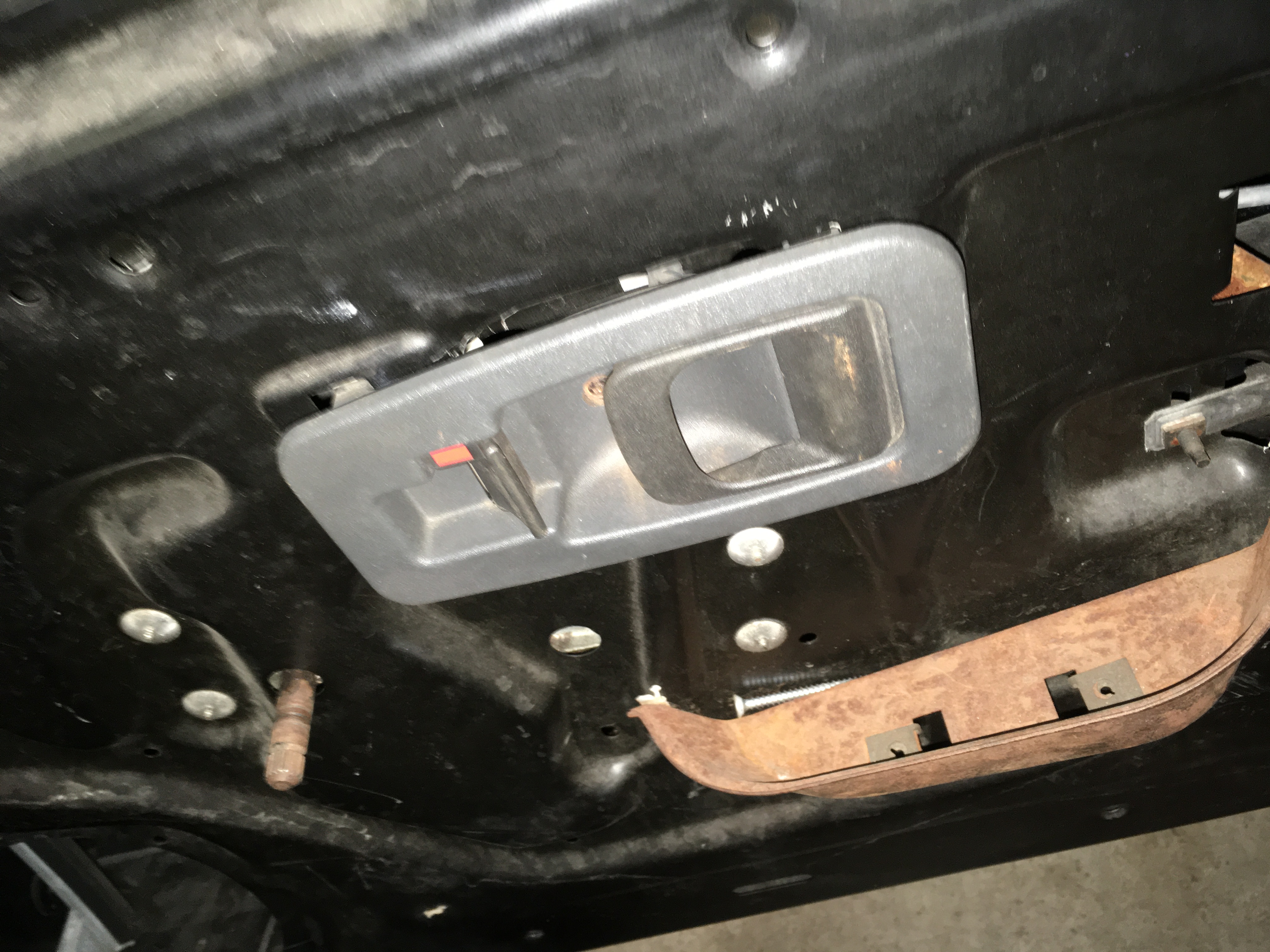

- installed the door levers

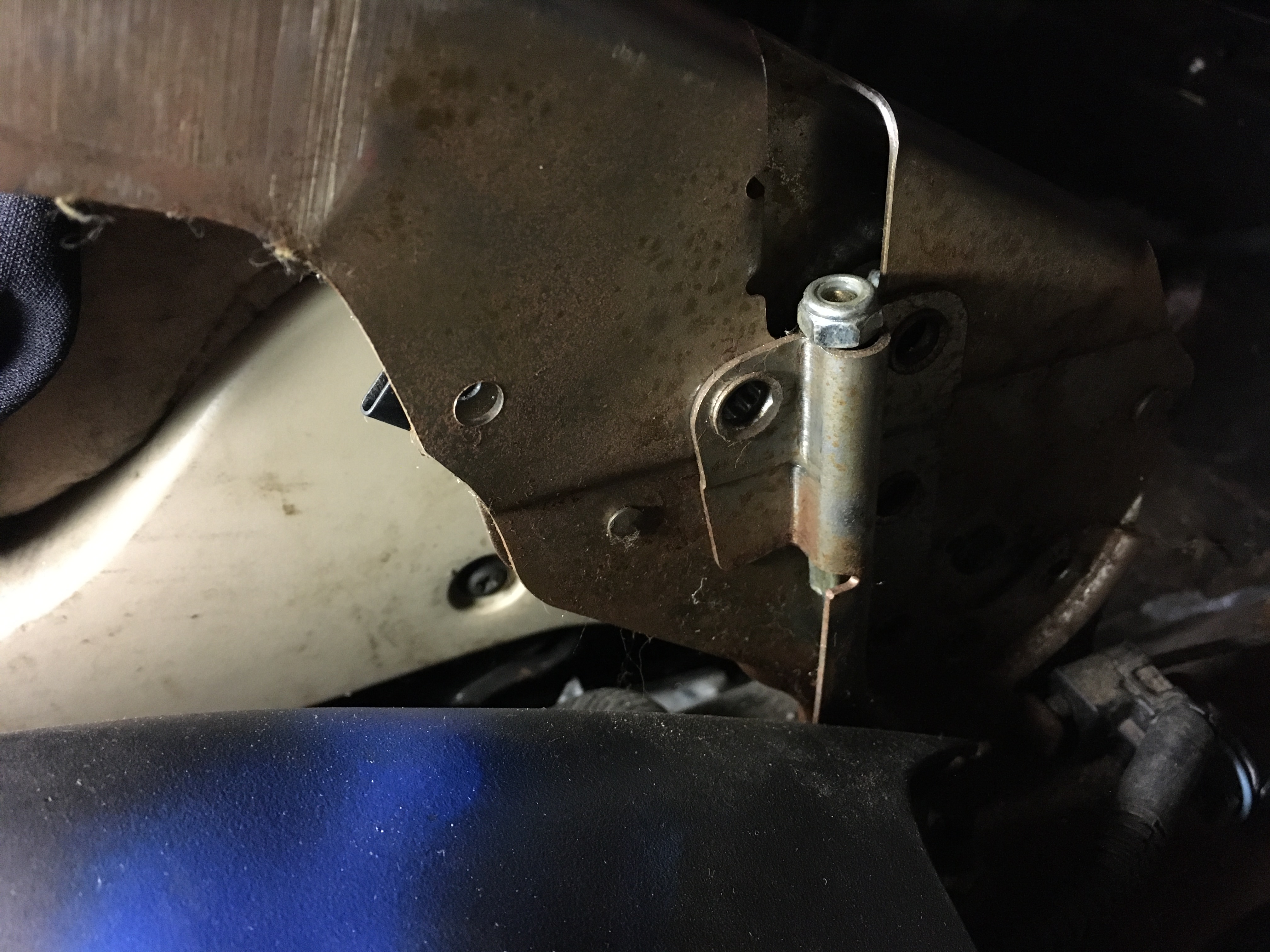

completed since last update:

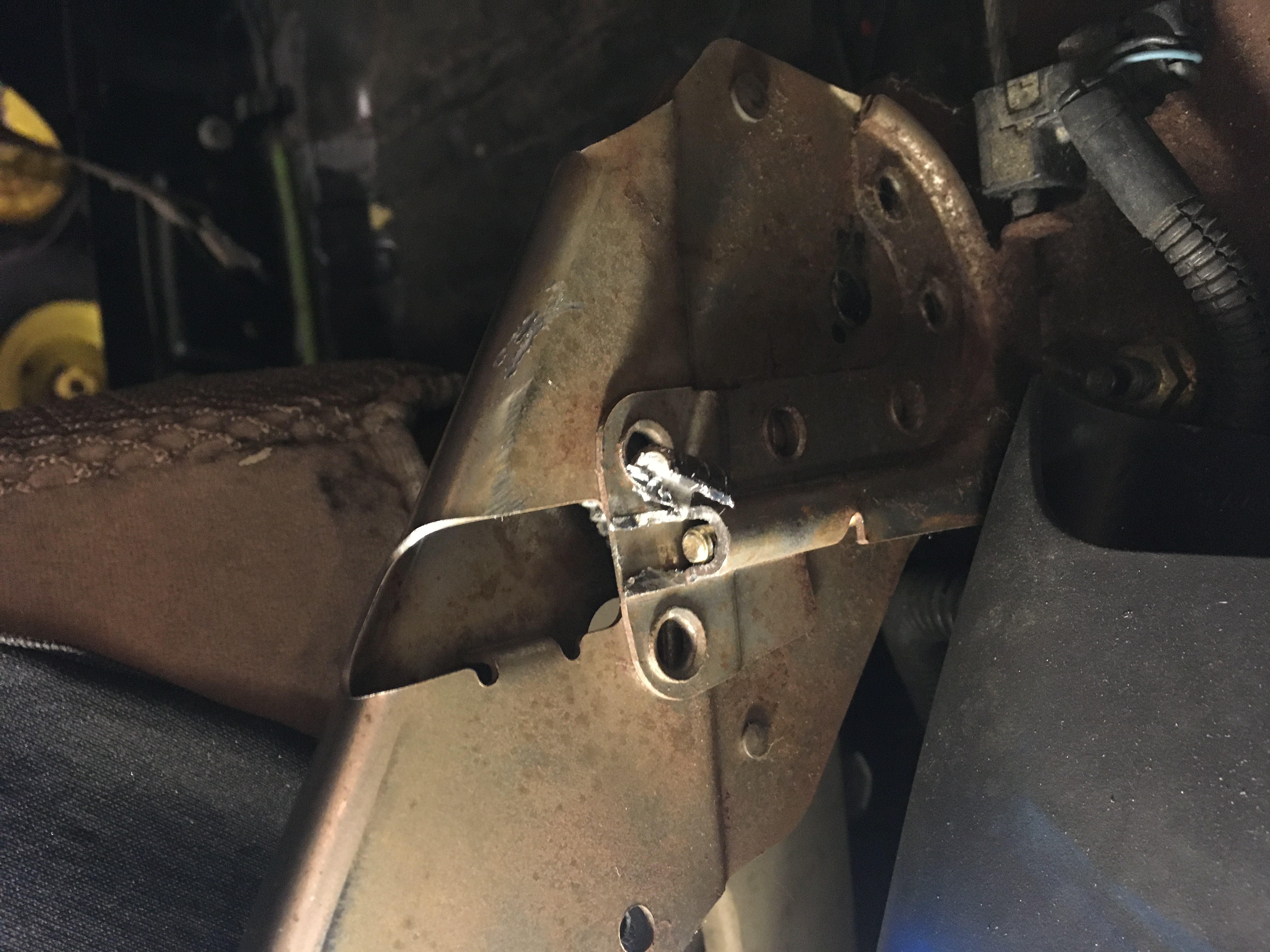

- e-brake brackets installed. The cables were a bit short which required some creative work to fill the gap - adjusted the bracket a bit in the interior and modified the ebrake lever to allow lengthening the travel of the cable from the lever.
- backup lights working. The switch in the transmission had failed. Had one in inventory
- installed the trim around the stereo to keep the thing in place
- installed the trunk key barrel. Before installing I decided I should check it and learned it was frozen up. With PB Blaster and a bit of finesse I got it working.
- ordered temp tags from the BMV. In the days of COVID-19 it takes ordering a temp tag which will not expire until the stay in place orders are lifted + 90 days.
- tied up the ebrake cables and the fuel vent line as they were hanging just a bit under the car
- bolted down the fuse box

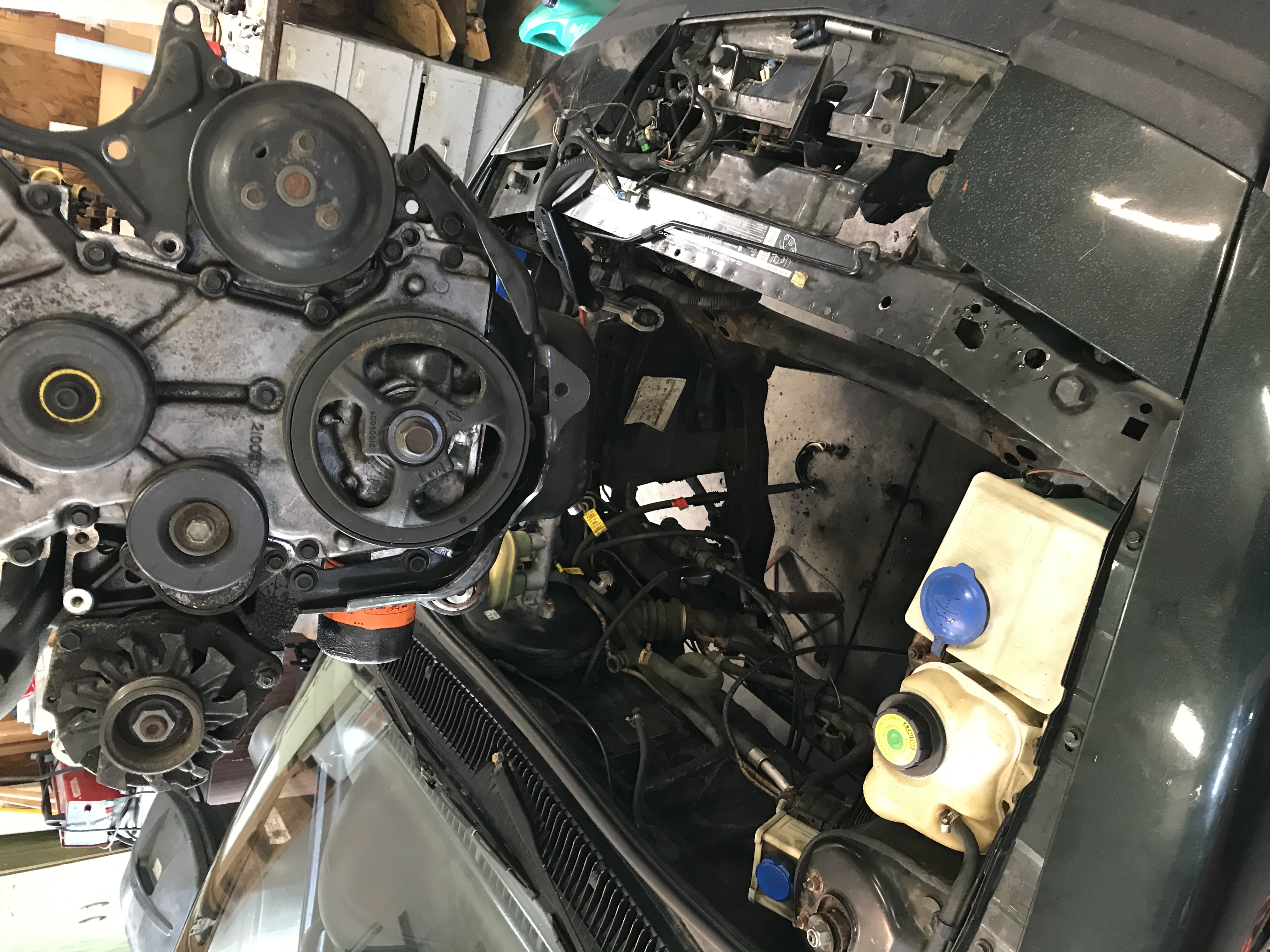

At that low miles the car is still a child. However it is child that has a rod knock. Someone was rodding on it two quarts low and spun a bearing on Monday. It burns a little but been leaking pretty good out the cam cover at the spark plug holes.
Fortunately we have a spare engine in inventory! Had to do some prep work - I previously had the timing chain cover off (also cam cover and oil pan) since I cracked a timing chain cover on the race car removing it. It was a small crack and Kurt welded it up a couple weeks back. So while Kurt did most of the disassembly and removal I went to work cleaning parts - including gasket surfaces - and reassembling the long block. It went into the car today, but not finished yet. Has a good chance to finish assembly tomorrow if Kurt wants it.
Coming apart: Going back in:
