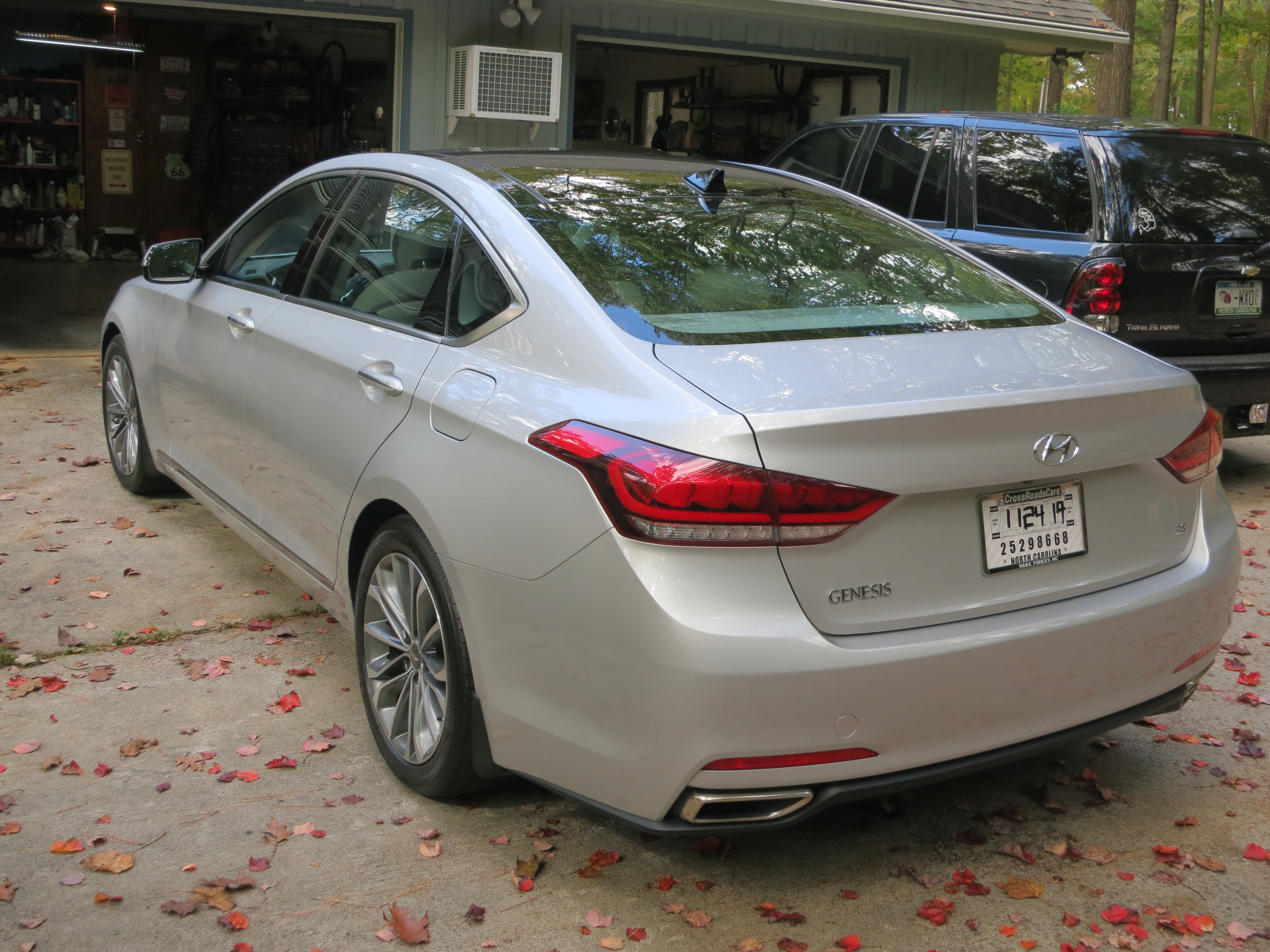

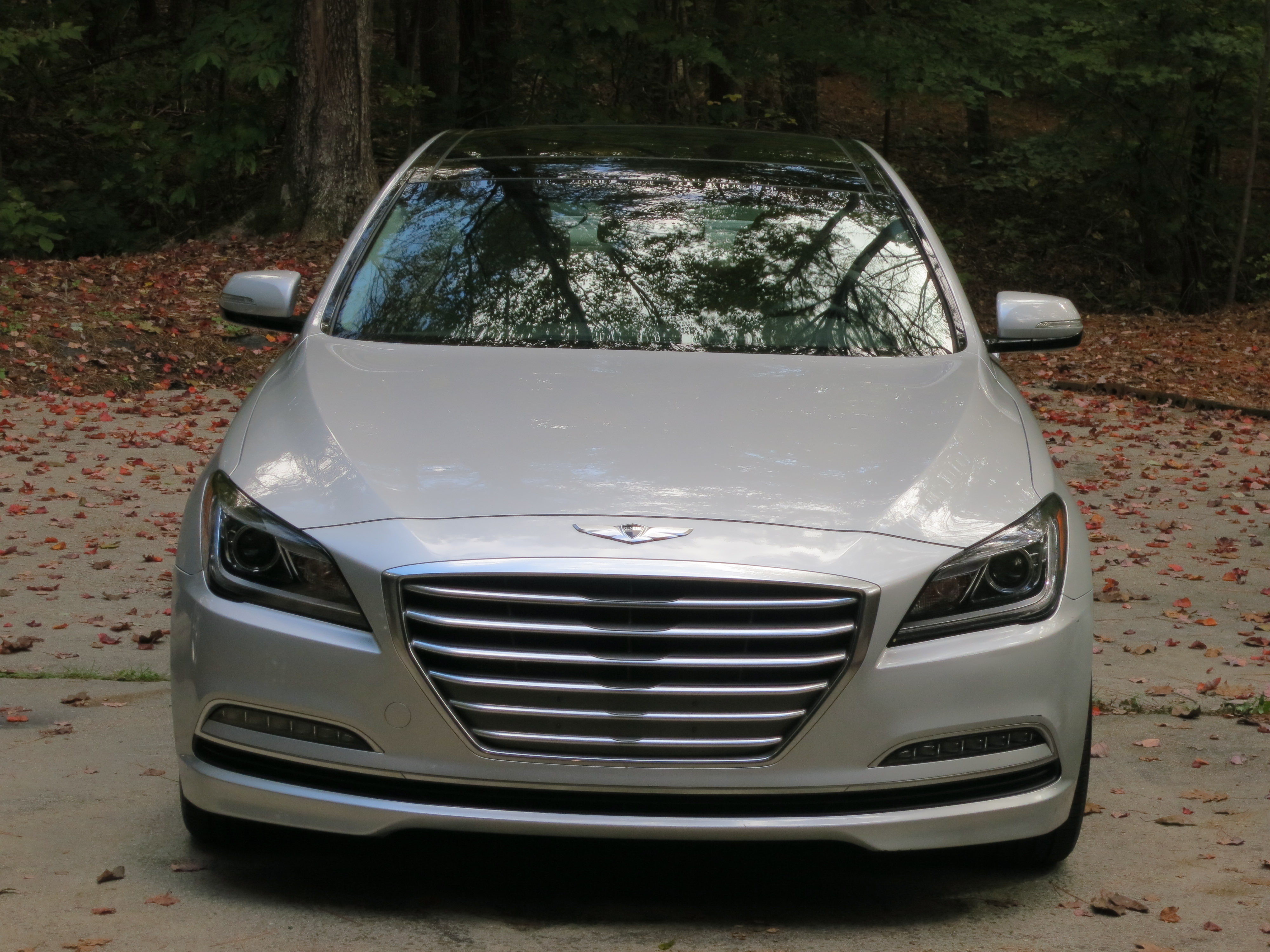

Just a few shots of Randi's new ride. V6, 311hp, direct injection, rwd, 8spd auto :mrgreen:

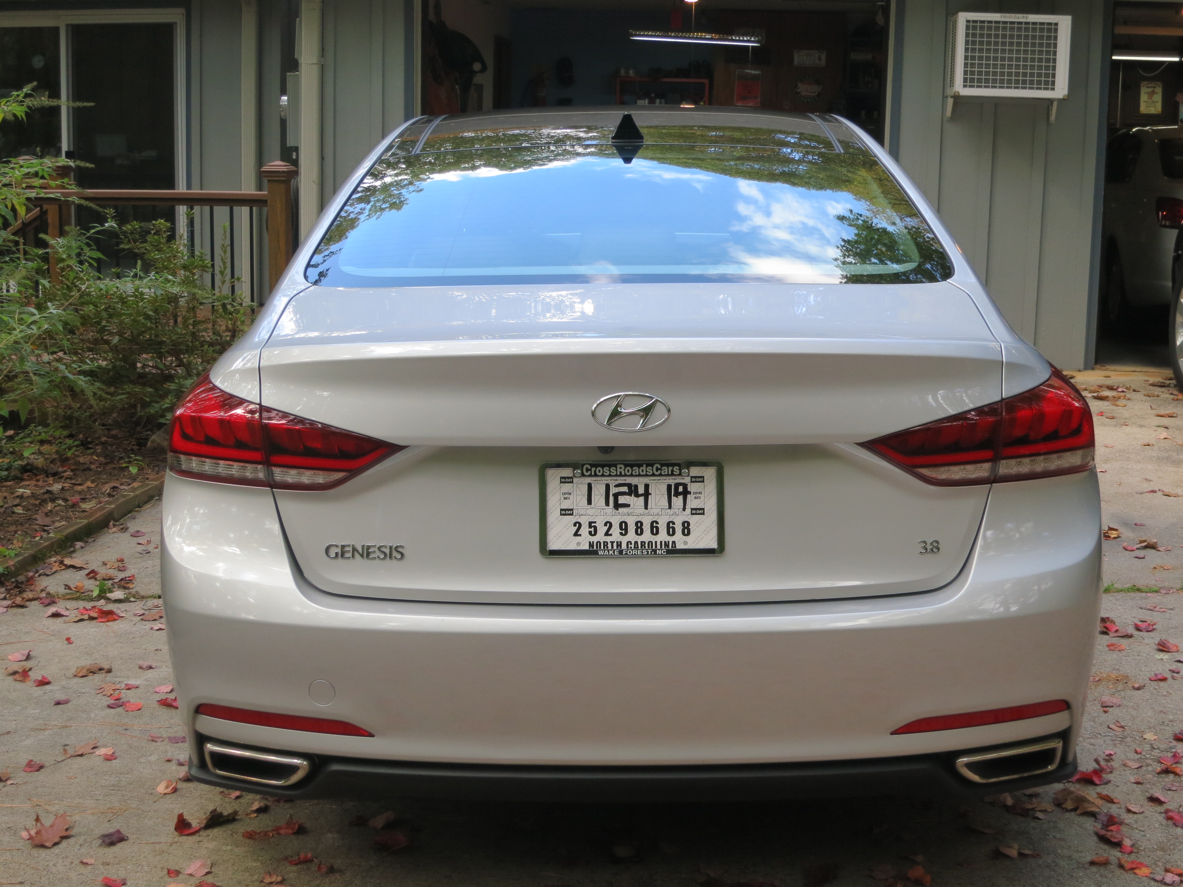

This past weekend I did my first oil change on Randi's hot rod at 22,200 miles. This was quite a project. This car has panels underneath covering all of the drivetrain with no access to the oil filter or drain. I believe later models does provide access covers for this purpose. There are front and rear interlocking covers with 14 10mm screws and a handful of plastic rivets which hold it in place. By the time I had finished crawling around under there, I could feel every muscle in my body aching. Randi heard me grunting and moaning and came out to the garage to see if I was OK.
Once the covers were removed, the first thing I noticed was the front to back true dual exhausts. What a surprise. Rear wheel drive and dual exhaust. I'm impressed with the overall design and build quality of the car (except for the under panels). The engine is a 3.8l direct injected double overhead cam V6 with 311hp at 6000 rpm. It takes 7.29 quarts of oil. It is serious fun to drive and even has paddle shifters for the 8 speed auto. :mrgreen:

Kinda neat to hear the Genesis has true duals.

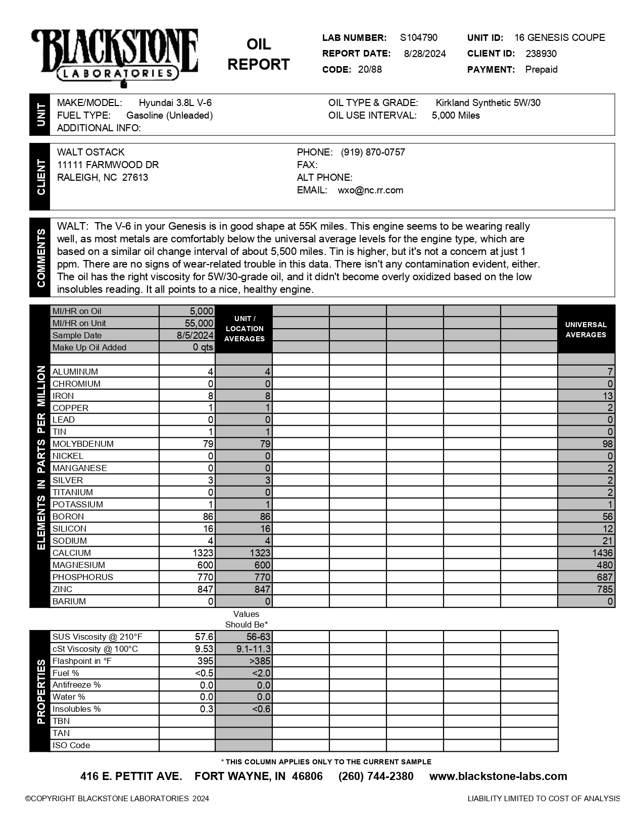

Randi's Genesis just had it's 55K oil change. Here's the results of the oil analysis I submitted:

I would say there's probably no reason to check that oil again. Looks tip-top.
Re: 2016 Genesis
It's been a great car. I would buy another. I like the confirmation that the engine vitals are as they should be.
