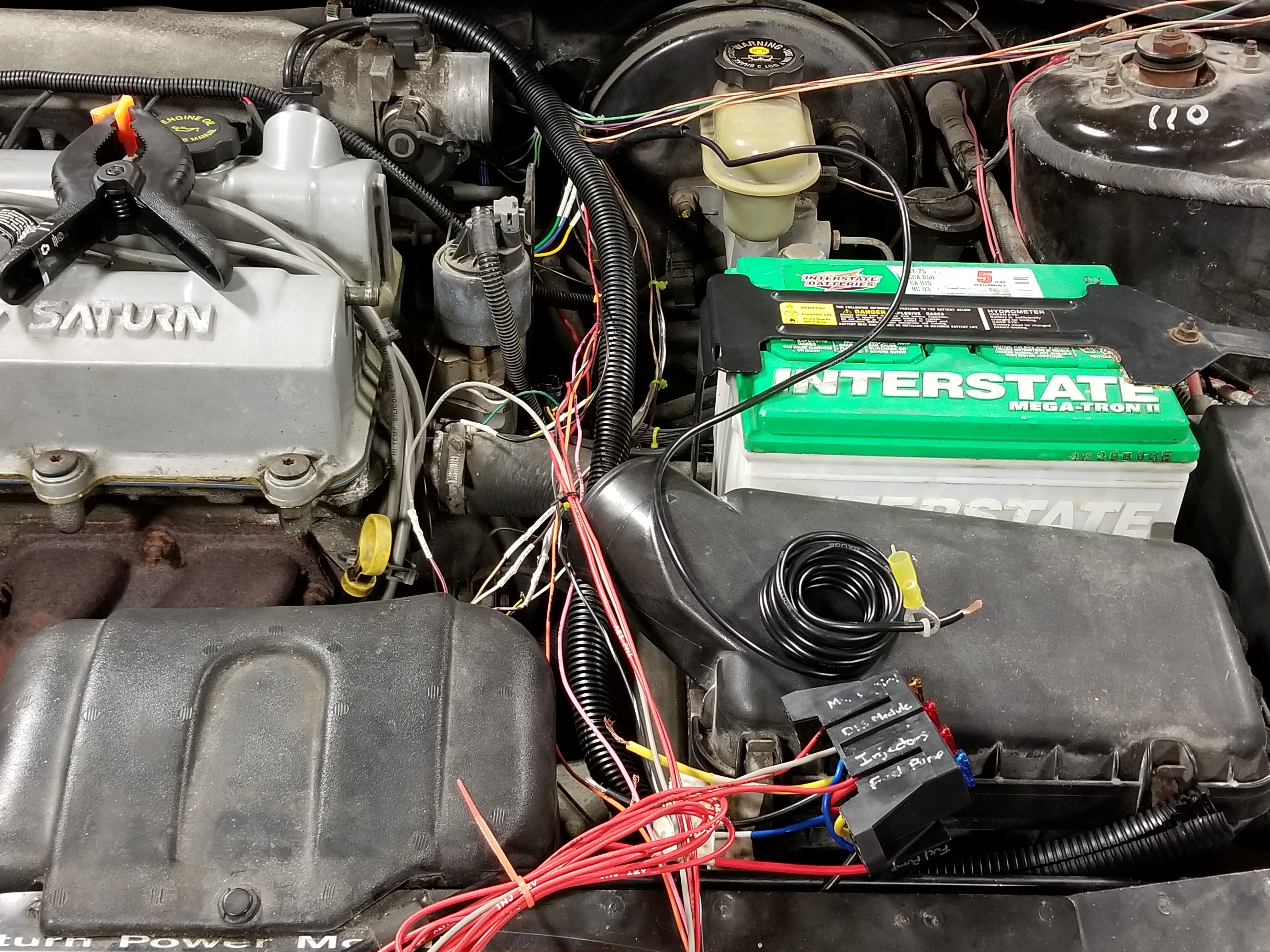

Today, I drilled a 2" hole in the passenger floor board. I fed the wire bundle down through the hole and up into the engine compartment and started laying out the wires where I want them to go. I got the injector harness done, the main ground, the tach signal from the Saturn ignition-control-module. I was able to temporarily jump power to it, I cranked the engine over and the Megasquirt registered cranking RPM. Woo hoo! That's an important hurdle crossed.

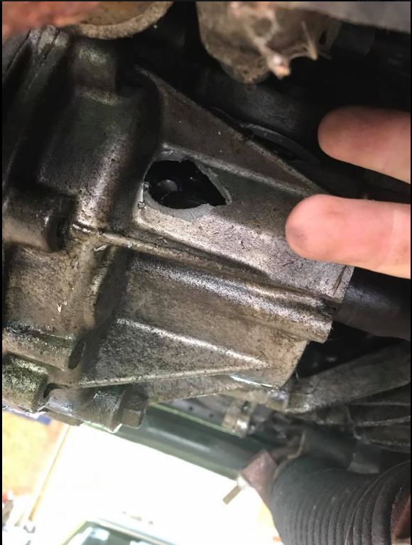

Despite having the car for a year, and having it up on the lift before, I never noticed the two (!!) holes in the transmission. Andy had told me there was a clutch or driveline issue that might need attention before trying to drive this on the street, but didn't think it was this bad.. :shock:

Ho hum, just another hole. :( But, the picture of your wiring harness looks like a sweet start.

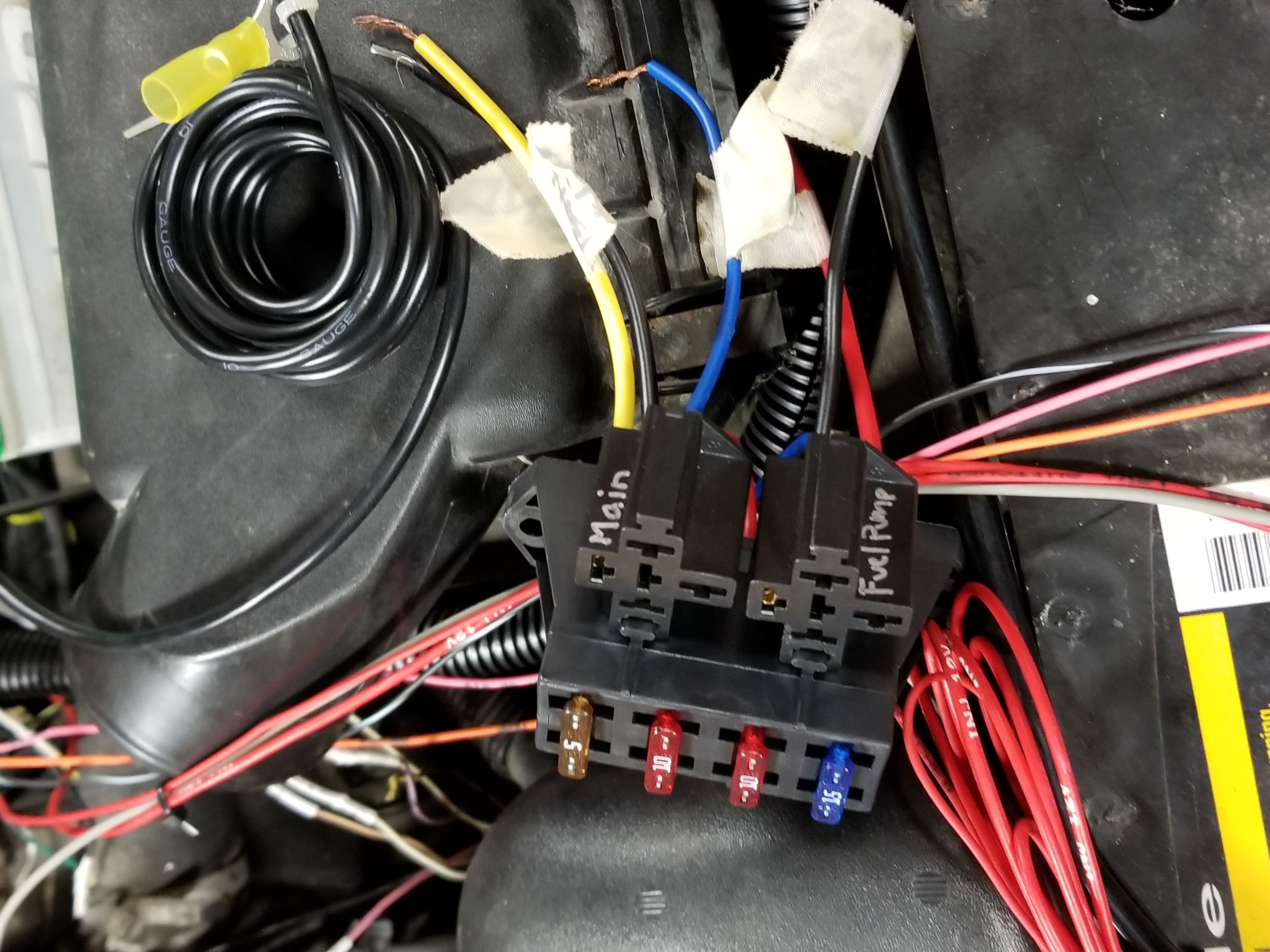

Made a bunch more progress on the Saturn tonight. I have the injectors, tps, coolant, iac all wired. Ignition is wired. I've gotten pretty good at soldering again.
I have a small fuse panel with a main power relay and a fuel pump relay. It needs 5 connections:
BAT +12V
Switched +12v
GND (just for the main relay)
Fuel Pump +12v (which I will just run over to the car's existing fuel pump relay sockets pin 30.
Fuel pump control wire from MS (MS provides the relay low-side ground, fuel pump relay pin 85)

Turns out the car had a bad transmission - what appears to be a loose differential pin. It still enabled Dave to learn a lot and get the car running on the Megasquirt.

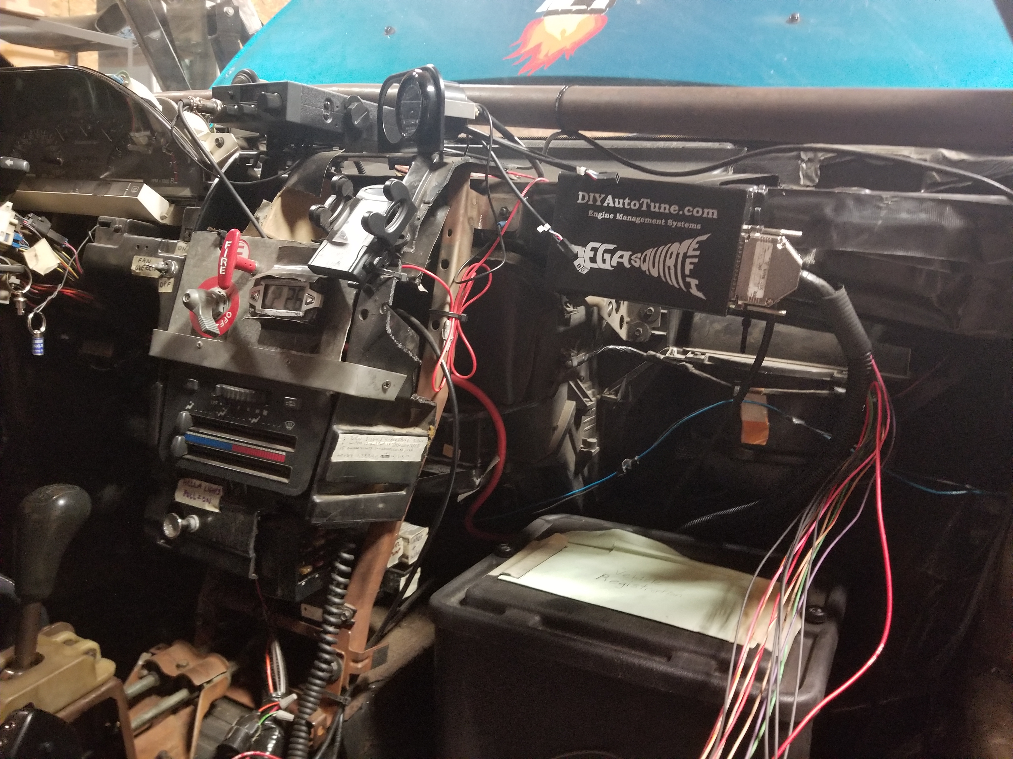

Made a ton of progress getting the Megasquirt into the race car. The engine side of the harness is all in place, access hole cut in the floor, the box temporarily mounted, but in basic final location. I need to wire up the power, ground, connect to the wideband sensor, fuel pump, and the knock module/sensor.

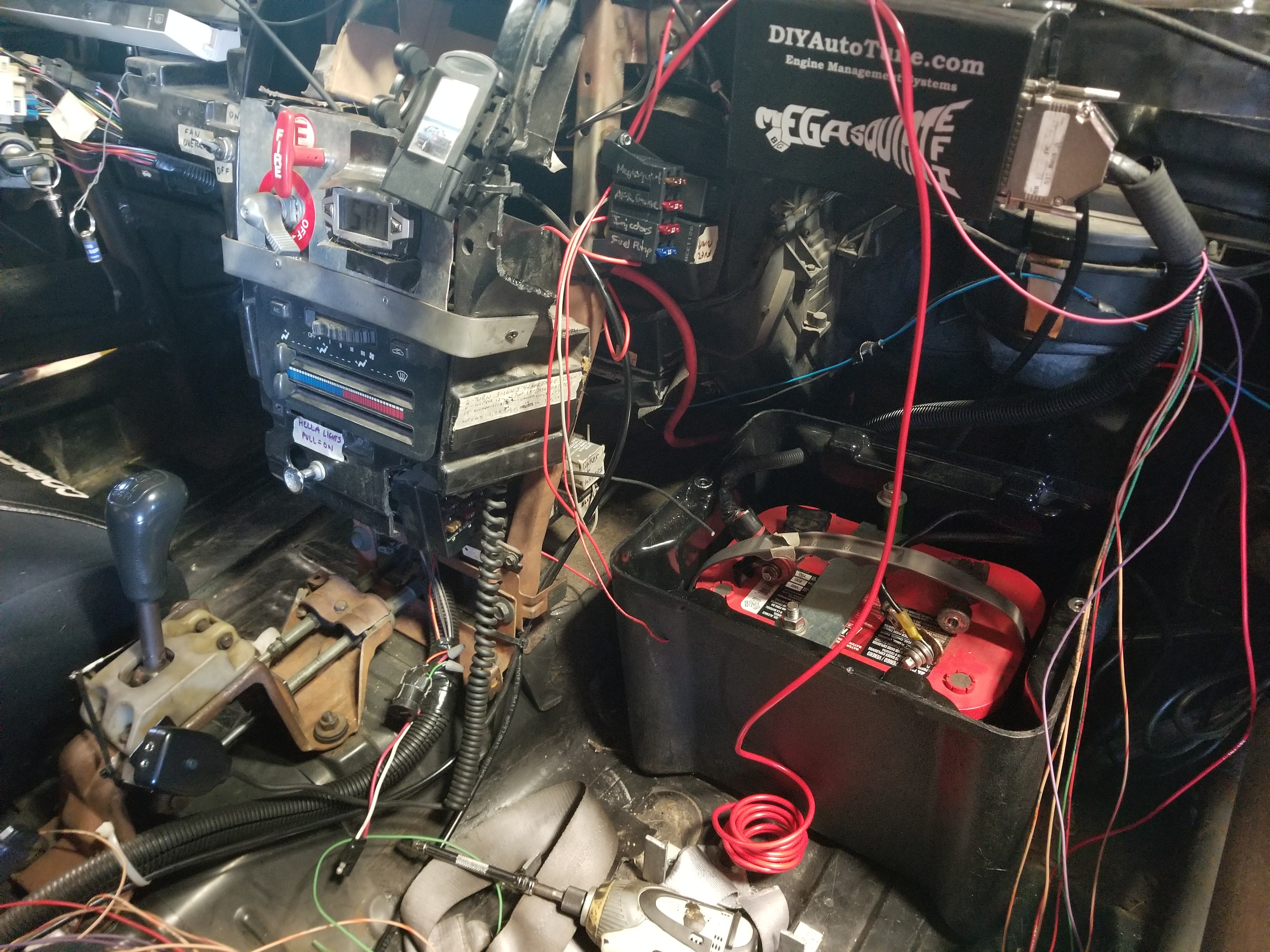

Progress continues. I got the main power from the Master Safety Switch. By wiring in there, I'm essentially hooked to the battery, and power will get killed when the switch is off. I hooked up a ground busbar directly to the battery. I mounted the fuse panel.
I'm waiting for a second busbar for the positive side to arrive. Once that is done, it shouldn't take long to finish.
Still need to hook up the WB02 to MS.
Fan control
Knock Module
My goal right now is to have it drivable by next weekend for a little testing/tuning.
