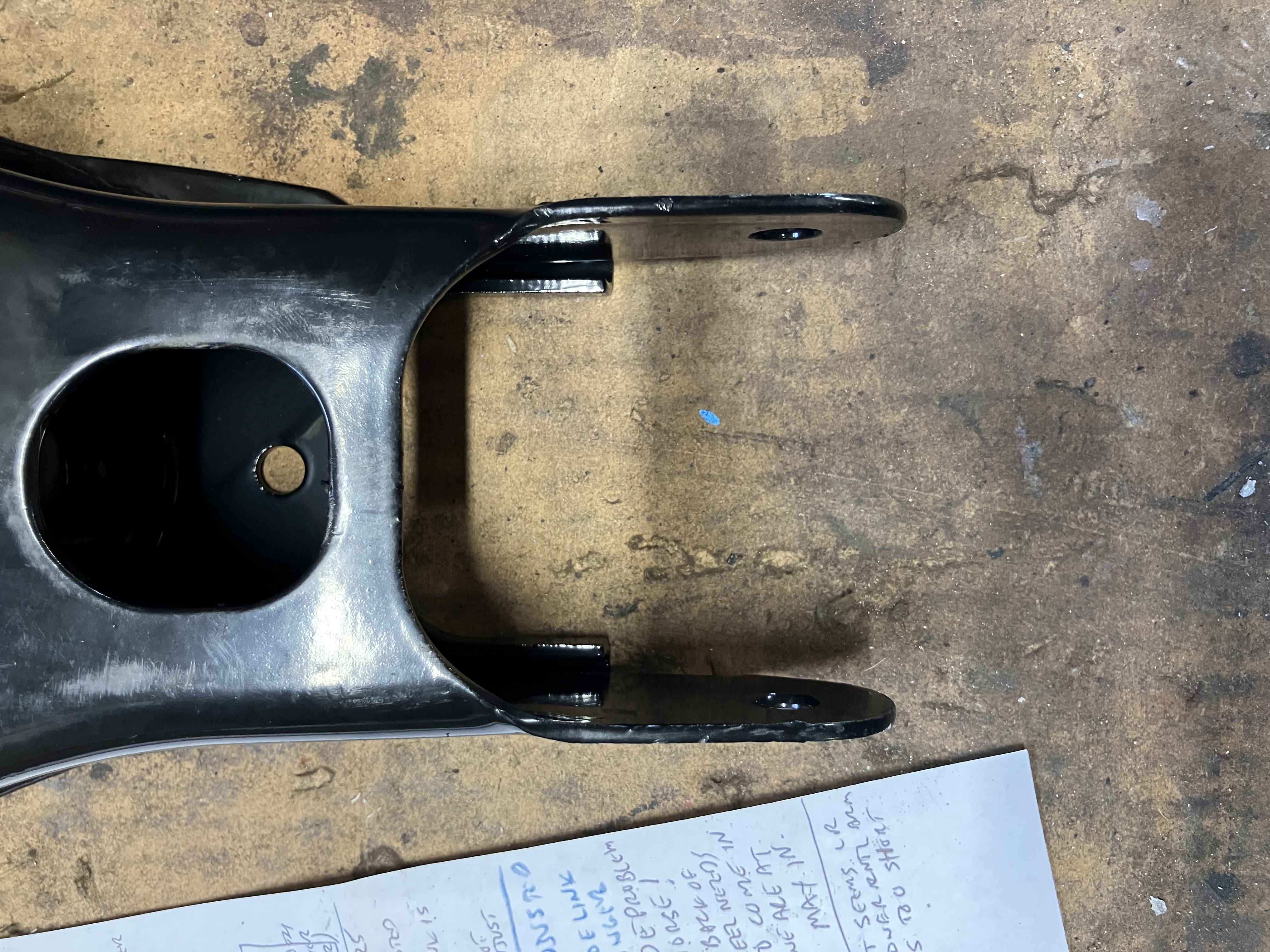

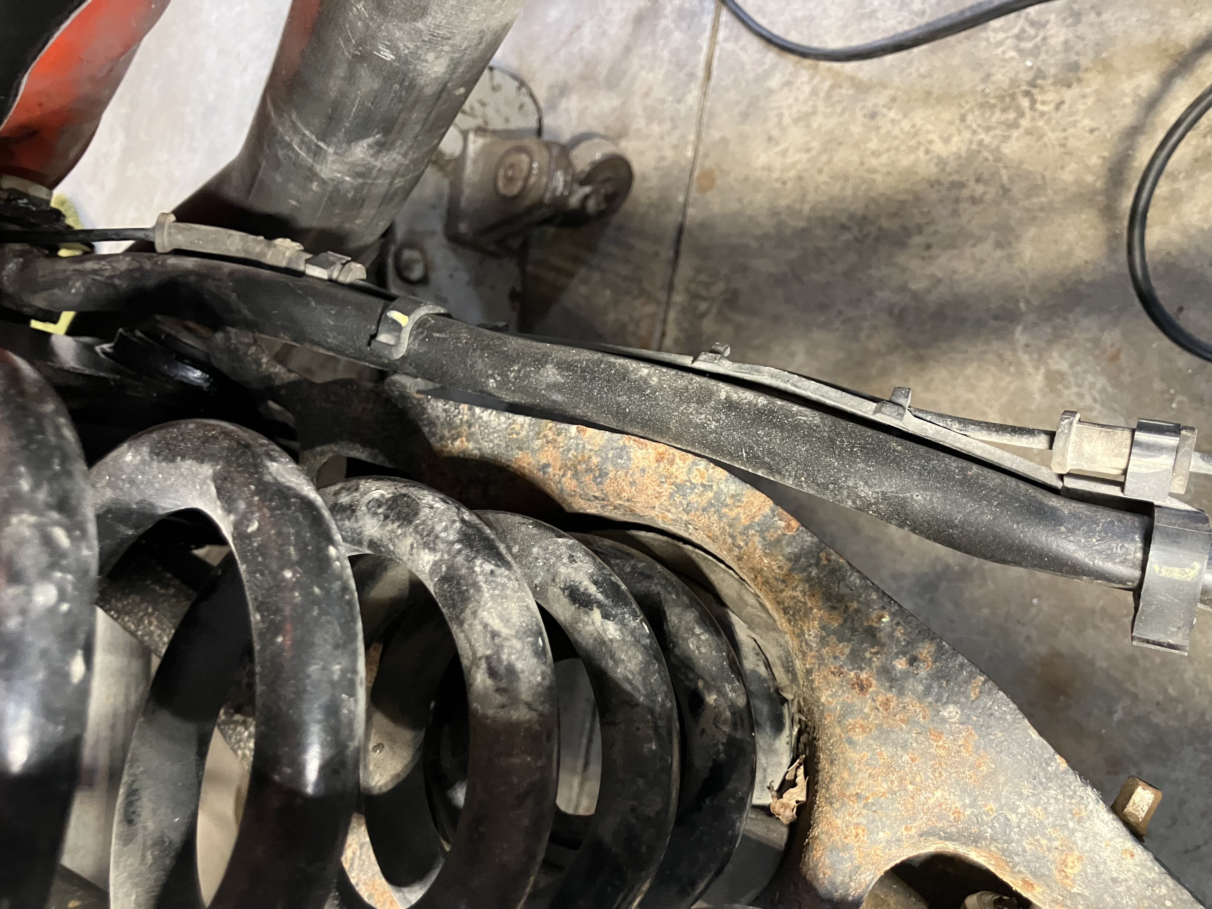

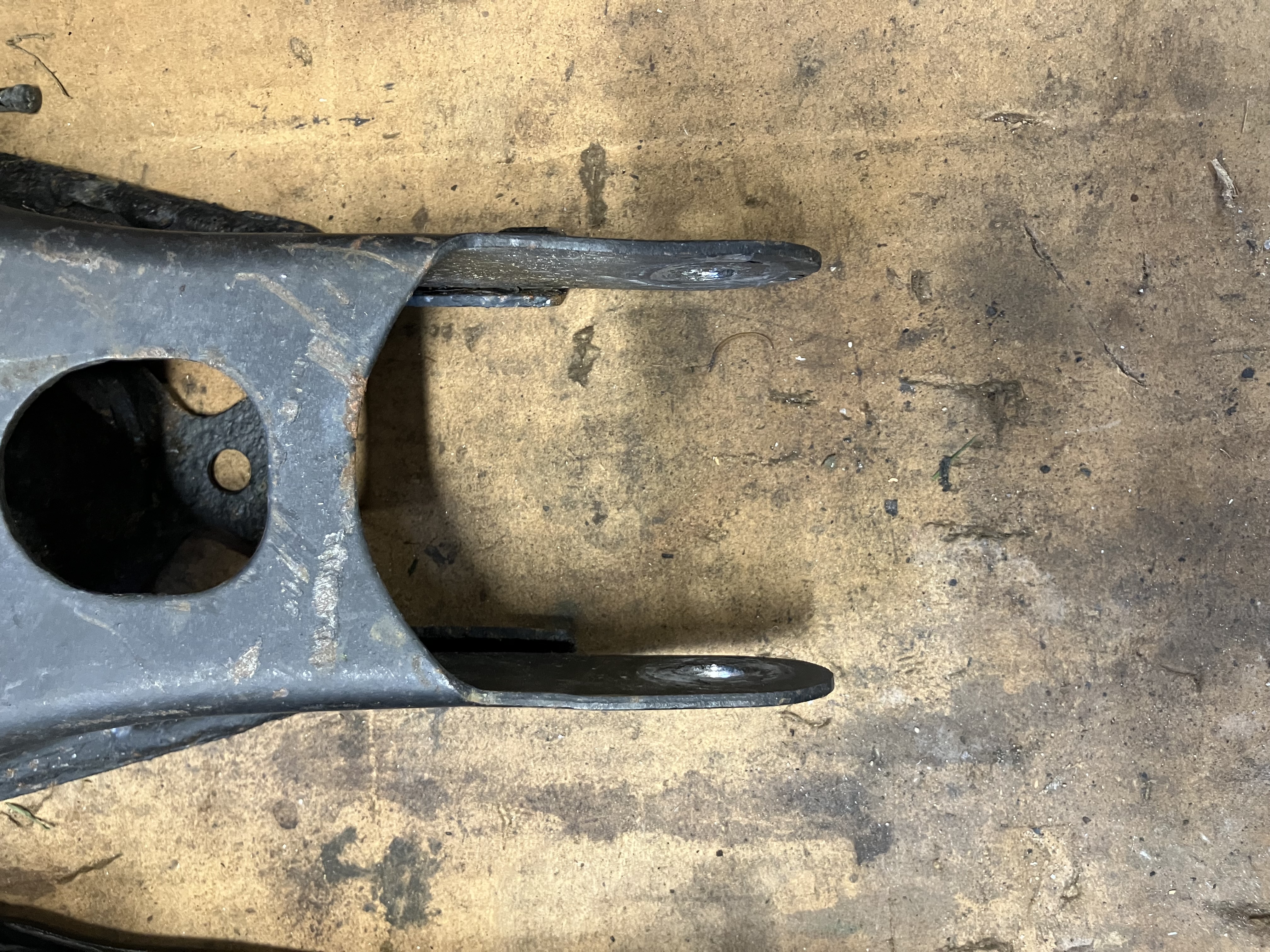

The replacement subframe was installed with the R/T swaybar. With this setup the weird suspension wiggle in the back was eliminated. Sadly I was not out of the woods with this project. I could not get the rear end to track correctly behind the front. One issue was the LR was at max adjustment on the toe link but it was not straight. First I changed the toe link, then the lower control arm. Both of these were from the 2017 Charger parts car, but it had been hit on the left rear wheel. Still the problem was not resolved, but at least the rear wheels could line up with each other. A few days back I made some final adjustments of the rear frame relative to the car - and now the distance from the front of the rear tire to the fender is within 1/8" from left side to right side. At this point I think its close enough I'm going to call this done.

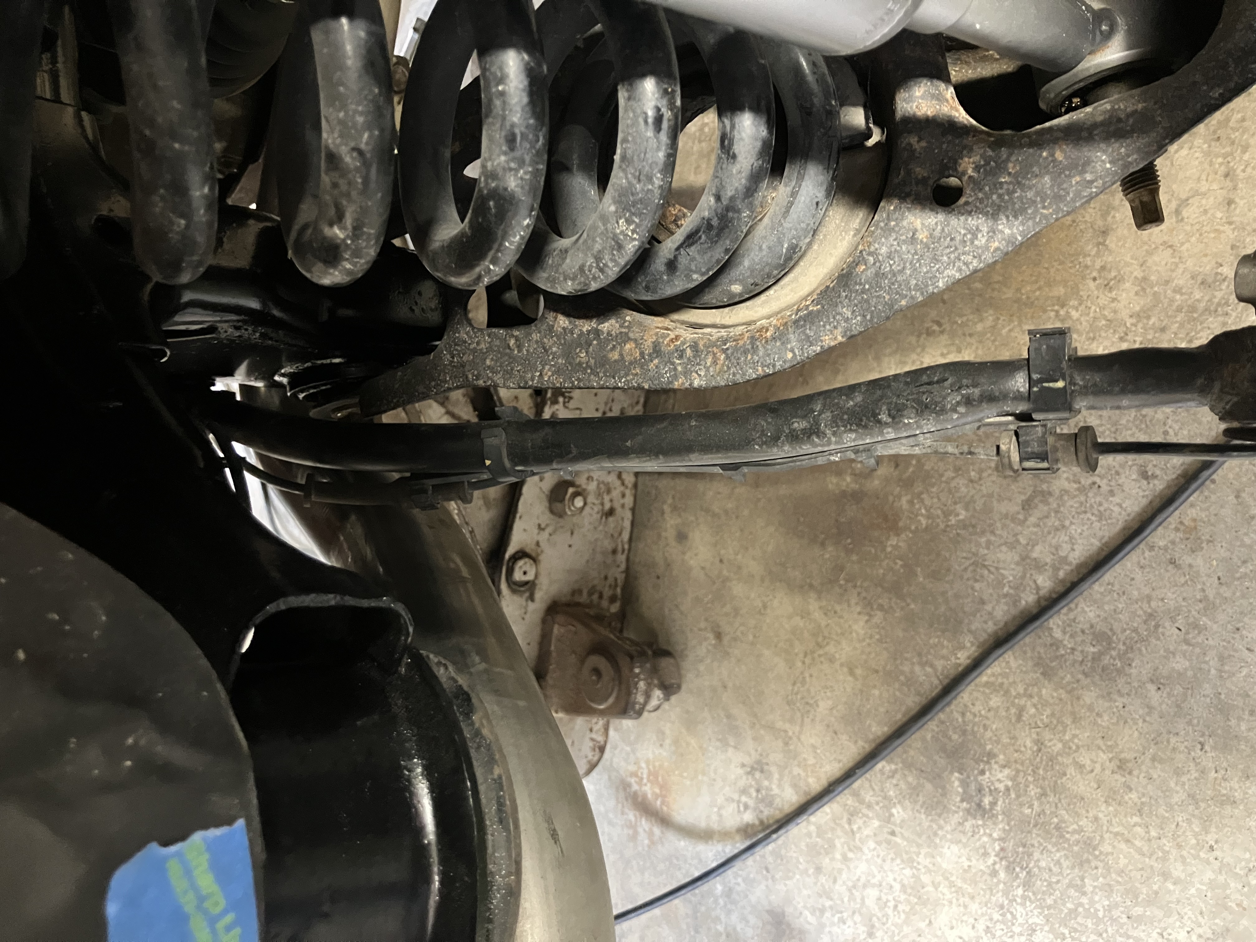

LR - toe link and lower control arm are way too close at full suspension travel
RR - adequate clearance

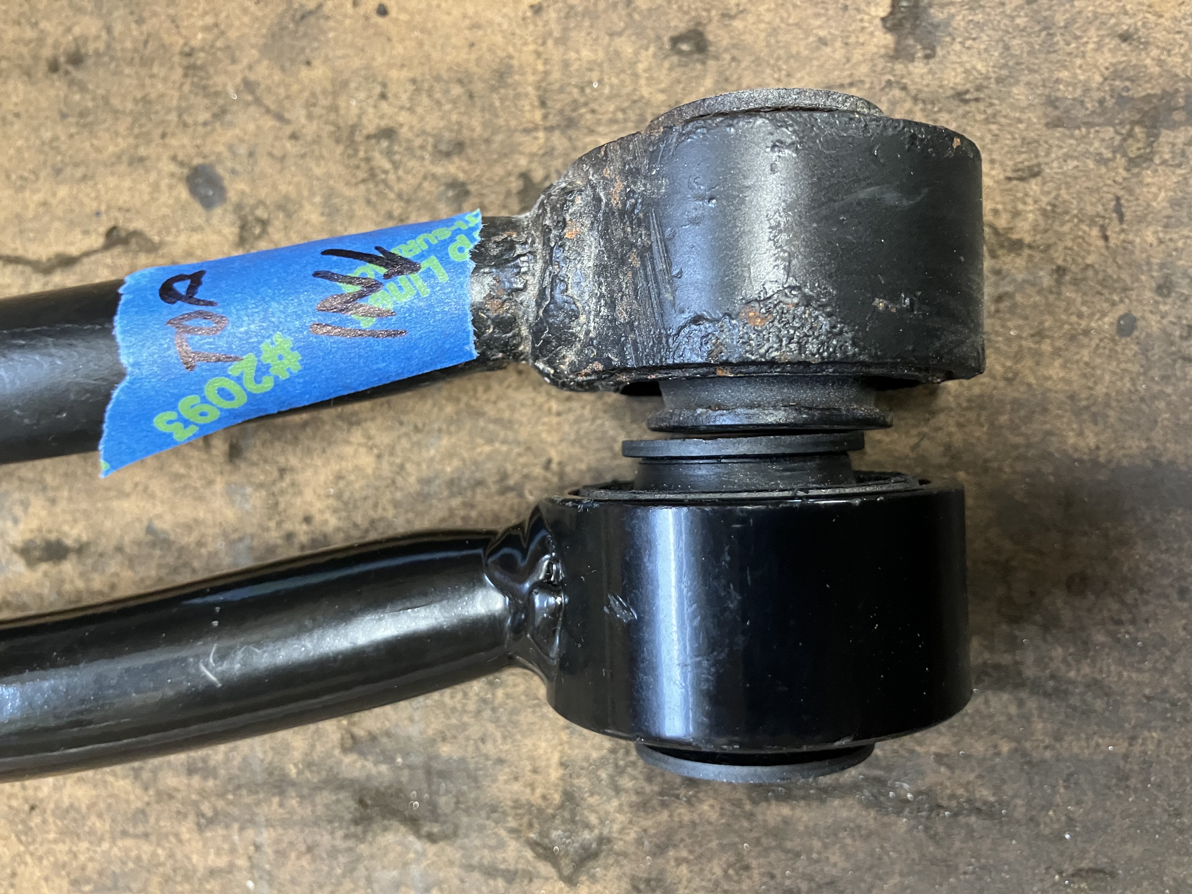

LR toe link too long by a little
minor damage to LR lower control arm shifted it back just a bit

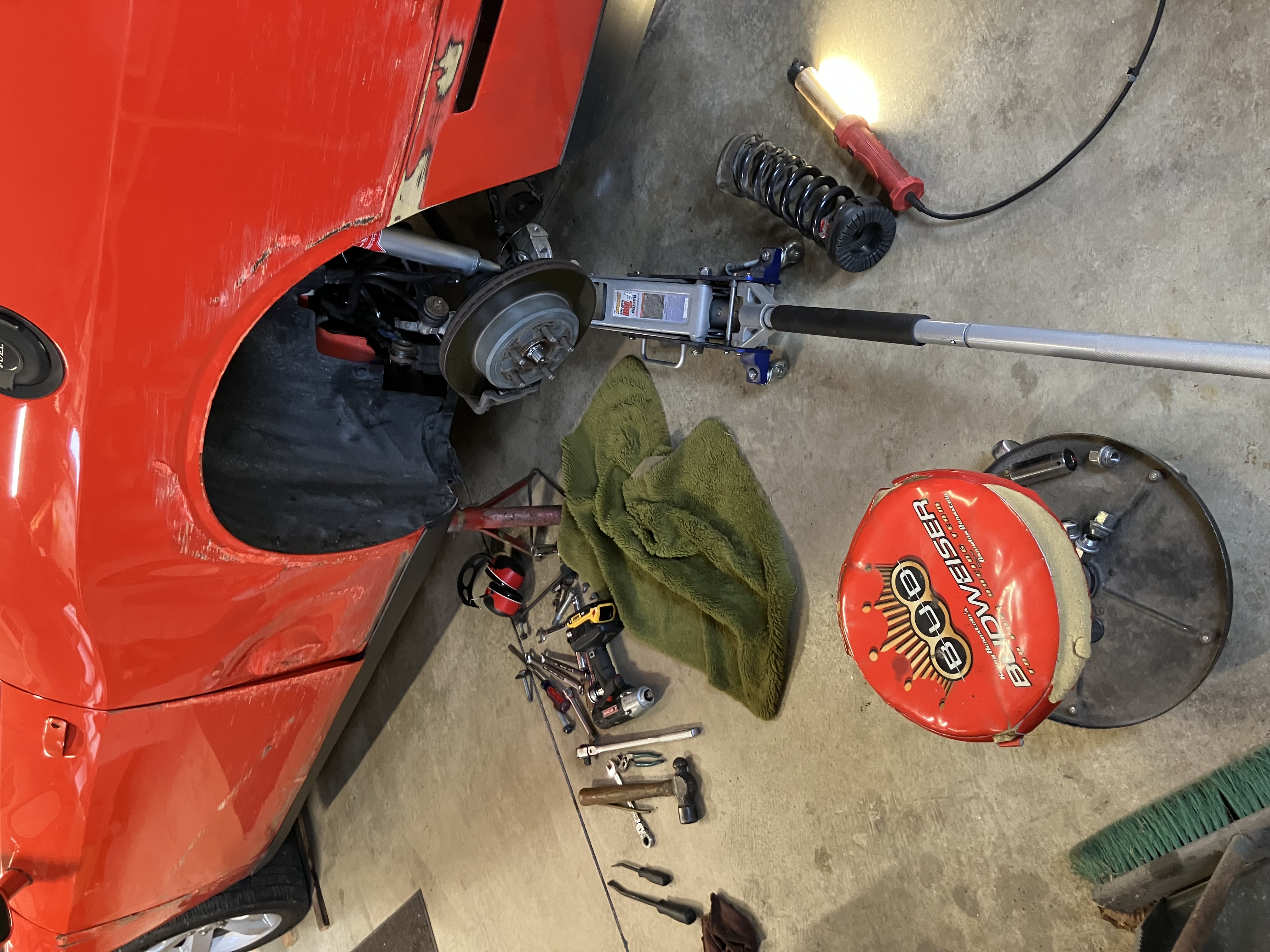

too many time up on the jack and working on this project

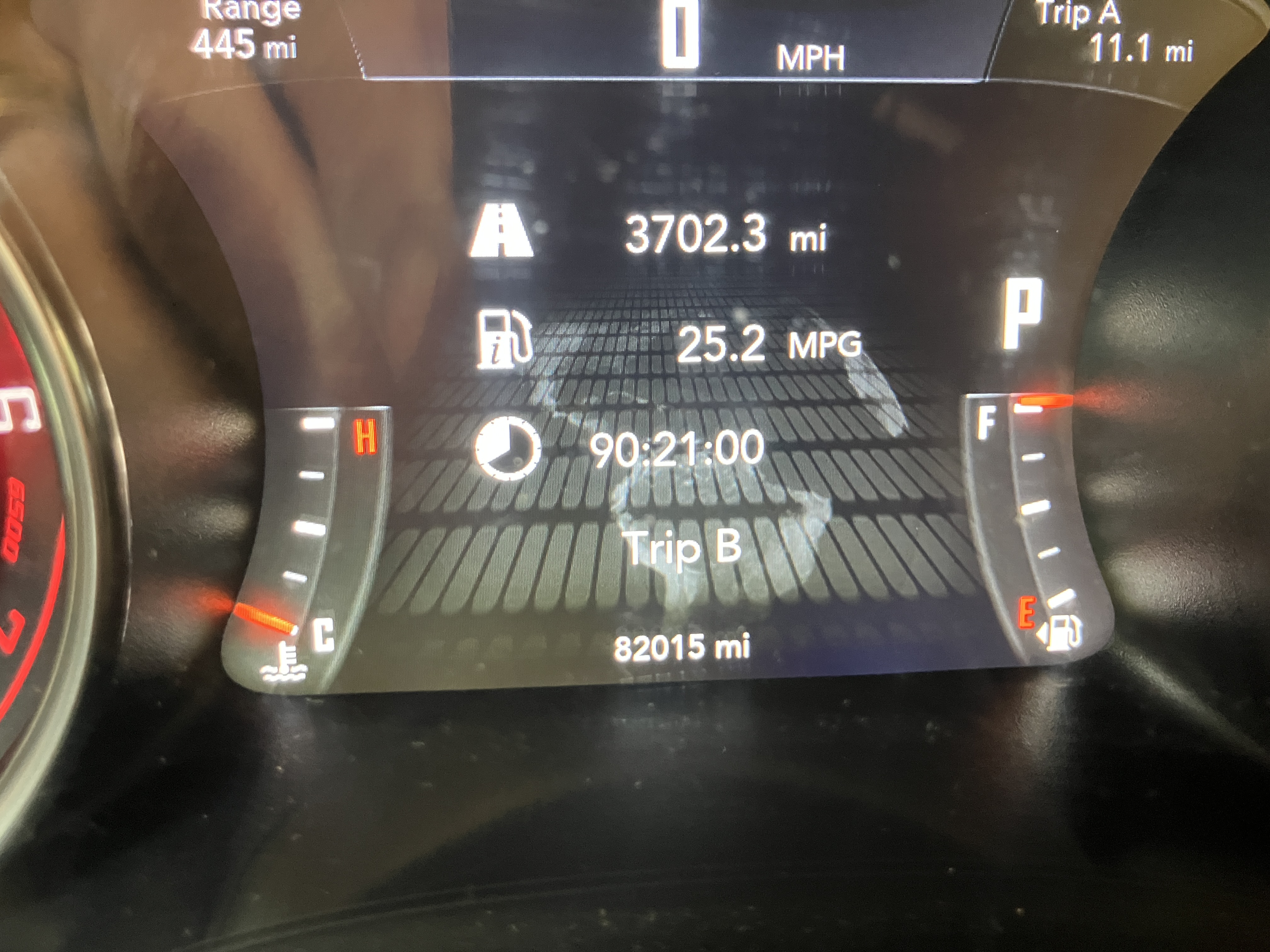

I’ve been driving this car regularly since the salt washed off the roads. Finally went over 4000 miles. Trip B odometer has most of them.
