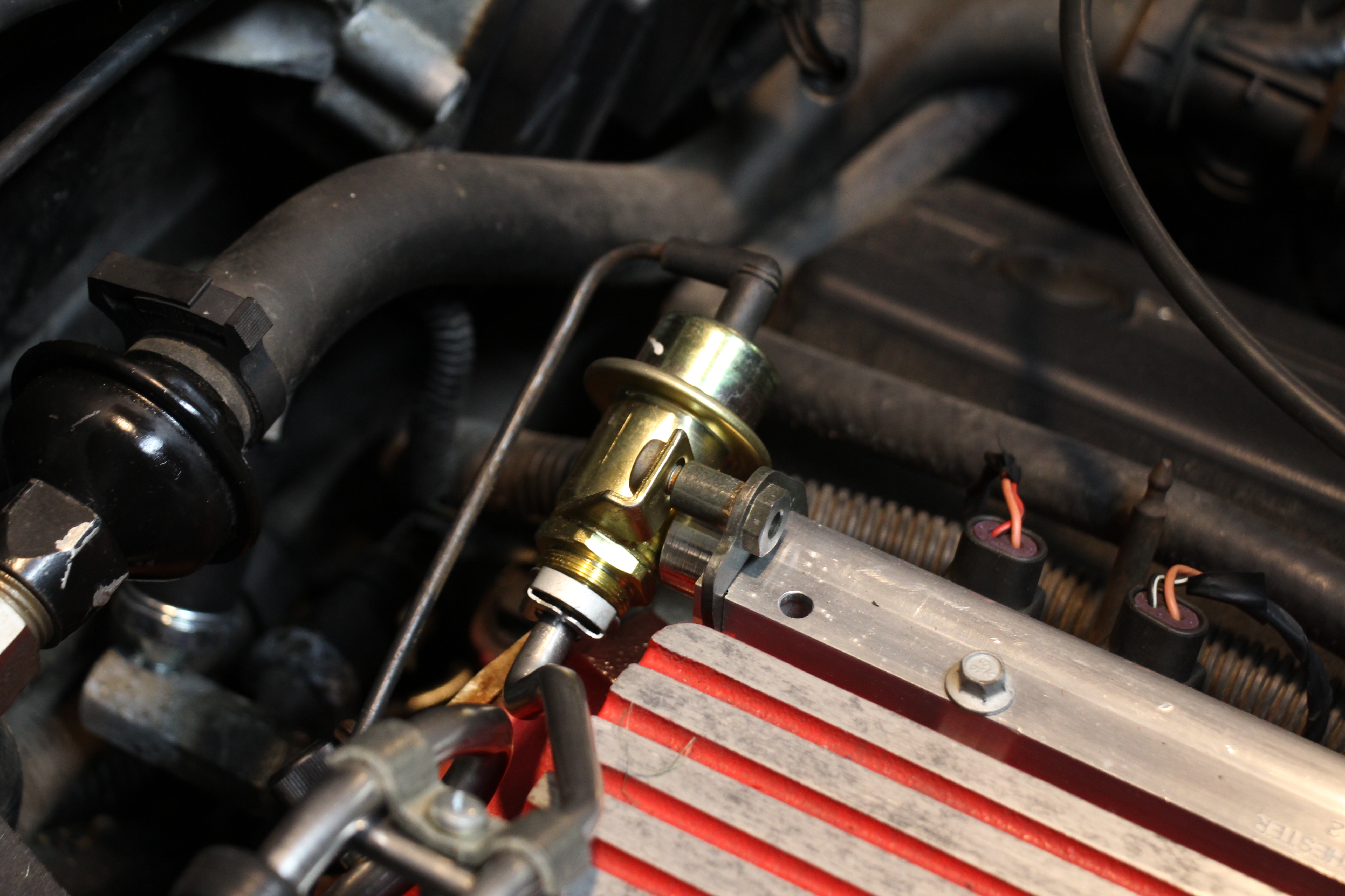

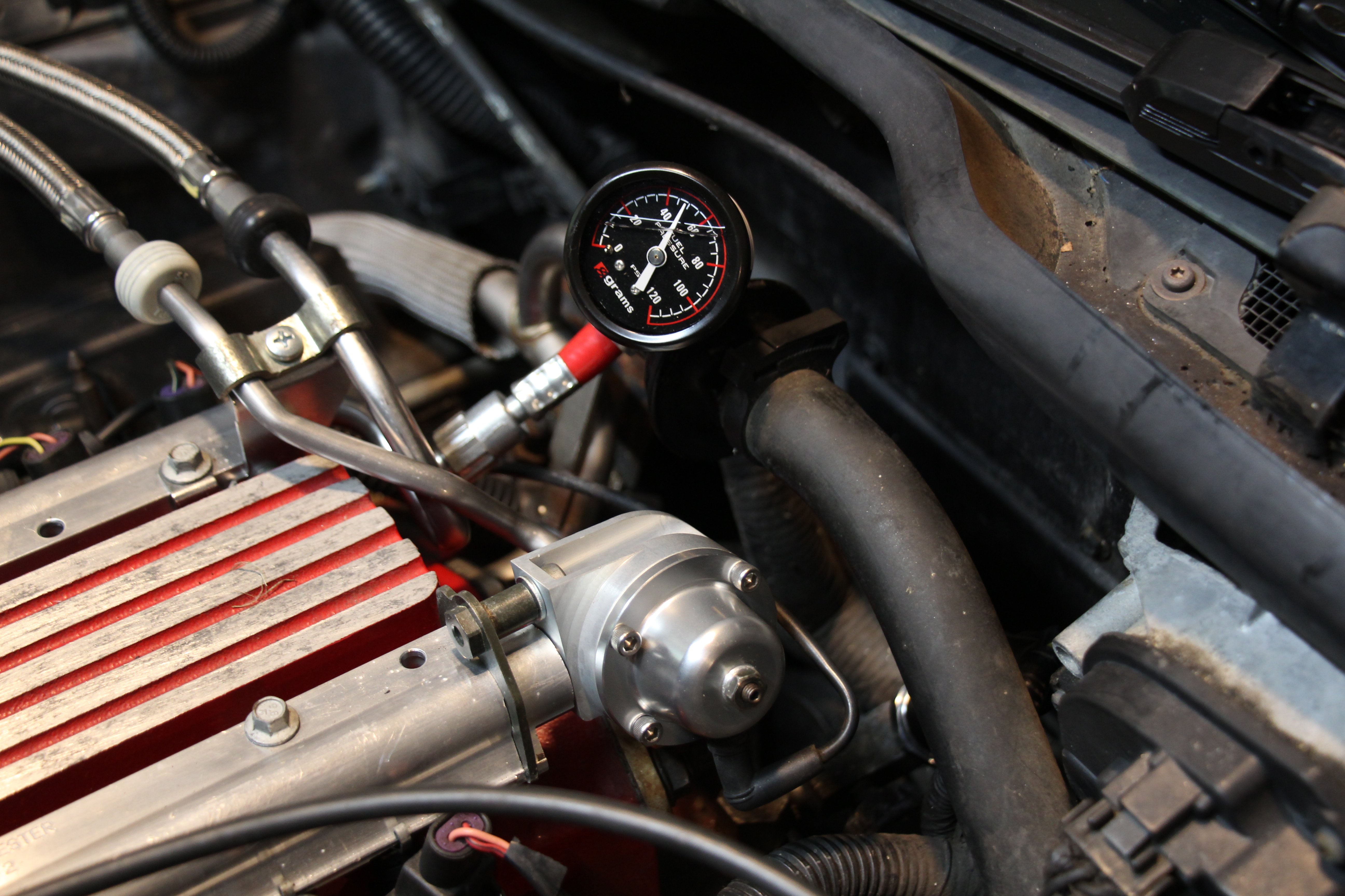

3) I also installed a fuel pressure gauge on the test port of the fuel rail and saw that the fuel pressure is lower than it should be. At Maverick's suggestion, I pinched off the return line at the tank and ran the pump. I got 90 psi at the fuel rail so the pump is good so that leaves the fuel pressure regulator as the source of the problem. I just ordered a Holley adjustable fuel pressure regulator. I'm expecting it next week. Perhaps more fuel pressure will fix the stumble. Fingers crossed.

The new Holley adjustable fuel pressure regulator was in the mail waiting for me when we returned from the beach last night. I couldn't wait for the morning to come, to get it installed, adjusted and tested. The off-idle stumble appears to be gone. I believe my fuel pressure gauge is inaccurate, because I had to set the pressure higher than stock to get the engine to respond without hesitation.

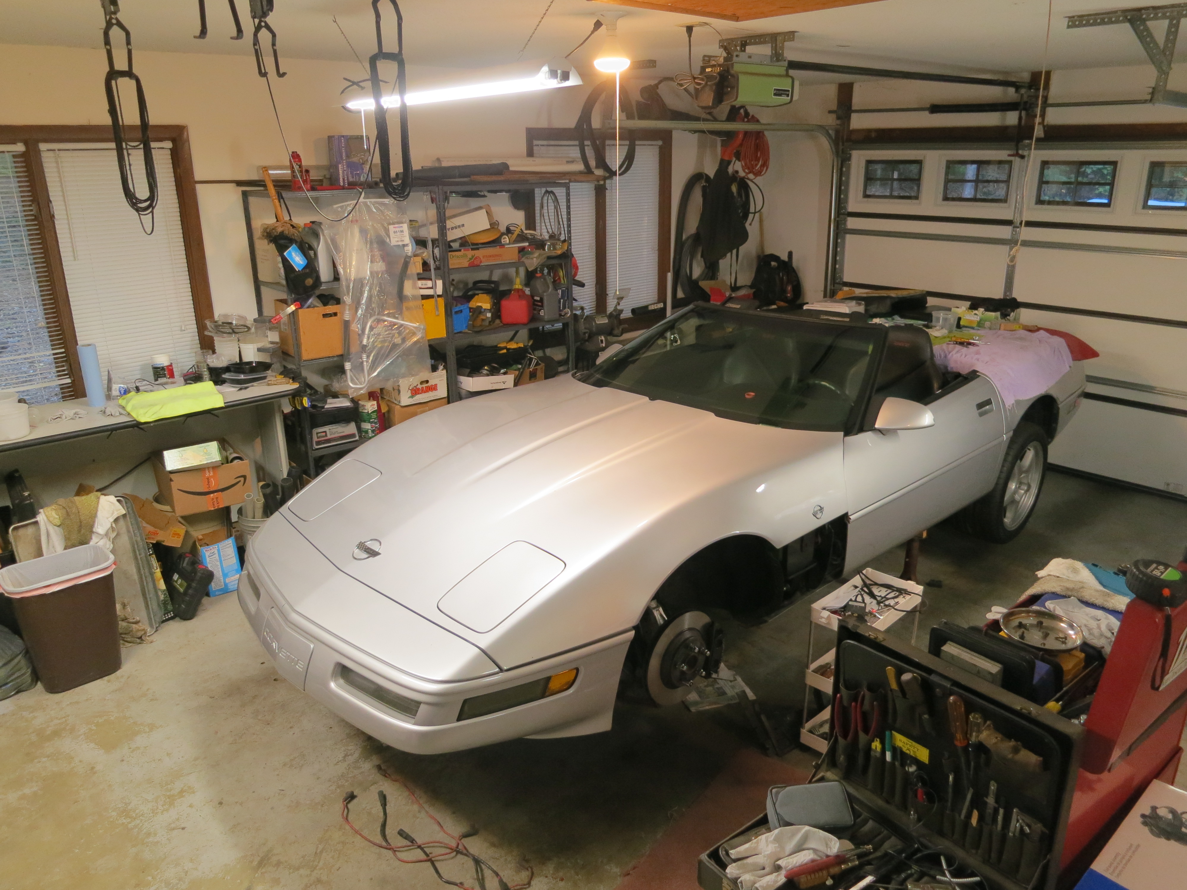

Time for wheels on the ground. Soon, very soon. :mrgreen: It's been over 10 weeks sitting on jack stands.
So glad to hear you've solved the stumble. Good work!! Are the wheels back on yet??
