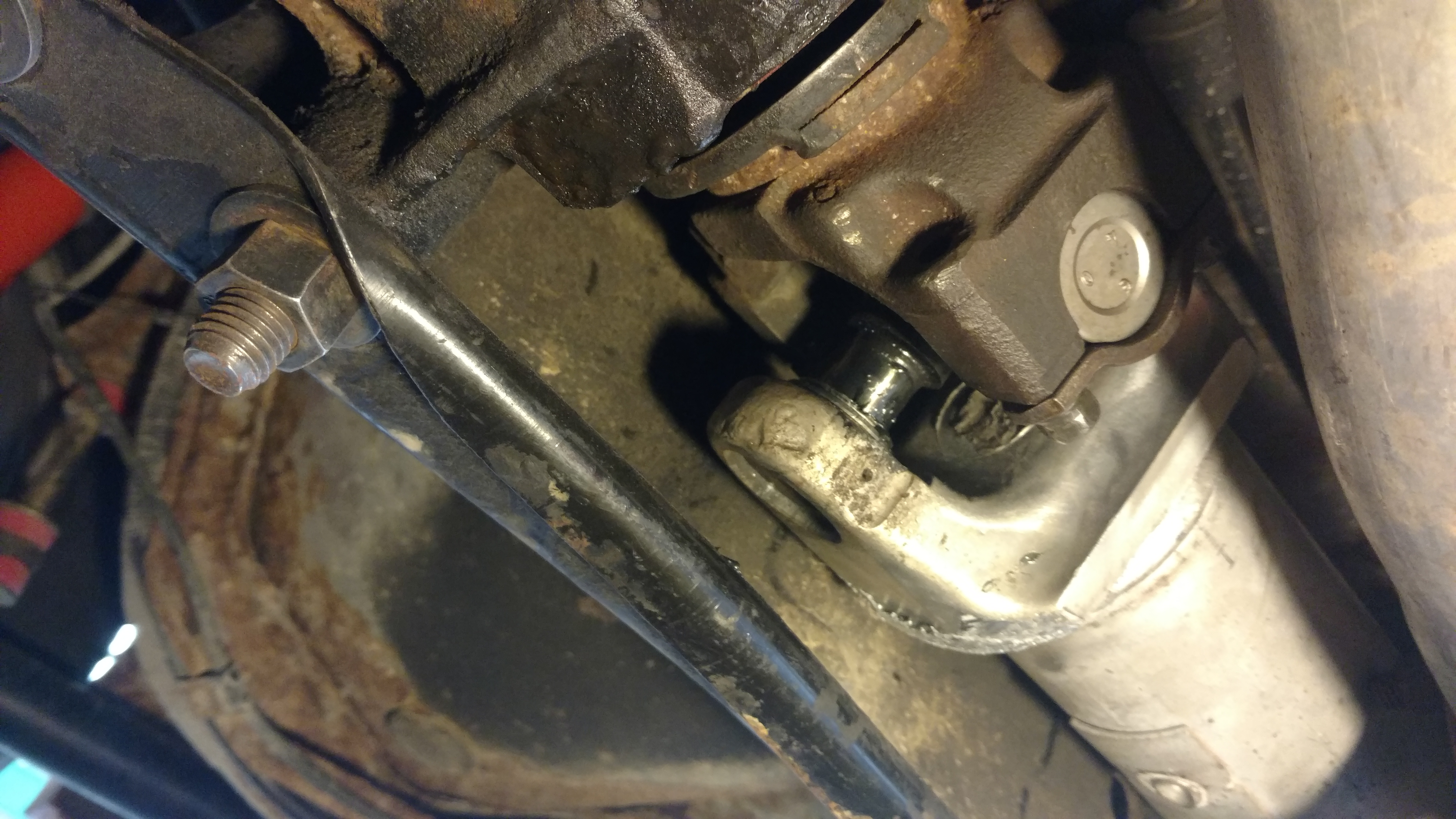

I made a trip to 32V's to assess the damage. We knew the u-joint came loose, no surprise there. But why? Once we pulled the driveshaft out, then removed what was left of the ujoint, we determined that we didn't burn enough of the plastic out of the grooves from the original factory u-joint and the clips weren't seated properly. Although we did do some slight damage to the rear u-joint area from all the banging around, we were able to manipulate the aluminum to make it work safely we think.
Two of the cups were still in tact and attached to the rearend, so 32V went to his stash and found a couple good ujoints. He greased up a couple caps and installed them on our current ujoint that seemed otherwise in tact. After reinstalling the shaft, I took it for a spin and it seemed good up to 90mph. There were a couple small dents in the driveshaft, but it didn't seem to affect it's operation at all. Keeping in mind this is aluminum and not steel, I'm not too concerned, especially after the test drive.
Now we have to re-figure out the brake lights not working again (only the 3rd light works) and I have to pull the blower fan out as something fell into the fan area during the autocross and now it makes a ton of noise when the fan is on. That one will be pretty easy.
Posts: 3648
Re: 1997 Pontiac Firebird
U-joint destruction.

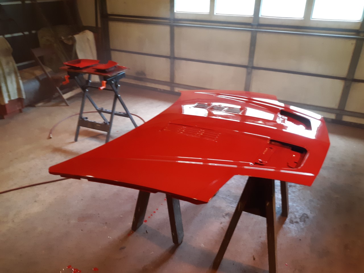

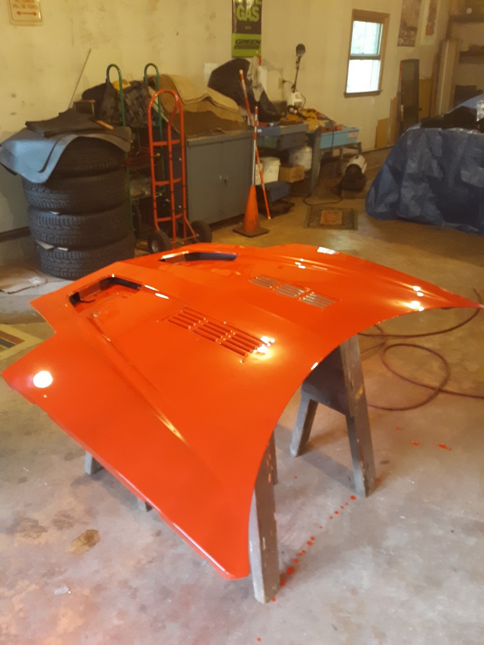

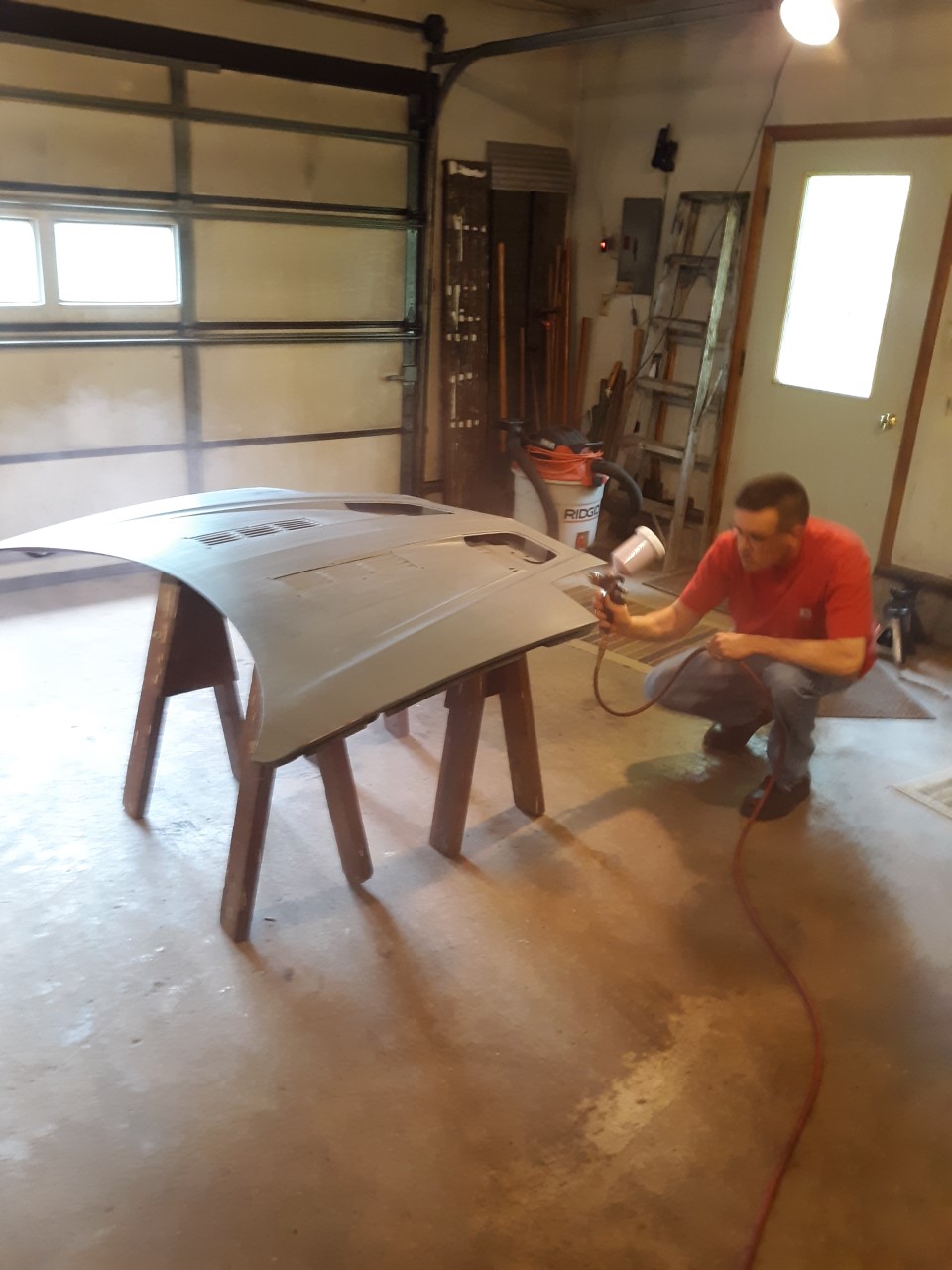

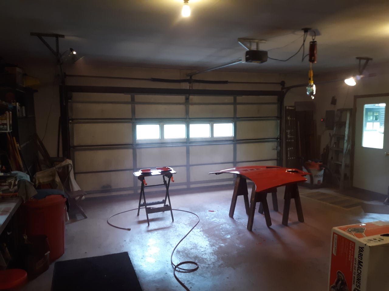

The louvered hood has been ready to be painted for awhile.
Well today was the day!
A Little of this & some of that.
Start
Start
Moving up
Moving up
Typical spray booth
Typical spray booth
looks good
looks good
Ready to assemble & install
During the week it will be reassembled, this louvered hood will be on the TrackBird for Track Day.

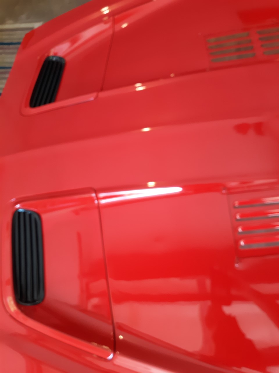

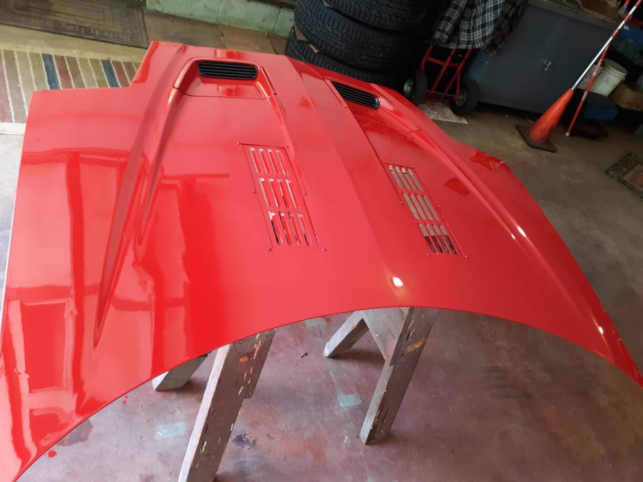

The false inserts were painted black. The hood is completely reassembled.
front view
front view
VERY Shiny, old hood in background
rear view
rear view
Ready to be put on the TrackBird.

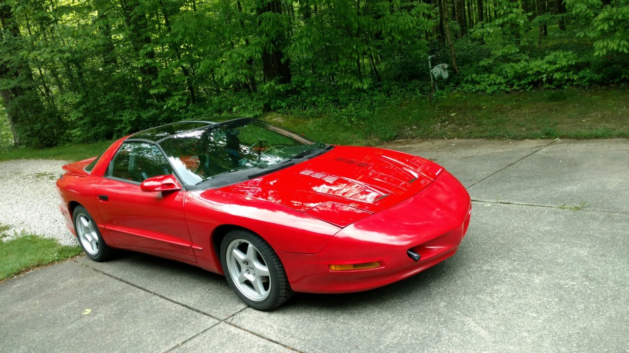

Outside pics.
It looks too good to be a race car. 8)
