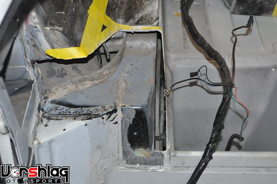

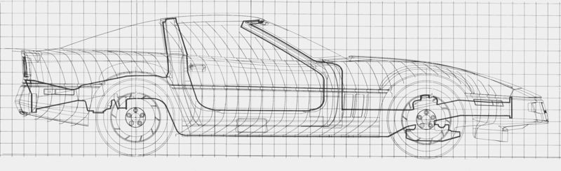

<pic 1> picture of the Vette silhouette *
<pic 2> picture of the Vette blueprint structure *

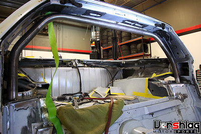

1. The halo hoop is going to be above the main hoop
2. The factory rollover protection will not be cut to put the main hoop above the driver's head. It is considered an extension of the main hoop, and the main hoop will be within 1/4” of the rollover protection on the roofline. Top of drive helmet to be 7/8” below the top of the factory rollover protection
3. The halo hoop and top portion of the front legs are going to be outside of the original designed structure of the car
4. Where the door bars typically connect to the main hoop, they will instead attach to flat plates secured to subframe of the car
5. There will be one additional bar between the front center of the halo hoop and the center of the rear main hoop

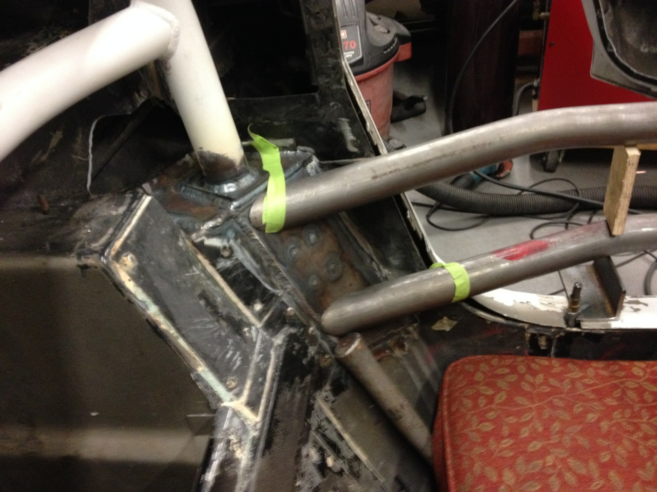

Main Hoop Proposal
Plan A:
Put the hoop under the factory rollover protection – keep it within 1/4” along the top and attach the sides with gusset plates.
Cut through the fiberglass to get to the subframe and weld mounting plate to that
<pic 3> Vorshlag main hoop to roof bar

Front legs of the cage will run outside the A pillar up to the halo hoop. Halo hoop will also be mounted out
Attach front legs to A pillar with gusset plates
Front legs to mount to subframe at top of rocker panel/kick plate area. Will have to cut through the fiberglass to reach the subframe
The halo hoop will be located above the rear main hoop and the bars will have a small bend to come down and attach to the main hoop

Typical installations I have seen attach these bars behind the driver seat on the angled floor plane, instead of the main hoop. The issue here is that the floor is thin metal and may crush in a side impact.
Our proposal is to cut open the floor in this area and attach to the subframe, which is much sturdier and should do a better job support the door bars in event of a side impact.
<pic 6> inadequate side door guard design *
<pic 7> pic of where the plates/side bars will attach to subframe (still need to cut floor and take this pic)

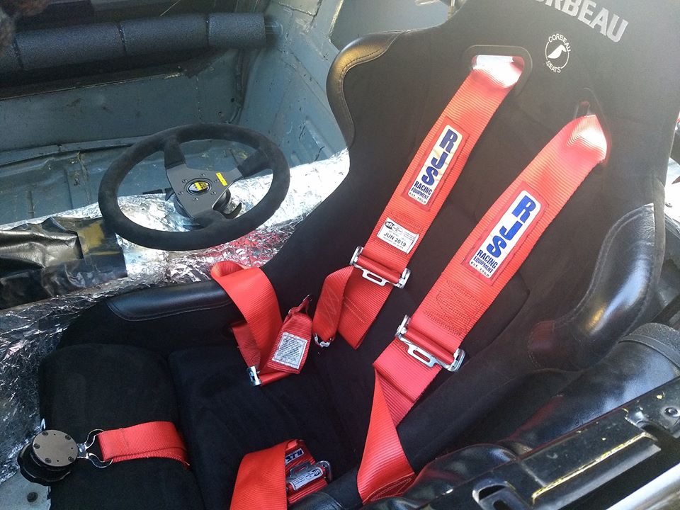

Seat Configuration Proposal
My tallest drivers are 39” tall with helmet in the seated position
We have large height variations we need to accommodate 5' 4” to 6' 3” so we will be using an adjustable seat
Current plan is to use an aluminum Kirkey 17” or similar and have drivers use inserts for adequate height, length, side support or comfort
We will fabricate adequate brackets to hold the seat in place and connect to the sliders
Current adapter slider configuration is just under 1.25” tall and fits on stock moorings. We plan to use stock mounting locations.

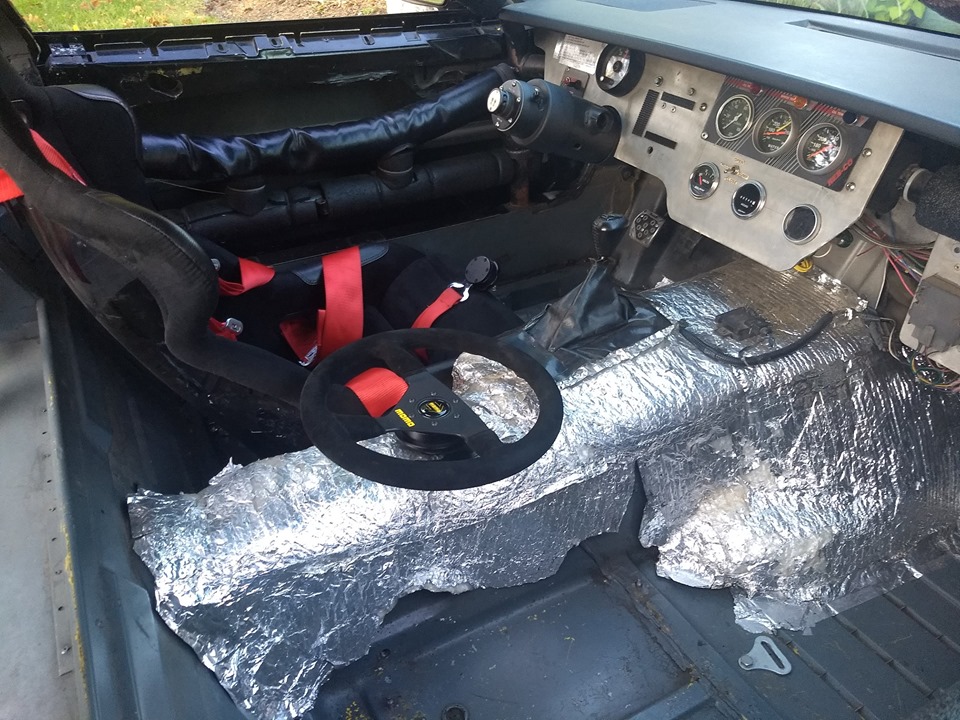

Some roll cage pics
From a Vette racing in ChampCar:
From a Vette that ran SCCA ITE - Nonnemaker
From Vorshlag Vette built to run NASA

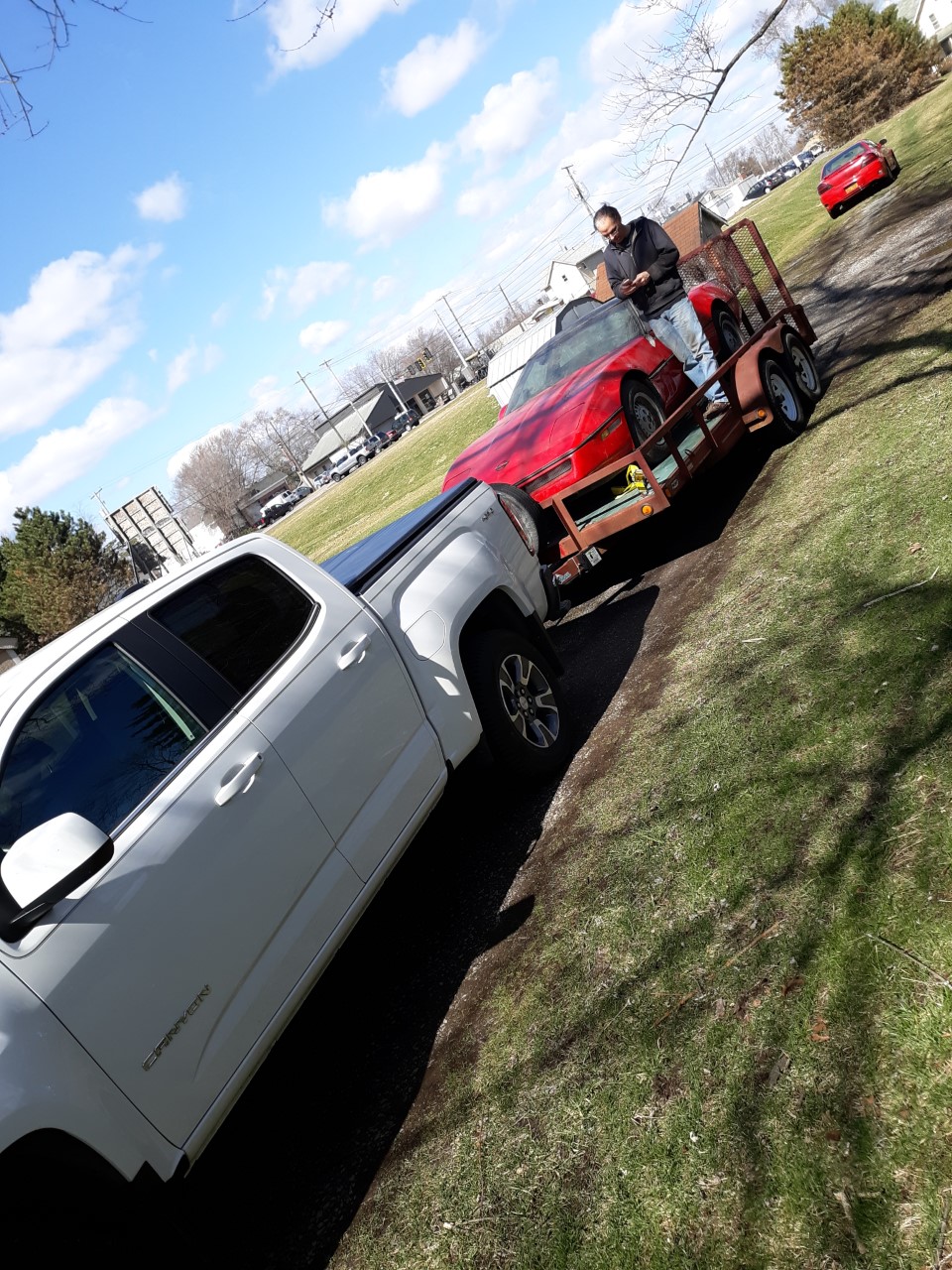

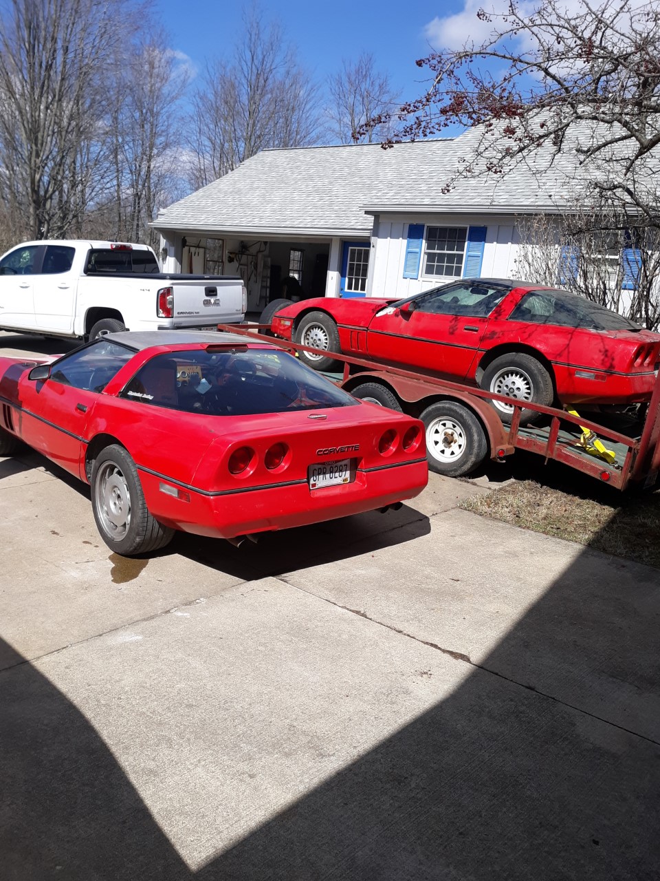

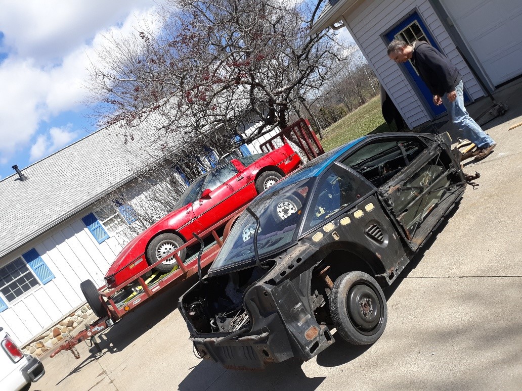

Re: 89 Corvette Mostmint #39 (Parts Car)
32V and the jimmy spent Friday the 13th with the MintOne.
Completed the Saturn parts car stripping and push it out to pasture.
He found an exact match to the Corvette Race car and had to have it.
Fun loading up, does not run.
Twins.
Twins.

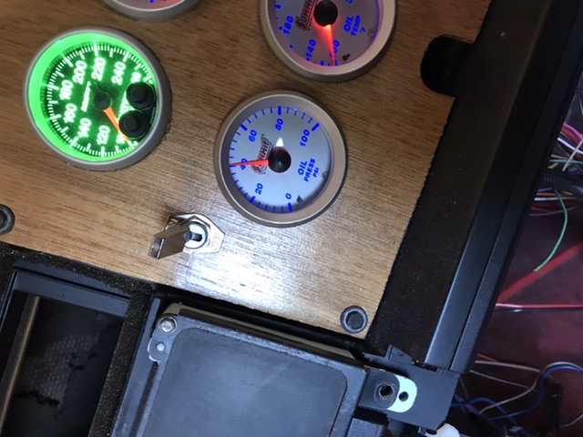

Posts: 3037
A tale of two gauges.
The electrical gauge was way off and eventually quit giving me a pressure reading so I went to mechanical and Obtained a replacement sending unit for the electrical.
So today I started it cold and got a reading on the mechanical. 30 minutes later the electrical was installed and I took a reading with it.
Which one is right? Ugh

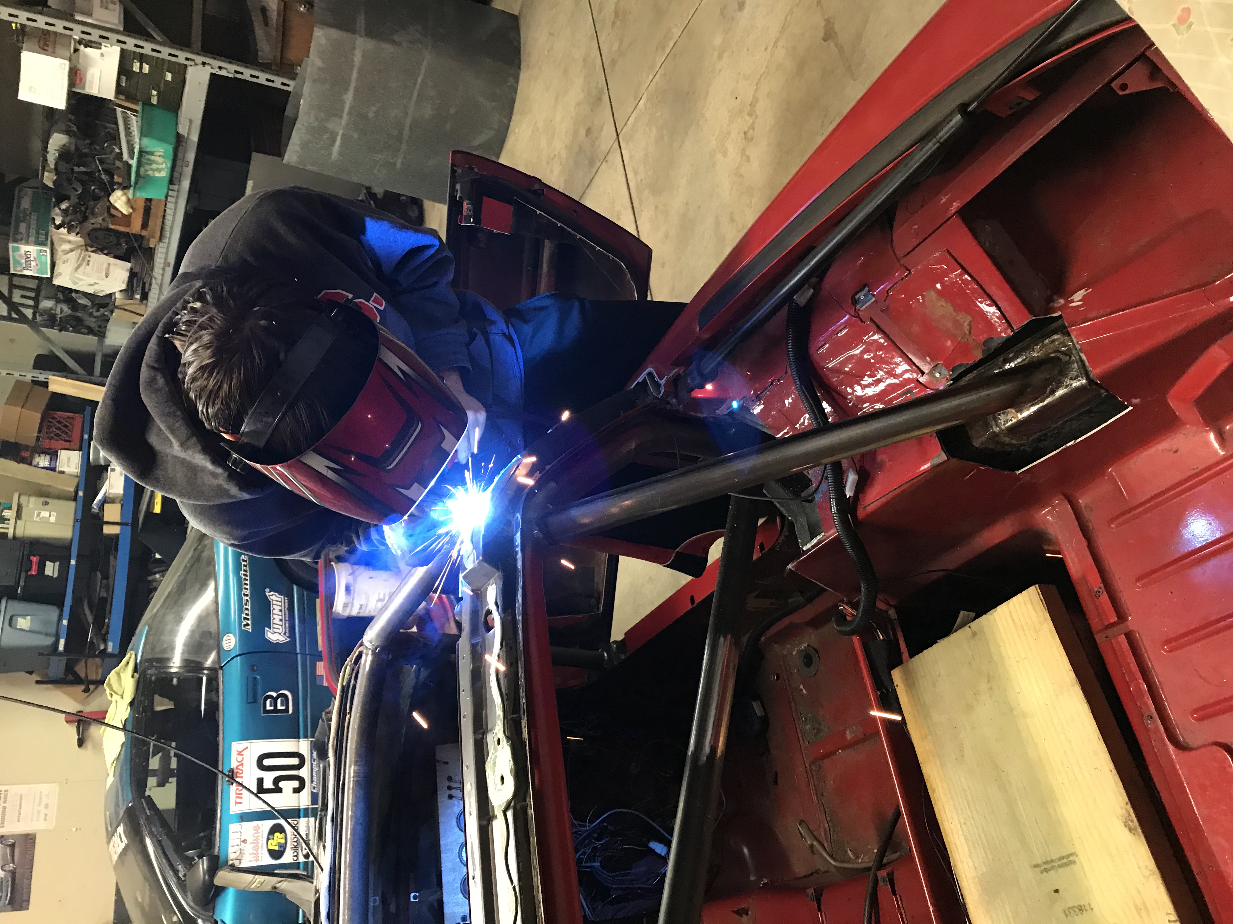

Lots of progress since last update. Biggest is roll cage which is at least 2/3 done. Still need door bars, dash bar, should belt bars. Also going to have one bar inside front to back at center of the targa top.
Posts: 3037
• Roll cage:
o Roll cage about 2/3 done: Base plates are fabricated and welded in. Main hoop, main hoop cross brace, front legs running from near A pillar base up to main hoop, halo hoop, back supports for main hoop are fabricated and welded in
o Fabricated the car to fit the cage also about 2/3 done: Removed rear hatch, fabricated new attaching hardware to allow install with main hoop in place. Temporarily removed fiberglass panel covering the B pillars and top of factory main hoop – trim this panel to accommodate roll cage bars. Cut access holes in the main hoop to allow proper weld of roll cage bars, and subsequently welded them back into place
o Other details: Painted the bars in the sections that will be hard to access once installed. Much time spent cleaning metal to prep for welding, and cleaning up metal from cutting and grinding. Remove trim from targa top and A pillar
o To do: Door bars, dash bar, seat belt bar, extra top bar need fabricated and installed. Fabricate method to attach targa top to the roll cage since stock brackets removed to fit roll cage. Fabricate covers to close up the holes in the fiberglass where roll cage is now attached to the frame
