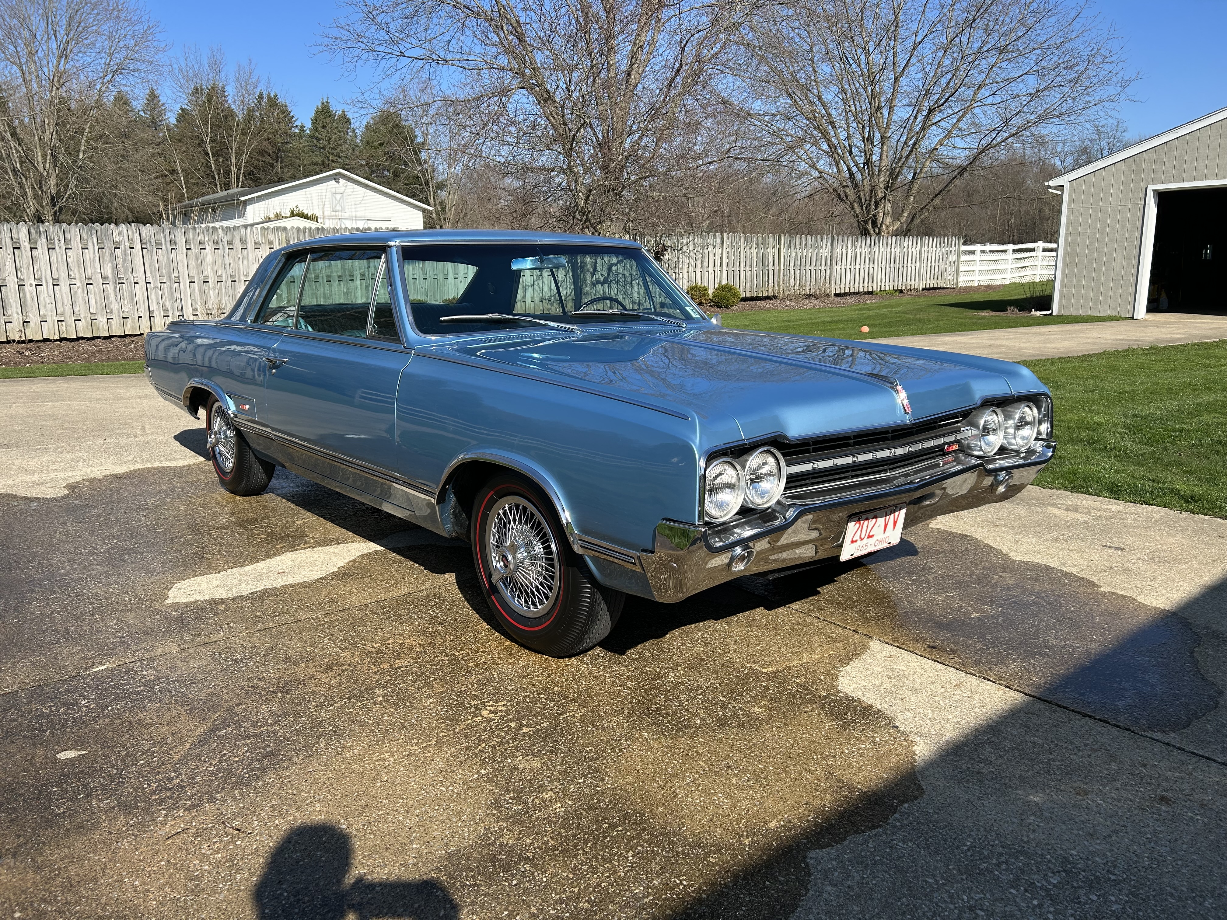

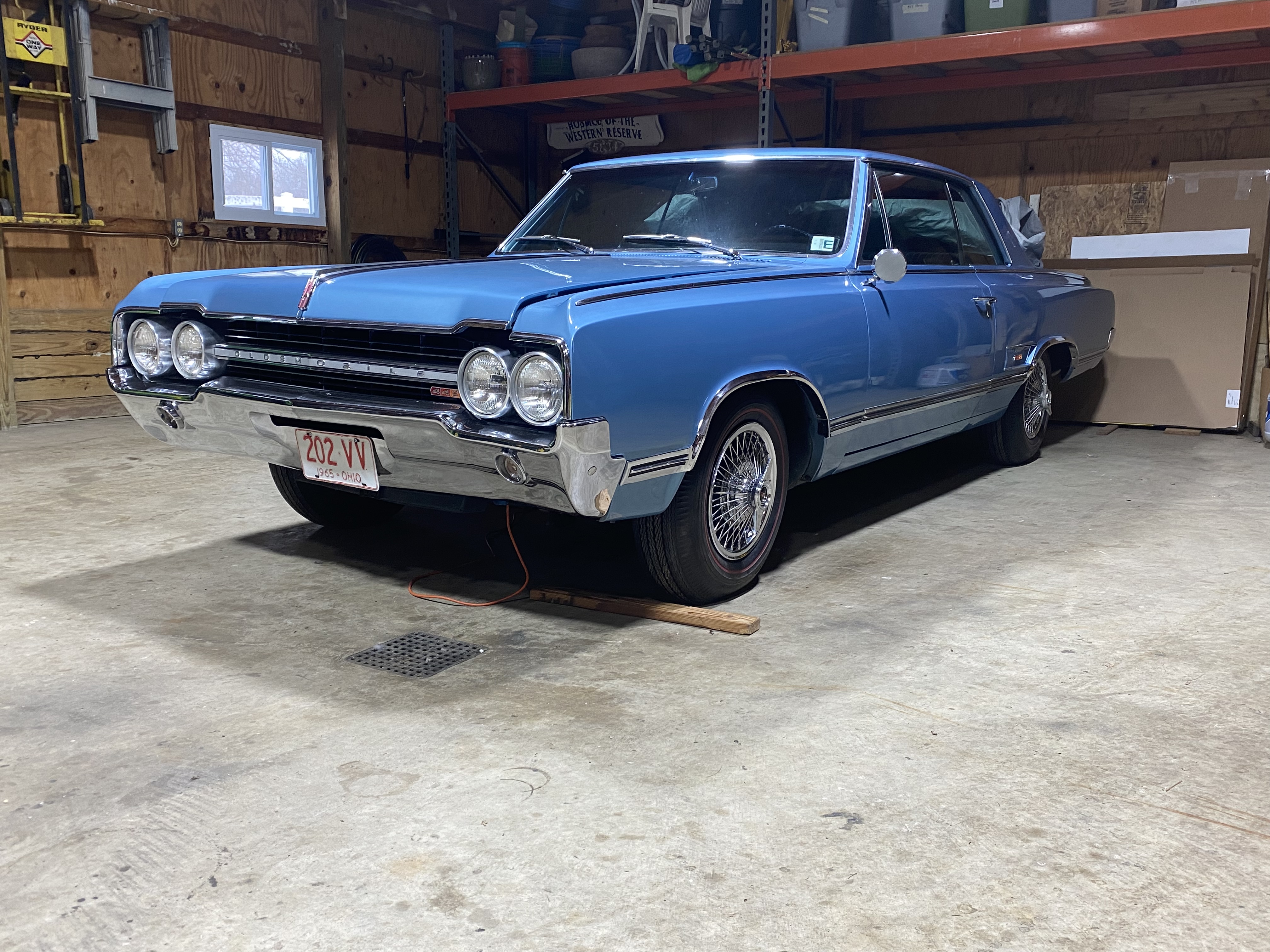

40,045... Hibernation time. The other day, the weather was wonderful, so I washed up the 442 and got it
ready for winter. It really was a pretty easy task. There were tons of bugs on the front of the car that I
washed off, but other than that, I put a battery tender on it and covered it up. I think this year was a
success with this car. My number one goal was to make it dependable. It is. I can take this thing anywhere
and it does what it's supposed to do. It leaks just a bit and doesn't burn oil. Looking forward to next year
as to what I should do, I find a small list. I have valve covers that are stock painted and waiting on the bench.
It's a matter of installing them. The factory original 442 carb needs to be rebuilt. I have the kit. I scored a
set of redline tires last week. I found a guy who wanted to purchase my old 442 3.90 rear end. Part of the
payment was a set of (bias ply) redline Firestone tires. I have 14" x 7" steel wheels ready to go, but the tires
call for 5" or 6" rims. I have to find those still. I also have to find two more spinner hubcaps to complete my
set. I have all winter to figure this stuff out. I'd like to remove the motor and get it painted, and I'd consider
a camshaft upgrade, but I'm not sure what's going to happen with those two things. For now, I can feel pretty
confident that, come springtime, I'll be able to start up the car and go.

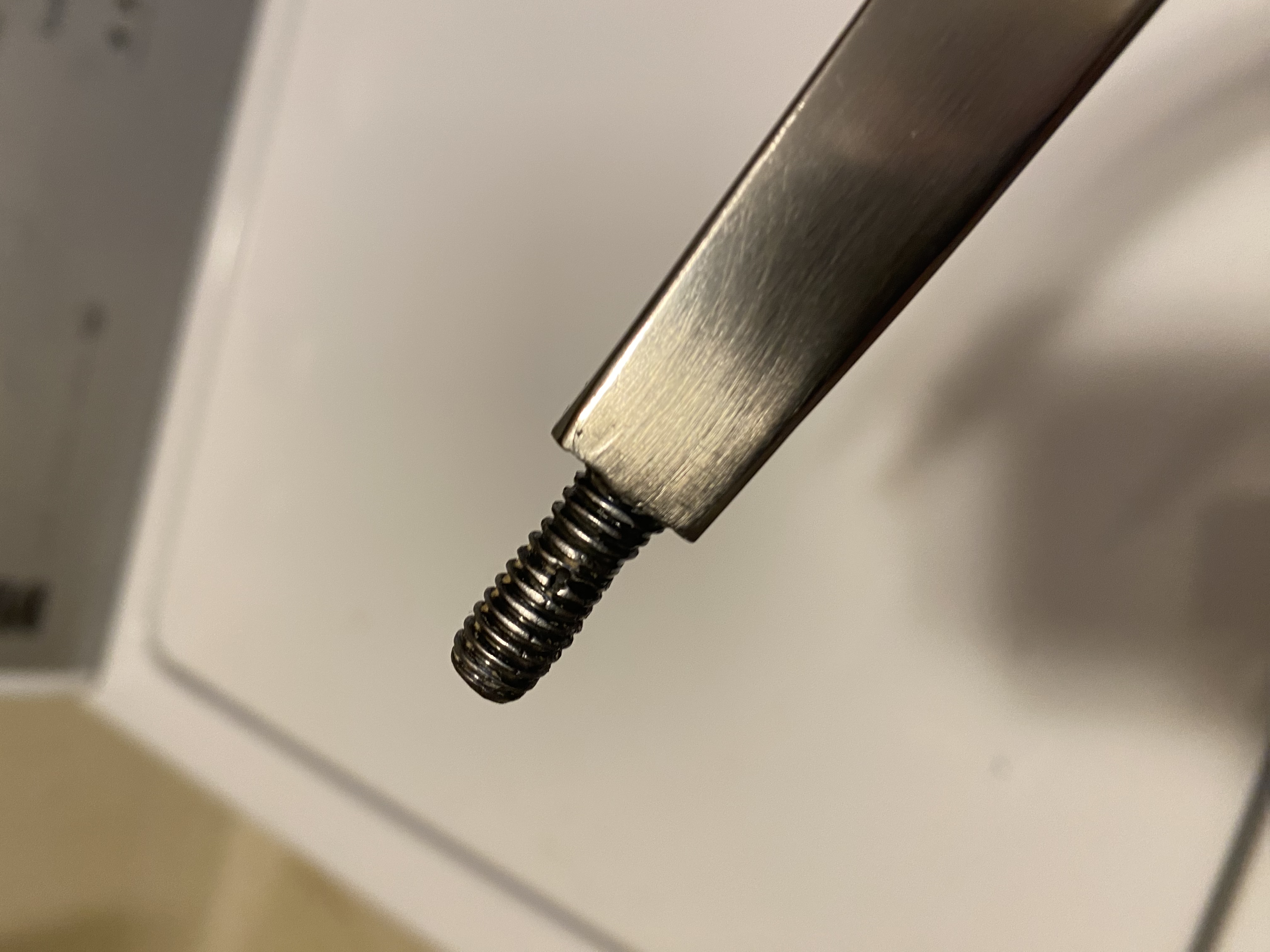

442 Shifter Lever Project
I’ve searched around for a factory shifter lever for the 442 since I’ve owned the car. The lever that’s in the car works fine, but it’s not correct for the car. I was able to score a decent shifter lever for $135 shipped to me last week. The lever I purchased looked like someone took a bench grinder wire wheel to it in an effort to remove the rust. The the threading that holds the ball on was a bit marred up as well.
I decided to jump on it, as it’s the cheapest one I’ve seen for months and months. Typically, these go for over $250. I put a bit of work into it and it turned out pretty sweet! A die on the threads cleaned them up enough where a nut holds tight to them. I spent a couple of hours with my bench grinder wire wheel, steel wool, scotch-brite pads, sand paper and rubbing compound to get the end product I have now. ( I finished with wet sanding 2000 grit then power buffed it.) A coat of clear gloss paint sealed it off and will protect it from rust. It doesn’t shine quite as good as chrome, but it’s a solid 90% of the way there. I have over three hours in this thing, but it was worth it for the look. I’ve ordered the correct thread ball and an adapter to adapt this Muncie shifter to the Hurst Competition Plus shifter linkage in the car. I’ll post those pics when the parts come in. More to come!

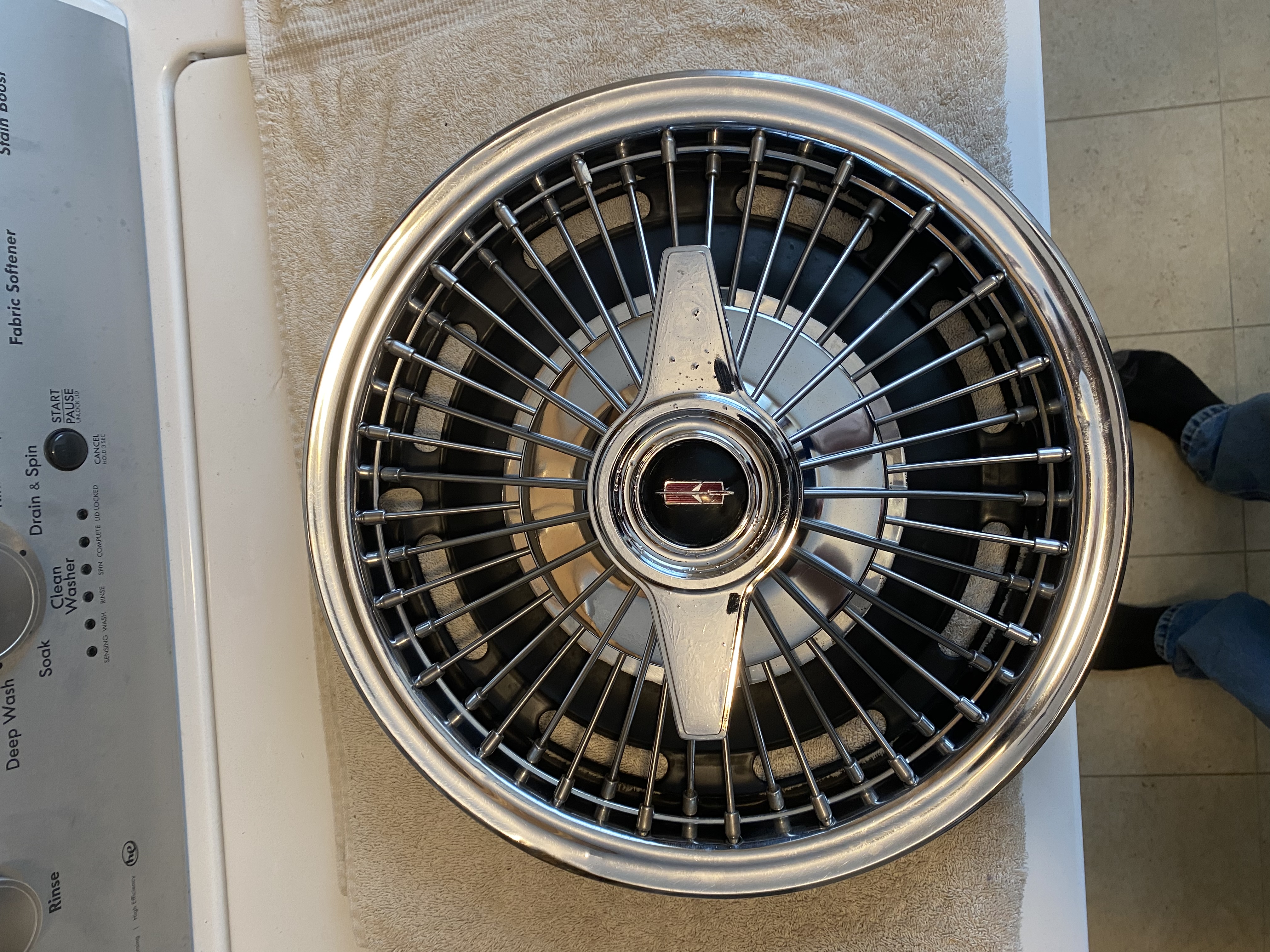

Spinner Hubcaps
Over the summer, for $30 I purchased a box of 2 bar spinner hubcaps from a local guy. In the box was enough parts to make one complete hubcap and then a bunch of miscellaneous other stuff. I made the first hubcap out of the parts on the day I got the box. A couple of weeks later, I took my wall-art 1966 hubcap off of the wall and, with the parts in the box, was able to make a second cap. A couple of weeks ago, I scored 2 more hubcaps from a ‘64 Cutlass on EBay for $80 shipped to me. To make them into ‘65 caps, I went back to my trusty parts box where there were two correct Olds emblems. I was able to convert the ‘64 caps to ‘65 caps to complete the set. Also in the magic parts box was a nearly mint spoke hub that was used on one of the EBay caps. A bit of paint, some elbow grease and about five hours of my life later, I have a very decent driver quality set of two bar spinner caps to install with my redline tires. ( I spent the time to make them all the same. The rocket emblem aims at the valve stem on all four now.)

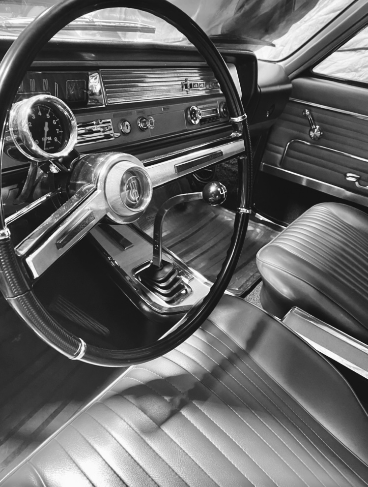

I’m a bit tardy on the post of this, but a before the new year, I was able to get the shifter installed in the 442. It looks and feels great! I think there might be a small amount of tweeking that has to happen to make sure that it’s just right. The “A-Dapter Kit” that I used to make the Muncie shifter line up with the Hurst linkage is making the bottom of the shifter contact the inside of the rubber console boot. I think I can modify the bolts that I used and grind some rubber off of the grommets that are between the kit and the shifter itself and loose about a half inch, which would be perfect. My concern is that it might pop out of 2nd and 4th gear the way it is. It’s hard to say with the car stationary in the garage. I can deal with this in the spring. It takes 15 mins to get the seat and console out, so it’s just a minor job to get to it. Here are some pics of it in the car, new black shifter ball installed.
Steel Wheels
In order to install the redline tires that I’ve acquired, I have to have 14” x 6” rims. I had a nice set of 7” wide rims, but they were too wide. A bit of a horse trade got me three 6” wide rims with 4” backspace. I found a fourth on Craigslist locally, so I was able to have a complete set. It was way more difficult to find these rims than I thought it would be! Everyone must’ve scrapped all the steelies! Anyhow, a quick cleaning, sanding, prep and some new 2" valve stems got me a really decent set to put the redlines on. I should have the tires mounted on the rims and the whole set completed and in my possession this week. I purchased stock lug nuts online and they’re enroute to me as I write this. Soon, I’ll have the spinner caps with redlines on the car.

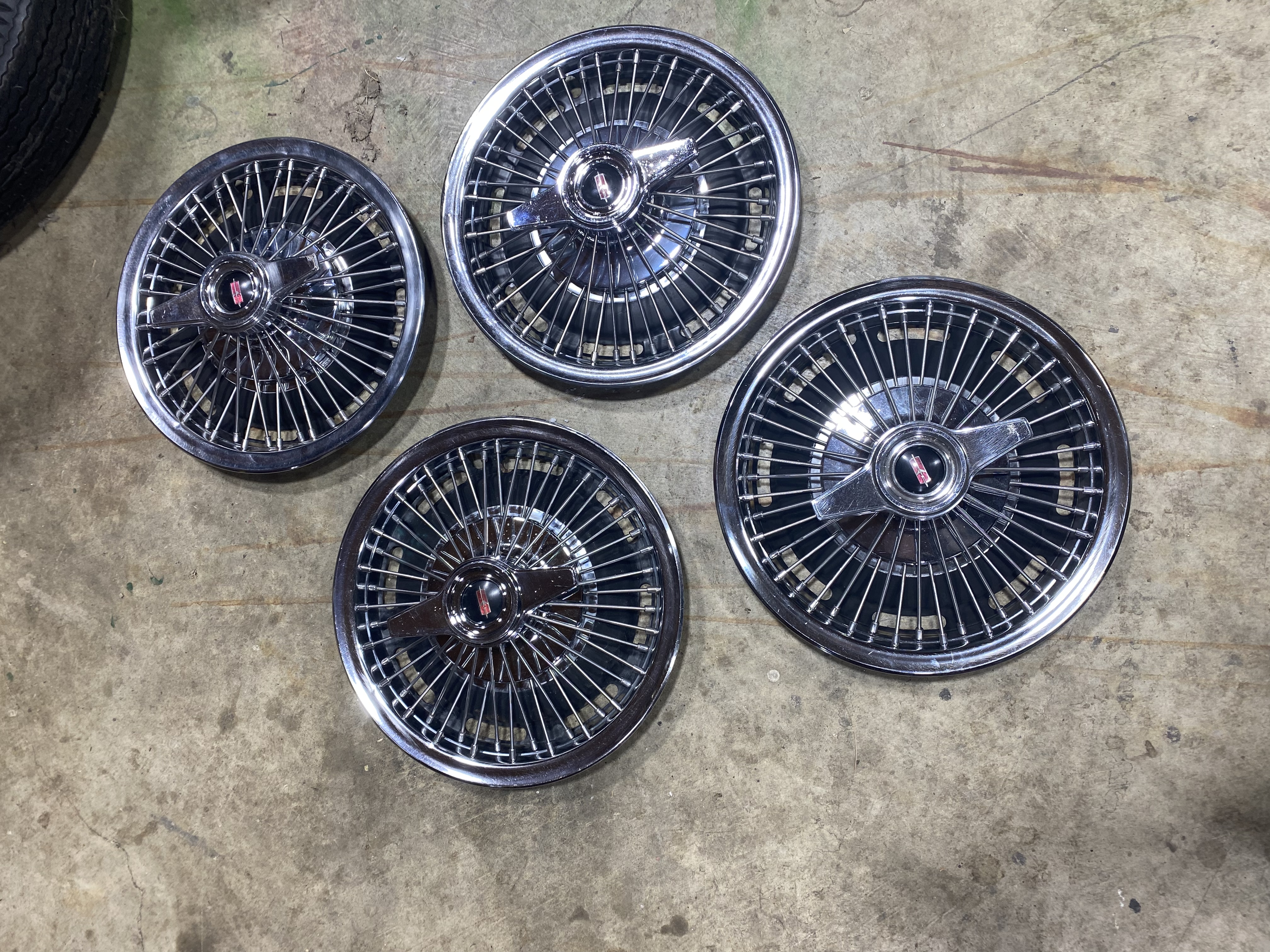

Redlines / Steel Wheels / Spinner Caps
So here’s the final outcome of the redline tire project. The tires and caps are factory stock look for the ‘65 442. The 7.75 x 14’s are narrower and taller than the 225/70/14’s I took off. The tires look pretty good, but need a good cleaning. If the weather had been a bit warmer, I would have taken the tires out and cleaned them, but it was right at 32 degrees and I wasn’t up to freezing yesterday. I put new lug nuts on while I was at it. I can’t wait to feel the bias ply and skinny tire feel! I’m going to hold on to the chrome wheels and RWL tire combo for a bit. I might want to go back and forth between the different tire combos.
