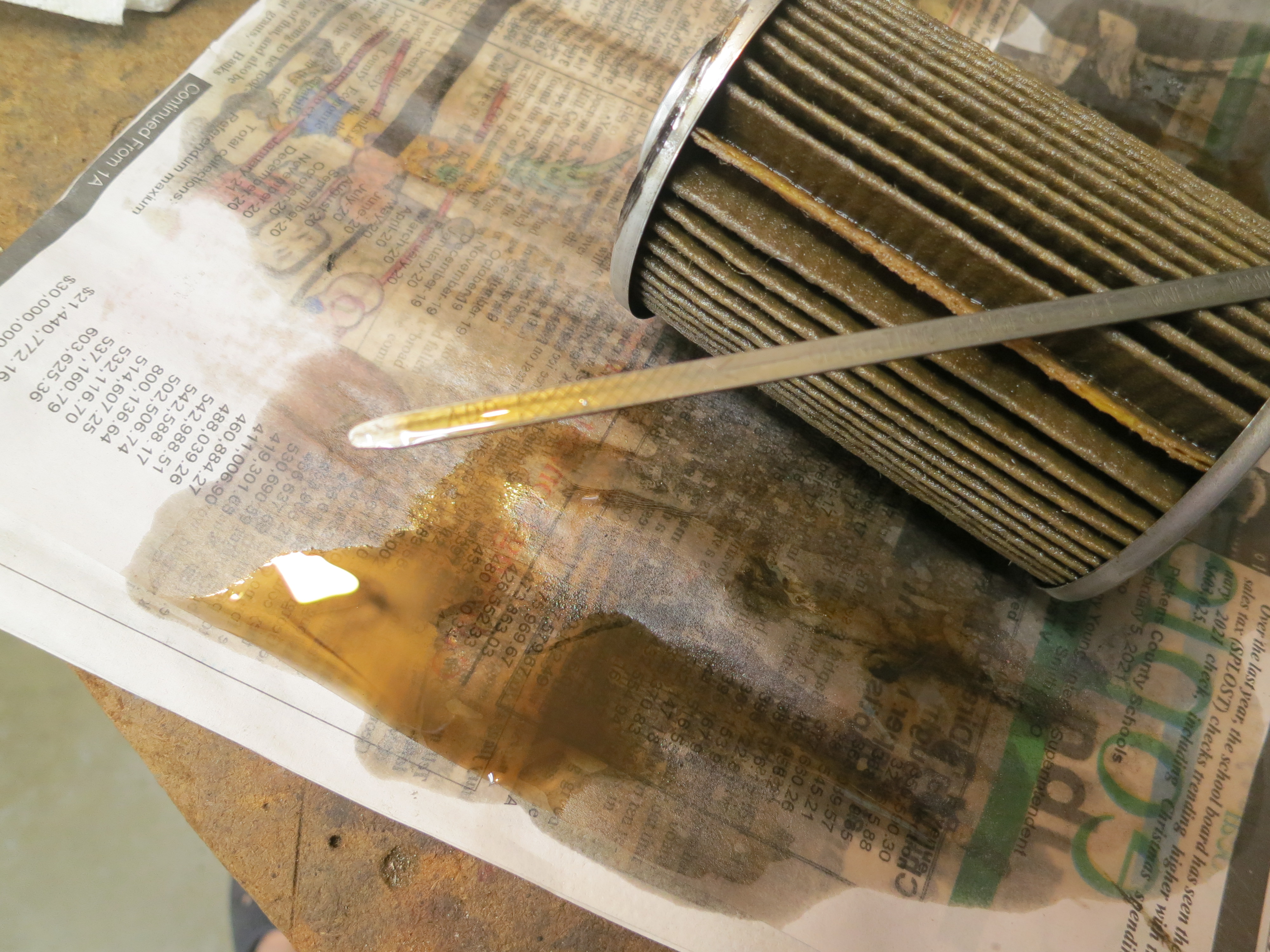

I just had to know what was inside the oil filter so I removed it and cut it open for a look. It didn't occur to me until after I had it open, that I probably shouldn't have used a cutting disk to open it since I'm looking for metal shavings inside. Regardless, here's a video I made to give you guys a look. I've never had an opportunity to examine the inside of an oil filter for signs of problems, so I welcome any and all comments about what you see here. https://youtu.be/V4tDaOX5JmE
To give you some perspective, this picture shows what I observed. The oil from inside the filter is a cloudy brown color just like you see on the filter, while that on the dipstick is clear with only a very slight of color.
The contrast shows really well how much contamination a filter removes from the oil. I see no good reason to change the oil at this point. I think I will just put on a fresh filter and call it good.
Posts: 3032
There would be little chips of metal between the pleats and or metal in the filter cup. We are talking very fine metal in the cup like grains of sand or smaller.
The big tells I discussed I can’t really see in the video
I just examined between the folds with a lighted magnifying glass and I see zero debris of any kind. I'm discounting the chips in the filter cup because of the cutting wheel I used.
Posts: 3032
good. i am pretty confident the bottom end is good to go.
after 3-4 years of sitting I would change that oil though, for many reasons. when was it last changed, what kind of oil was used? IDK maybe you got service records from prior owner. I have no facts here - mine was full of water presumably due to leaving the hood open - but the same condensation situation for the fuel tank may have put some moisture in the oil.
I forgot to mention that the seller told me he had changed the oil just before the sale. When I checked it then, it was crystal clear so I believe him. I was hoping to use the current oil for a short time. I want to add some SeaFoam to it to help clean things out and possibly stop the tapping noise. Then I'll do a fresh oil and filter change again.
