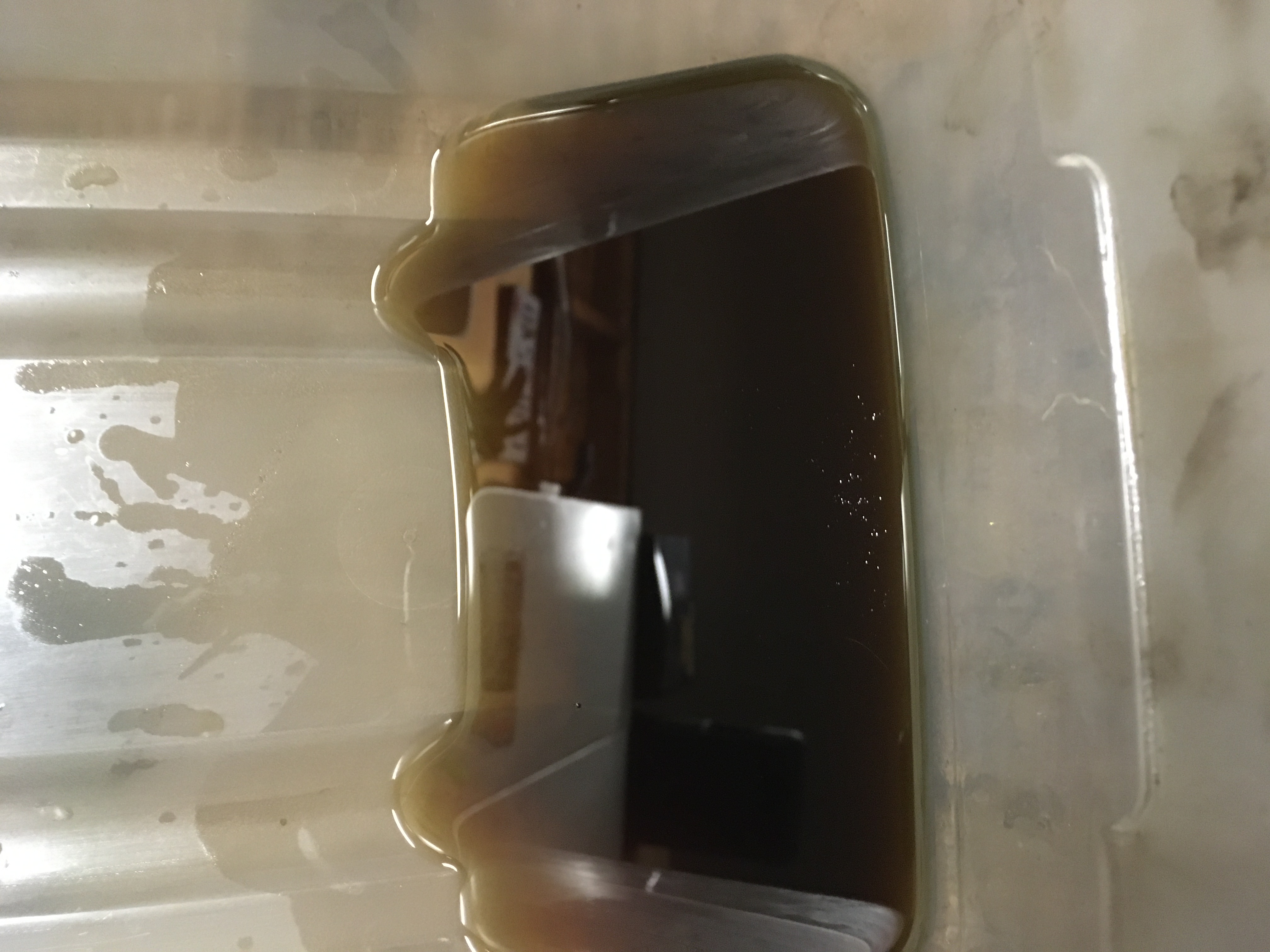

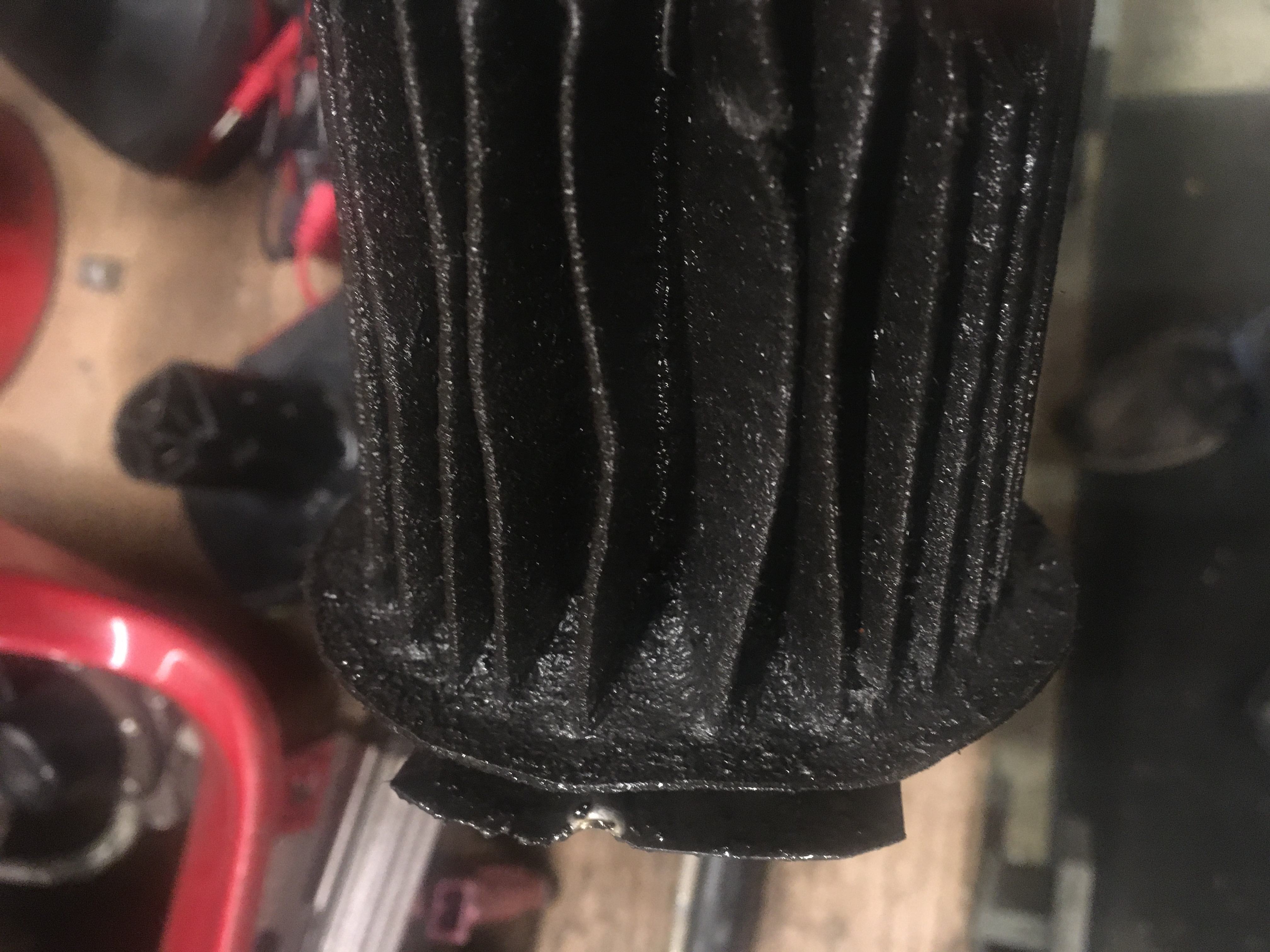

* cut open the oil filter - no metal shavings at all but yikes there was a bunch of carbon in there

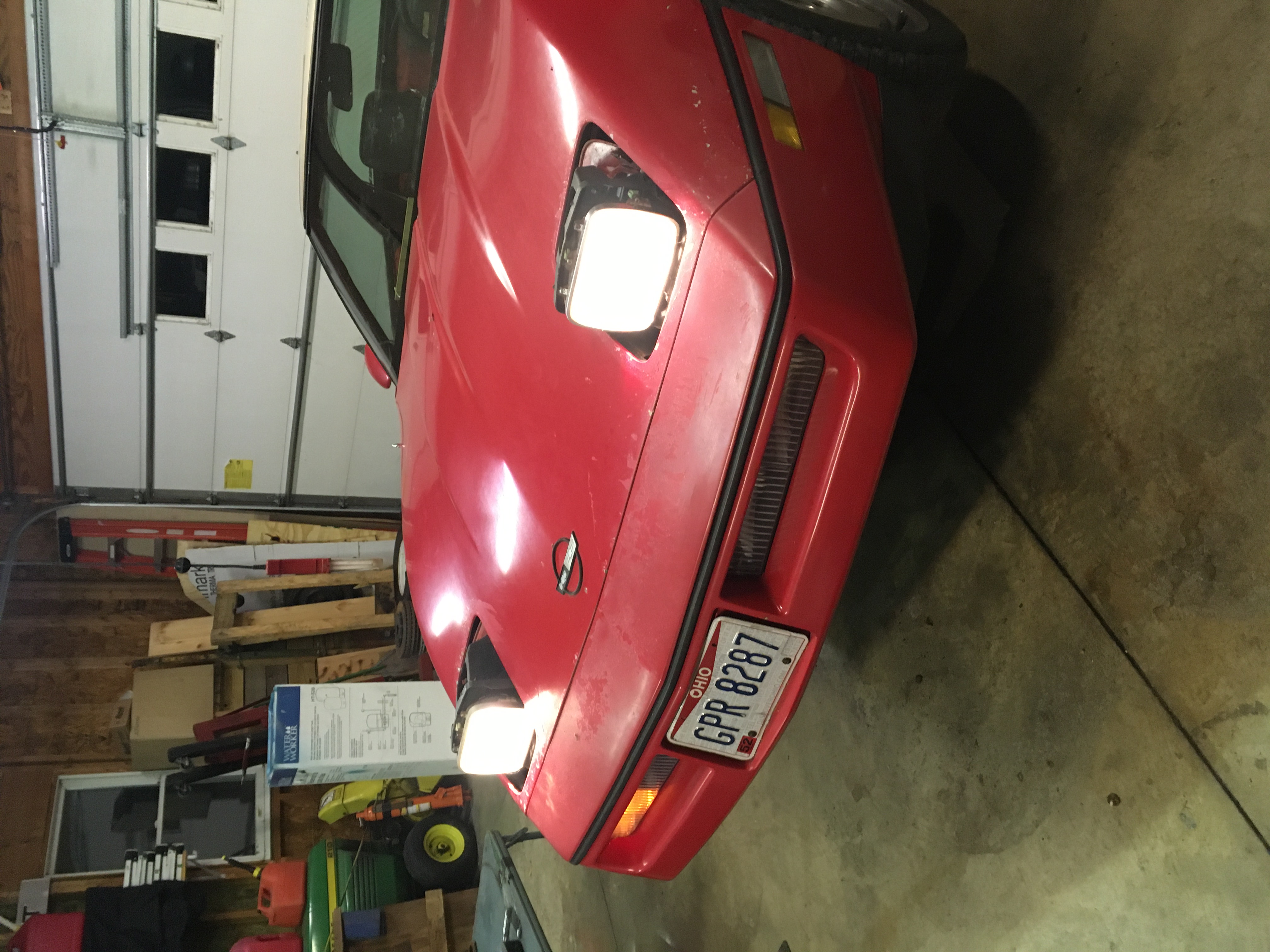

* fixed the headlights - the low beams are burnt out I needed to replace the RF adjuster it was rusted so I can point the bulbs lower. Test drive got no high beam flashes from oncoming traffic so it must be OK

Please tell me that oil filter was left over from when you acquired the car. That can't be a fresh one after the engine work you did? Any thoughts on how all that carbon happened to be there?
Posts: 3038
Re: 89 Corvette Mostmint #39
wxo wrote:Please tell me that oil filter was left over from when you acquired the car. That can't be a fresh one after the engine work you did? Any thoughts on how all that carbon happened to be there?
That filter was brand new. Thing is this is the backup engine that I threw together so the car would run. Truck heads and cam, replaced the valve seals and the crank bearings, and fixed one of the valve seats. None of this engine was tanked I just cleaned the gasket surfaces and reassembled it. I underestimated or forgot how "unclean" it was on the inside. I may have aggravated the situation by scraping off some of the carbon buildup then doing an inadequate job cleaning it up, not to mention detergents in the fresh oil and all that extra heat loosening things up.
The current oil filter will be on there for maybe 100 miles then I will change it again, and repeat until it stays clean.

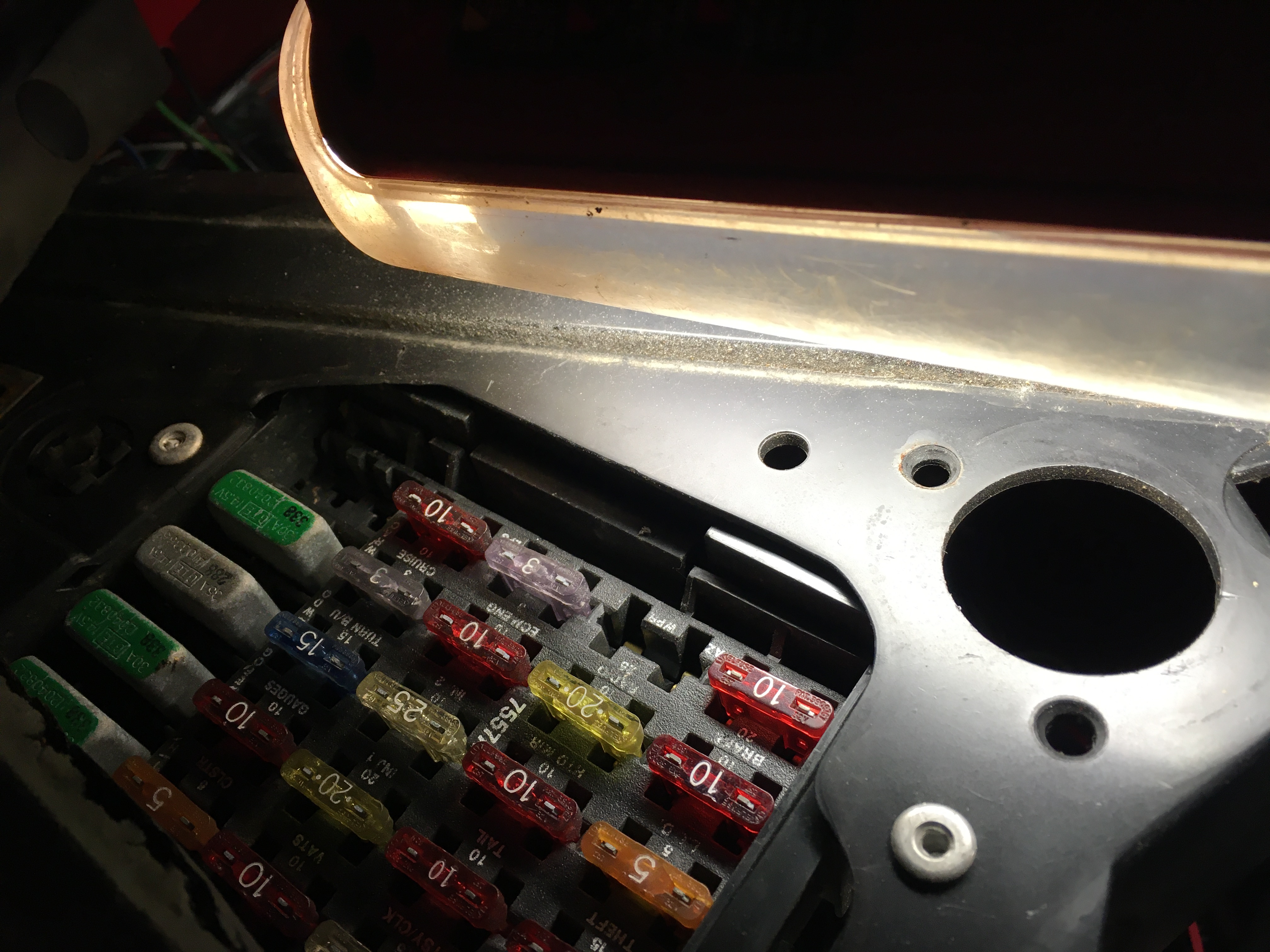

4) Fixed the windshield wipers - spent a bit of time reading wiring diagrams. Step #1 was check the fuse. Fuse was missing. Installed fuse and fixed the problem

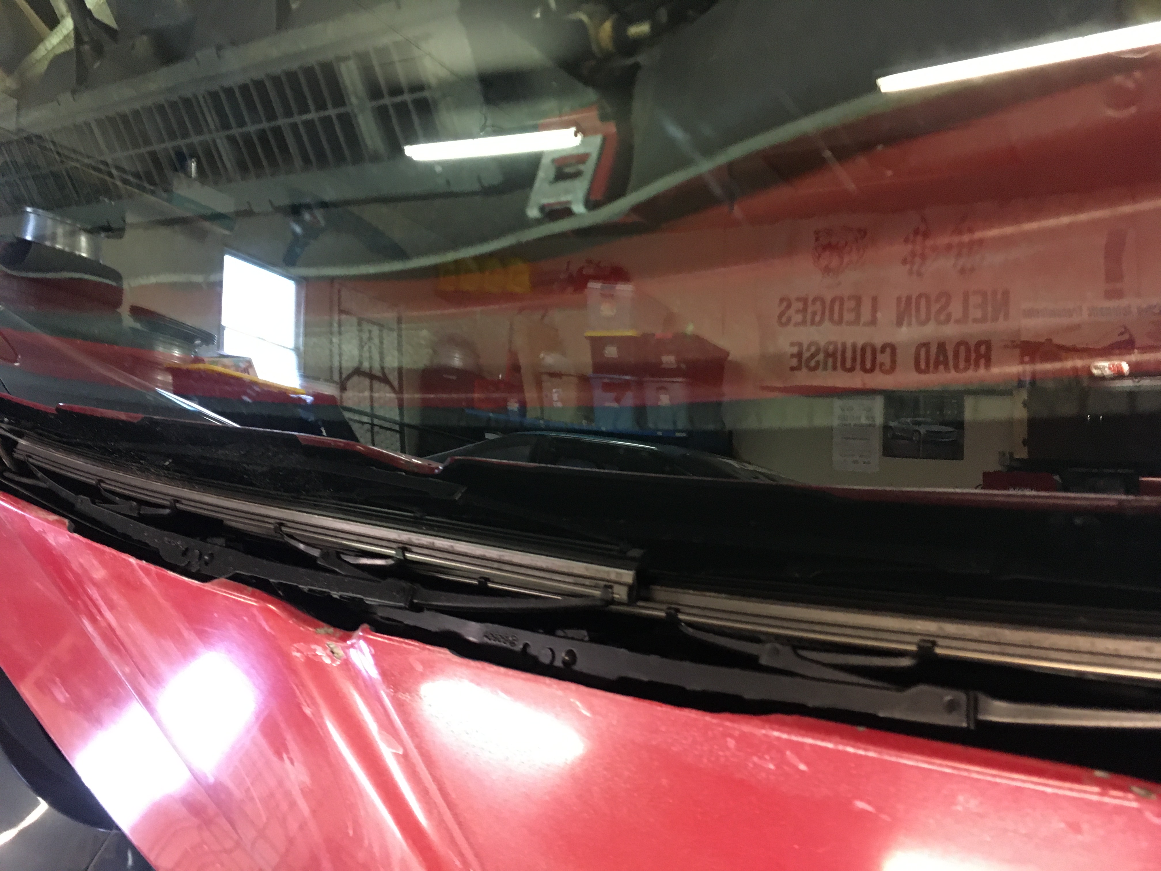

5) Wipers do not clear the hood. Raised the hood but still hitting. Note to self: get lower profile wipers next time. In the meantime I ground a bit off the rear lip of the hood to make room

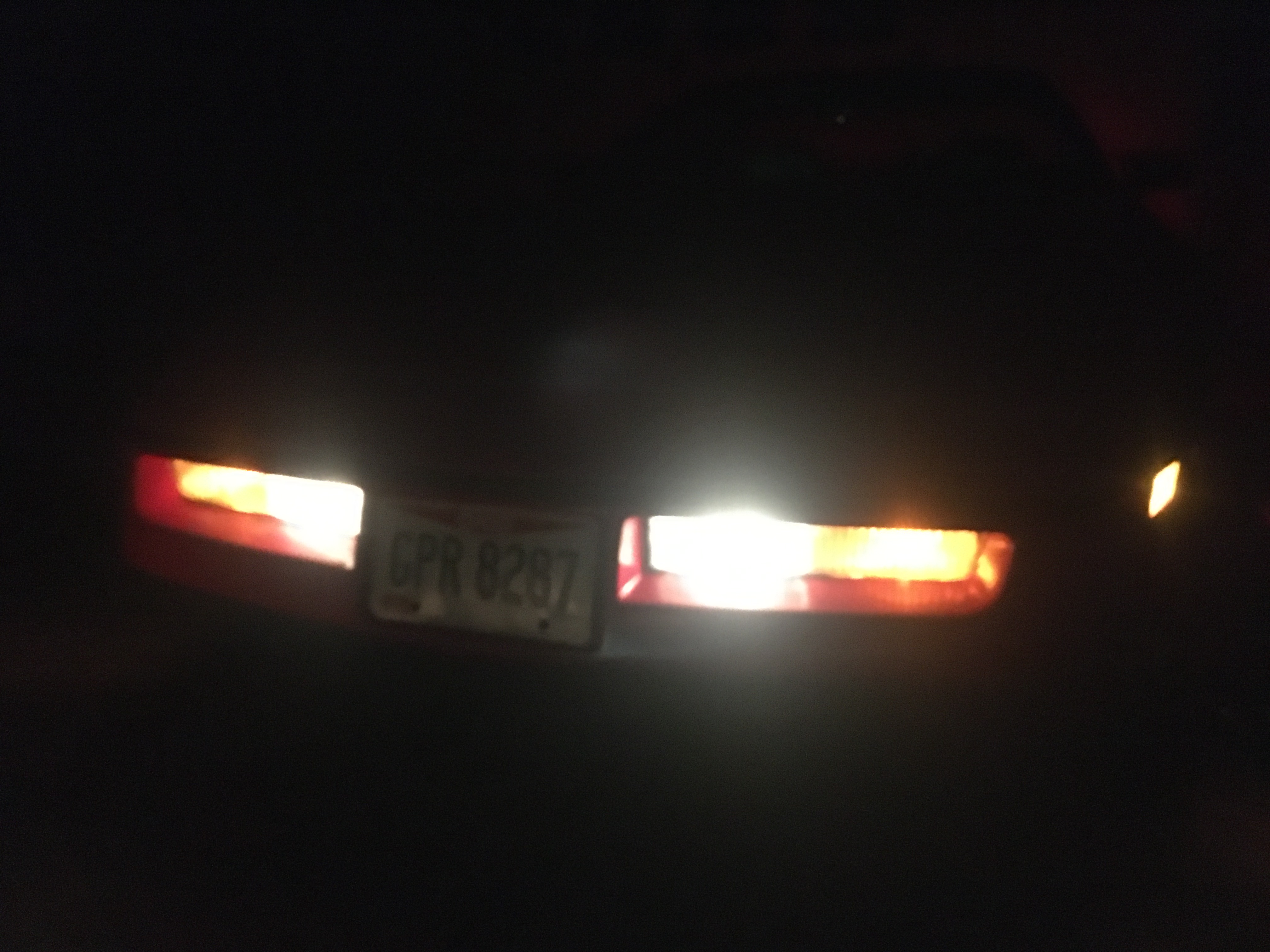

6) left front marker light out. Took some debugging to figure out the ground connection in the socket was bad. Replaced the socket with a spare from Saturn inventory - even the wires were the same color! I am still trying to figure out how the prior owner managed to break that little tab? His legacy is leaving the car one item at a time.

doh!  fuse missing
doh! fuse missing
wipers now fit!
wipers now fit!
socket bulb ground tab broken
running lights back on line.  I really hate when the lights don't work

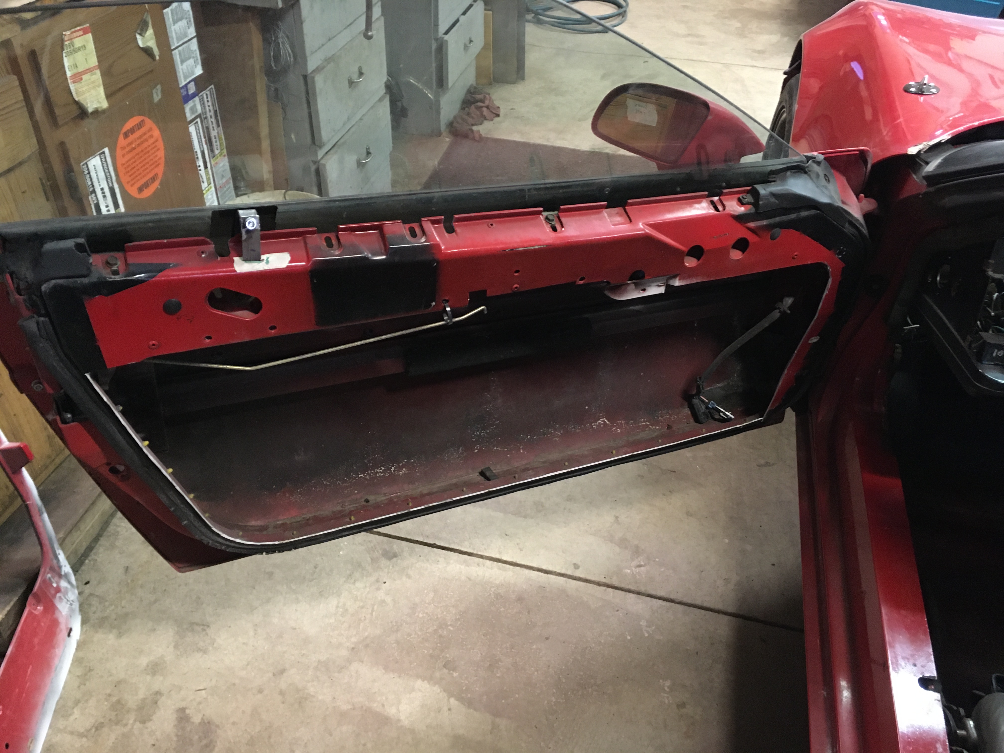

* removed the power window mechanisms and set up a method to install the windows for storage and driving around on cold days. The windows, mechanism and wiring was 37 lbs

* got the wipers working it was just a fuse lol

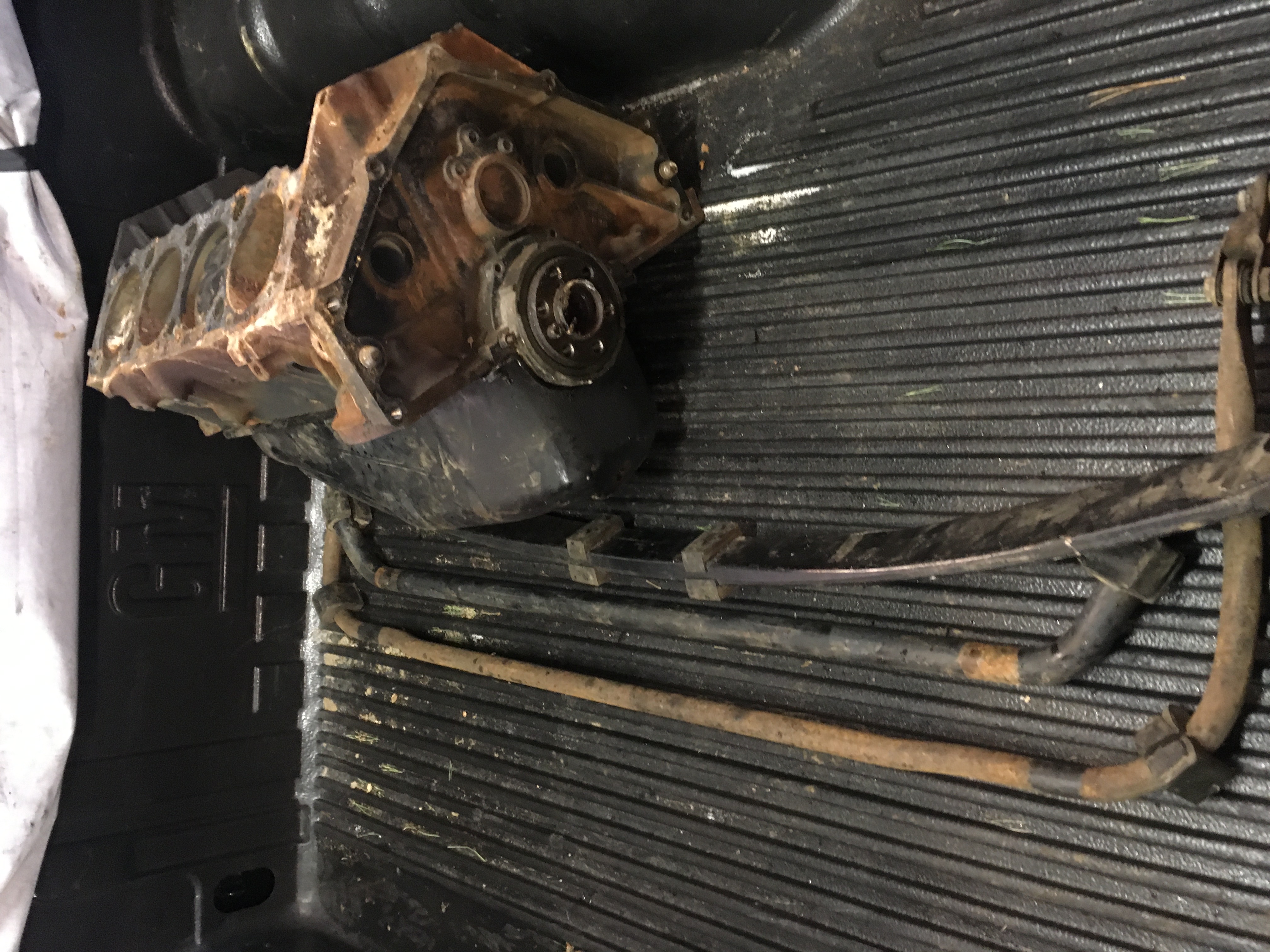

* Acquired the rest of the engine where the heads/distributor came from. It was a flood car which seems to have wrecked the pistons but inside the crankcase was clean which means we have the roller cam, lifters, pushrods and other supporting hardware, oil pan, factory oil cooler, flex plate.

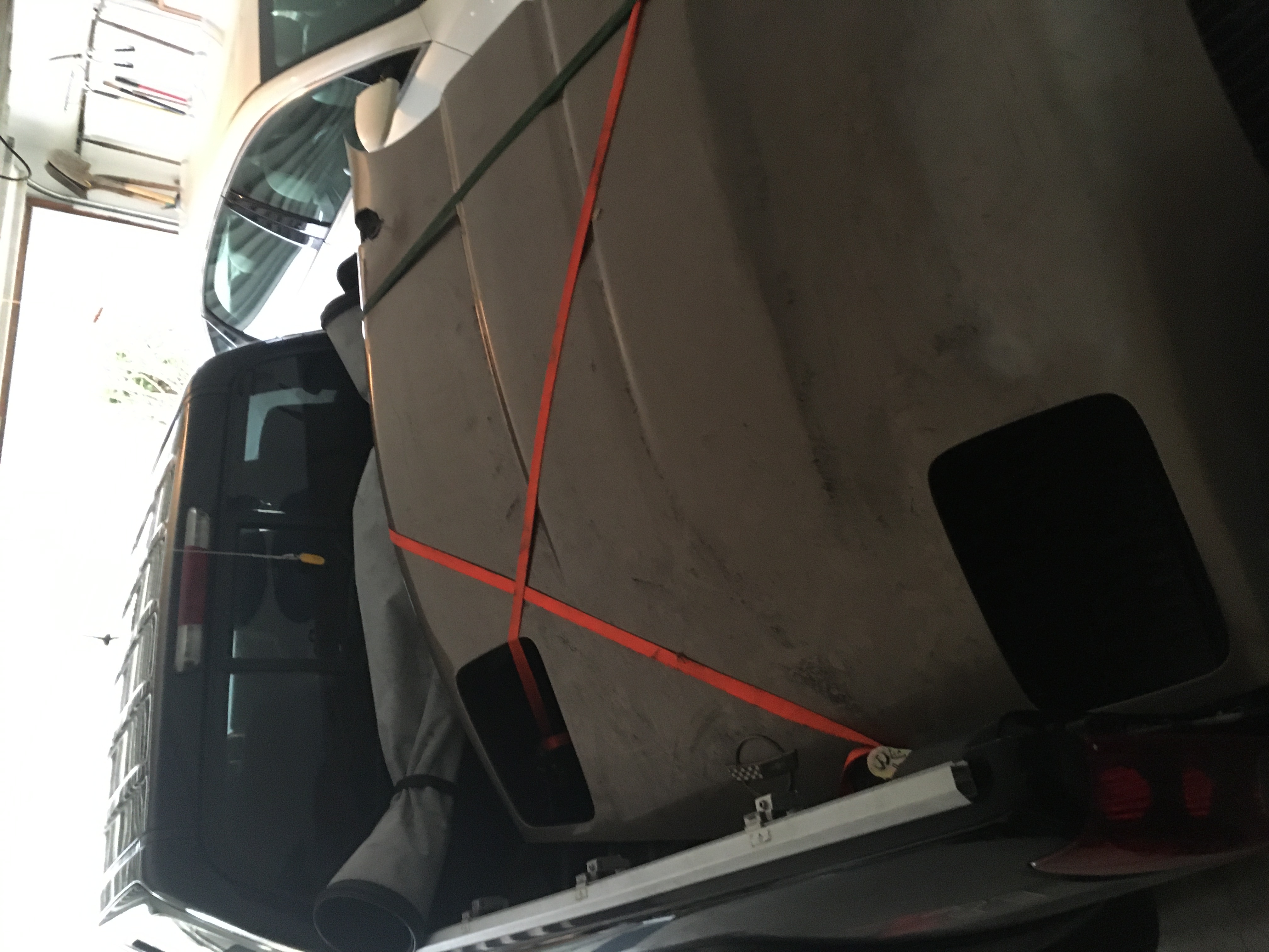

* Acquired a spare hood - it has a hole in it as often happens when the latch seizes up someone cuts a hole. It was cheap and I want to experiment with aero by cutting holes in it for improved cooling and reduced lift on the hood

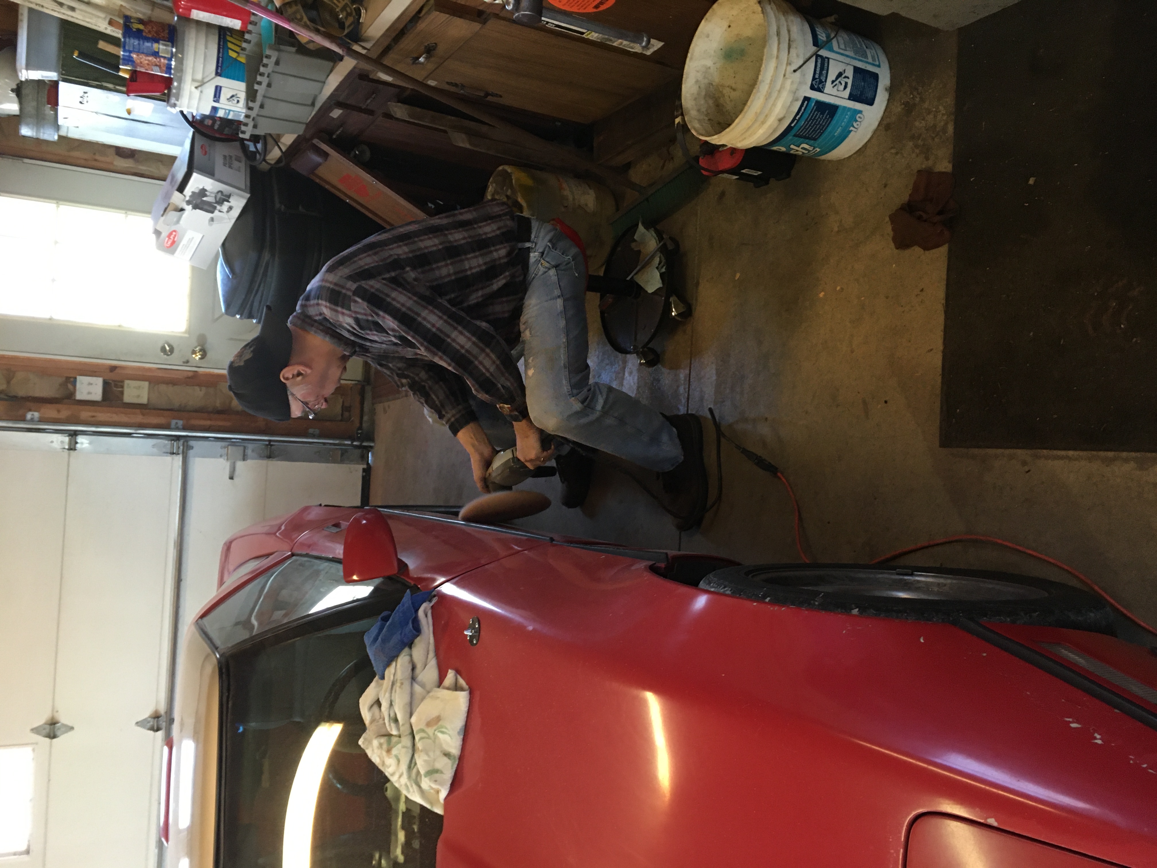

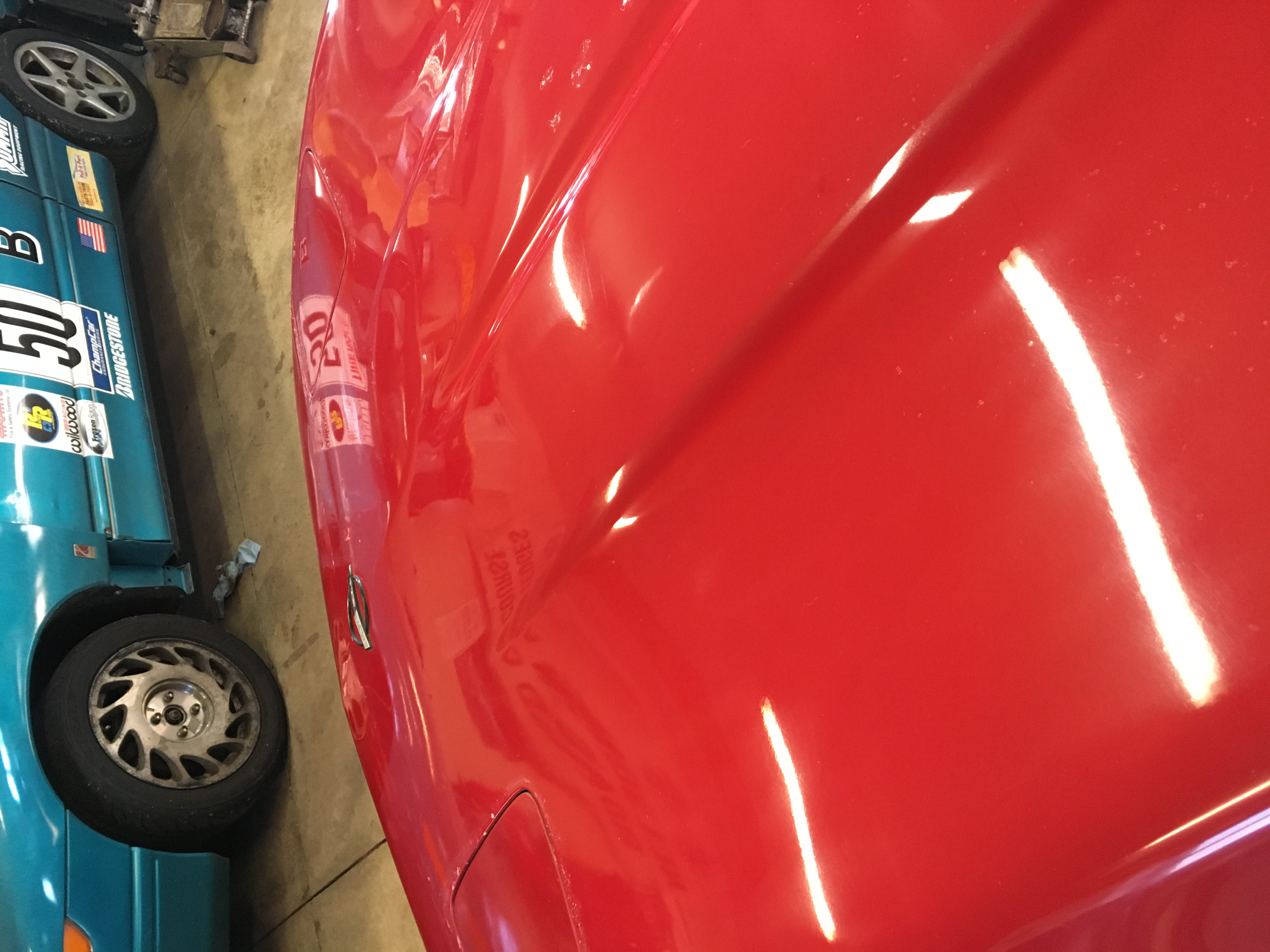

Today Fred32v was over and we went to work on the paint. Lots of improvement!

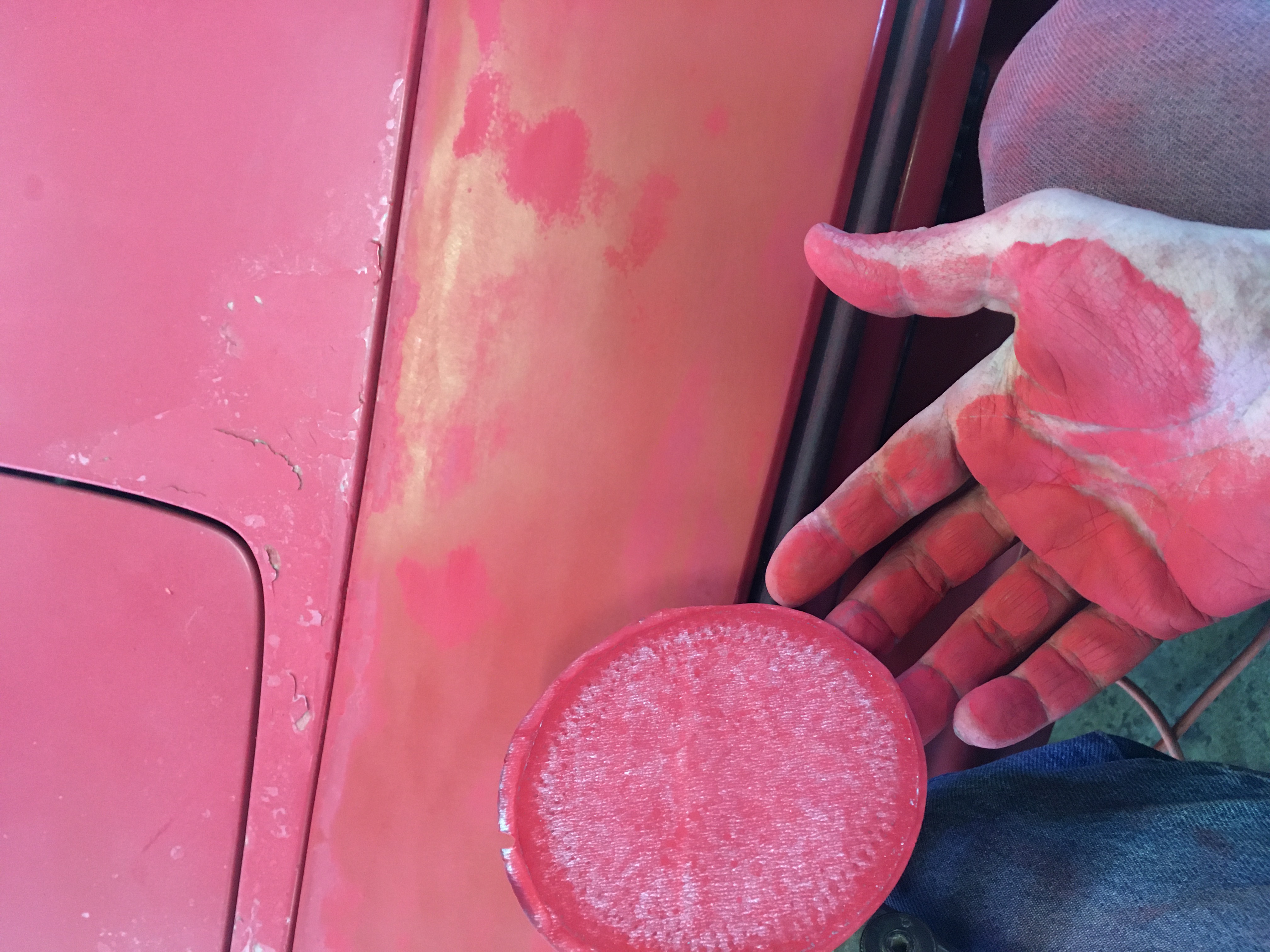

On the front bumper cover and the right rear, the clear was failing so I sanded it off with 320 and we buffed it with DRX-16 buffing compound
A fifty year old buffer with 25-30 year old DRX 16 and some equally old glazing compound.
It was what was available and the finish was so incredibly bad there was nothing to lose.
This polish job didn't real make the Vette faster, but it surely helped improve the motivational factors.
A rewarding fun time. :D
