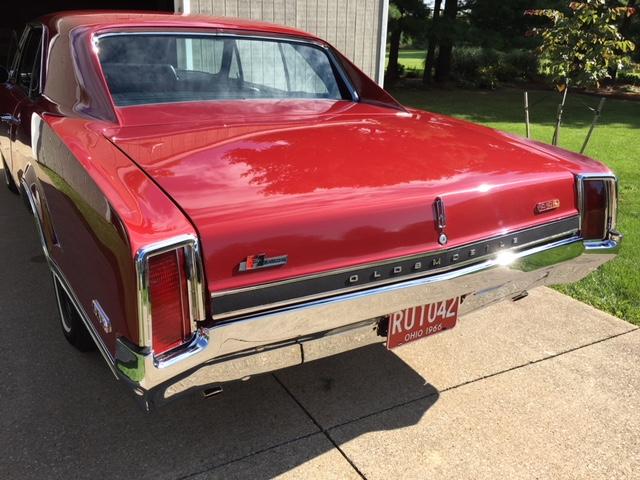

I've done a couple of mini-projects since my last post. I purchased and installed the period correct, stainless
wiper blades. They were $23 delivered to my house, and look 100% better than the stupid black framed ANCO
wipers that were on the car. I also decided to go back to the 7 blade fan. That (because I've done it 30 times )
took me about 10 minutes. I've driven it a bunch since the install and no clearance issues have been detected
at all RPM's. Today I hit the barn early. My goal was to stop a fuel issue. This started last fall sometime when
I noticed, after going to the local car wash rack, that there was some smearing on the rear bumper coming
out of where the reverse lights are. At the time I wiped it off and thought it was just soap from the car wash.
After detecting the issue again after the car sat dry for many days, I knew there was an issue going on. Thinking
that the sending unit was the issue, I ordered a fuel sending o-ring and retainer kit and it showed up this week.
When I went to install it, I realized that was not the issue. The real issue is that the tank has a vent line in the
side that's 1/2". The installer of the tank put a 12" piece of hose on it and just ran it behind the bumper to nowhere,
without anything on the end to hold the fuel back. What was happening was, when I accelerated, the fuel would
slosh out of the tank and get sucked through the reverse light housings. Terrible workmanship. I plugged the
opening with a piece of hose that was capped off and (for this week ) drilled a small hole in the non-vented gas
cap to act as a breather. I've purchased a vented gas cap that looks period correct which will cure the problem.
The gas cap that's on there is junk anyway as it needed a rubber washer on it. It's supposed to have one and doesn't.
While I was under the car, I re-ran the wire for the fuel gauge. The previous installer had it dangling between the
exhaust pipes with a crappy butt splicer in the middle. I ran it along the frame rail and used shrink tube on it so it
is out of the way and neat looking. I crimped the end where it connects to the fuel sending unit because it was loose
and about to fall off. I also adjusted the two rubber fuel lines so they run parallel to each other and are nice and neat.
I cleaned the bumper with wax and removed the smearing residue from the whole bumper. It looks great! I also adjusted
the license plate bracket so it closes the correct way and all the way, which it never has done since I've owned it. I had
ordered some wire clips to hold the wires correctly in the trunk. Those got installed today as well. Loose wires and
hoses dangling all over the place drive me insane. I have no more of that on the back side of the car. I'm not quite sure

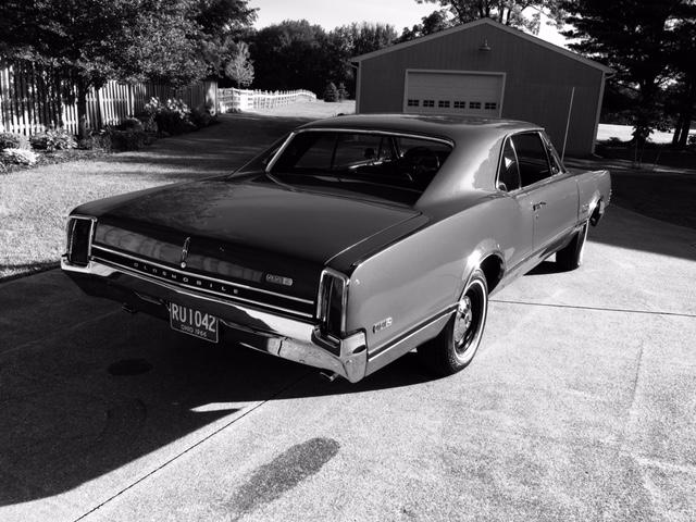

Re: 1966 OLDS 442
Summer of 66...
Re: 1966 OLDS 442
She looks good even in black & white. Very creative, GM.
Re: 1966 OLDS 442
Thanks, Walt!

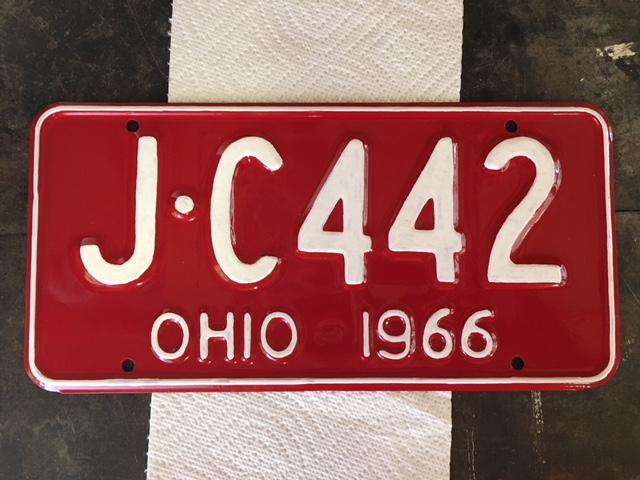

to be towed in and leaning out. I also have been working on a license plate that I purchased on
Ebay. It was a "I think I can do this" type project, and it was a pretty low dollar try at it. I'm hoping
that the BMV will accept this plate, if so, I will run it on the 442. I'm posting two pics of the plate,
the white one is taken from the eBay ad and the red one is the finished project. I have about 5
hours in making it look like it does now. It took about 250,000 taps with punches, chisels & hammers
to convert the 6 into a C and make the 1946 into 1966. Then it took many coats of white paint to
cover the red embossed letters on the plate. It isn't perfect, but it looks pretty good and going
by a 60 mph nobody will know that I made the plate myself.
