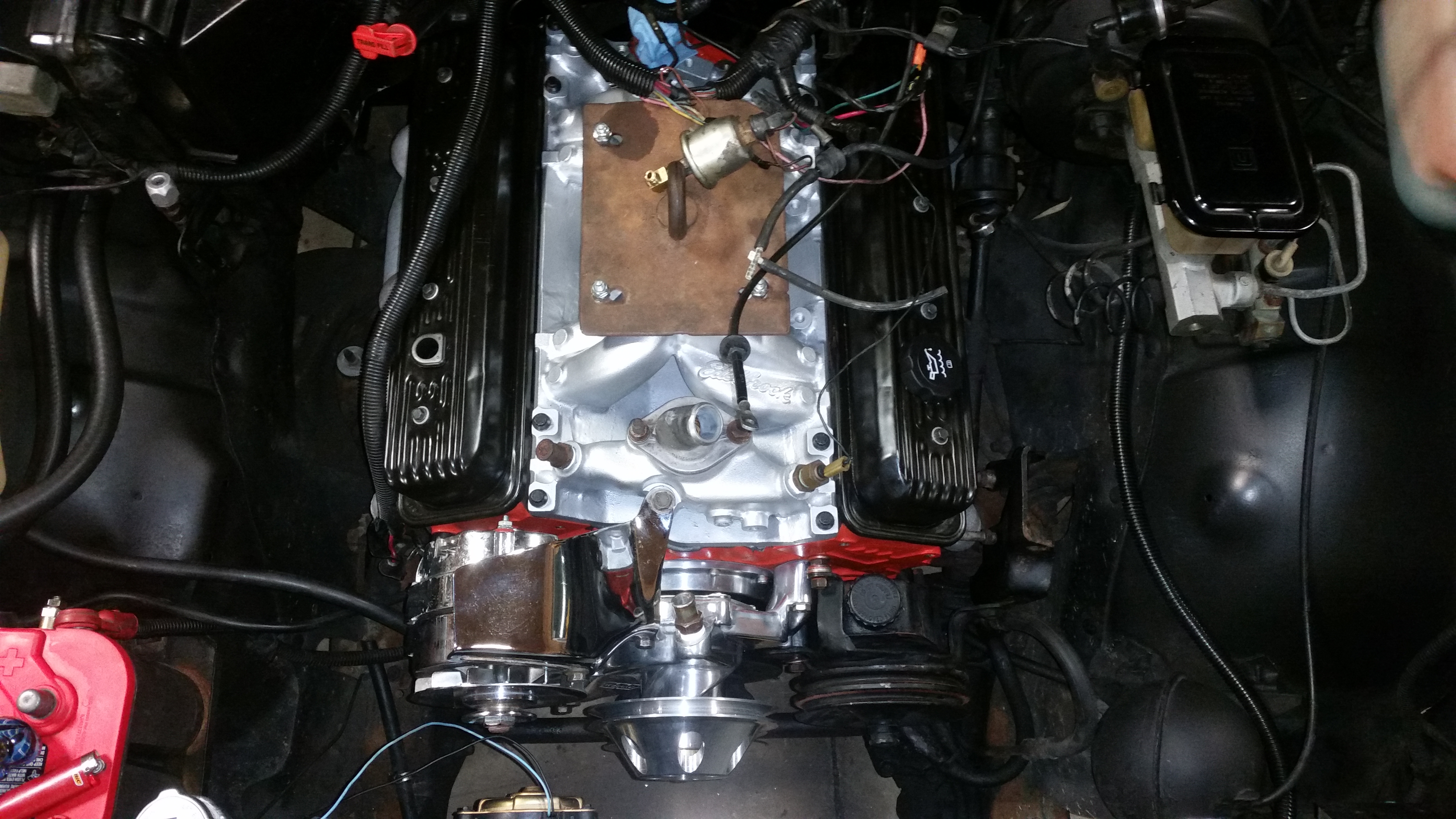

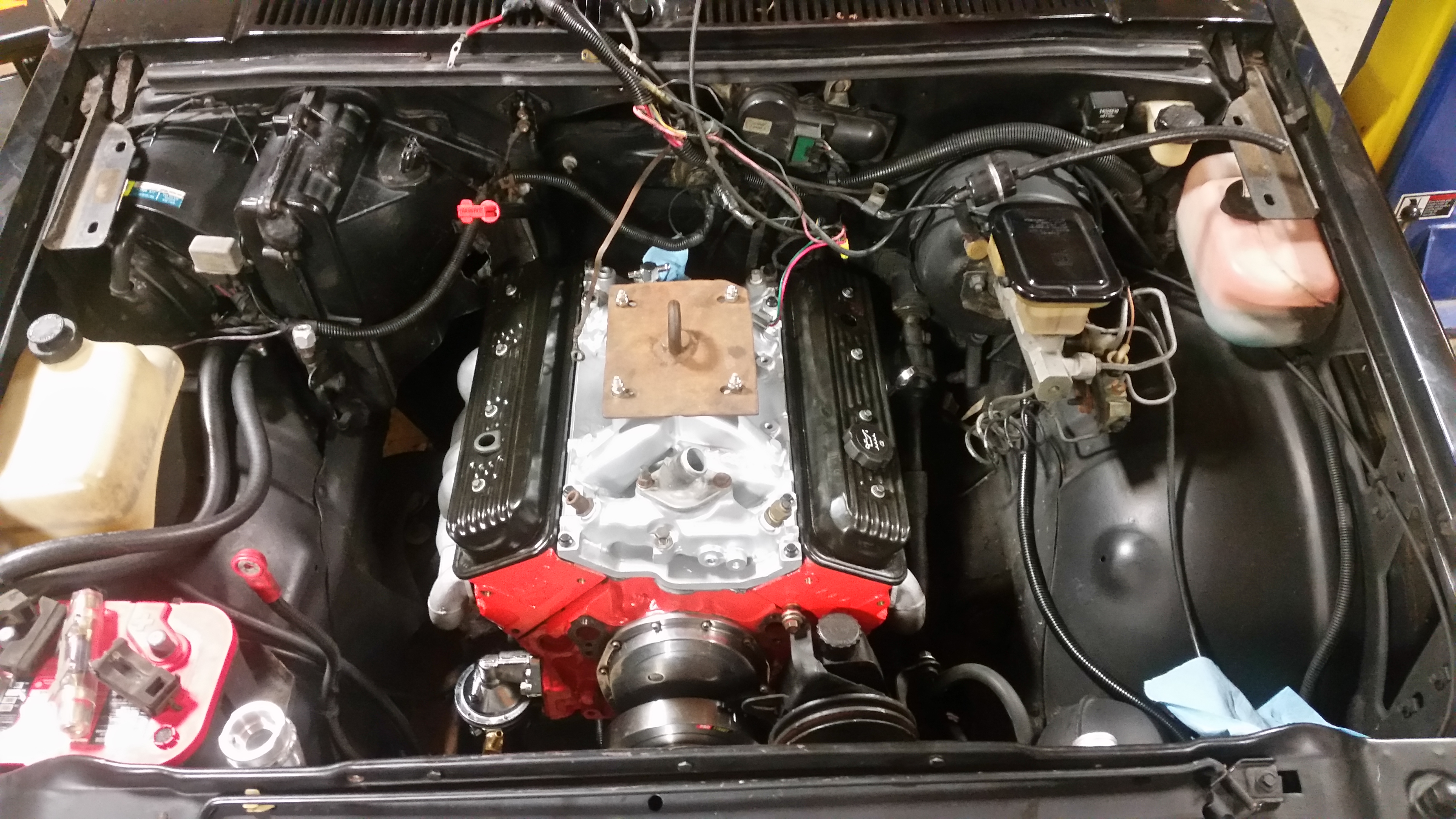

I picked up my new 700r4 on Saturday. Bill at http://www.thetransmissionshop.org put together what should be a pretty good unit. Red Eagle clutches, wider Red Eagle 2-4 band, Kolene steels, hardened splines on the sun shell, B&M Shiftkit configured for Street/Strip. I'm pairing it up with a Summit 11 or 12" 2600 stall lockup converter. And since the new radiator doesn't have integrated transmission cooler, I've got a regular aftermarket one to hang/plumb in front of the radiator.
Chris came over and Gwen helped too, we got the engine and trans back in today! Had to pull it once after setting it in and finding the ears of the transmission case were interfering with the exhaust on both side. After pulling it out, sliced off the ears with the angle grinder, and got everything back in. I need to round up some metric bolts for the trans mount. Bolts from the TH350 dont fit. Having removed a long-tail TH350 means I don't have to shorten the driveshaft for the 700.

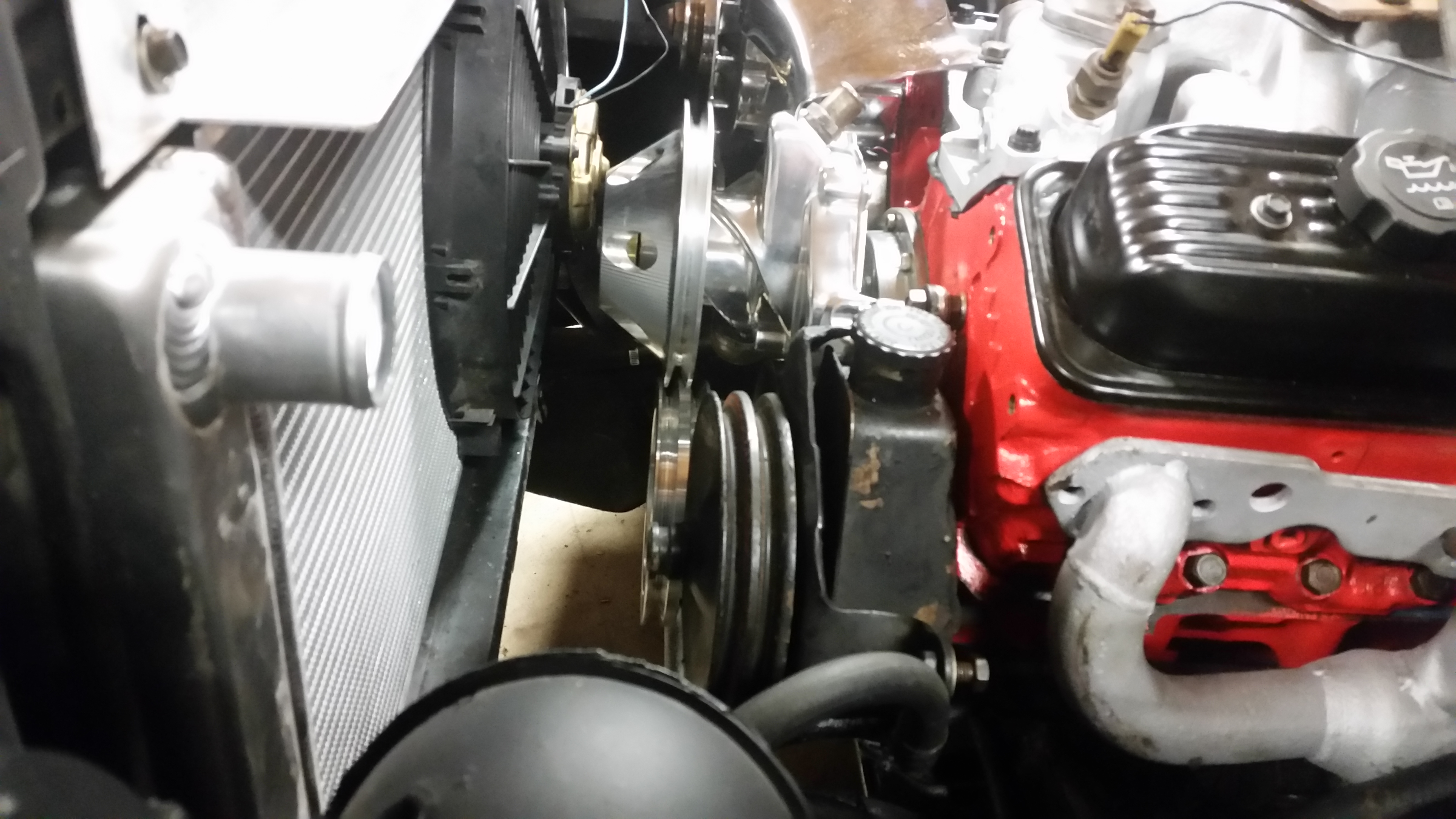

With the engine in place, I set the radiator in place and I'm going to have plenty of room for a couple puller fans on the radiator. Very happy about that!
But now I can pick at all the little issues. Can't wait to get this thing fired up!

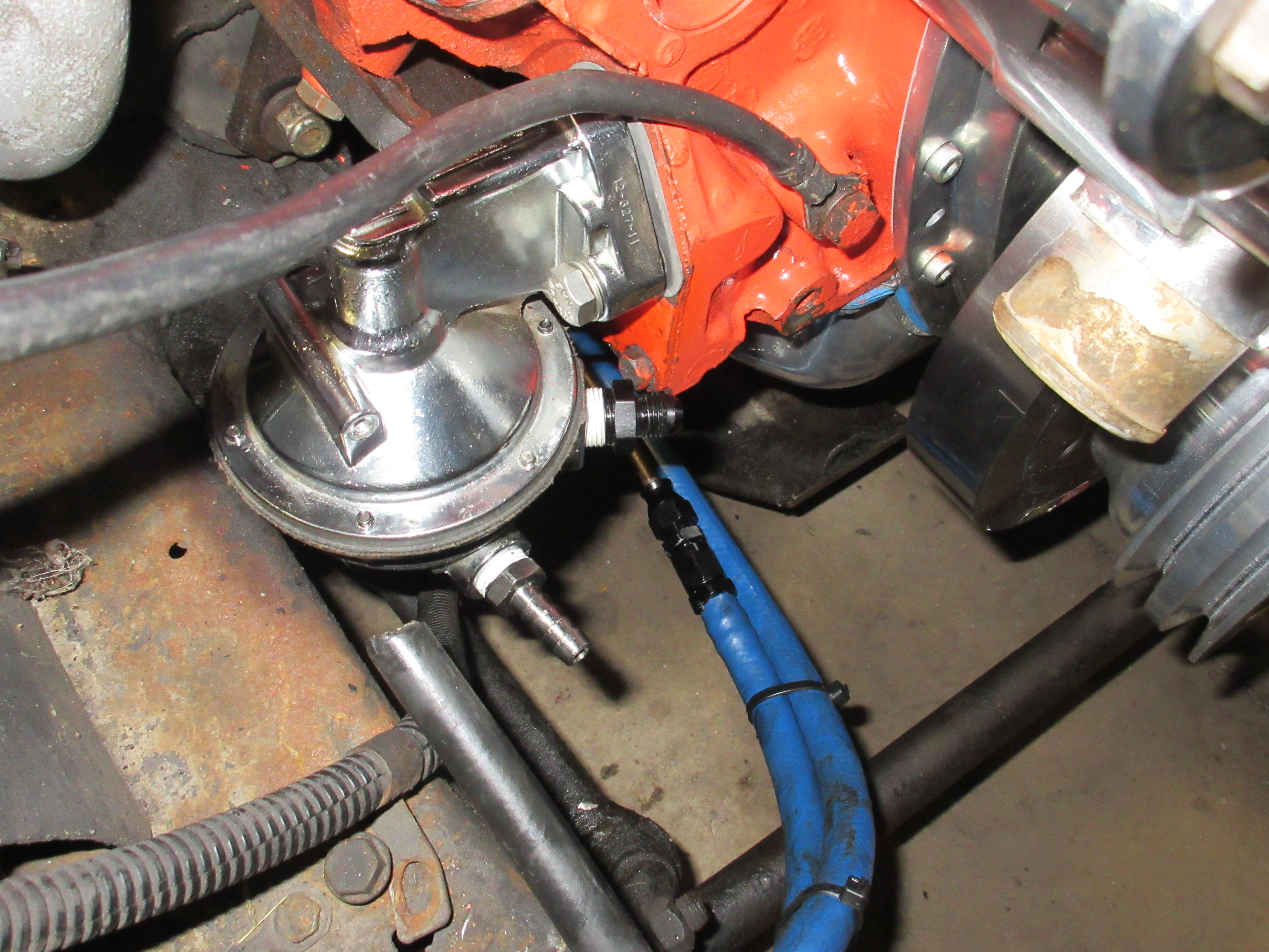

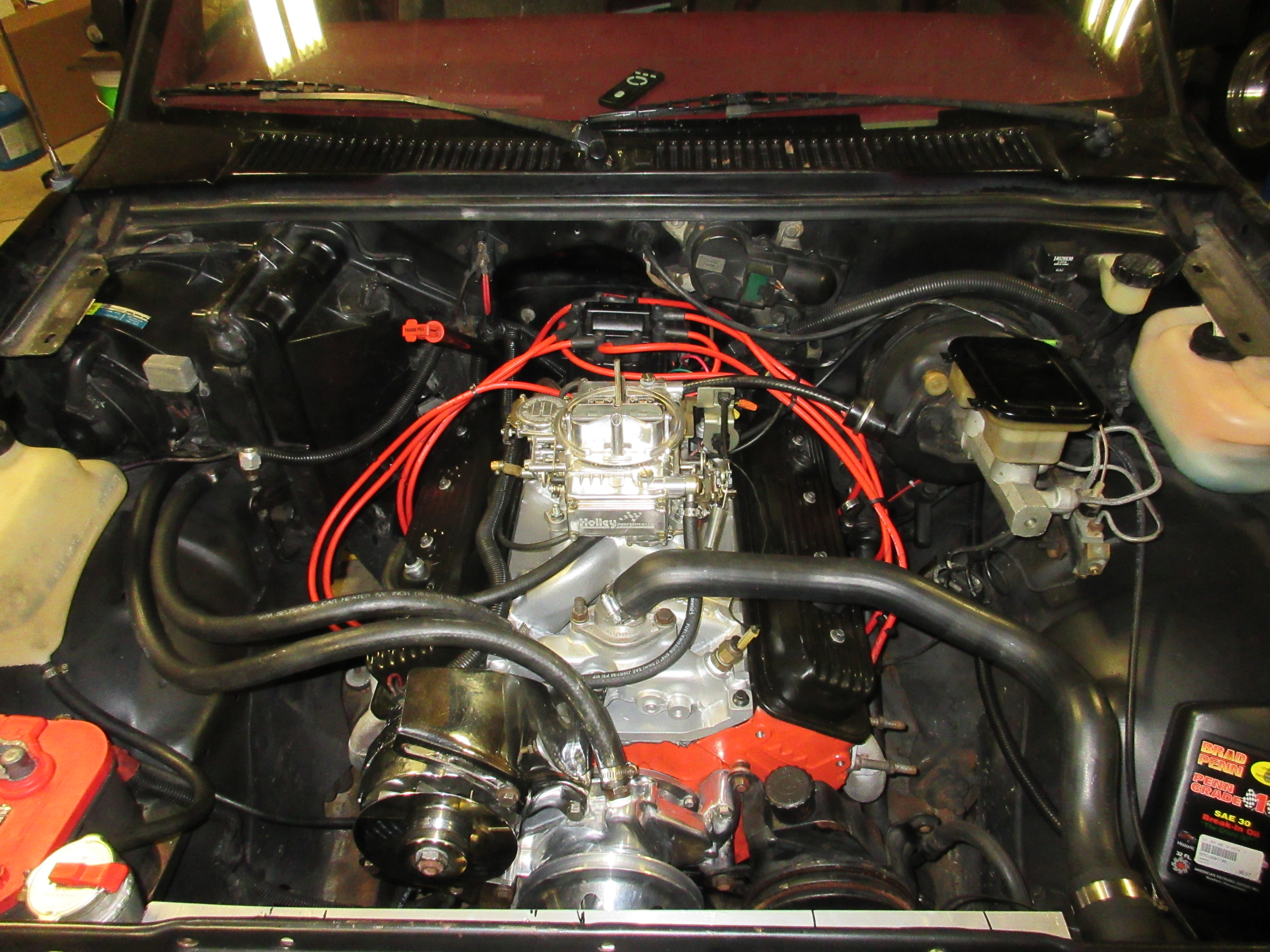

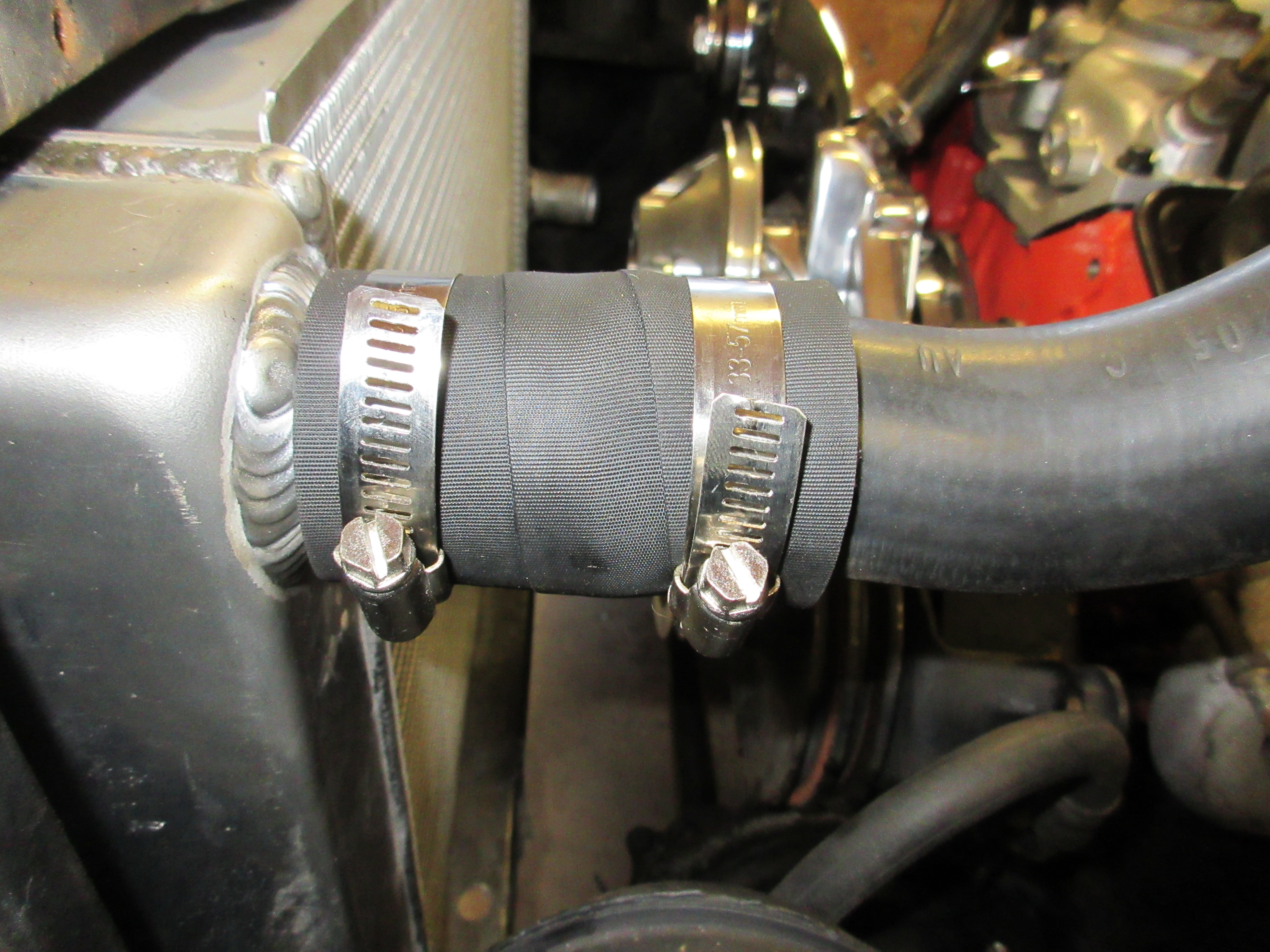

Made more progress tonight. Got the radiator fan mounted. Got the accessories installed on the engine. I am working on the trans cooler -- need to mount the cooler, but the -6an push-lock hose is in place. I'm waiting for tube-to-AN adapters so I can connect them to the ni-copp lines I have installed at the transmission.

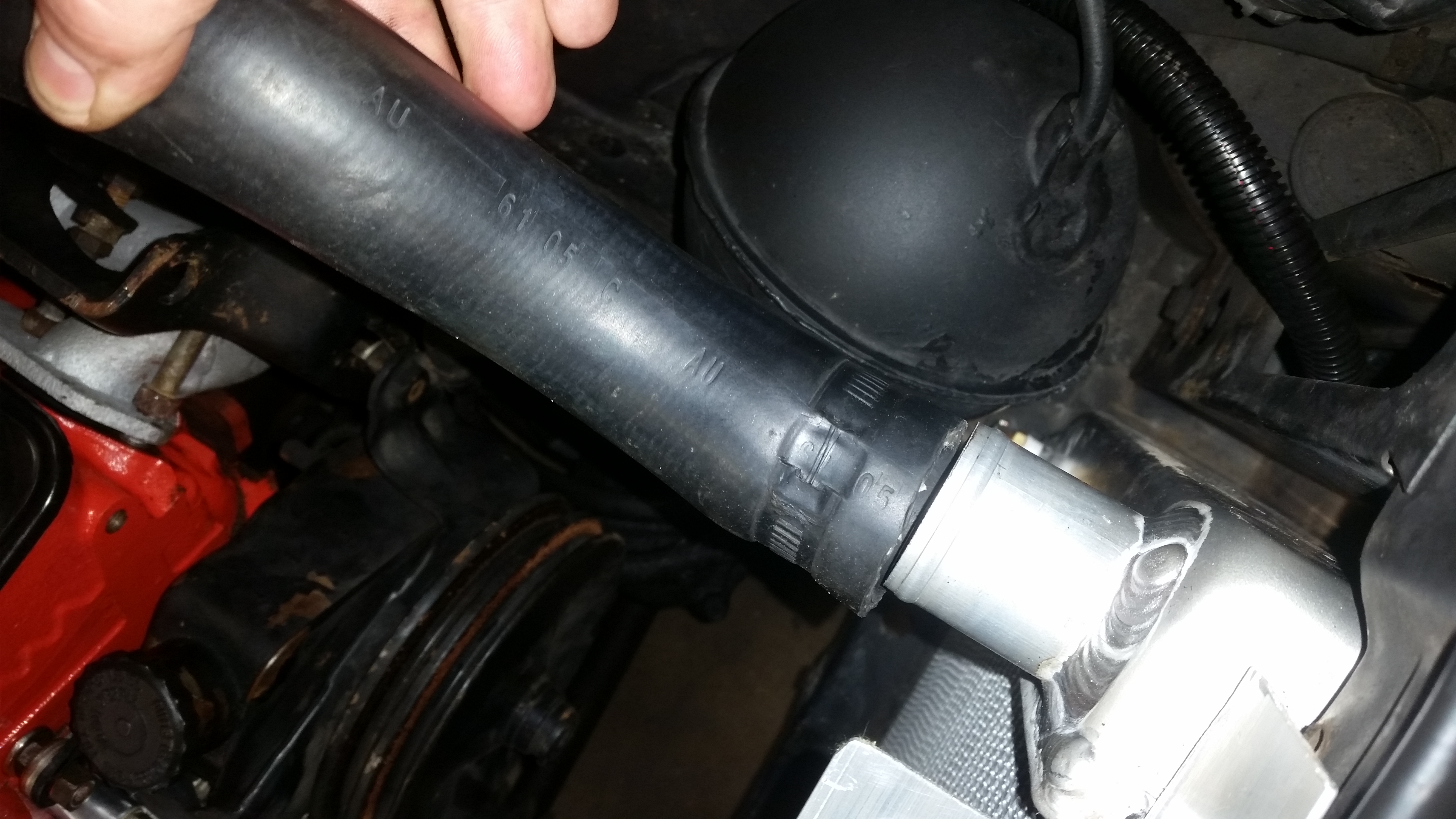

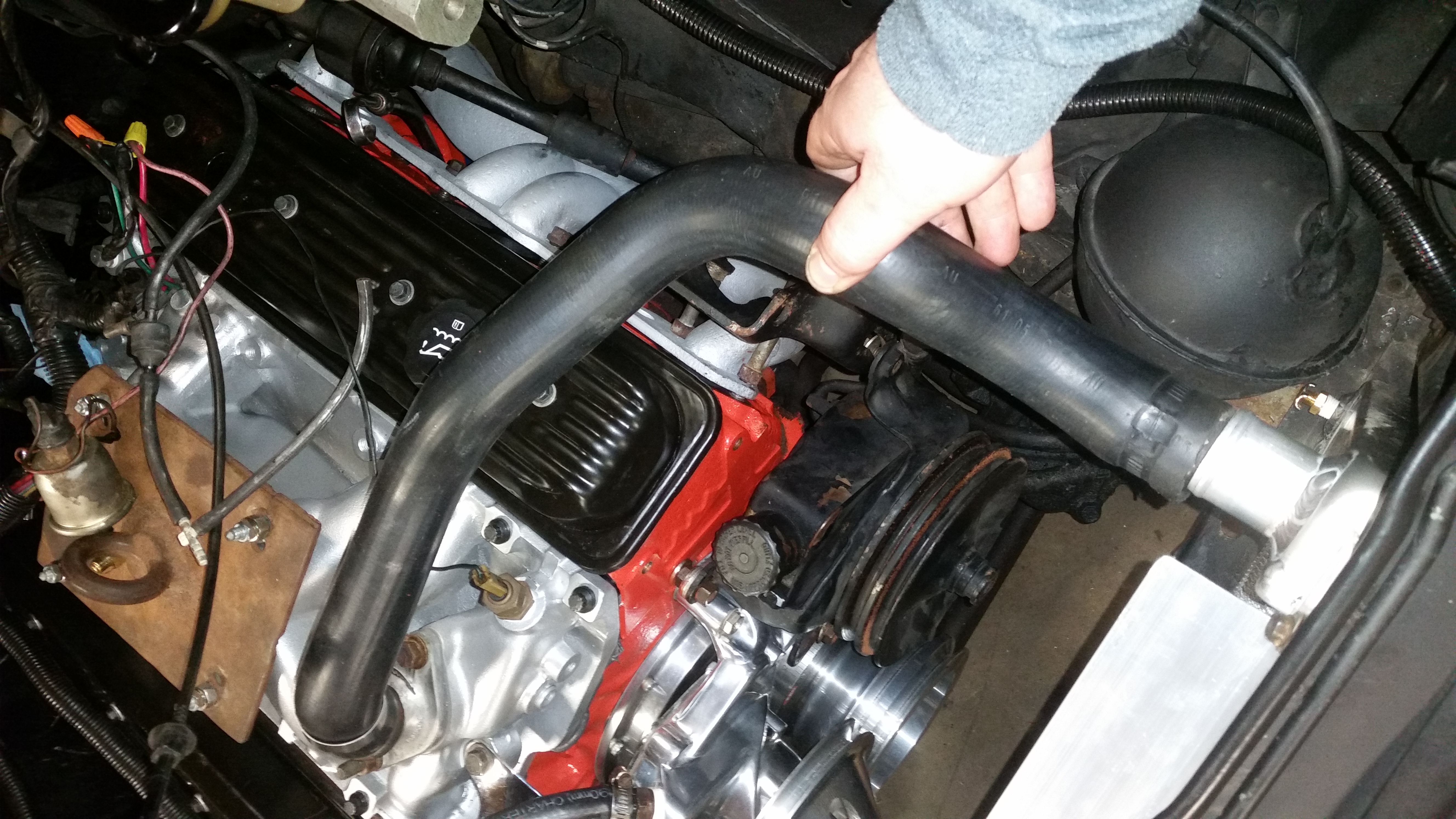

I need to adapt the upper radiator hose from 1.25" to 1.5". Old hose would fit perfect if it had a larger end. For the lower hose, I think I have what I need to make one. (2 90s and a coupler). The nipple for the over flow tank is supposed to thread in by the cap. Well, the threads got damaged when the neck was modified. Ordered a 1/8npt pipe tap, hope I can clean that up. Custom radiators take a bunch of work.

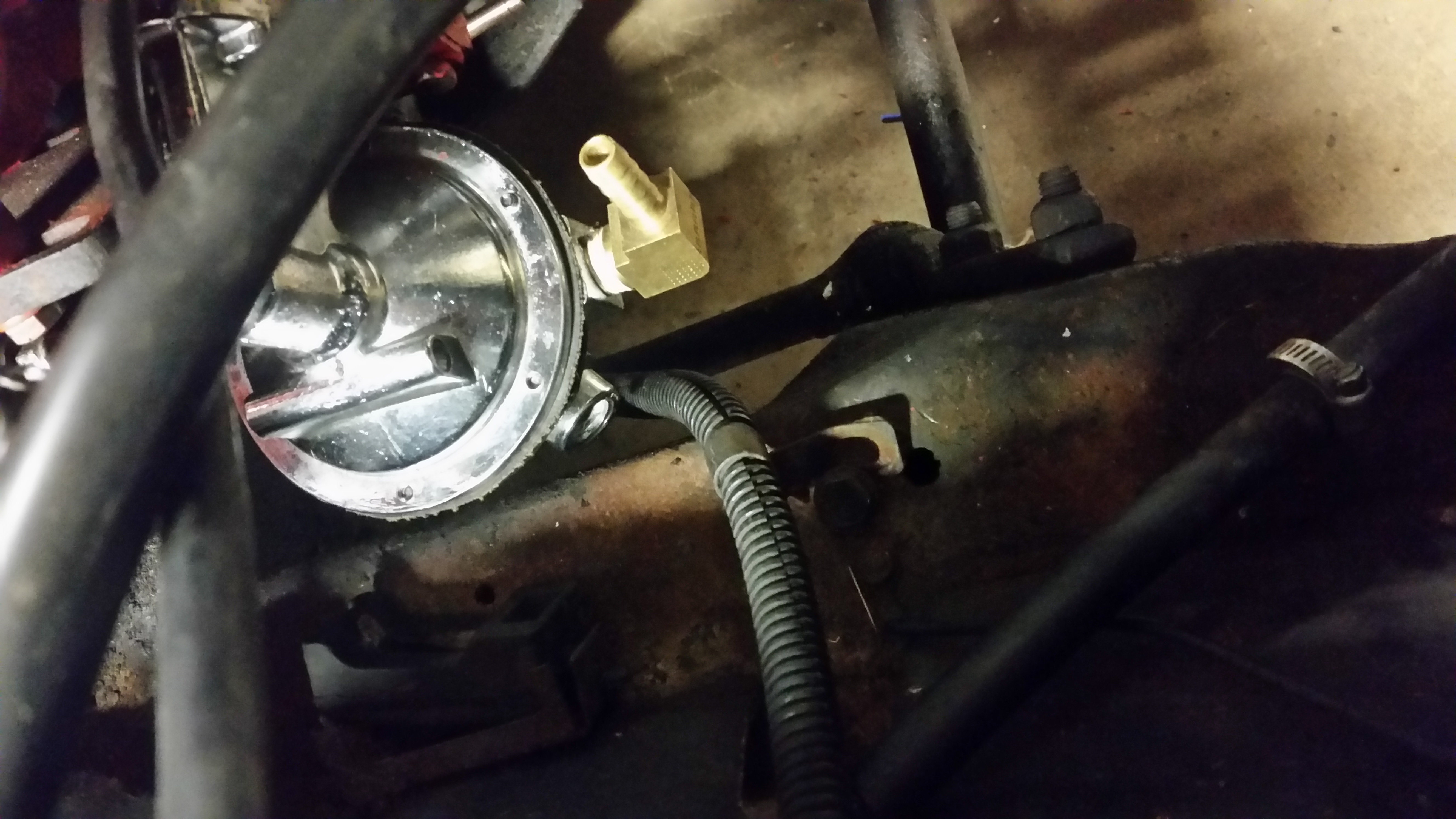

Fuel pump needs to be clocked. I think I tried clocking it when it was still on the stand but that the output was almost hitting the block. I need to try that again now that I see it won't work as-is. I could go back to the original pump too.

Wow, that looks about perfect. Good find!! On its way.
This is the one I found at Jegs, http://www.jegs.com/i/JEGS-Performance- ... 5/10002/-1 Figured I could shorten it down to just a few inches, but I like the one you found better.

So this is the piece from Summit that Paul suggested. The upper hose fits sorta snugly into the adapter. We'll see how it seals. I also pieced together a lower hose with a couple 90s, a coupler, and some trimming. Forgot to get a pic of it.

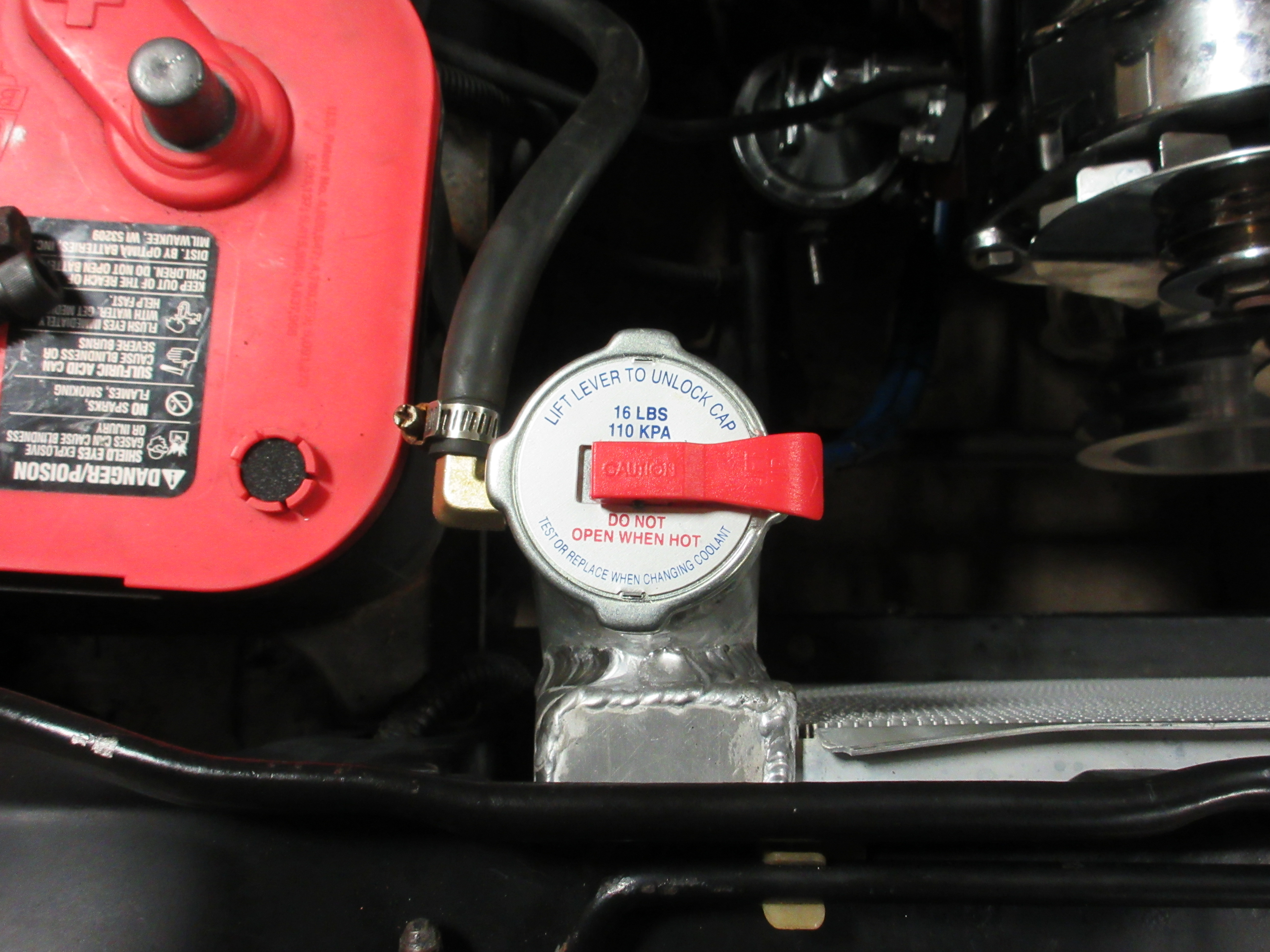

Here is the with the repaired/improved overflow outlet connected.
So the radiator is essentially done -- I just need to wire the fan up with a relay and it'll be 100% done.

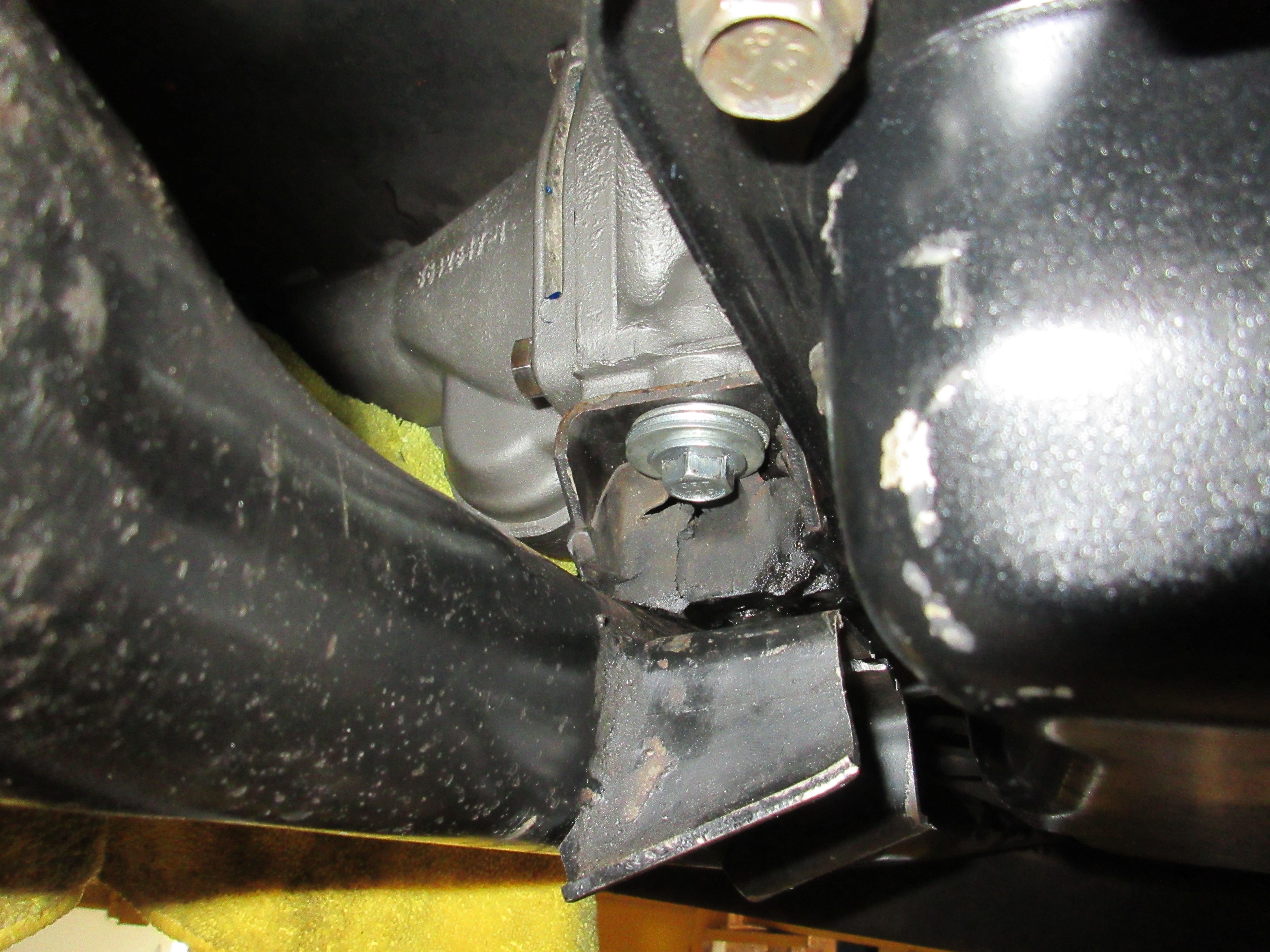

I re-clocked the fuel pump, and as I kinda thought, the output hits the block. I guess I'll go back to the stock-ish pump that came on the engine. The big headache right now is the trans + crossmember. The mount I removed from the TH350 and put on the 700 isn't allowing the trans to sit on the mounting pad of the crossmember. I've been hacking up the mounting pad thinking it was getting stuck by the threads on my the hole I drilled, plus clearancing the mounting pad to not hit the rear of the trans pan. I also got the speedo gears changed. I installed a 15/38 gear combo. Still waiting on a TV cable on a TCC wire harness.
On the engine, I need to get the oil pressure sender re-installed before I can set the distributor in. Once those two tasks are done, I just need to add spark plugs and fluids, I think.
- Posts: 3644
Re: 1985 V8-S10 Blazer
How about a 90 on that fuel pump? Looks like there's room for it. You'd have to take it off to install, but after that should be OK.
- Posts: 2618
Nope, no room. It's hitting the block.

I swapped the original fuel pump back on, but the feed line from the tank is now a little short, because I had to cut the line when I was pulling the engine because I couldn't get it off the pump at the time. I thought there was some slack there, but I guess I not. Also, the line from the pump to the carb was shorter than I wanted before the swap, so I have some extra hose now to make up a new line there too. Both should be an easy fix.

Agonizingly close to fire up. Fixed up the fuel lines to/from the fuel pump. Exhaust band clamps are on. Oil is in, and oil pump was primed. Distributor is in. trans fluid is in (some of it, was told to put in half before fire-up, then top if off once running) I have the wires for the 700r4 TCC run into the cab, but not hooked up.
Electric fans are mounted, but not wired. Need to fill the radiator with water. I'm having some concerns about that upper radiator hose adapter, but I'll see how it fares. If I have to use duct-tape to get through break-in, so be it.
