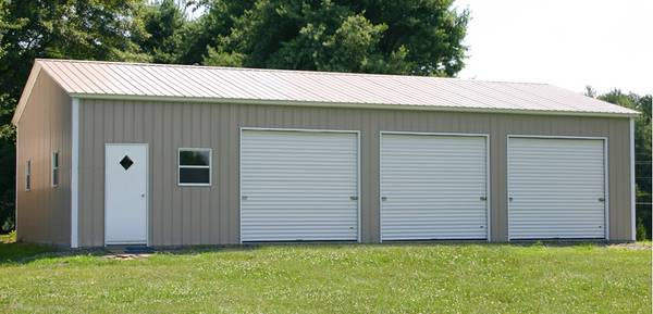

Dave, now that Tiresmoke Central has been around for a bit how do you like it. Too big, too small, wish it was a differnt arrangement, etc ? I am considering an outbuiilding here. Maybe something 24x41x10 (that is this one). It would fit my lot the best I think.

Where else are you going to put all those turbochargers? Looks AWESOME to me.

Wish I had something like that built instead of the 15X30 attached garage I had added on to the new house 29 years ago. If there's a way to make it 2' deeper, you'd have much more usable space in front of vehicles for things like work bench, air compressor, tool chests, drill press, parts washer, blast cabinet, fridge, welders, room to use an engine lift, ...
2' higher would give you head room for a lift and overhead heater.

I think you are entirely correct Maverick, my existing garage is basically 23' deep and 23' 6" wide with a 16' door. I looked at Dave's lift and it appears to be 11'6" tall. So 2' deeper and 2' taller would be perfect I think.
I can't seem to get myself under 4 cars. Plus I am in the market for a pick-up so we'll see what happens.

If I had the chance to do it all over again, I think I'd still do the same thing. Part of it for me is that I didn't want to take up the extra room across my back yard with the 3-wide layout. And the biggest difference between my layout and the one in your pic, is that I can get 4 cars inside for sure, without having to put anything on dollies. As John pointed out, the downside is I occasionally have to shuffle things around. The only time that is ever an issue is winter, though. I can also put a vehicle all the way up on the lift, and drive a car under it to get in/out of the back spot on that side. I can't drive the truck under a raised car, though.
My grandparents house where I first kept my Chevelle has a 26x26 garage, which I was basically given half of at the. 26ft deep was very nice for having a workbench, tool box, air compressor up front, plus plenty of room to work. I had enough room to use a chainfall for doing engine pulls while the door was closed. My garage in Lyndhurst was only 20ft deep and there wasn't much room in front or rear to do anything.
Build as big as you can afford, you'll find a use for the space. If you're considering a lift, draw everything out on paper first. Make sure it will fit where you want it.
