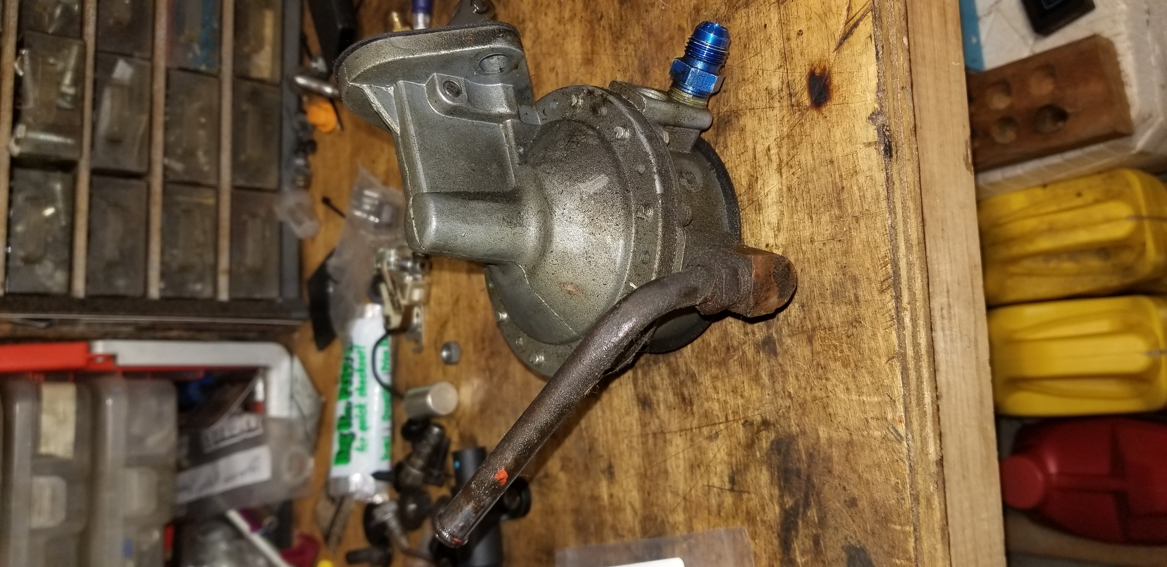

Well, I guess it's time for another 3-year update. Picking up right where the last post left off, I got around to doing a bit of a tune up on Dad's Vette. I was driving it a couple weeks ago across 480, and it just wouldn't pull past 4000 rpm at WOT -- and I was cruising GPS indicated 72mph at 3700! I've never been super happy with the WOT performance of this combination since I put it together, but I tolerated it since it was never supposed to be anything more than a good cruiser, which it IS.

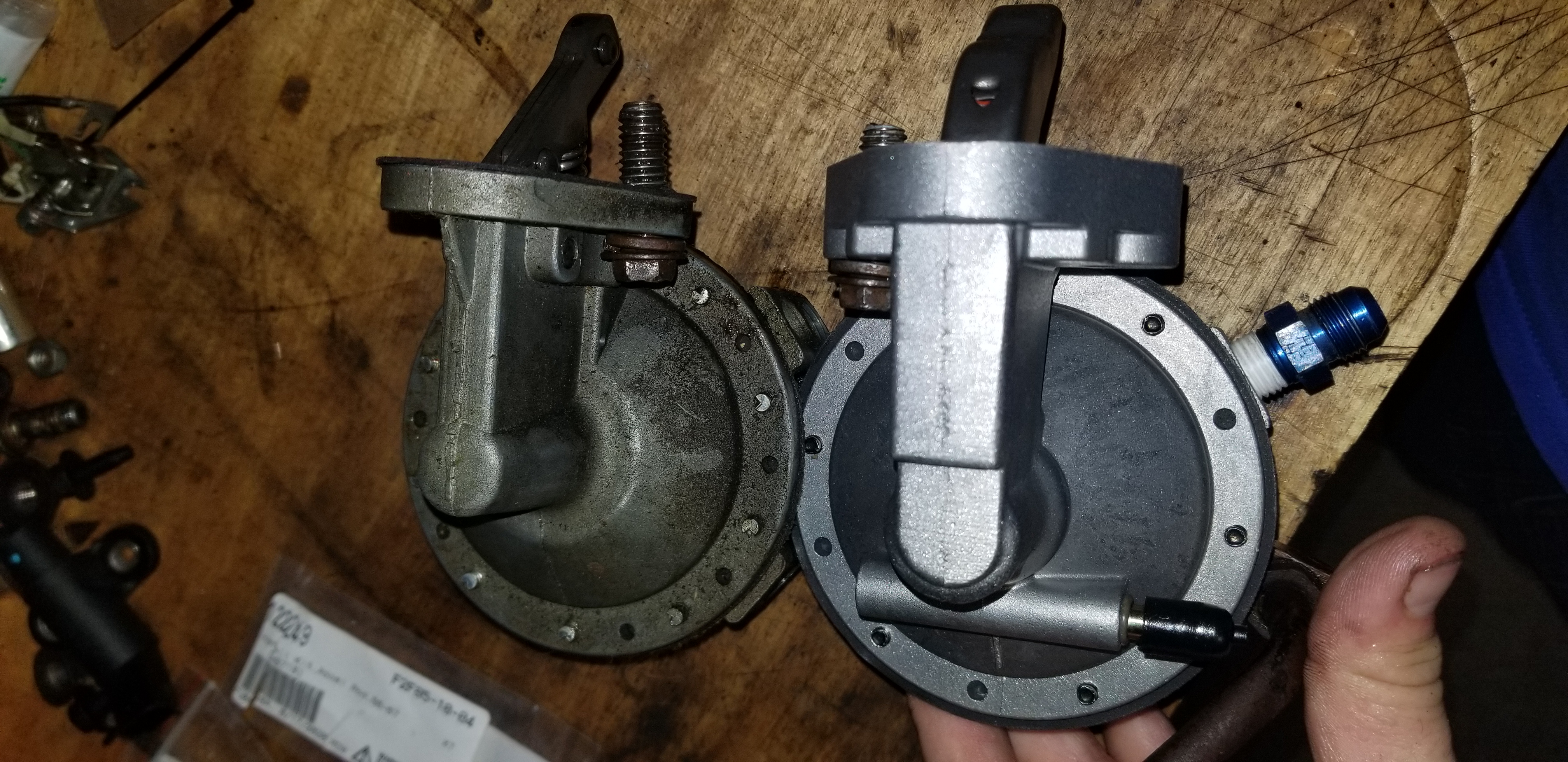

I placed an order from Eckler's Corvette for a new fuel pump, points, and condensor. I wanted to start simple. I changed the points while chatting on the phone with Andy, with both of us acknowledging that we hadn't done such a task since the late 80s or early 90s, as an HEI swap would've been the go-to mod. It's a very simple job-- I probably spent just as much time labeling my spark plug wires as I did doing actual work. The cap and rotor looked almost new inside. Just a little bit of crud on the rotor, that I cleaned off with some scotch brite. Upon re-assembly, the car wouldn't start, Andy suggested the points werent opening/closing. A bit of adjustment there, and it fired up. I didnt gap them and I didn't have a working dwell meter. The butt dyno confirmed an improvement, but still plenty room for more improvement. Last night I swapped the fuel pump. I've done a few small-block fuel pumps, its usually a pretty easy job. I even swapped the one on Tony's Chevelle in the hotel parking lot at Woodward years ago without much issue. Not this car, though. From above, the alternator is in the way, and to a lesser degree, the exhaust manifold. From below, the crossmember and suspension make it a tight job. Also, on my particular block, the hole in the front of the block that can be used to hold the push rod out of the way is not tapped all the way through. Youtube suggested using an old hacksaw blade to get under the pushrod and hold it out of the way while sliding in the new pump. This worked pretty well. Out with the old...
Of course, the new pump was a little different than the old one. I was a bit miffed at first-- that was why I bought the pump from Eckler's, so it would be RIGHT. The mounting flange was measurably thicker, meaning my bolts weren't long enough now. Discovering something like this at 10pm can be a motivation killer. Fortunately, I had my old Holley pump from the Chevelle on the shelf, and it had the thicker flange too, and the bolts were with it. Problem solved. One of the other annoying parts of this job is that the fuel tank gravity feeds the pump. The sending unit and outlet from the tank is on the bottom. After removing the hose from the inlet of the pump, gas POURED out. There's no flow issue there! A 3/8 bolt kept the line plugged while I did the rest of the job. Knowing this, I now realize there's no way for any of the fuel line from the tank to have a pin hole causing a suction problem. I'd have a straight leak if there was anything wrong. All in all, doing a fuel pump on this car is a sucky job, one that I would NOT want to try in a hotel parking lot.
The road test showed not much improvement, but thats ok. The old pump may not be quite as old as I first thought, but now I know its good.

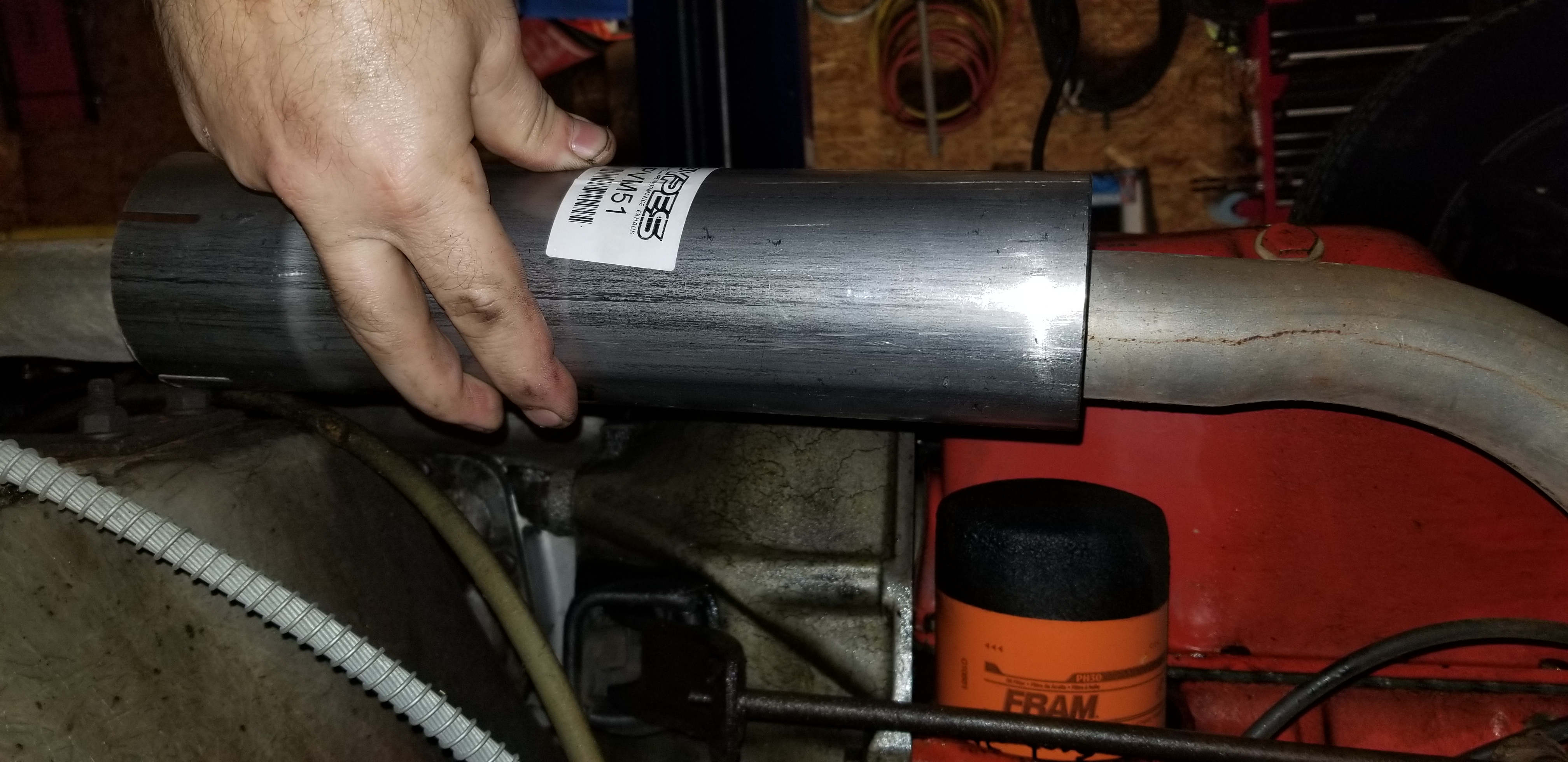

One of my winter projects this year will be a new exhaust system. Being a 250hp/327 car, the pipes are only 2-inch. Good grief, they look like straws. I'm going to use stock 2 1/2" manifolds & pipes from the 340hp/327. Here's a photo compared to a piece of 3" pipe from my Chevelle's Pypes kit. setup.

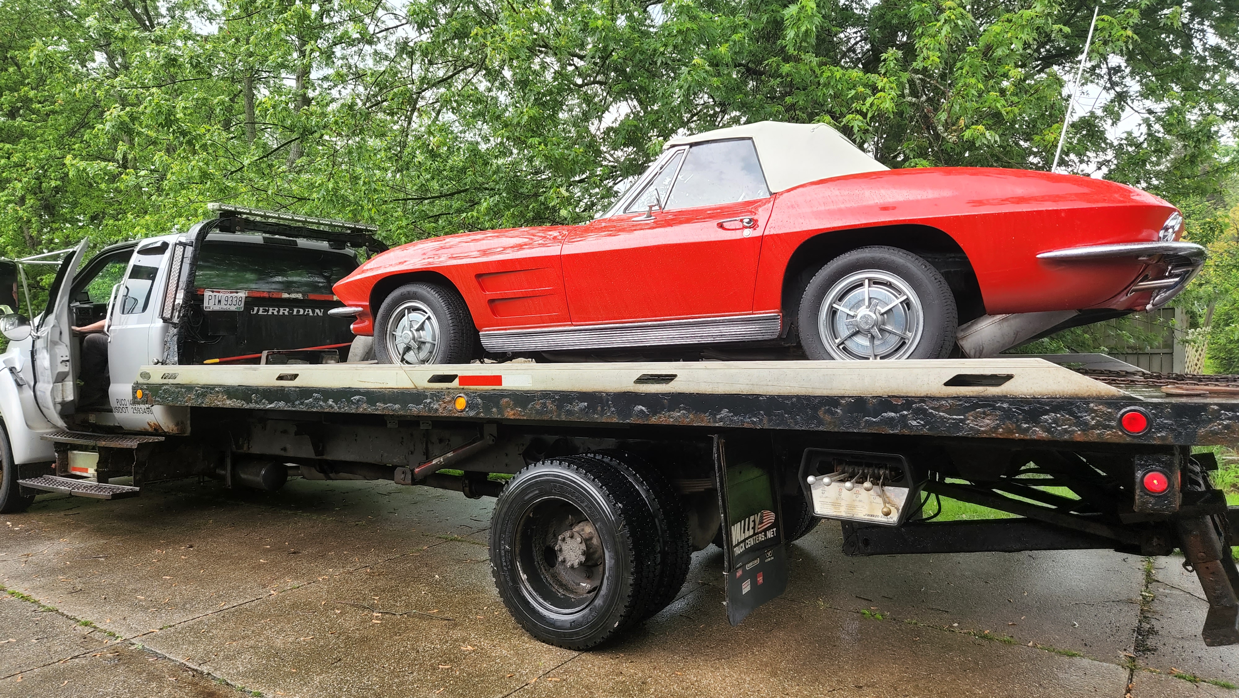

It had idled/revved ok for a couple minutes, so we decided to head out. We made it to Andover (rt 7) without too much trouble. Heading west down US6, it got progressively worse. A couple more backfires and I've clearly done some sort of damage to the exhaust because the car is MUCH louder. After barely getting to the BP at US6/OH46, I had to call for a tow. It's parked in the front garage for the moment. A quick swap of the coil didn't help anything. I made a trip out to Johns house for some spare points and a tool. It should be dirt simple to diagnose once I get out there.
But even if I get it running immediately, it's gonna need that new exhaust ASAP. In the bits of time that it was running after some of the blowout, it did sound pretty good. Even my mother commented years ago that the mufflers were too quiet. "I thought it used to rumble a little more."

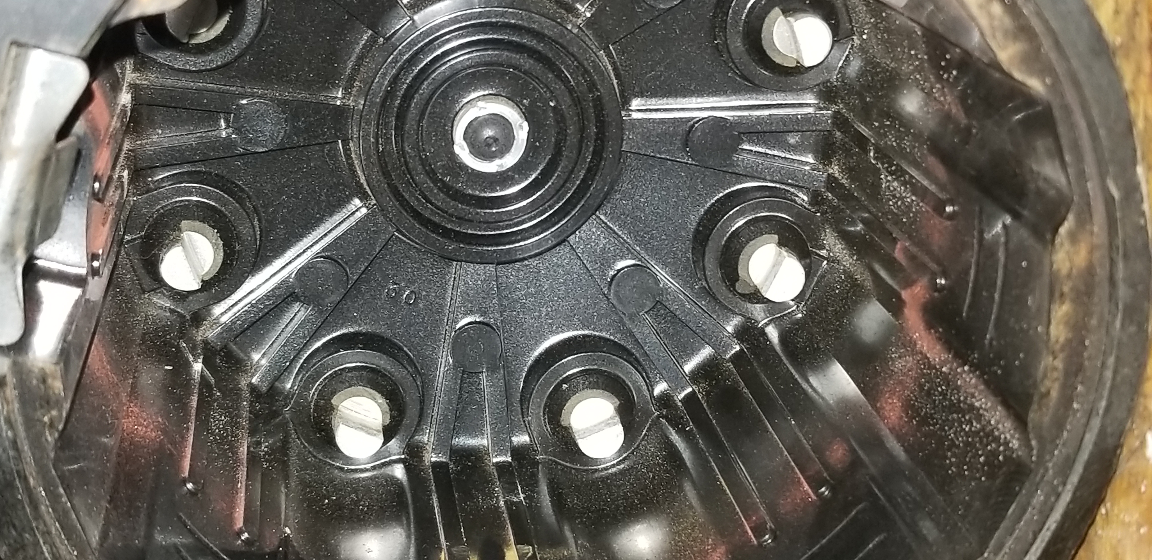

After writing my post last night, I went out and did a little troubleshooting. Dad and I were talking during the ride home and neither of us remember ever replacing the coil. There is a distinct possibility it's the original coil. I tried swapping it with my Blaster 3 coil, but still wouldn't start. I checked the power to the coil, and at first it was good -- then it wasn't. I had Gwen come out and jiggle the ignition key a bit, just within the On position and I could see the power cut in and out.
The next thing I'll try is putting a jumper wire from the battery to the coil. If that works, I'll have to take a close look at the ignition switch. I'm getting the feeling my cars are plotting against me!! (key switch issue in the Chevelle)

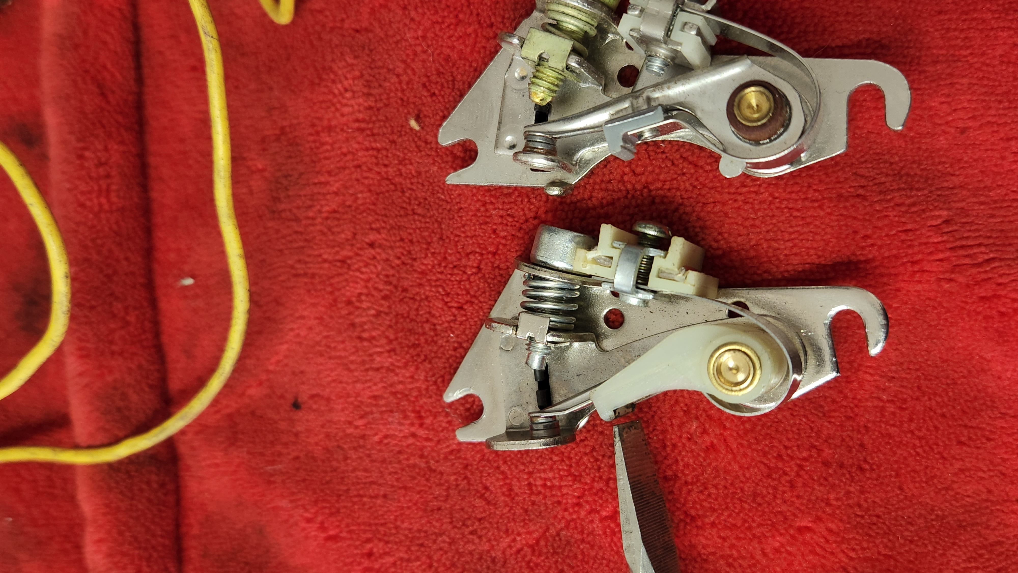

Armed with a new set of AC Delco points, ACD condensor, and brand new ACD coil, went out to the front garage where its been languishing since the tow home from the Bair's show. Comparing the new points (right) to the old, I could immediately see a difference. It looks like the rubbing block is completely gone? These points were just changed in 2020 and I bet the car didnt get 500 miles in the mean time. Bad luck? Shitty quality like BP's ignition modules?
With the new points installed as they were out of the box, with the new condensor and new coil, the engine fired up pretty easily. The passenger side muffler is the one that's blown out and it seemed to be running with a miss. I got it moved back to Tiresmoke Central from the front garage. I'm guessing the plugs are probably fouled out a bit. They are probably 10+ yrs old anyway.

Isn't there supposed to be lube of some sort on there? I somehow remember on maybe the Caddy when I was adjusting the points seeing lube where it contacts the distributor shaft. Not sure if that's true or not, or if the kit comes with anything like that.
Re: 1963 Corvette
Studying your photo, Dave, I think you have two different versions of this set of points. Could it be that the rubbing block is not really worn?
