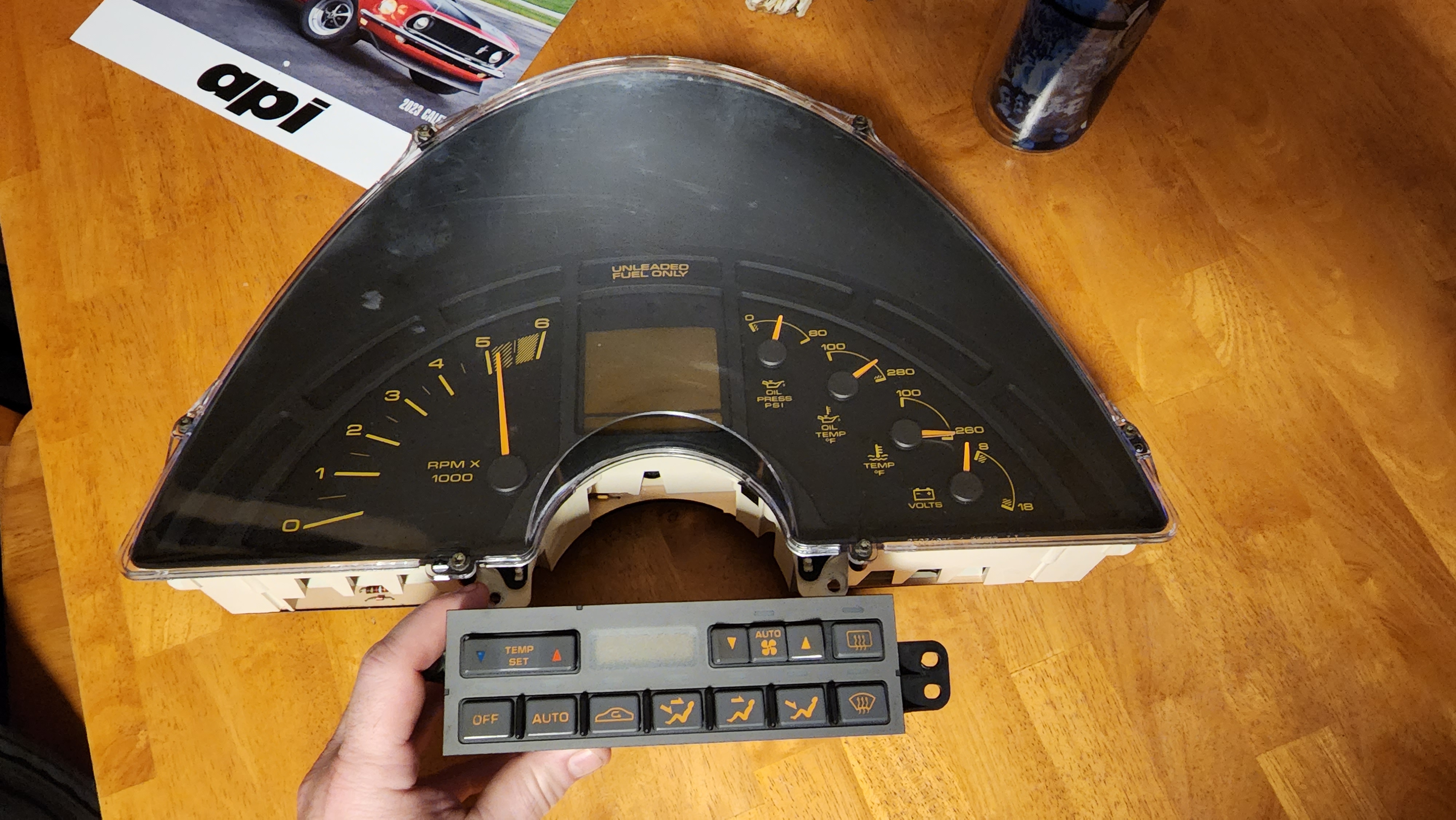

I got my gauge cluster and climate controls back from batee.com this week. They fixed the tach and re-applied a film to the LCD -- mine was 50-60% worn. They said the climate controller was actually OK. There's another piece called the climate programmer (??) that might still be bad. In the mean time, I'll put this all back together and hopefully have a working tach.

So after getting the gauge cluster back, I installed it in the dash. As I usually do, I just put minimal stuff together to make sure it works before I put it all back together. I started the car and tach needle moves and seems accurate, but it doesn't seem to move smoothly. I didnt wanna whack the throttle on an ice-cold motor to really test it out, and it was cold enough I didn't wanna leave the garage open on that night.

I've run out of things on the other cars to procrastinate with, so I got back to this today. I finally took a video.. tell me what you think about the tach movement.

Definitely not moving the way it should (like mine does).

The guy who fixed it, Bryan @ batee.com agreed. He responded to my email within a half hour. He said to send it back, they will take care of it.

The dash is still kinda glitchy and is very annoying. The backlight behind the digital speedo flickers constantly. The tach needle is still somewhat bouncy, although its still way better than before I had it fixed.

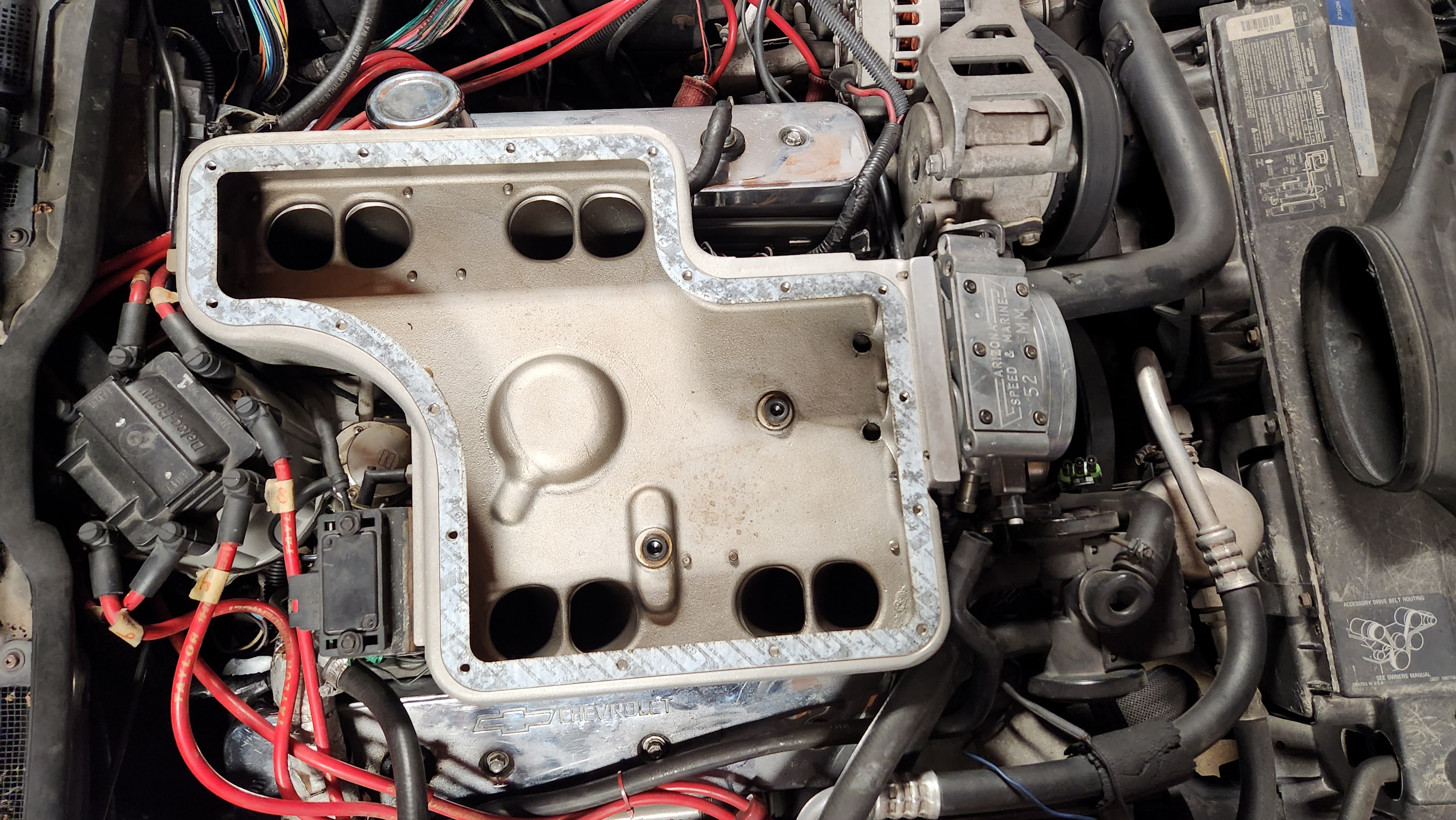

I drove the car again this today and this misfire was even worse, especially in the beginning. Whatever the Techron knocked loose, I think they need to come out for a real cleaning. I've never really had to clean injectors like this before, and boy did I pick a doosey to start with.

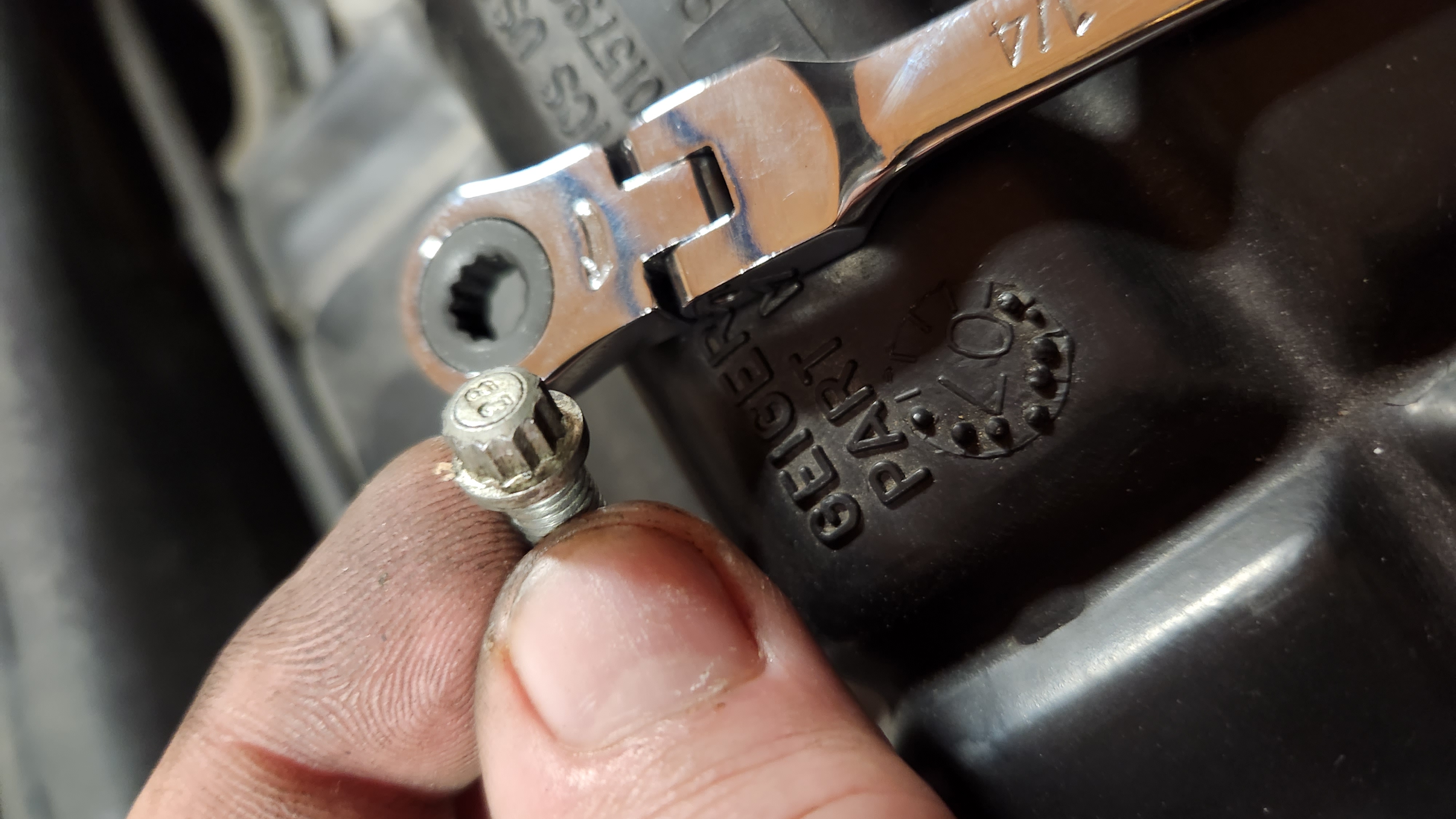

The Accel SuperRam has 17 fasteners to hold the lid on. No biggie, right on top. I've read in the past that these intakes are PITA to work on. Once I got the lid off, I quickly understood -- there are 16 more fasteners *from the bottom* that hold the plenum to the runners. And they are 12-point 1/4" bolts. I can't get my ratcheting box wrenches on all of them. I'm gonna run over to Tony's garage to see if he has a 1/4" 12-point socket.

The SuperRam is a stupid intake

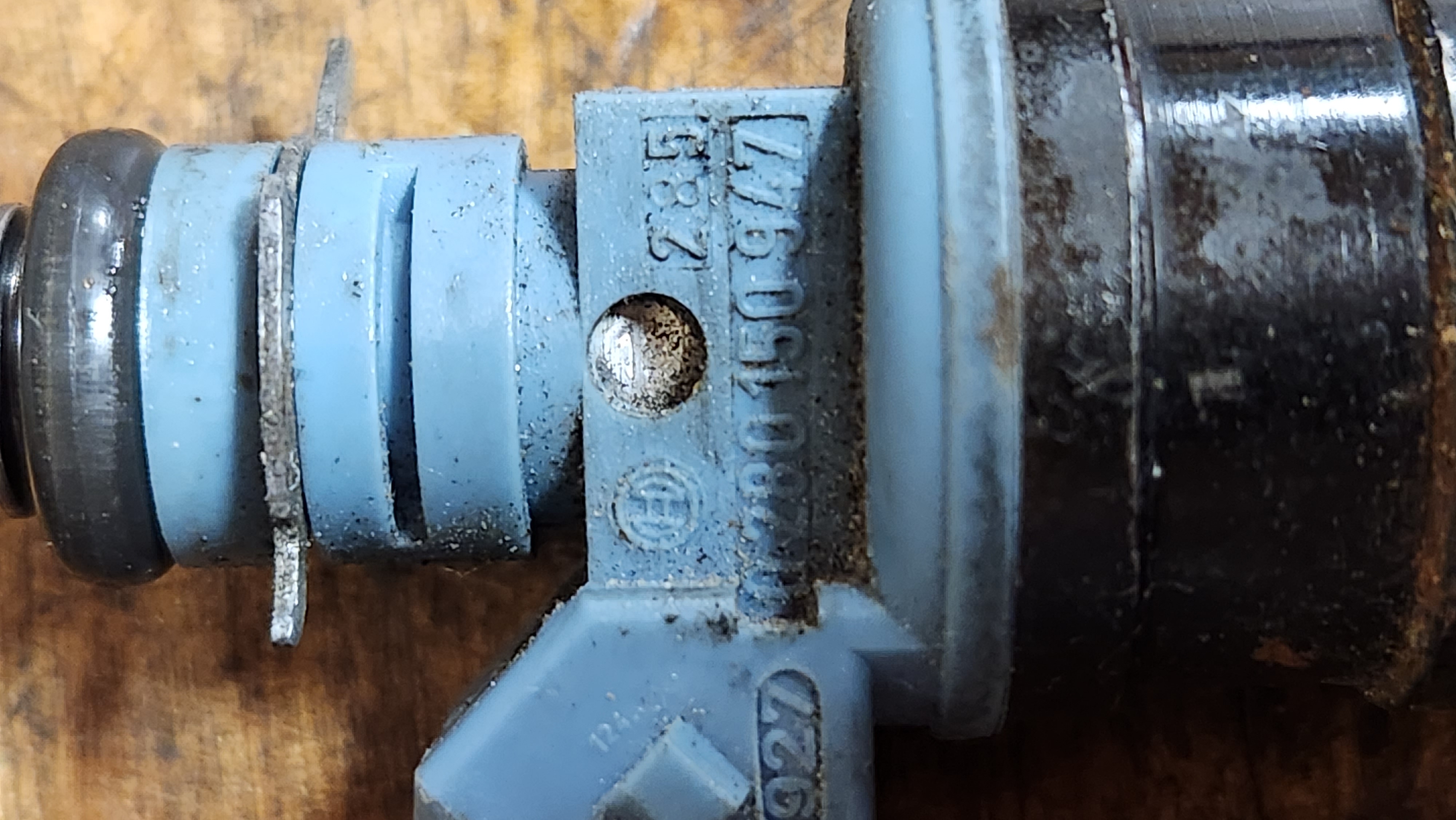

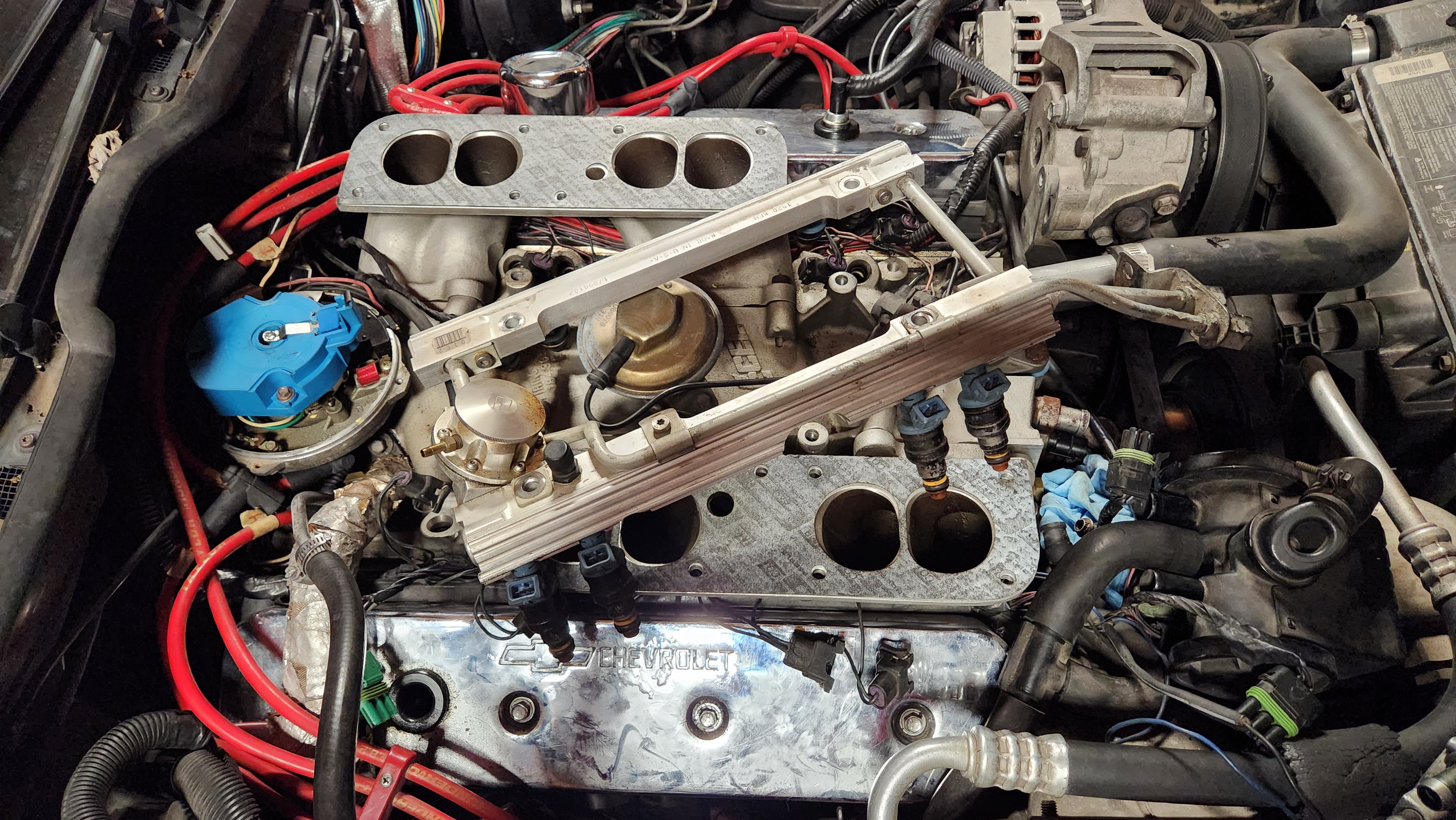

The injectors are finally out, but wow, what an effort to do so. This is such a trivially easy job on almost any other Chevy EFI intake I've played with -- my StealthRam, a 4-bbl single-plane EFI, Ramjet. But on the SuperRam, it is a several hour job. Actually, of those 16 bolts from the bottom, only 4 are really hard. The other 12 arent bad. Some suggest threading a stud into the 4 difficult one and using a nut from underneath.
Because the coolant runs to the bottom of the throttle body, and I needed to get it out of the way, I ended up draining the cooling system. Good news there, the coolant in there looked very good.
I thought I was going to have to remove the runners from the base to get the injectors out, but instead I was able to slide the little clips the hold the injectors into the rail so that I could pull the rails and leave the injectors in the place (I'm sure Walt, Andy, Paul all are probably familar with the clips). The runners block them from all coming out together. However, once every thing was out, the fuel rail itself looks pretty clean inside. Nothing of concern.
What was concerning was how loose the fuel rail feed/return fittings were when I took it apart. Seemed barely more than finger tight. The o-rings are clearly ready for replacement too.
The numbers on the injectors are 0 280 150 947, which come up as 25lb/hr @ 43.5psi. Commonly used on 460 Fords.
https://www.injectorplanet.com/collecti ... d-f1te-d1a
They quote $15/each for rebuild service. That gives me a point of reference. I'm going to see if Cleveland Injector Hospital, being local, can come in around the same money.

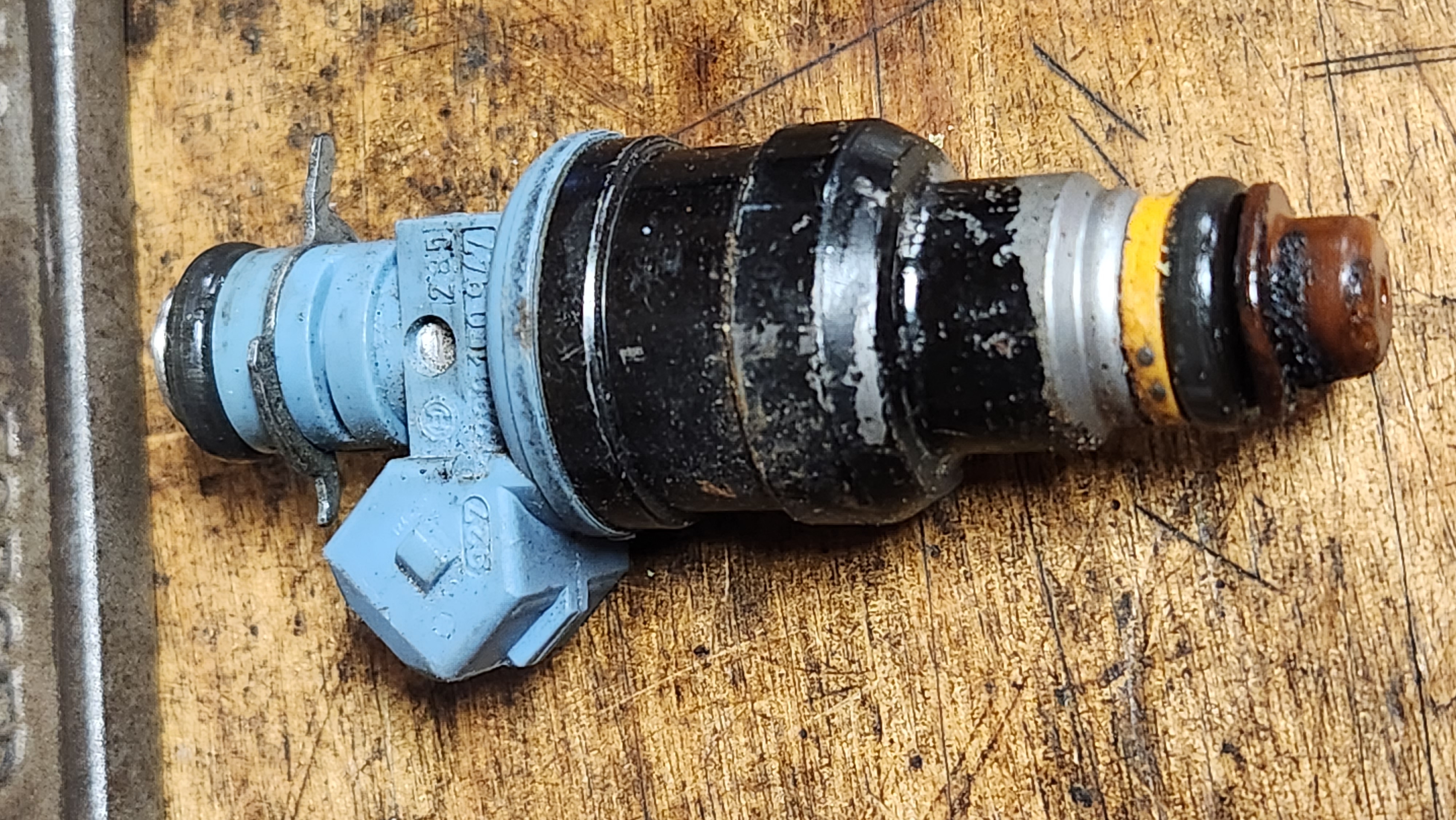

- Posts: 3665
Re: 1990 Corvette Z51
Those look pretty rough towards the spray end.

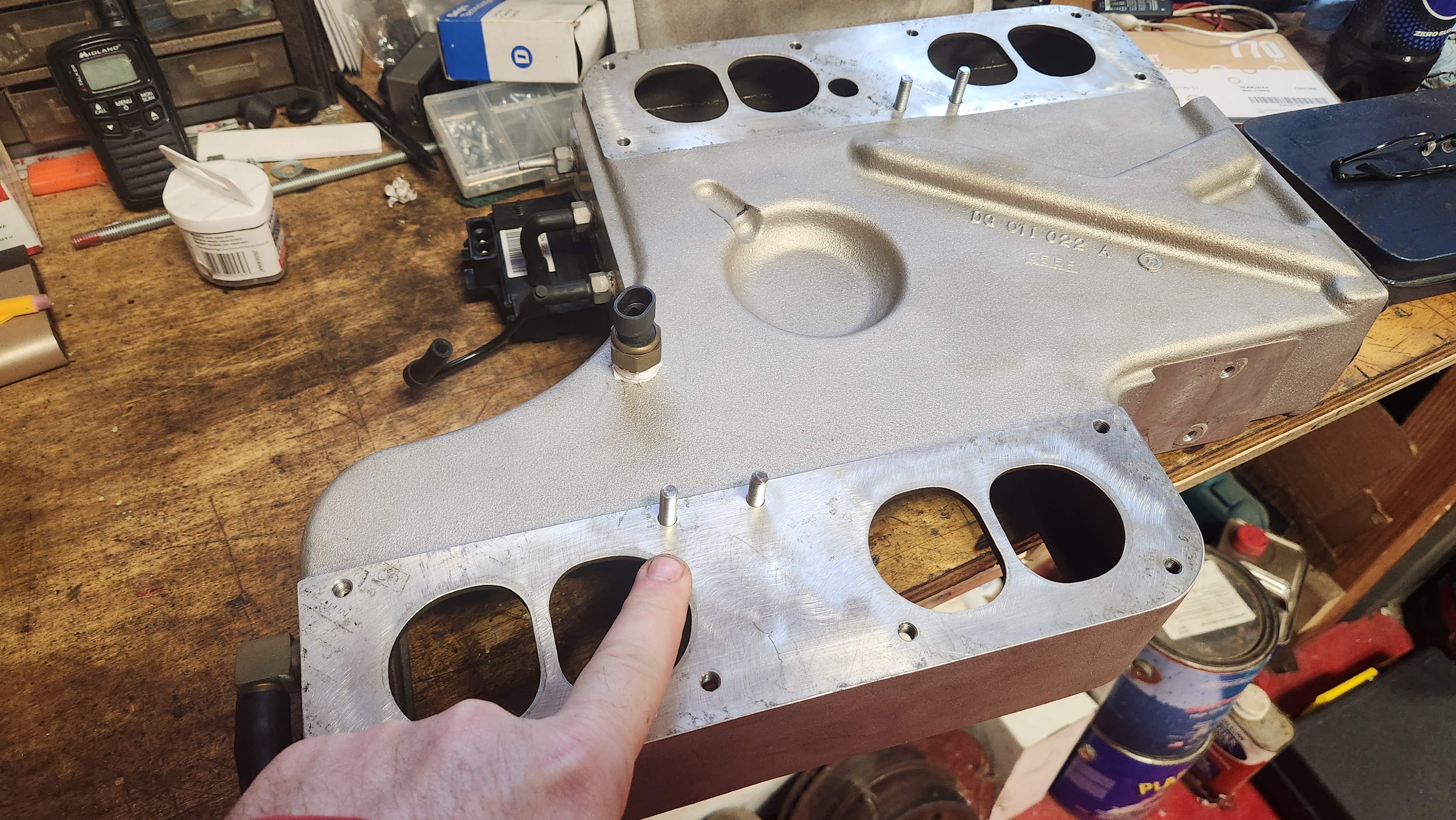

I picked up a gasket set for the SuperRam at Summit last weekend. I also picked up some long 1/4-28 screws that I can cut into studs. Of the 16 bolts, only 4 are really tough. Some people make studs for those 4, which is supposed to help out a little bit.

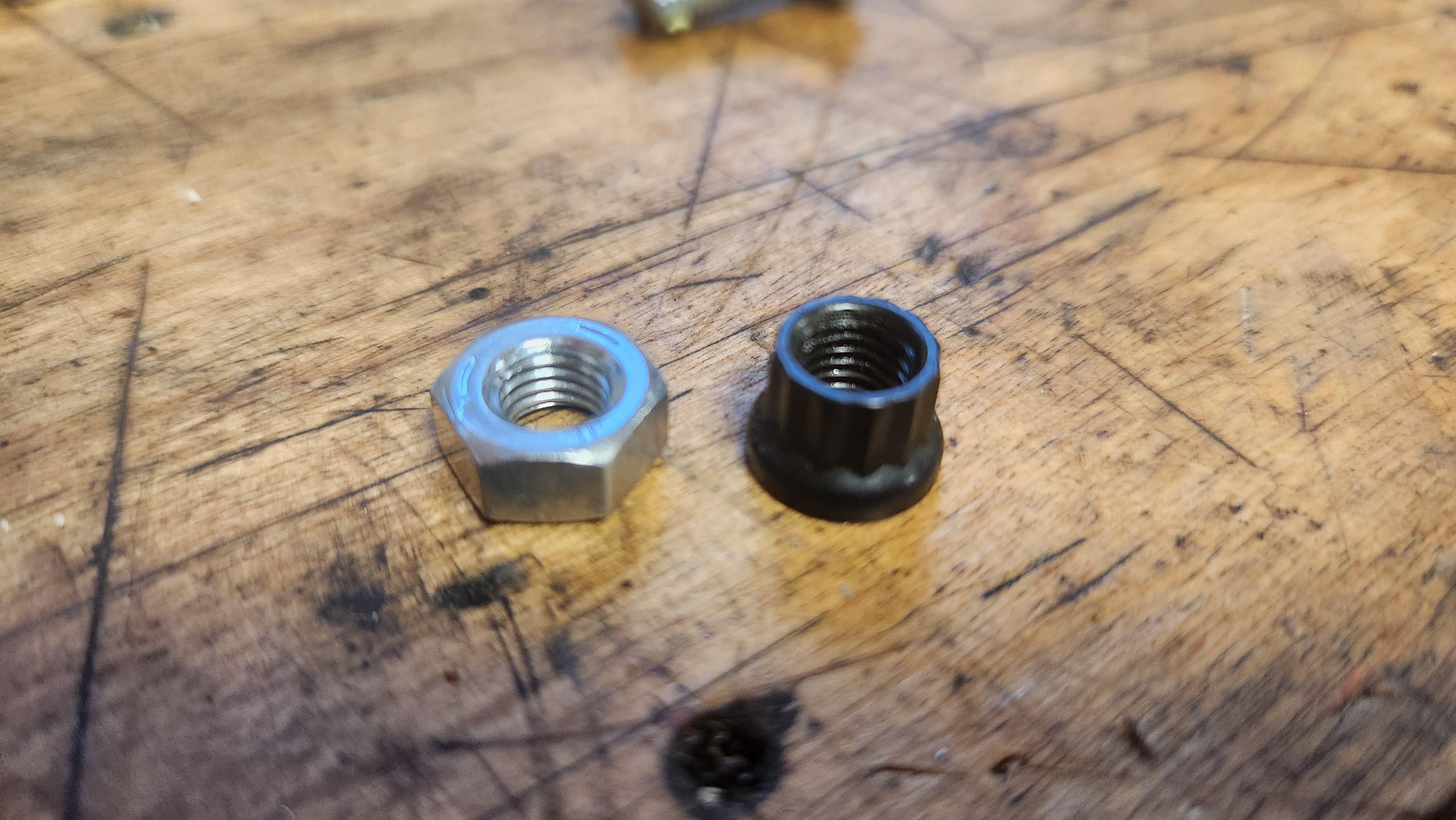

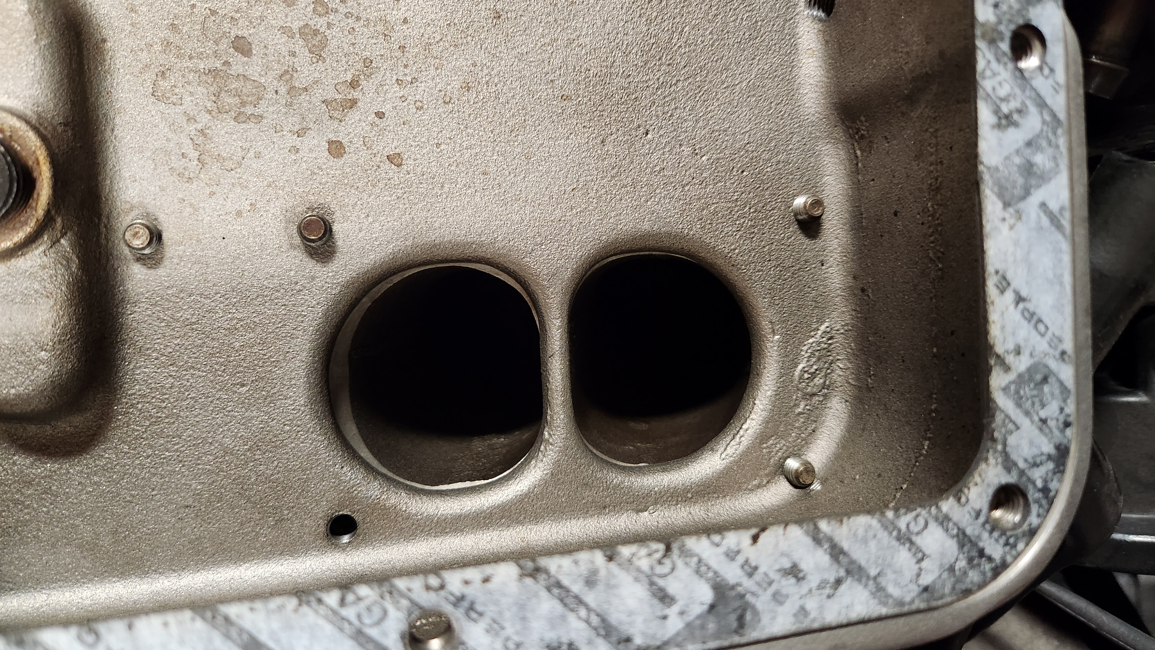

I picked up my injectors and got started on the re-assembly process over the weekend. I got all the old gasket surfaces scraped and otherwise ready. The o-rings in the fuel rail feed & return lines look due for replacement, gotta dig up replacements. I cut the 1/4-28 screws into 4 studs and threaded them into the plenum. I bought some normal 6-point nuts for the studs but remembered I have these sorta trick ARP 12-point thin-wall nuts that came with something else. Chris is scanning in the gasket set I bought into Cometic's system.
