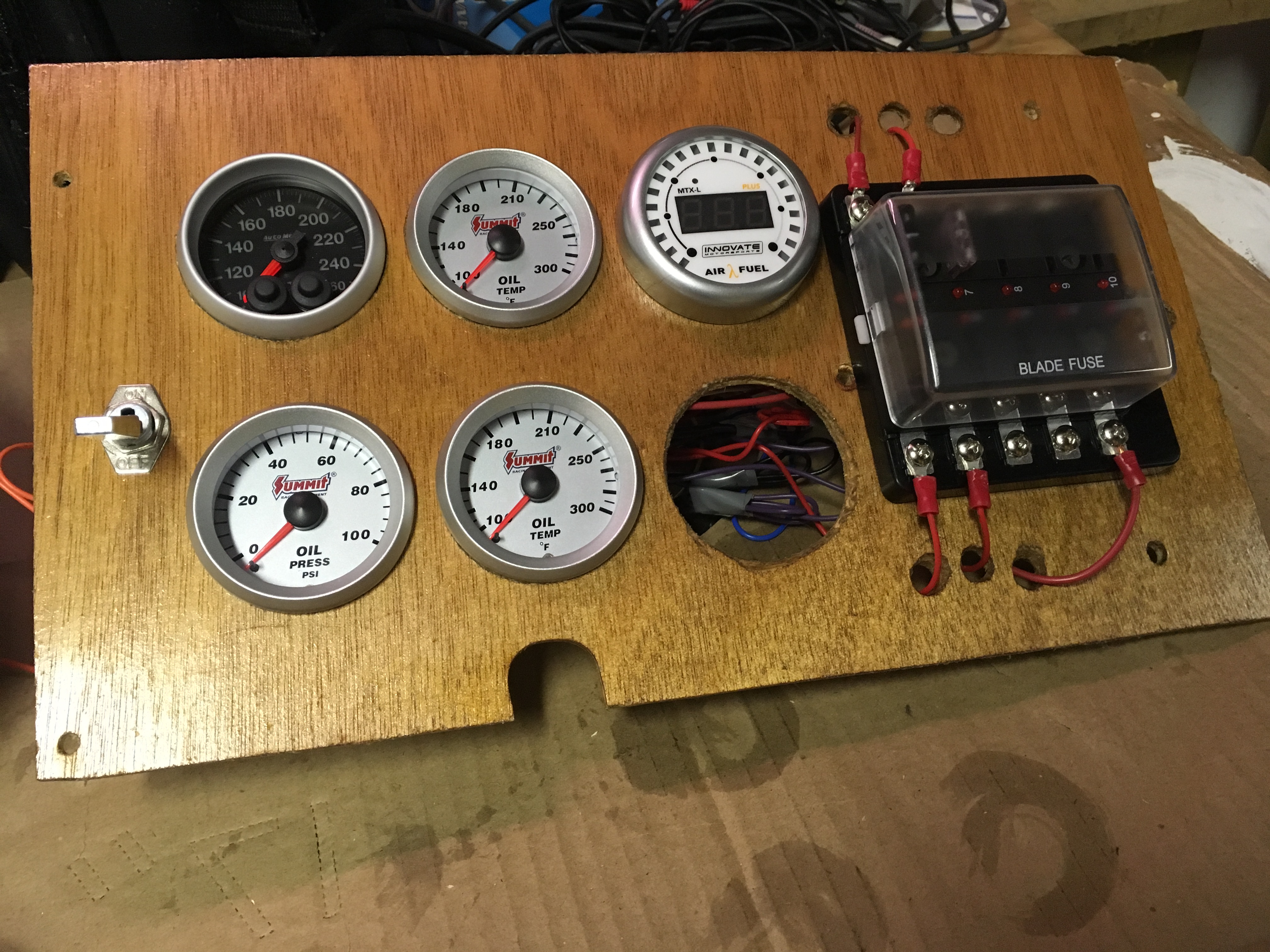

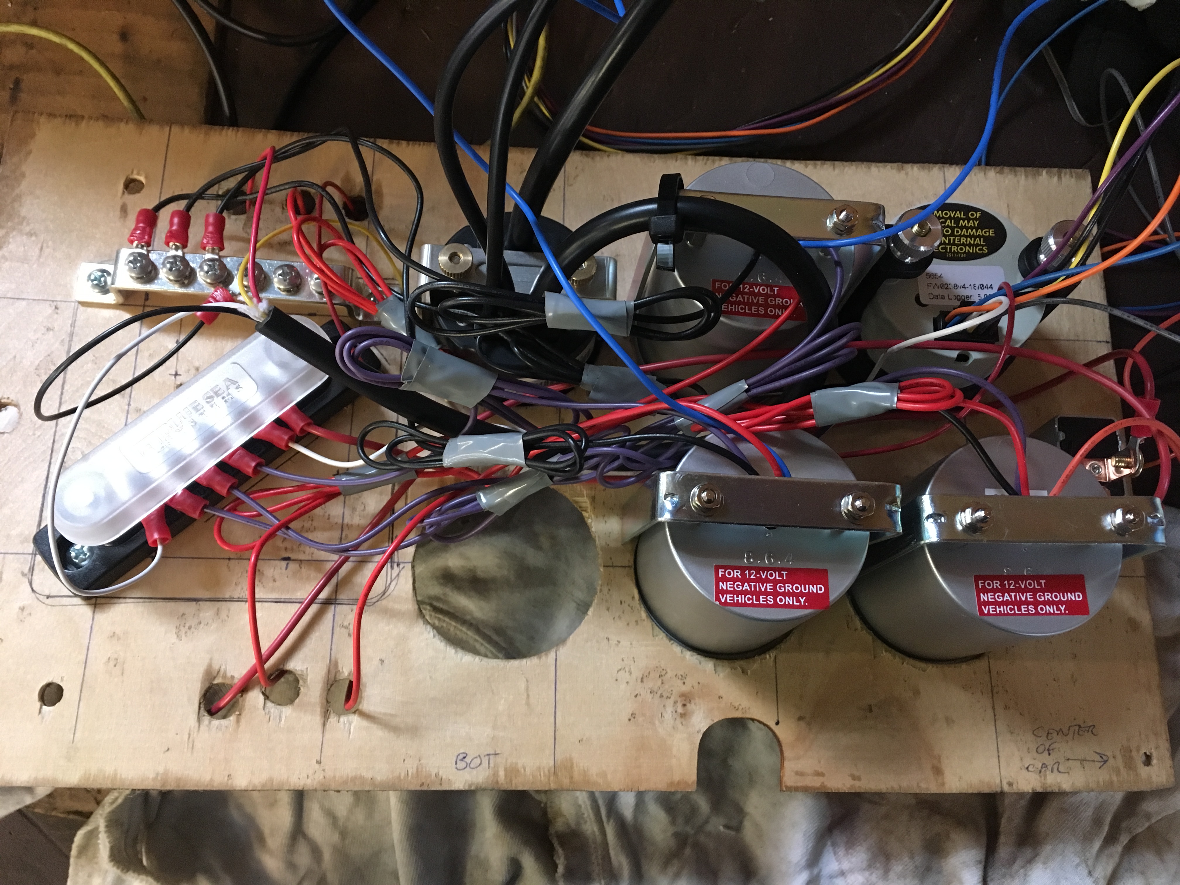

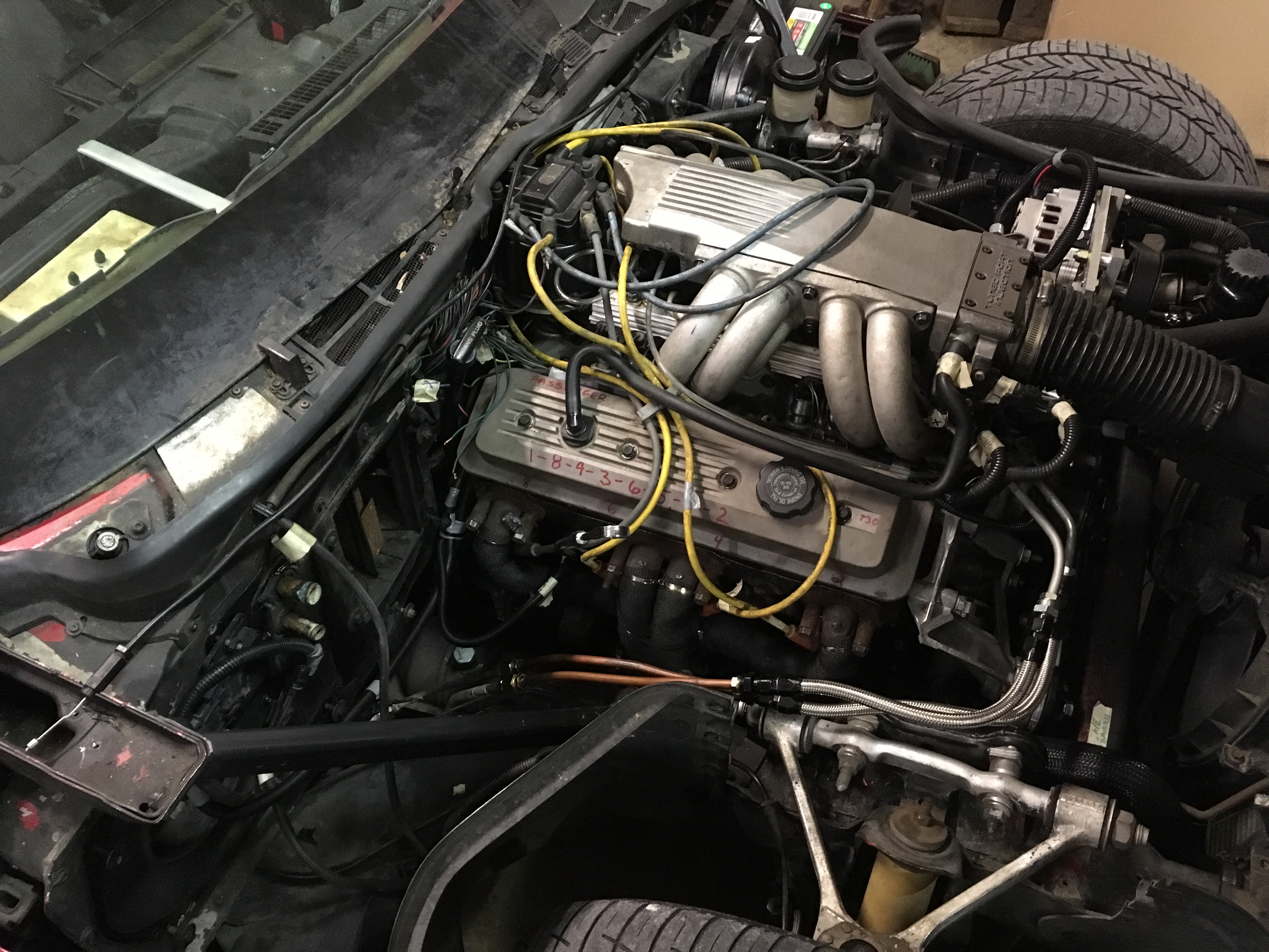

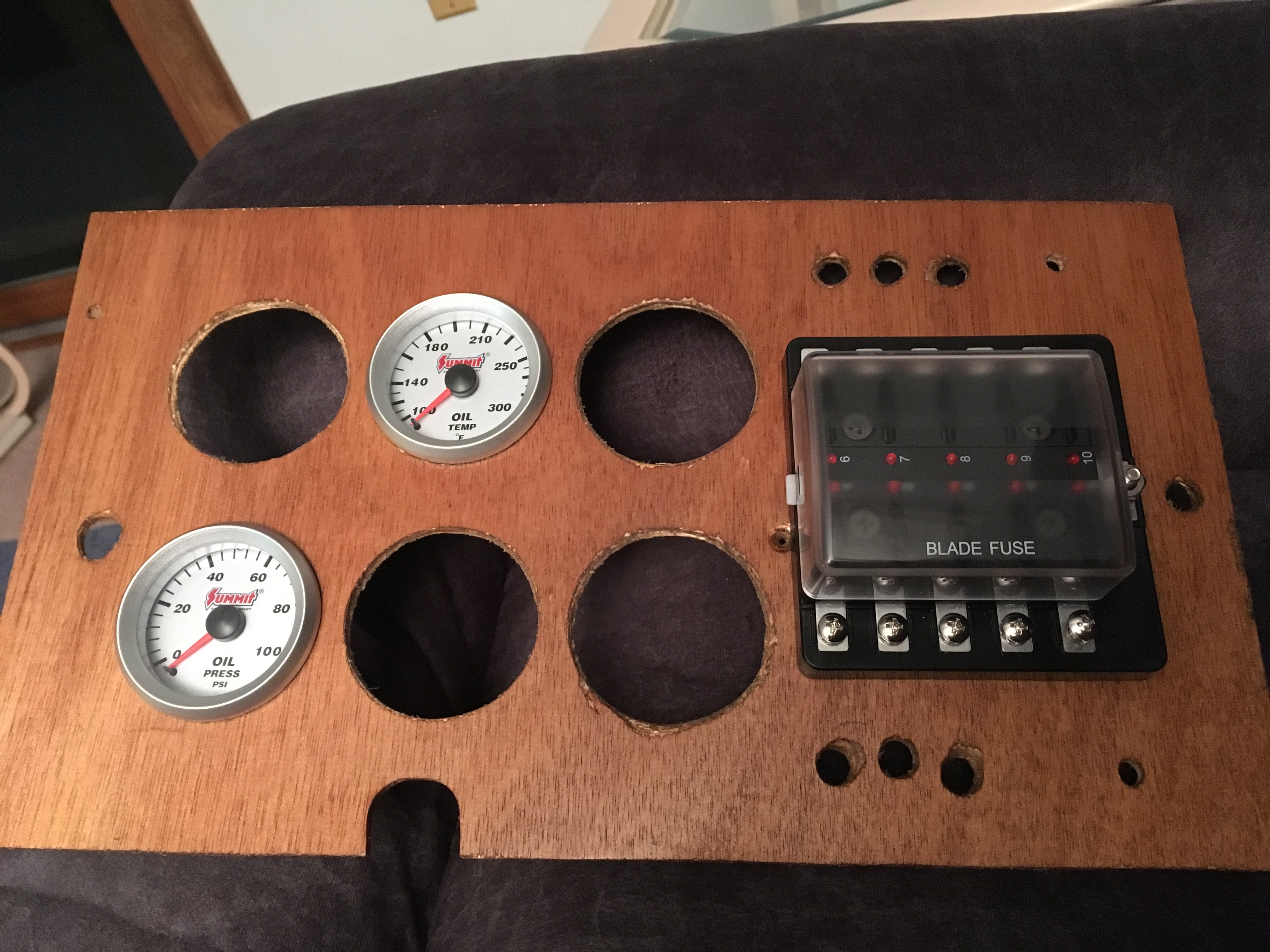

Working on a temporary gauge panel. Have a fuse box and a bus bar for the ground and for the gauge lights. In this pic there are only two gauges but I have five installed now. Engine water temp, engine oil temp, trans oil temp and air fuel ratio. Also bought a six wire connector to use for the sensor wires that needs wired in.
Re: 89 Corvette Mostmint #39

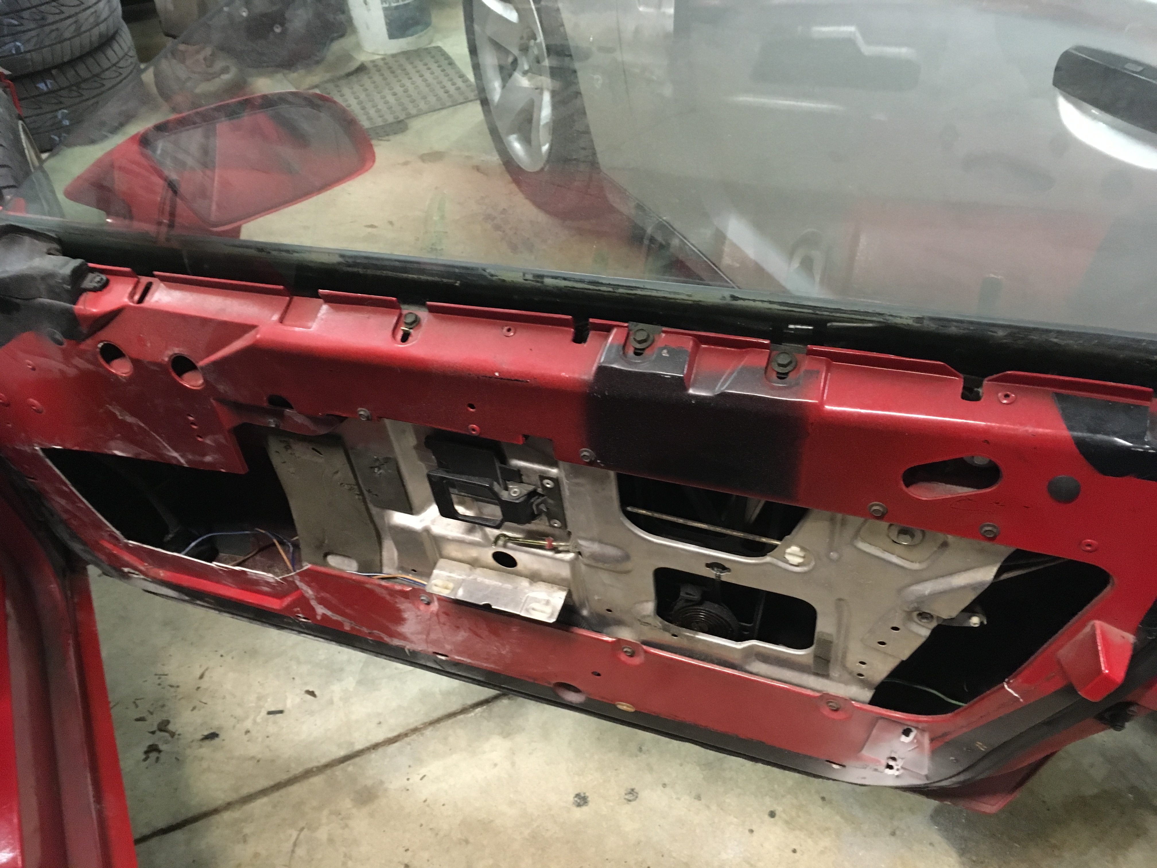

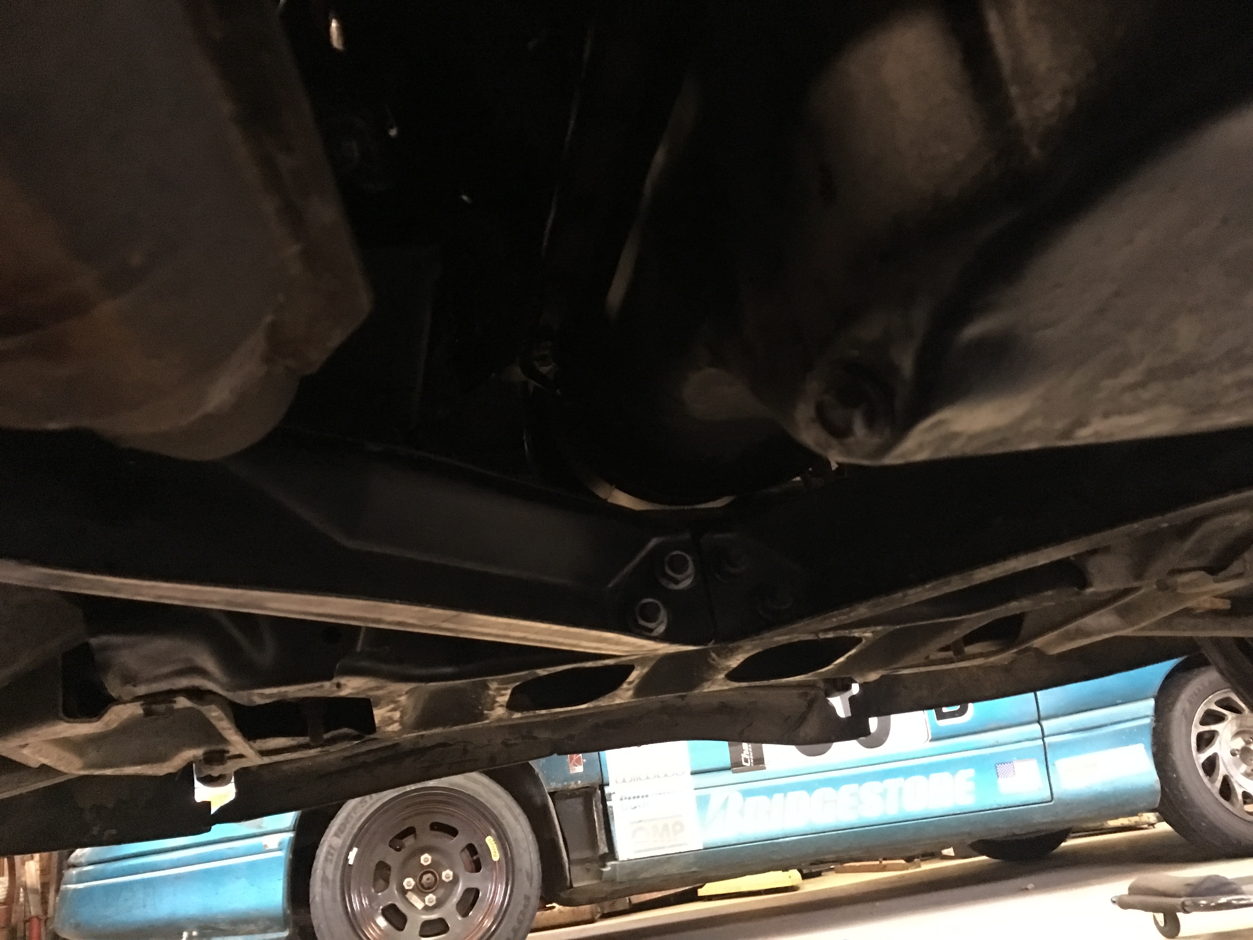

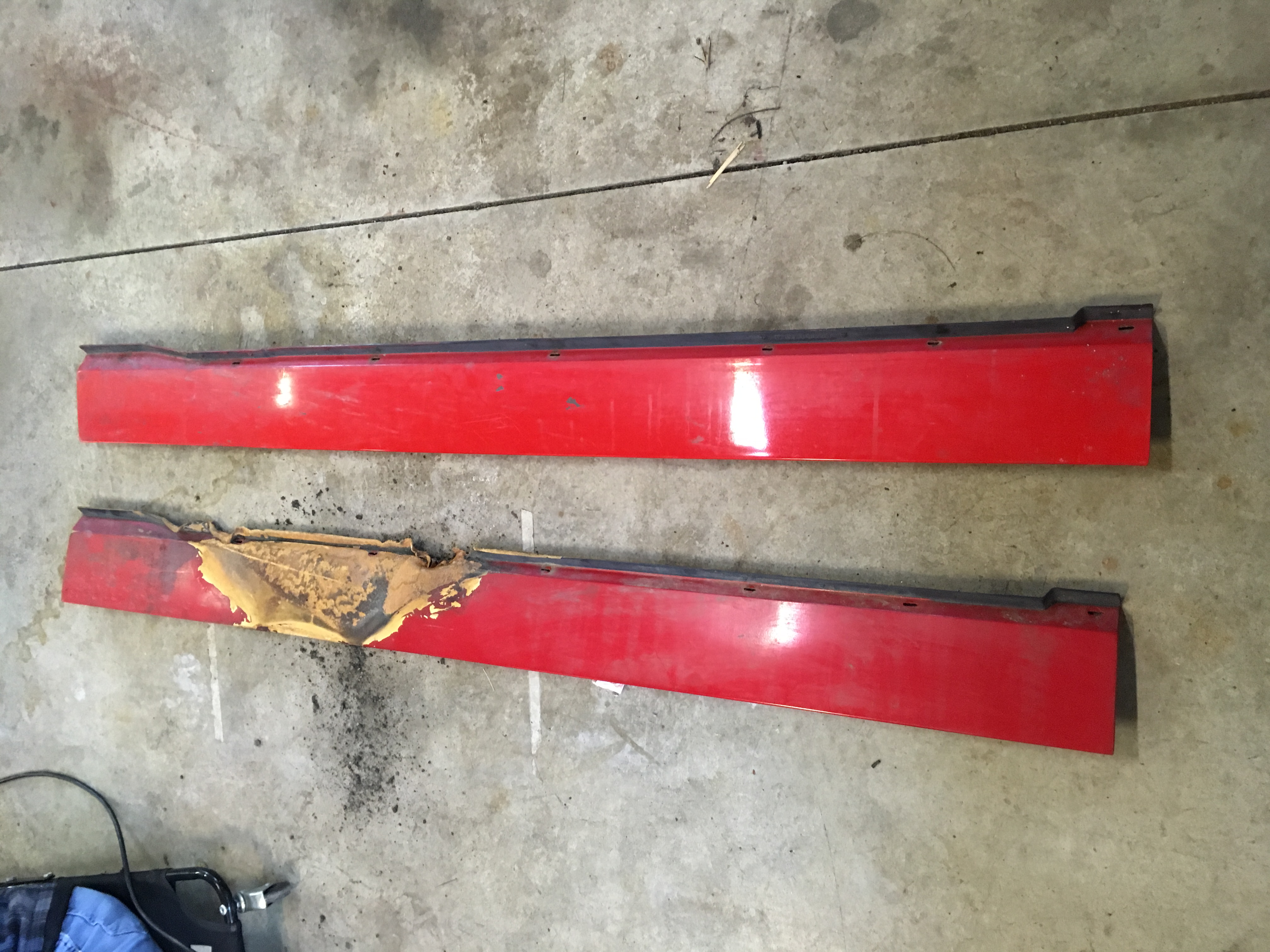

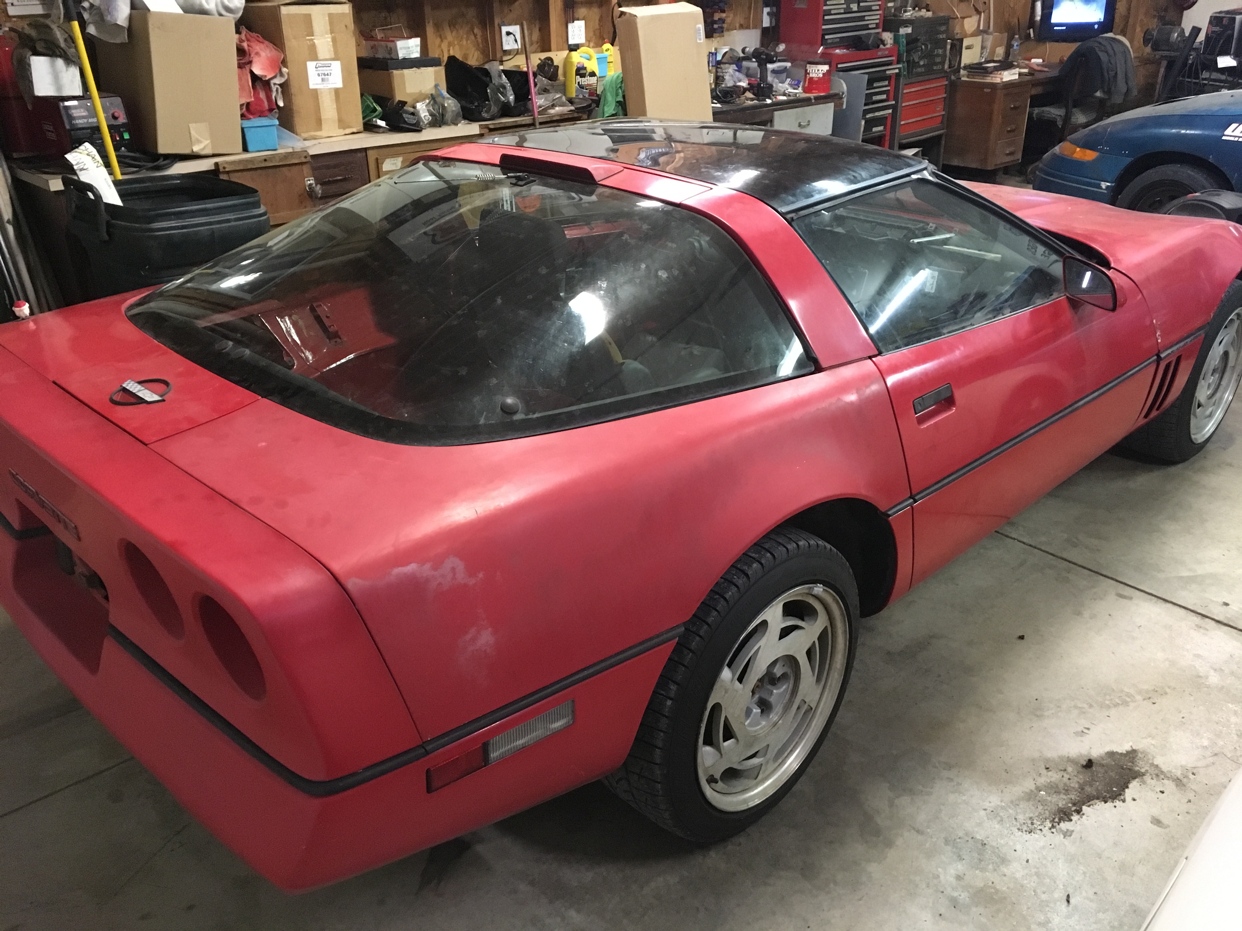

Two work sessions on the Vette since last update:
1) Installed the RF inner fender center section. Took a bunch of fabricating since the part we had was from an earlier model and GM changed the part.
2) Fixed the targa top it had some bolts loose on the support bracket at the top of the A pillar.
3) Replaced the RF headlight frame (discovered the headlights pop up OK but they don't come on
4) replaced the melted right side rocker panel

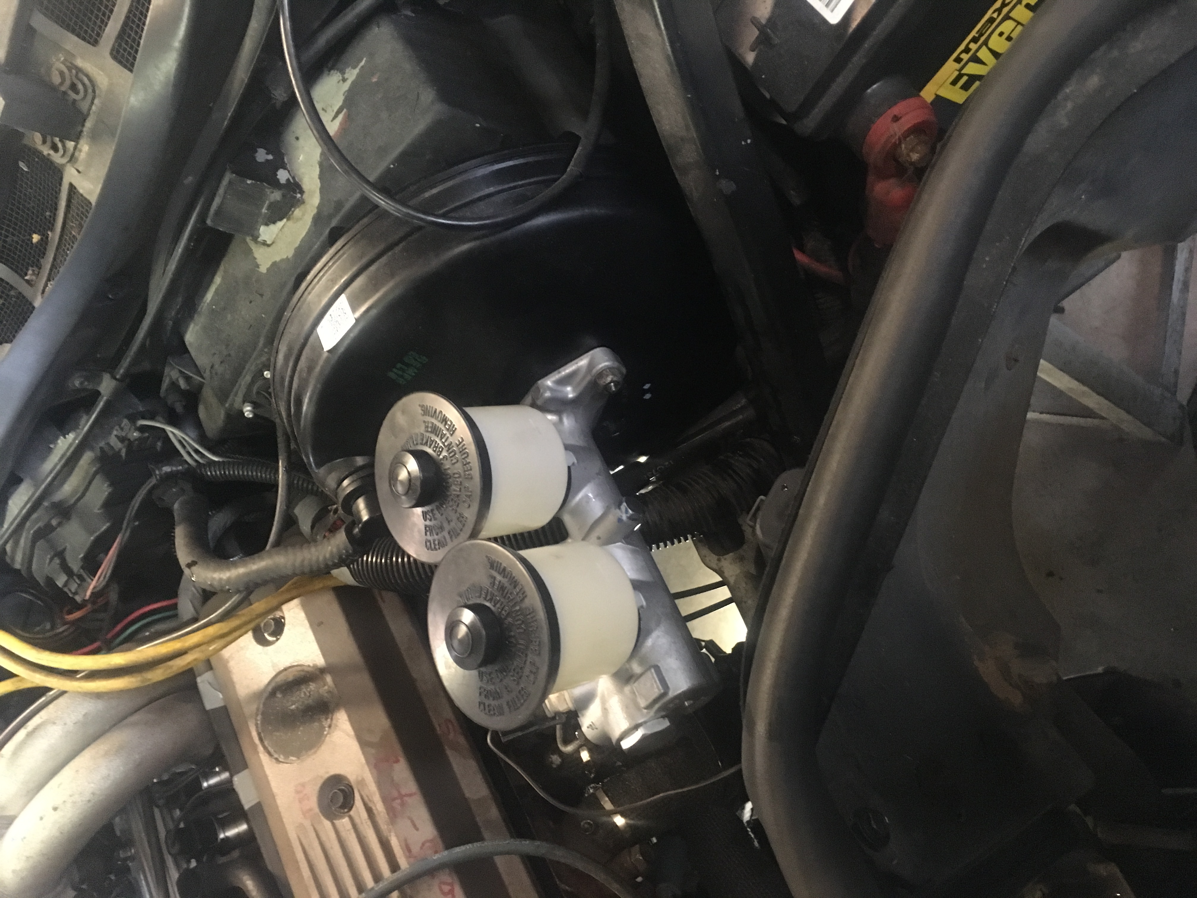

5) installed the new master cylinder

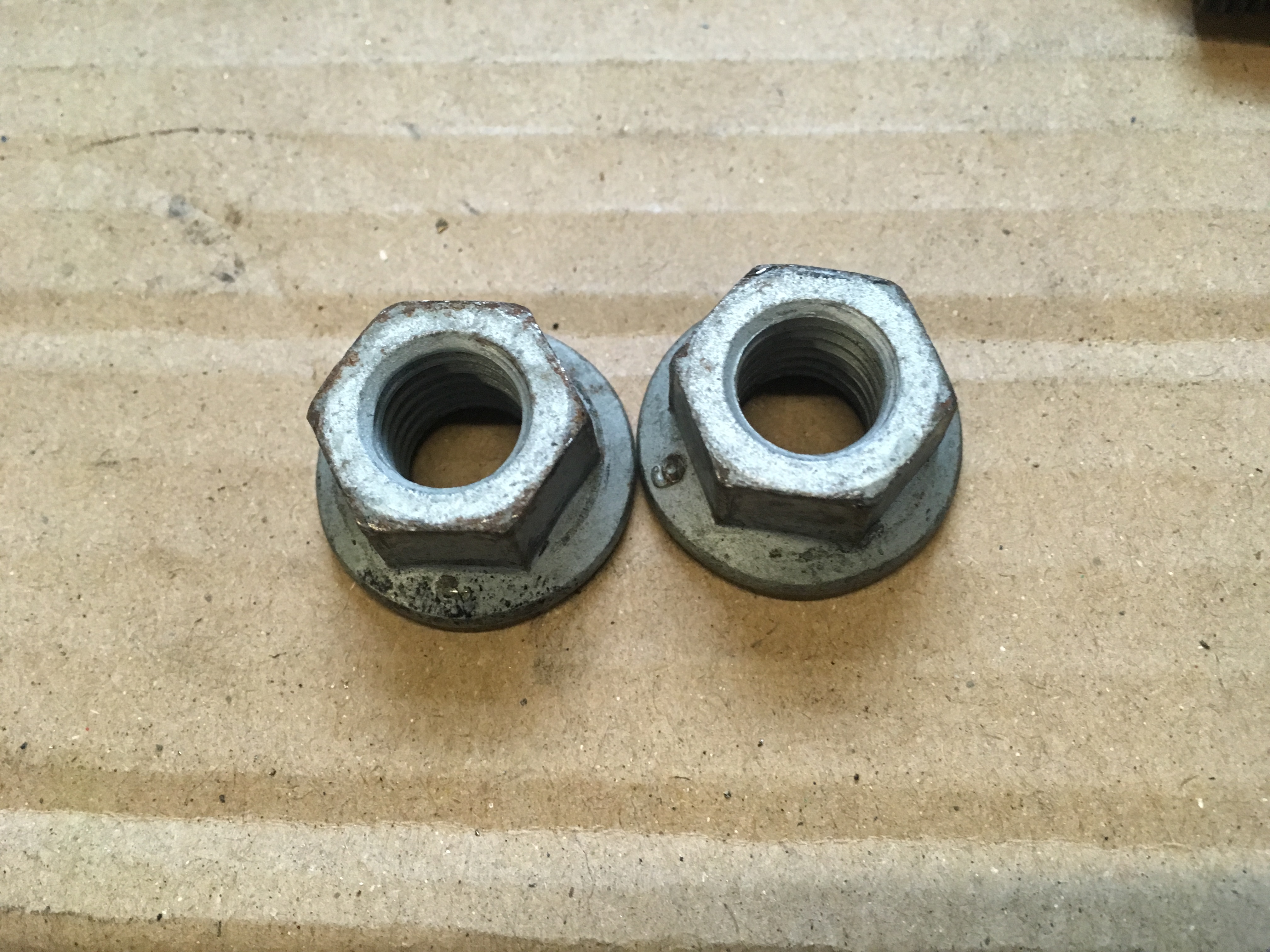

6) installed cradle to frame brace on LF (used a couple nuts from the Charger to secure this)
7) more prep work on the exhaust manifolds for the straight plug heads.

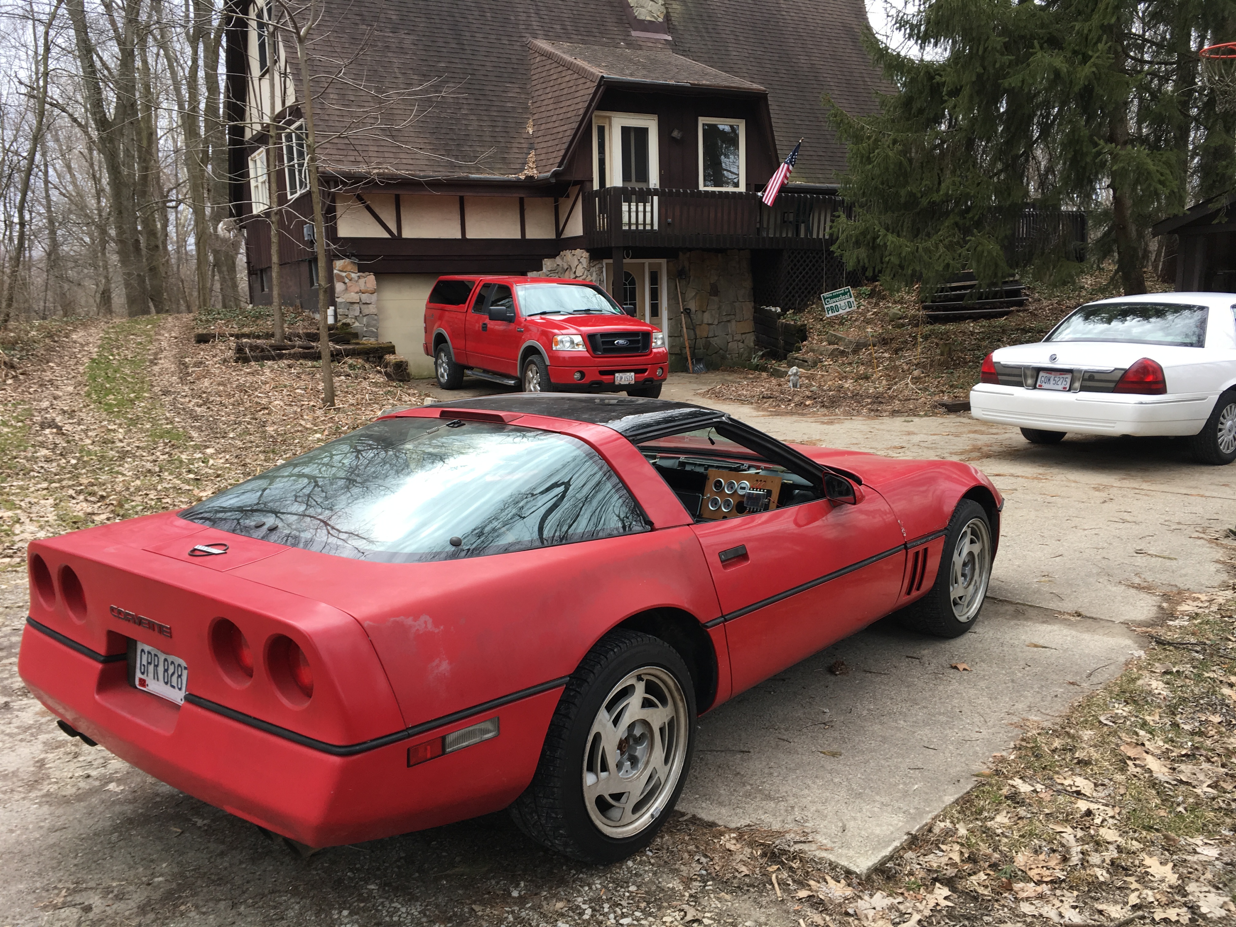

I also got license plates yesterday. Hoping for a road test soon.
In between this I did update the temporary gauge panel

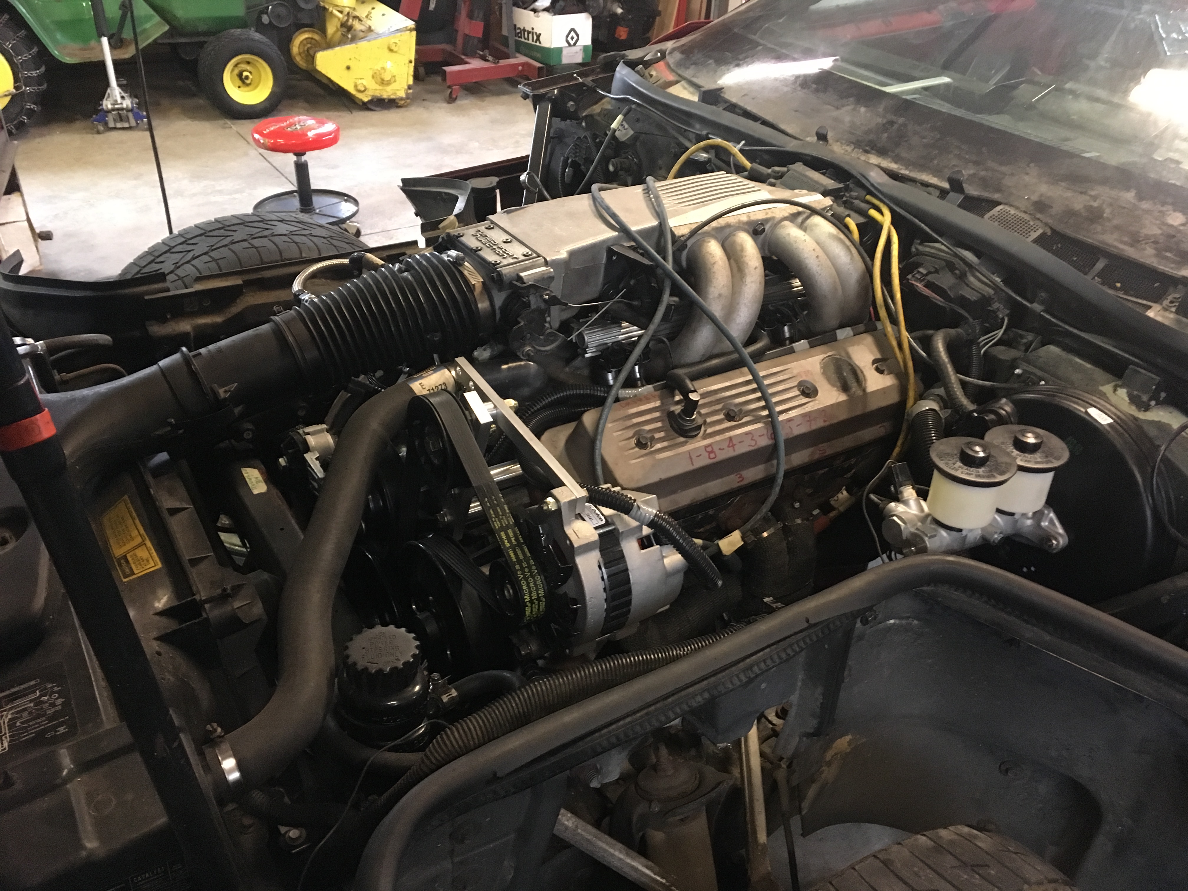

Some additional pics

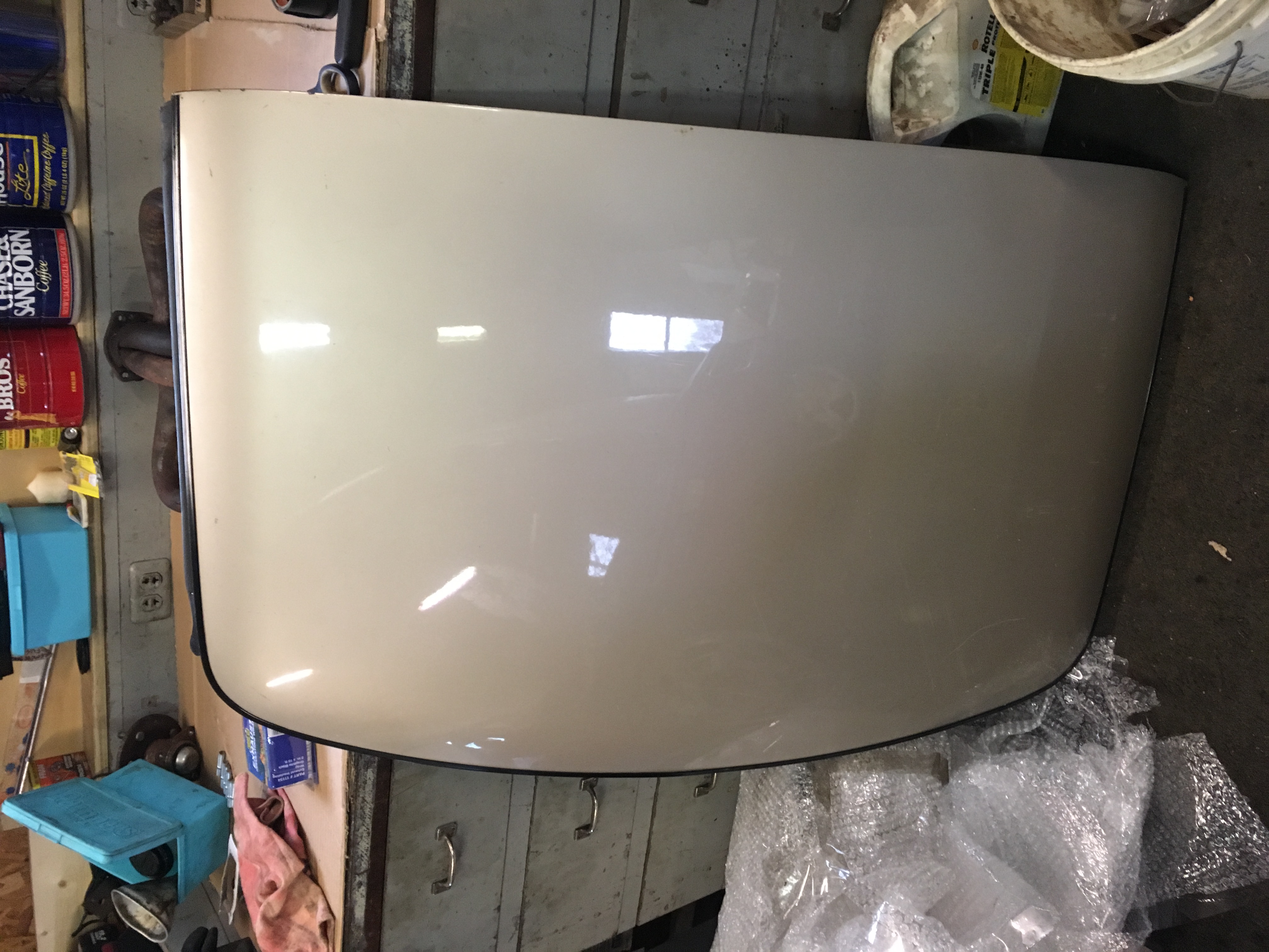

Took the car for a test drive a few weeks back. Suspension feels good, brake pedal is right up, car tracks straight. This engine does not rev - it's done by 4500 RPMs. You can feel the torque - it puts you back in the seat. We did uncover a couple issues: some type of grinding on left rear, and cooling fans do not come on.
Found a deal on a fiberglass top so I bought it - can't race with the glass top

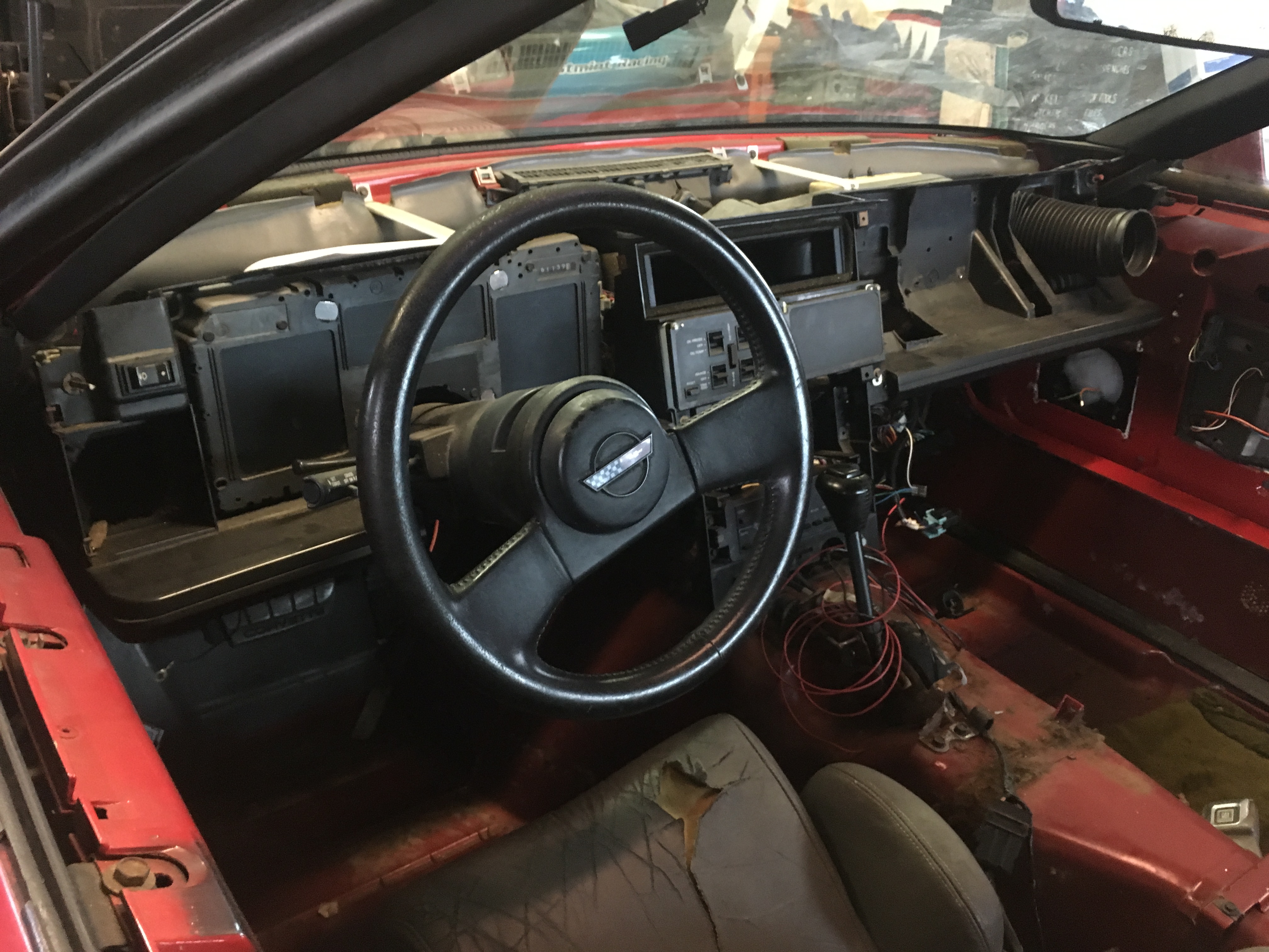

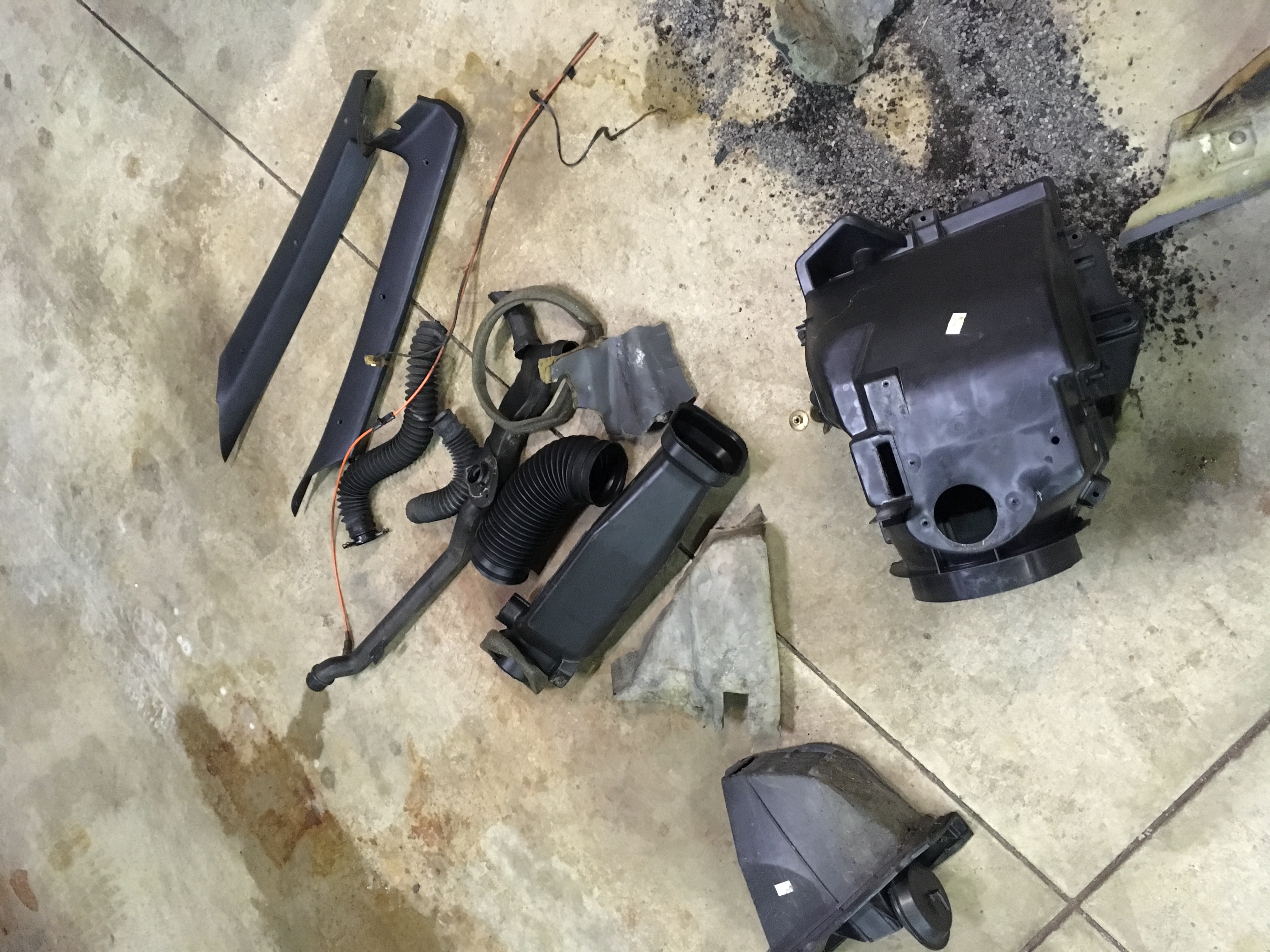

Spent a little time on level 2 weight reduction - removing heater core and supporting ductwork on the passenger side last weekend. I also made a list of all the electronics that are staying and those that are going.

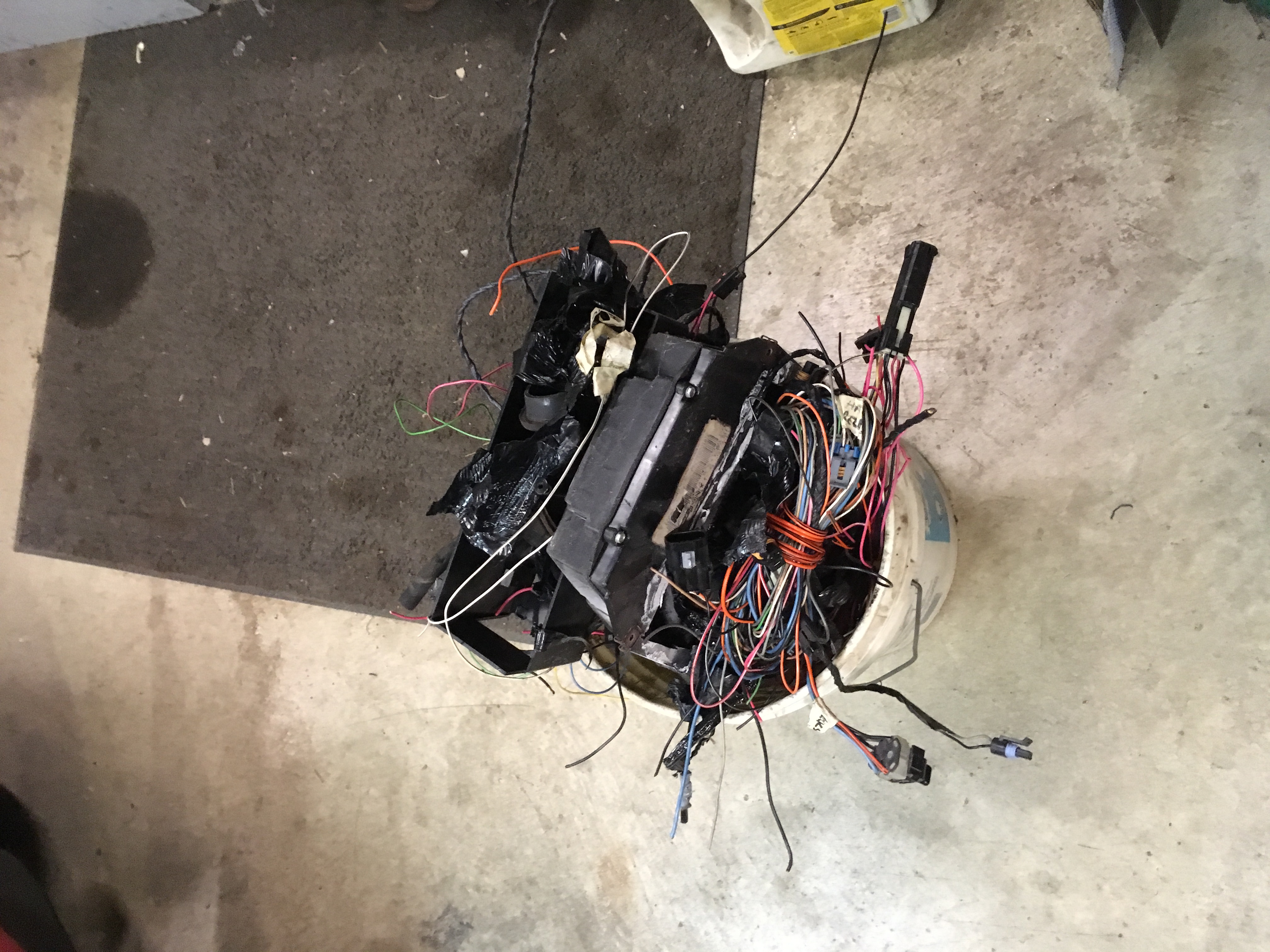

Yesterday Kurt and I worked on some additional weight reduction. Focus now is on wiring. my friend Mike took 90 lbs of wiring out of his 90 Corvette so I know there is potential. Kurt started in back, and I went to work on the passenger door. The door has many wires: power mirror, heated mirror, power lock and switch, power window, courtesy light, door ajar/vehicle security, speaker, rear hatch switch. They are now all gone from the passenger door except power windows.
I have also removed the tape/bundling wrap from the harness on the passenger side enabling removal of now obsolete wires.
