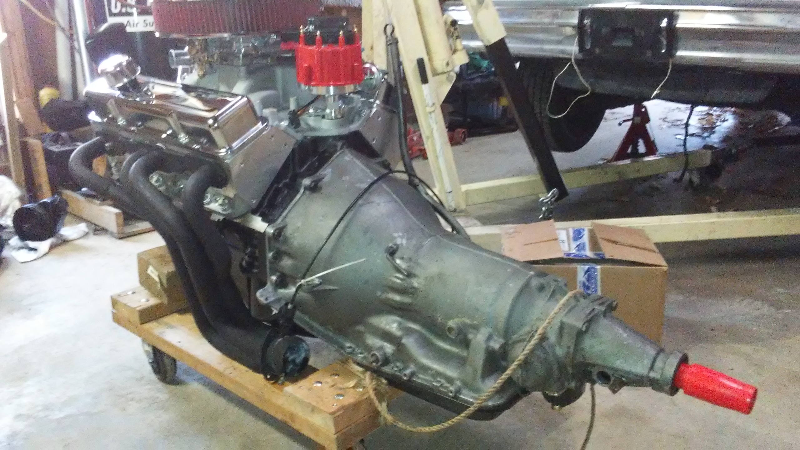

Engine and trans are mated up. Getting all the threads chased and everything test fitted. Clocked the Powermaster mini starter closer to the block and the right header clears it nicely. The left header clears the 4.X" WIX oil filter. Getting the accessories mounted. The chrome aftermarket bracket for the alternator needed some messaging to fit with the new manifold. Still need to clean up the alternator.

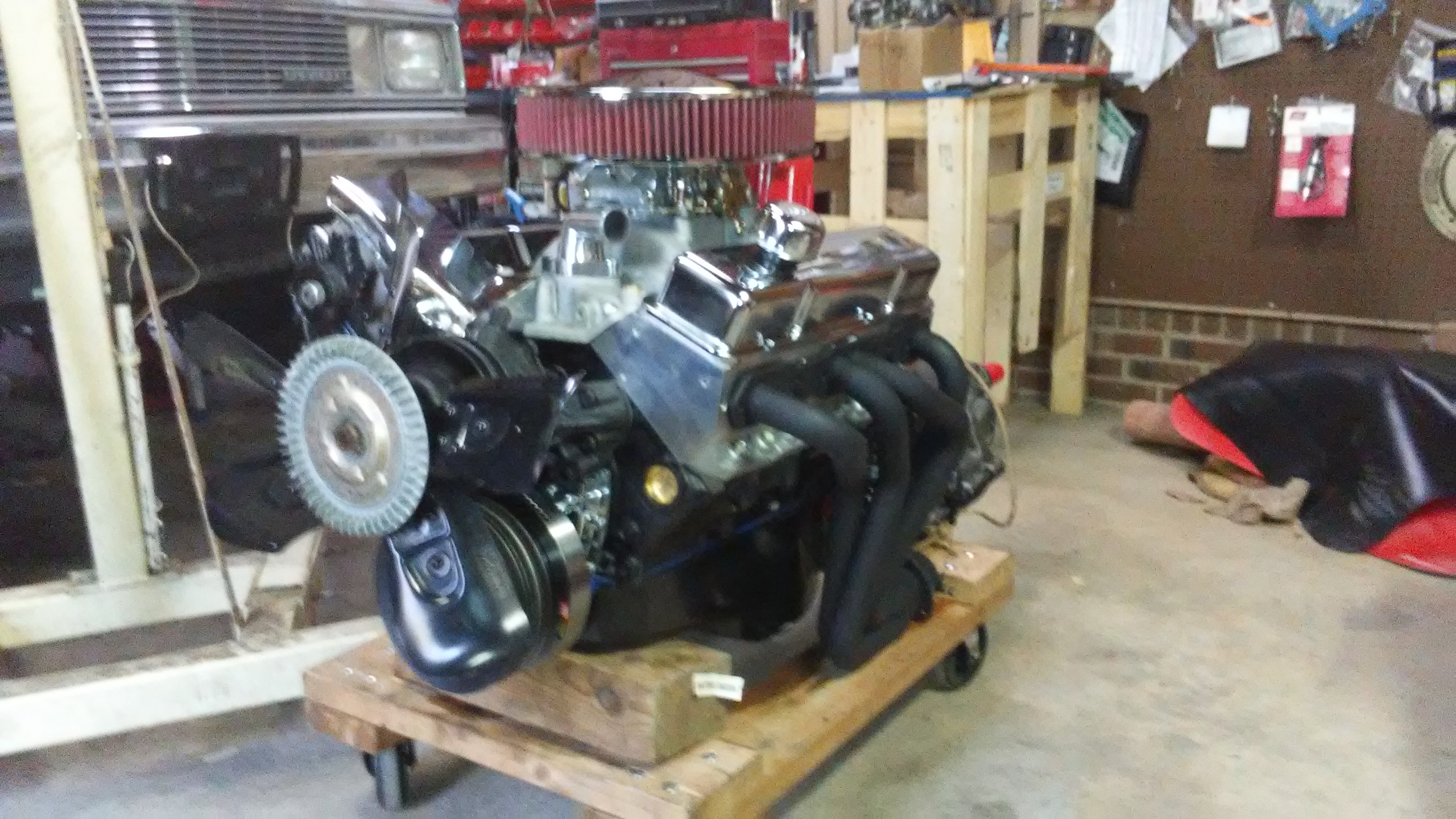

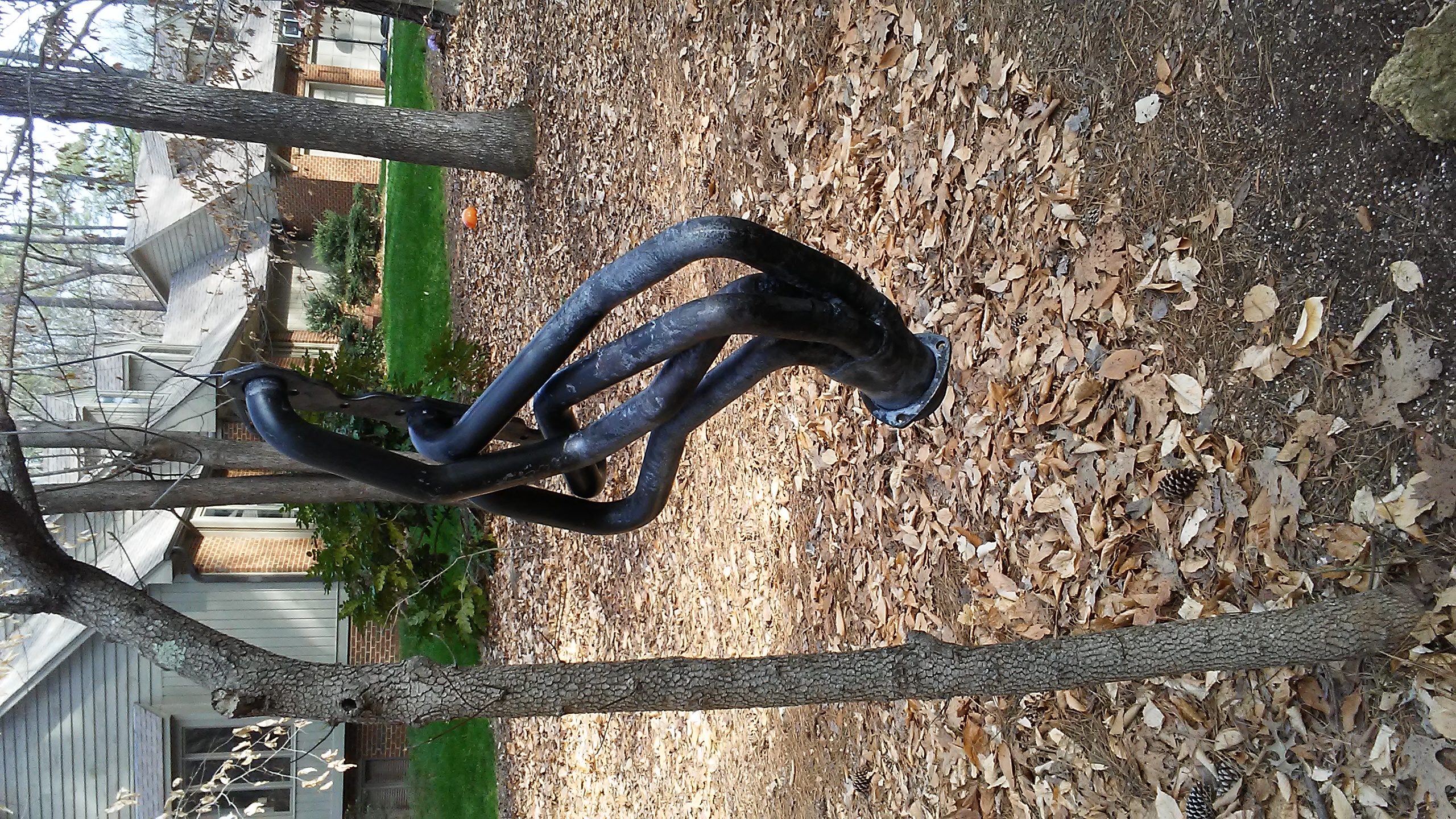

VHT paint came Saturday. Got the left header de-rusted and painted. Right one is drying before painting.
Pictures are with my new smart phone. Focus was good on the header picture but sucks on the engine pictures. Maybe I'll figure it out someday.

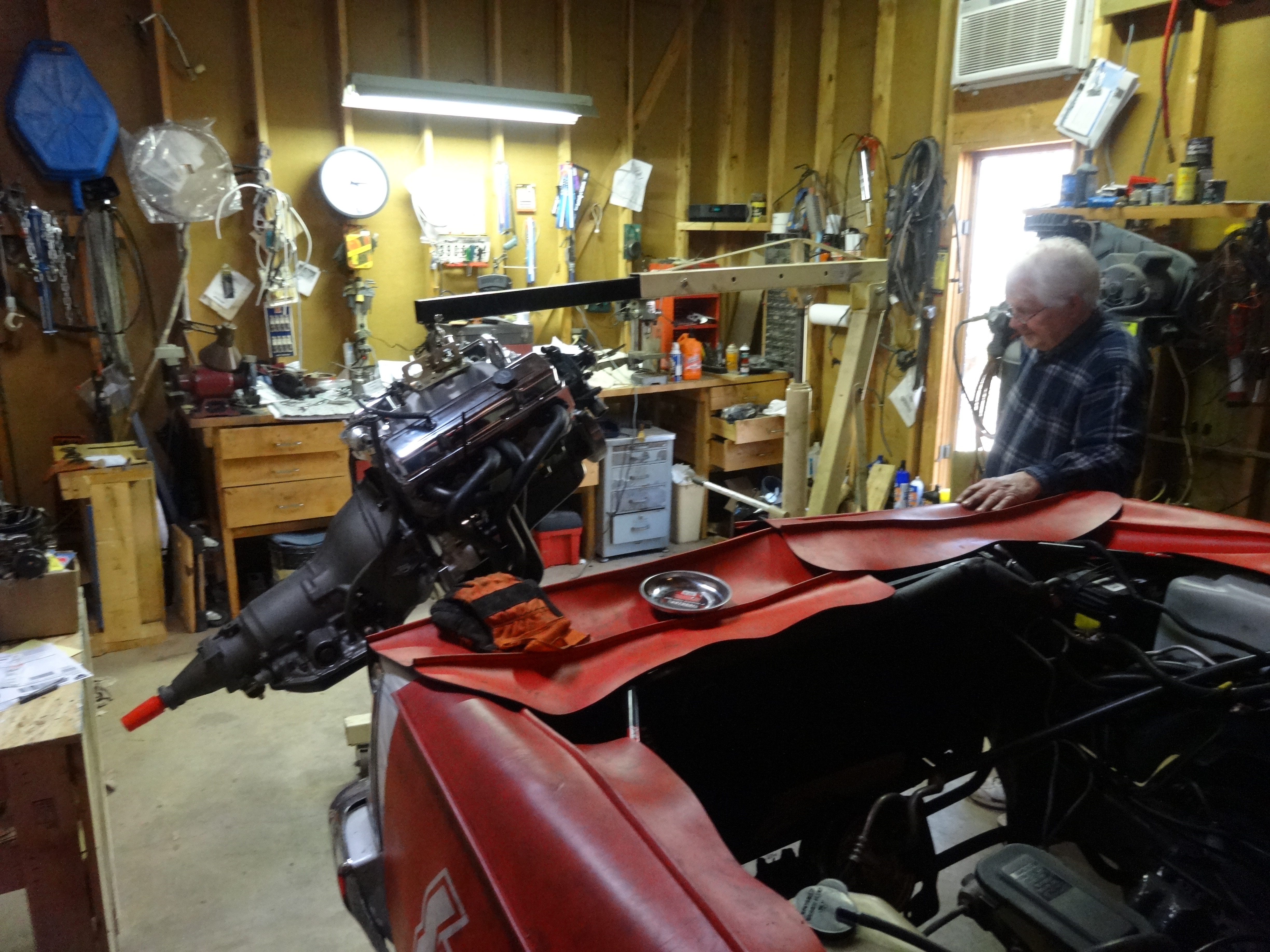

Mocked up the engine for pictures while the right header is drying.
The plan is to put the engine/trans in tomorrow. Still some details to sort out before it can be started.

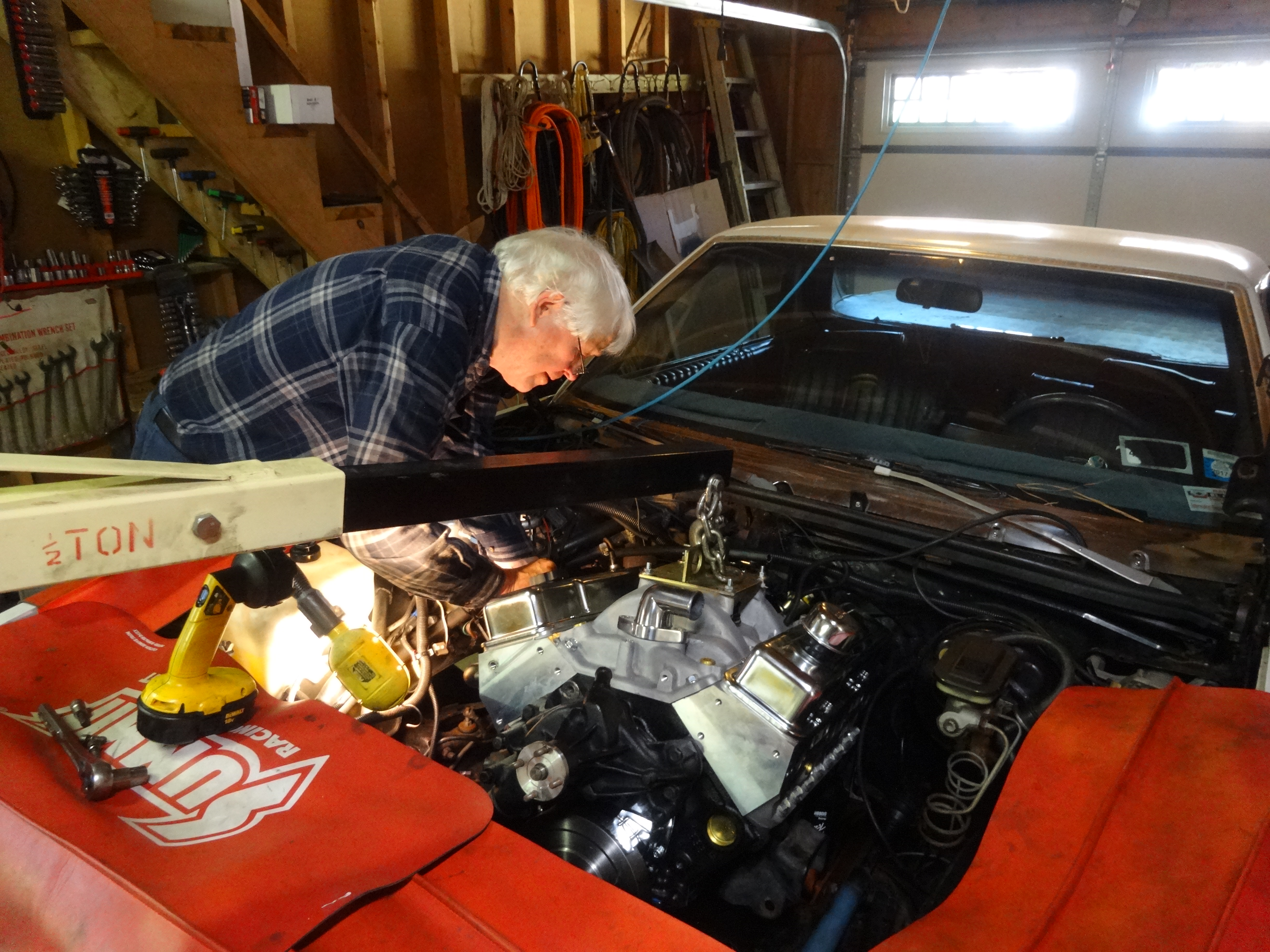

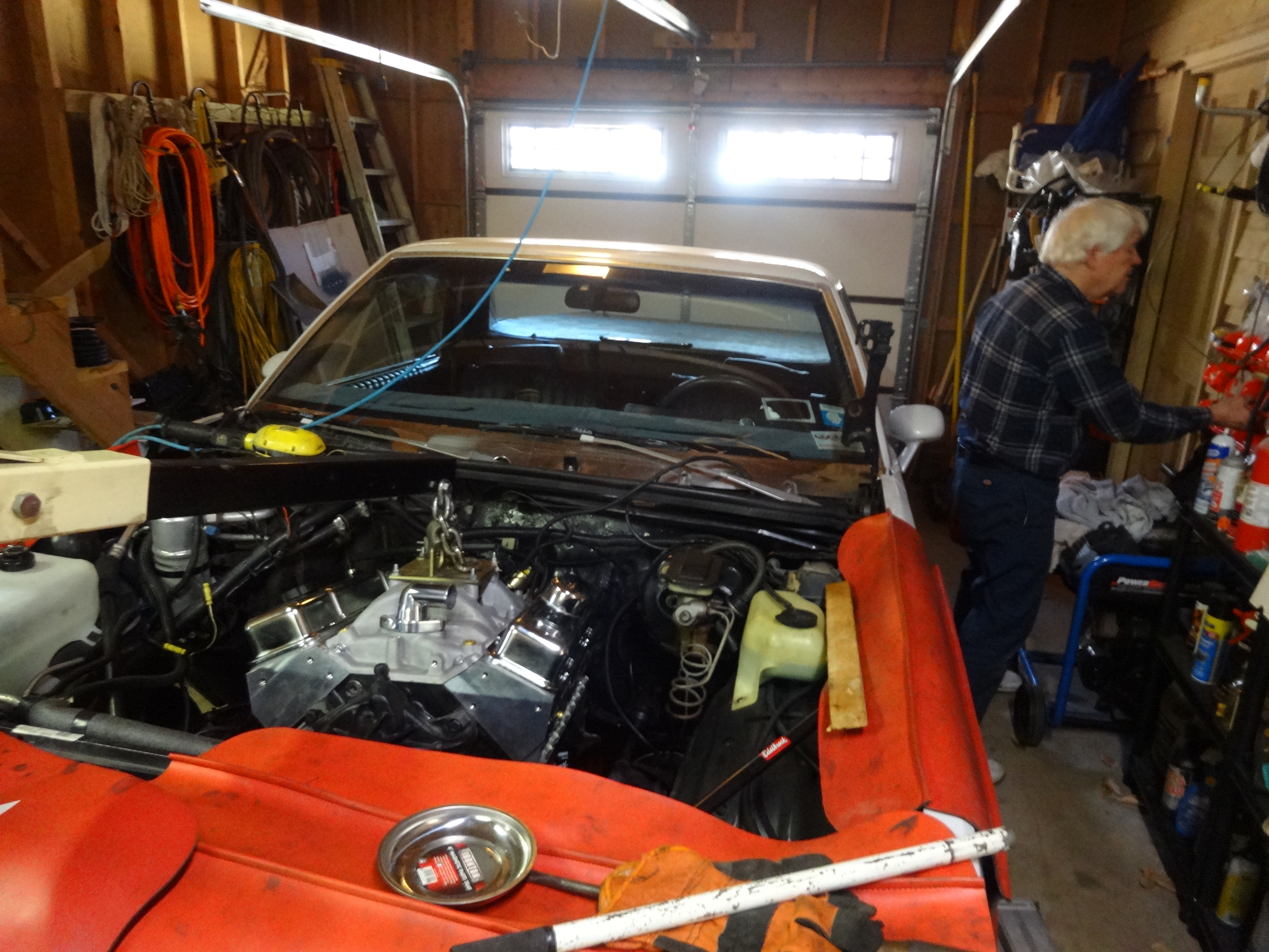

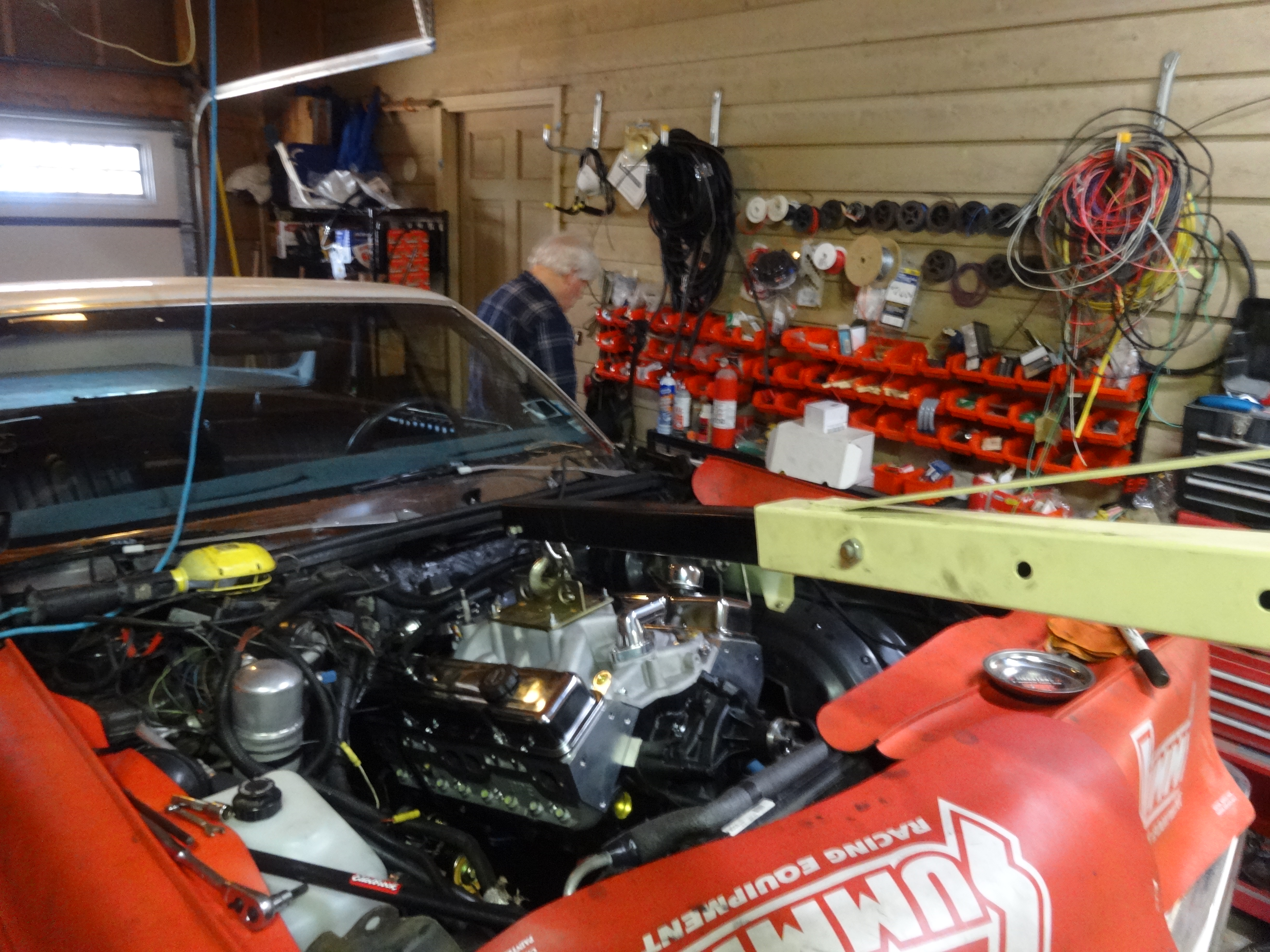

WXO and friend, Jim, came over yesterday and we got the engine on the mounts after a lot of difficulty. It looked to me like the engine/trans would go in with headers attached and save us a bunch of problems. That was a really bad idea. Maybe with just the passenger side attached? Nope. We tried both ways and FINALLY gave up and removed the headers. Then it went on the mounts pretty easily.]
However, the transmission mount appears to be an inch plus off to the right side. I suspect the problem is the V8 engine stands (which replaced the original V6 stands) aren't just as they should be. I'll try loosening the bolts fastening the engine stands to the frame and see if maybe there's some play that would let the engine yaw a bit so the trans mount will bolt up to the X-member. If not, ... oh, boy!!
The Allen head header bolts that I picked up work great EXCEPT under the tube bends. Gotta find my header bolt stash and get some hex head bolts under those bends.

Maybe asking a dumb questions, but is it possible for the new tranny mount to be mounted in there 180deg off? Some Ford ones can be put in there backwards... Any chance the hole in the crossmember is off center?
Re: 1981 El Camino
There is a front and back to the trans mount but the holes are symmetric. There's a bulge in the rubber that goes toward the back of the car.
The G-forcej X-member has been used by a lot of El Camino guys with no complaints about off center trans mount. Eye balling the drive shaft tunnel the trans appears to be off center a bit.
I"ll try shifting the frame mounts. If that doesn't work, I'll think about what to try next. Sure hope I don't have to struggle with those headers again. But, if I have to, I now know the sequence that works and I'll have some more convenient header bolts.
Re: 1981 El Camino
False alarm. Only one of the two X-member-to-trans-mount bolt holes, 1+ inches apart, line up with a bolt hole in the mount but that's OK. The instructions for the mount say only one bolt is used for some applications. The old trans mount only had one bolt there. Installed the drive shaft and it fits in the tunnel OK. Another hole could be drilled in the X-member and the second bolt installed but I don't think its necessary. X-member is in and trans is mounted.
Swapped the header bolts out for some locking bolts. The locks will be installed when the bolts are re-torqued after a few heat cycles. The locks on some of the hard to reach bolts are a PAIN to install. Doubt I'll get a lock on the rear-most bolt on the right header.

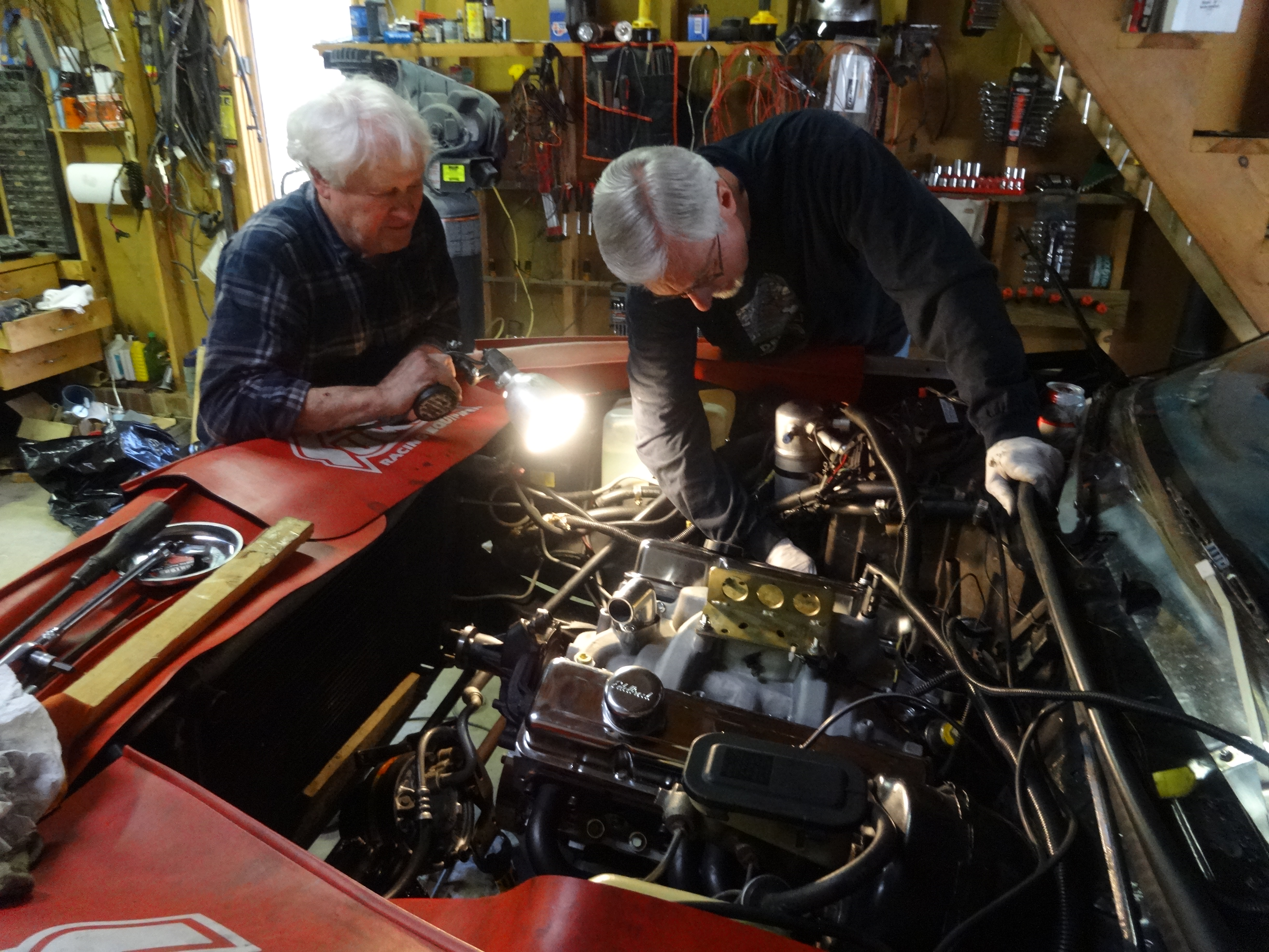

WXO and Jim came over yesterday and we got all the accessories and brackets figured out. Tightened that all up today. We also got the power steering hoses routed yesterday and tightened up today. AC/PS belt is either too long or the sides are worn so much its going too deep in the pulleys. The adjusting bolt hits the end of the slot and prevents that belt from being tightened. A 1.5" shorter Gates 7550 V-Belt belt has been ordered.
