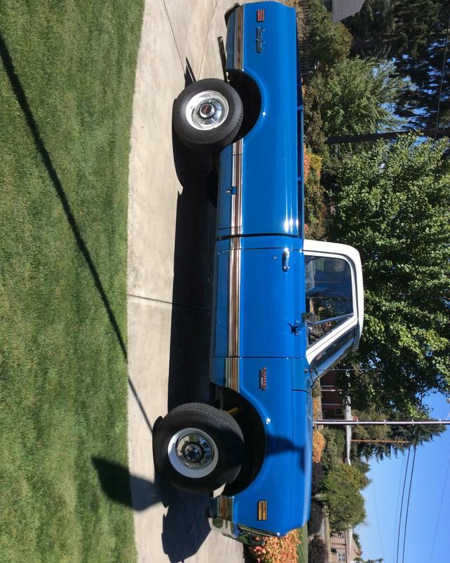

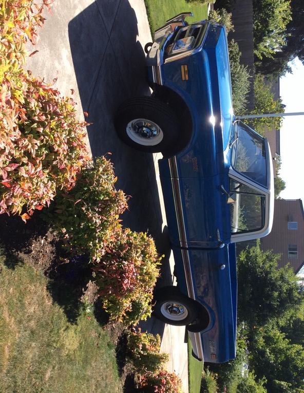

Good news and bad news...... Good news first. I found a set of Ford steel 16" x 7" eight lug rims locally.
I bought the set and got the rims for less than $50 / rim, which was a pretty decent price, as they are
in pretty nice shape. They are black and will need to be painted white before going for tires. Now the bad
news. Only three of the four rims will take a hubcap! The guy who I bought them from helped me load
them and it wasn't until I got them home that I realized that one didn't have the "bumps" to hold on the
hubcap. I'm toying with the idea of welding on some bumps, but I can get another rim on Ebay for about
$50 - $65 dollars. So the rim decision has been made. On the way home from buying the rims, I stopped
at a local tire store. The guy at the counter was nice and showed me the different tire sizes next to the
truck in the lot. I felt that a 265/75-16 was the best option. He was a bit skeptical that that size would
clear the fenders on the front when the truck turns. He tried to talk me into getting a 245/75-16. I came
home and searched out pics of both sizes on the trucks just like mine. The red truck has the 265's on it and
the blue truck has the 245's on it.... I'm leaning toward the 265's still. Both of these guys are running Ford
16" x 7" rims on their trucks, so it gives a nice depiction of what they should look like on the truck.

Ak... The tires that are on the truck now are 7.50 - 16's. Aside from the fact that the ride is horrible
with them because they are bias ply's, they are just to skinny and the back spacing on the rims is
4.5". They set way to far in. One dude on a forum said that tire combo looks like a fat guy on a
bicycle! HA!! Anyhow, both tire combo's are working for other guys, and I'm leaning heavily toward the
265's because they will fill up the wheel wells best. I've seen at least 5 posts of guys with that tire
set up on their C20's, so I feel I'm pretty safe. It's difficult to find a tire that is not really aggressive
with its tread pattern. I'm hoping to find a more mild road tire. Many of the options I saw on TireRack
are SUV tires and have heavy lugs on them. More research needs to be done........ and I just purchased
the last wheel on Ebay. It has the hubcap bump on it, and I should have it in about a week or so.

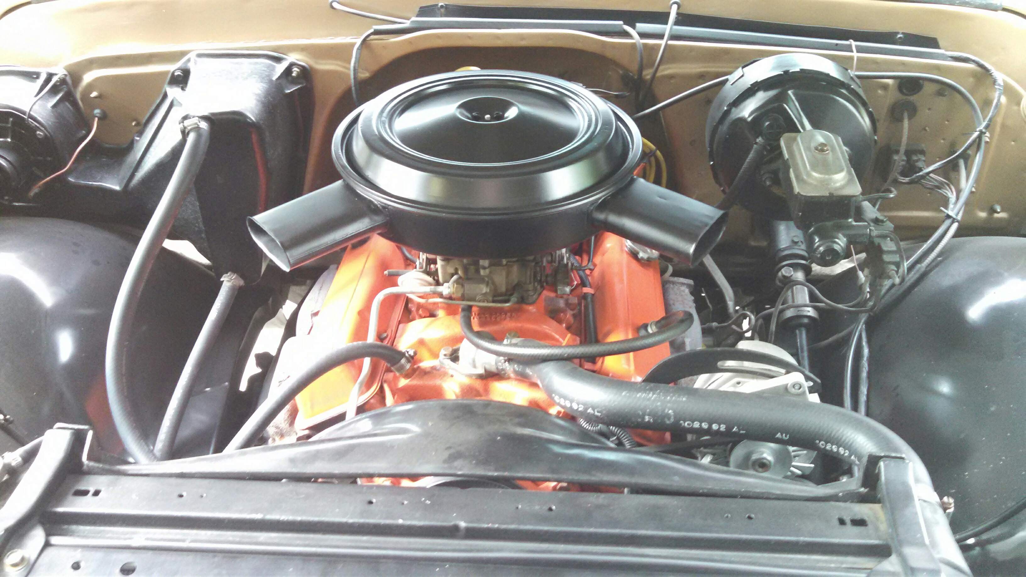

I FINALLY got the dual snorkel air cleaner assembly on the truck today. I had about twenty
minutes of fab work to do to get it correct. The spacer between the carb and the air cleaner
wouldn't allow the snorkels to be centered up on the motor. A bit of trimming with the whizzer
wheel and that was fixed. I had to install a longer stud as well, but that took about a minute
to cut to the correct length. Once it was on the motor, I took the truck for a spin to the car
wash rack. It sounds GREAT! Just like a QuadraJet is supposed to sound like. You can actually
hear the carb over the fan now. I degreased and painted the fan today, and purchased the stud
kit to install it. That'llbe next week's project. I also "fixed" the directional signals that had stopped
working. When I went to check the fuse in the fuse panel, the directional signal relay thing was
not pushed in the correct way in the fuse panel. I must've kicked it with my boot while my feet
were sliding around on the old floor mats. I also put the final coat of paint on the new wheels
today. I still haven't ordered tires, but that'll happen here pretty soon. Today was good!
