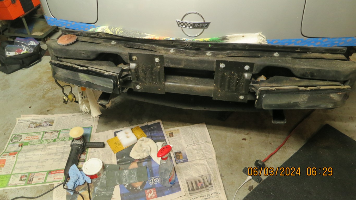

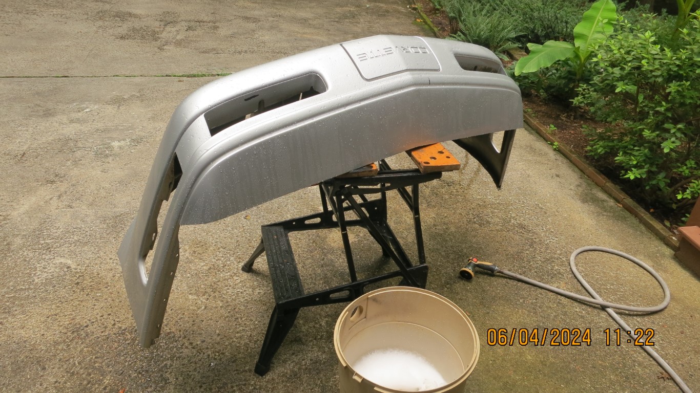

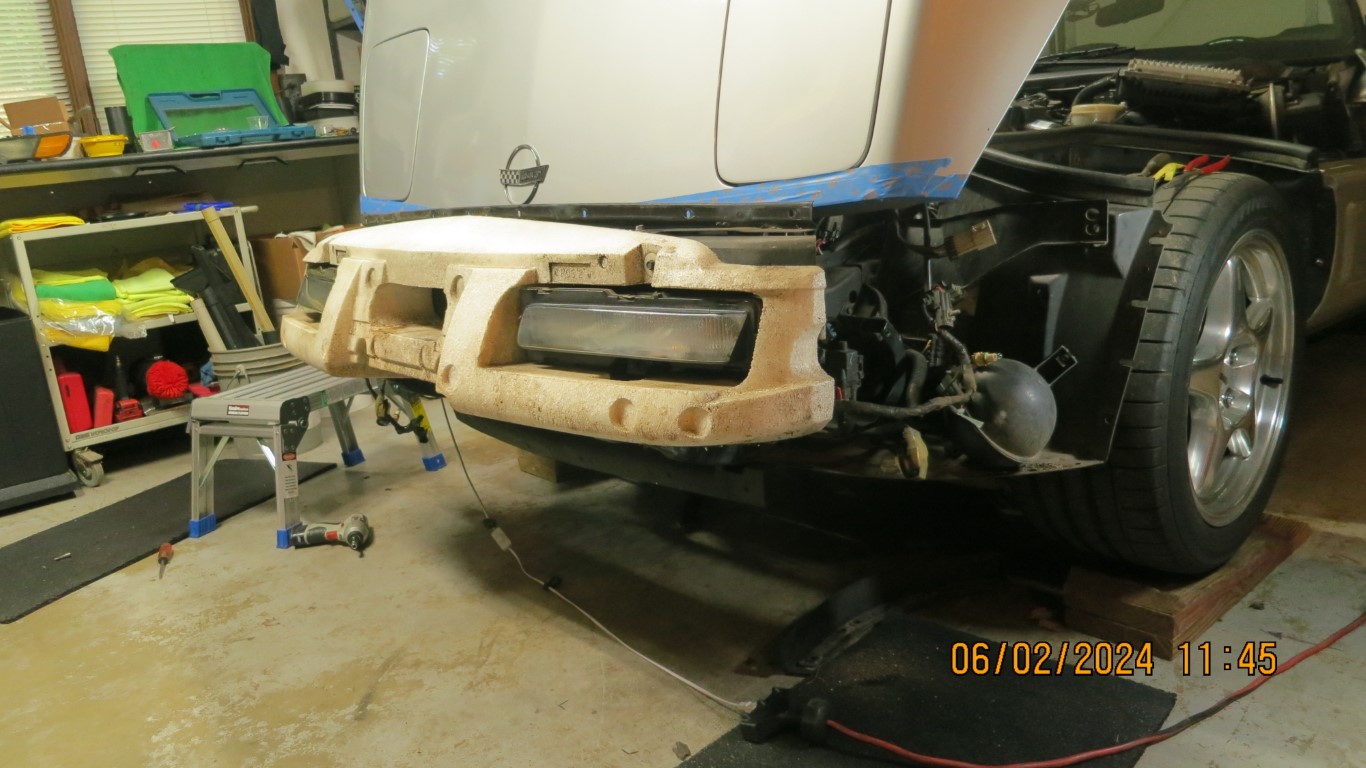

I lost count of all the screws. I don't think there were 56 because at some point, my '96 did not match up with the YouTube video. I had to figure out some of it on my own to get the cover off. It's quite a tedious job. Once I got access to the four lens housings, I saw that someone had sprayed some tint on them and made a mess of it. I could see runs and swirls in the lens. The next part was also tedious. I started with 400 sandpaper and worked up to 2000 grit as a first step. Then I used red rubbing compound followed by two grades of plastic polish. The final coat was Meguire's car polish. I may be the only one who notices the difference after all this work. Following are some photos:
With the front bumper cover off.With the foam bumper removed.Front cover washed and ready to go back on.

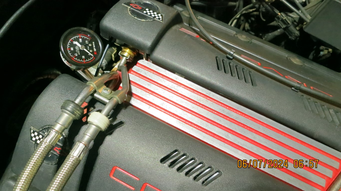

I found this adapter on Amazon to enable an easy install of a fuel pressure gauge on the AN4 fuel rail test port. I think the AN4 fitting is common to the older GM 43psi fuel injected vehicles.
It's claim to fame is an adjustable pin, that upon installation, depresses the Schrader valve in the fuel rail port to allow fuel to flow up to the gauge.https://www.amazon.com/dp/B00GS8RDE4?ps ... ct_details

I, like a few others, ended up with leakage issues with that fuel rail adapter for my fuel pressure gauge. I took it off. I'll probably send it back when I find the rest of the components that came with it. I spend more time looking for stuff than fixing stuff
The leak is fixed. I found this on the web:
You could try specifying a gap-filling, anaerobic, semi-hardening pipe sealant instead of PTFE tape. You could then turn the valve to the right orientation without worrying about exceeding the installation torque – leave it slack(ish) and let it stiffen up as the compound sets.
I used some Permatex hi-temp Thread Sealant. After applying it to the male pipe threads and screwing everything together in the orientation I wanted, I just let it sit for 24 hours and it's good to go. No leaks and tight as a tick.
