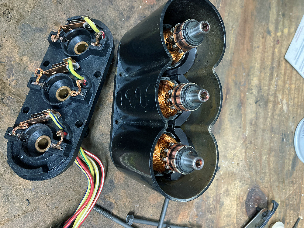

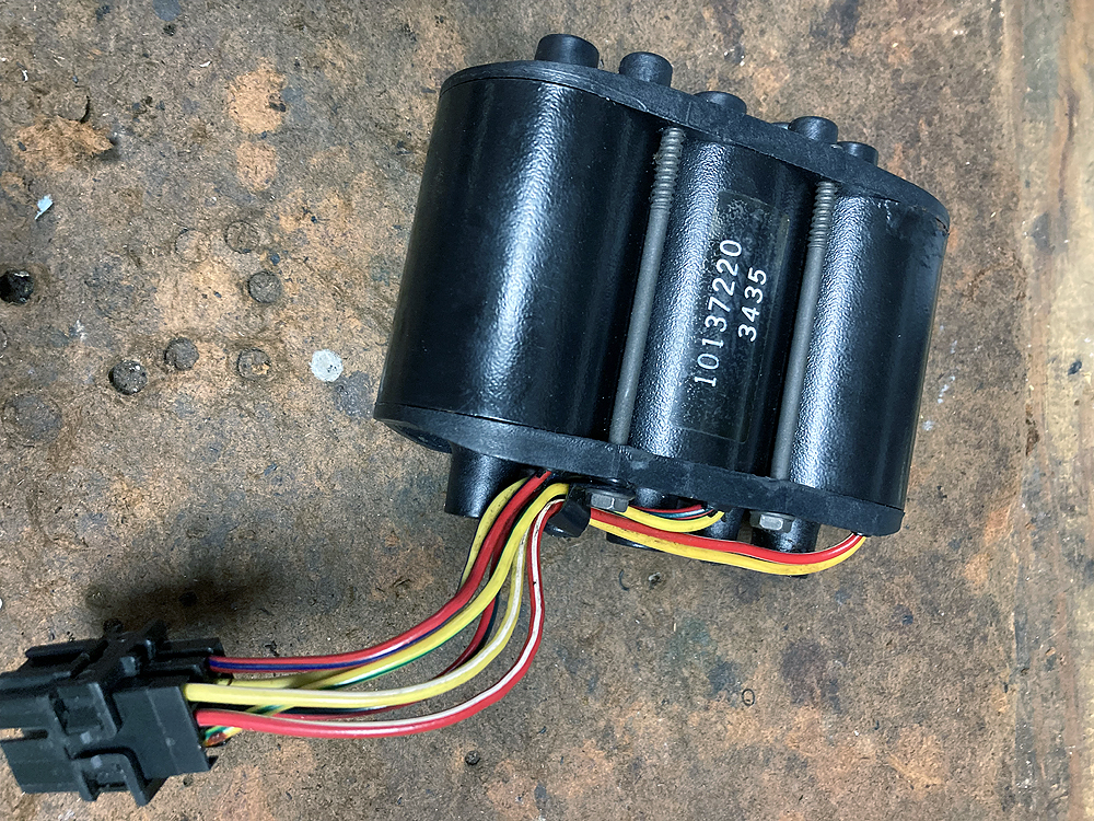

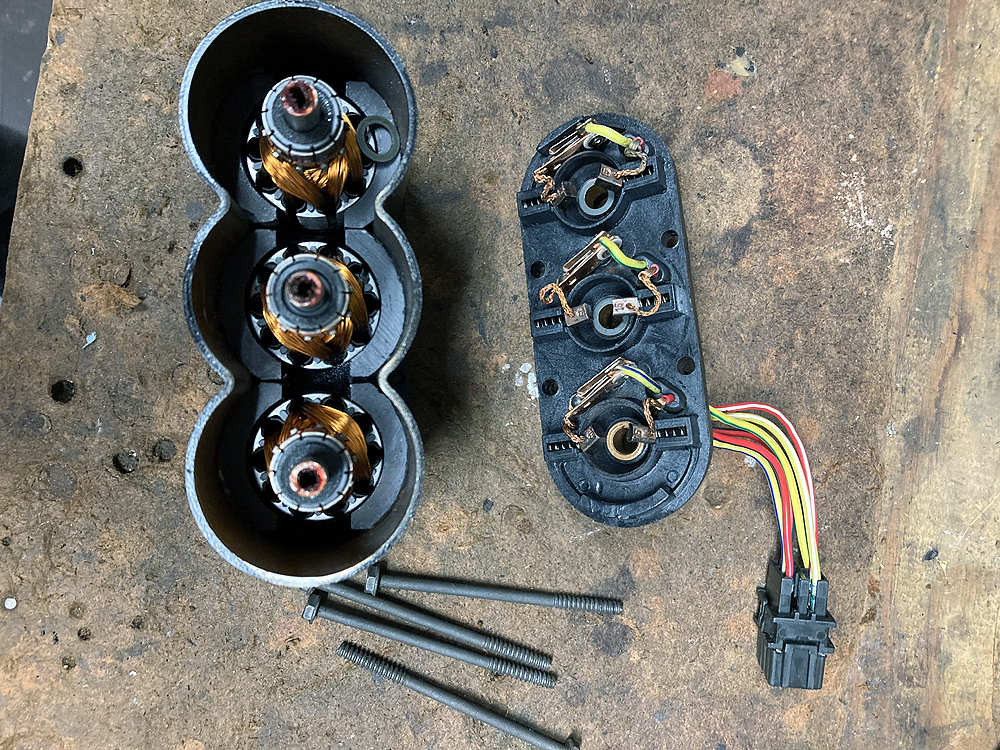

I'm getting a lot of experience on C4 power seats. My driver's seat track had the center motor of the tri-motor unit that was non-working. It turns out that the center motor drives the seat forward and back. I took the motor unit apart to see if I could fix it. Once I got inside all looked pretty good, but when I rotated each motor I found that the center motor would not rotate. It was stuck in the lower bearing. A little tapping with a small hammer and punch and it released easily. I cleaned both the shaft and bearing and it rotated as well as the other two motors. Once reassembled, I plugged it into Corvette wiring and all three motors operated according to the movements of the controls. I'll set this motor unit aside now as a spare.

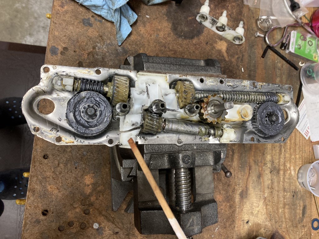

I started work on one of the extra seat transmissions. Here's a look at the inside when you split the cases.

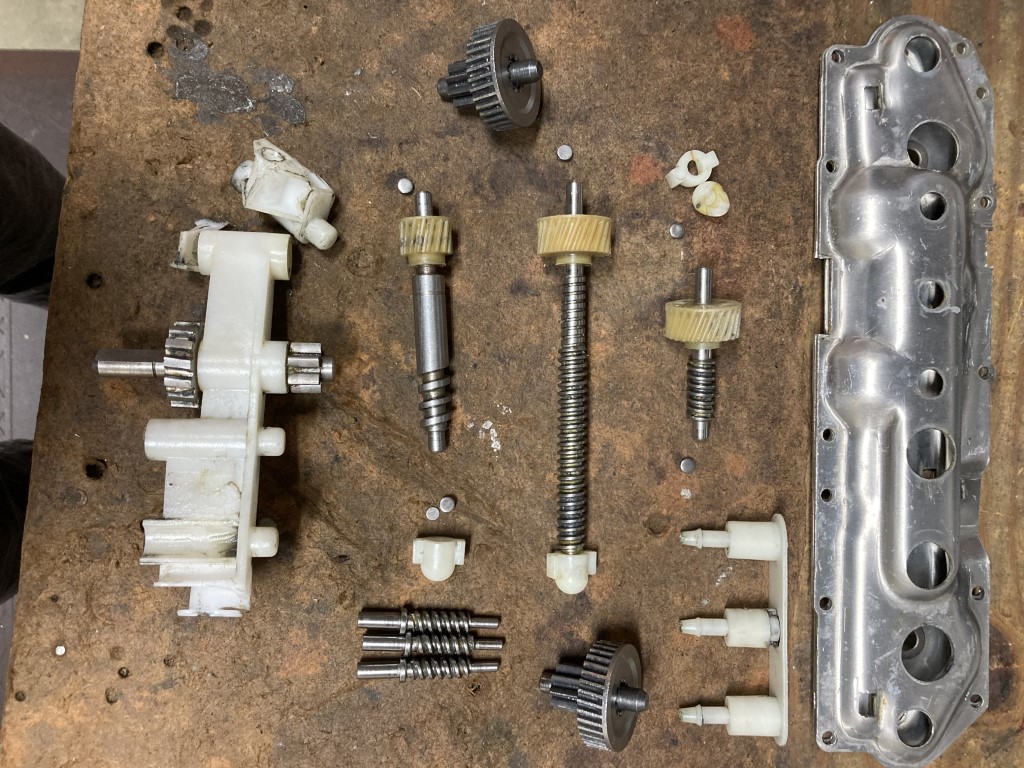

Here are all the parts cleaned up. Looks like I need a replacement for the main gear support and one shaft end cap. All the gears and shafts look good. I found a guy in Texas that prints these parts. He told me the breakage is caused when the seat is run against it's normal front and rear stopping points. There is no protection designed into this system to protect against that.

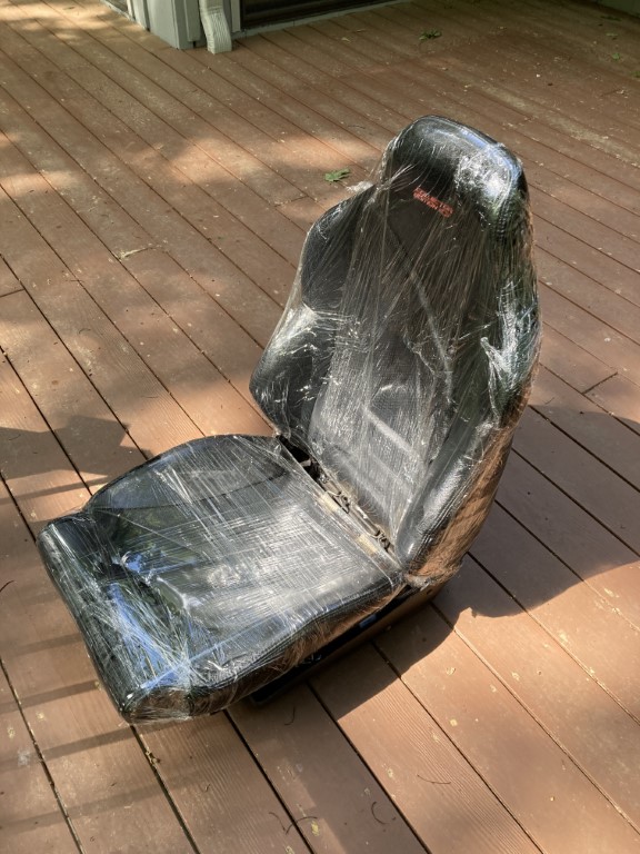

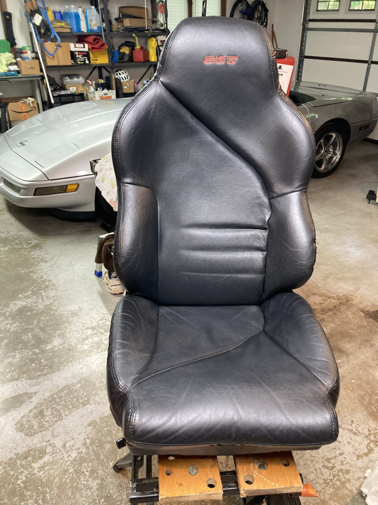

While I have the passenger seat out, I thought it would be a good time to treat it with Leatherique Professional Leather Restoration product. There are two parts to the kit, a Rejuvenator Oil and a cleaner. The first step is to generously slather the Rejuvenator oil over the entire seat and rub it into all the seams, and crevices. Then, wrap it in plastic wrap to marinate for a day in the sun.
Next use the cleaner to remove all the Rejuvenator along with its accumulated dirt, then wipe it clean with a dry cloth. I've already done the driver's seat and there is a noticeable improvement.

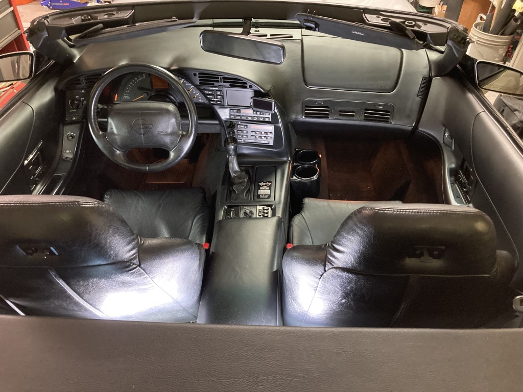

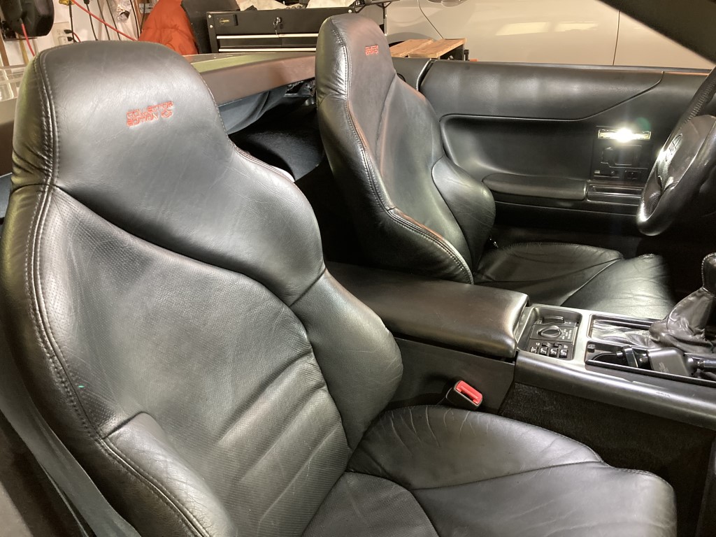

OK, both seats are finished. Both have full movement and a good and thorough cleaning and rejuvenation. I'm amazed at the great condition of these seats. There is virtually no wear and tear for 106K miles and 27 years of use.

Those seats do look amazing.
Posts: 2644
Wow, those turned out really nice. C4 seats seem to be notoriously bad, almost every one i see for sale has failed upholstery.
