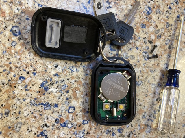

Since I've been driving Silvia a lot more, I decided to switch on the PKE (Passive Key Entry) feature on the key fob. PKE senses the transmitter in the key fob and unlocks the doors and disables the security. It worked for a while, but then went dead. I bit of diagnosis indicated that the fob was the problem. I checked the battery and it was sitting at 2.97 volts. That should have been plenty of voltage to operate the system. Anyway, I put a new battery in and it came to life again and things began looking up. The next day I went out to the garage, key fob in hand, expecting it to open the door as I approached. No such luck. I took the fob apart again to check voltage on the new battery again. Then I remembered that I had dropped the fob while hanging the keys on our key hook. Hmmm.... so I pushed down on the battery and held it in place while I walked out to the car. Bam! the door unlocked. The key fob had just enough room inside for the battery to move away from it's contact and render the fob inactive. To prevent this from happening again, I sliced a thin piece of foam rubber and glued it into the cover of the fob right over the battery to keep downward pressure on the battery when the fob is screwed together. As an additional test of my theory, I snagged the old battery (2.97 volts) out of the wastebasket and put it back in. Now it works, too. Good fix.

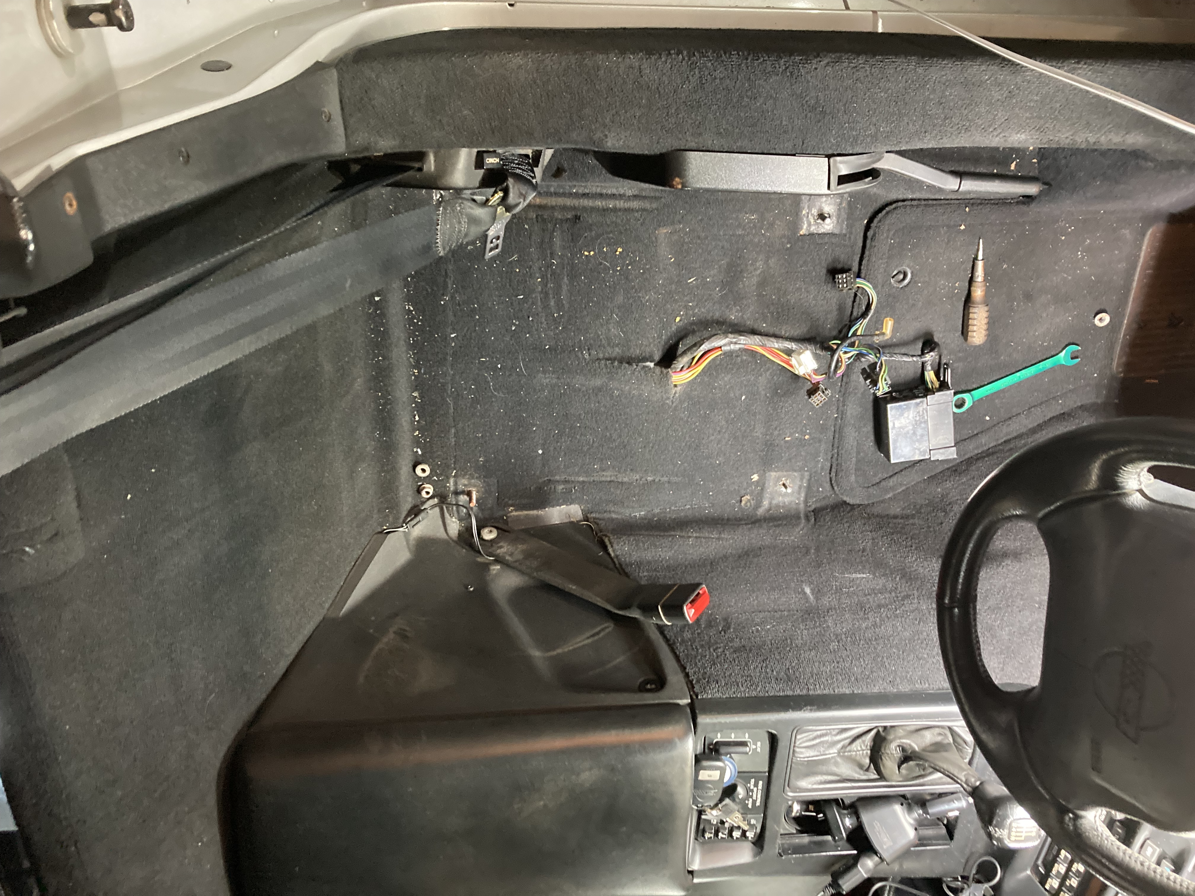

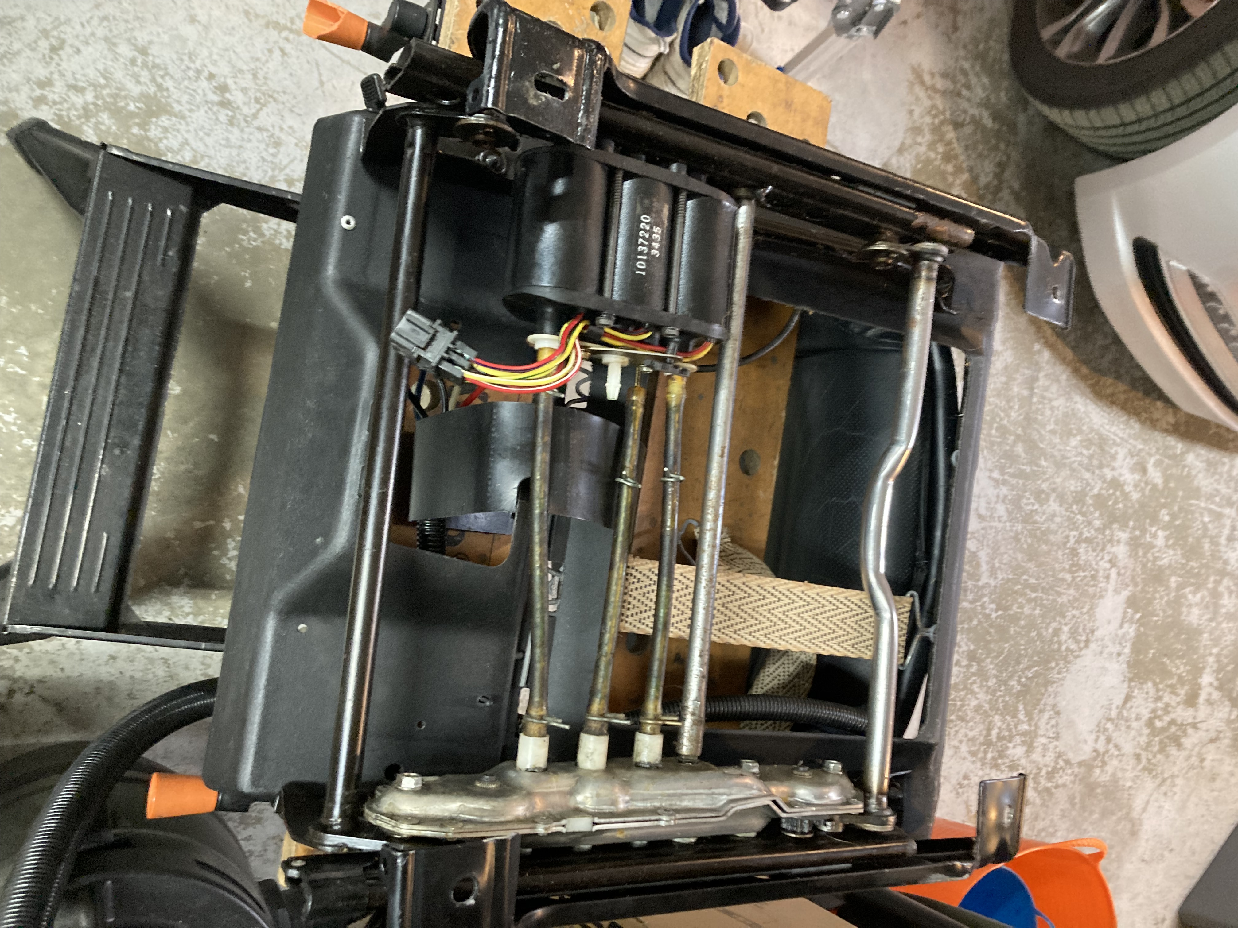

I finally got around to tackling the power driver's seat problems. Getting the seat out wasn't too bad and there weren't any dead, mummified, animals underneath. There is a unit with three motors that controls the movement of the seat. I tested each motor with a 12 volt jumper and two of the motors worked. I ordered a replacement for the whole unit from eBay and it should be here in a couple of days.

I haven't pulled my seats out for anything yet, but do you pull the seat bottom off to access the mounting bolts to the floor?
Yes. The front of the seat bottom is held on by a stiff wire latch that you push down to unlatch. Then just pull the seat forward and it comes out. For your first time, it's best to take a look under the front of the seat to get an understanding of how it works. After that you can do it by feel. You need to move the seat forward and back to get access to the nuts that hold it down front and back. You can get a look at the front nuts when get down to look for the latch.
