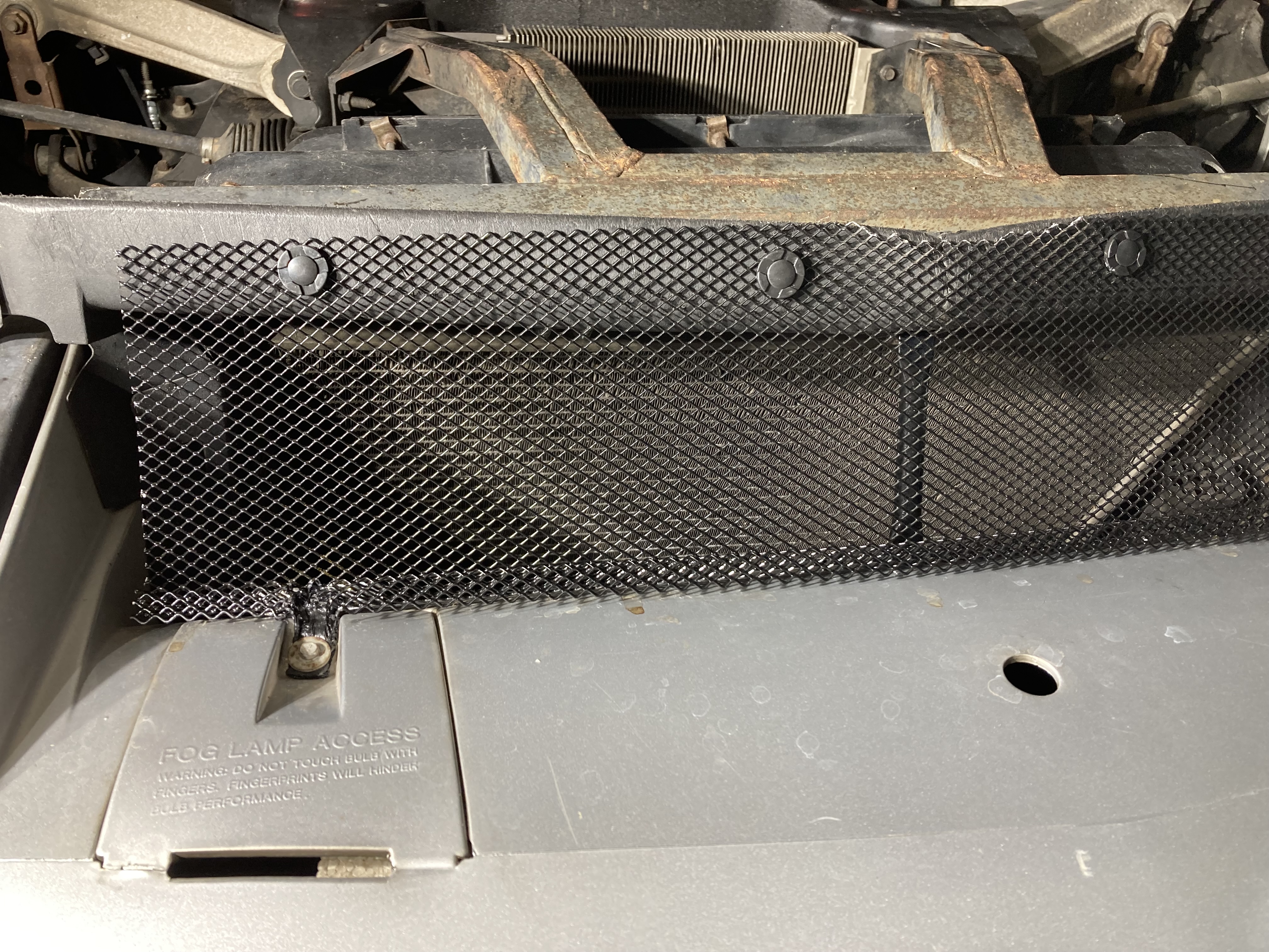

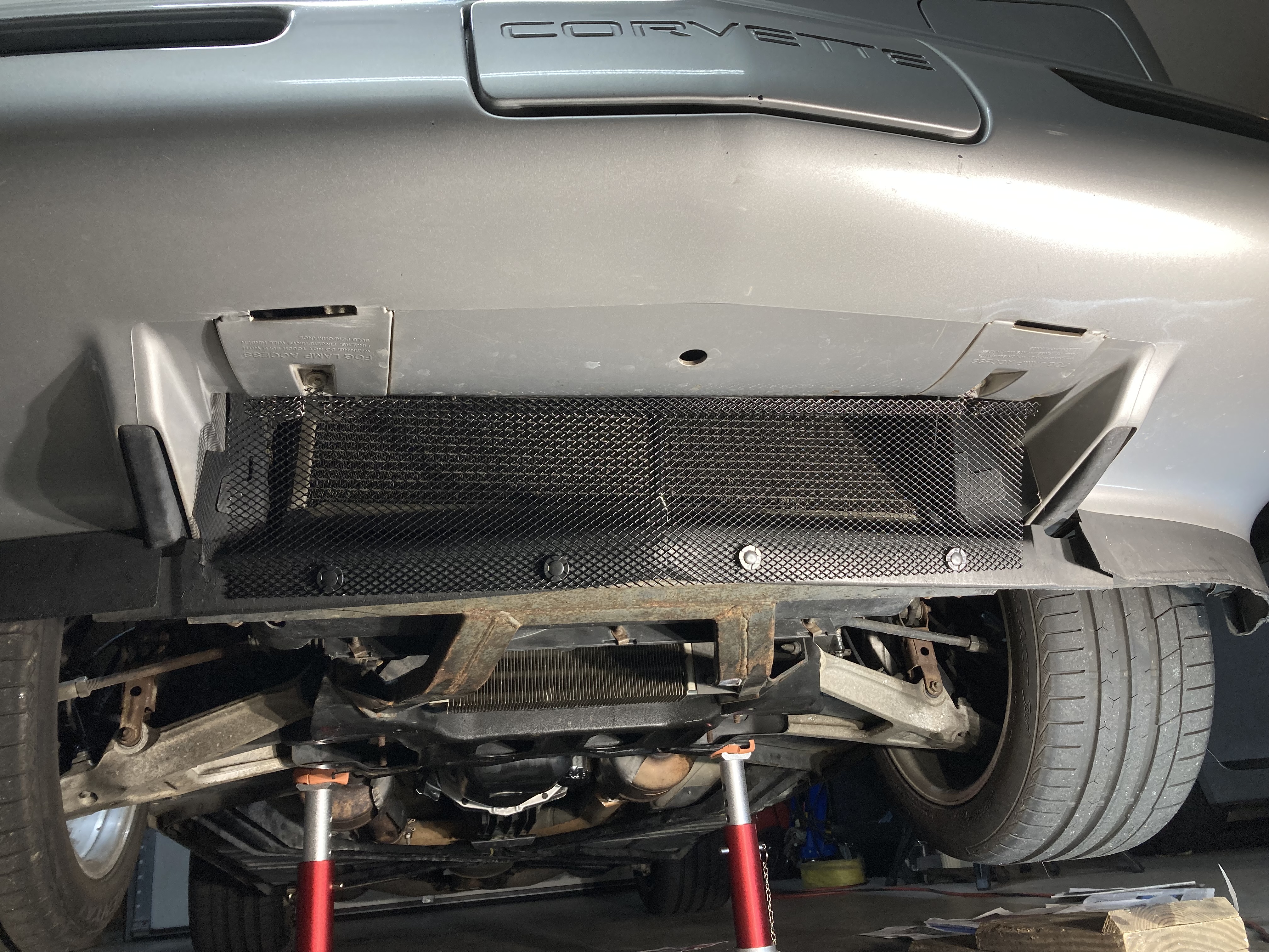

Some leaves are beginning to fall and Silvia has been sucking them up and plastering them on the front of the AC condenser, so I thought it time to do something to prevent it. At Home depot I found a piece of black plastic coated metal mesh screening that is meant for covering gutters. It was just about the right size and for less than $4, it looked perfect. This is the outcome:It appears to work fine around town, but when I took it out on the Interstate at 80 plus mph, the temp gauge was showing 215°, but to be fair, the ambient temperature was 95°. I plan to remove the screen and take it out again to see if the temp is any different. I may have to find some screen with bigger holes.

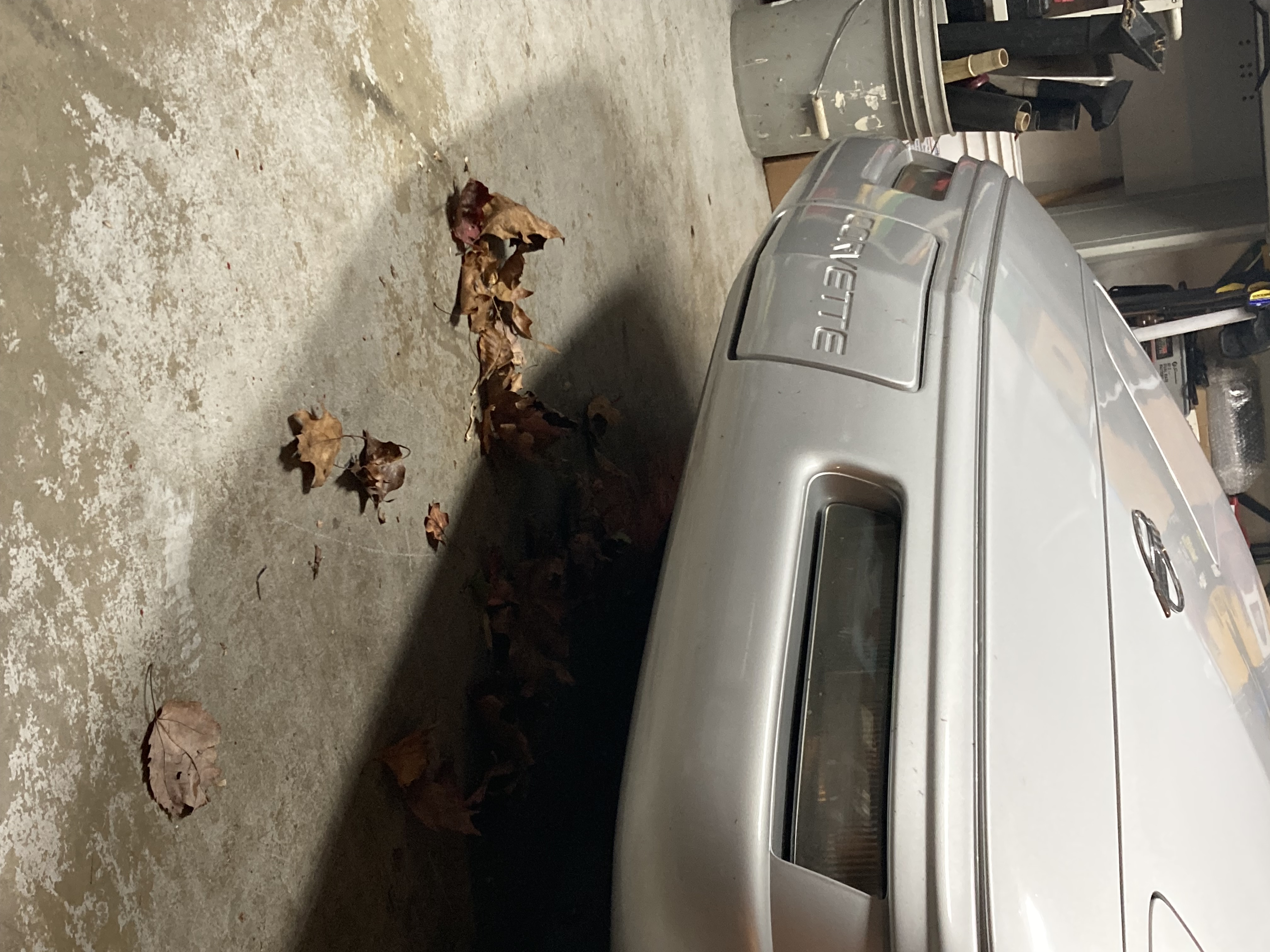

First, I'd like to report that my debris screen is working as expected. Many small leaves on my driveway are sticking to the screen and being deposited on the garage floor when I pull in and shut it off. Nothing has gotten by the screen.

Now that the leaves are coming down in earnest, my debris screen is also working beautifully. It sucks them up and deposits them on the garage floor in front of the car instead of plastering them up against the AC condenser.
