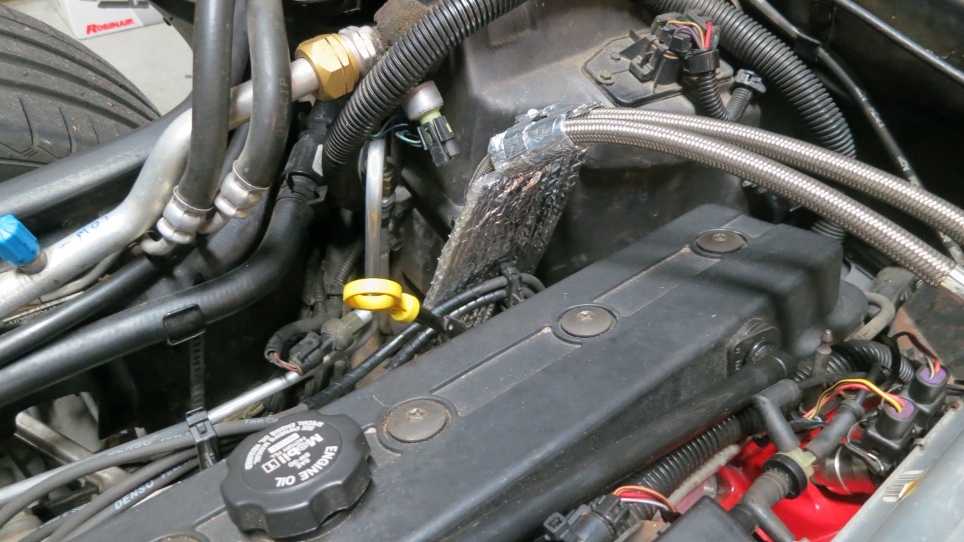

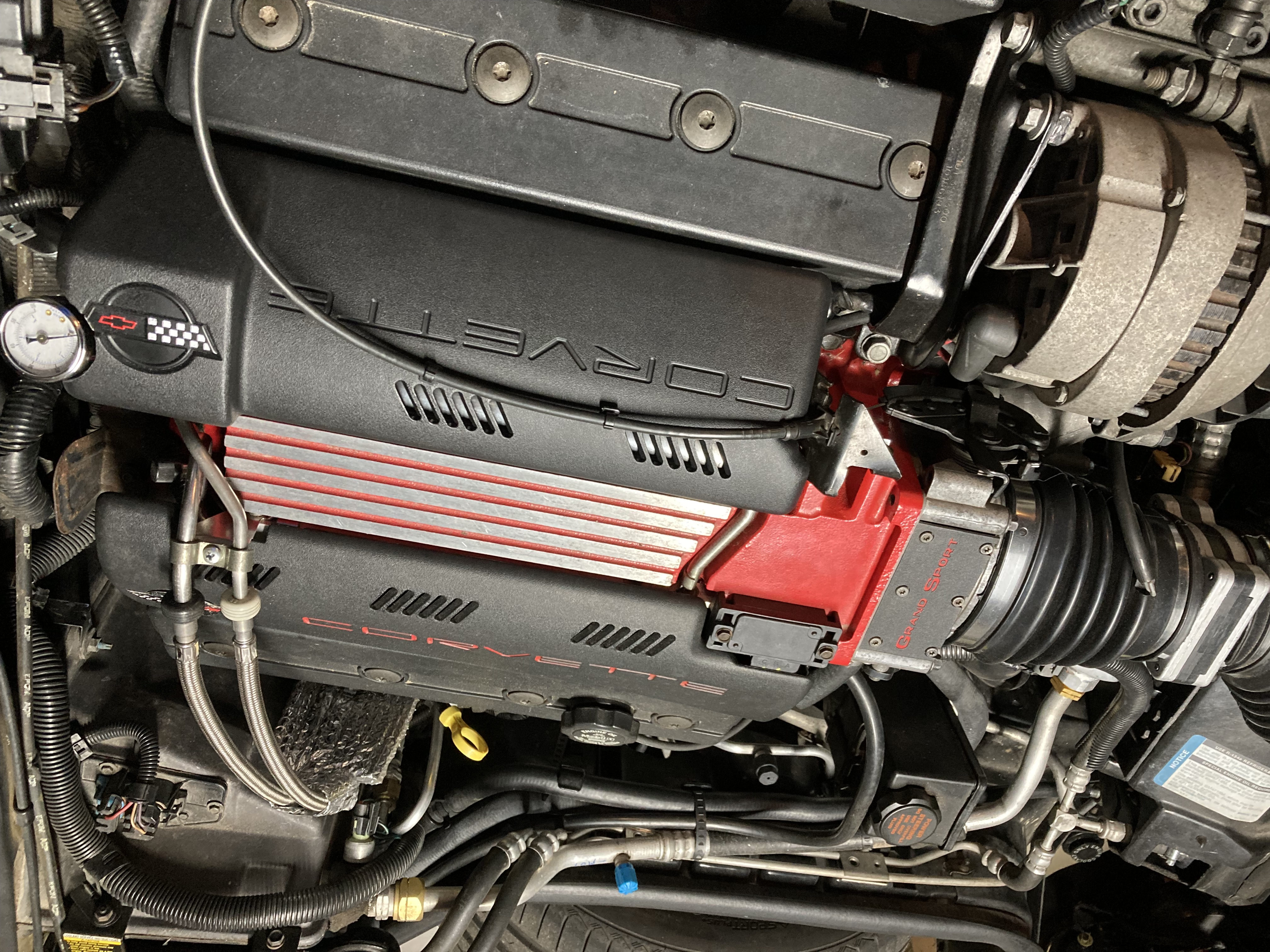

- After I added the adjustable fuel pressure regulator and FP gauge, the LH injector cover would not fit anymore. My solution was to buy a new replacement cover and cut it to fit over the FP gauge. This was much more difficult than it sounds. After hours of trial and error cutting and fitting I finally got it to settle into place.In the photo, notice that the embossed "Corvette" logo is not painted in like the original on the RH side. I would hand paint it if I knew how to match the paint. Also notice my permanently temporary fuel line heat protector on the RH side. I'm not sure how much it helps, but theoretically it should.

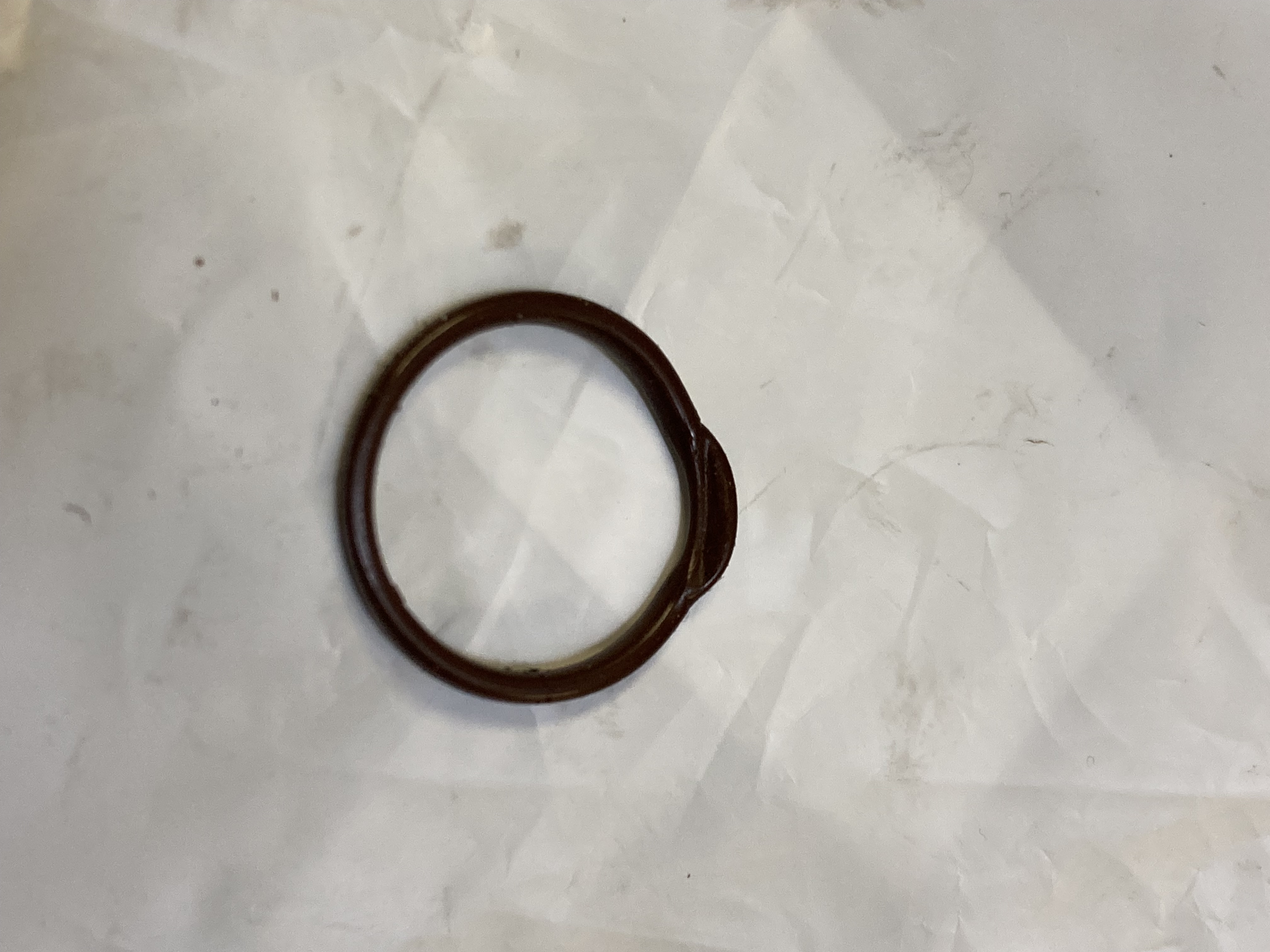

I've been seeing a spot of oil on the garage floor so I followed the oil trail forward to the Crank Position Sensor under the timing cover. It pushes in and is sealed with an O ring. It's held in place by a single screw. This is a new sensor I installed previously. Back then, I did the installation sight unseen from the top of the engine with my arm extended down to the area in front of the oil pan. It was all done by feel. Here is the result: Today with a tip from a guy on the Corvette Forum, I put Silvia up on the jackstands and used a bottle jack to lift the engine a couple of inches. Like this, I was able to get my hand into the area of the sensor quite a bit easer to get it out and back in place with a new O ring.
