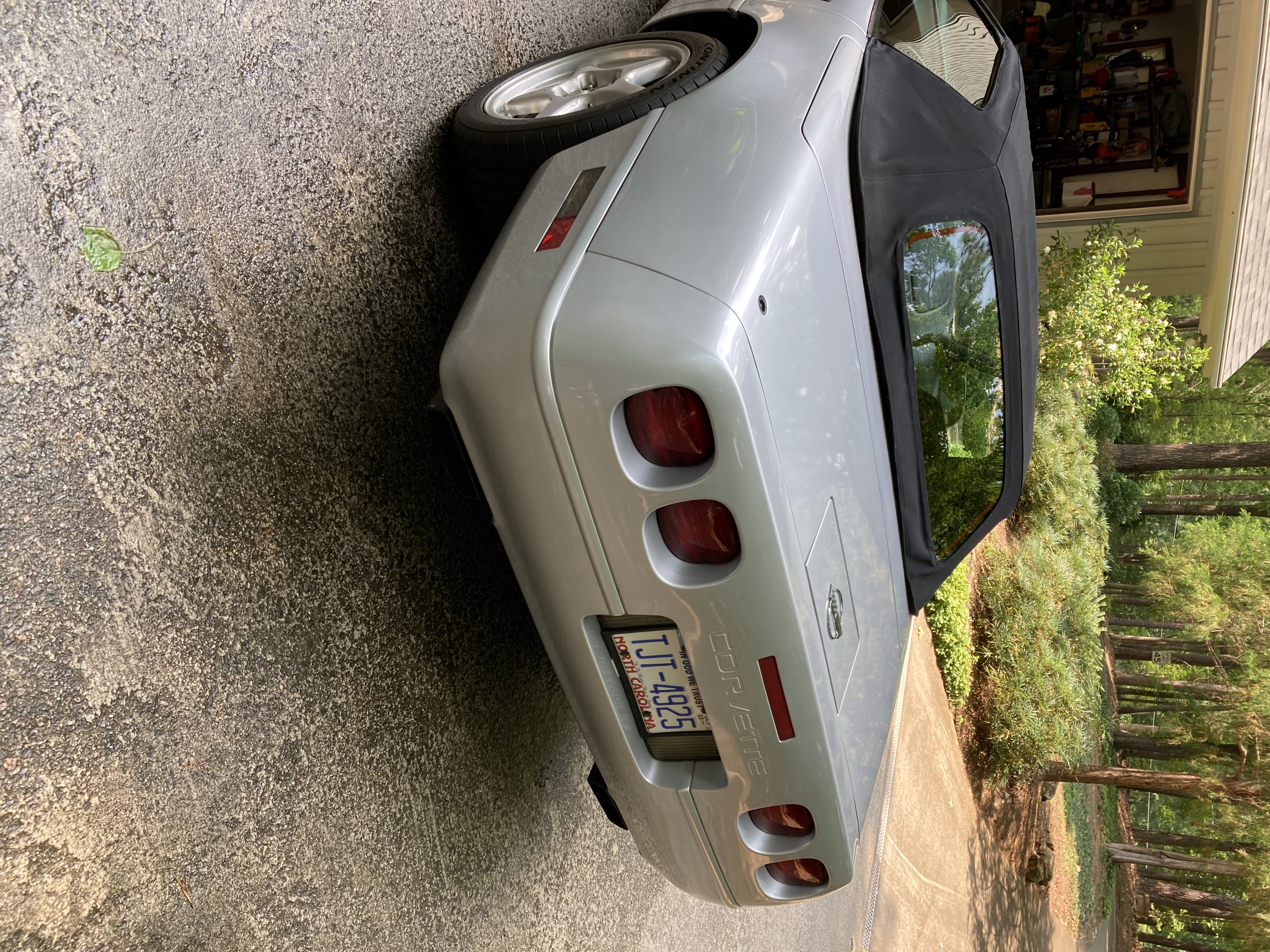

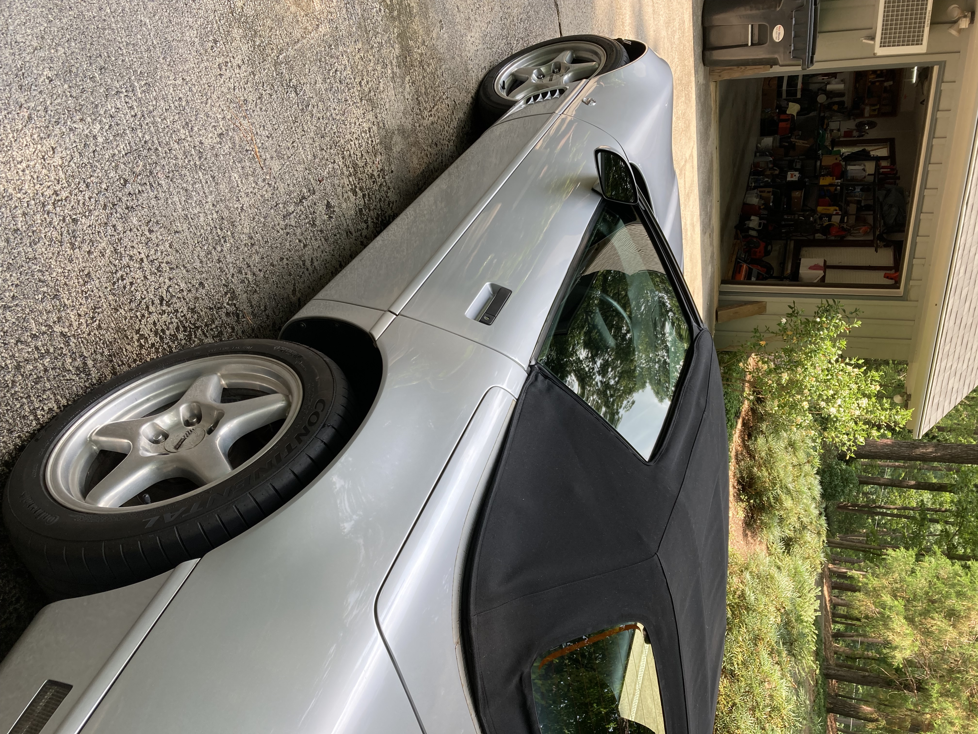

Photos from Fred's visit
We gave Silvia a bath then took some photos:
