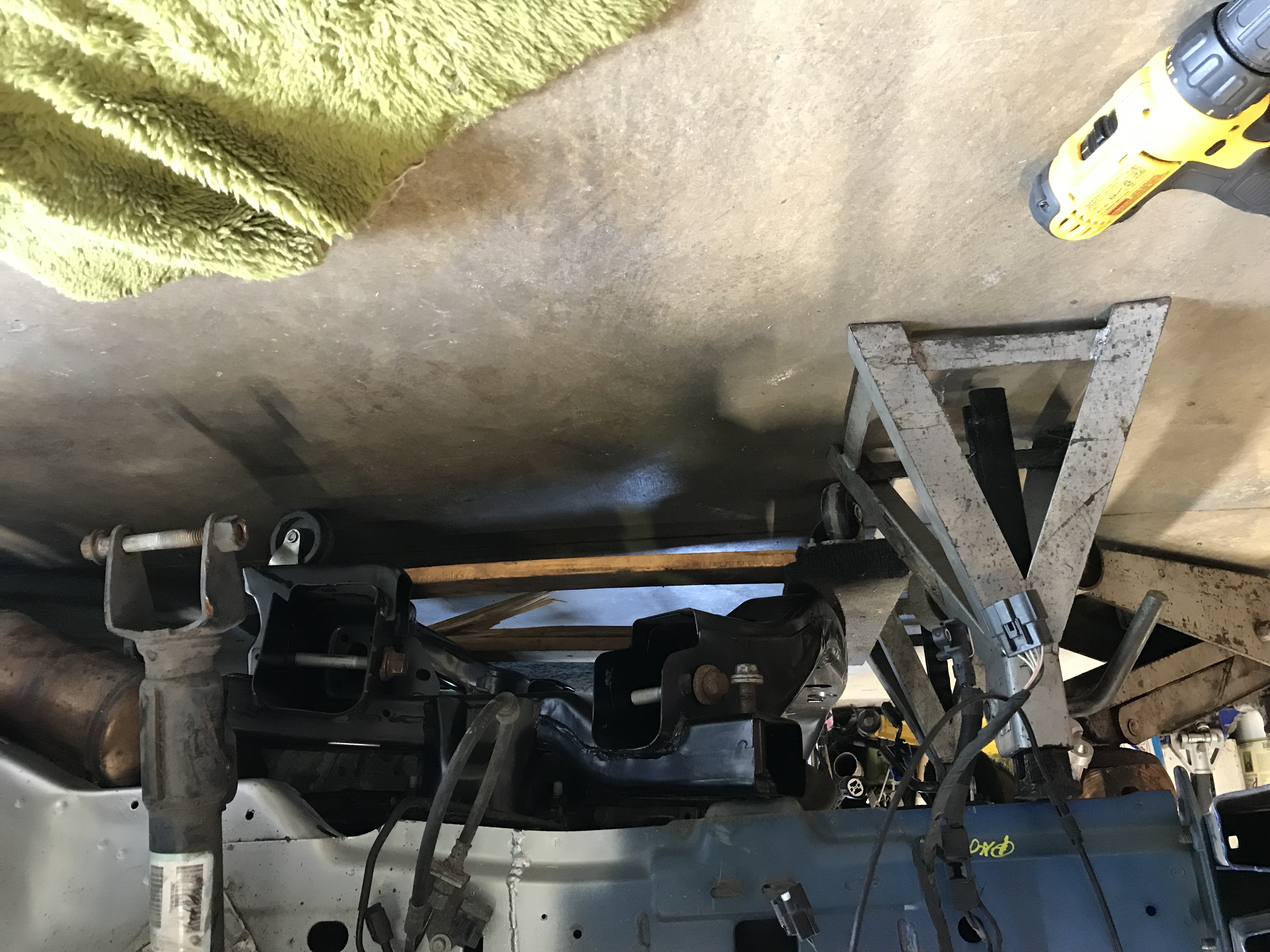

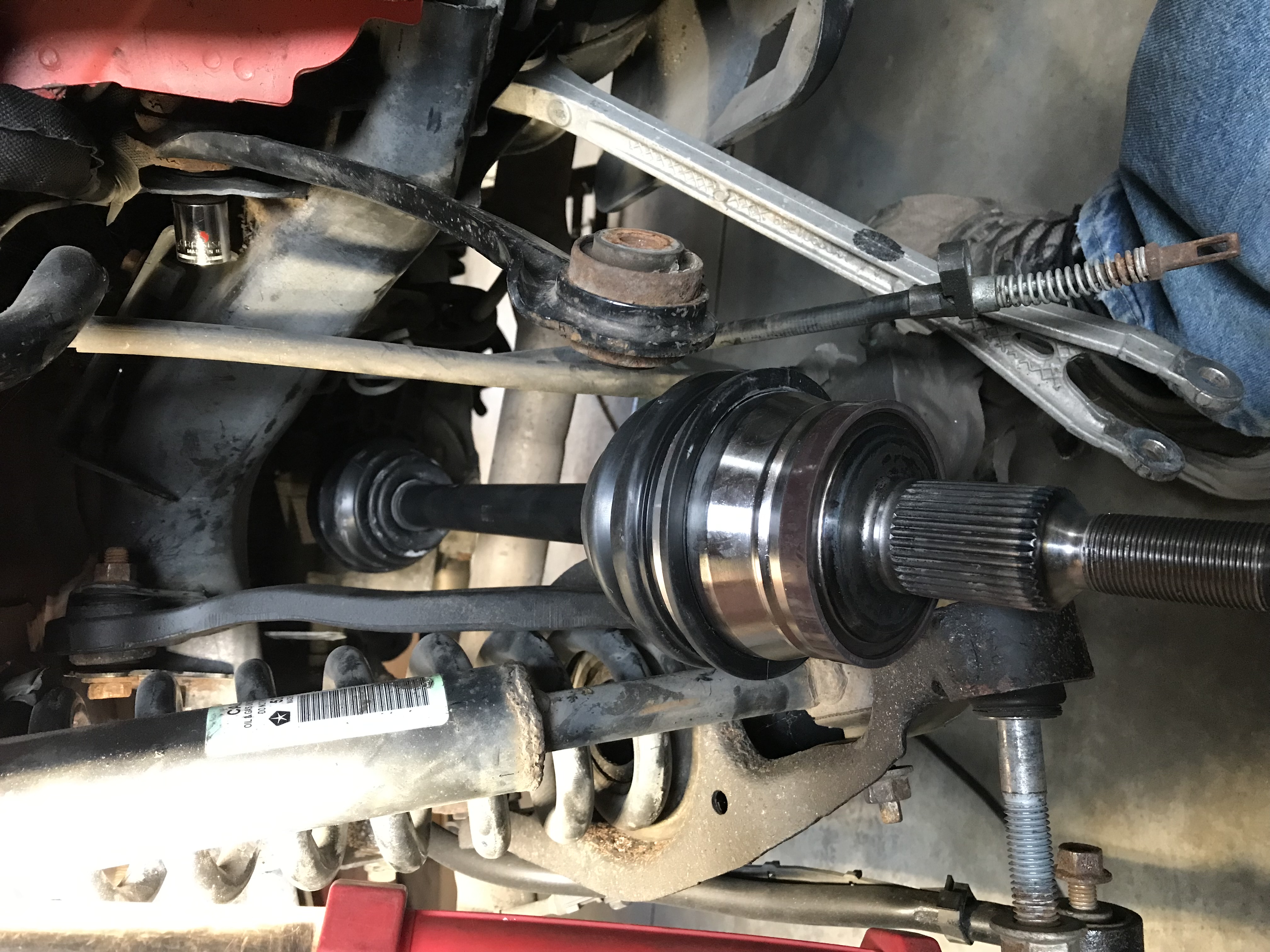

Rear axles installed, ebrakes assembled properly

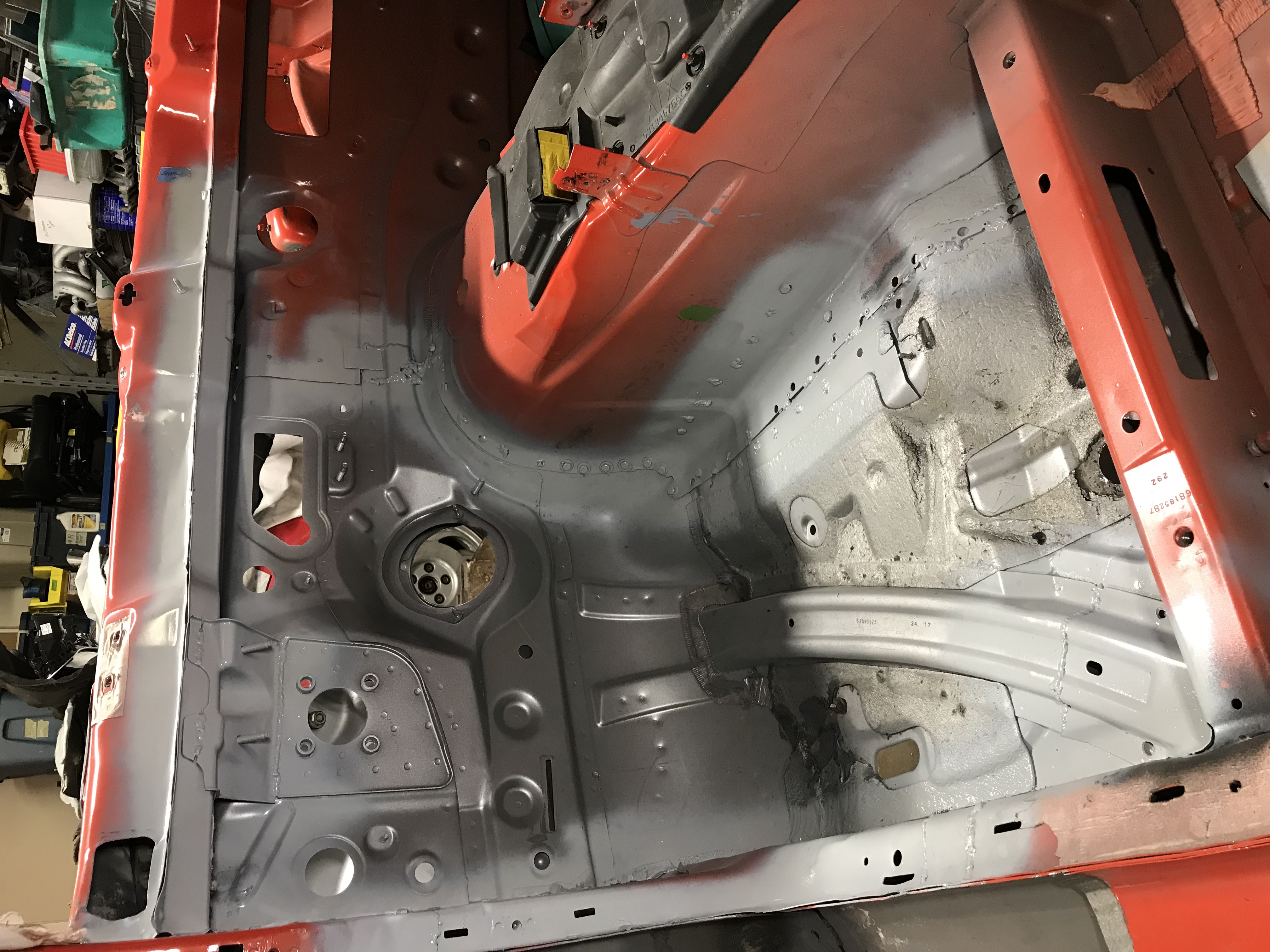

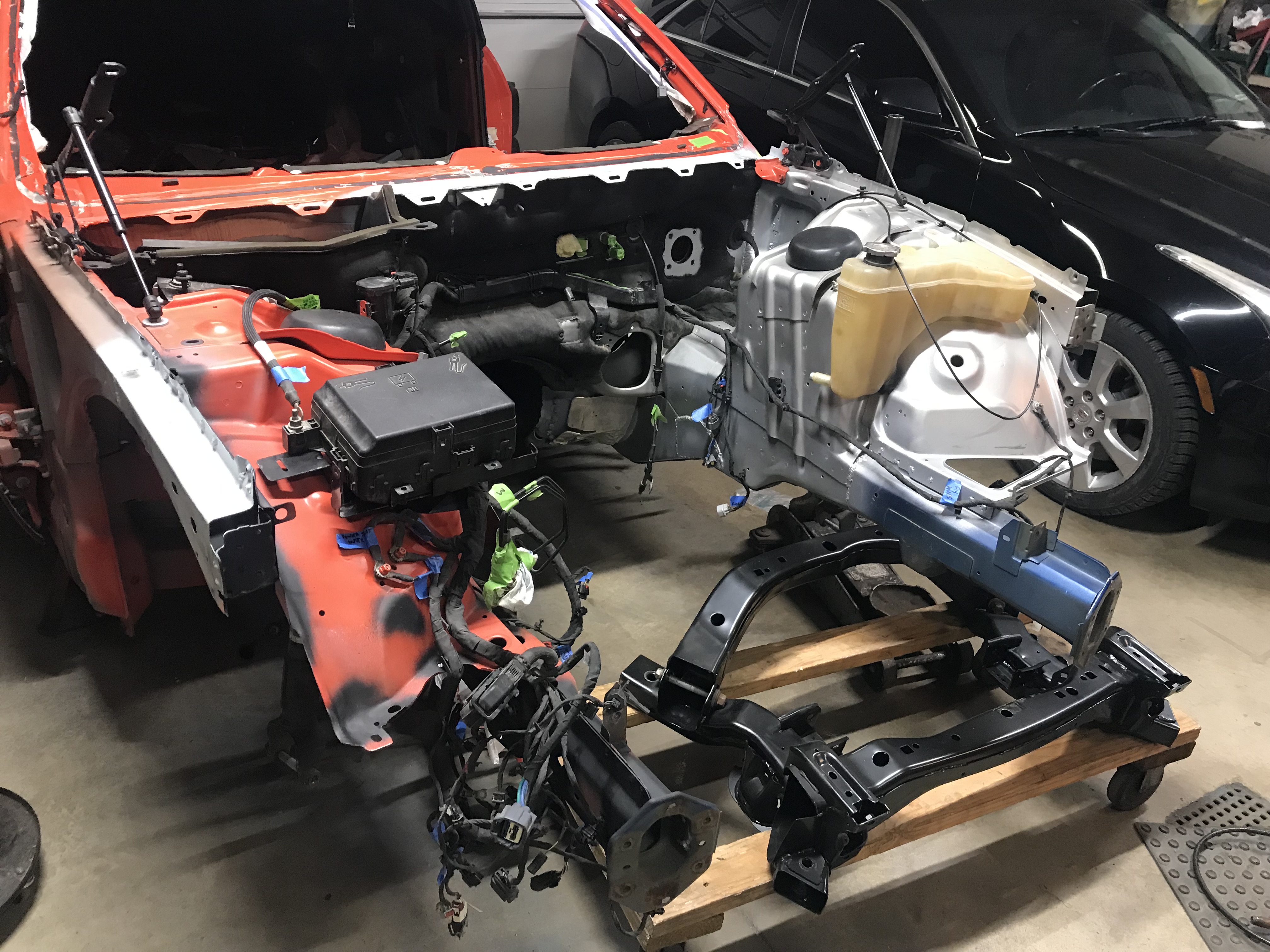

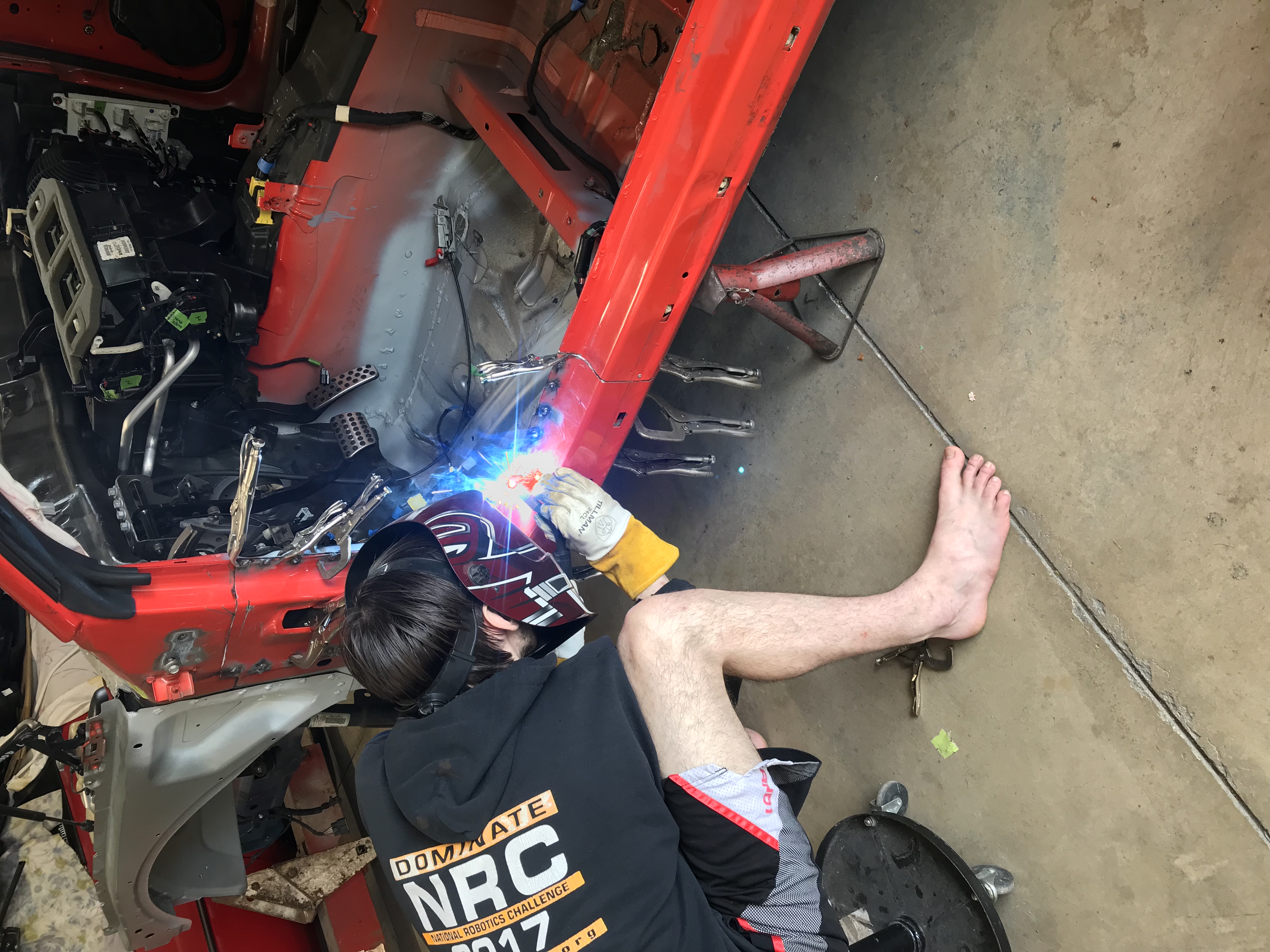

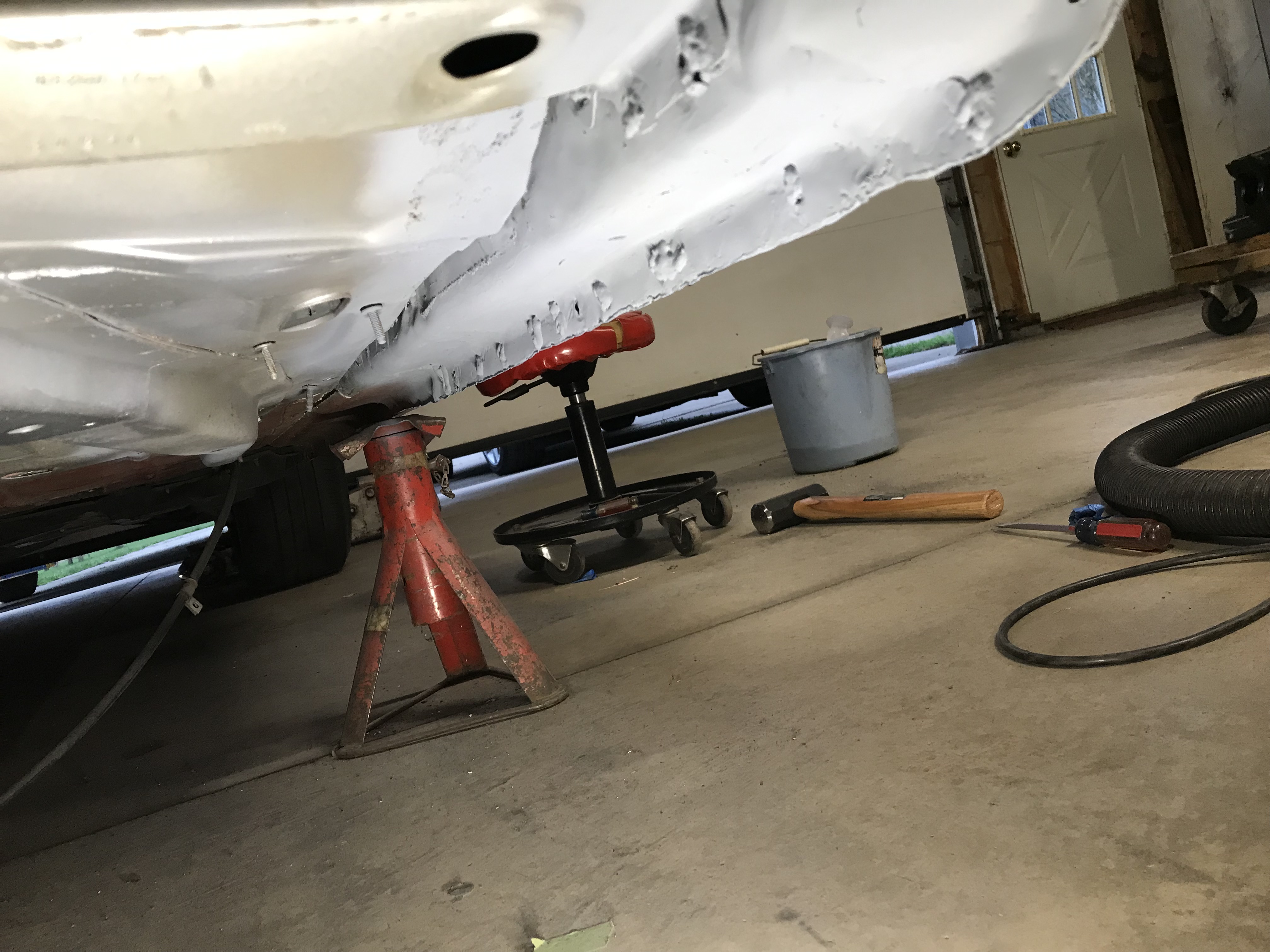

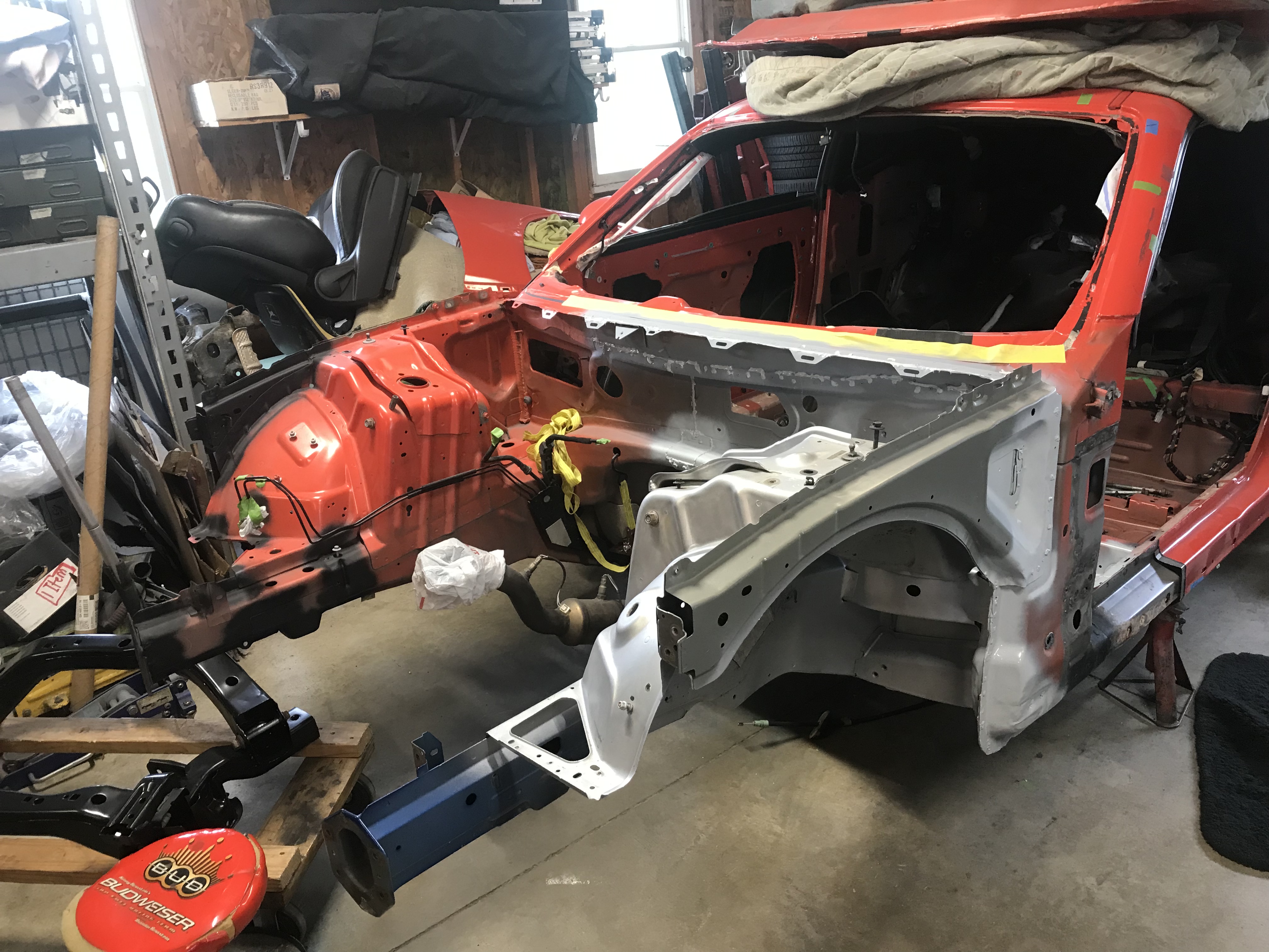

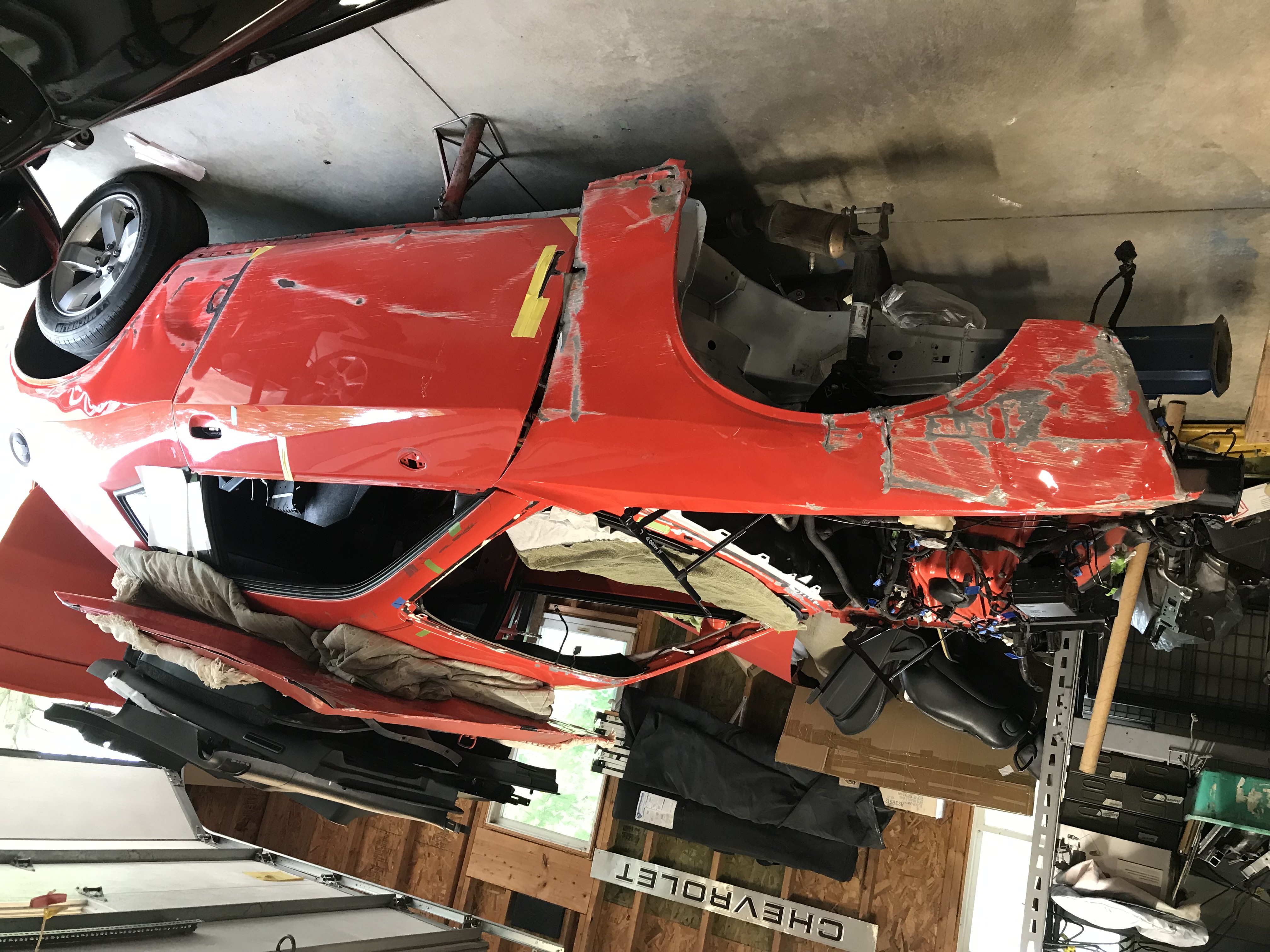

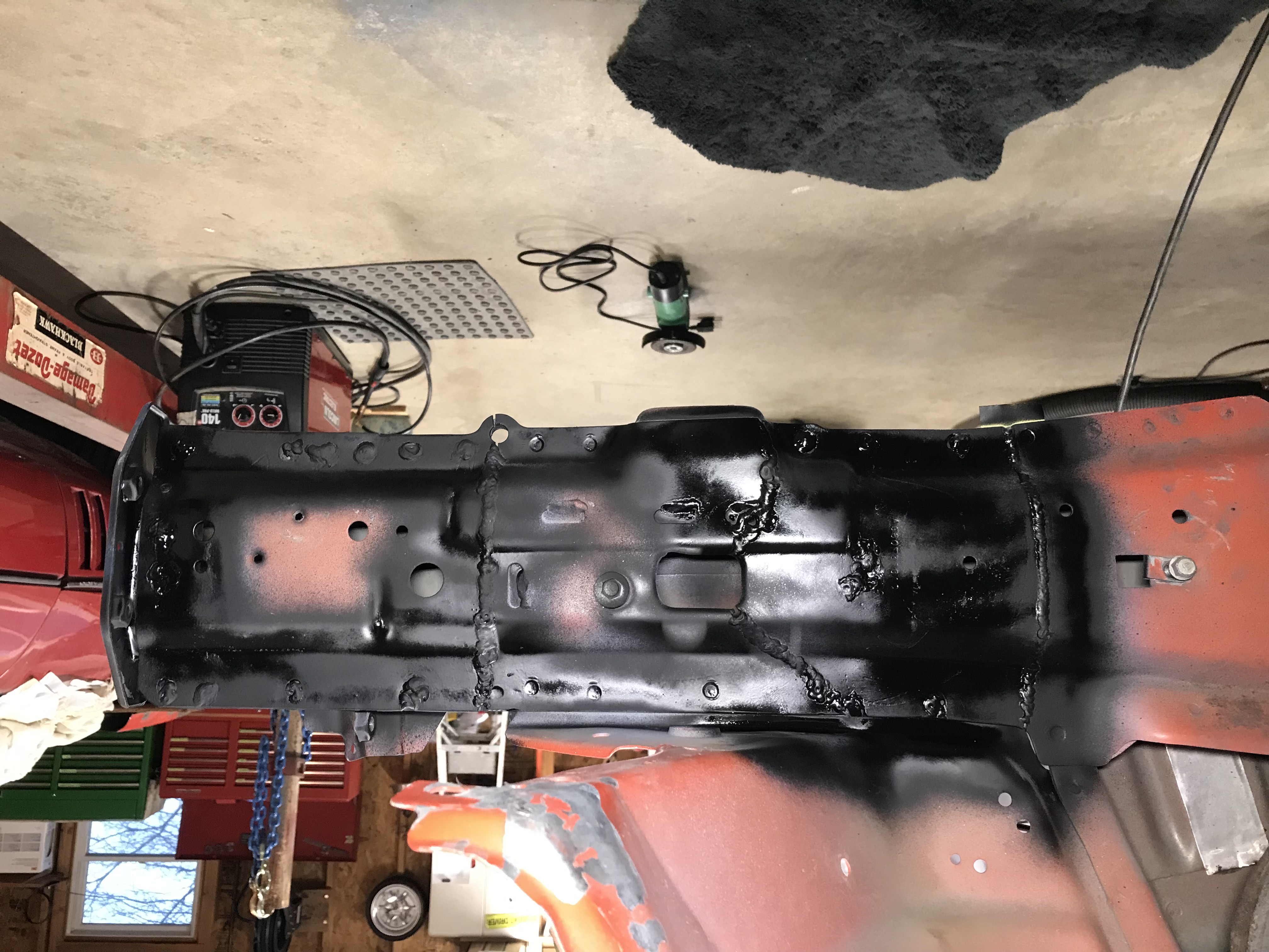

Big round of welding. Almost done. Missed a couple small welds, and still have to put the sheet metal on the bottom of the A-pillar in the door jambs.

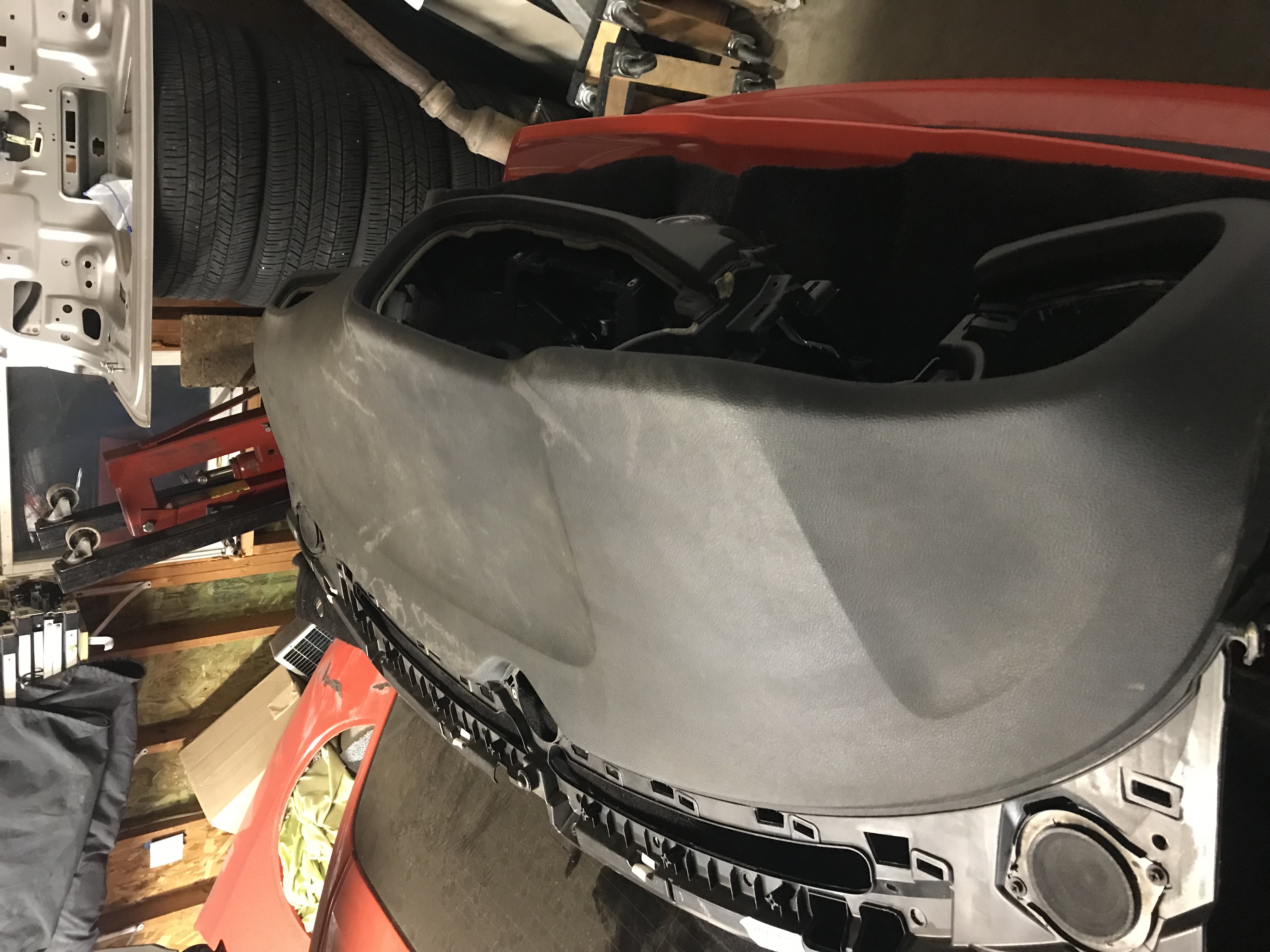

Made contact with the junkyard in Dover - the dash is in - so I went to pick it up.

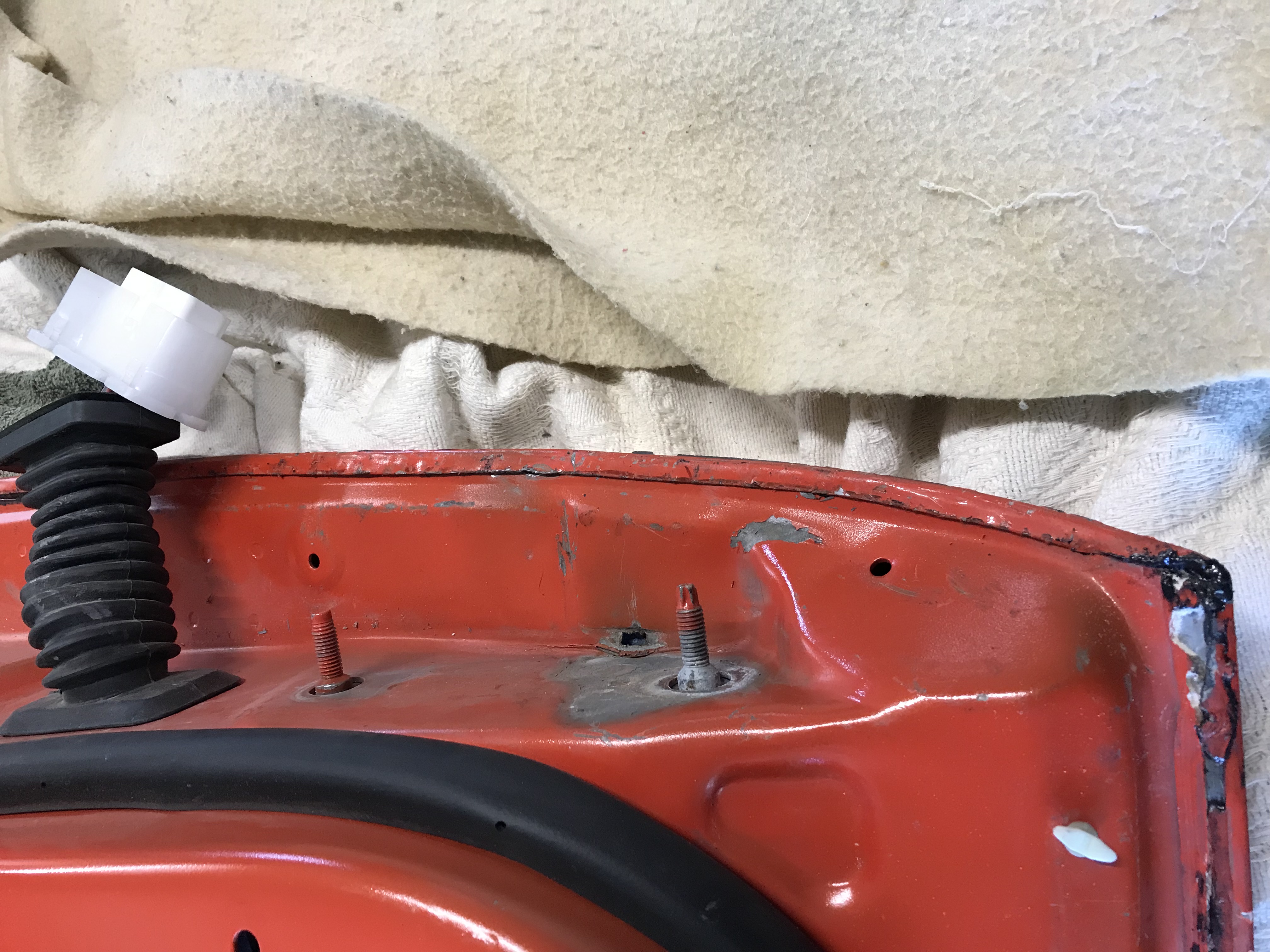

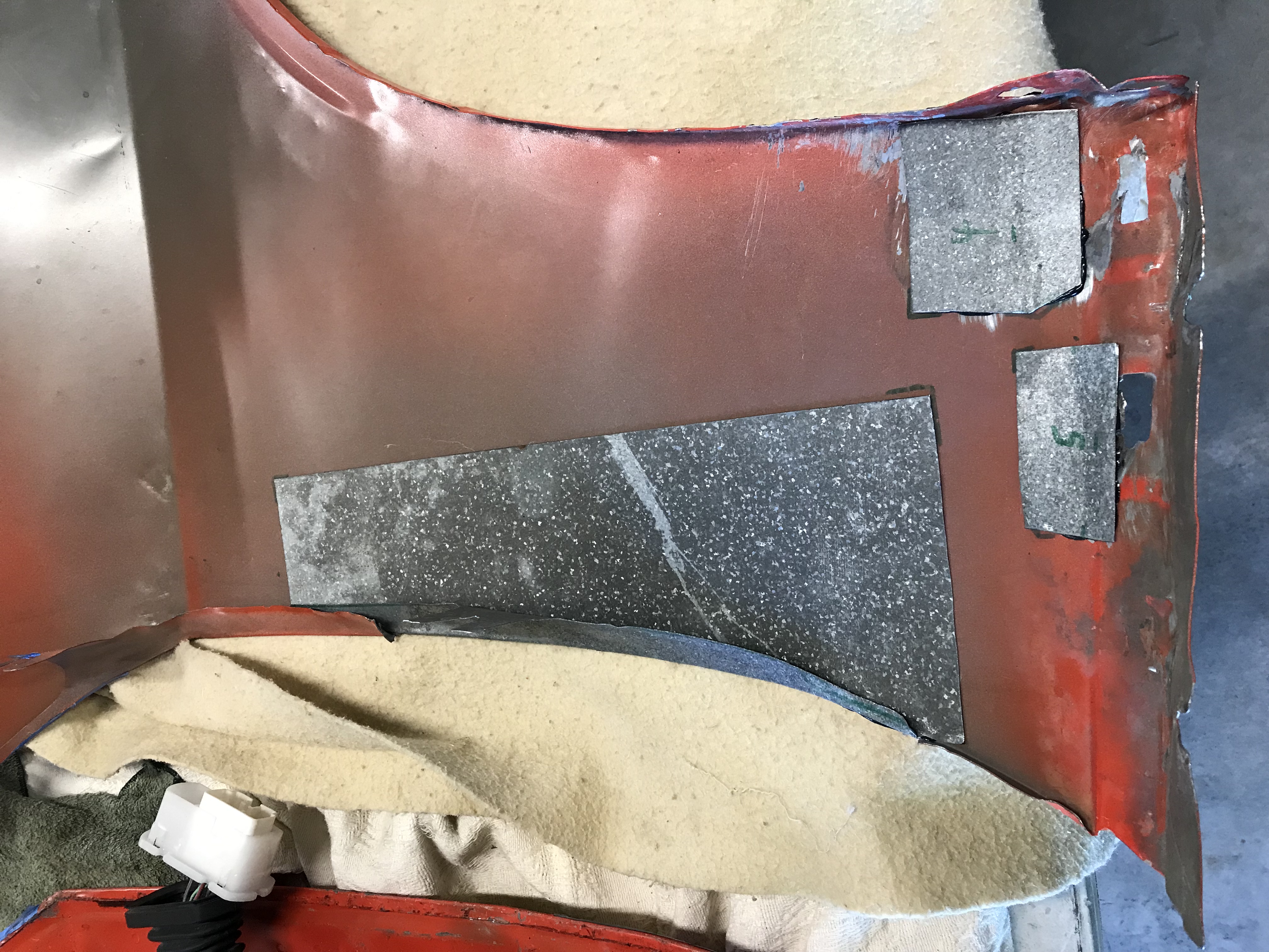

Spent an hour with seam sealer to seal up the newly installed section.

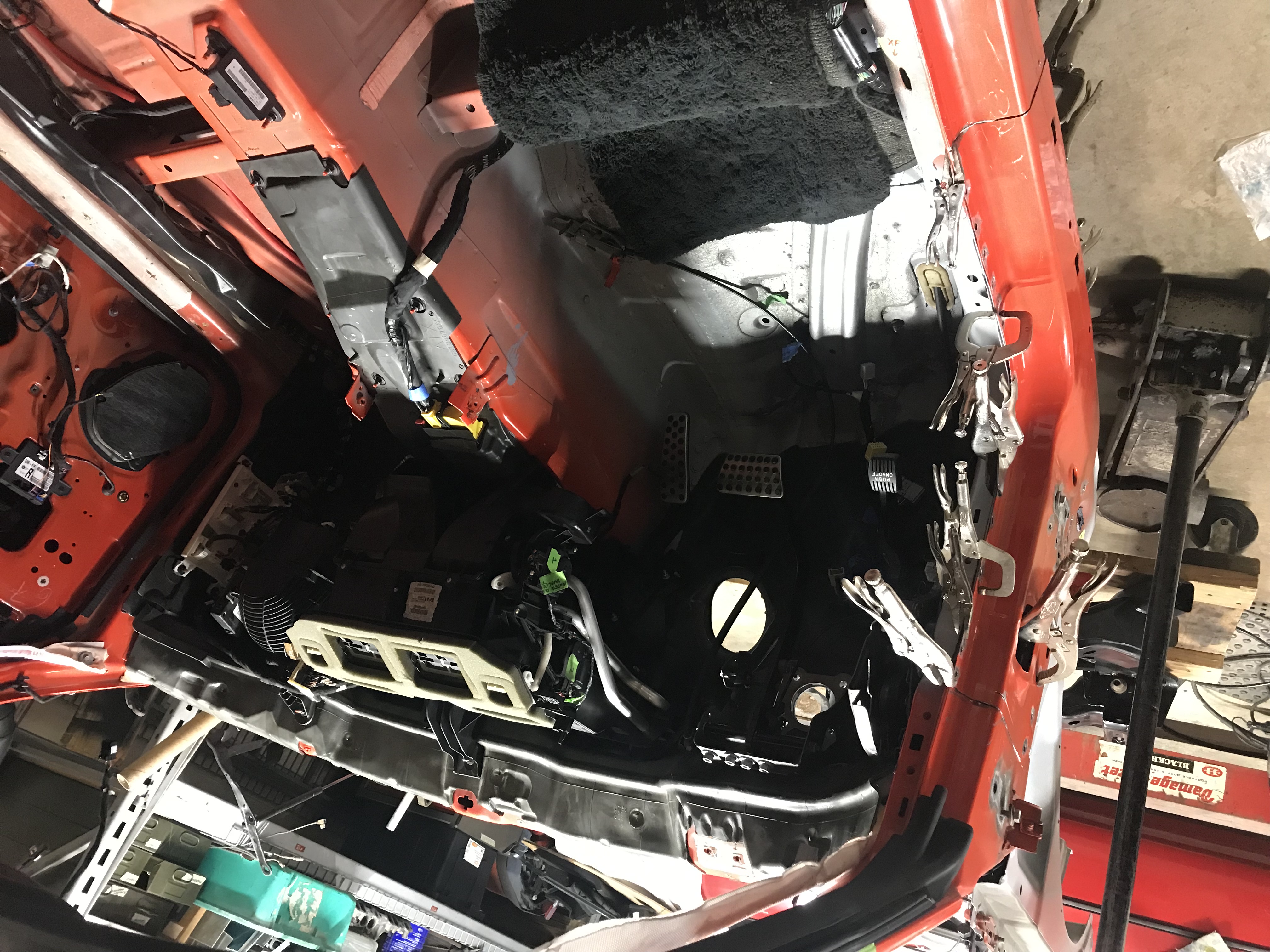

Installing things on the car:
• Transmission tunnel insulation and driver side heat shield
• E-brake pedal
• Interior firewall blanket
• Some wiring harnesses. Trying to figure out where the harnesses are supposed to route, and attach to the car presents some challenges
• Main under dash HVAC assembly. Some additional adjusting to firewall to get a good fit/seal

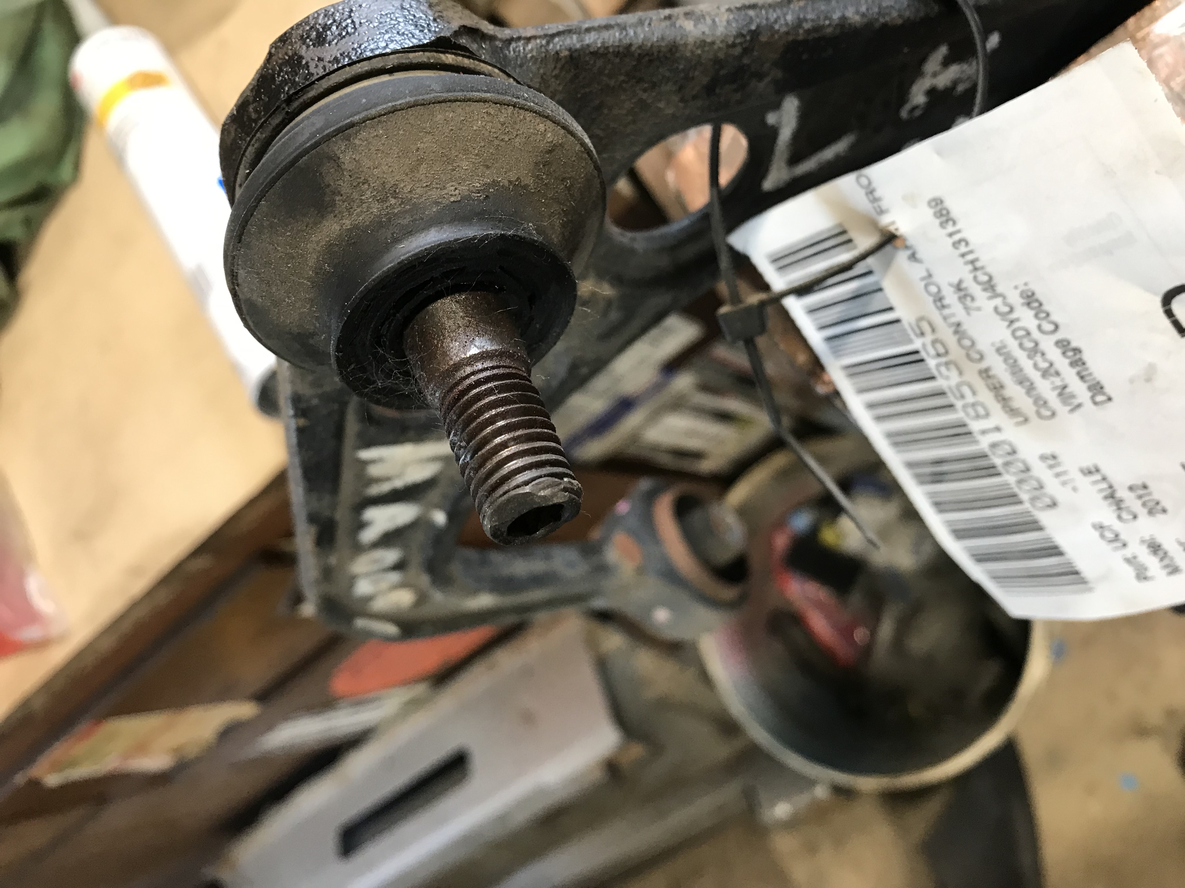

• Front struts and upper control arms. The LF upper control arm had damaged threads on the ball joint. I debated taking it back but it was faster just to fix it with a bit of grinding, filing and a die

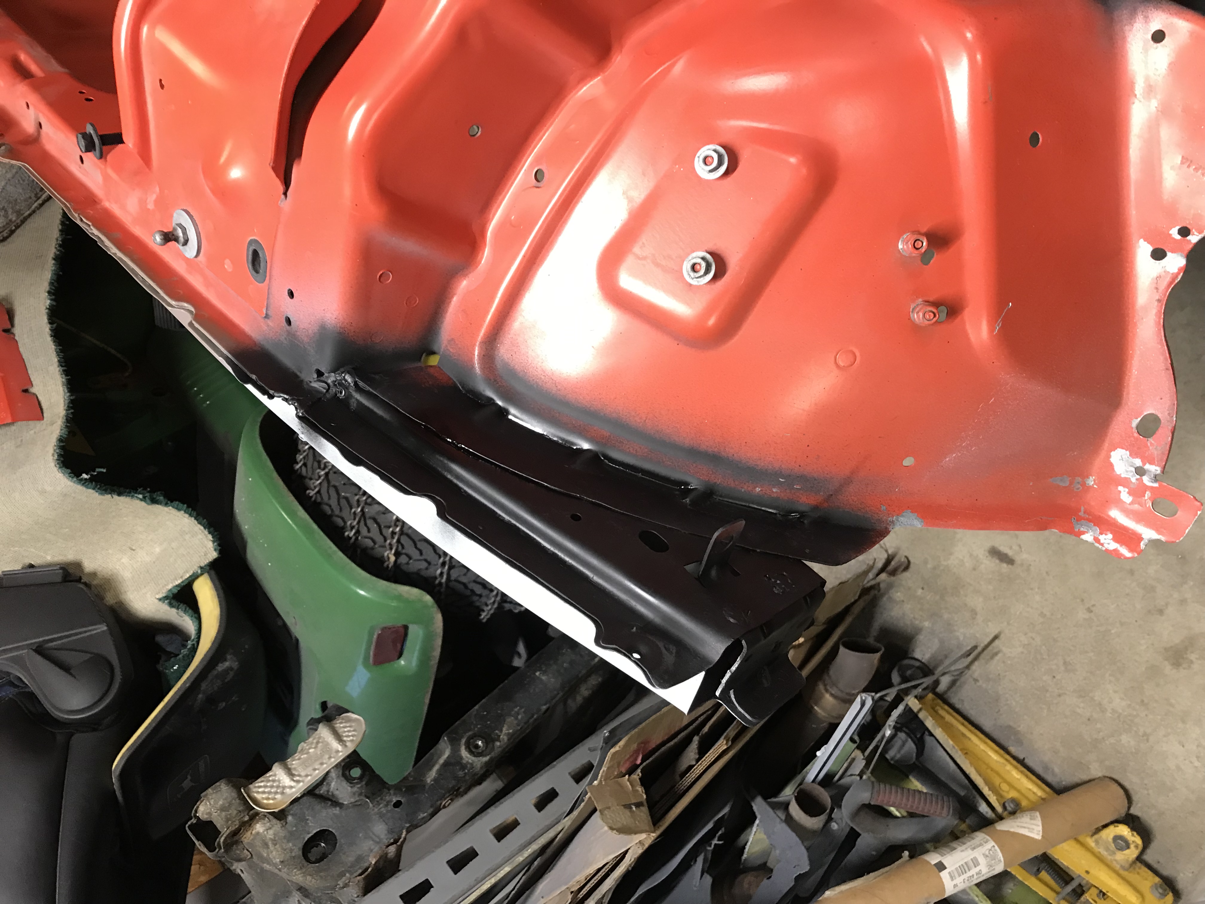

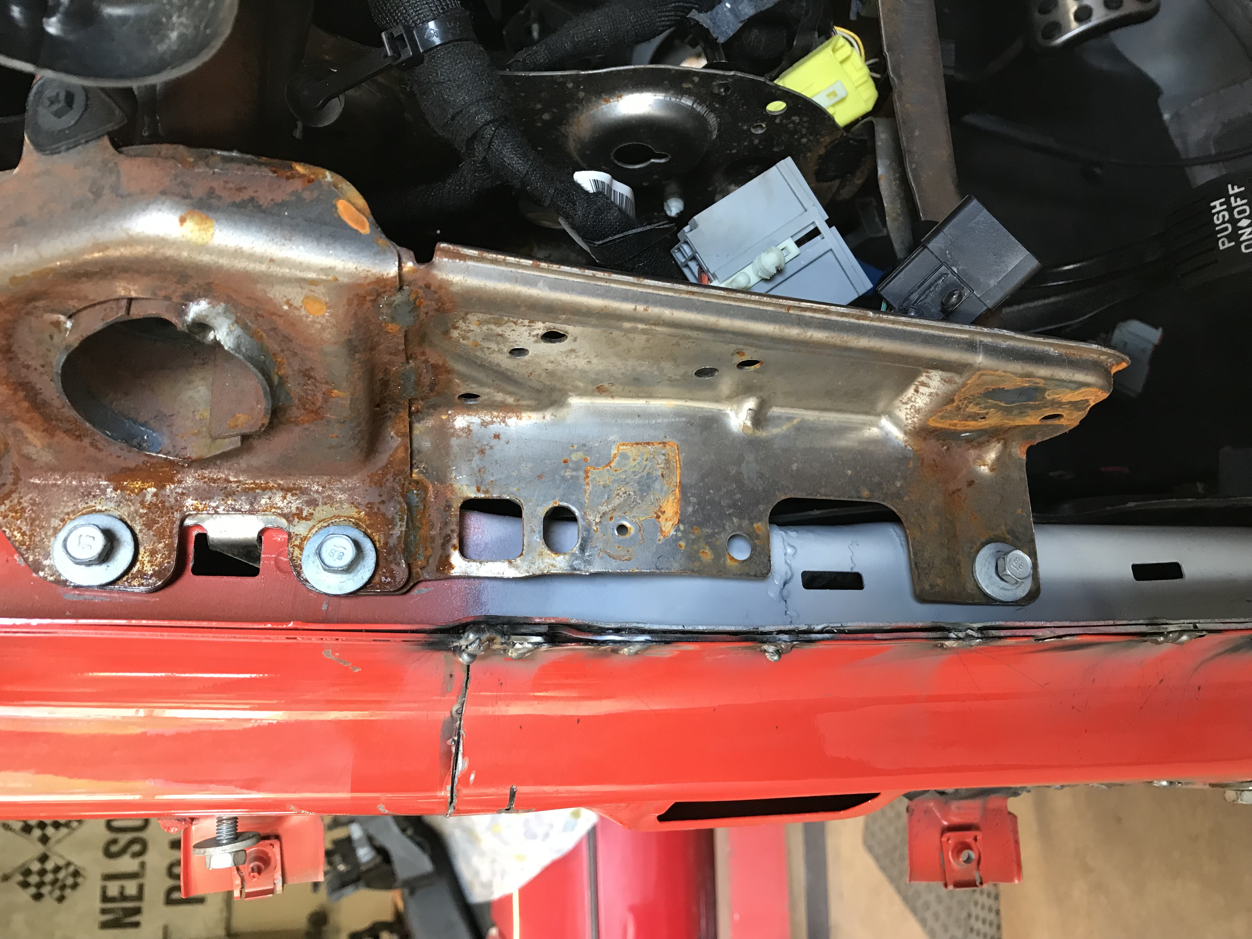

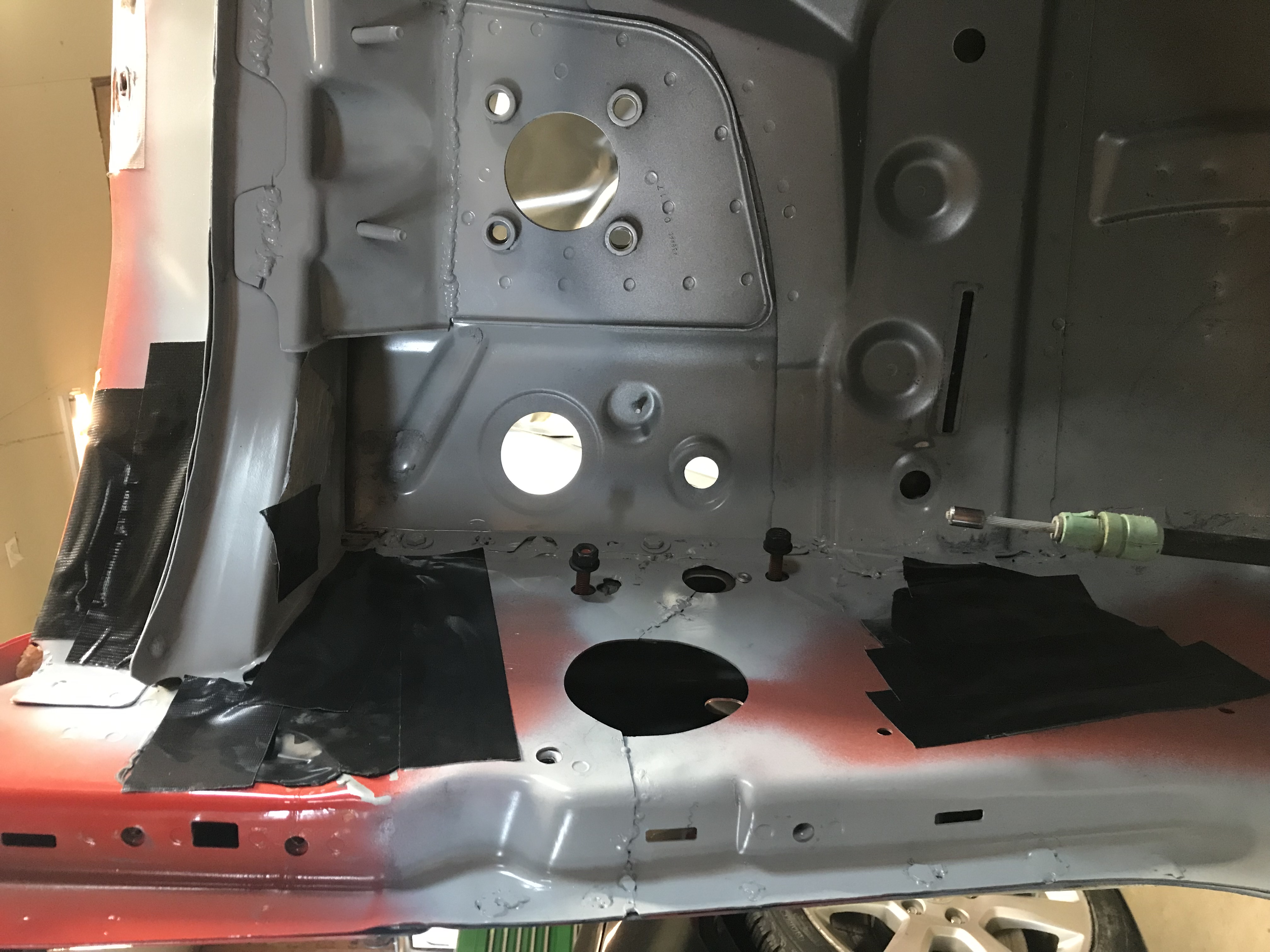

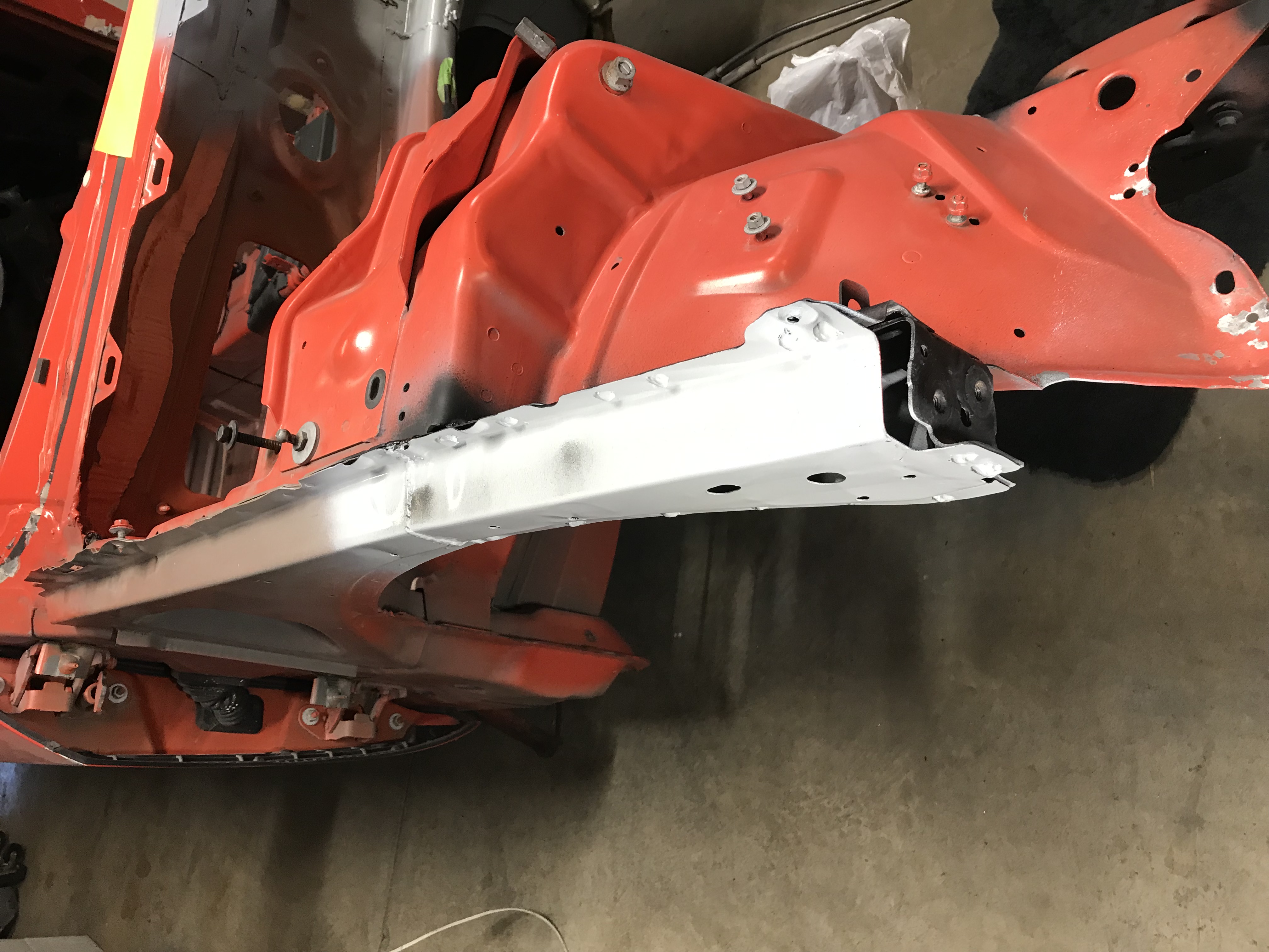

• Sheet metal for bottom of A pillar and part of frame rail fitted and clamped in place

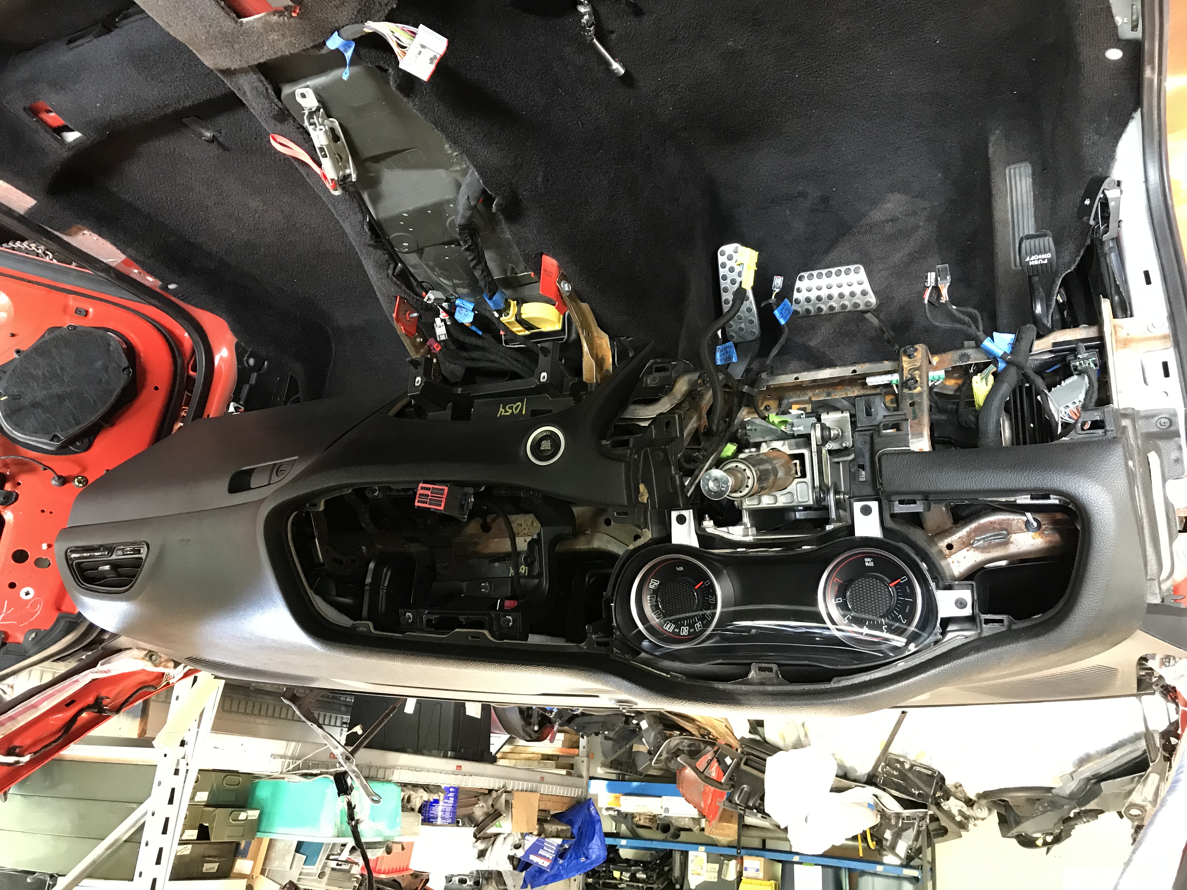

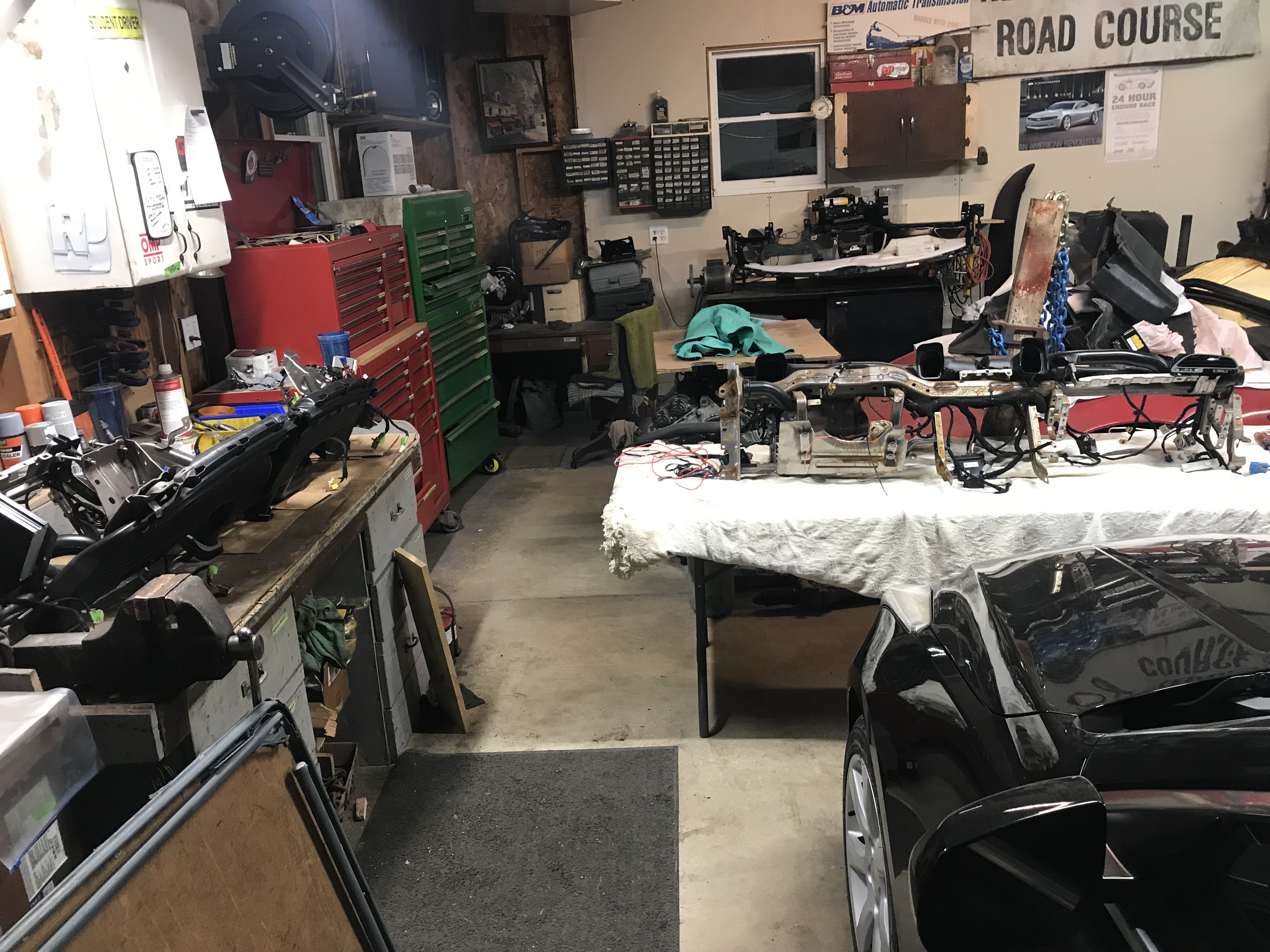

Started on the dash work

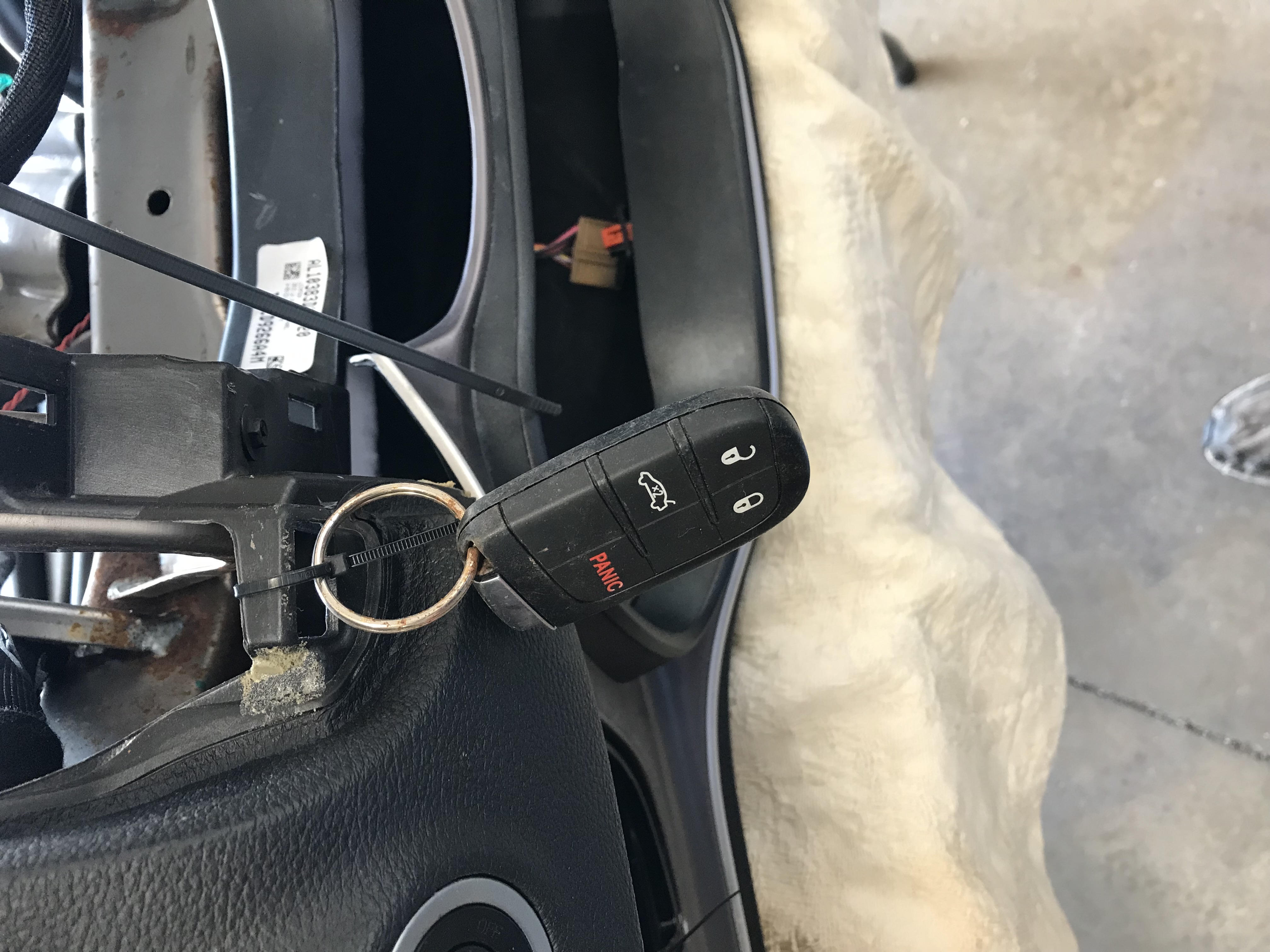

• Decided it will be easier to move the cover to my existing frame. The wiring harness on the junkyard dash had some after market mods, moving the harness looks quite involved since it winds all around the dash
• Removed the pad from the junkyard assembly
• Discovered this assembly has a passenger airbag and also a key fob. The first dash I ordered was not to come with the airbag. As it turns out this one was about $100 more and this explains why.

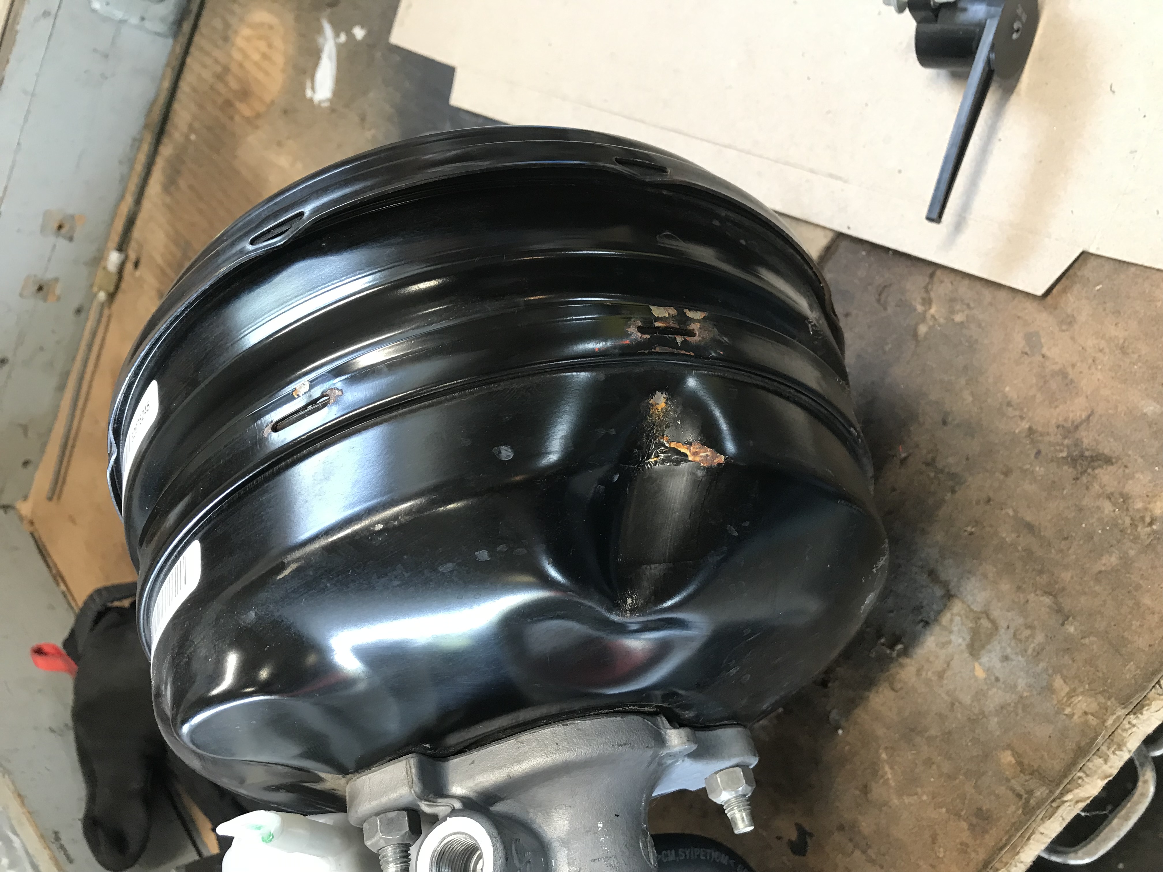

• When I went to install the brake booster I found it had a dent in the bottom from the crash. This explains the lack of brake assist when I was lot driving the car last year. I thought it might have been pinched brake lines.

Dashboard
Turns out the original dash frame was bent and bolt holes did not line up. I was concerned for a bit but test fit of the replacement dash frame showed all the bolt holes line up.
With this information I moved the original wiring harness to the new frame and reassembled the whole thing. To make sure I got everything connected in the right places, I removed the harness from the dash frame one or two connections at a time and installed the original right after.
After assembly and other prep I installed the dash. Install was pretty straightforward, and this job is so much easier with no windshield and no front seats. Lots of bolts and small screws to install, and wires to connect. I had labeled most of the connections which helped.

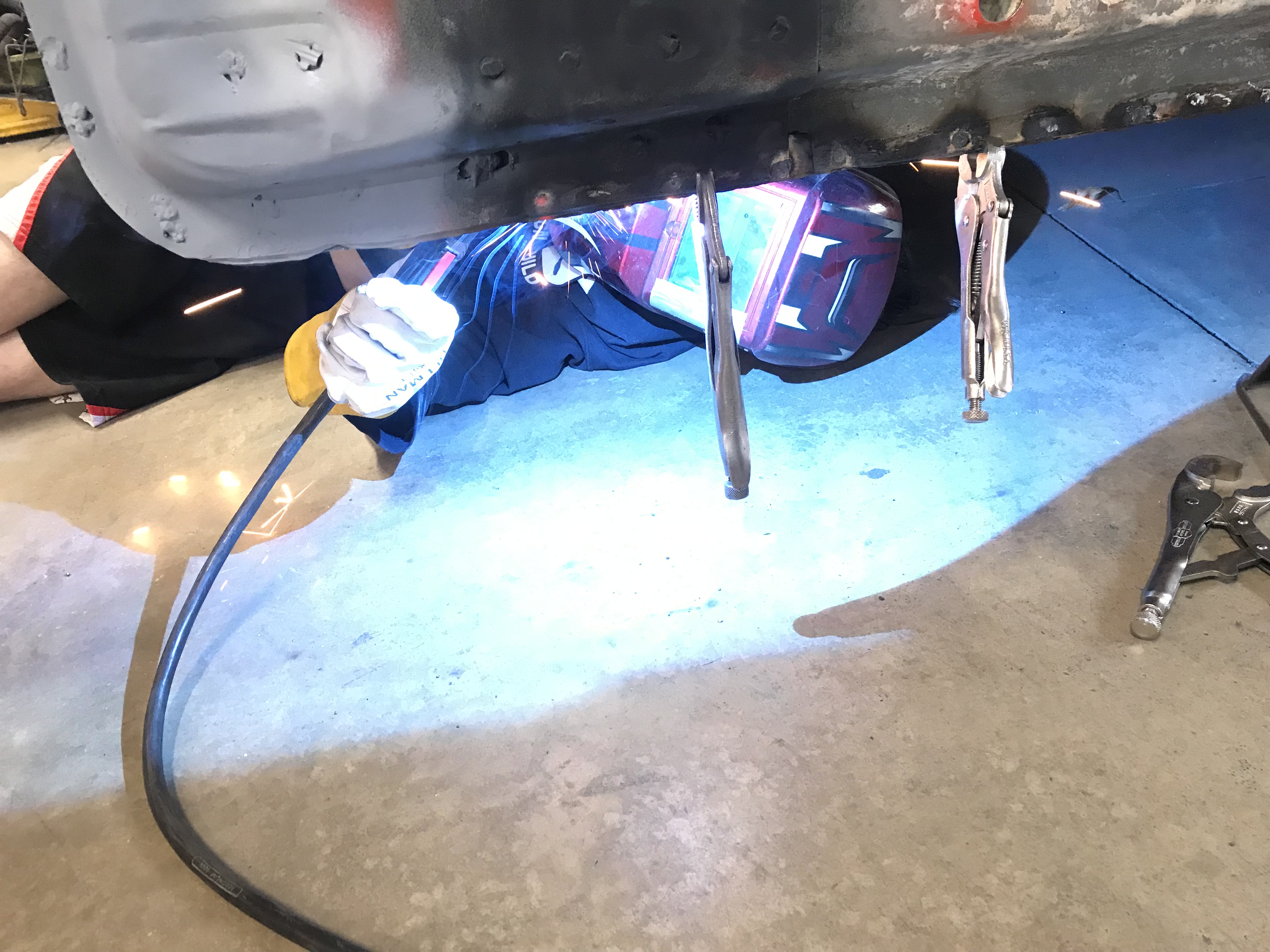

Kurt did the final welding for the lower A pillar sheet metal panel. Cleaned up the welds and got some paint on them

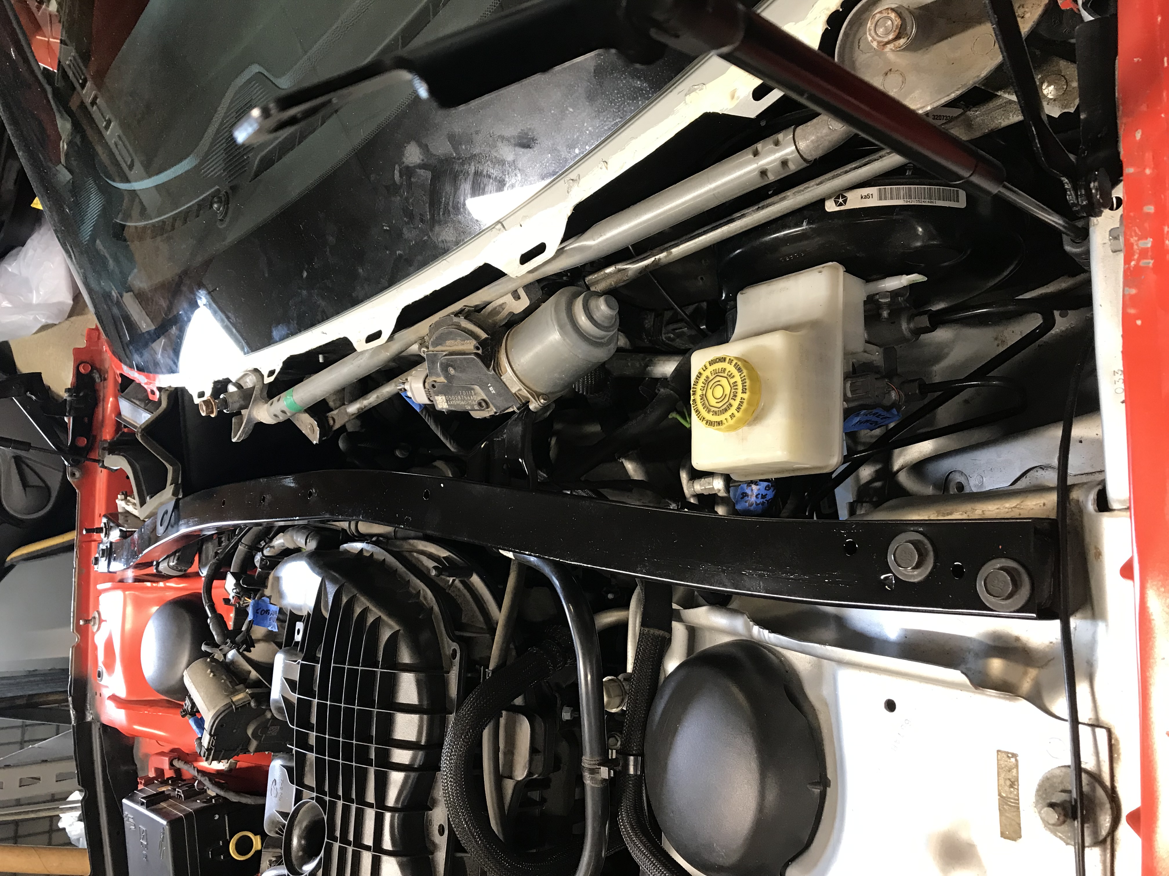

Obtained and installed the brake booster

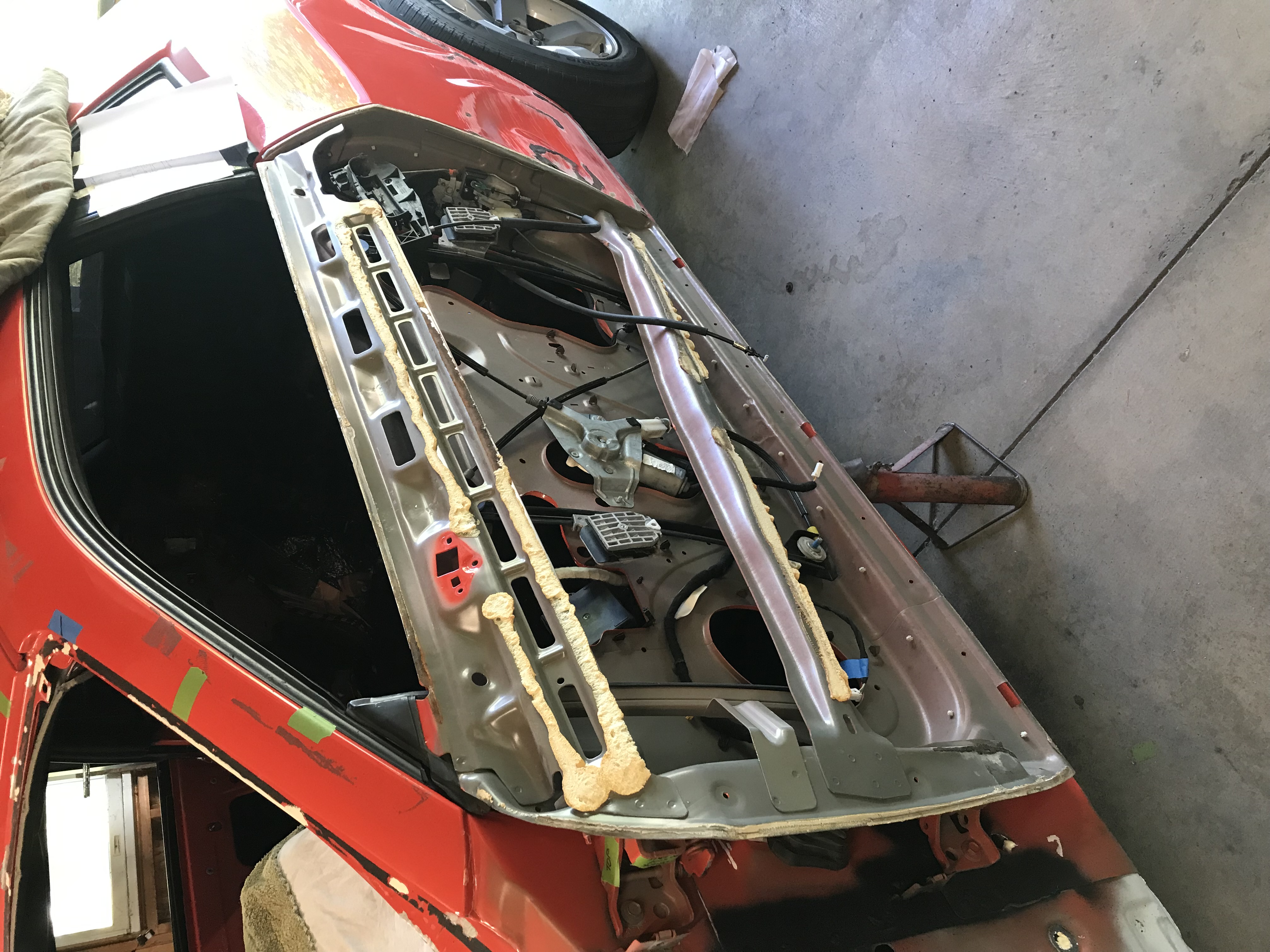

Got busy with expanding foam in the driver side frame rail and lower windshield brace – replacing what was removed during repairs. It took about a can’s worth

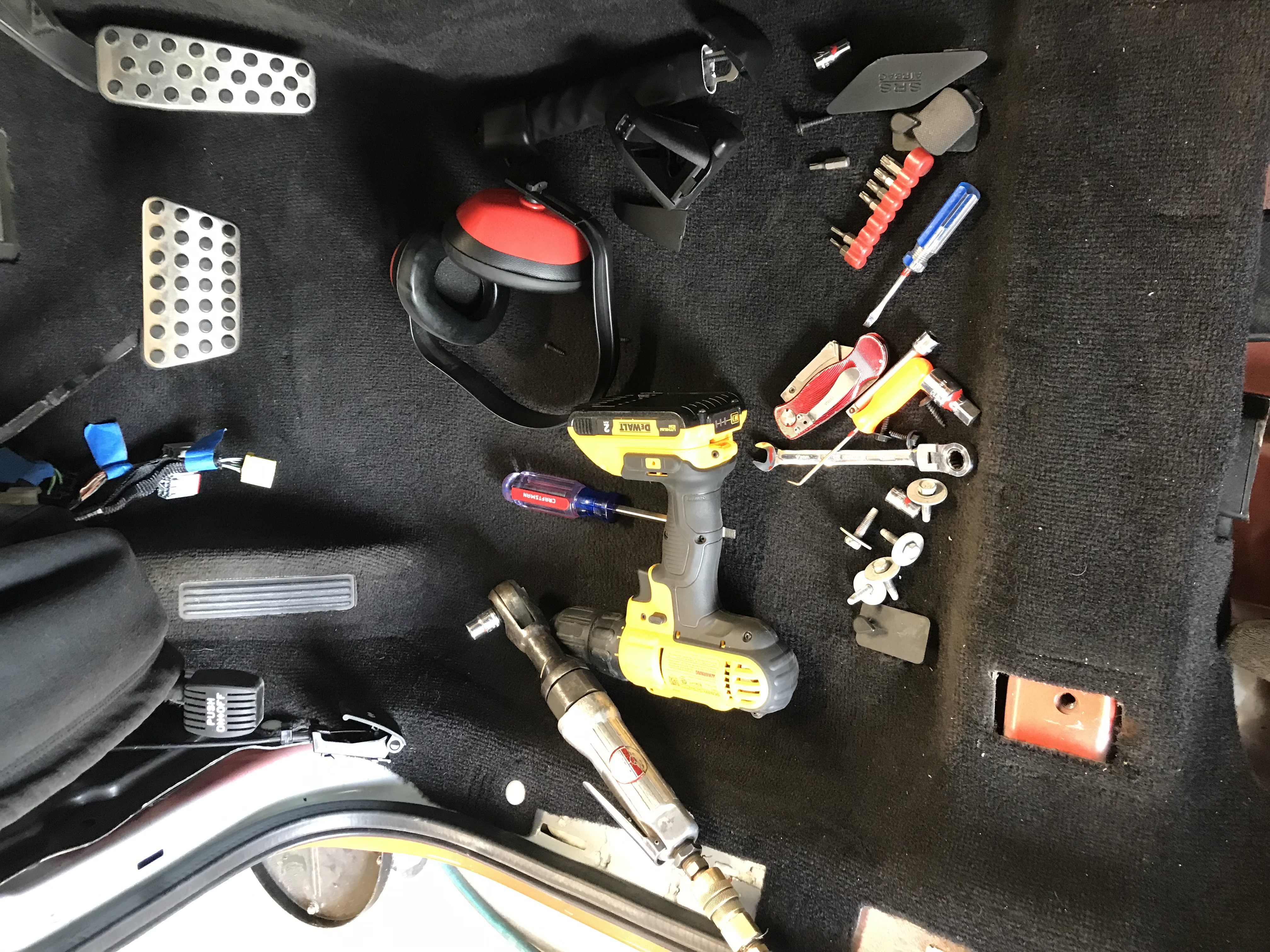

Install the front carpets – these loop in over the lower dash support brackets. Also put in the ducting that goes under the carpet to the back for the car

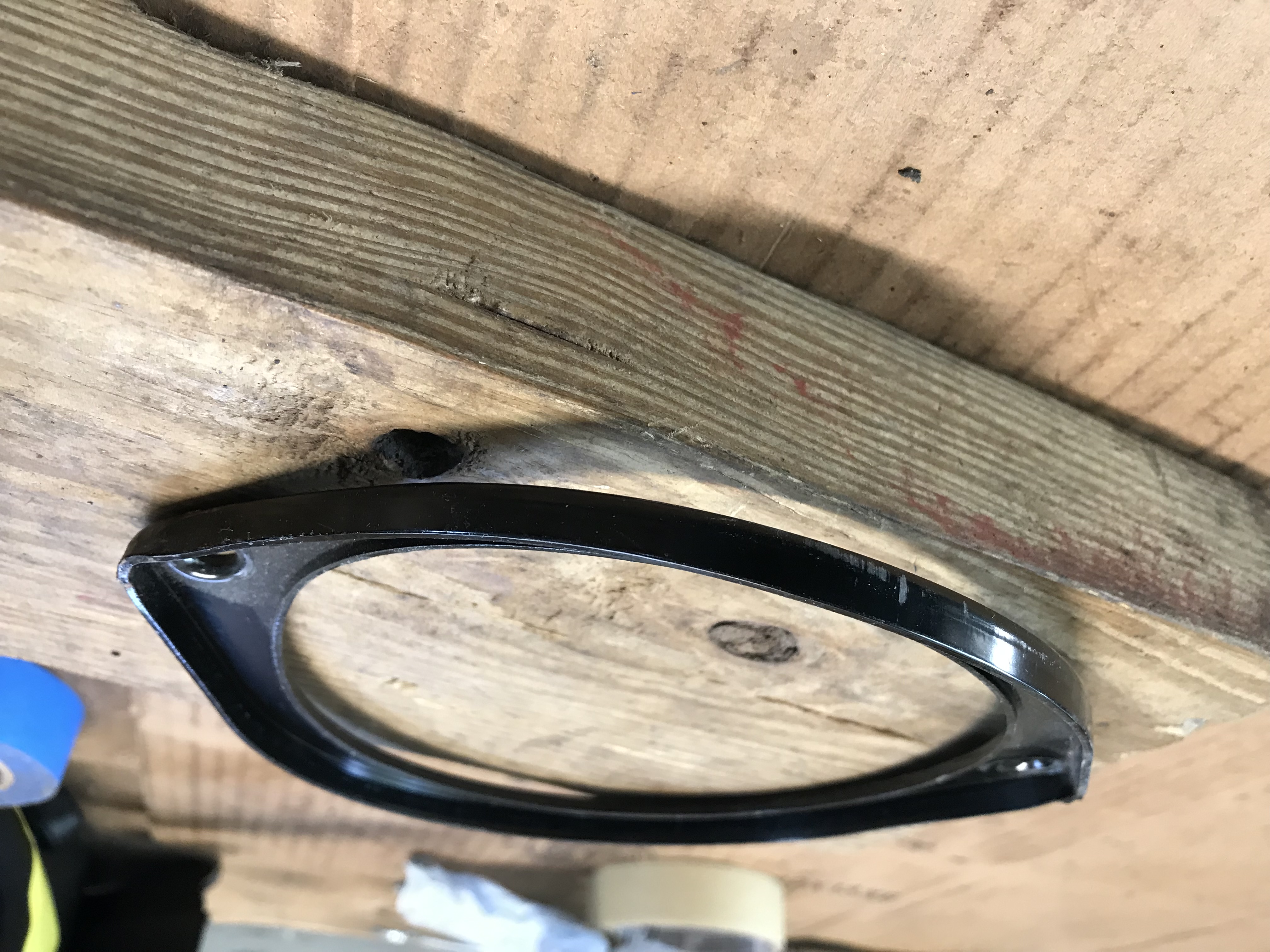

After the dash was installed, the steering column, glove box and gauge cluster were installed. There is a metal ring that holds the seal at the firewall, and of course it was bent. Each time I find another bent item I wonder if this is the last surprise from the crash. The brake booster had that title for about a week.

Definitely into a new phase for this project - still a long way to go but expecting a lot more assembling and less fabricating from here on in. After looking at this shell for so long it's really nice to see it starting to come back together.

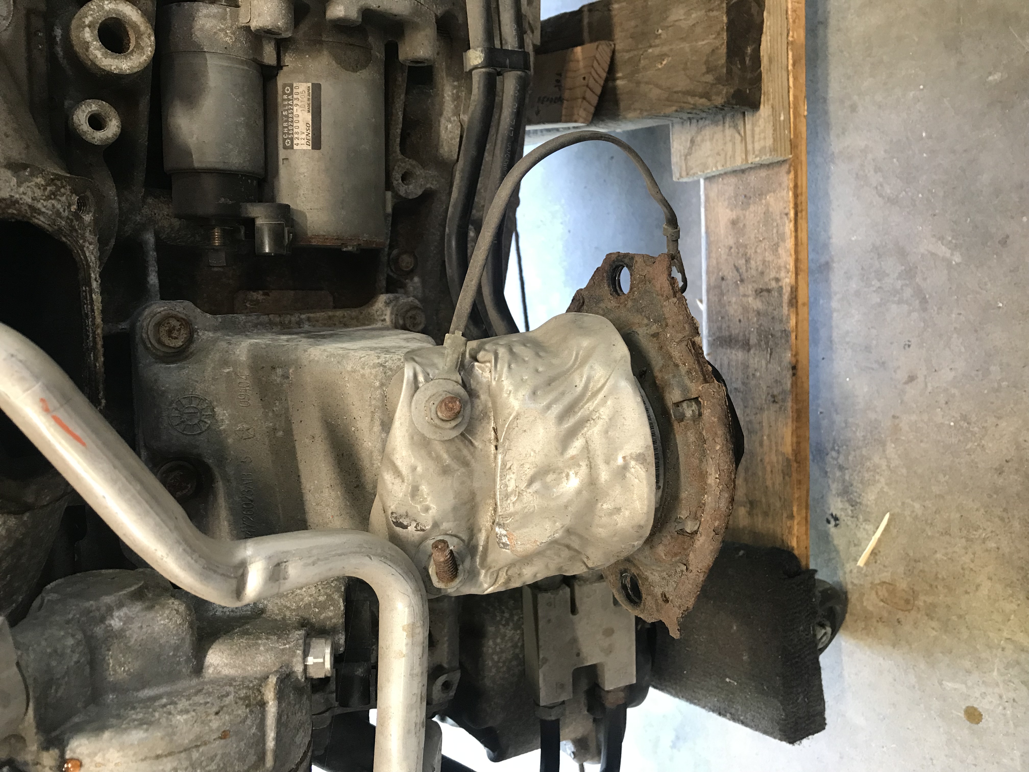

Installed engine on the subframe. The driver side mount was wobbly – I figured it had been damaged in the crash. Once I got the heat shield off I could see the top mount had loosened up. Easy fix.
note how the studs for the heat shield were bent from contact with the chassis

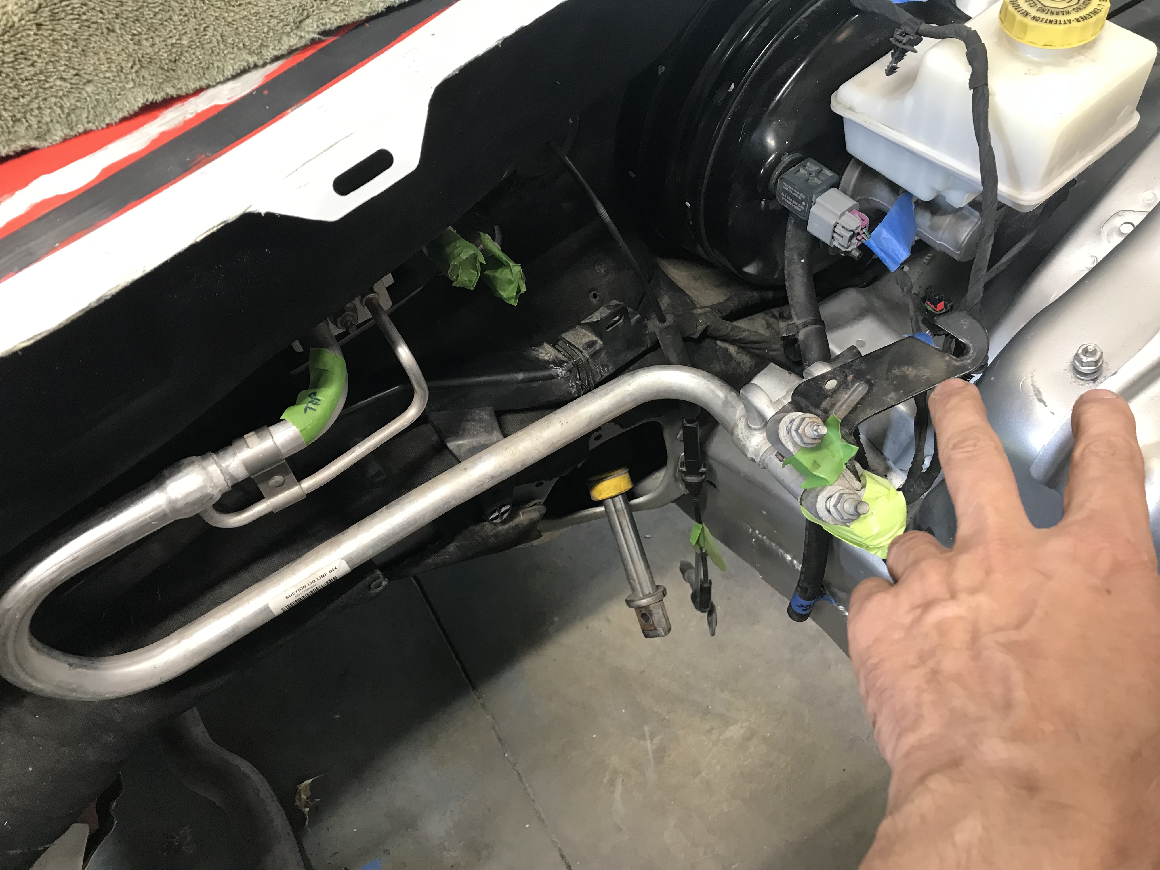

Installed A/C line to the exchanger unit on the firewall. Tried the Challenger part but it was bent. There is an anchor on the LF shock tower and the mounting bracket was at least 3” away. Fortunately I saved this part from the Charger and they are the same part. Also installed heater core hoses and a few other odds and ends.

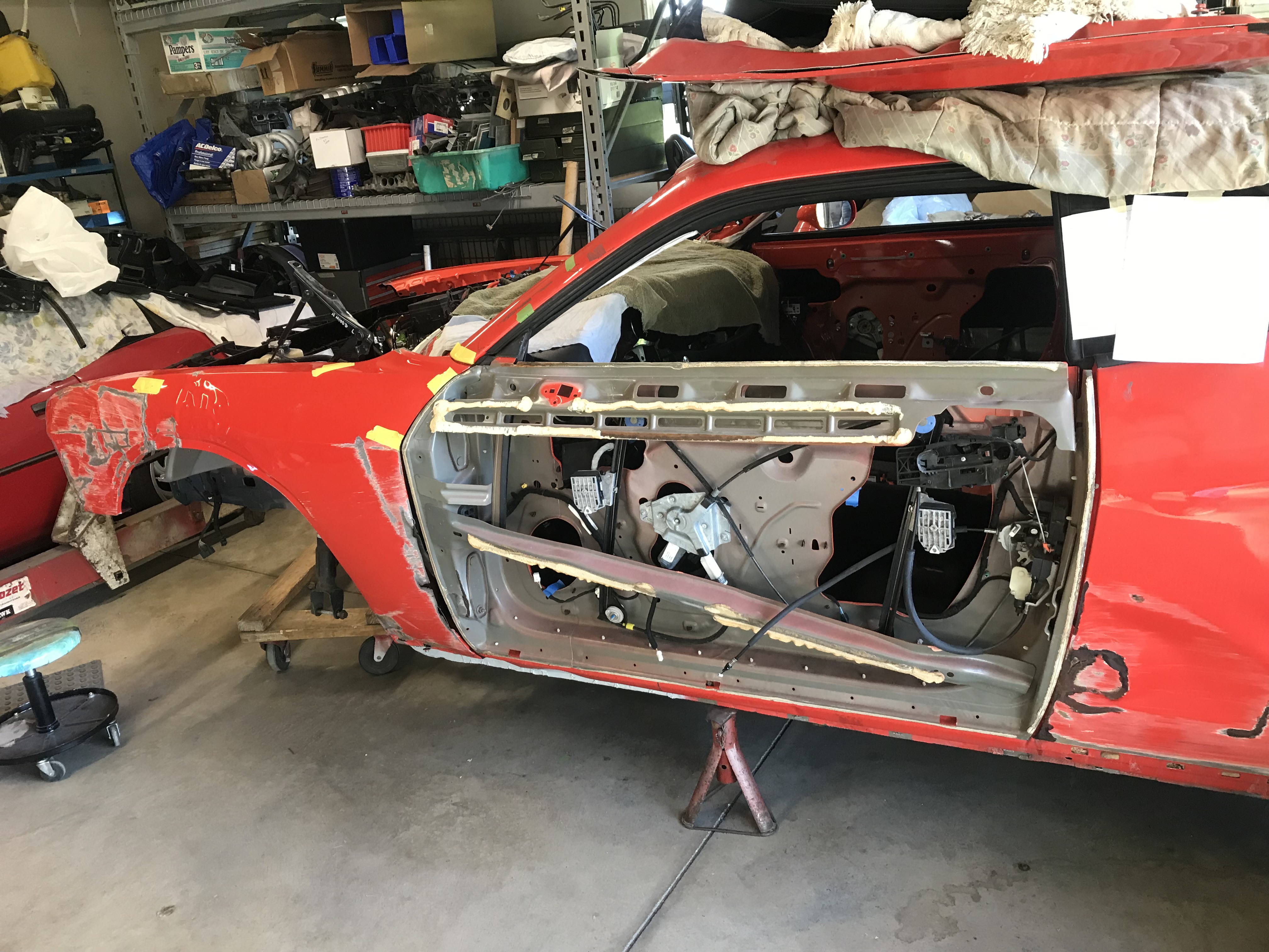

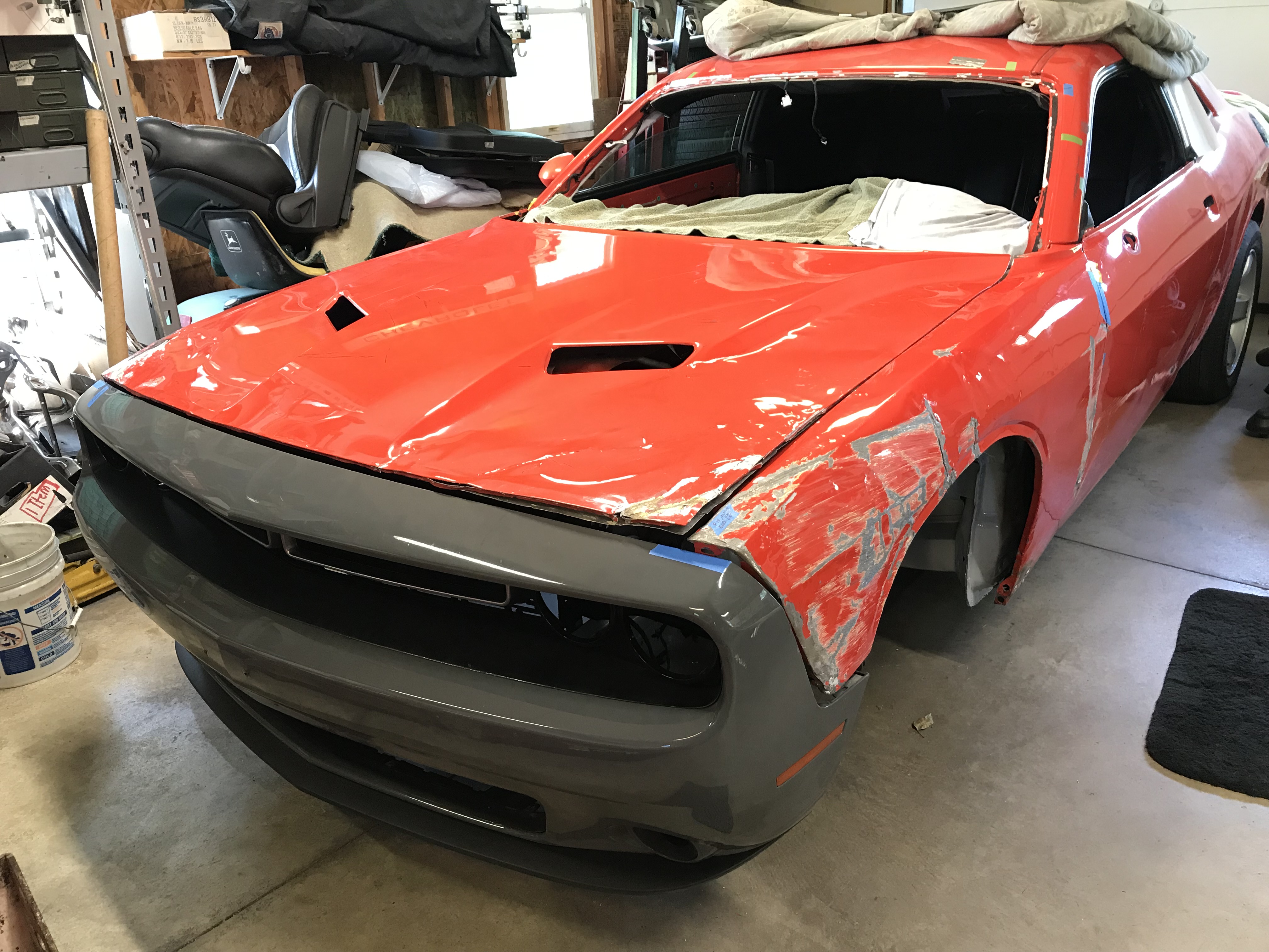

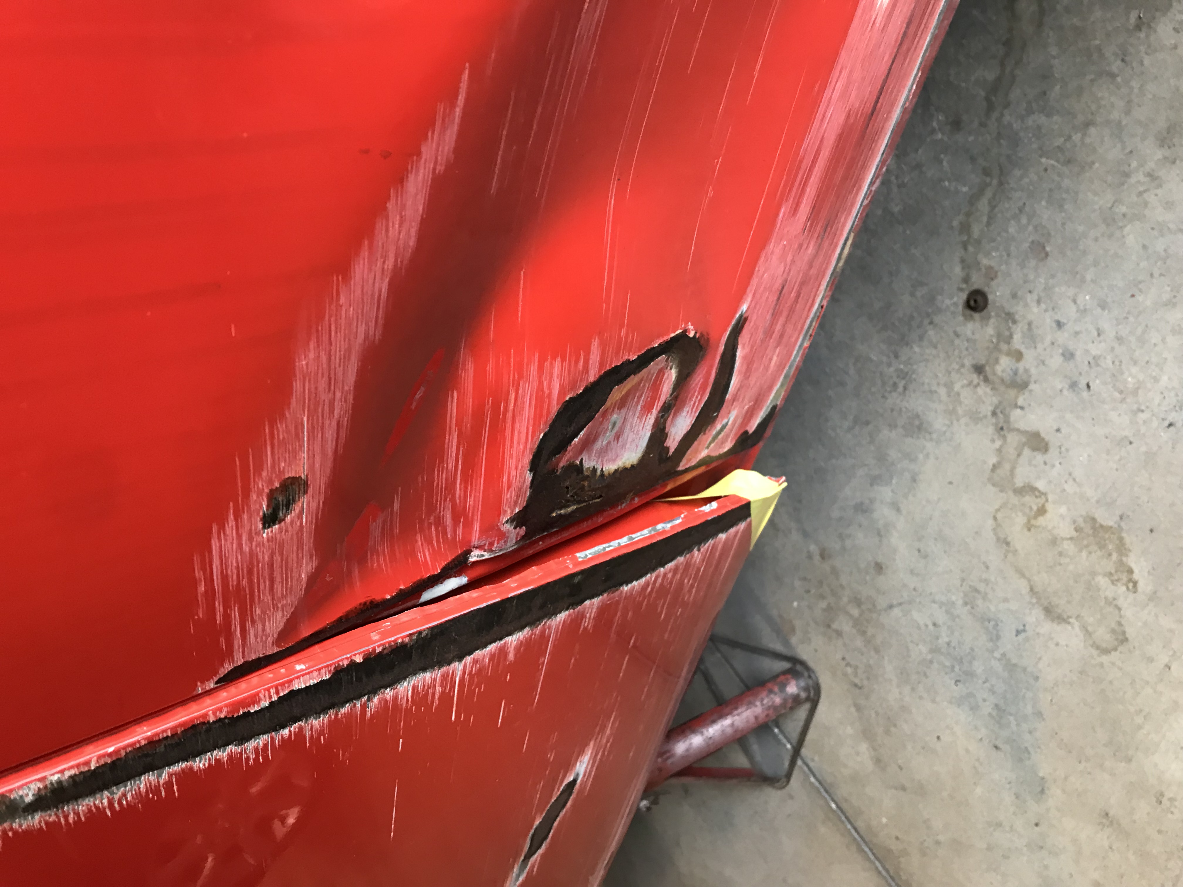

Test fit the driver door. It was still a bit bent – the lower edge of the door was about ¾” too far out just before the B pillar.
bottom of the door sticking out
Took a bit to realize the top of the door was too far in. Fixed this by pushing in on the bottom of the door while pulling out on the top of the door. Also had to adjust the striker to get the door to close properly. I’m doing all of this without the outside skin on the door – looks good right now but won’t know until the door skin is on to know if it really does fit OK.

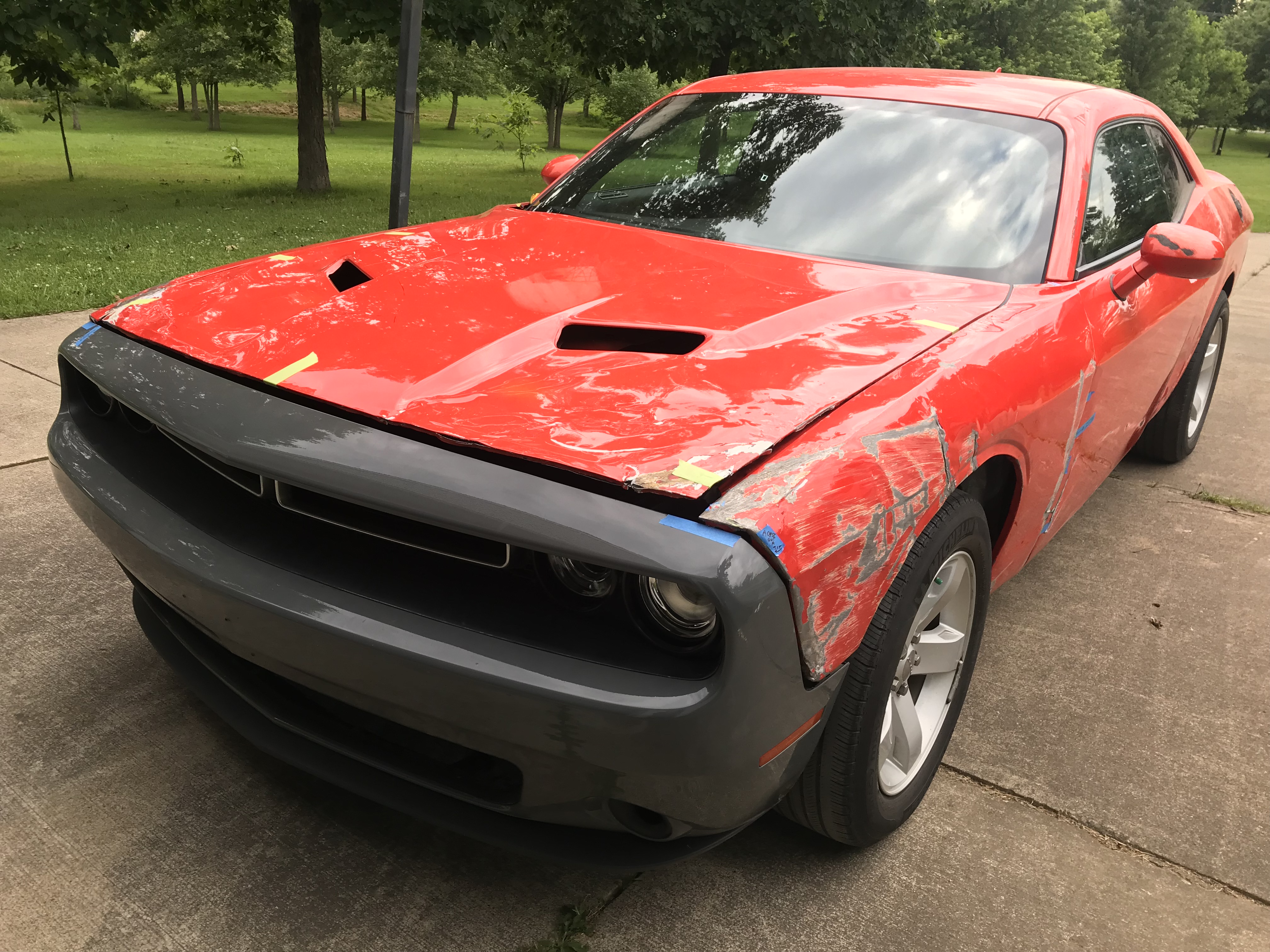

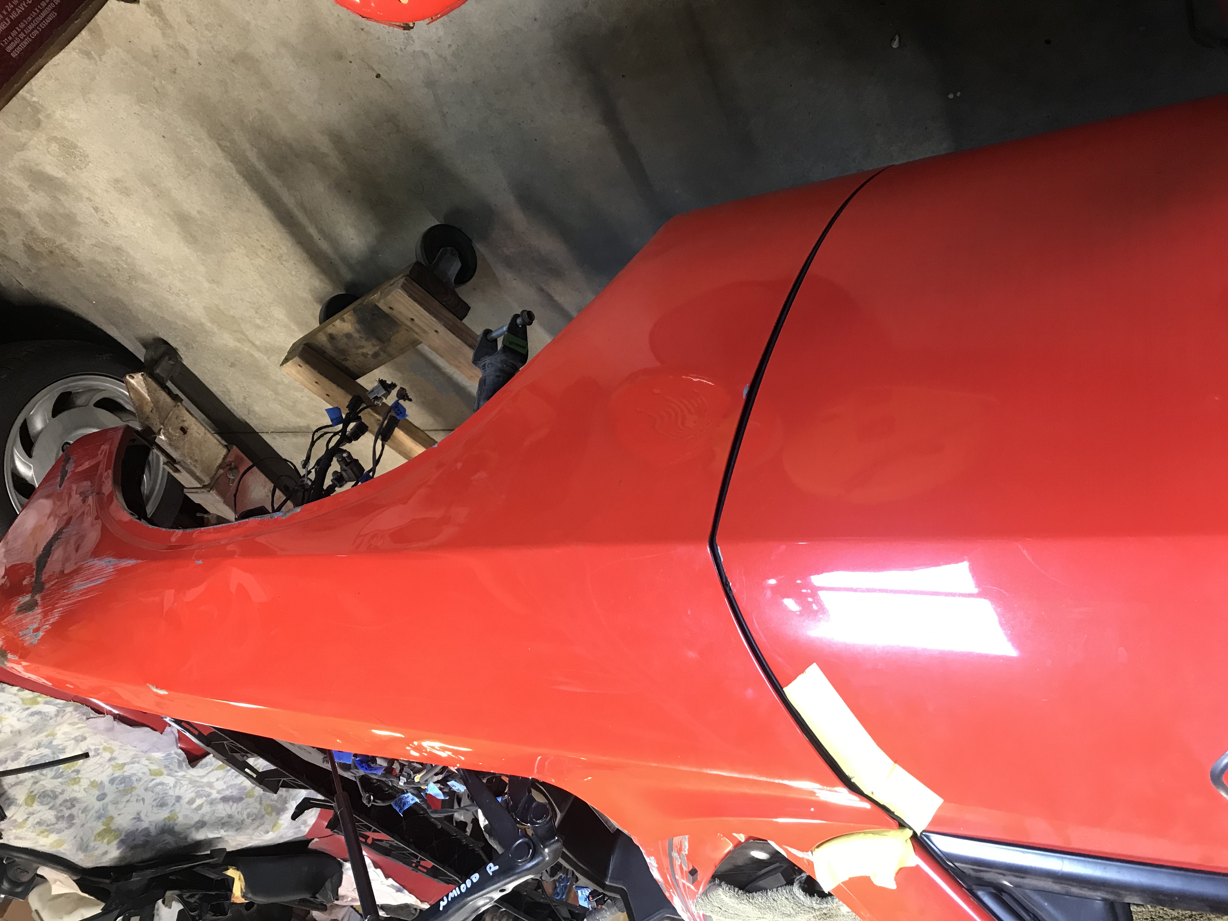

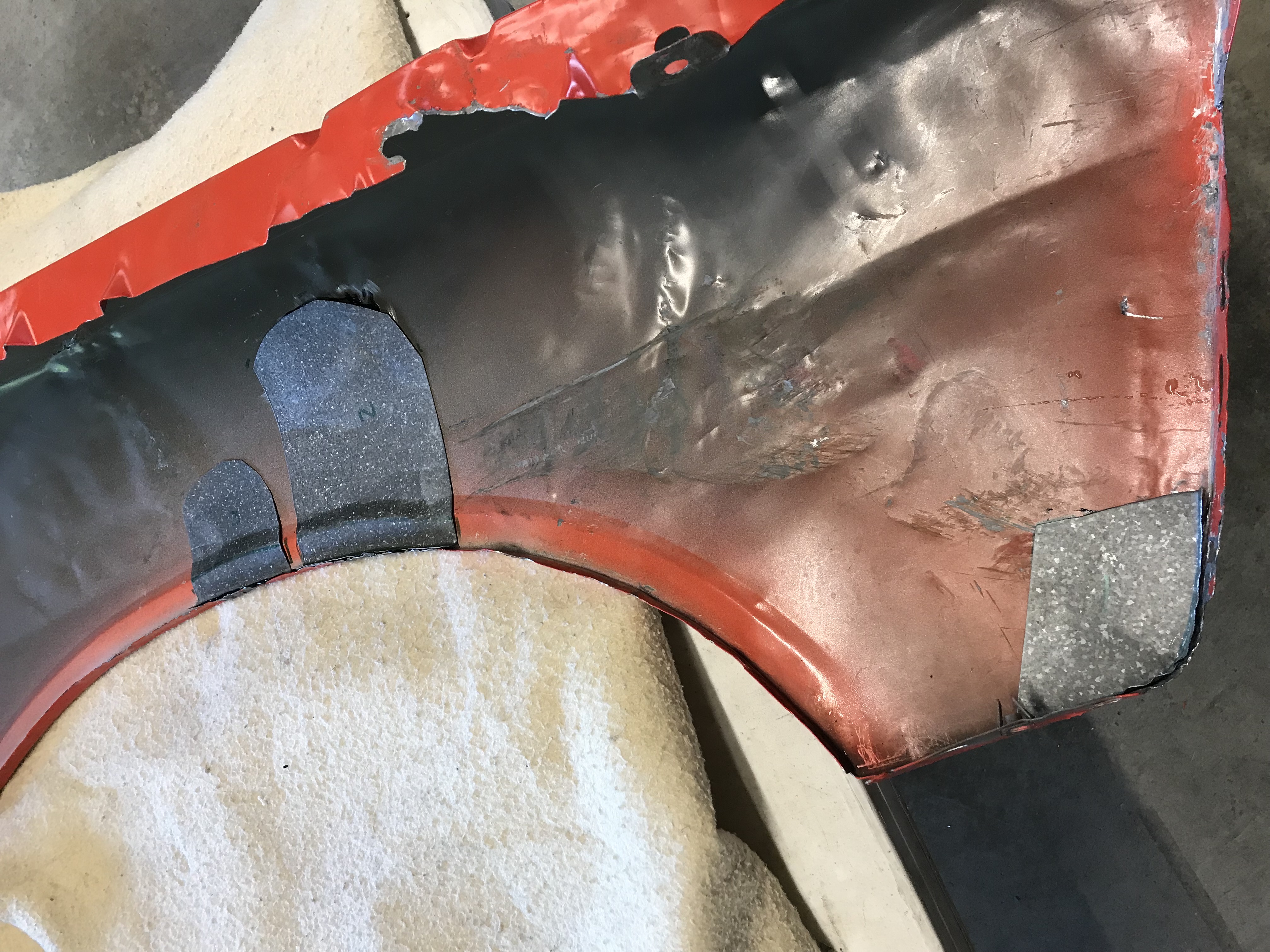

Went to work on the left front fender. This was by far the most damaged panel. I was comparing it to the sample fender I had, but ultimately wanted to compare it to the passenger side front fender. It was pretty good from the last round, but there were still more adjustments to be made to get the alignment with the A pillar right.
Took a few rounds of tweaking the fender shape by the A pillar, but also where the fender attaches to the car along the top of the fender. Once I had that side in order I went back to driver side. It’s hard to explain all the adjustments I made. There was a big adjustment to the top of the fender in the front – five hours of work so far. Still a ways to go but it is fitting to the car.

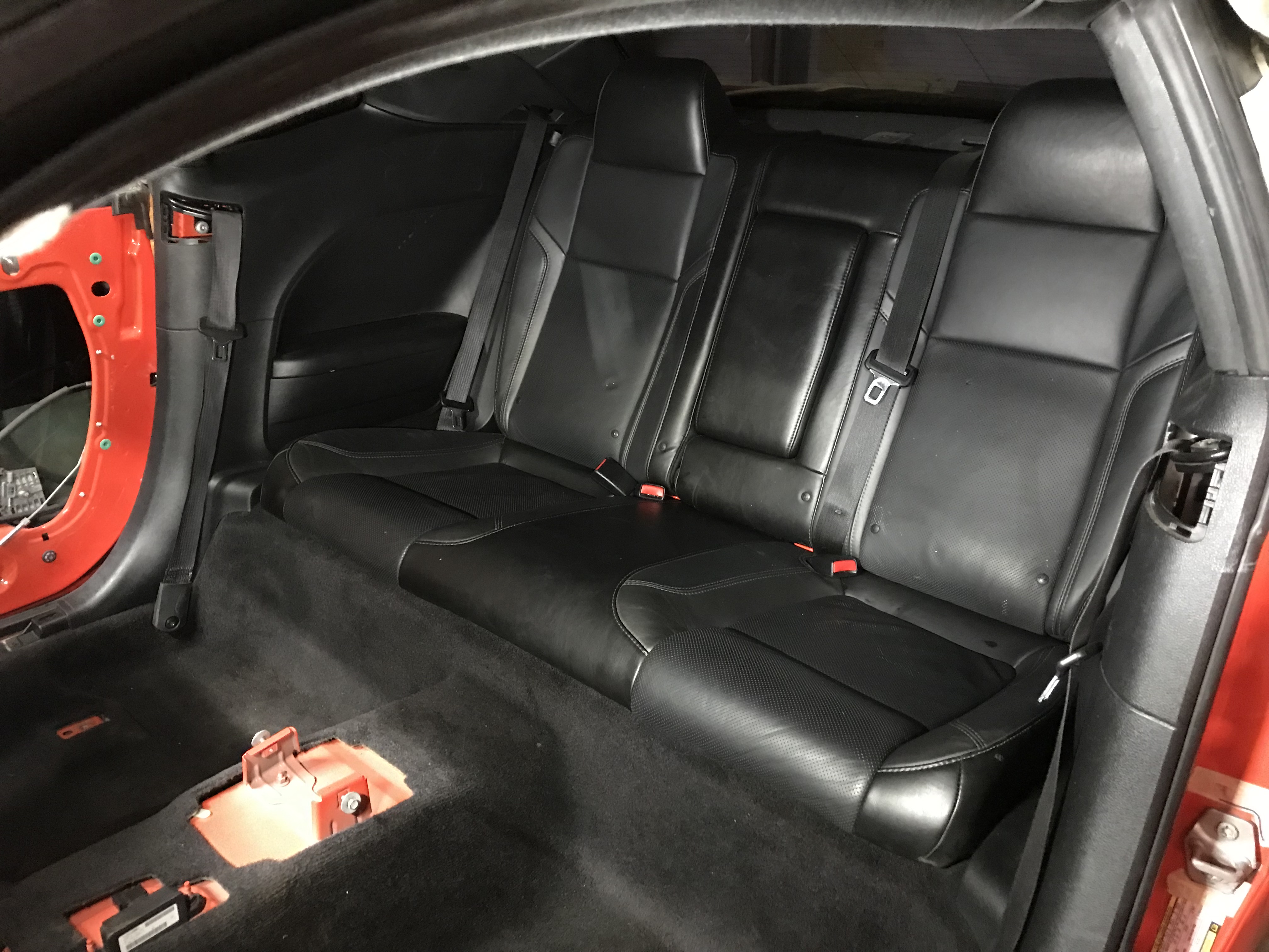

Sent the seat belts out for rebuild. Upon their return I put them into the car, and reassembled the back half of the interior – seat belts, side panels, seats. Lots of visible progress for relatively little time on this front.

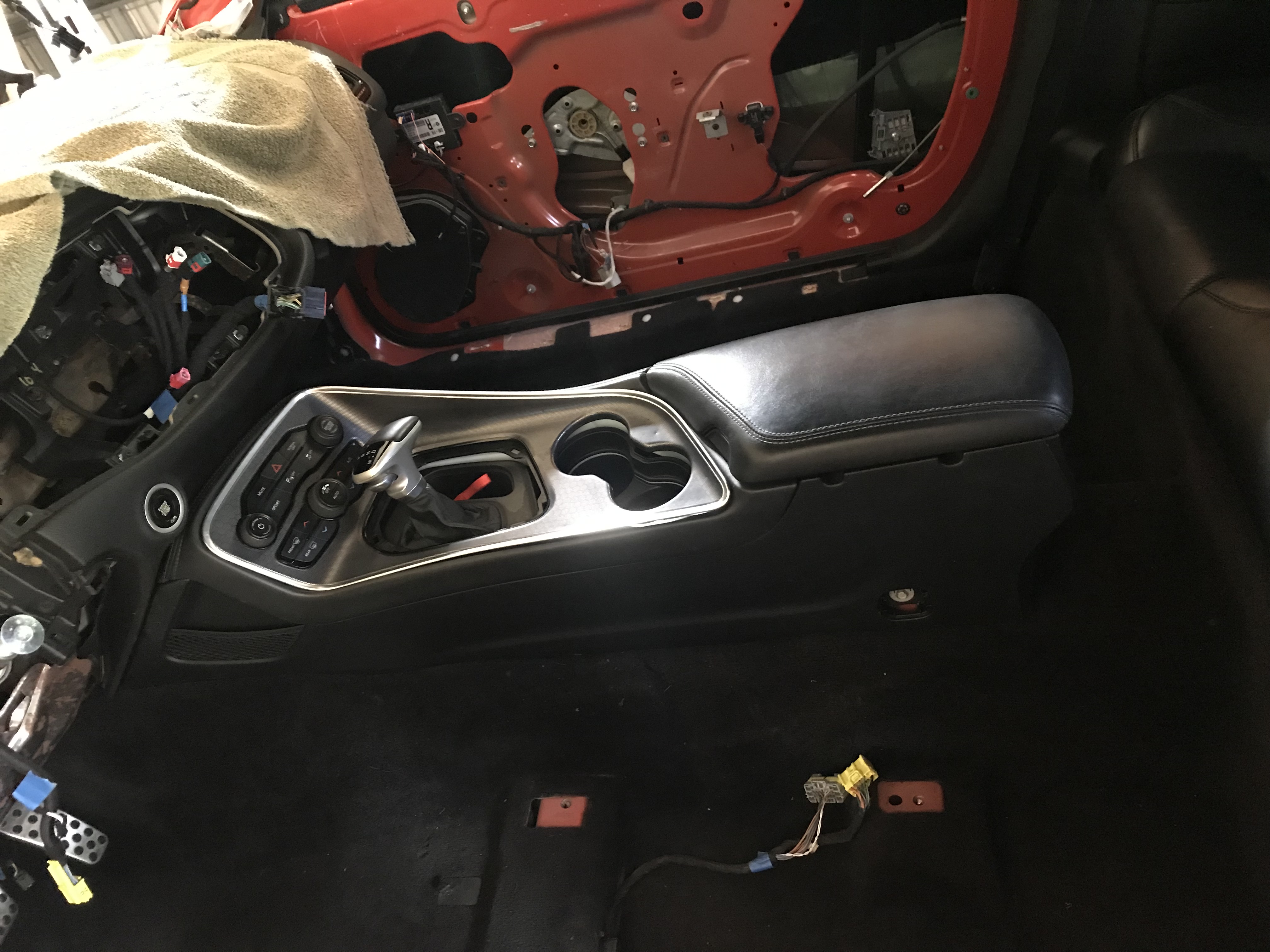

Installed the center console. The storage compartment had a strong smell (perfume?) so I ended up washing it out with soap and water before install.

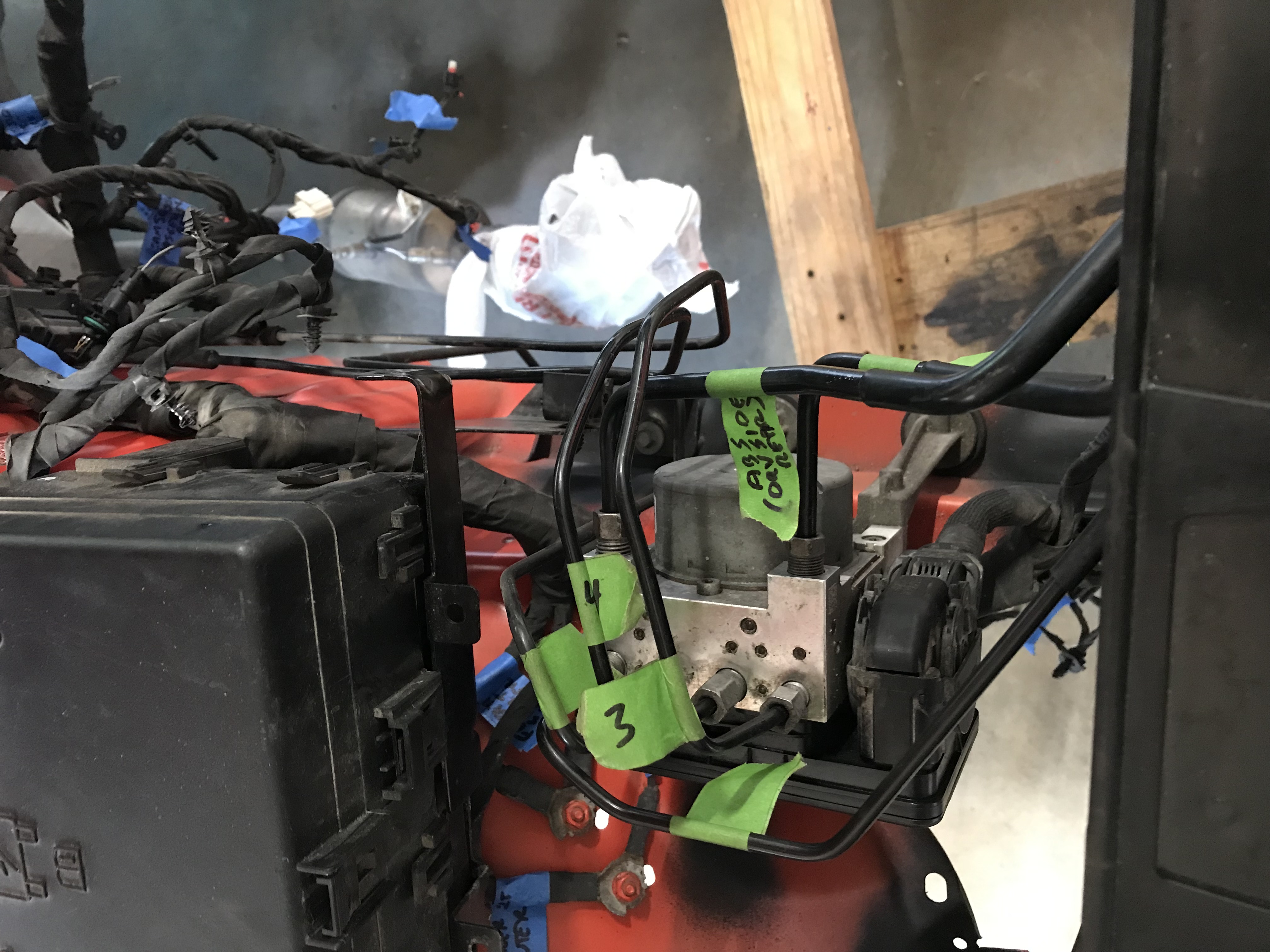

Install the ABS module and brake lines. Used the Charger parts car brake lines as they were all straight and not broken.

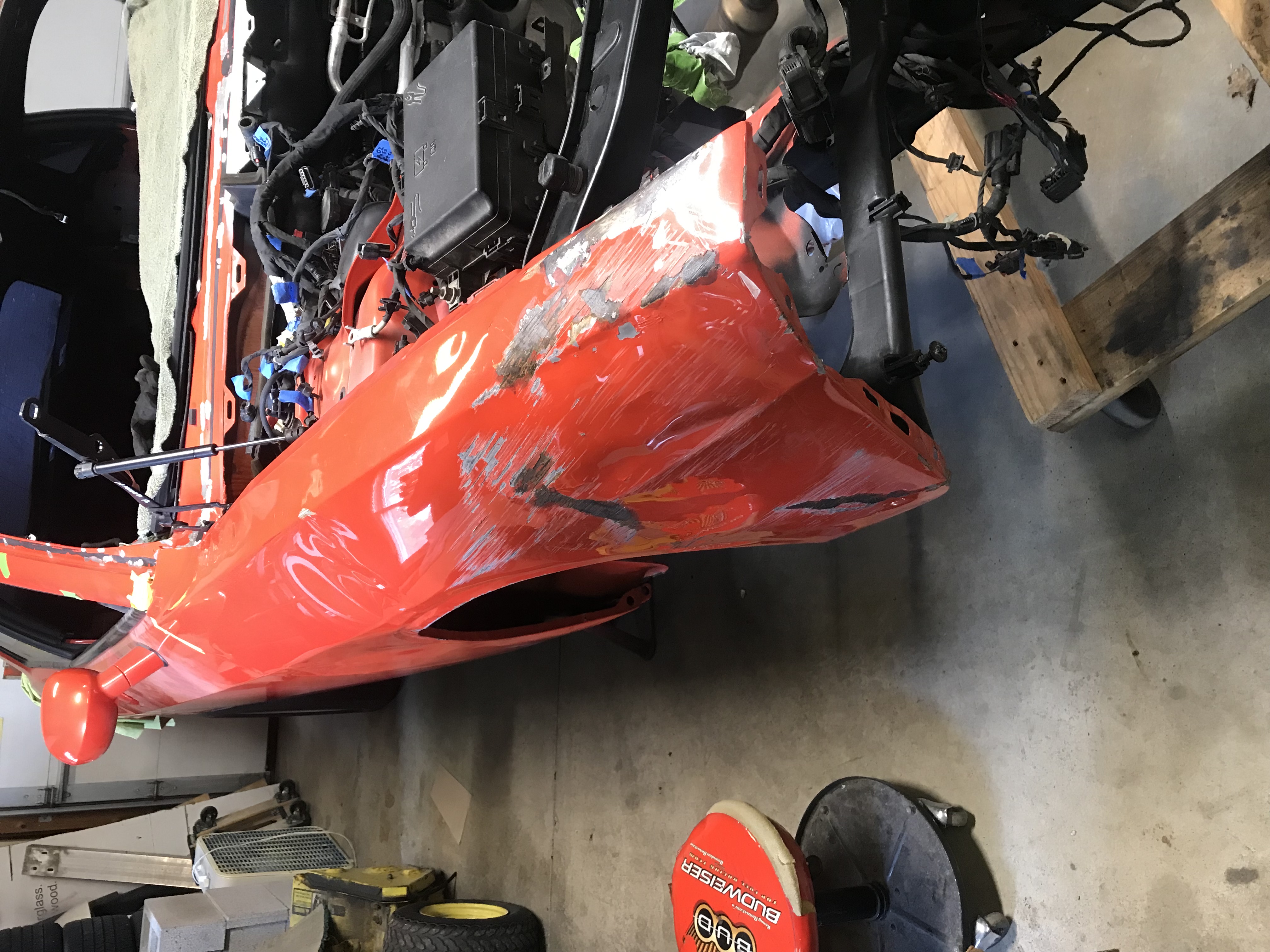

Did some heavy lifting on the LF fender. It was by far the worst panel. It had been roughed in during earlier sessions but now it was time to fit the thing. The shape was off in multiple ways so it was quite a challenge to get it to align with the door, A-pillar and hood. Ultimately, I made some small adjustments to the bolt holes at the top of the fender so the fender would clear the door. After that I fabricated some patches with galvanized sheet metal to cover the holes from grinding on the barrier, and connected them with panel bonding adhesive.

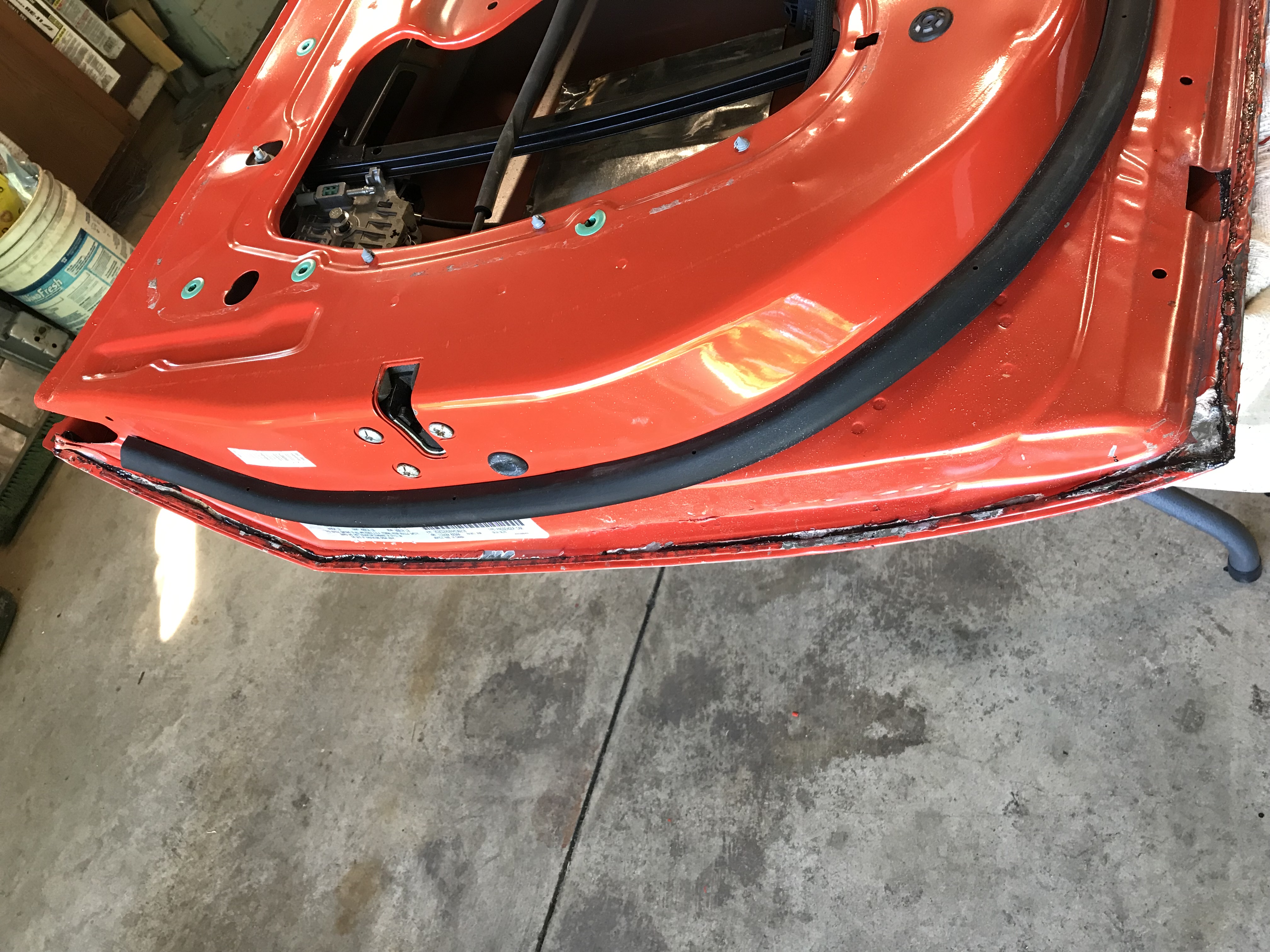

Also did some work on the driver door. Aligning the structure with the rocker panel, front fender and rear ¼ panel. Test fit the window to make sure it aligned with the window seal on A pillar and roof. Then I made a patch to cover the hole in the door skin, and finally I reinstalled the door skin using panel bonding adhesive and peening all the edges of the door skin back over the frame. After all this I put the door back on the car, and installed the door handle, side mirror and the trim at the top of the door.

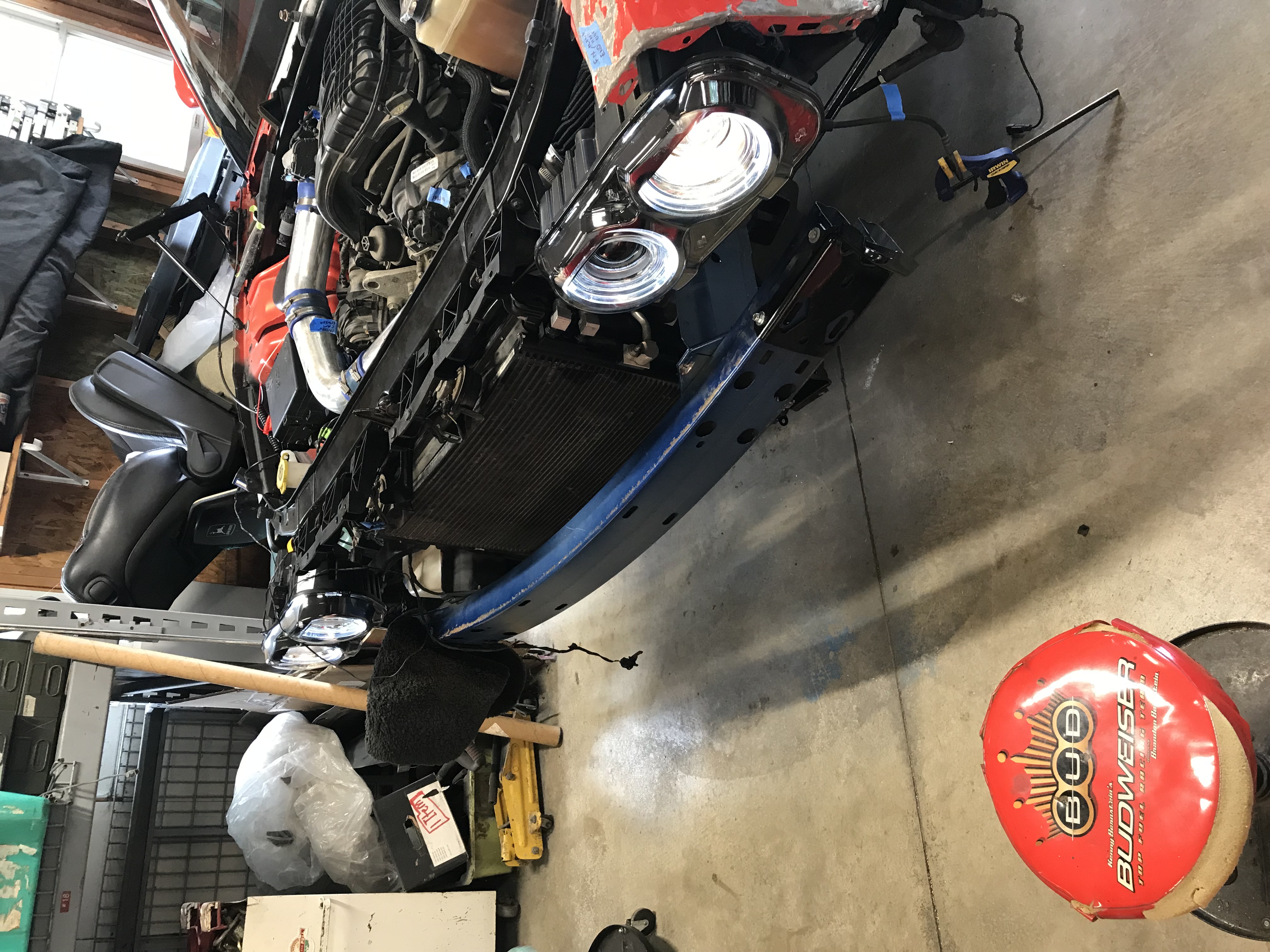

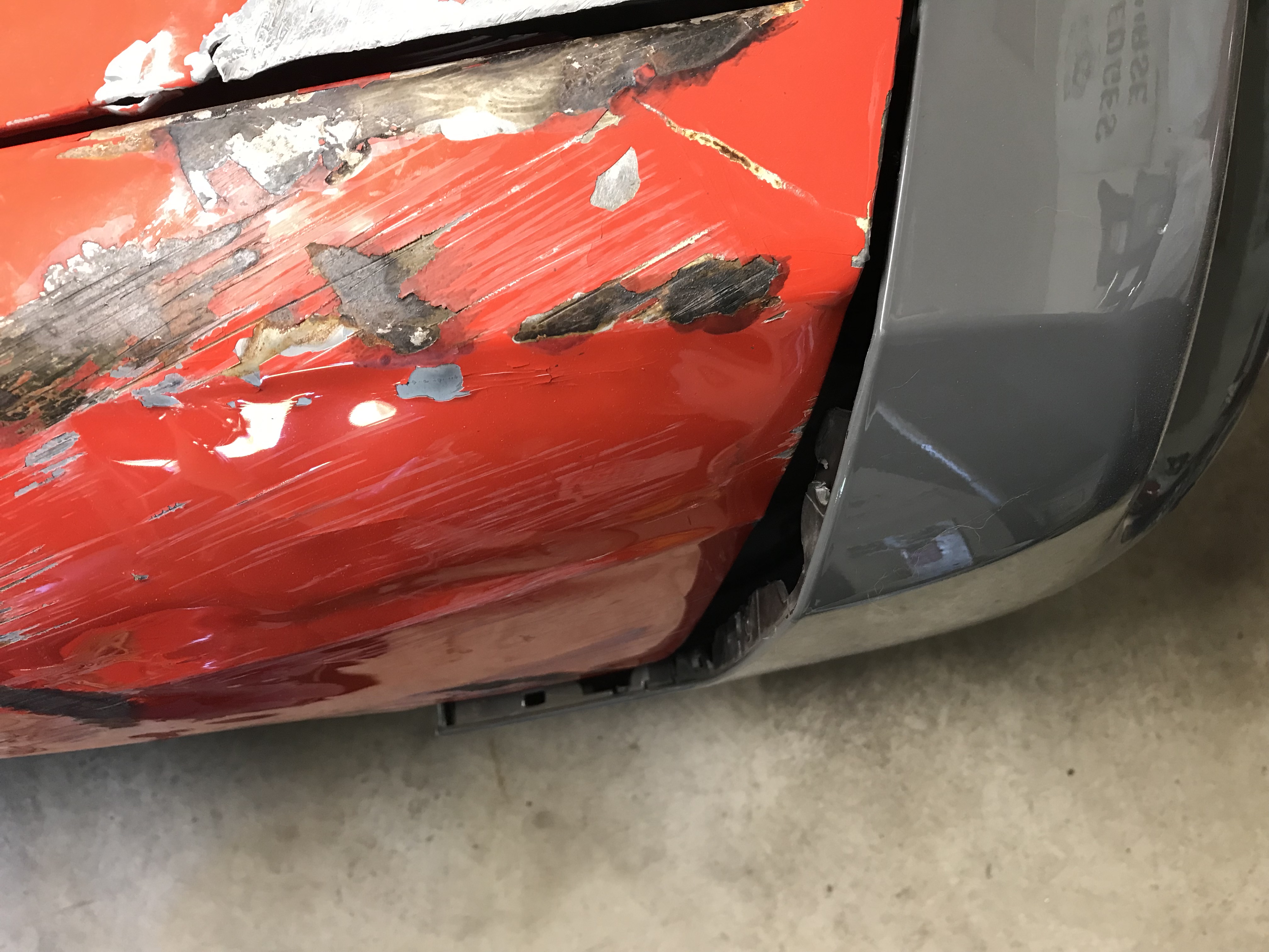

Installed the front bumper and side brackets. Installed the plastic bumper support as well. One of the side brackets was a perfect fit and the other one was off a little – but easily straightened. This allowed me to set the front bumper cover on the car. This uncovered some misalignment where the RF aligns with the bumper cover – I took some swings at it and its better but not there yet.

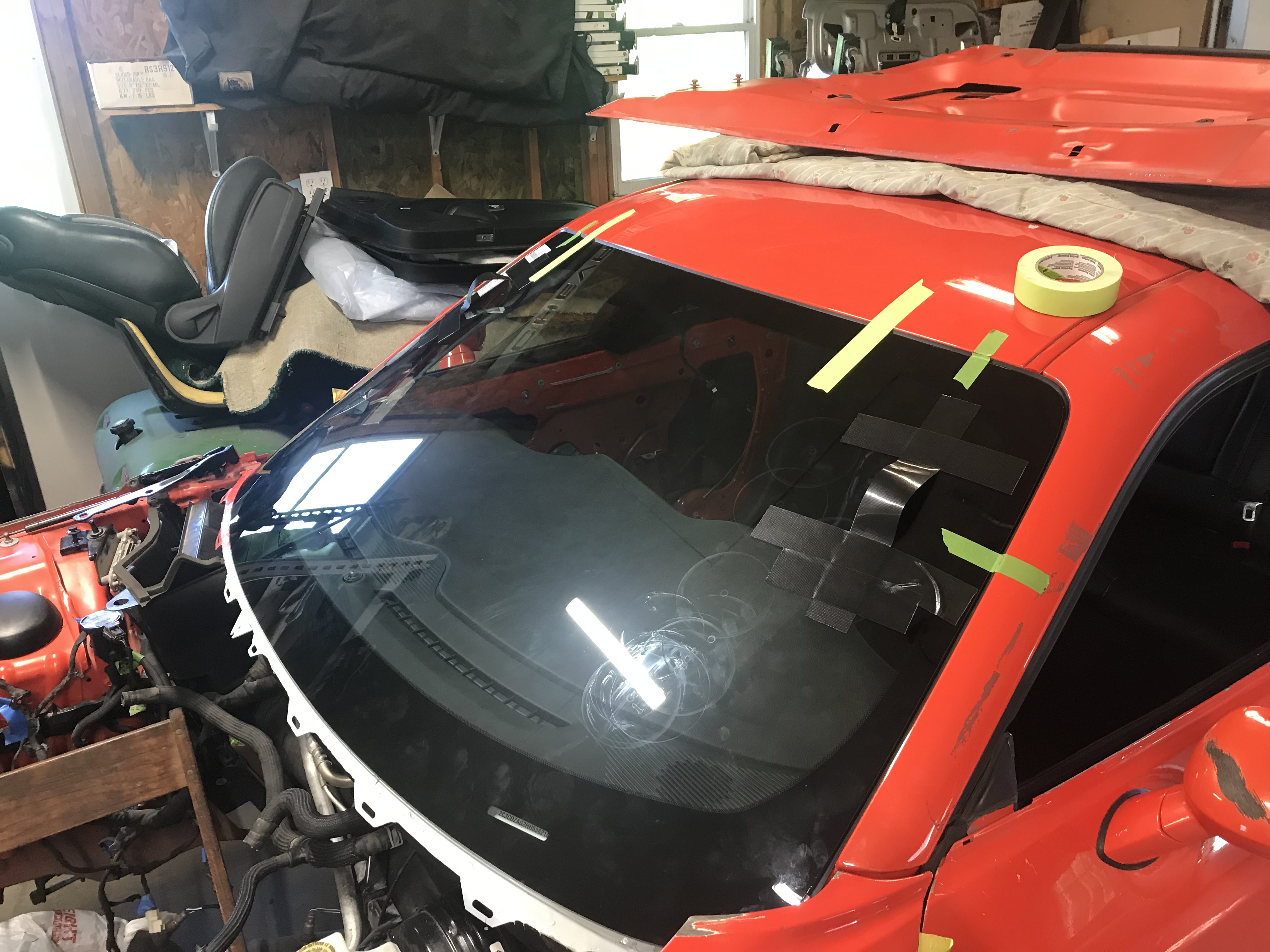

Installed the windshield. Got some help from Kurt. Tried the Harbor Freight suction cups to hold the glass but only one worked. I had made handles with duct tape so that helped.

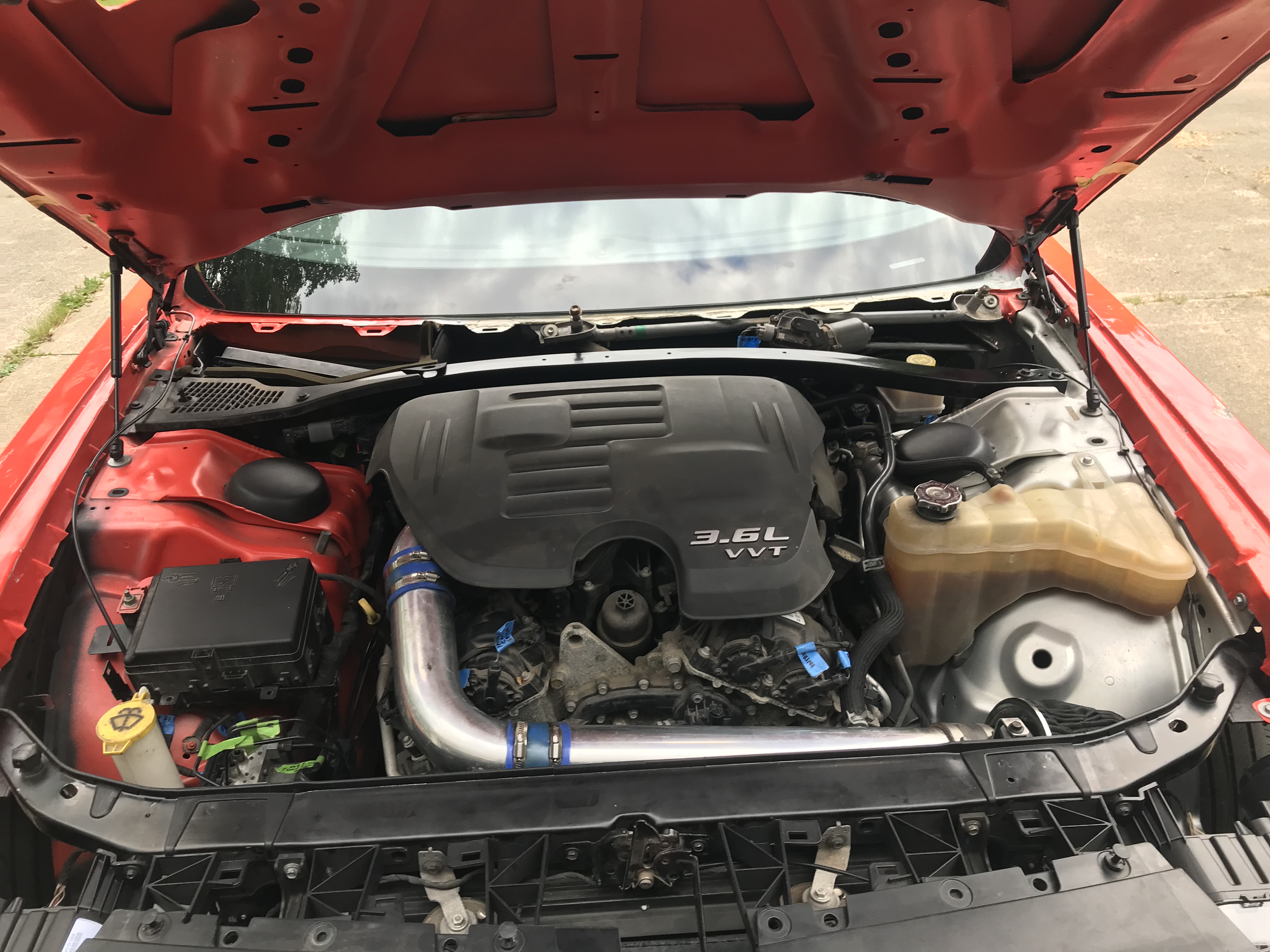

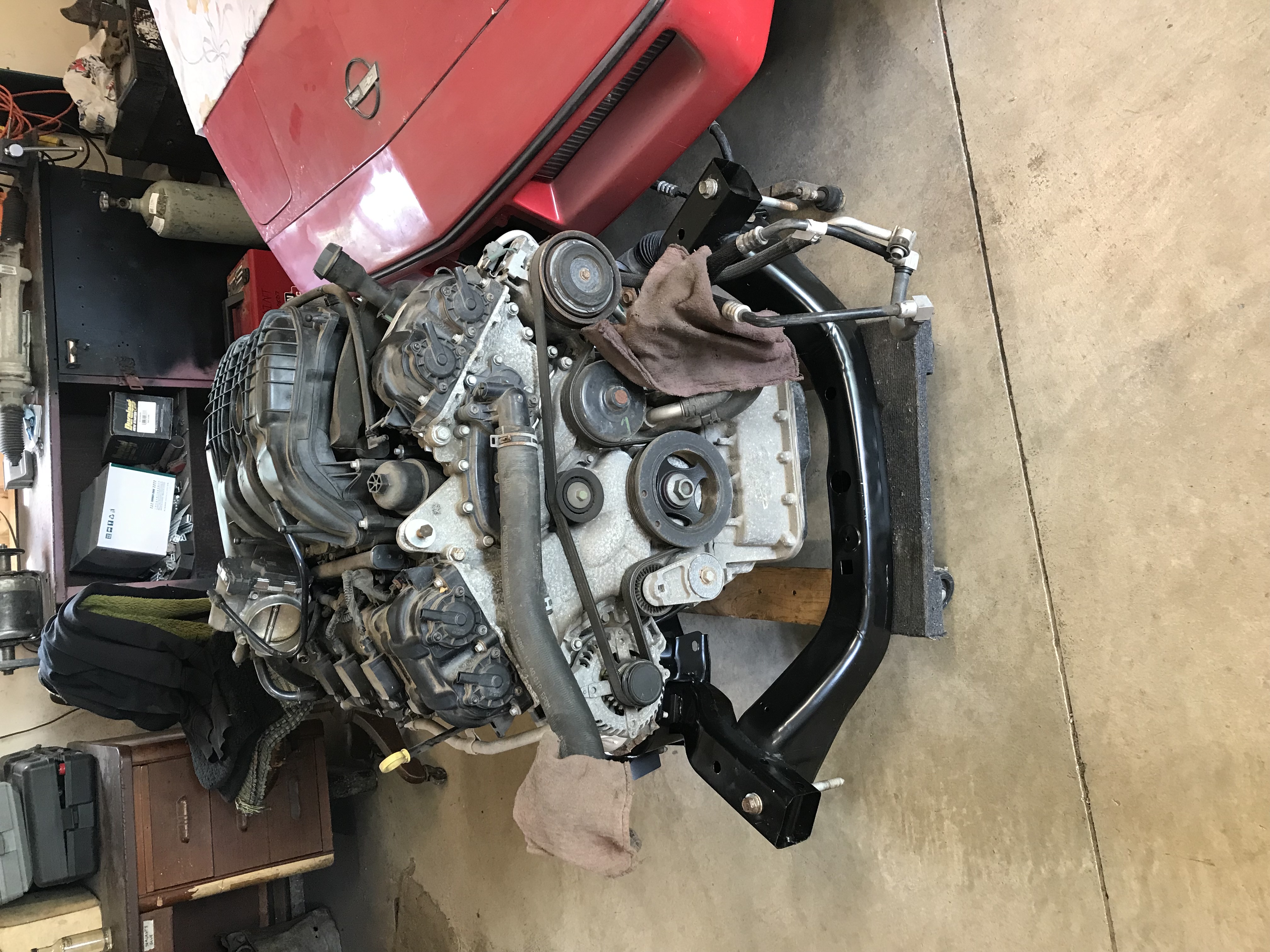

Installed the engine and transmission. Raised up the car and rolled it in place. Connected wires and hoses as the car was slowly lowered onto the subframe.
Once the frame was connected I lifted the whole thing back up and finished connecting things and torquing it all down. Finished out this process with installing radiator and the air filter housing. There was some fabricating required to get this to fit better. It was setting on the passenger side intake cam position sensor pigtail

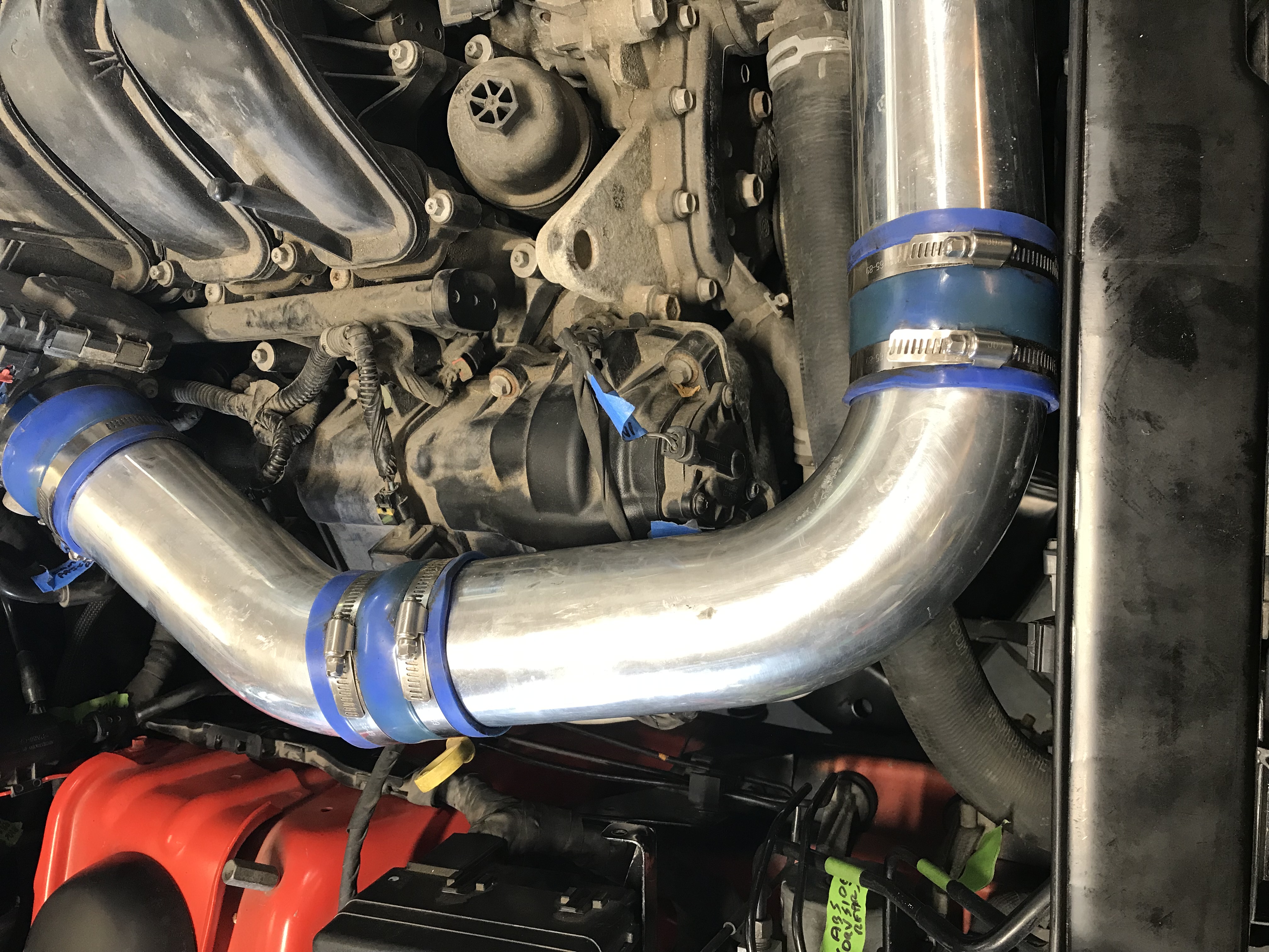

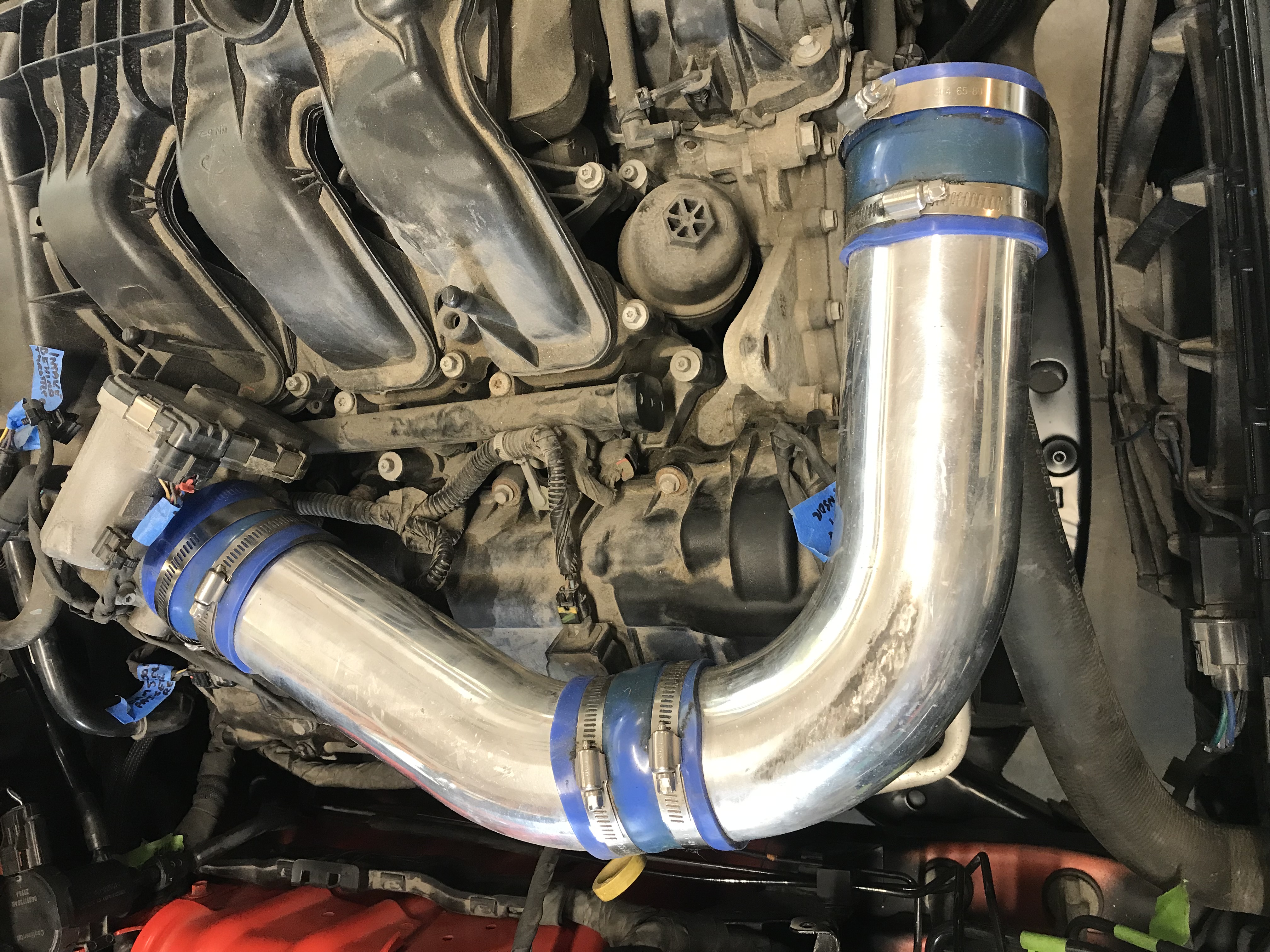

and rubbing on the bottom of the hood. I ended up reversing the middle pipe, adding a short extension, and fabricating a hanger to hold it up from the core support.

The headlights showed up so I installed those as well. First time since the crash this car has had headlights.
Also cleaned, painted and installed the strut tower brace. With that I had the necessary mounting locations to install the wiper assembly.

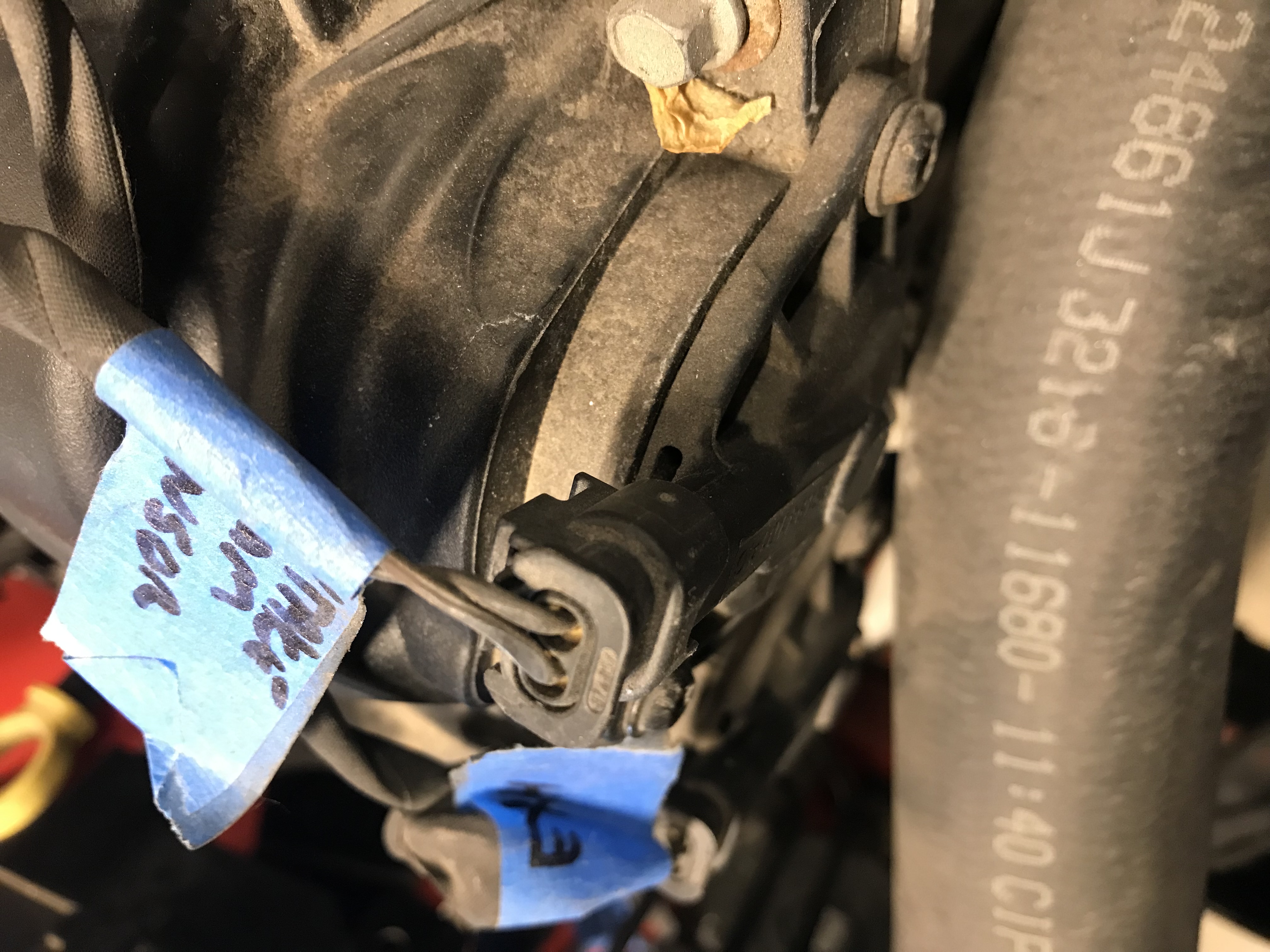

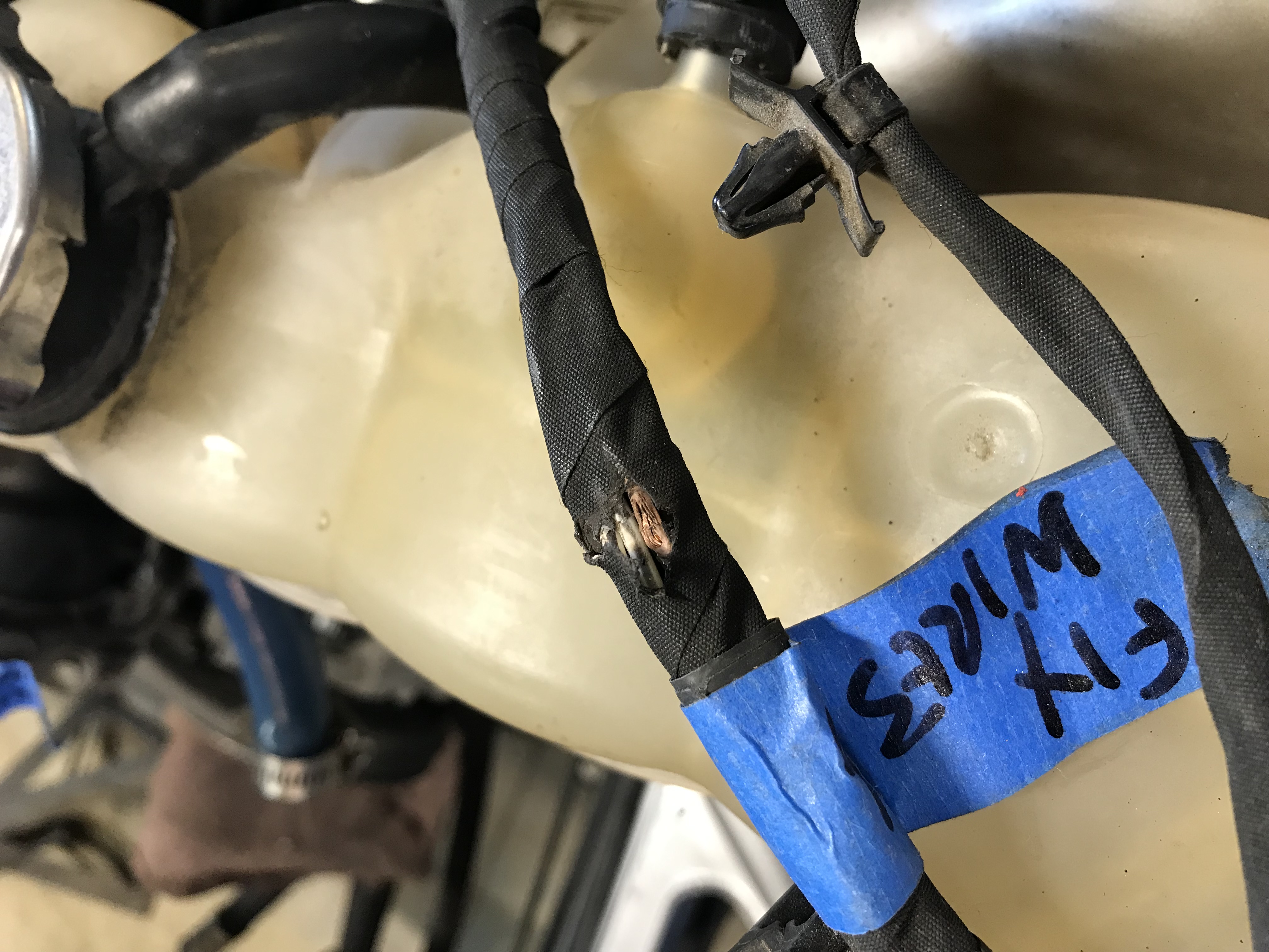

There were a couple spots in the wiring harnesses (horns, lighting) where a couple of the wires had their insulation damaged so I fixed those also.
I was able to cap off today’s work with a test start! It started really quick – almost like it was never apart and sitting for 9 months.

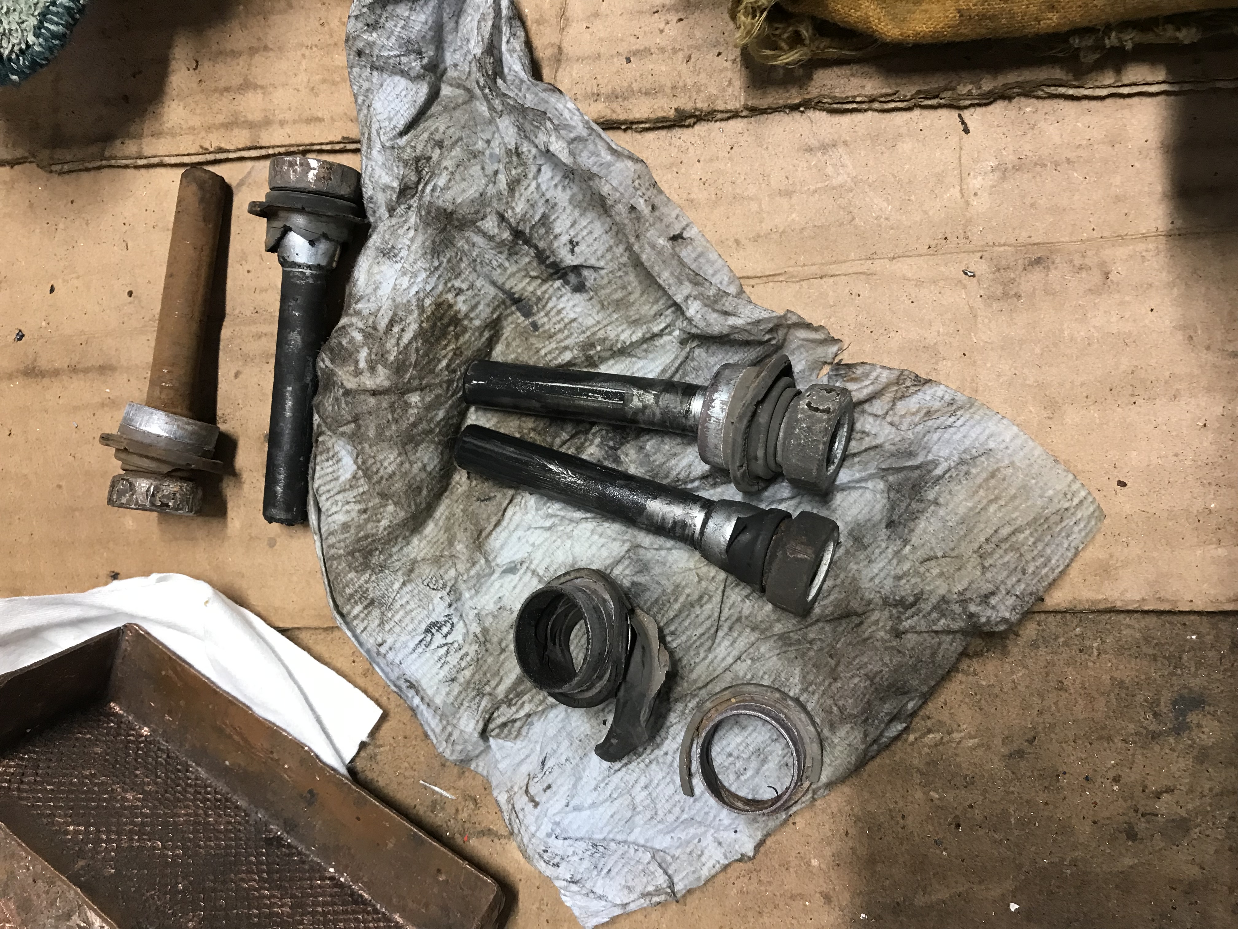

Installed new caliper bins and LF brake hose. Bled the LF corner and the rear calipers which opened the door to moving the car. A short move from the right to left bay in the garage uncovered some leaks in the brakes. Had a couple lines that needed up to ¼ turn to tighten. Had to bleed the system again which made it better, but additional lot drives got it a bit soft again.
Made some adjustments to the RF to better align with the bumper cover. Spent a good bit of time adjusting the LF fender to align with the door, and align with the bumper cover. The whole fender needed to come up a bit in the back which I achieved by moving the section along the top near the back mounting location down. It’s pretty close.
The driver door needed work too. It seems a bit low to where the window will not quite close all the way. Spent a fair amount of time trying to get the door up high enough. Ultimately slotted the holes in the top hinge and put a washer between A-pillar and lower hinge. Adjusted the front edge of the door to look more like the other door but not done yet. Also did some adjusting of the slot for the window as it’s a bit wider than the passenger side but also not done yet. Finally if the window is up when you open the door the Challenger automatically drops down about ¼” and then go back up ¼” after closing. Problem is this door window was not going back up. Ended up recalibrating the controller to get it to work properly.

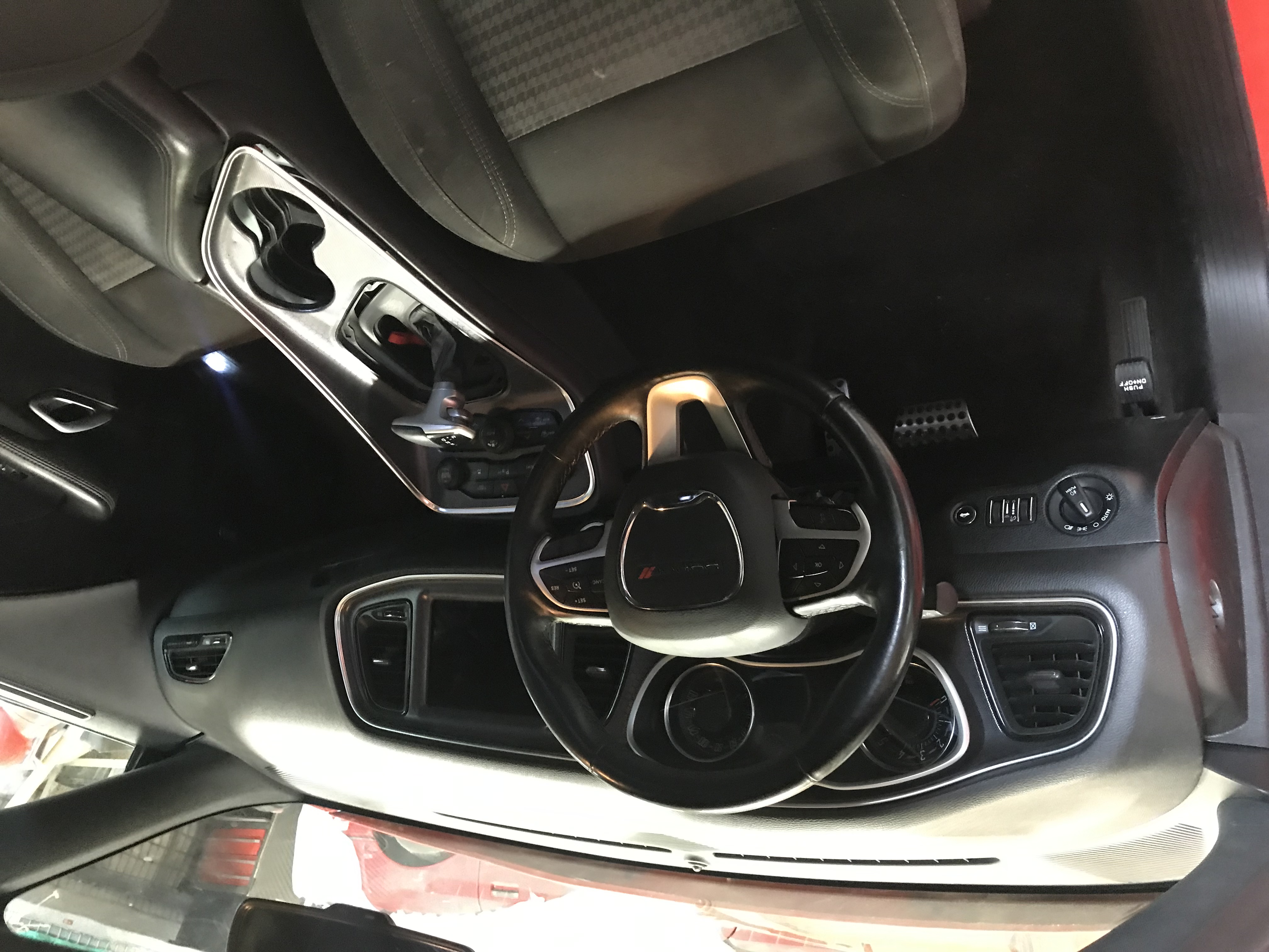

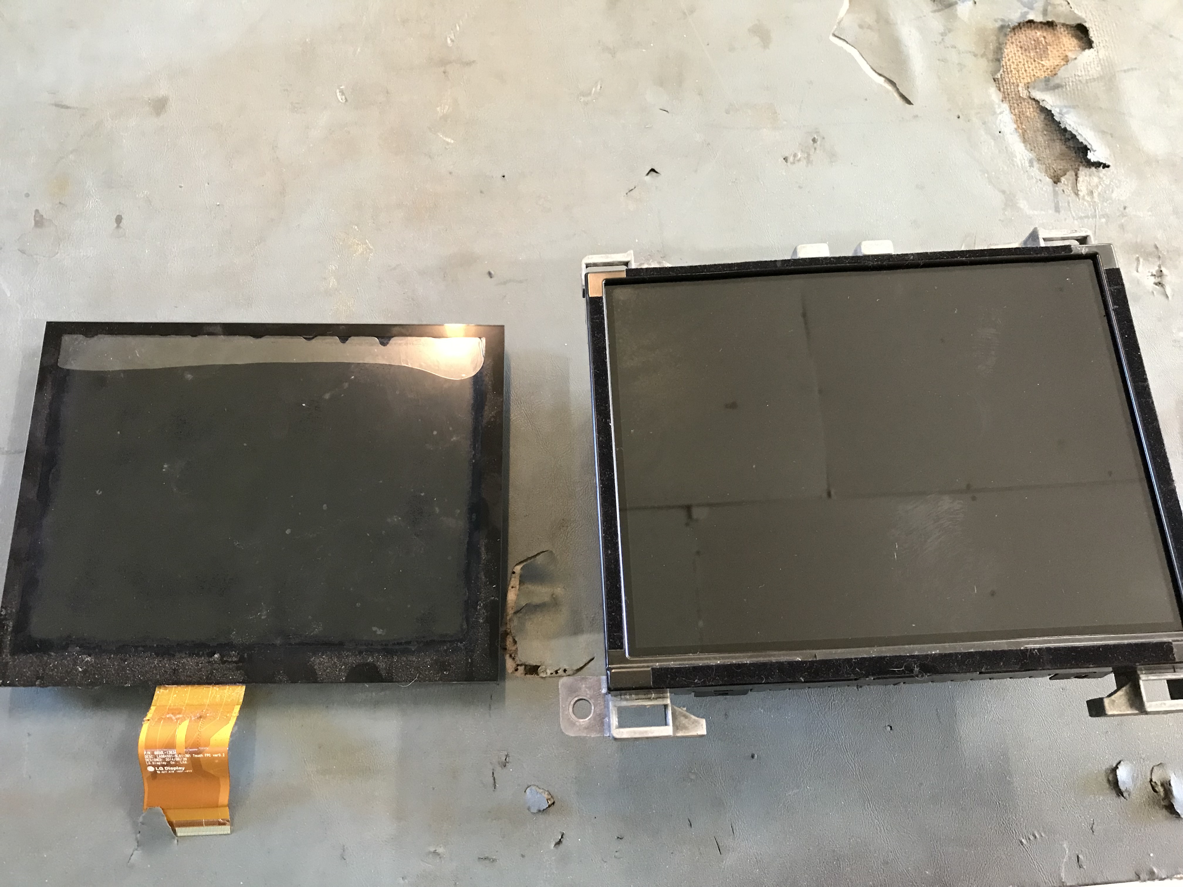

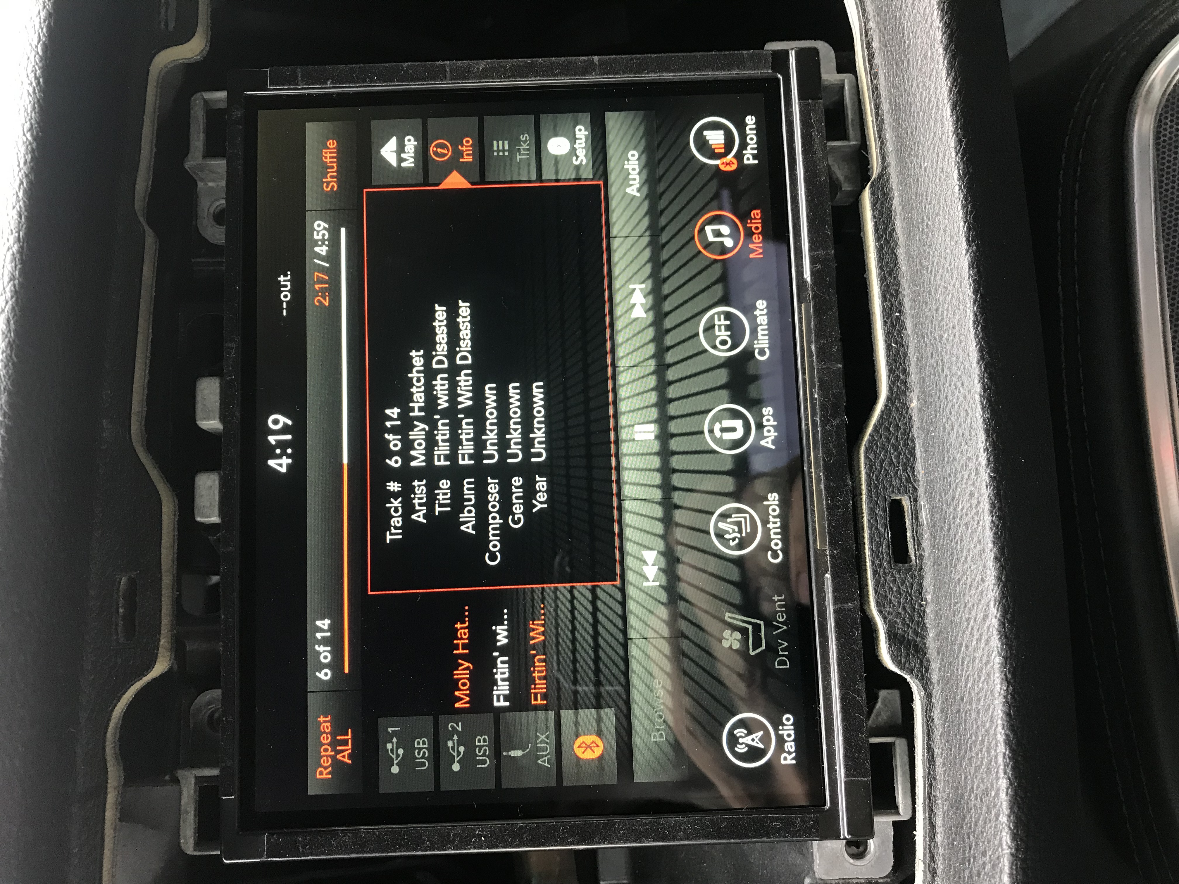

Made progress on the dash. Installed the lower panel, also the side covers. Then I repaired the touch screen (new touch screen into the unit) and installed it. Finished it off with the main dash bezel.
Installed the trim on the inside of the rocker panels, and the seats. Seat install uncovered an issue. The replacement seats are from a base model, and this car is an SXT Plus. The old seats had two electrical connections but the replacements only had one. The missing connector is for the heating and cooling function of the seats.

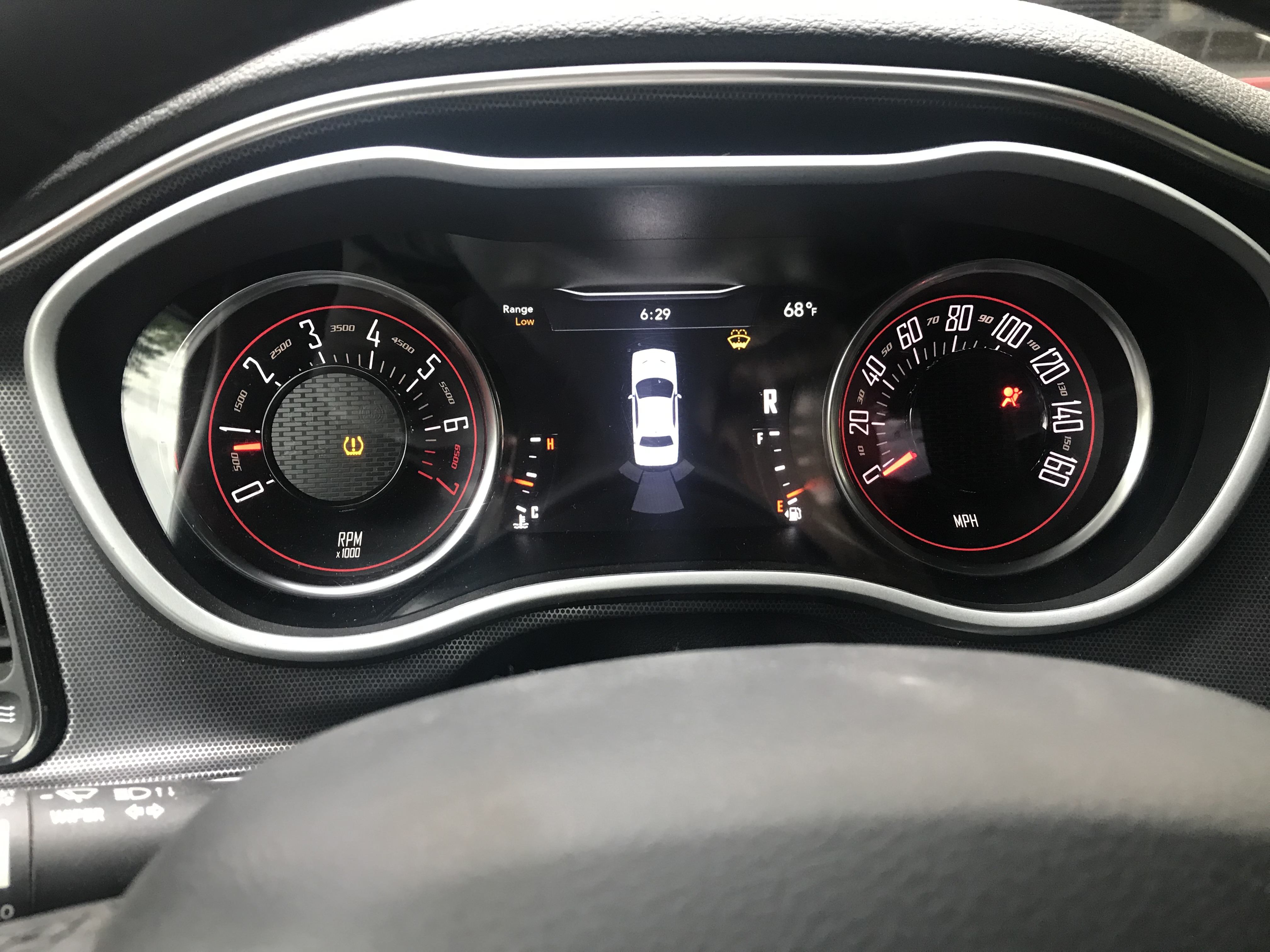

Installed the steering wheel airbag. With the seats installed made an attempt to get the SRS light out. It failed. Turns out the seat belt buckles have an open circuit. They don’t look deployed but they must have been affected by the crash of the donor car. I’ll send out these buckles for rebuild next week.

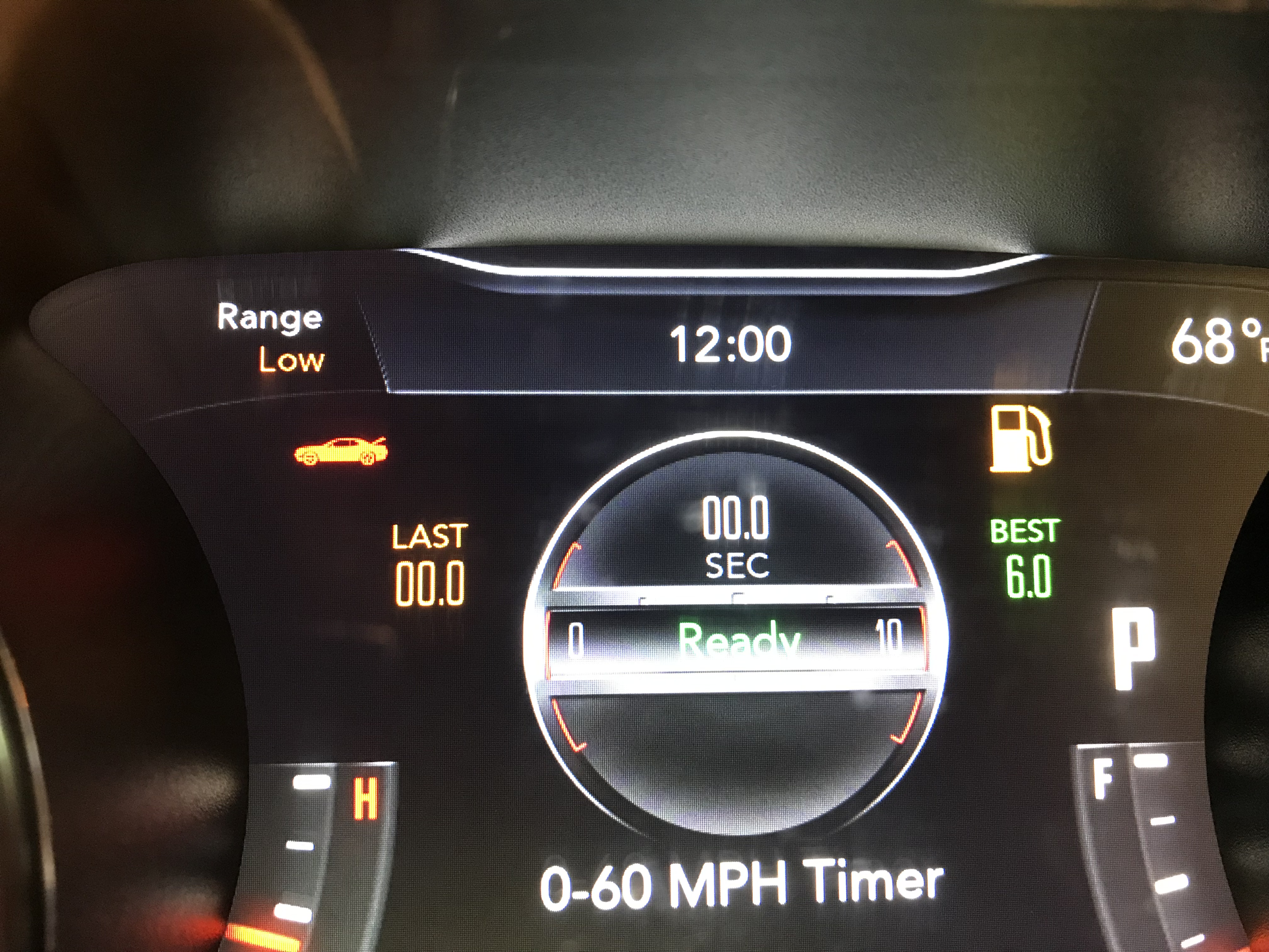

I learned this car has remote start! It won’t start unless the doors and hood are closed. It also has a built in timer for 0-60.
It’s starting to look and feel more and more like a car. I’ve started and idled it a few times, got it up to temp once and blead air out of the cooling system. Sitting in the driver seat, I want to drive it now.
