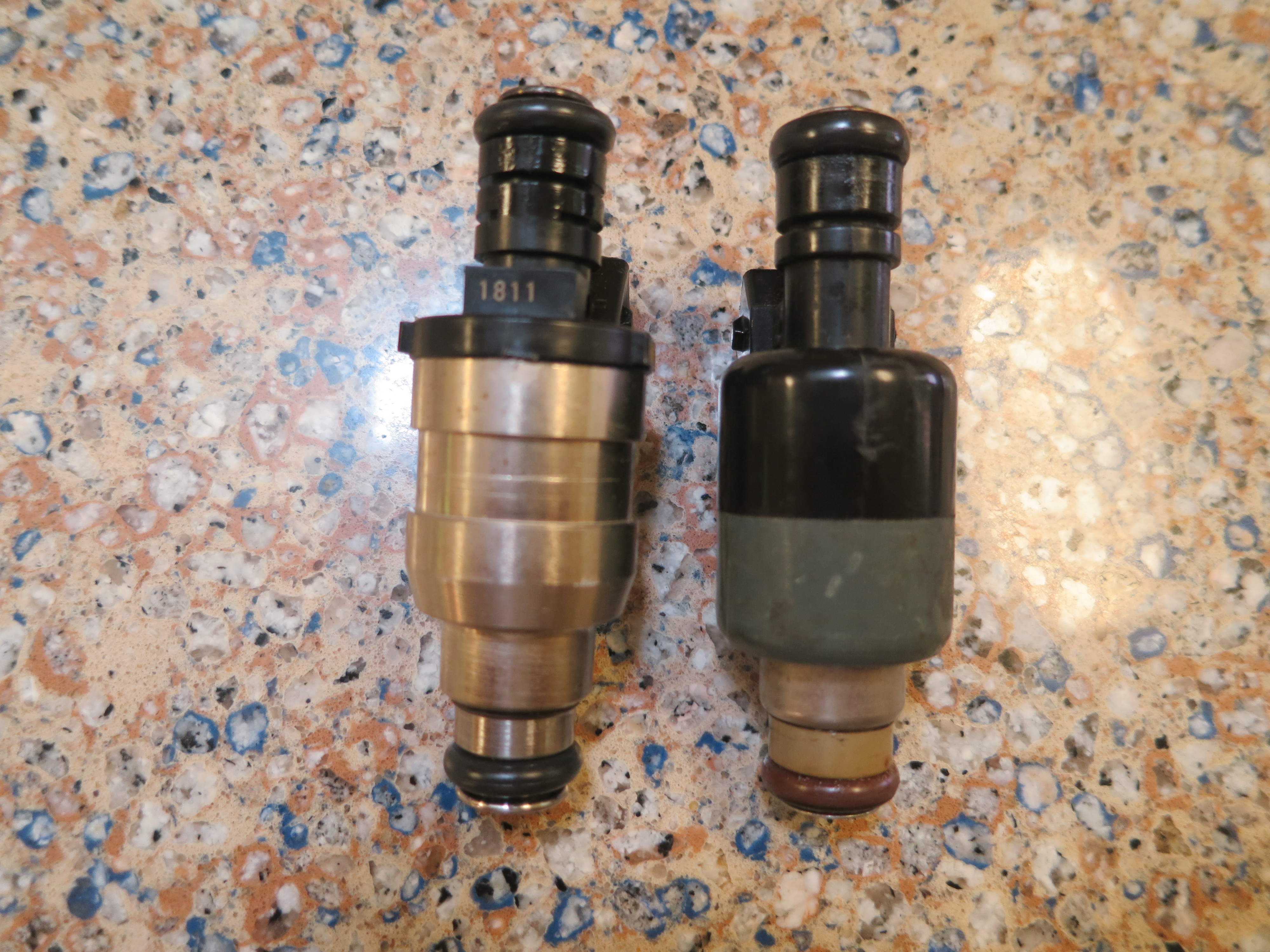

the injectors that came out of my C4 had rust stacked up on the fuel supply side. Once they dried out I tapped them on the bench and the rust came out like salt out of a salt shaker.
MostMint wrote:the injectors that came out of my C4 had rust stacked up on the fuel supply side. Once they dried out I tapped them on the bench and the rust came out like salt out of a salt shaker.
Were they usable after that?
Posts: 3023
I never tried them. I was just thinking if you are using those old injectors for line testing you might be introducing some rust into the return lines.
Excellent point! By using the old injectors, I was thinking I could to avoid contaminating the new injectors during the flushing process. But, I wouldn't want to add contaminants from the injectors back into the clean return line.

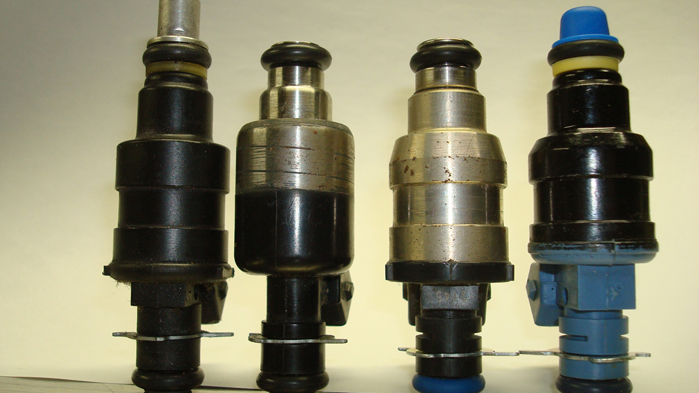

Next I turned my attention to the fuel rail. As I began to install the new Accel injectors, I noticed a difference in the clip location between the Accels and the originals.
Not sure how to proceed, I emailed my injection specialist friend, Rich Jensen, for guidance.
Rich said:
Here are four different injectors that have been commonly used on the TPI and LT1/4 engines.
The one on the far left is the TPI injector from 1988. The second is the LT1/4 style, the third is an Accel and the forth is a Bosch 24lb/hr. injector.  You can see there is a slight difference in the clip position but they all will work.

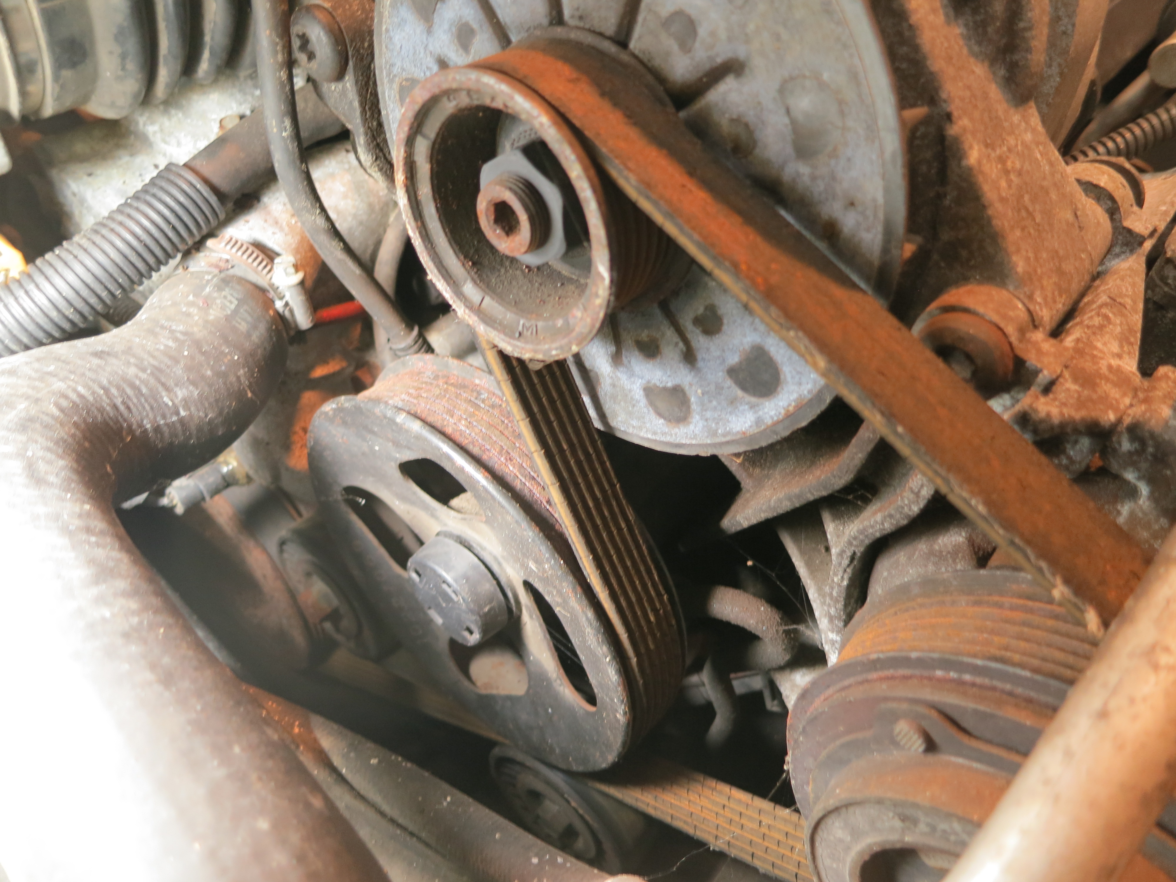

I'm not happy about how that went down, but I went ahead and worked on some other stuff. I was going to change the serpentine belt, but when I took a close look at it and the pulleys, I decided to wait until this thing is running. I reasoned that it would be better to let the old belt clean off the pulleys while it's running. I may have to take further action to clean them manually. I don't look forward to that.

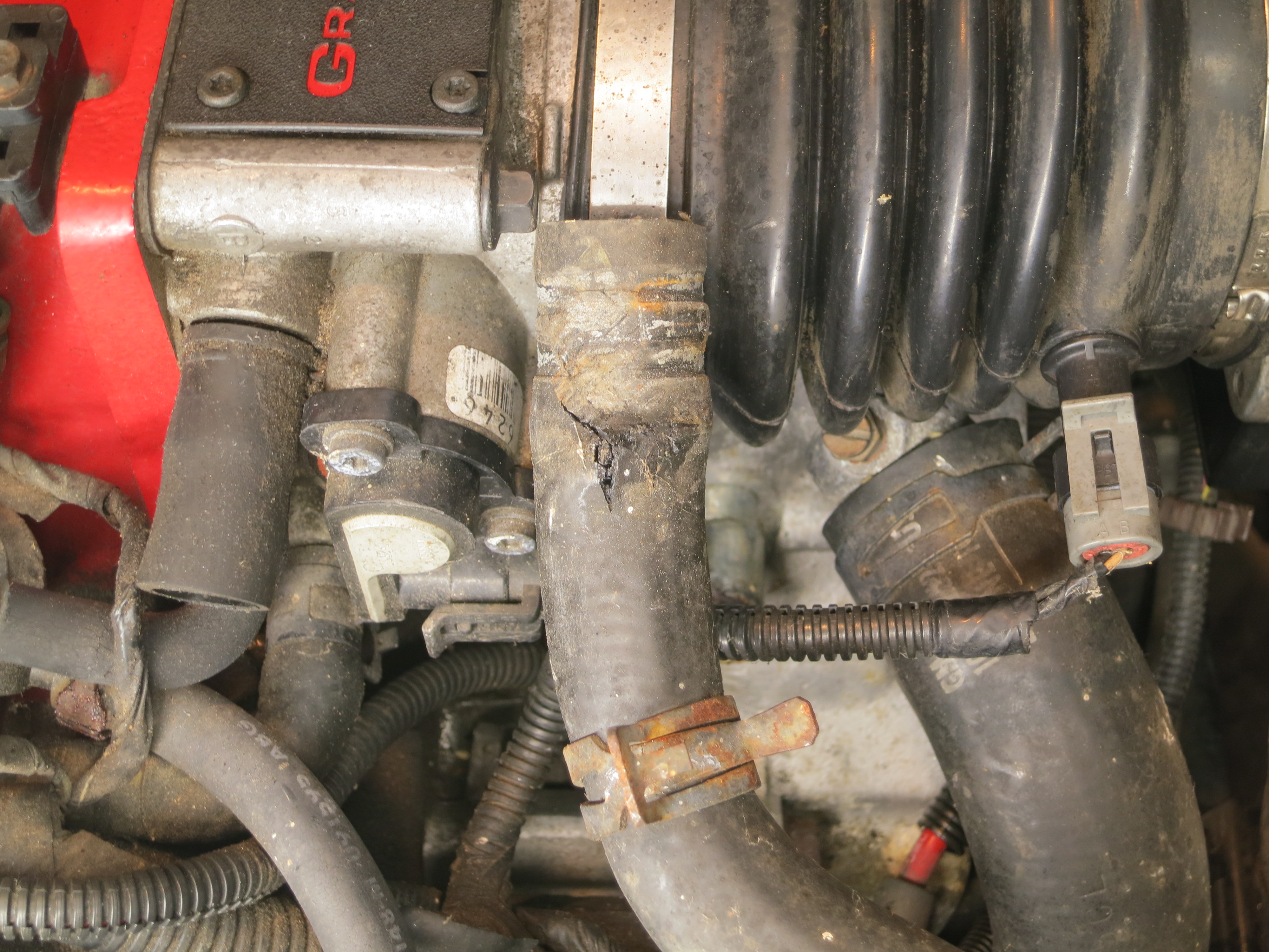

When I got up this morning, I just couldn't resist going out to the garage and starting her up one more time. Before I did, though, I looked all around for a vacuum leak and I found a big one. It was a major hose in the EGR system which I had forgotten to connect after I worked on the spark plugs.
So I put my jumper on the oil pressure sensor to get the fuel pump going and hit the key. She started right up, but the knocking was still there although greatly diminished. Once at operating temp, here's the videos. Be sure to watch them back to back to get the full effect. https://youtu.be/fOvdAW_BsUE.
