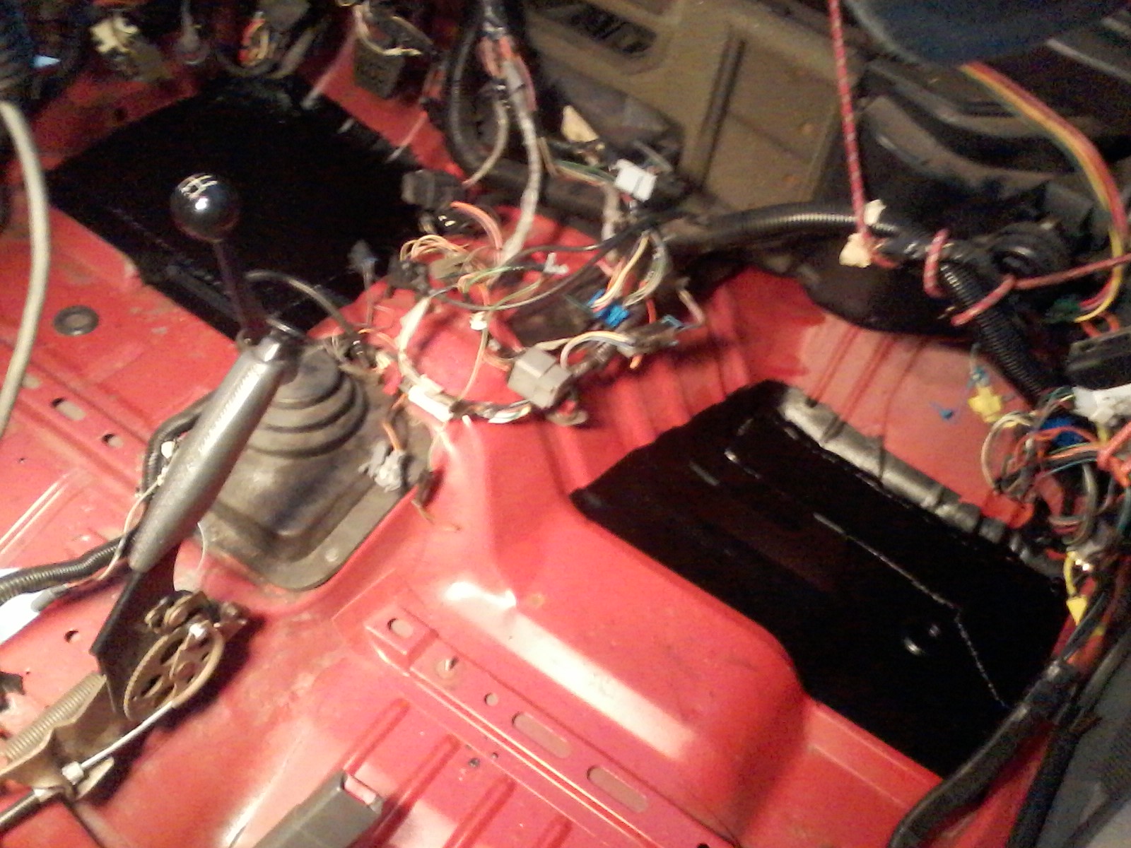

Hopefully we won't need to use anything like that anymore. Given the nature of the car, we didn't bother with metal prep, we just cut out the bad stuff and welded to something solid. And since it's probably not going to rust any further, I'm not too worried about it getting worse. This poor car sat outside most of it's life, I'm sure, and T-Tops given their leaky nature, caused this problem. Michigan salt didn't help much either.
Good tip for the future though. I've also used Rust Oleum's Rusty Metal Primer before painting and that stuff is awesome. We're coating the floor with bedliner material so it should be sealed pretty well.

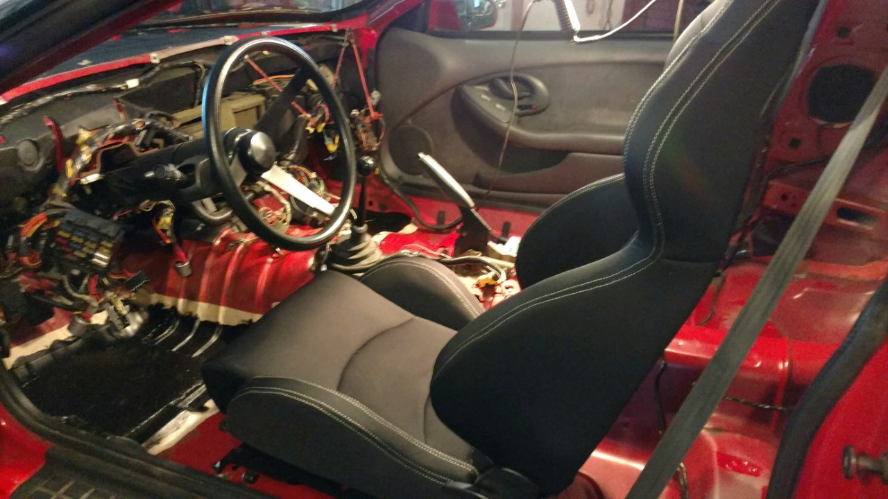

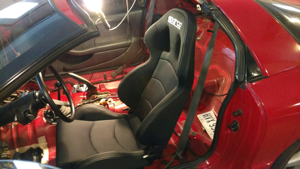

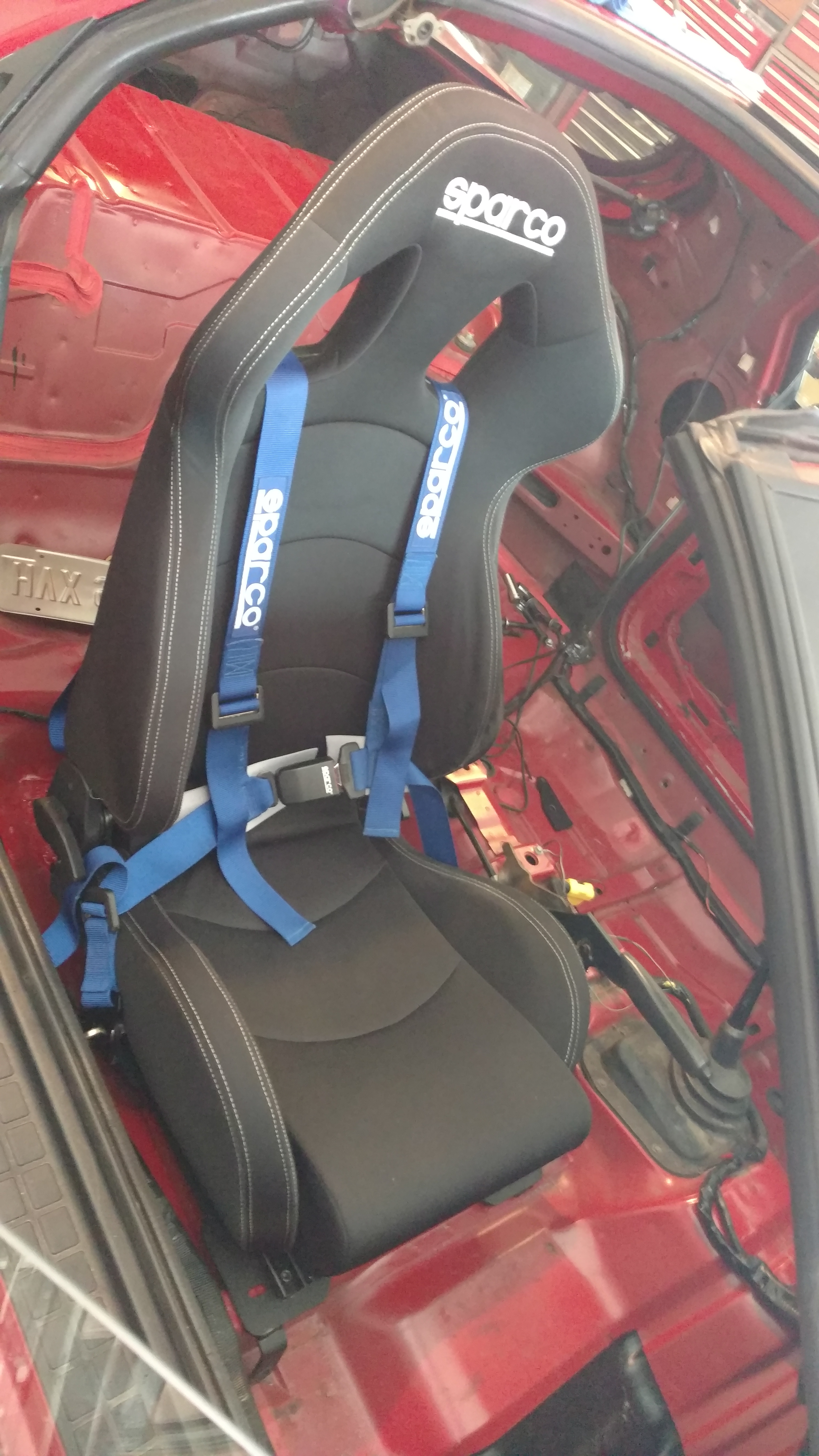

Between yesterday's activity and a couple hours this morning, we were able to get the driver's seat mocked up and installed using the existing seat frame that came with the sparco seats. There was drilling, welding, and grinding, but we got one done so far. Unfortunately the floor on the passenger's side is different than the driver's side, so it will be like starting all over next week. At least we know we can do it.
The seat does fit well, and has lots of travel for short and tall people. We made sure to test fit Fred with his helmet on to make sure he'd clear the roof before we started welding things. Just sitting in the garage it feels like a HUGE improvement over the stock seat. Between the new steering wheel, the sweet shifter, and the seat, the car has a real cool "feel".

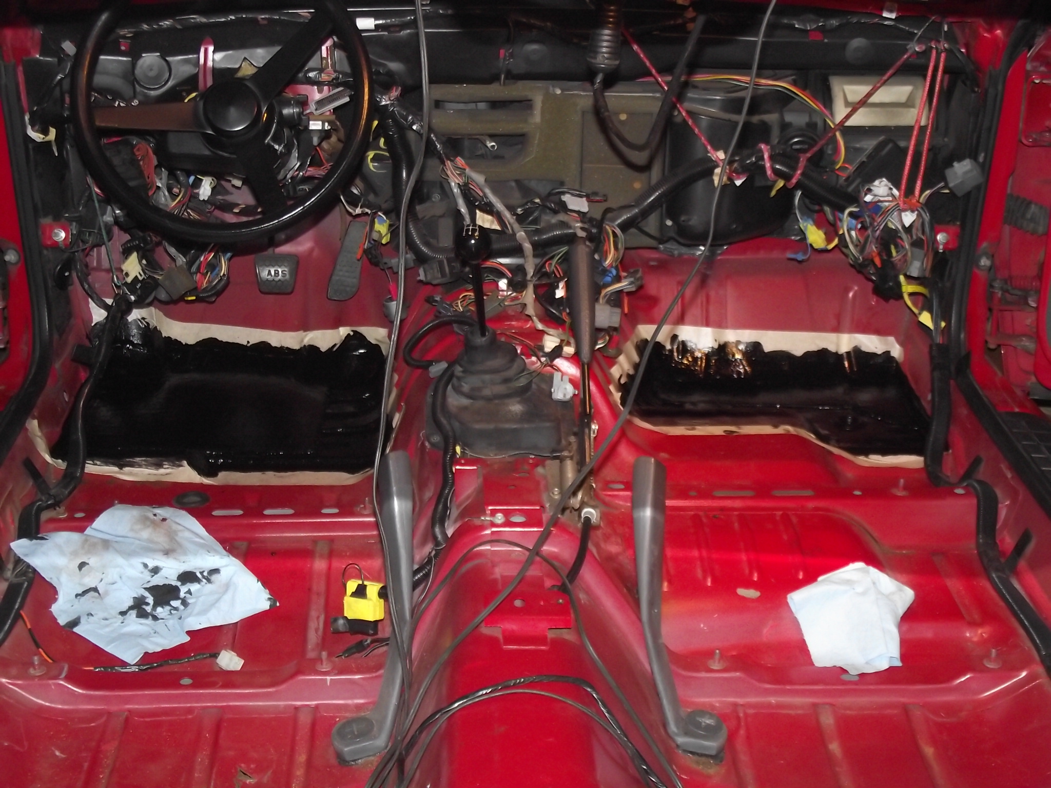

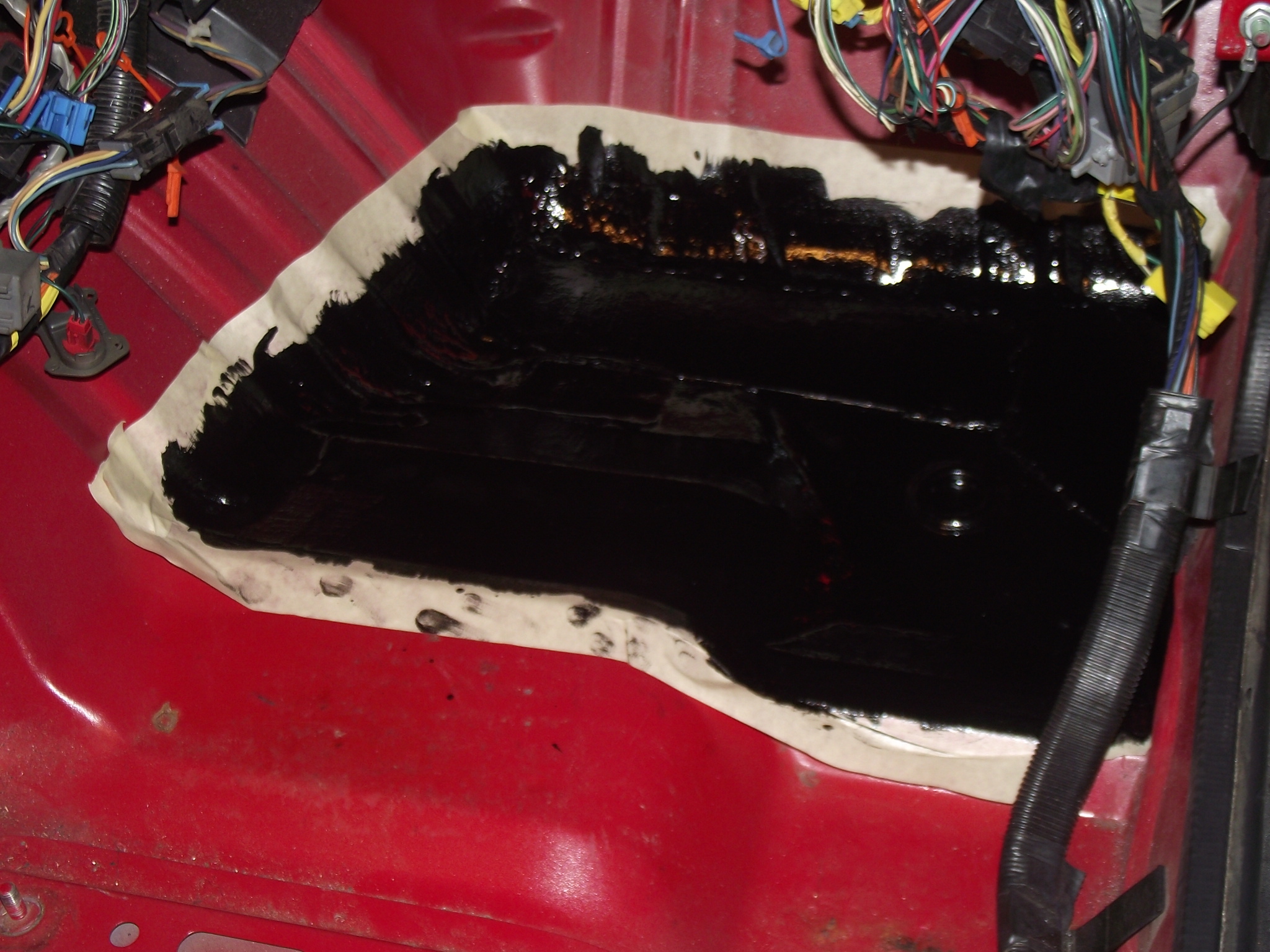

Re: 1997 Pontiac Firebird Paint issue

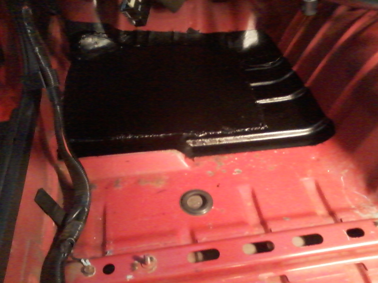

When I left the the 32V Garage Sunday in the late afternoon,
I had just applied a third coat of Bed Liner on the floor repairs.
This morning was the first time I've check and the floors are final dry to the touch. Also removed the tape.

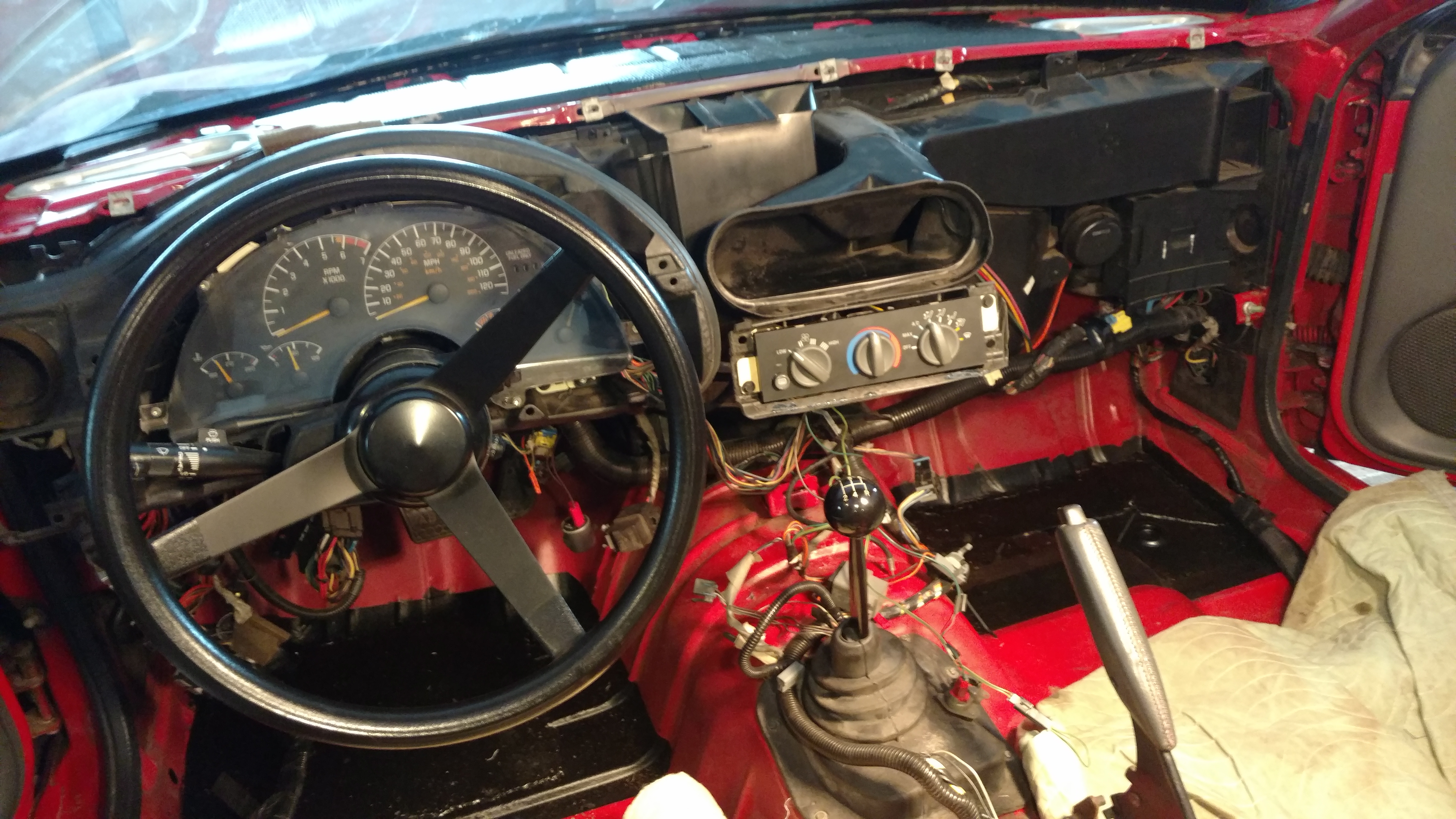

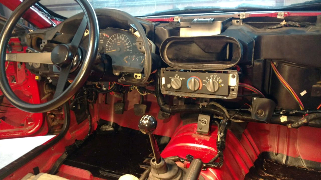

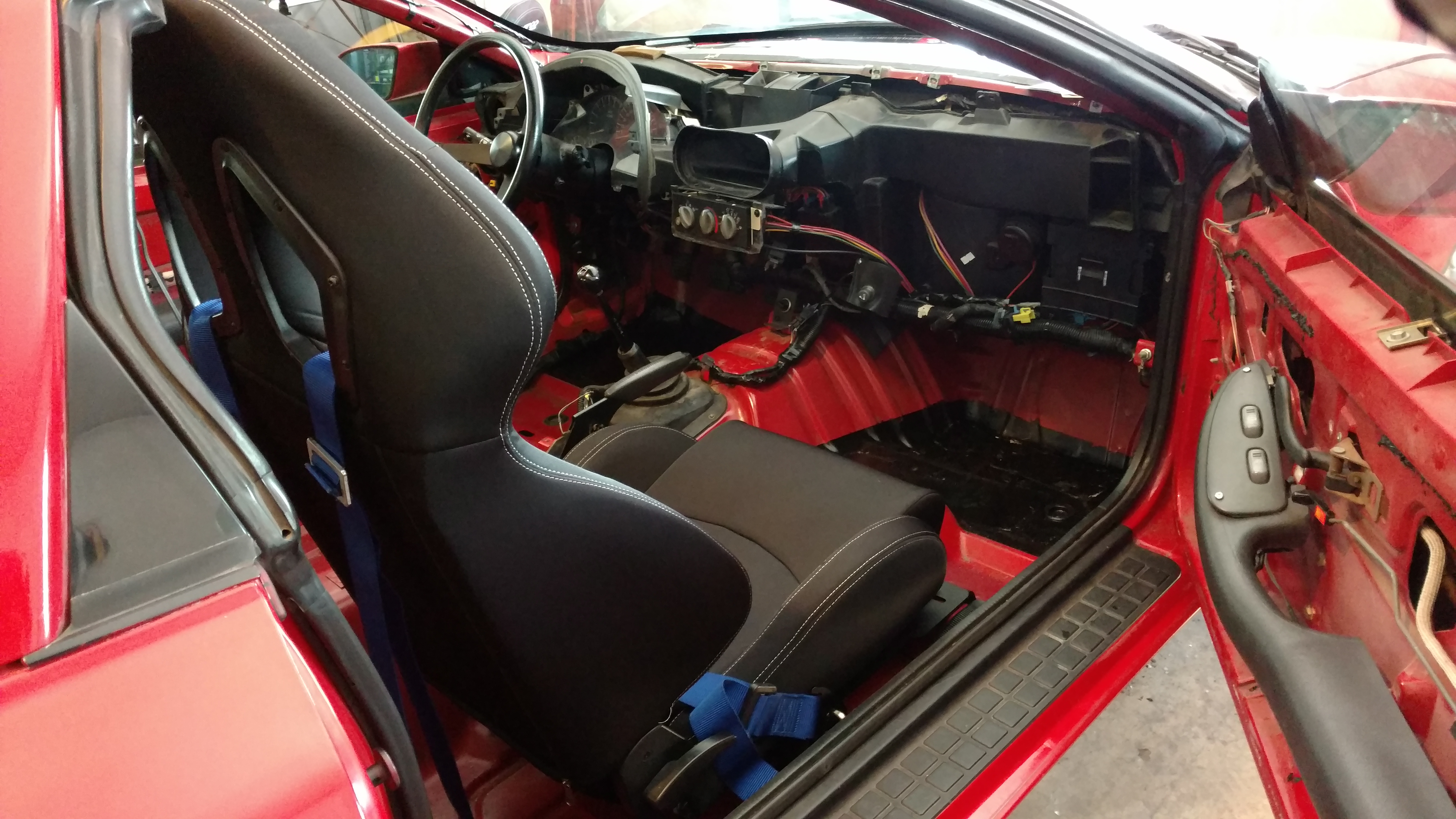

Today's activities revolved around getting what's left of the dash area put together. First up was the ducting for the heat and vent. That went into place relatively easily, and with a few we'll placed sheet metal screws, it was secured solidly.
Next was the gauge cluster. After a few different theories, we decided to cut apart the mounting area from the original dash, and mount that to the ductwork. Then installing the cluster was simple using factory screws. This also helped with routing of the main wiring harness.
Last up was the radio and HVAC controls. The radio was super easy as we decided to just not use it at all. This saved us 5-6 lbs for just the radio, and probably another 5-6 once we pull the speakers out. So then we just had to mount the controls. With the center air duct hanging right out there, it was an easy go-to. We took a page out of the cluster book and cut apart more of the original dash to make a solid mount. A few more drywall screws later, and that was done.
I tidied up the wires all around the passengers footwell, and we called it a successful day.
Next up will be the driver's side wiring cleanup, and the passengers seat mounting.

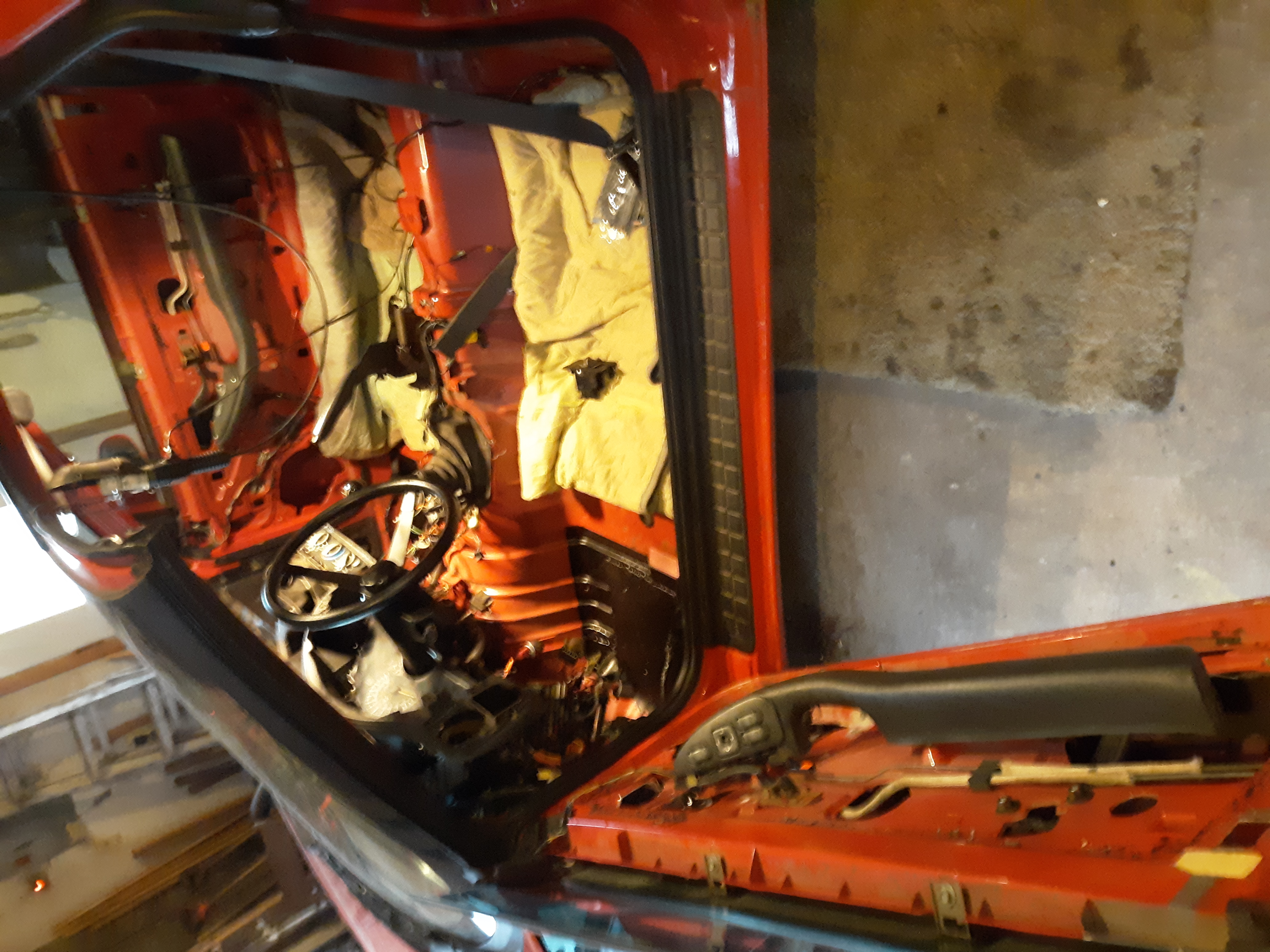

After a quiet afternoon in the 32V Garage,

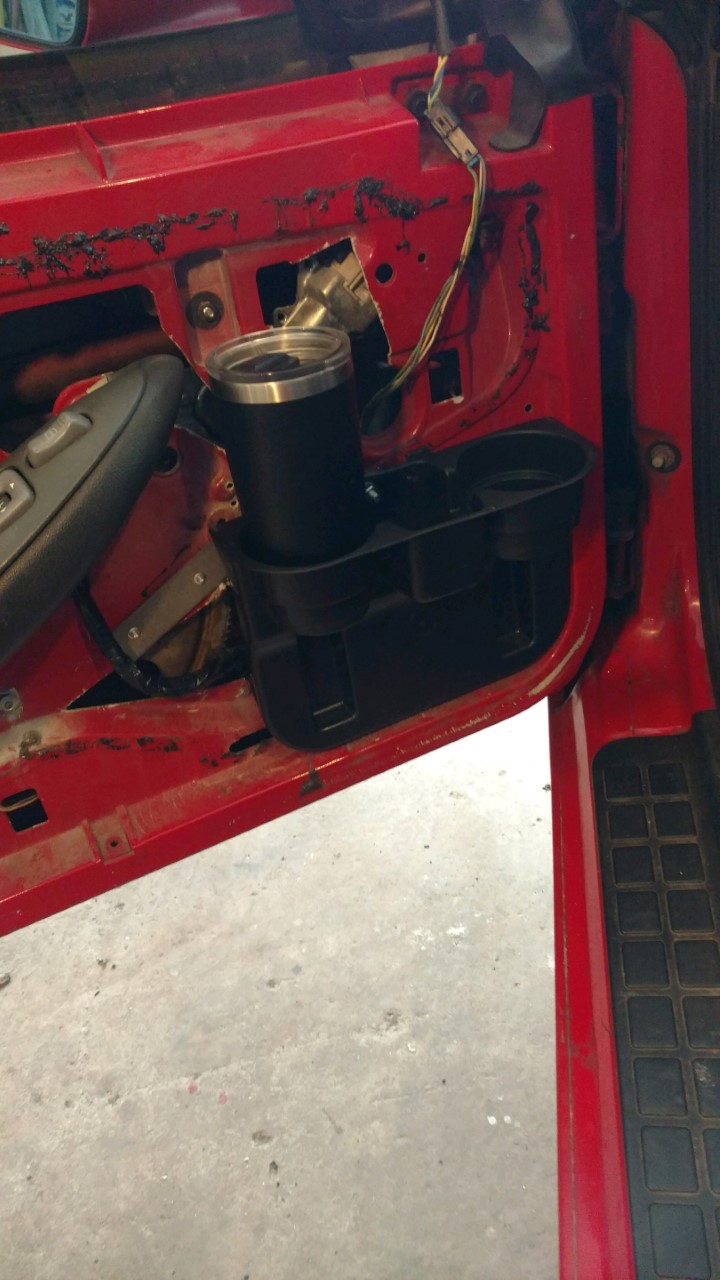

the door panels have been removed and the speakers are out. The switches have been retained and the armrests are a little long.
Once the seats are in they will be trimmed back.

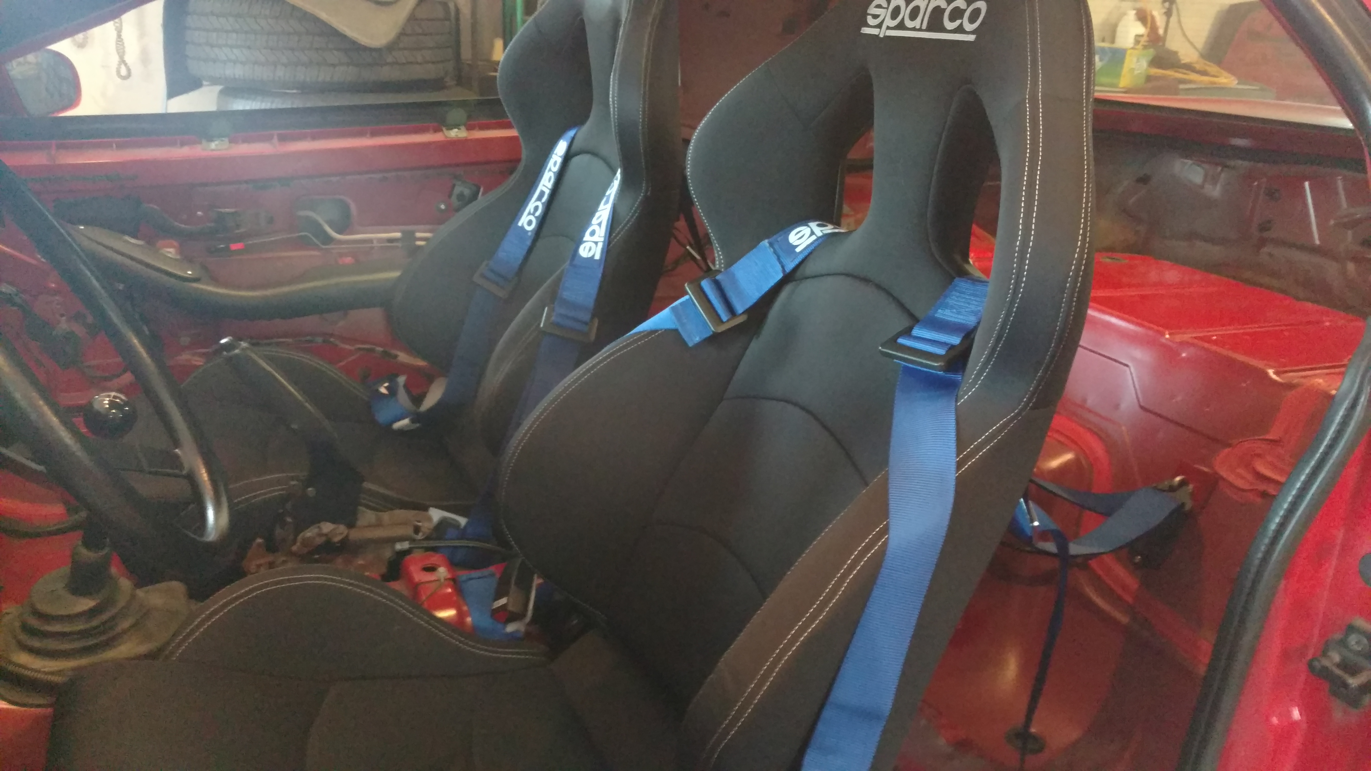

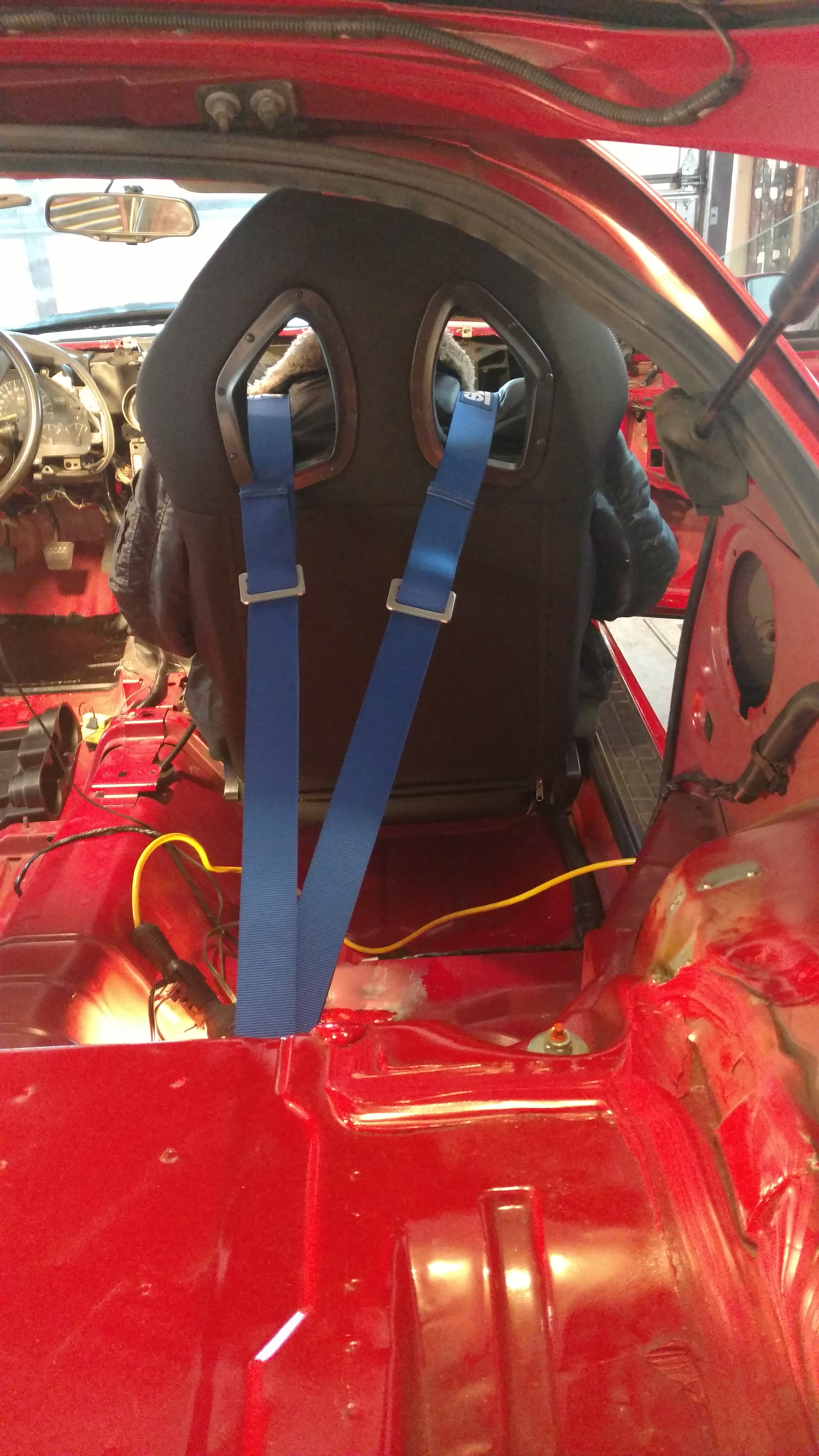

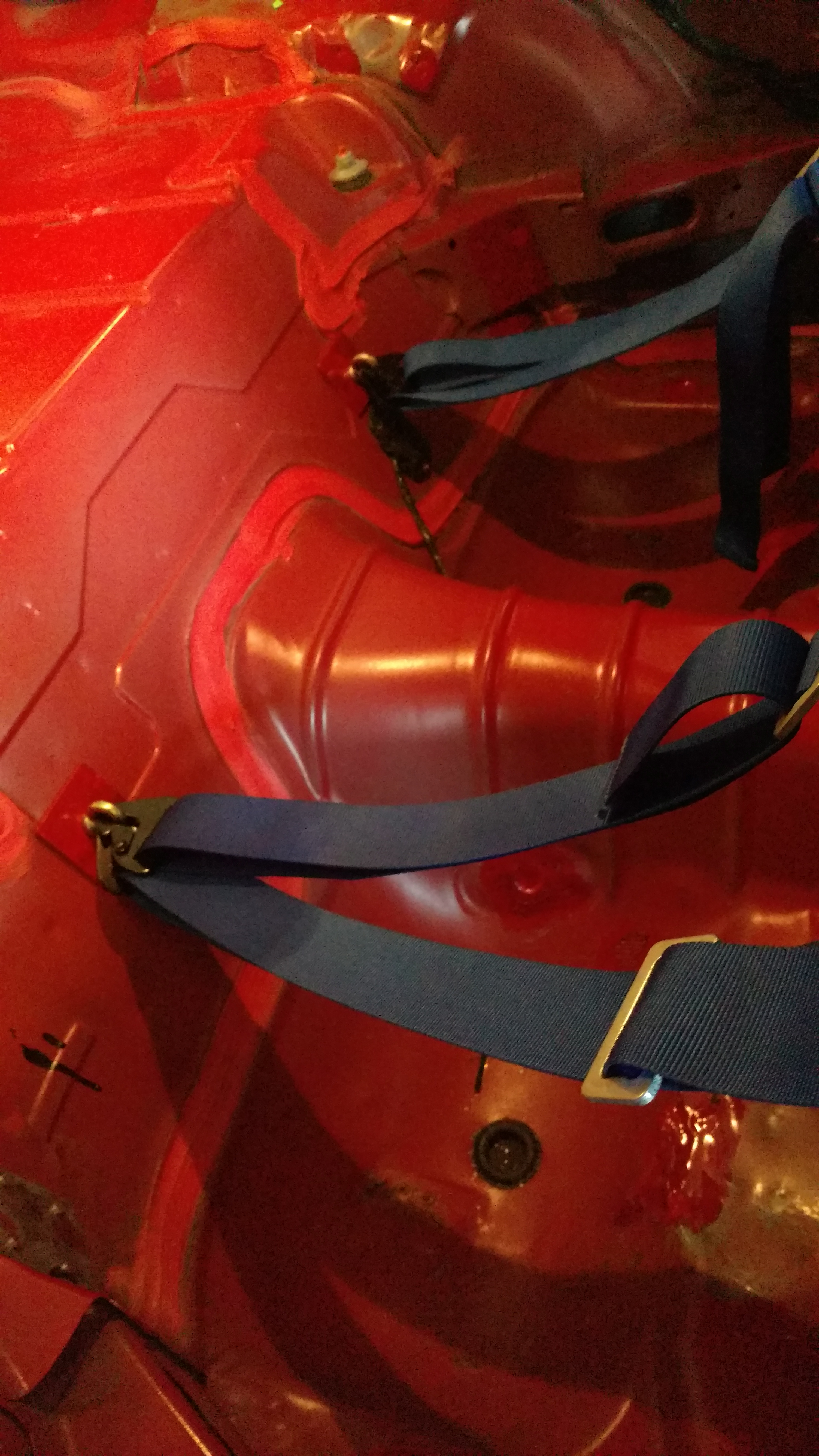

Yesterday we went to work putting the seats in. We started on the passengers side and although what we thought we be a drop in at this point required a little more work with the die grinder and now it's done for real.
We started thinking about the four point seat belts and went to work on figuring those out.
After some screwing around we got lap belts mounted and made some plates to mount the shoulder belts to the floor behind the seats but didn't finish the install on those. That will happen on our next episode. In the meantime we were also able to remove the stock front seatbelts.

I suggest doing some research on seat belts before bolting those to the floor. I think the geometry is all wrong and will not be safe in some situations.
The Saturn was like that when I got it and I remember getting some flak about it but I can’t recall the reason it was bad

According to the instructions that came with the belts, it was do-able. But I've been rethinking it a little bit which puts the mounting surface about a foot off the floor and a little further back. I have a 1" x 2" piece of aluminum that would theoretically bolt in all the way across the back seat area with little modification that I might use as a mounting surface for the hooks. It would be more sturdy than the floor, and not be excessive weight.

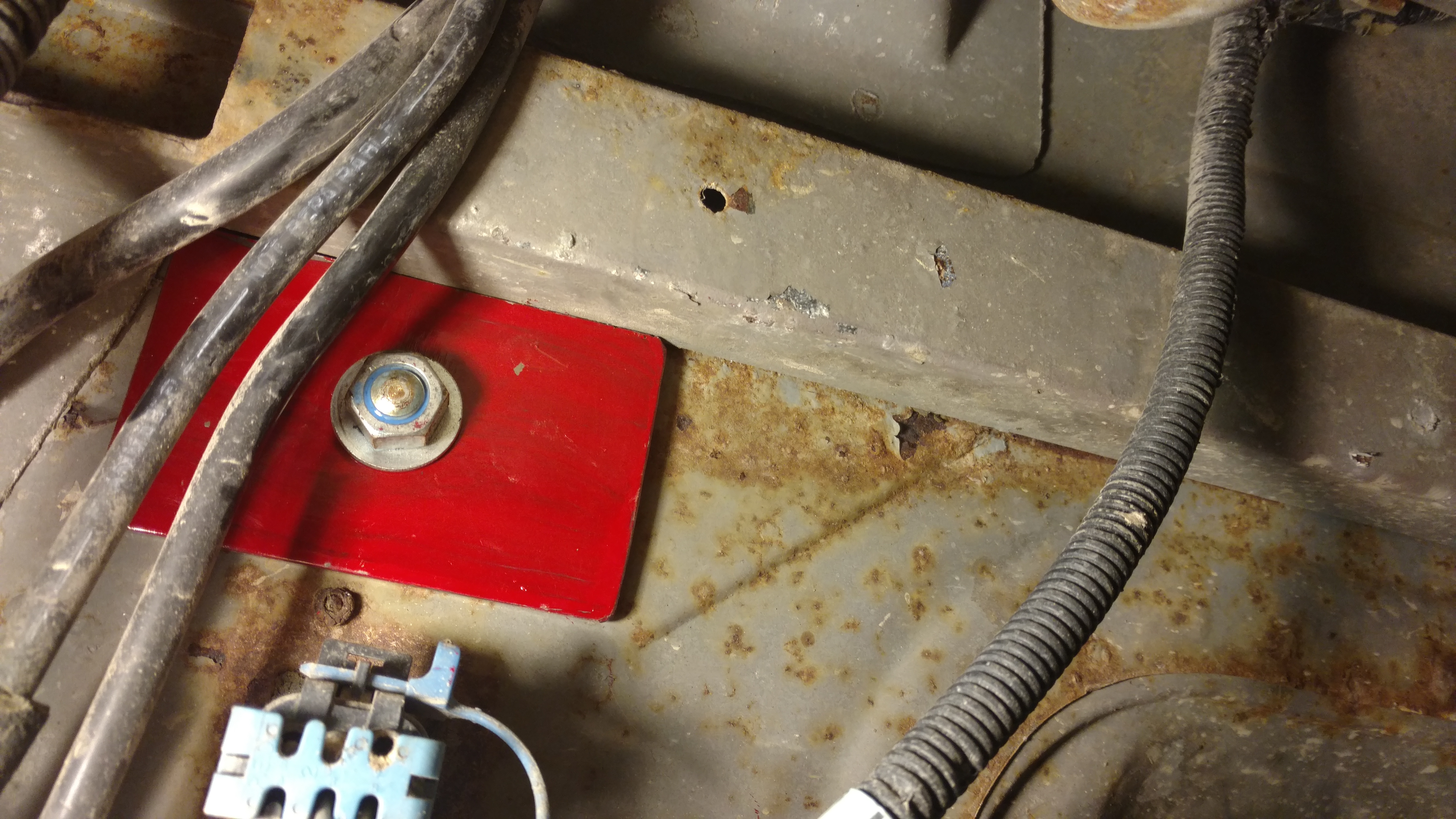

After more research, the floor mount was not recommended. So we found a relatively convenient location much higher along the back seat area that could house our mounting plates and began drilling. By the end of the day, both seats were installed, and all the seat belts were at their final resting place.
With the weather as nice as it was, we were able to take the Bird out for a spin. The things we learned during our trip was that we needed to reinstall the black cloth dash pad because the reflection was nearly blinding. The directionals don't work, and we'll need to reinstall the relay under the dash, accidentally removed during the dash removal. And the passengers window doesn't work now, most likely happening when the door panel was removed.
We have a few other things left to do, but we're getting real close to being ready for all matter of racing activities.

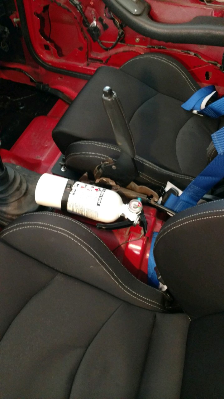

Once those things were done, we did a couple more small tasks. The first was installing the fire extinguisher between the seats and the second was mounting a cupholder to the driver's door. Simple tasks, but both very important. Where would I put my coffee otherwise??
